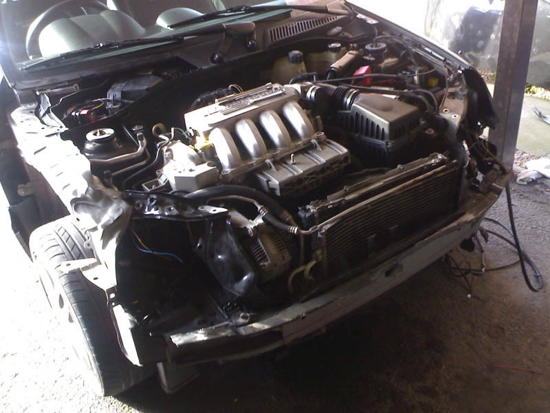

after my accident ive stripped the car back to reveal the proper damage here are the pics..

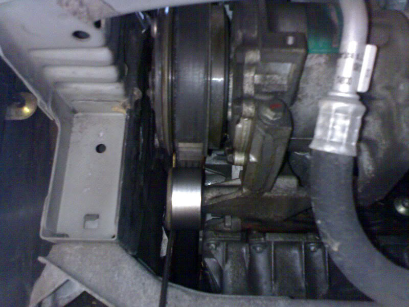

this belt has also tore and a strip has come off i take it its the aircon belt
what are peoples thoughts?

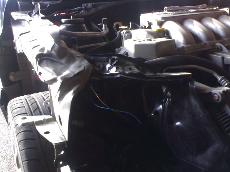

From your pics it doesn't look that bad really! I'd say try and get a quote to fix the damage then source second hand panels and get them painted.

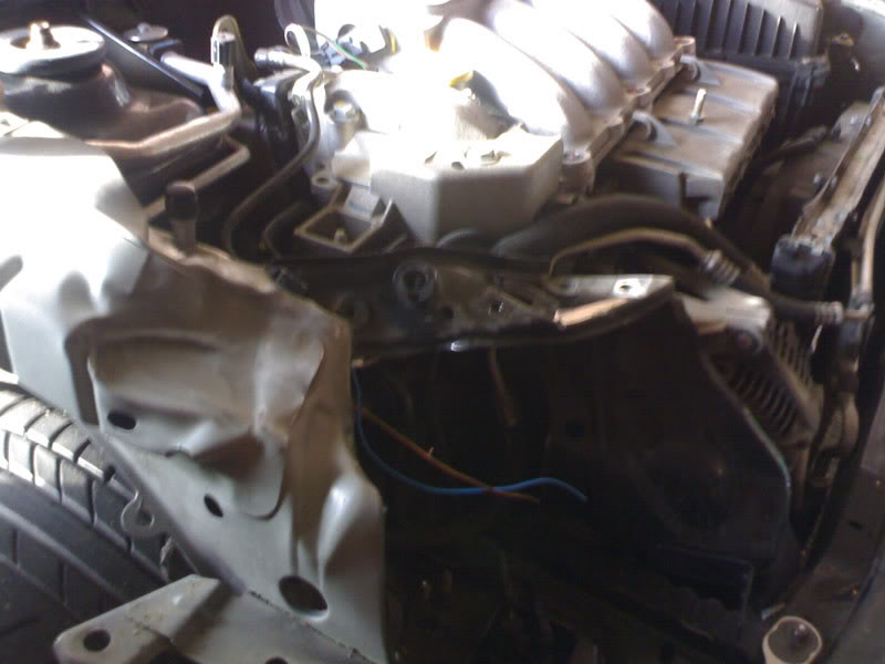

Looks like it may need a new flitch on that offside (thats the metal part above the front wheel thats bent).
All looks fairly repairable. No suspension damage i take it?
thats good to hear guys cheers theres lots of broken lastic parts i dont know what they are that broke im gonna try and sort as much as i can myself.

aircon belt?
slam panel looks ok its just the bit that sticks out that has bent
engine cover
the bit that bonnet locks onto
on the top pic bottom of the tyre to the right whats that? thats also broke
as far as i can tell theres no suspension damage i need to look into it abit further.

ah loverly cheers fred ill give them a call soon, would that be matt blacks number?
how would i go about getting the bits straightend is it a renault job what kinda price would it be?
thats a bodyshop job mate, unless you're good at welding/fabrication
yeah ring up and ask for yankee doodle matthew
