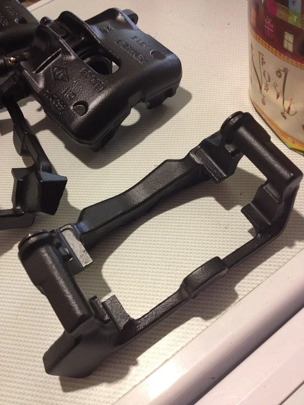

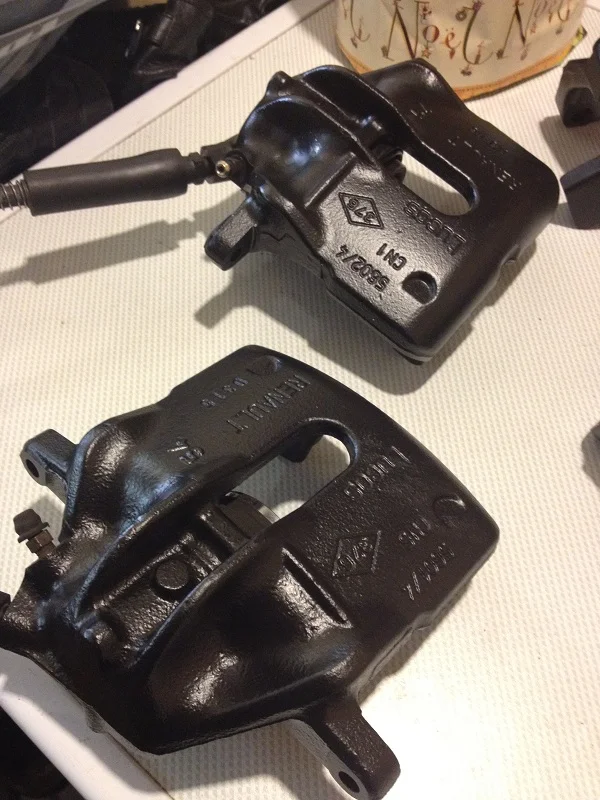

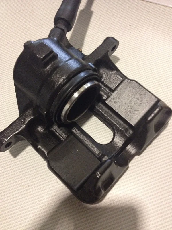

i wouldnt, you'll have to strip it down very very well and mask all the threads and unless you find someone who will put the Powder coat on very very well its likely to be silly thick and clog up the caliper, care will have to be taken as you only want it on the front face really i guess (the bits you see).
Just use a wire brush and hammerite. Ive had the pad carrier pwdercoated, but youd need to strip down the caliper itself fully to get coated. Plus with blasting, you will have a hard time keeping the fluid channels clear of debris
