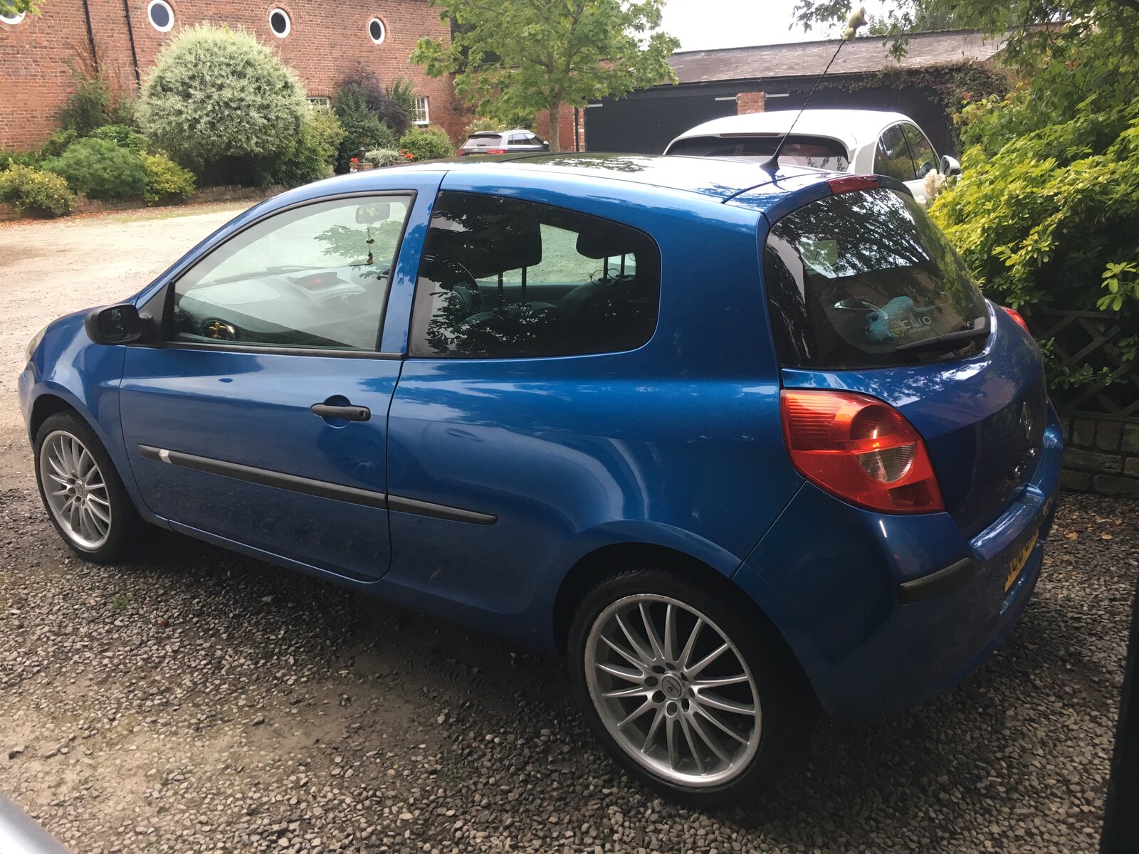

Is it possible to add the TCE turbo to the N/A 1.2 Clio?
Car  Clio Extreme 1.2 16V
Owner of a mk3 (pre-facelift) Renault Clio Extreme. 1.2, 16V, 75bhp, 2006 model. I’m wondering if it’s possible to fit the turbo from the 1.2 TCE to my car, or if there’s a difference in the internals of the engine. Or perhaps there’s a 6 speed gearbox as oppose to a 5 speed.
I’ve seen the turbos online pretty damn cheap. An extra 25 BHP or so sounds pretty nice:) any info would be greatly appreciated
