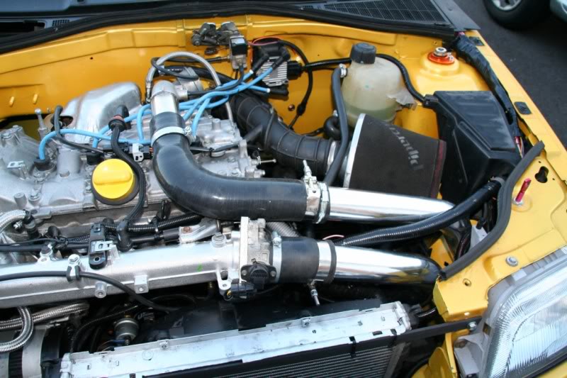

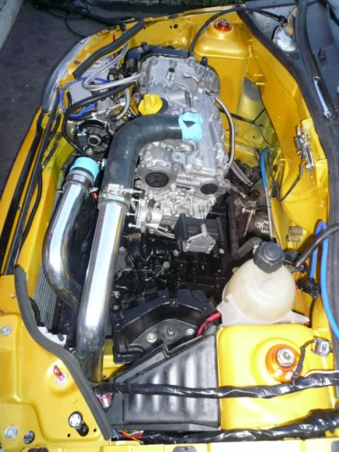

I decided when i fitted it to my car to keep the Jc5 not for ease but for the weight and the clutch issues, i didnt want to be pulling £££ to replace a 6 speed clutch that are expensive etc.. Here is a photo for you
