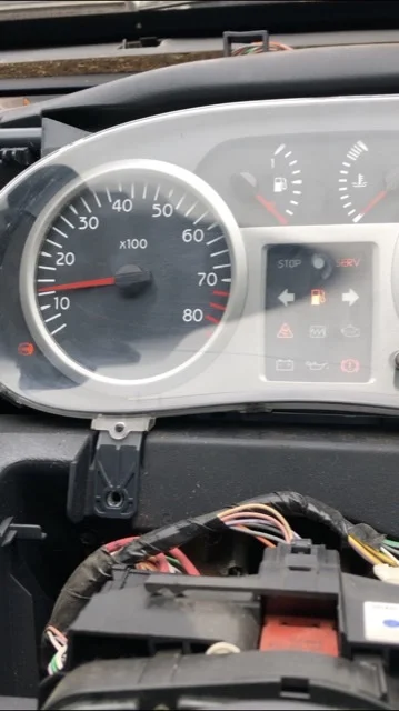

Is this too far gone
yep exactly my thought too but very easy fix probably.

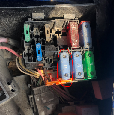

I would do what Kyle suggests, change over the clocks and see what comes up. It looks like the ABS fuse may have been removed and hense no faults on the generic code reader because it doesn't detect a module to probe for faults.
The ABS is fuse 10 and 60A

Thanks for this. So is this one No.10 Just pulled it out and had a look. it looks ok. Cant see any fuse numbering on my panel.

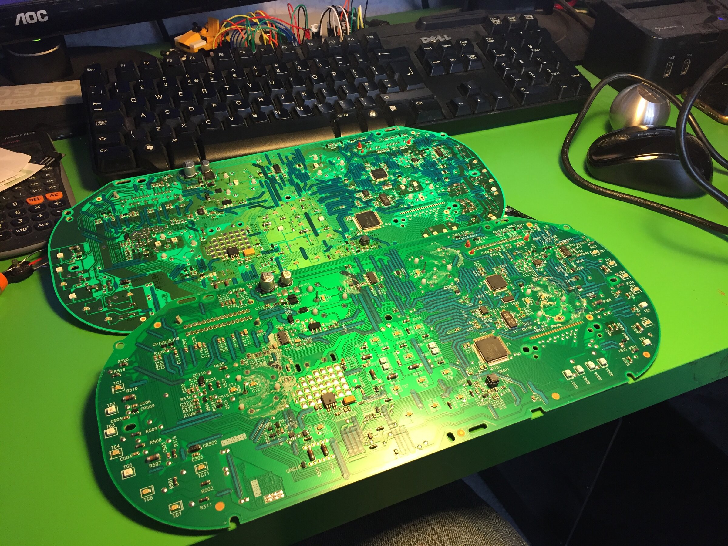

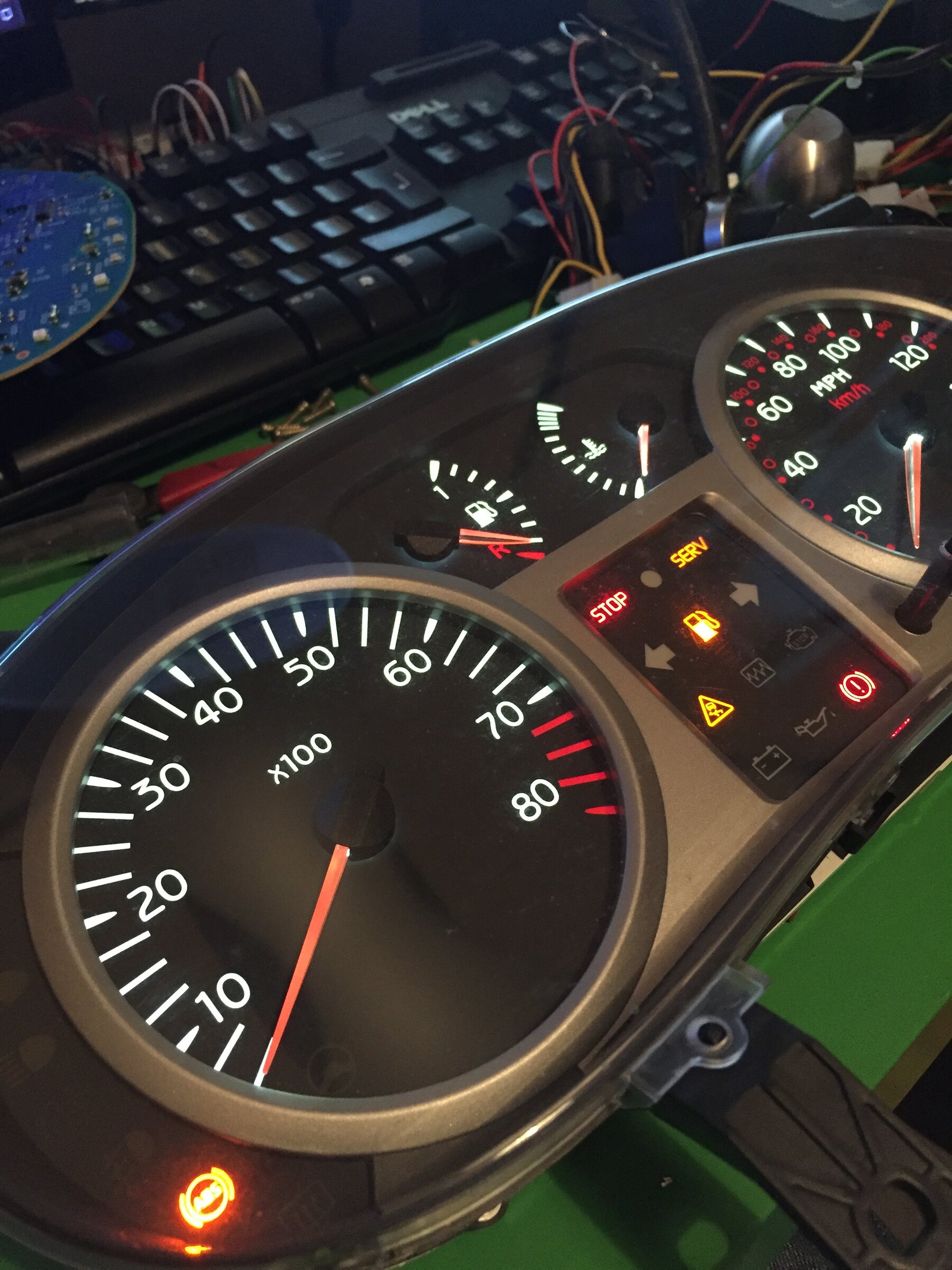

I have an old set of later 172 clocks you can have, just cover postage mate. They don't have the dial face on them but they're still useable for you to figure your light situation out
Thanks for the offer bud. I'll grab a set off fleabay and then if they work (light up like a christmas tree) i'll just leave them in.

Mileage is definitely stored in the clocks on the Clio. Have changed a few in the dcis I've owned for the upgraded sets which display cruise control and the mileage on the car changed as a result.

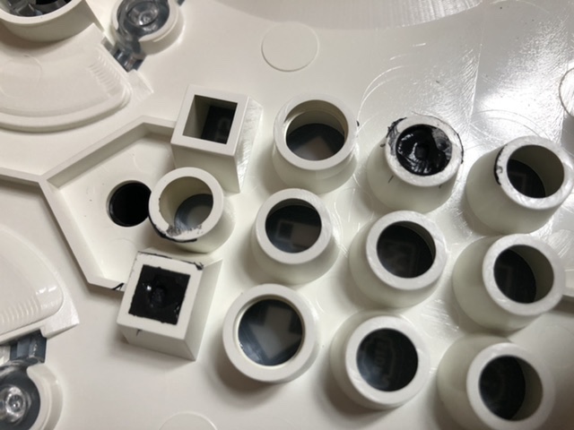

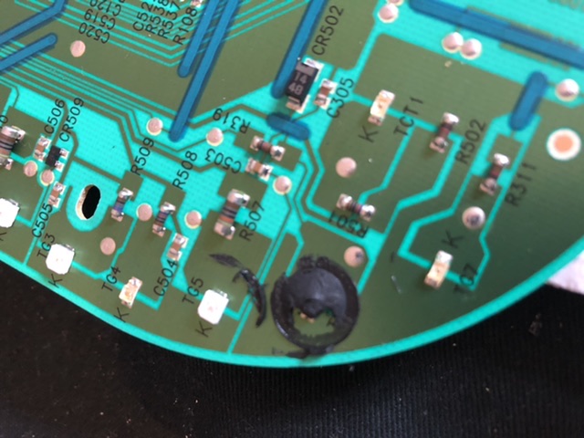

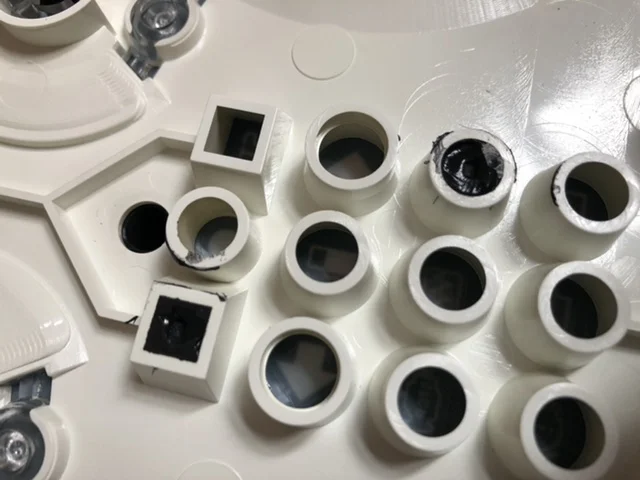

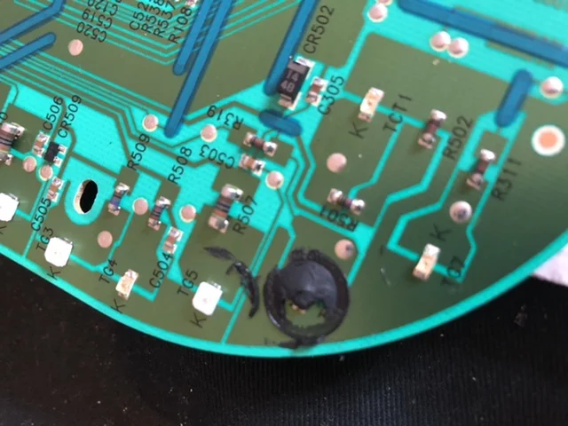

You'd want to do what I did on these clocks and desolder the bulbs which have been removed. Hopefully you just find a piece of tape covering them up though. Happy days if so.

thanks. i'm abit lost then. if teh abs fuse is the one circled it looked ok when i pulled it out. could R107 be disconnected? any idea where R107 is?

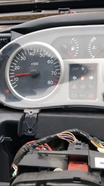

So after cleaning all this 🤬 off. I’ve managed to stick it back and and Atleast its now telling me it’s not happy.

Hopefully. will fit the missing senor and try a new ABS ring before i just fit a driveshaft. need to find out somehow if the ABS has been clipped off though if the lights don't clear. Its all connected up from what i can see (apart from the sensor).
