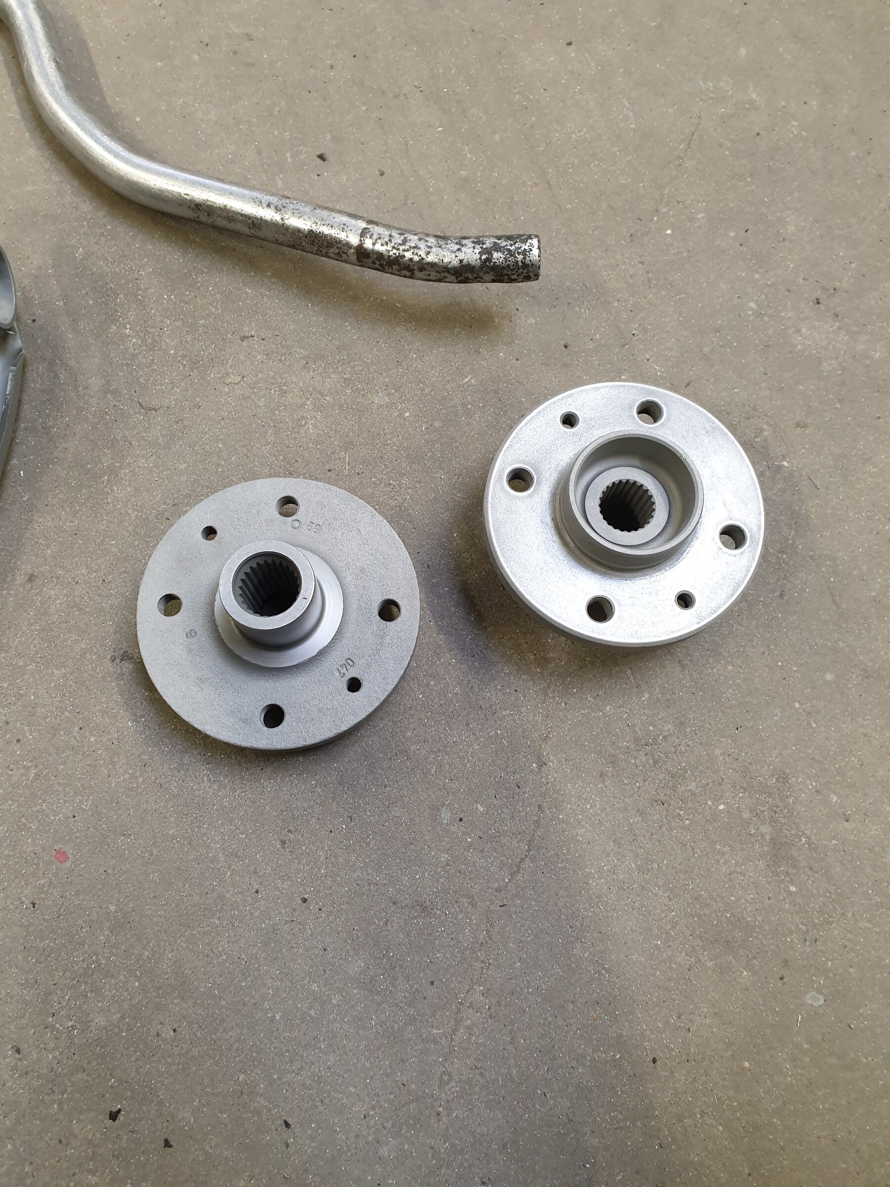

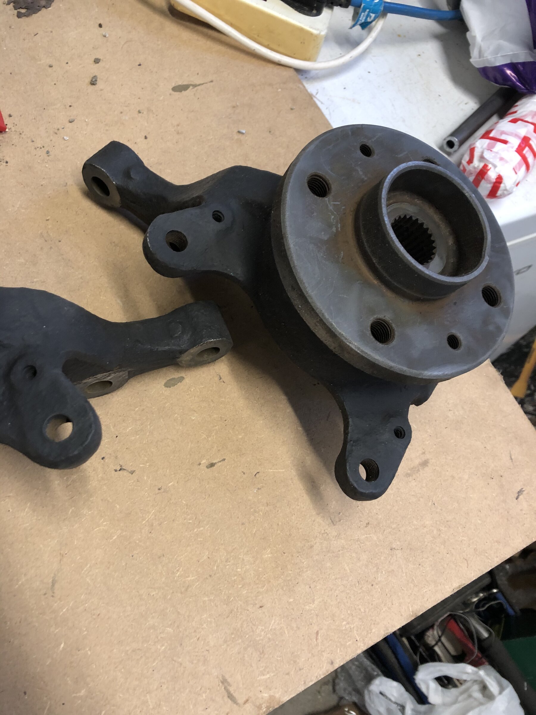

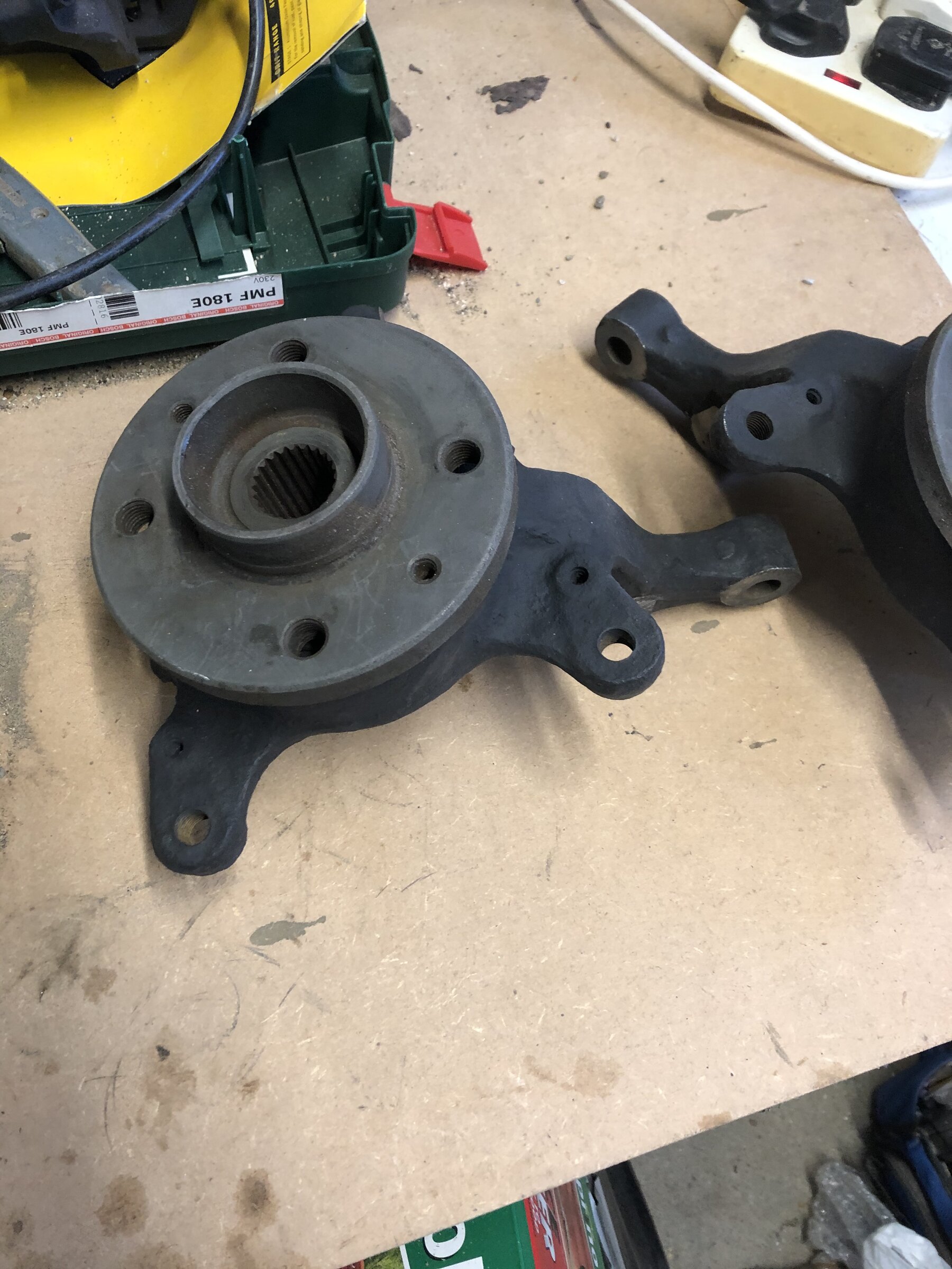

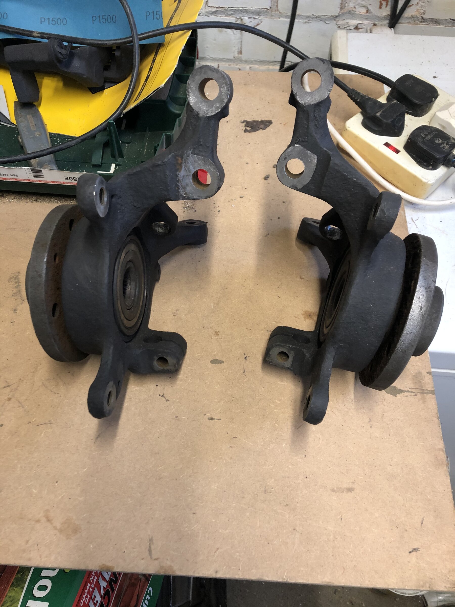

This is the hubs currently.

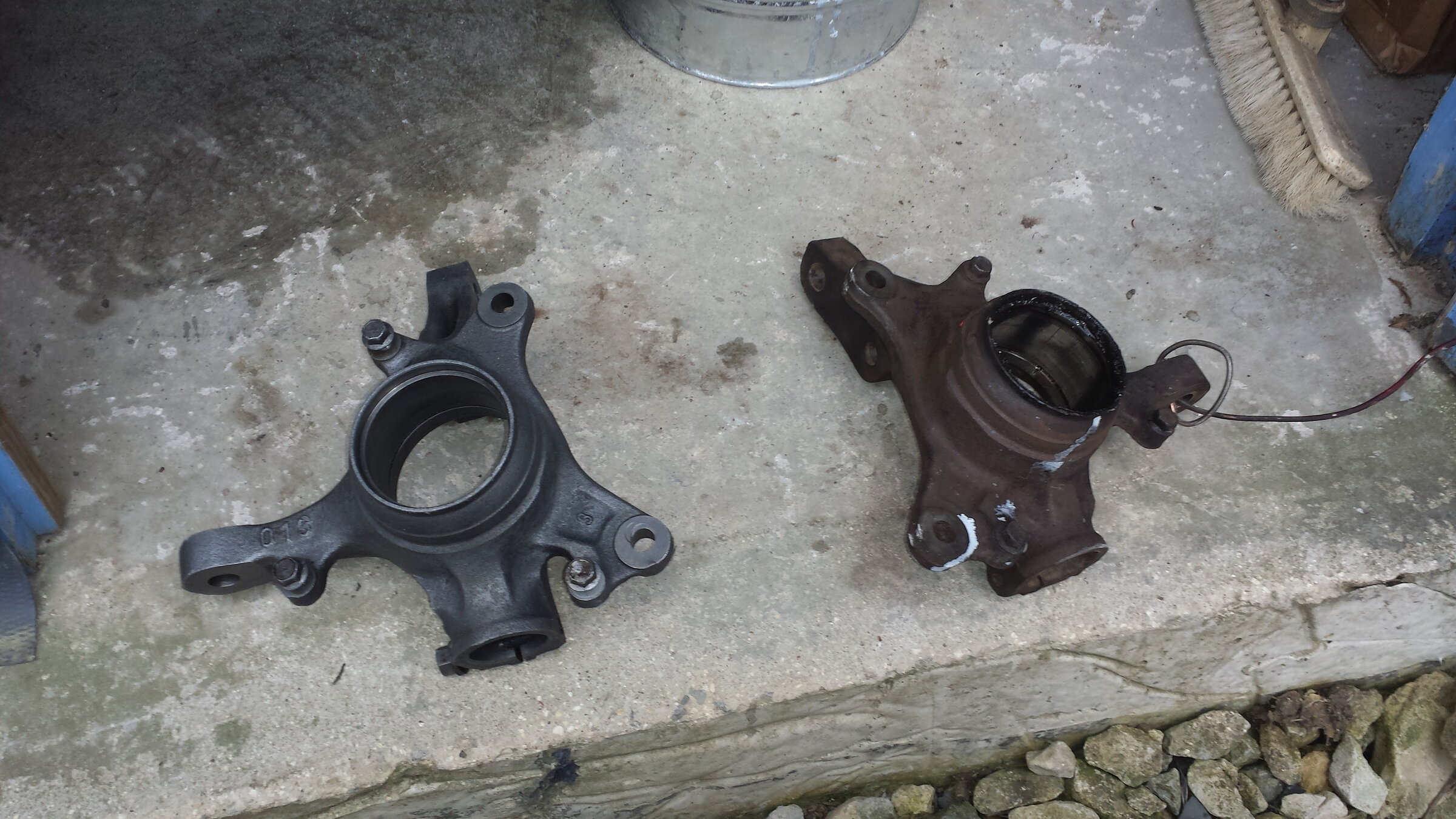

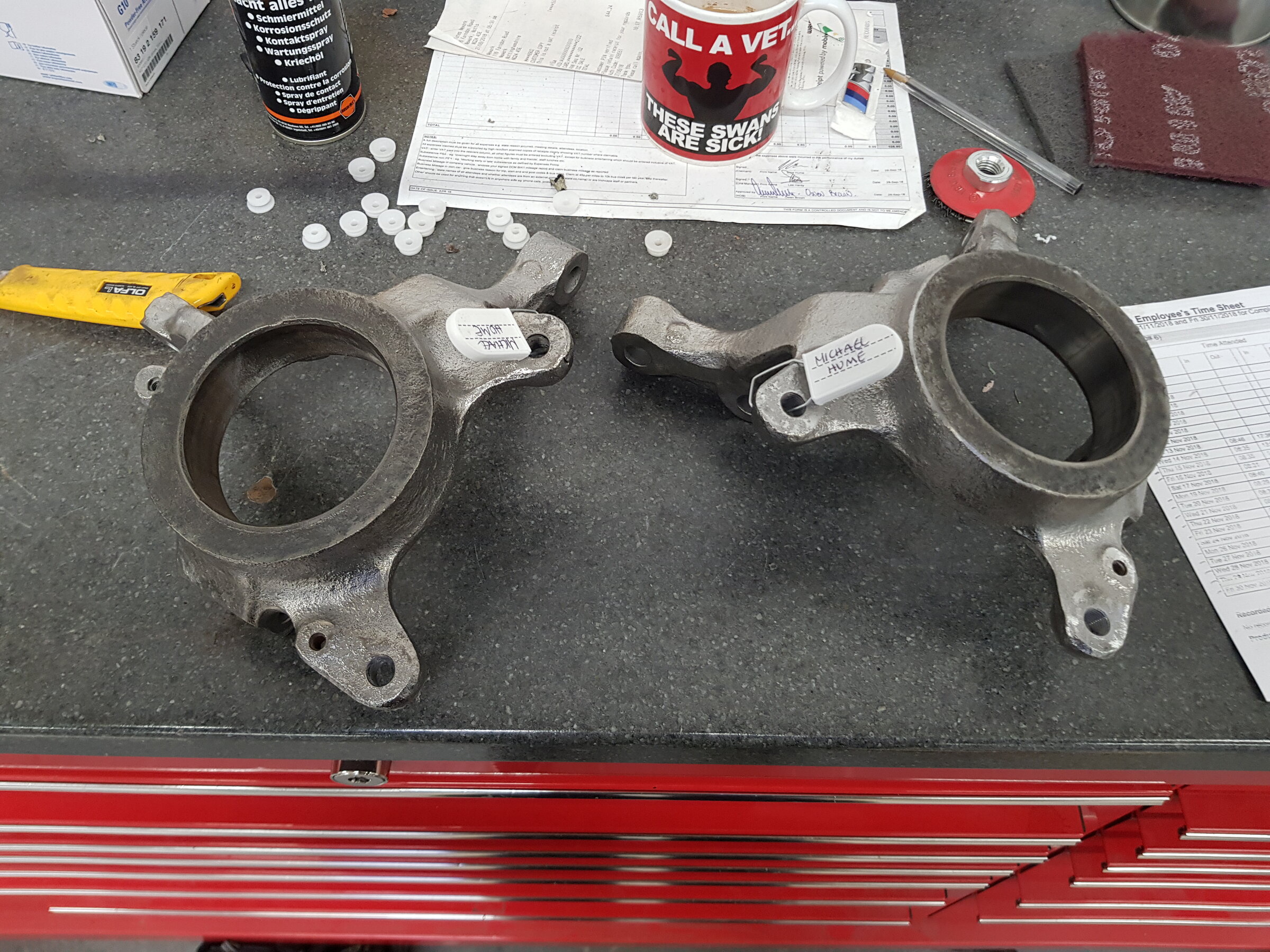

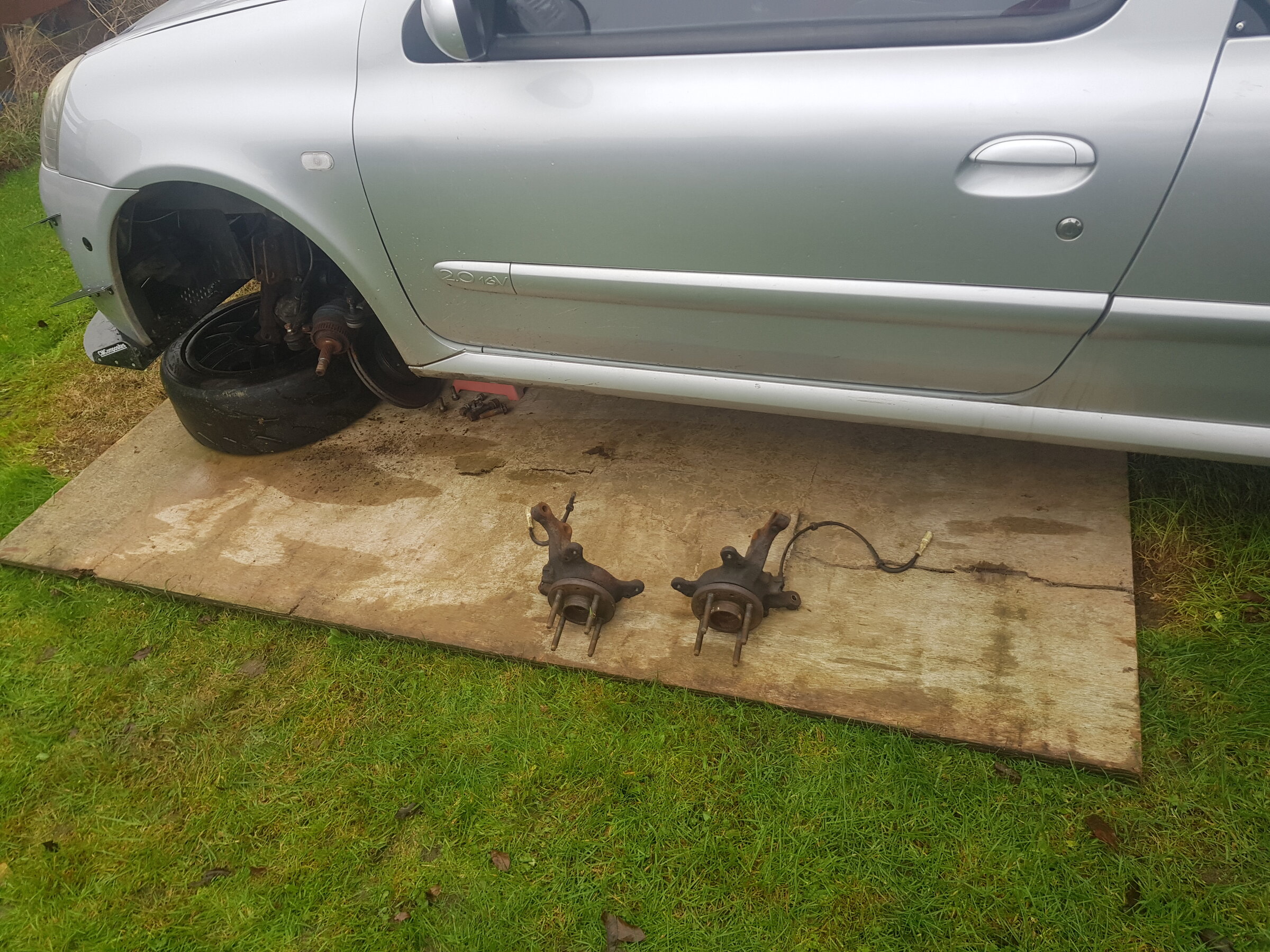

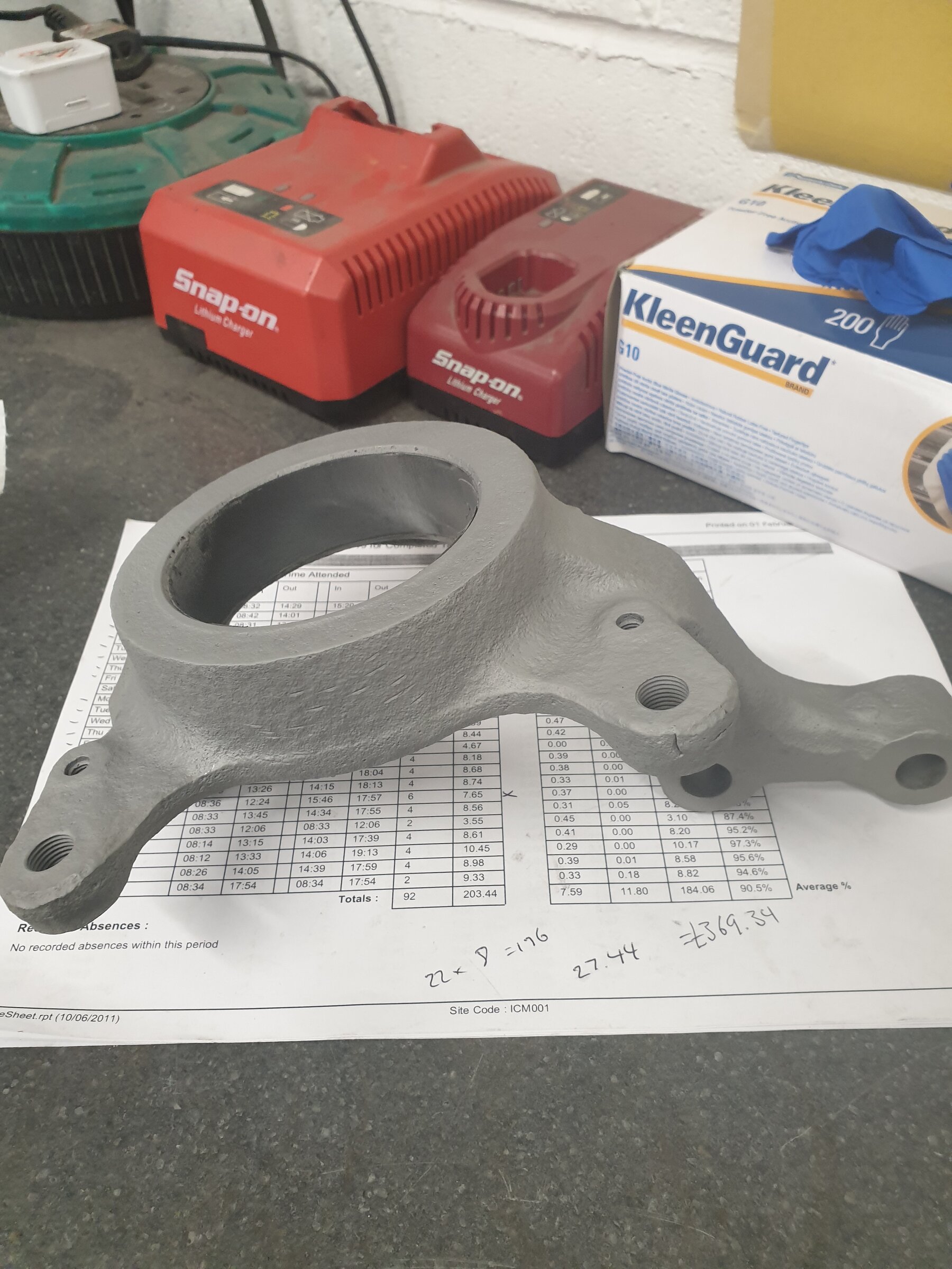

How they looked when I took them off.

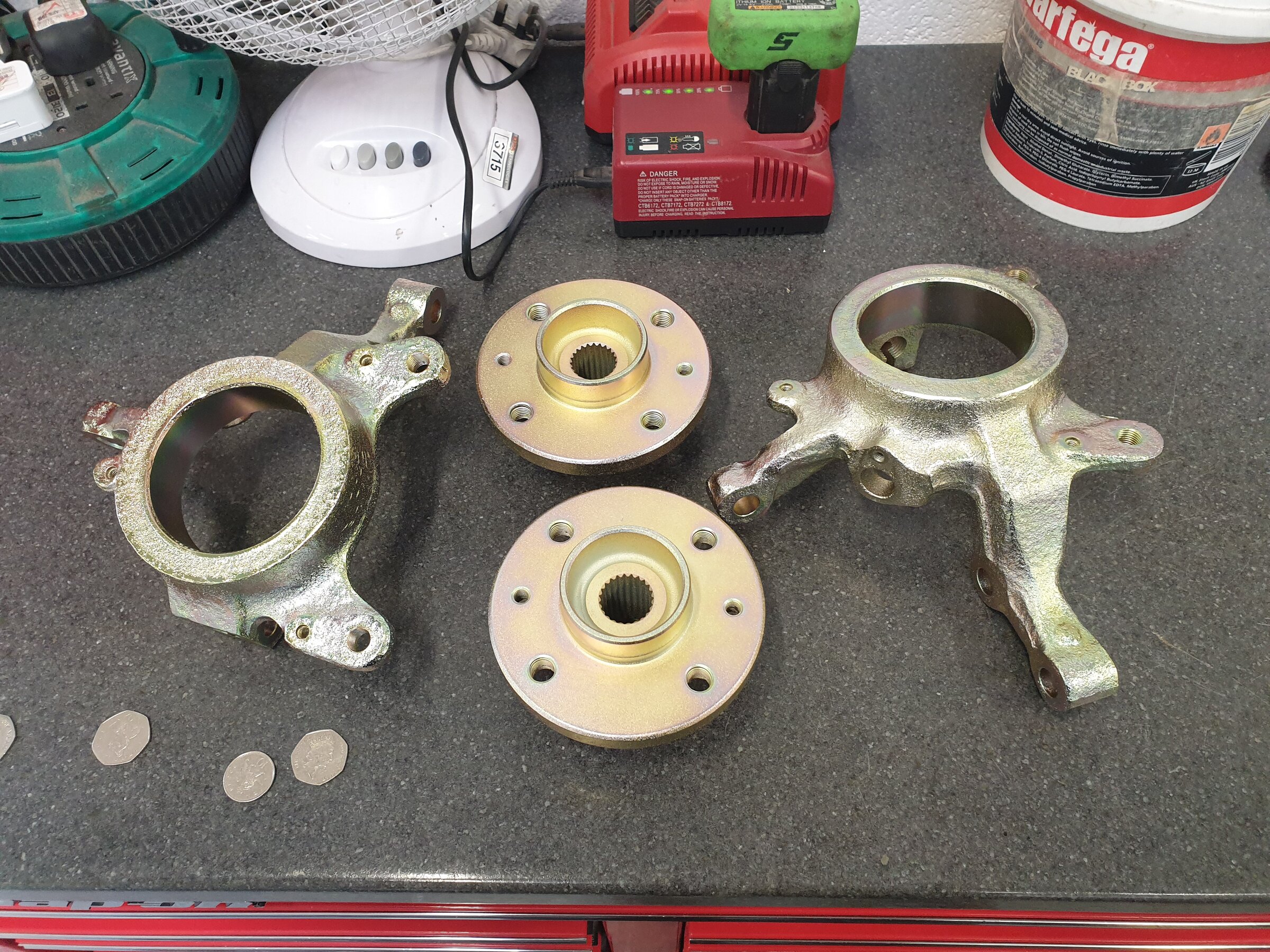

I removed the bearings and gave them a 90% do with the blaster then sent them to NortLoopCup for the role centre to be done.
They came back machined and kit fitted. I removed the lower ball joint extention and gave them a thorough 100% blast again.
Then they went for plating to protect them properly.
Nuff said (mic drop)

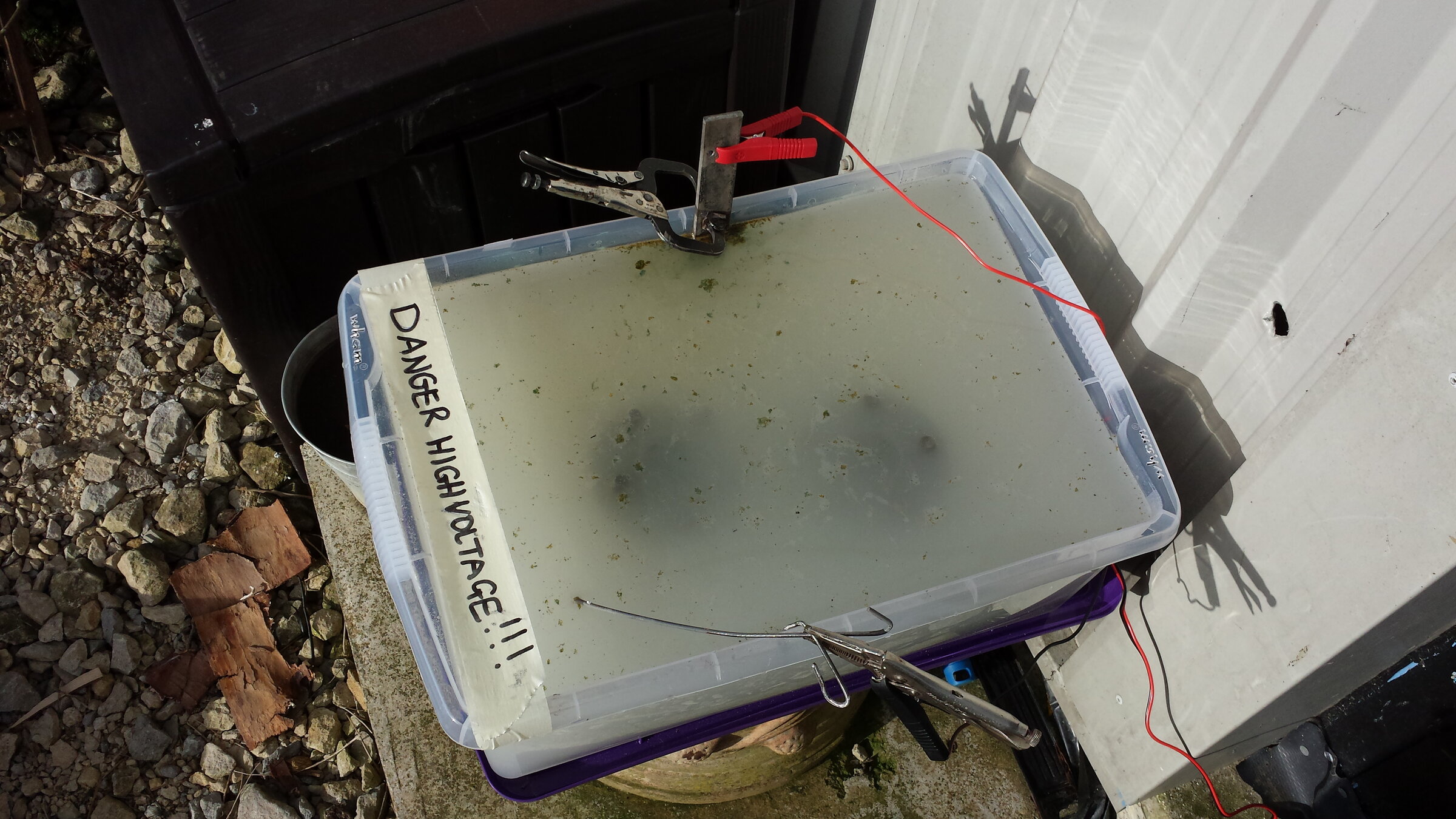

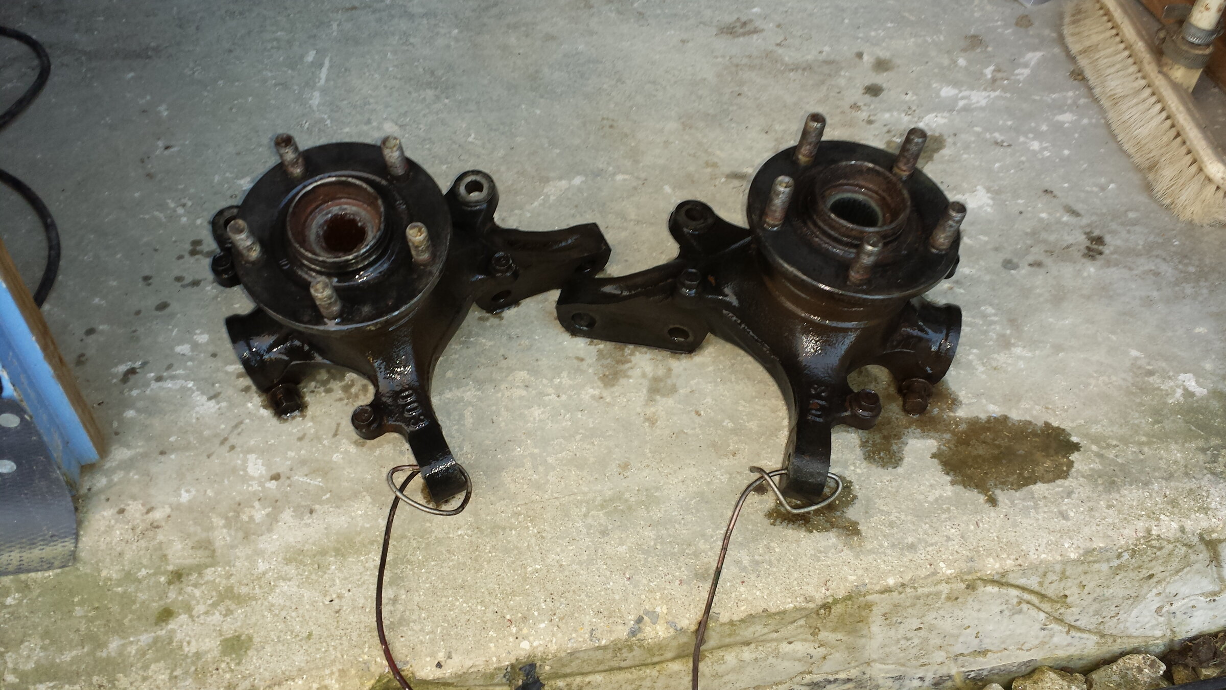

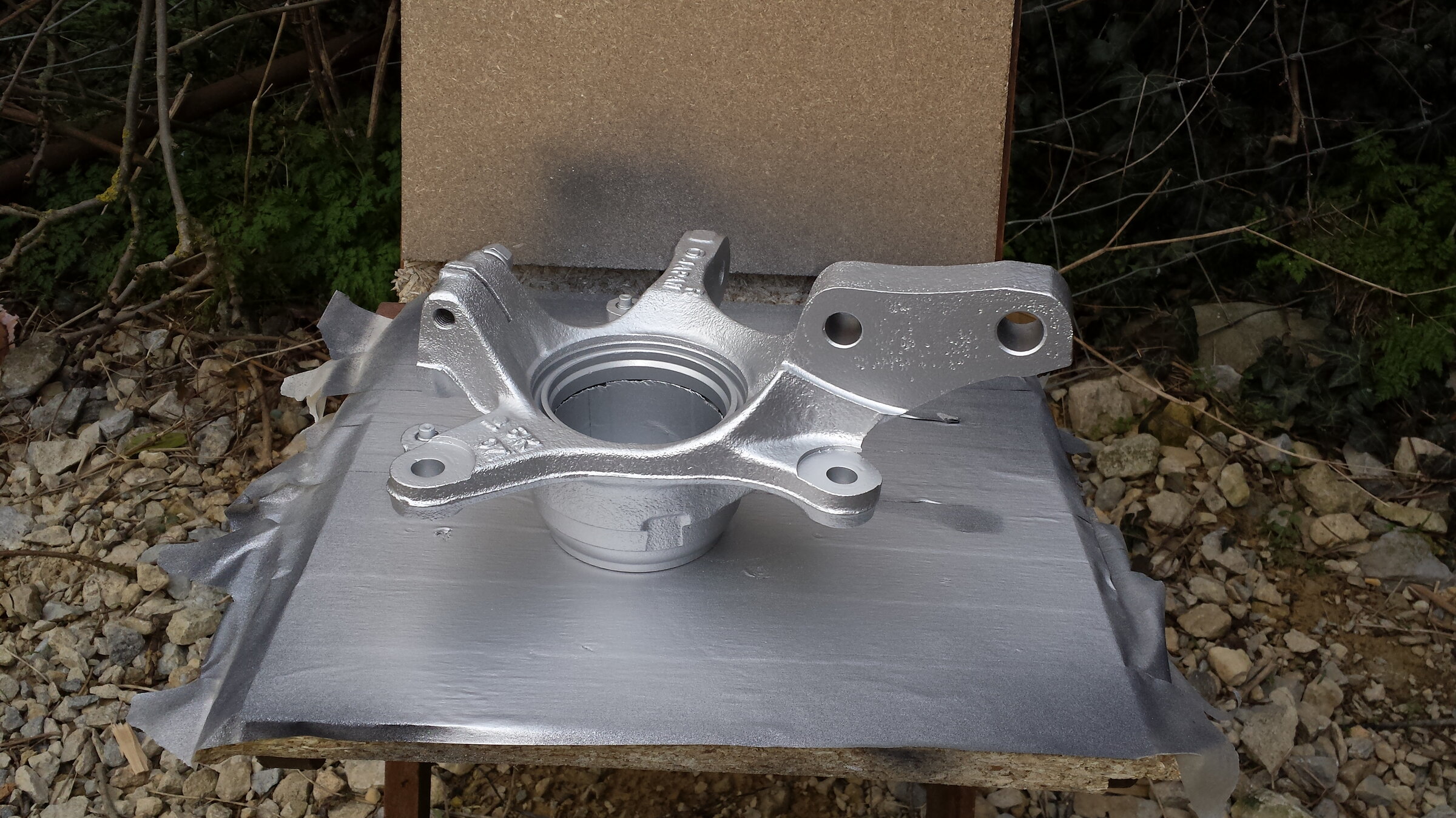

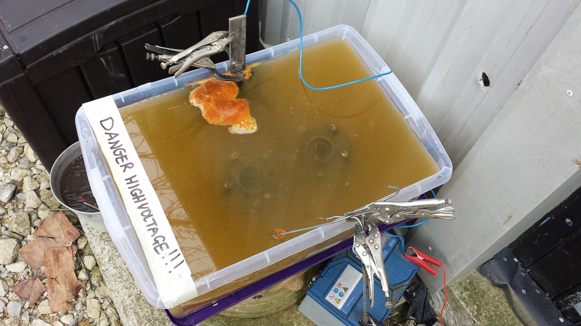

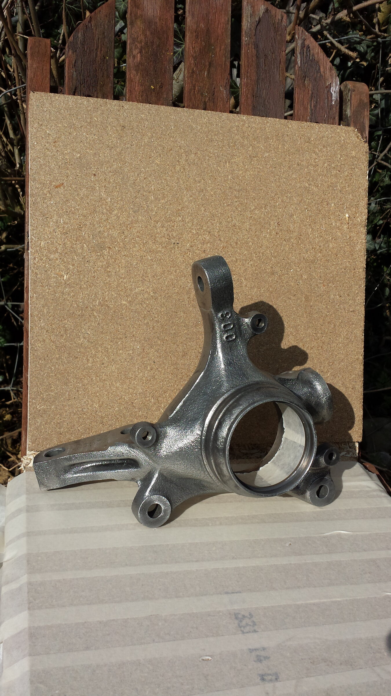

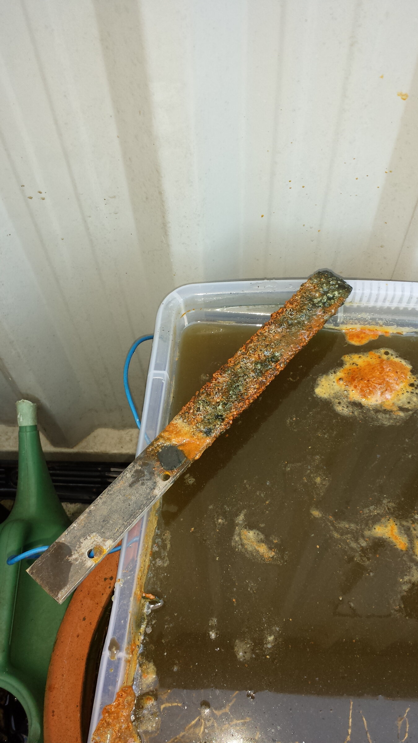

And then theres electrolysis. I did this on my classic scooby as a trail more than anything and worked perfectly.
12v car battery with the charger attached to keep a good voltage and draw onto the sacrificial piece of steel.
After 48hrs they looked like this
Wire brush by hand
After wire wheel
Etched and silver enamel
No harmful acid needed just washing soda in the water that's it.

Be careful of the hydrogen being emitted but another good way of removing rust

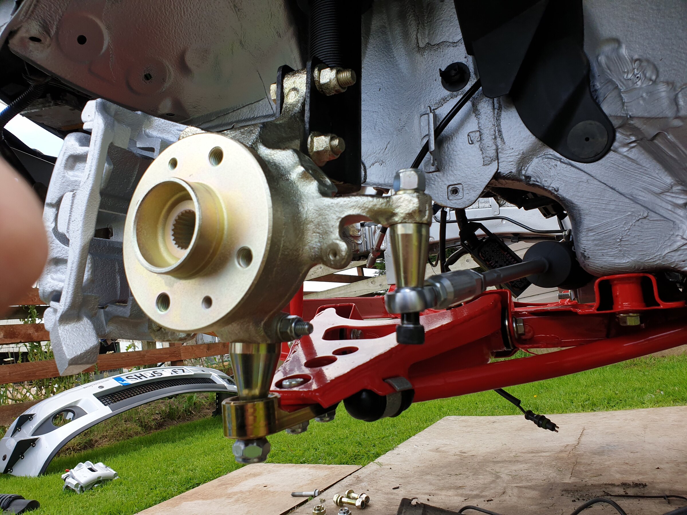

deox-c mainly so will find out if the bearings are shot + wire brush and dremel. They feel ok for now. then just sprayed them in high temp matt black. Got some replacement calipers aswell which i've cleaned up and painted.

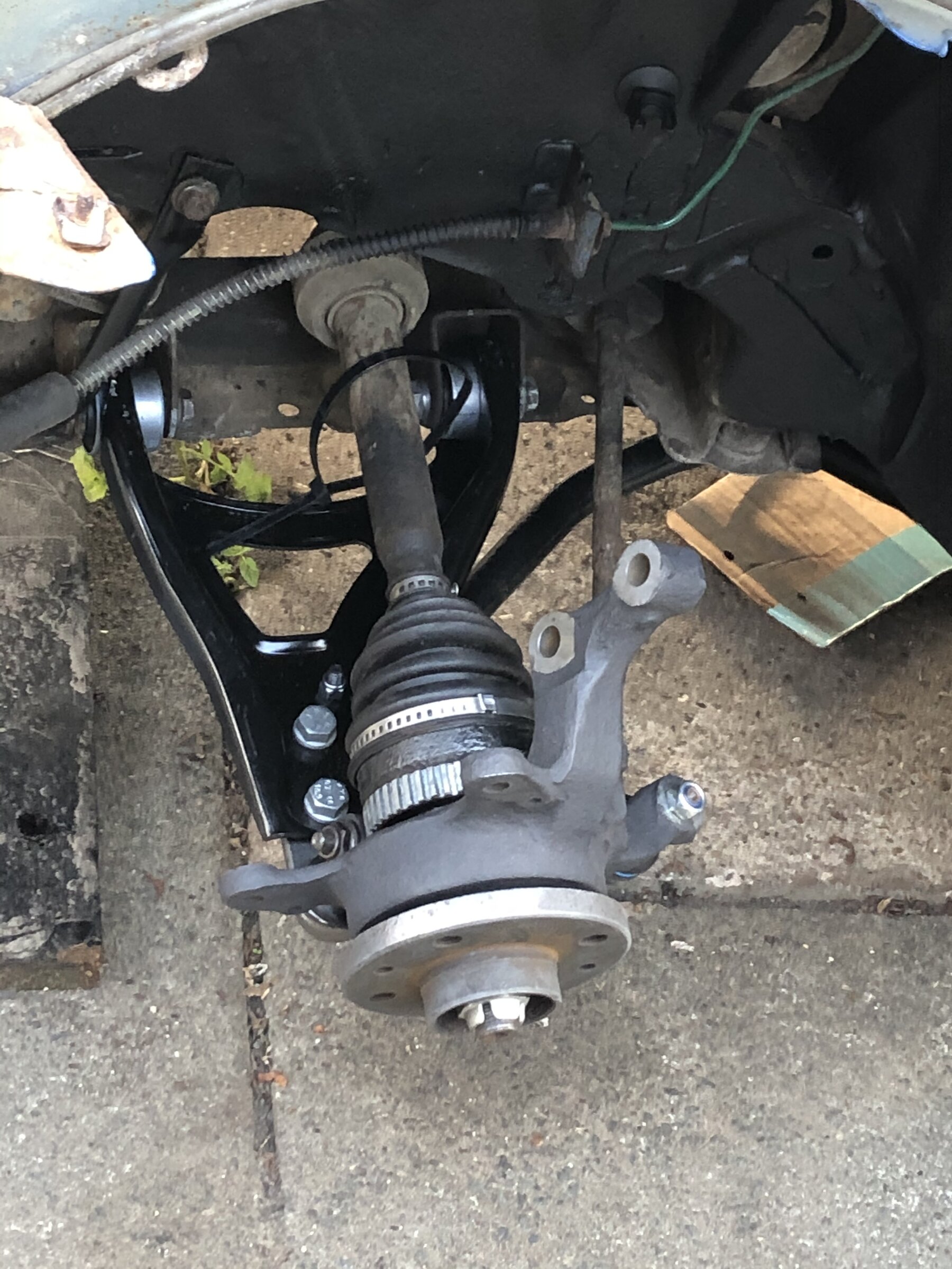

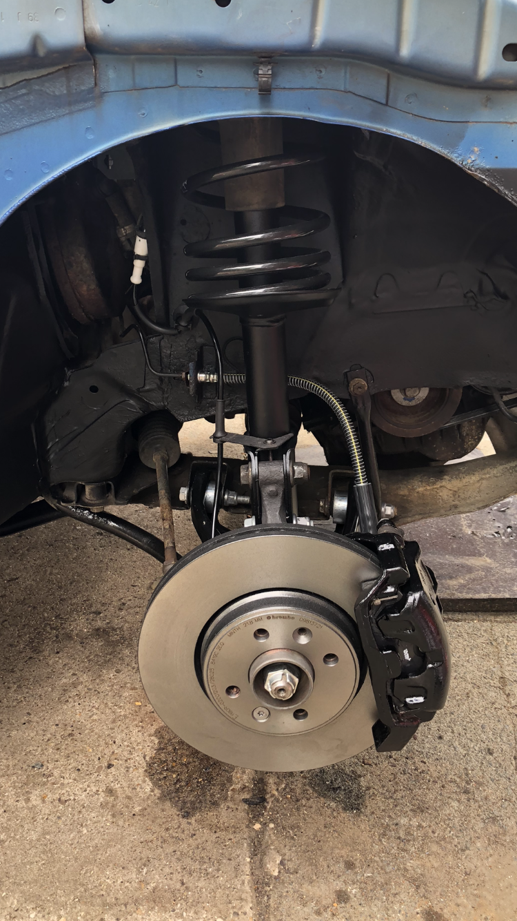

Ok. Update. Cars back together (running gear not panels) and looking a lot better than it was but still got the fault lights.
Fitted the abs ring that was missing and two new sensors. Started the car up and still have the abs, traction and service lights on. All cables are connected up. It now lets me turn cruise control on though which it wouldn't do before. So that’s cruise and limiter it lets me switch on now.
Question being. Has the abs been turned off with a clip and since it’s all connected up it’s flagging the fault lights? I have no codes on my code reader though.
And can you get it set back to factory easily?
Thanks.
They stuck crap over the dash lights didnt they? Might have gone into clip first but if the abs is turned off then will it display a speed thats the question
04-182
  AB Clio 182
Yeah they filled the lights with black silcoset which I’ve cleaned out now. Don’t know anything about clips and what that do etc. Just want it setting back to factory settings so I have a baseline to go from.
