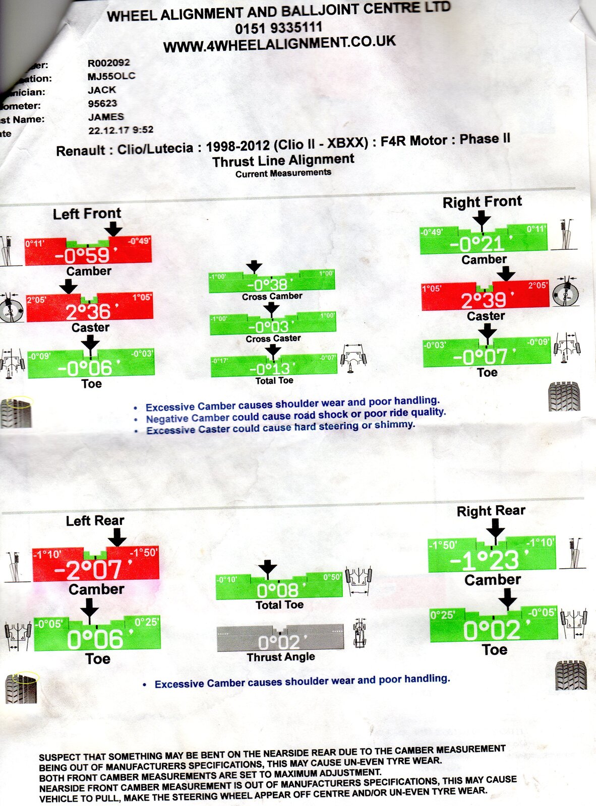

I've just dug out the attached from the previous owners documents. I'm guessing this could be part of the issue (going off the last sentence on the document)?

Im not sure that would cause it to be 20deg out. If the toe is set like that, the car will go straight if you hold the wheel straight but will want to naturally pull to one side (does it want to go to the right when you take your hands off the wheel?)
Have you had the car aligned since? As that rear end and front camber is quite off, probably has a quick rear end but slow front
It doesn't seem to be pulling in any direction, possibly favoring the right slightly.
I've only had the car a week and that scan is the only evidence I can find of the car being aligned.
