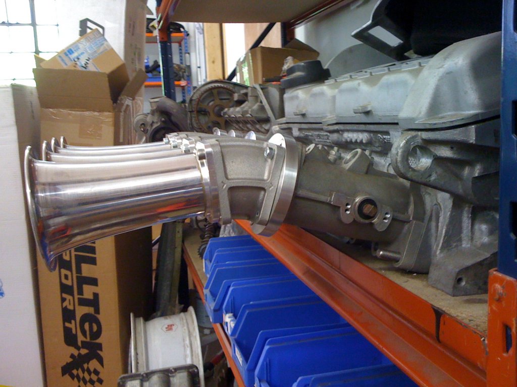

Tom what bodies, trumpet size are pictured and do you know how much the trumpets are dropped down at the lowest point with that setup.
Grandpa Joe
I'm away to buy these spacers in a week or two.
It's a Golf DTH setup Morgan. The trumpets are 120mm.
I don't, but you could work it out as the angle is 22.5°.
I asked Jenvey how much they space the trumpets out but they weren't much use.
  Cup In bits
Id bet its around 25mm in the lowest edge, I am away to order one to start with and try them before and after the SF body to see which fits best. It will save me trimming the bonnet with my 120's and give extra room and better flow too.

It would only act as a venturi Russ if the diameter is bigger either side which I would try to avoid tbh if there is enough meat to port them spacers.

Assuming they are the standard 50mm spacers but at an angle of 22.5° that makes the bottom part 30mm.
So with 60mm standard trumpets on the DTH kit you will end up with 110-90mm trumpets (100mm nominal). And you won't need to change the air filter. Assuming you have space of course.

I do like the look of those spacers... Seems like the only way to go, il have to make a spacer at 22.5 degrees and see where that puts the trumpets before buying them. Whats the price on them as I cant find them in 45mm bore?

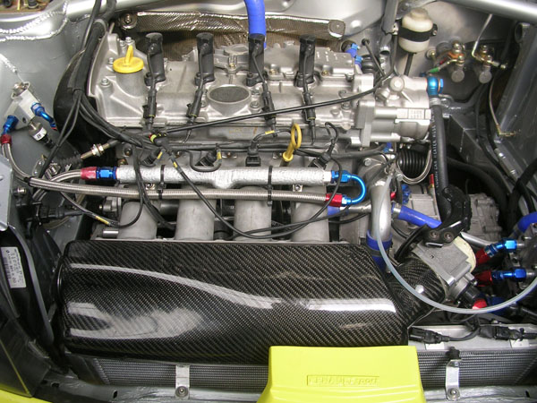

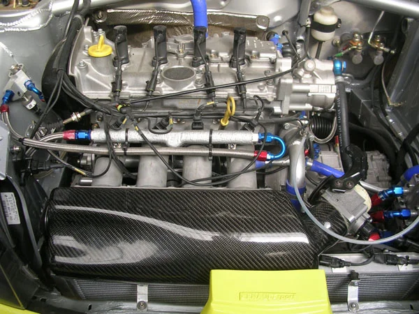

I've been on the reverie web site and they have quite a few air box options and Jenvey use their back plate and air box Zolder 112 as an option, expensive I know being carbon but they have GRP options as well.
So the air box and remote filter are not a good option or was there a problem with your set up Ph1Tom?
I notice that Meeks post shows a nice flowing curve to the inlet runners and a single plenum, I already have the 64mm single AT cable TB the S2000 unit.

That reviere airbox strangled Burpspeeds car when they first built it but they do keep the induction noise down nicely to pass a noise test if your struggling.

It's not something rude...it's a rather shonky mockup of the DTH bodies with the SF spacers, 60mm trumpets and the recommended filter height.

Checked out the 22.5 degree spacer on this set up. It brings the trumpets to near as damn it 90degrees off the floor which is nice! And theres about 15mm of room from the bonnet, il still have to cut the bonnet slightly to have the clearance that I'm happy with.
Grandpa Joe
Is that 15mm between the trumpets and the bonnet or the filter and the bonnet?
