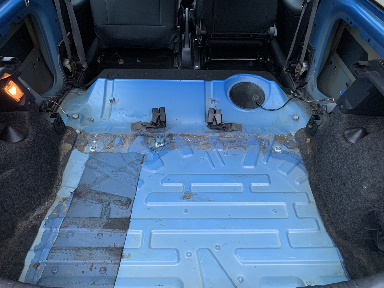

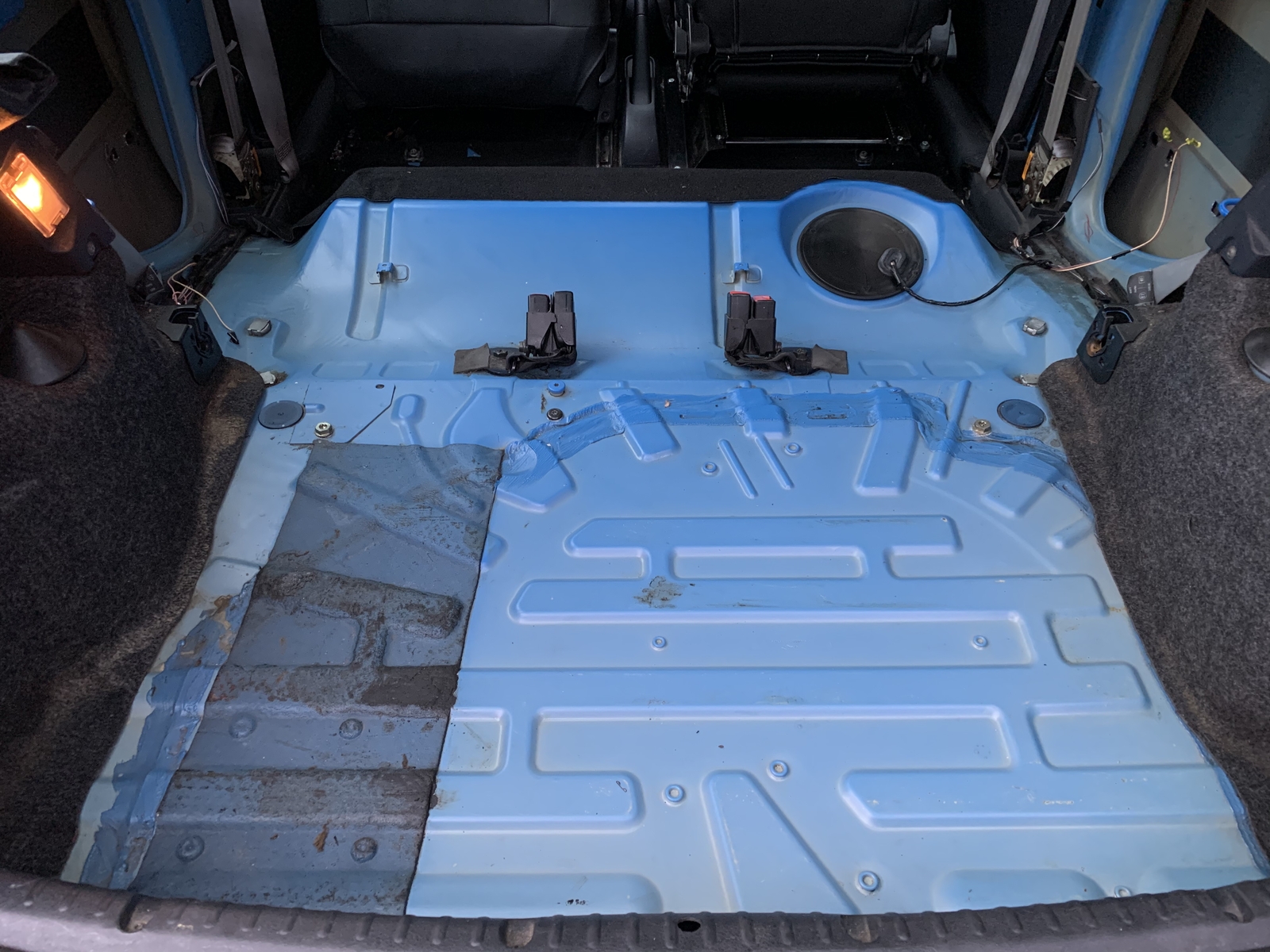

I purchased the car in November, from a gentleman near Gainsborough. The car was being sold on behalf of his son, who had owned the car for six years. There is a good amount of paperwork and practically full history with the car, including the original bill of sale. The odometer readout was 140k miles.
The spec of the car as I purchased it was: Eibach Sportline springs; Whiteline rear anti-roll bar; cat-back Scorpion RS 192 exhaust; Powerflex dog bone mount; Team Heko wind deflectors; braided front brake lines; upgraded front brake pads; driver's Sparco bucket seat; a Pioneer stereo; front Yokohama ADVAN Neova AD08R tyres and rear Continental Sport Contact 3 tyres.
It had been serviced recently, however there was no receipt or invoice for the timing belt present though the owner assured me it had been replaced during his son's ownership. So, being happy with the car I purchased it and drove it to my parents' home. That week, the OSF wheel bearing and ABS sensor were replaced, and wind deflectors removed.

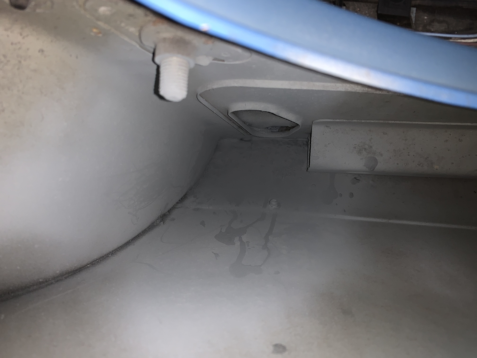

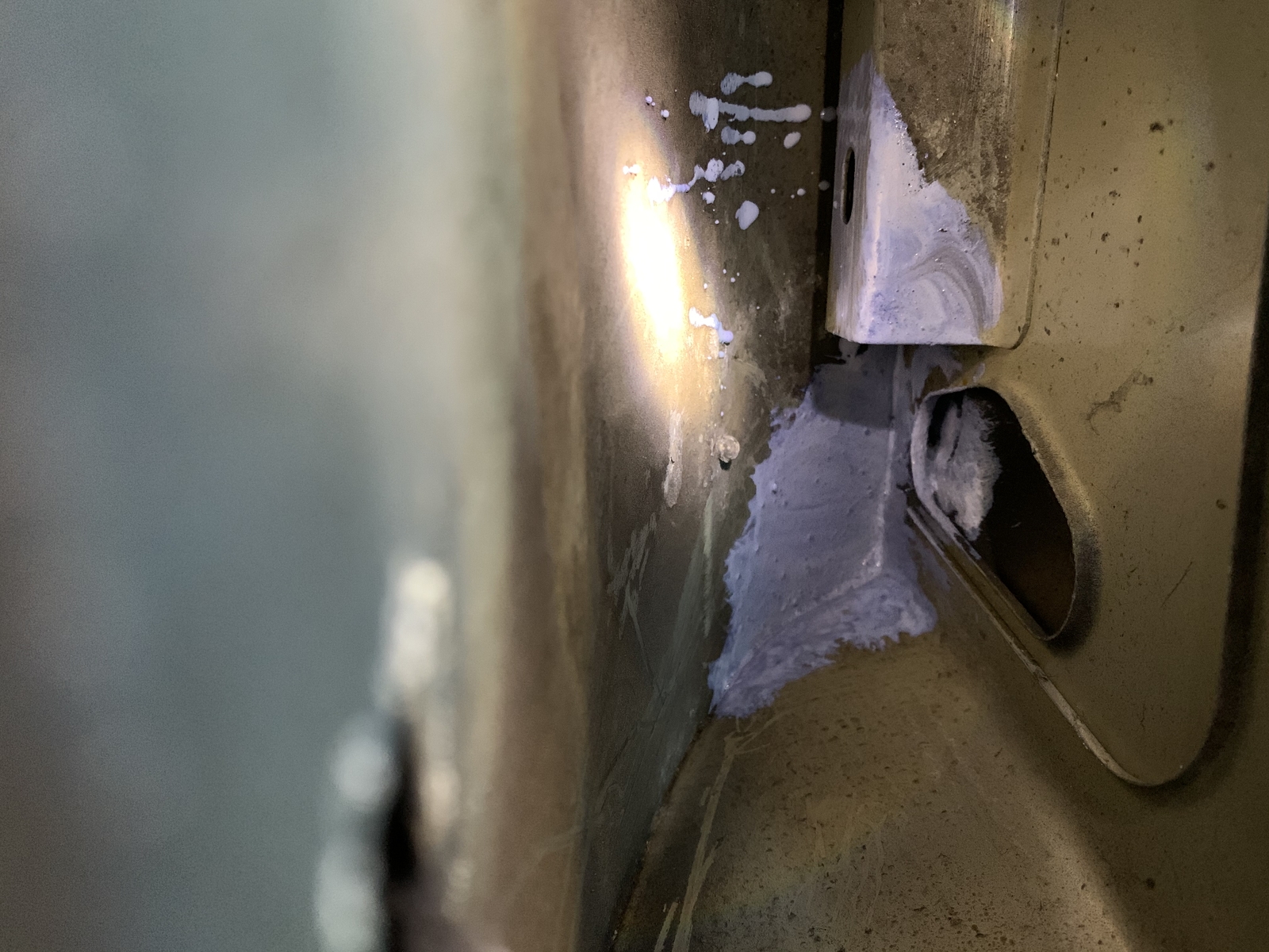

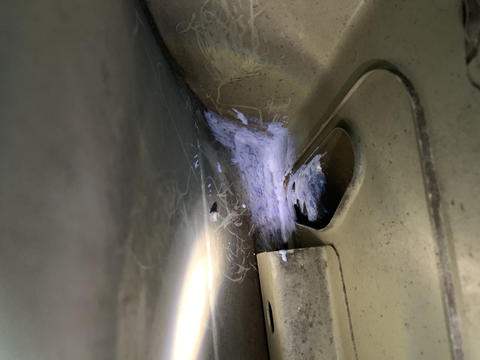

This week, I returned to my parents' home having received my delivery from Renault Parts Direct and the following was replaced: timing belt; water pump; aux belt; dephaser; oil; oil filter; air filter; pollen filter; spark plugs and coolant. Then we refitted the factory stereo and aligned the rear plate. In addition, we cleared the driver's side sill drains, then removed the OSF inner arch liner and removed said build up:
Having already checked beneath the scuttle panel which was clear, this should remedy my footwell being damp. We also applied sealant around the grommets adjacent to the rear lights, as the boot mat was damp (I've removed this to allow it to dry and make it easier to see if water returns).

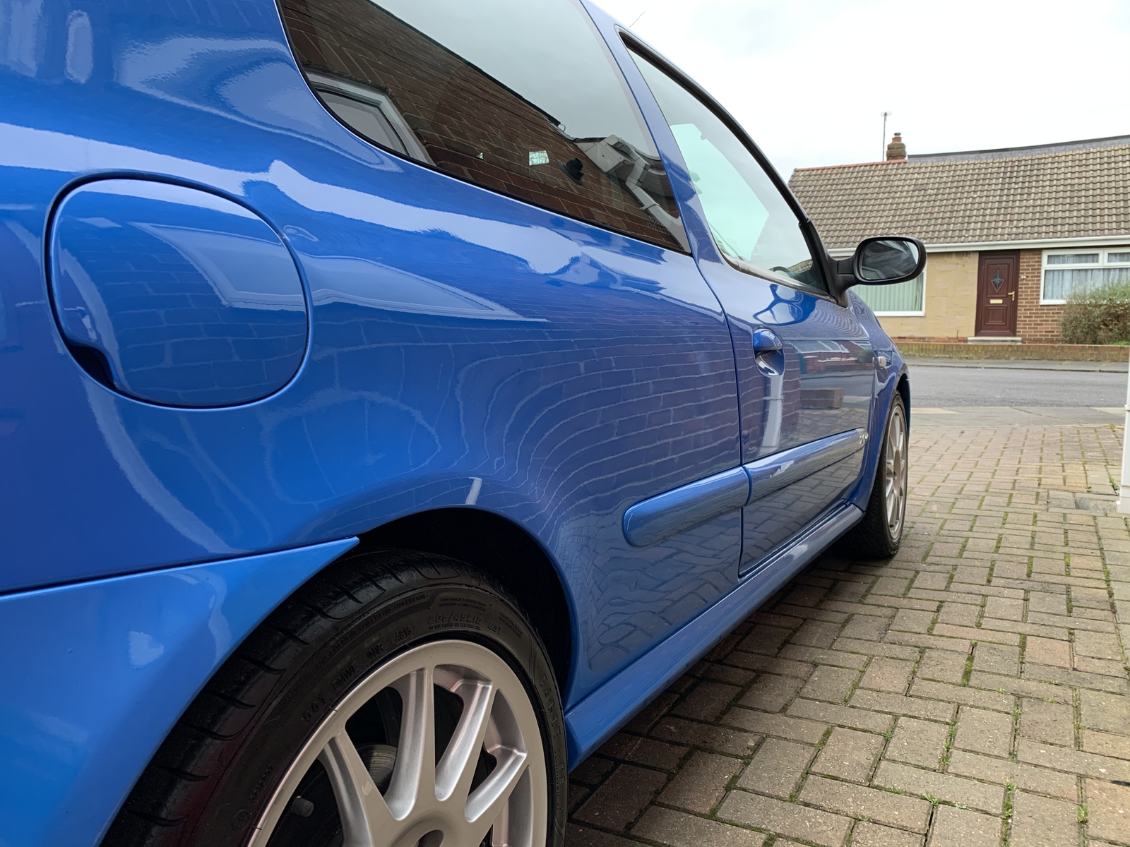

The car was then given its first clean in my ownership:

Looks like a good purchase! My boot had water coming in too. It was from these plastic bungs. Might be worth checking yours. I replaced them with nylon bolts.
Hi, yes those are the bungs I applied silicone sealant to. Hopefully it’s stopped the leak, otherwise I’ll try your method:)

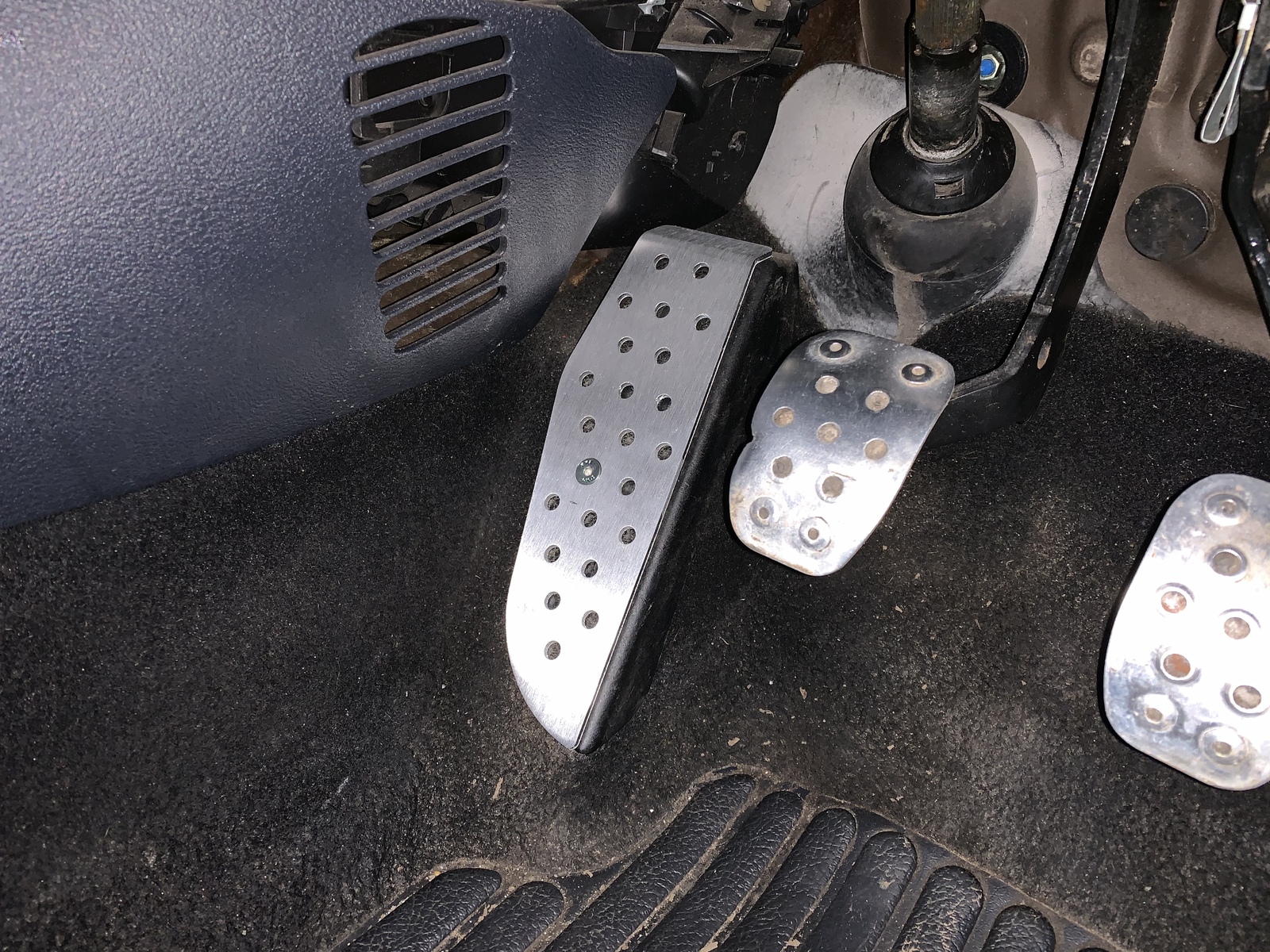

Purchased and fitted an aluminium footrest:
Untitled by Joshua Tarnai, on Flickr

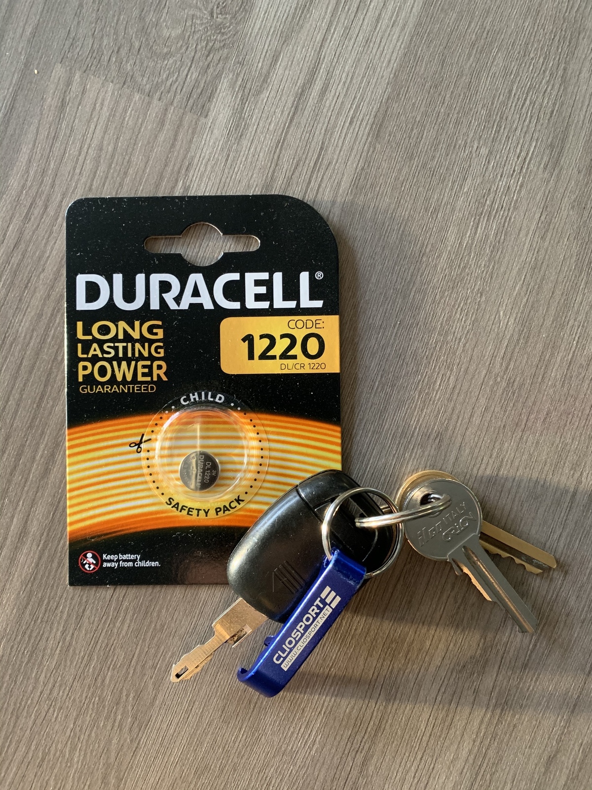

Replaced the key battery as well.

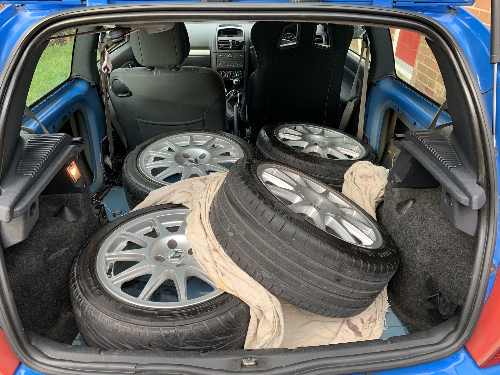

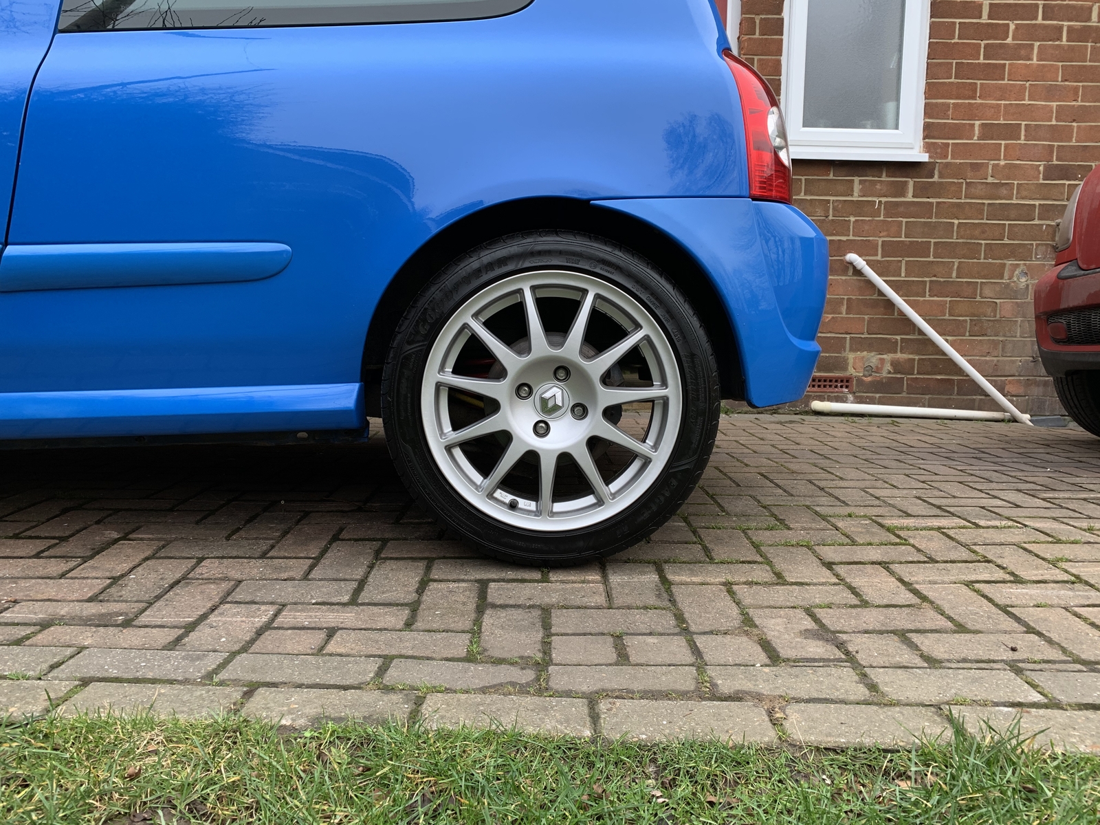

Then made the trip to collect some new wheels courtesy of @mossyv6 . These were recently refurbed and came with 2 Nankangs and 2 Goodyears fitted.

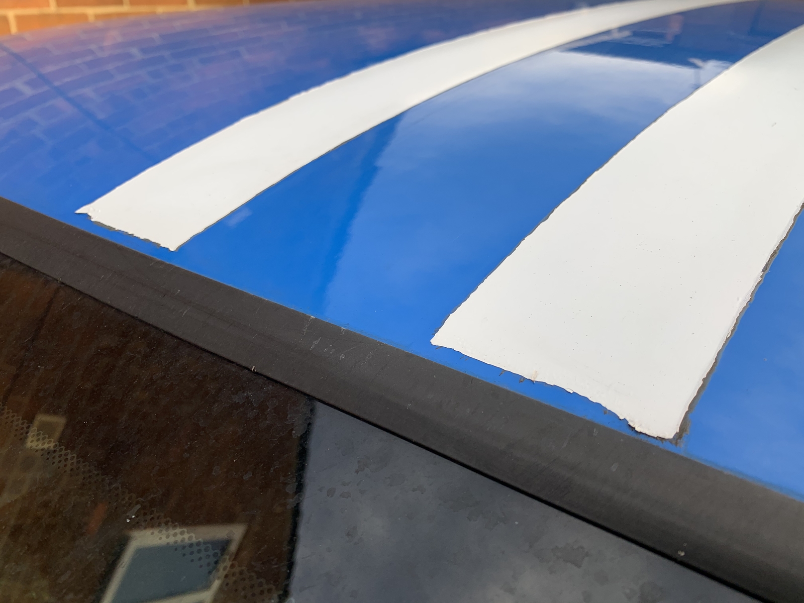

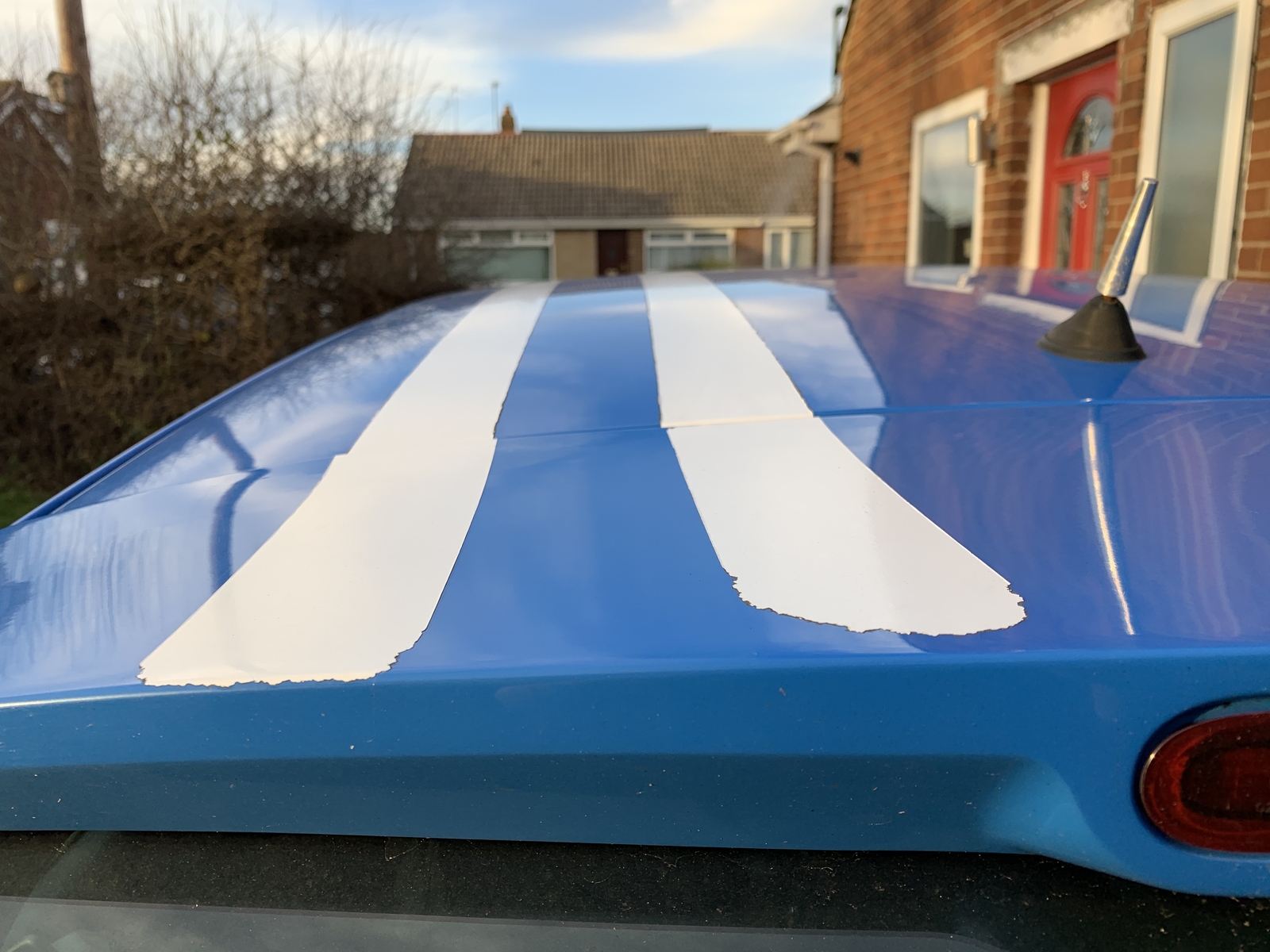

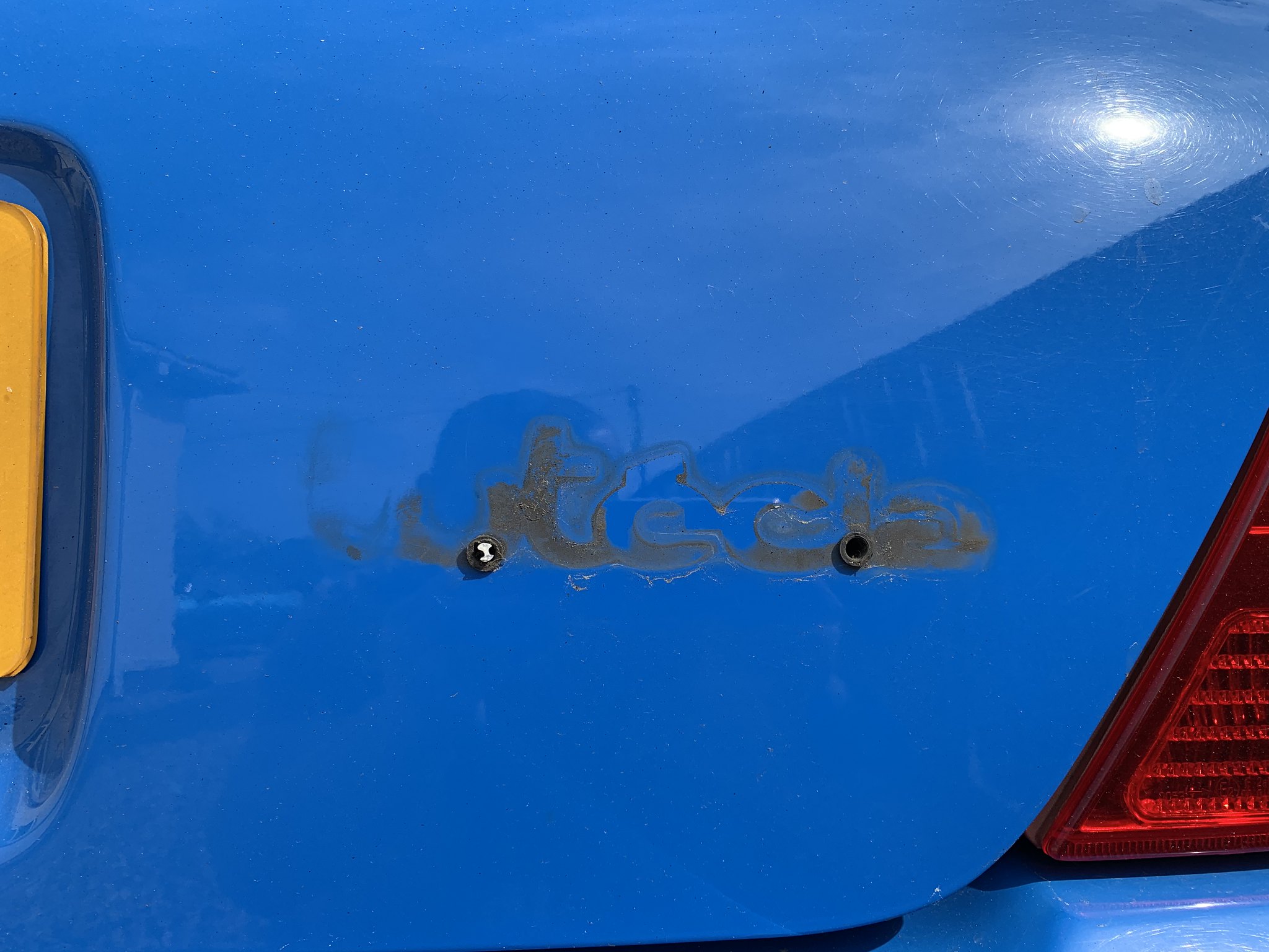

As much as I liked them, I wasn't happy with the condition of the stripes:
So, booked in at Total Valeting in Thornaby to have them removed, as well as the cup decals on the side skirts and the Renault badge from the bottled. Very happy with the outcome.
Much happier with how it looks now, I know some will mourn the loss of the stripes but they were passed their best. Next post will be detailing attacking the small amount of surface rust inside the rear sills.

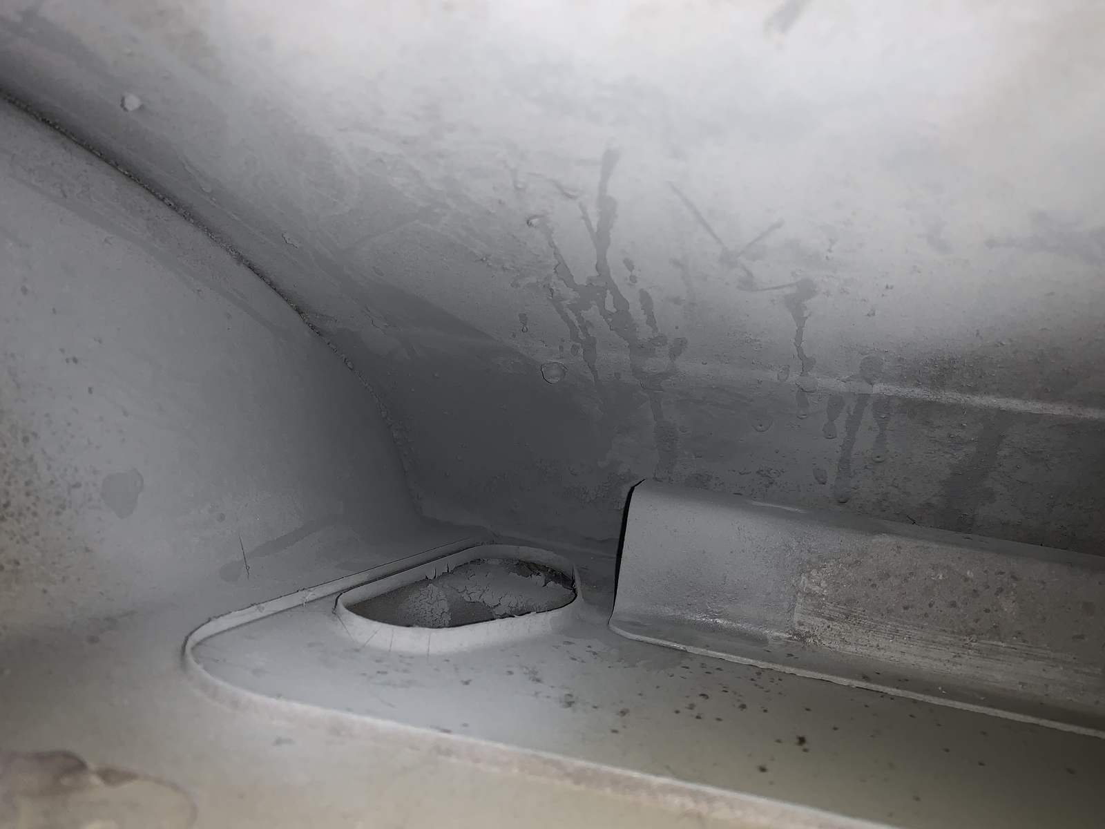

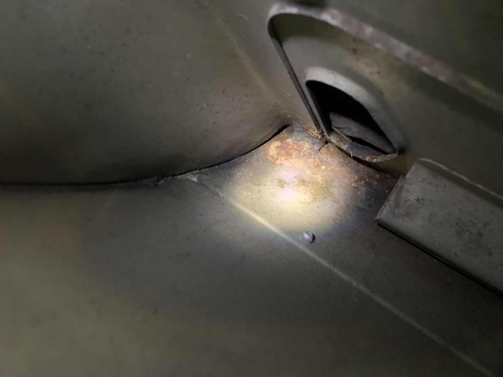

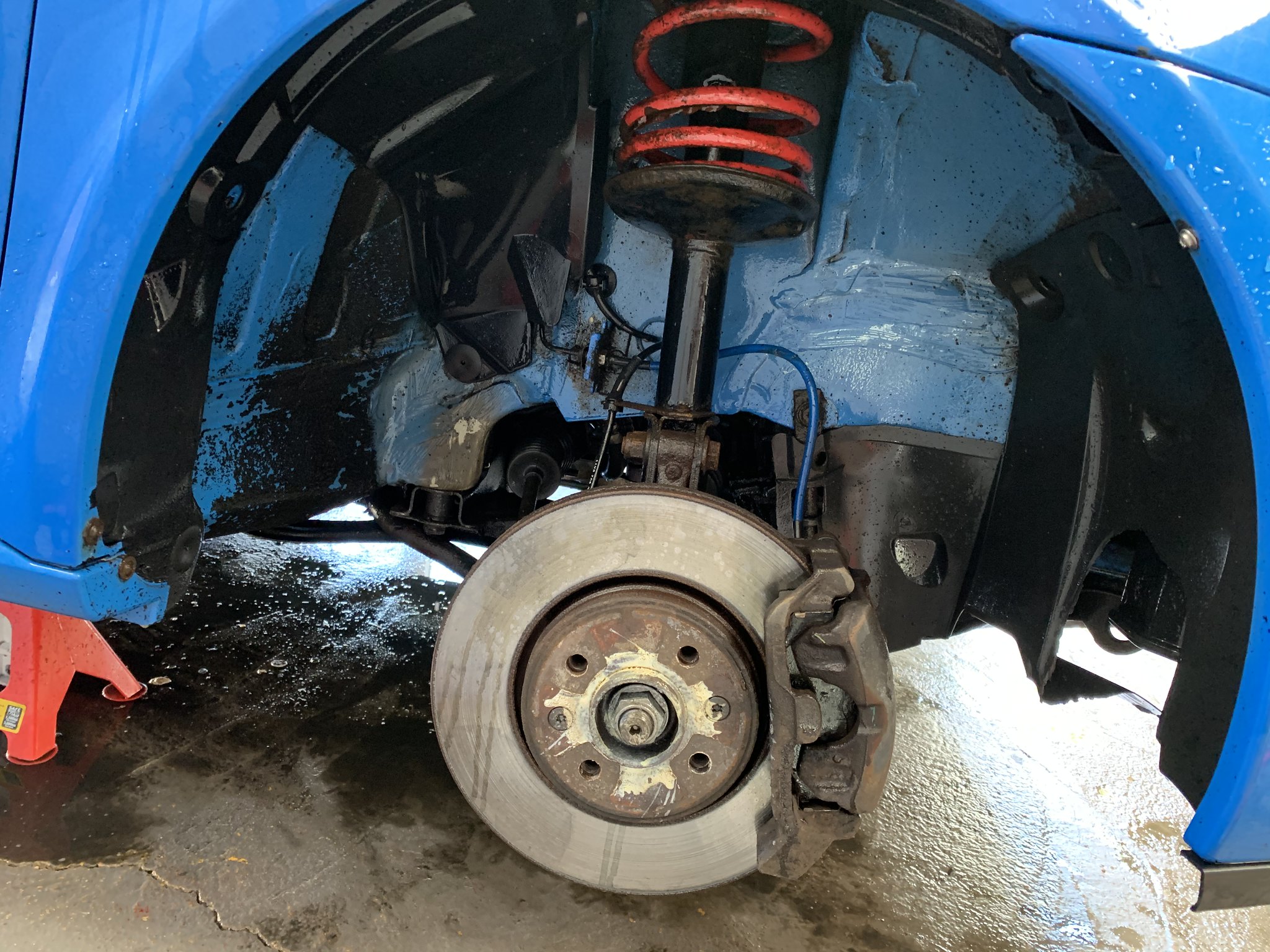

So after reading and seeing that some Clios suffer from rust in the inner arches, I had a look at mine. My brother recently did his which kind of spurred me on to inspect my own, seeing as my car has done twice the mileage.
Drivers side:
Passenger side:

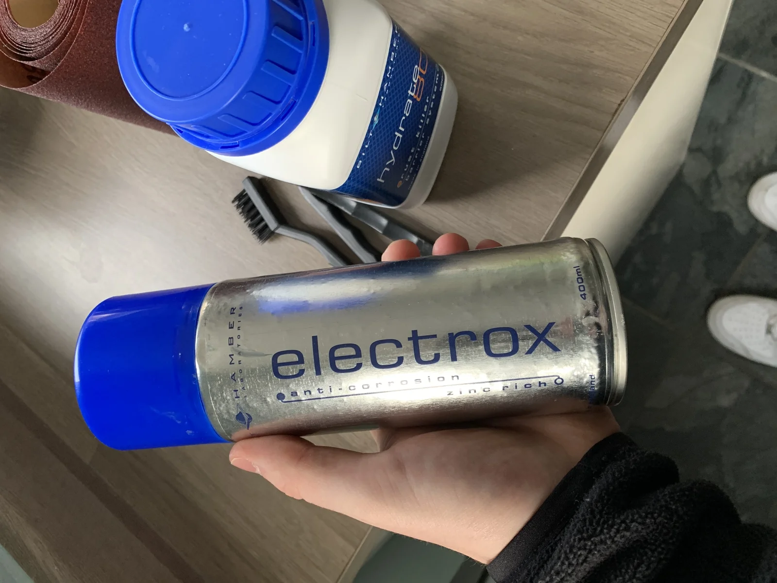

Nothing major really and not as bad as some I'd seen. Made a start wire brushing what was there, then vacuuming the loose debris before applying some Bilt Hamber goodness:
Left this to dry before adding a second coat, then finished with a few coats of the following:
Overall not too bad of a job and I'm glad I've done it now for the peace of mind. Gave the rear of the interior a quick clean up whilst it was all out as well

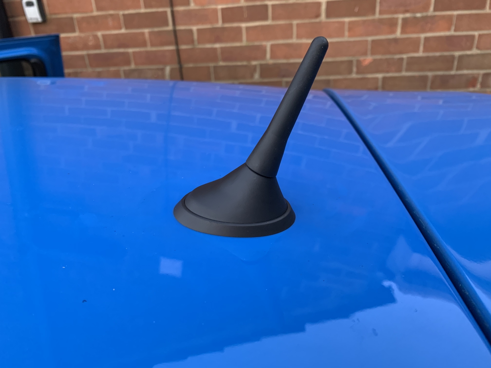

Radio reception began cutting out and being generally crap, so following advice on here I replaced the aerial base and took the opportunity to fit a new smaller aerial as the old one was silver, and seized on as well :cautious: This was an alright job, the main thing was to not rush pulling the rear headlining down to unscrew the base, as it would have creased it.
New base and aerial

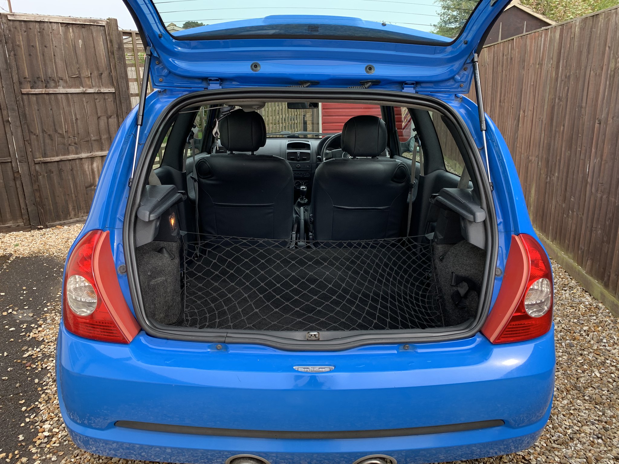

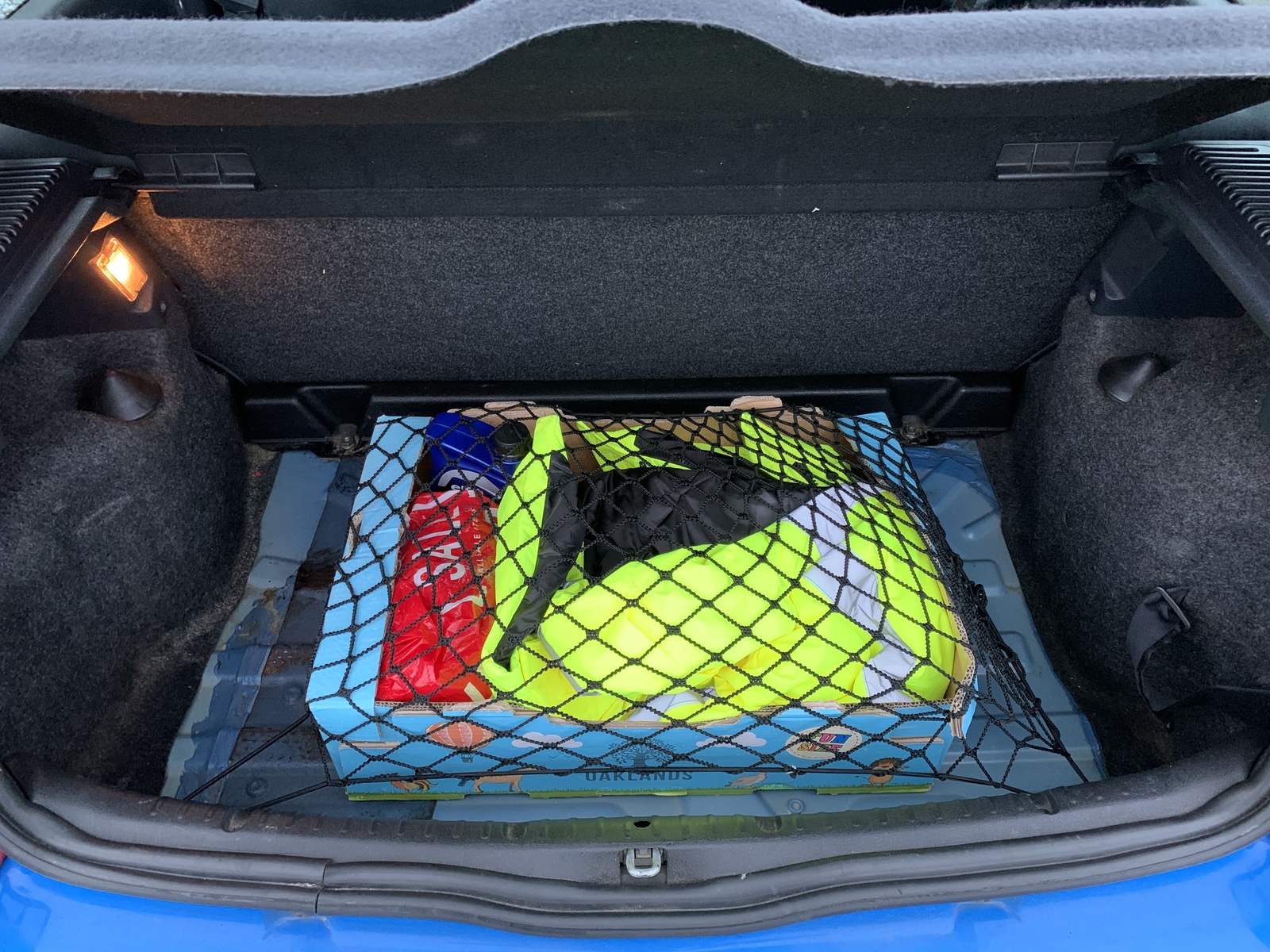

Purchased a boot net and got it in, stops my tools flying all over! Notice the boot mat is still absent from when I removed it due to being wet from water getting in via grommets after I bought the car. Not bothered refitting as they just hold moisture, and anyway lets more noise from the scorp in :)

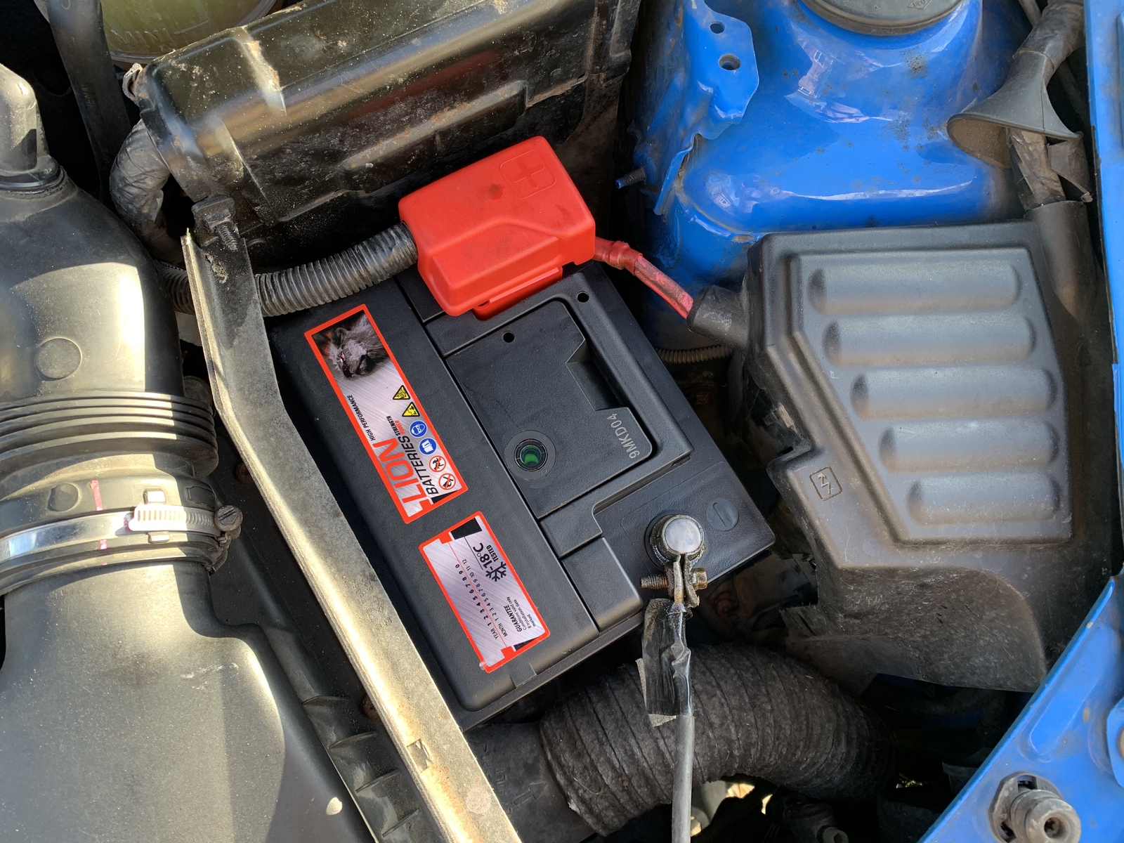

Also took advantage of euro car parts code and ordered and fitted the correct size battery, 063 by Lion. Old one was larger which made removing harder than it needed to be, and probably wanted replacing as it was fitted 2017 according to my receipts. Fitted a new positive terminal cover at the same time.

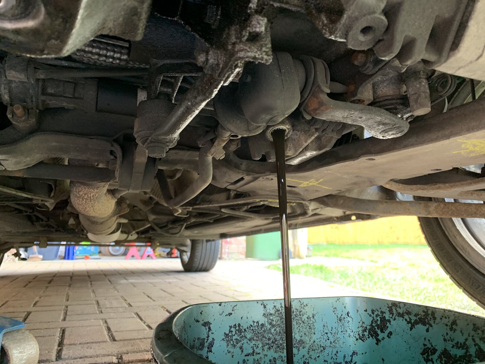

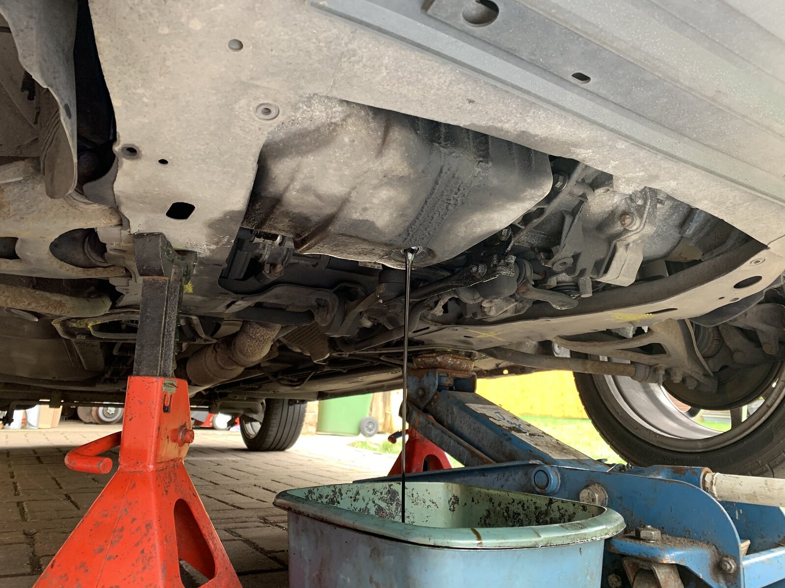

Oil and filter and sump plug washer changed:

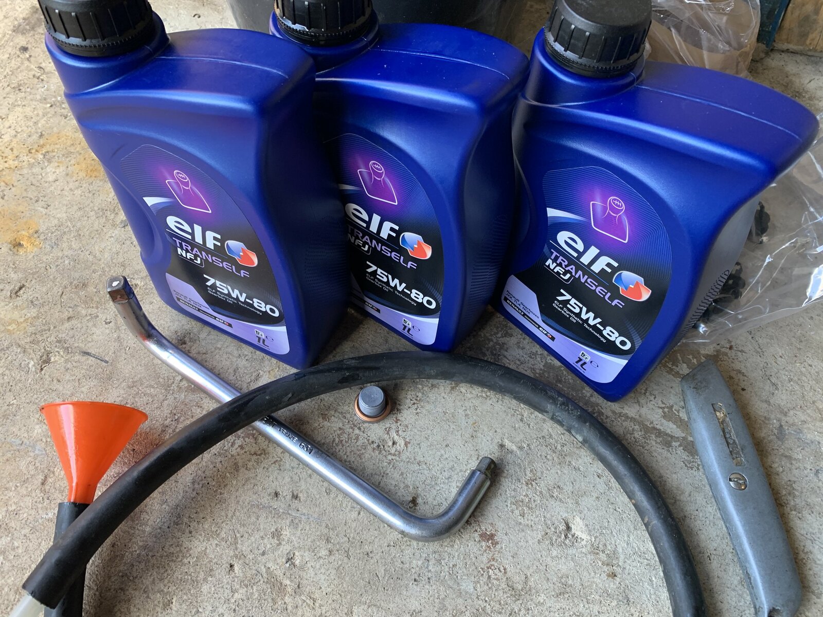

Gearbox oil changed with new sump plug and washer:

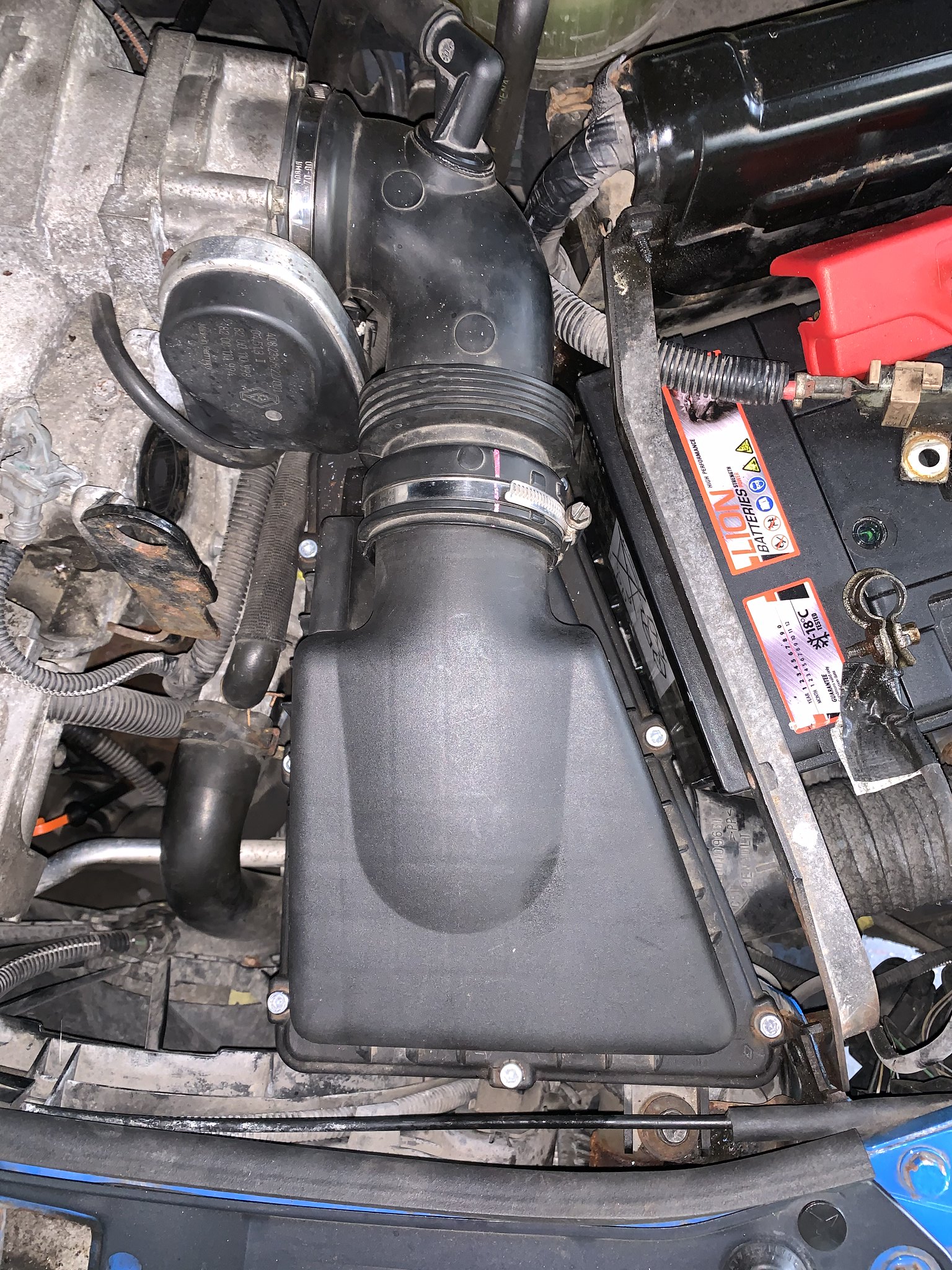

Homemade filler pipe made it easy to access front wing nut once air box removed:

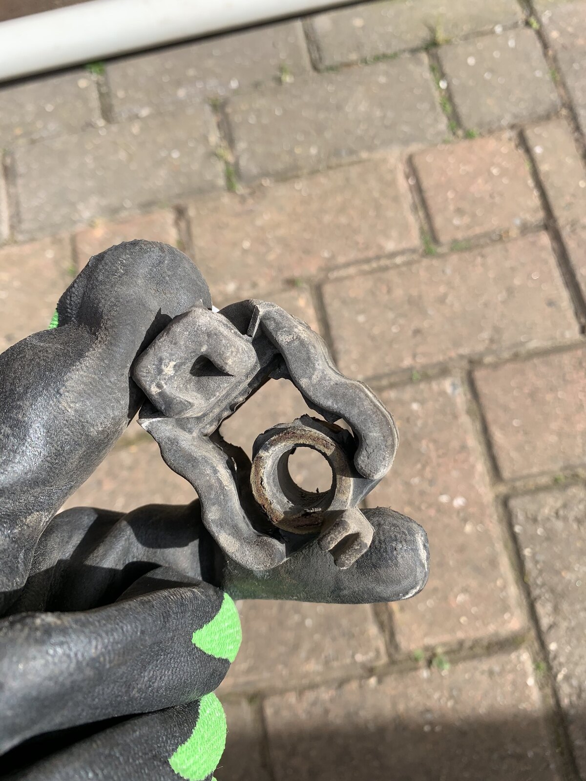

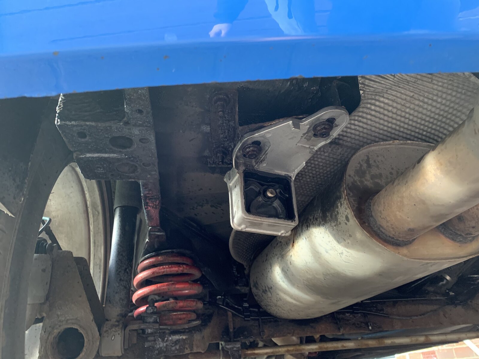

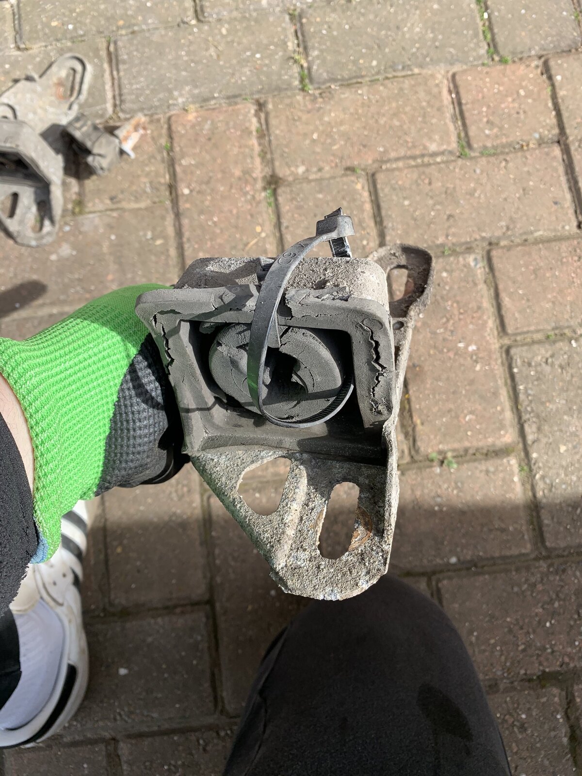

Next up, changed knackered exhaust mounts, including centre mount with updated red one. Had to use a blow torch to free the old bolts. Old mounts were in a sorry state:
New rear ones in place (forgot to take pic of new centre one on):

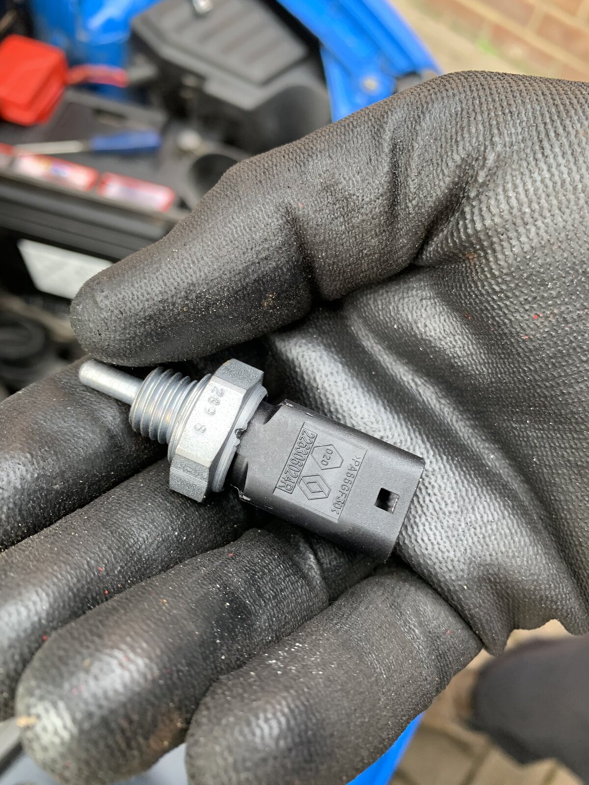

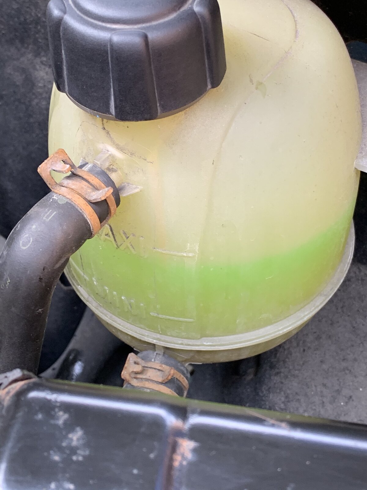

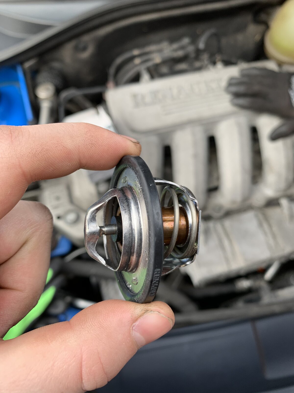

Lastly, coolant temp sensor and thermostat replaced and coolant topped up with proper stuff:

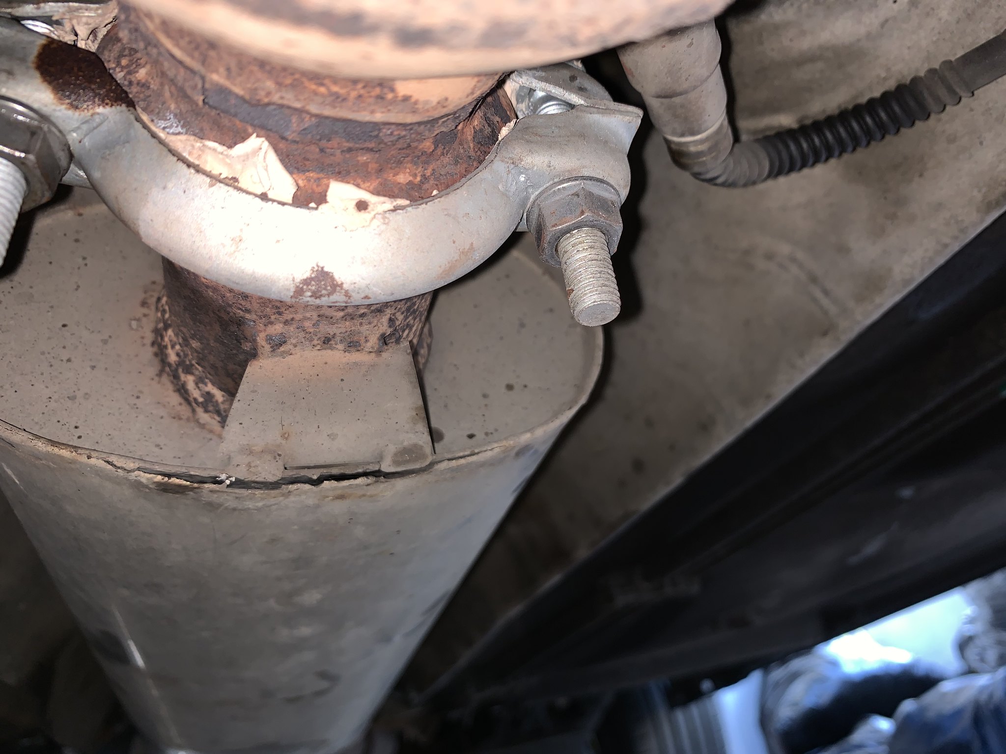

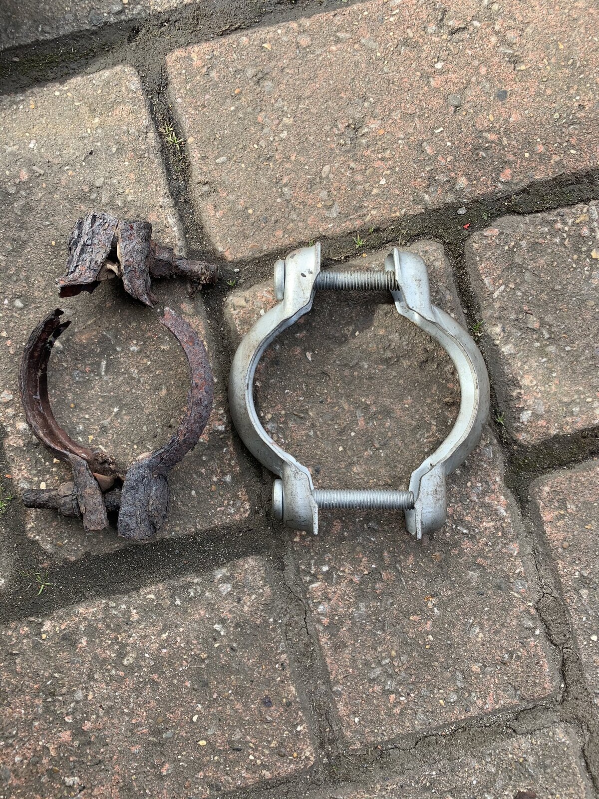

Almost forgot, centre clamp from cat to cat back was goosed ... crumbled in my hand so good job we spotted that!

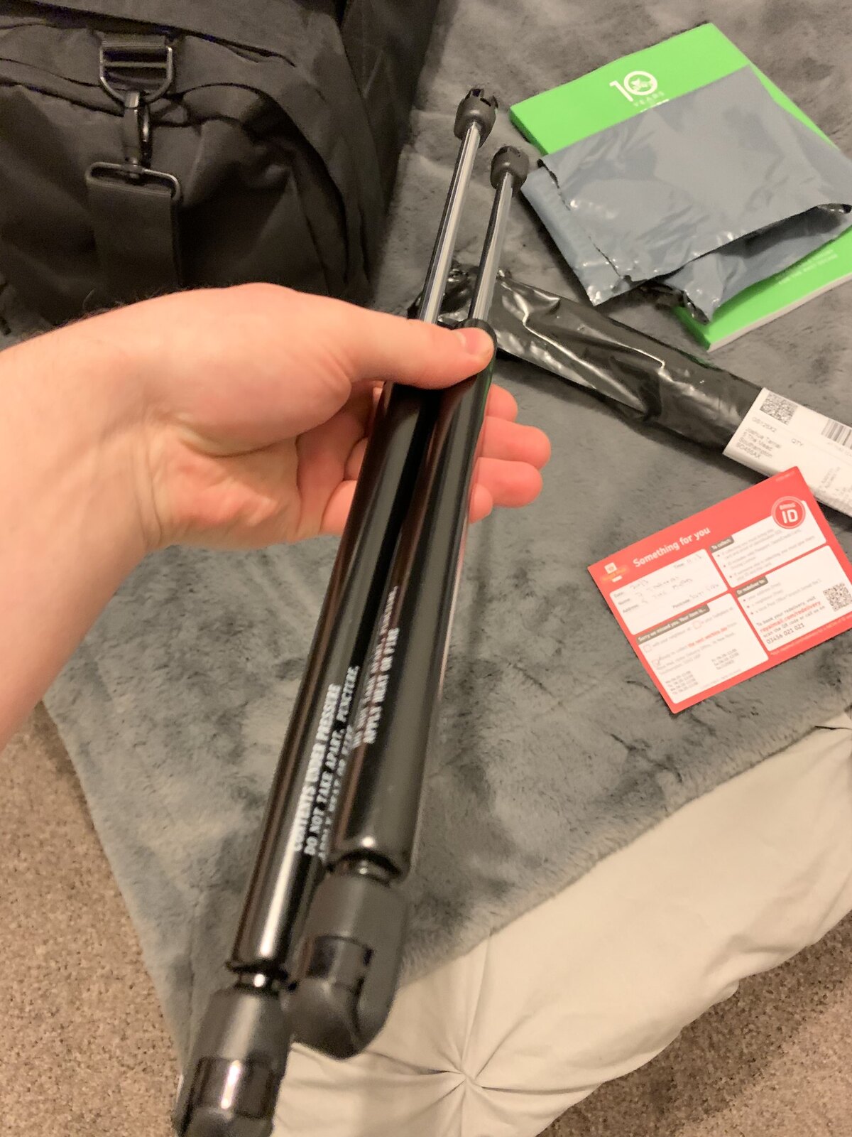

Fitted the new boot struts I received from eBay, fitment was easy and for £12 I think I paid it was worthwhile.

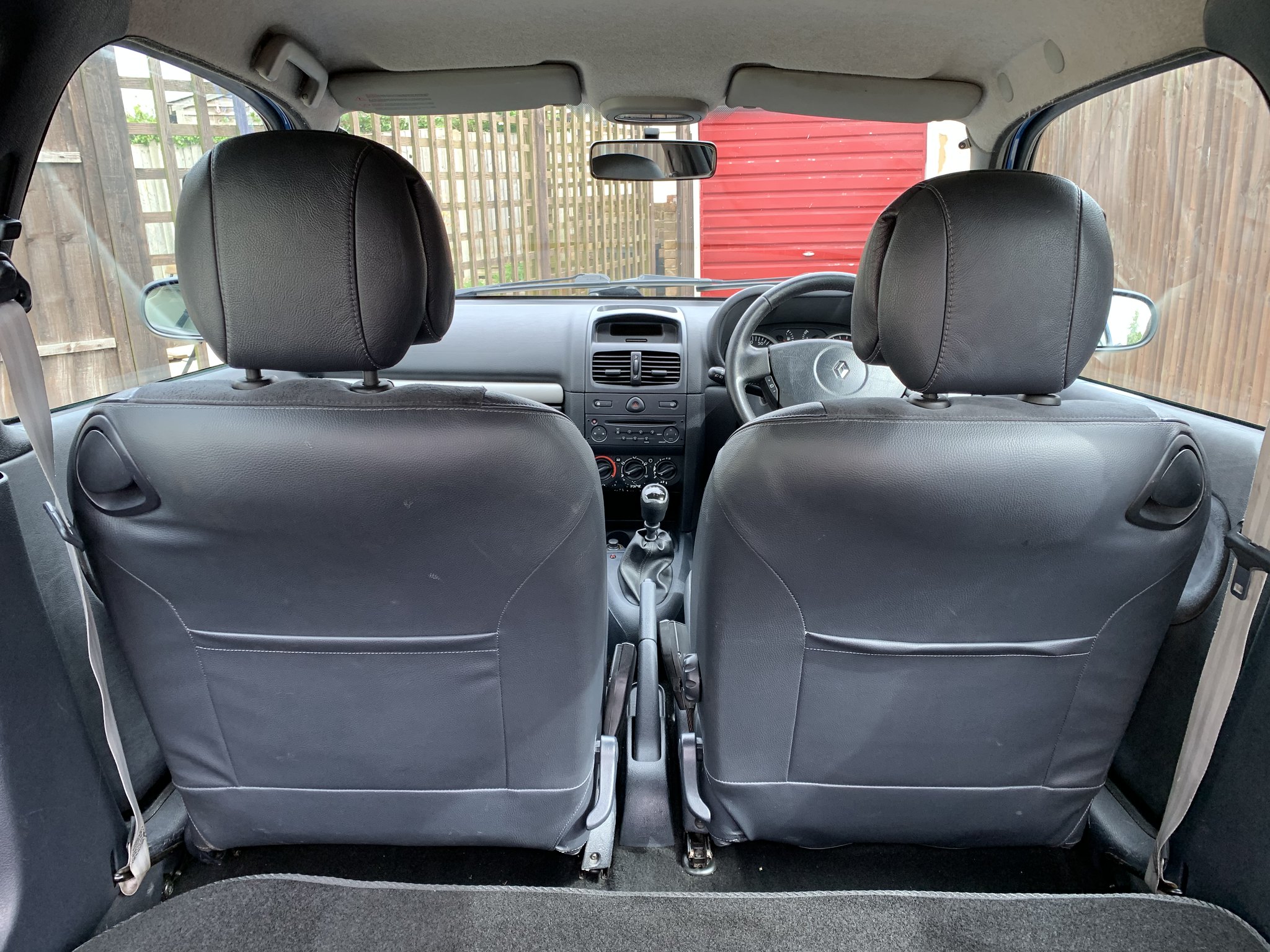

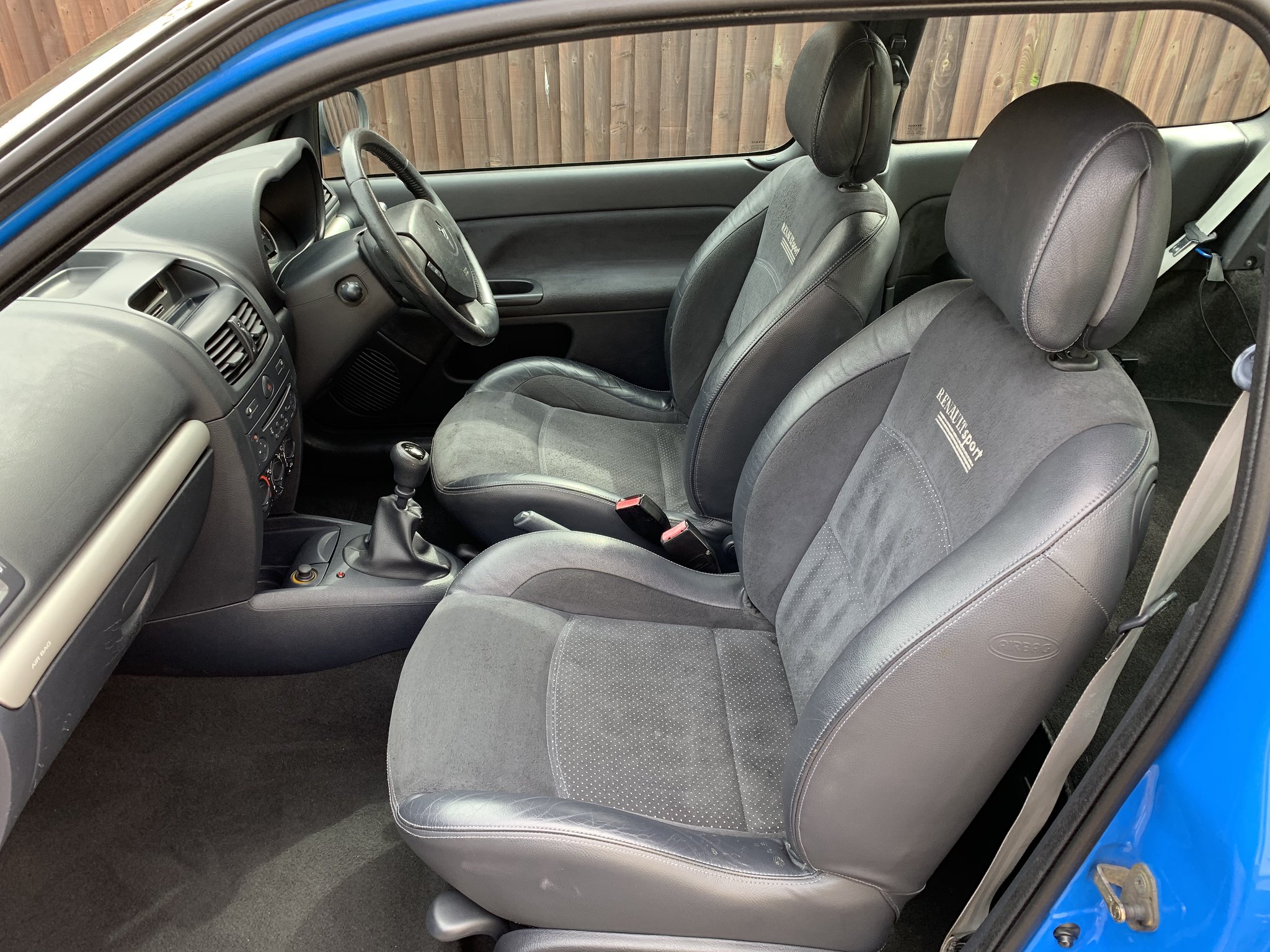

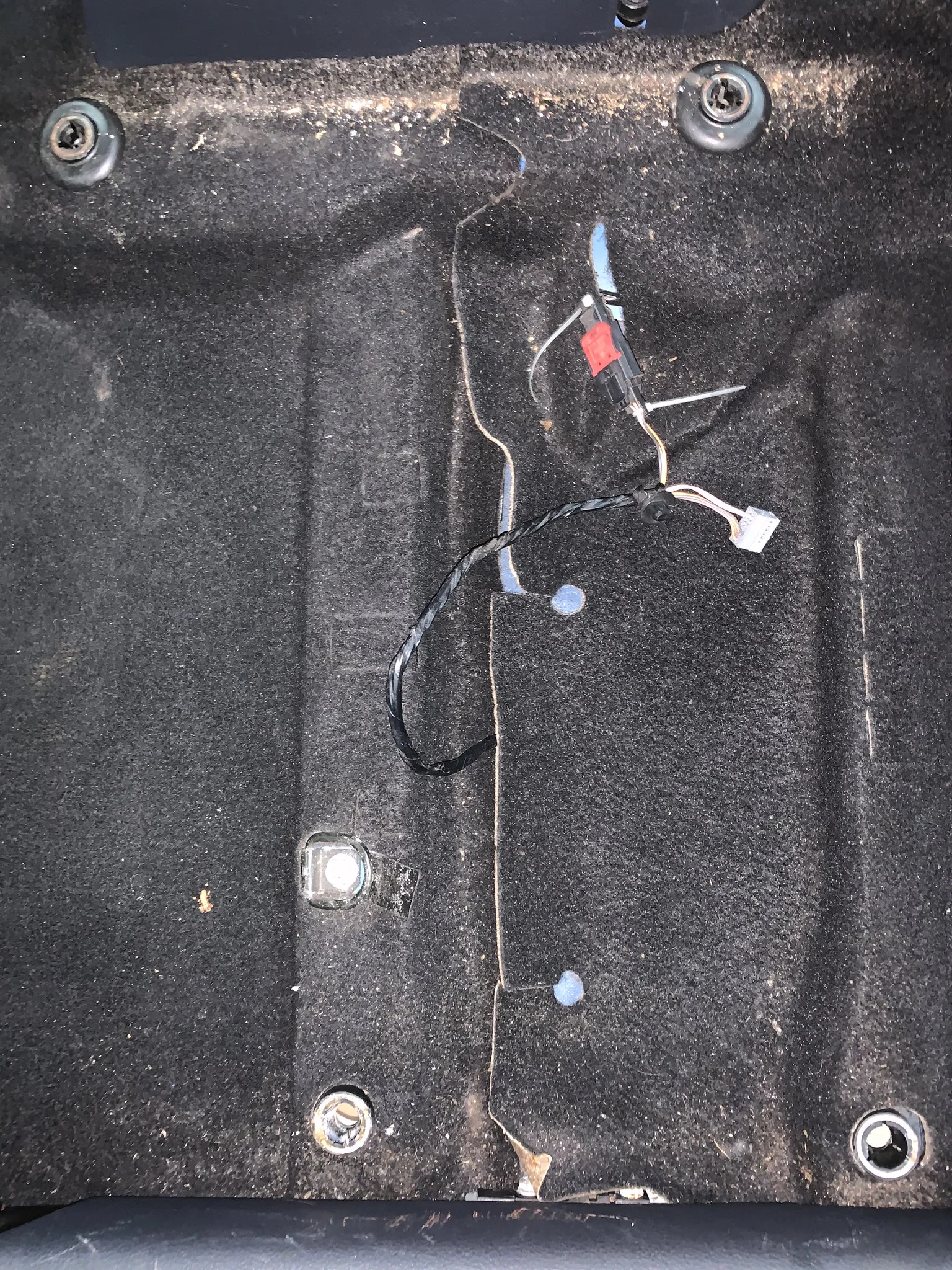

A member on here was looking for a cup interior for his 182. So, wanting rid of my drivers bucket we agreed to do a swap. So, had to remove my Cup interior which wasn't bad. Whilst under the car, noticed this small exhaust hole:
Not major but will need repairing at some point, I can't hear a blow whilst driving either. Anyway, seats out at least allowed me to clean up this mess beneath them:

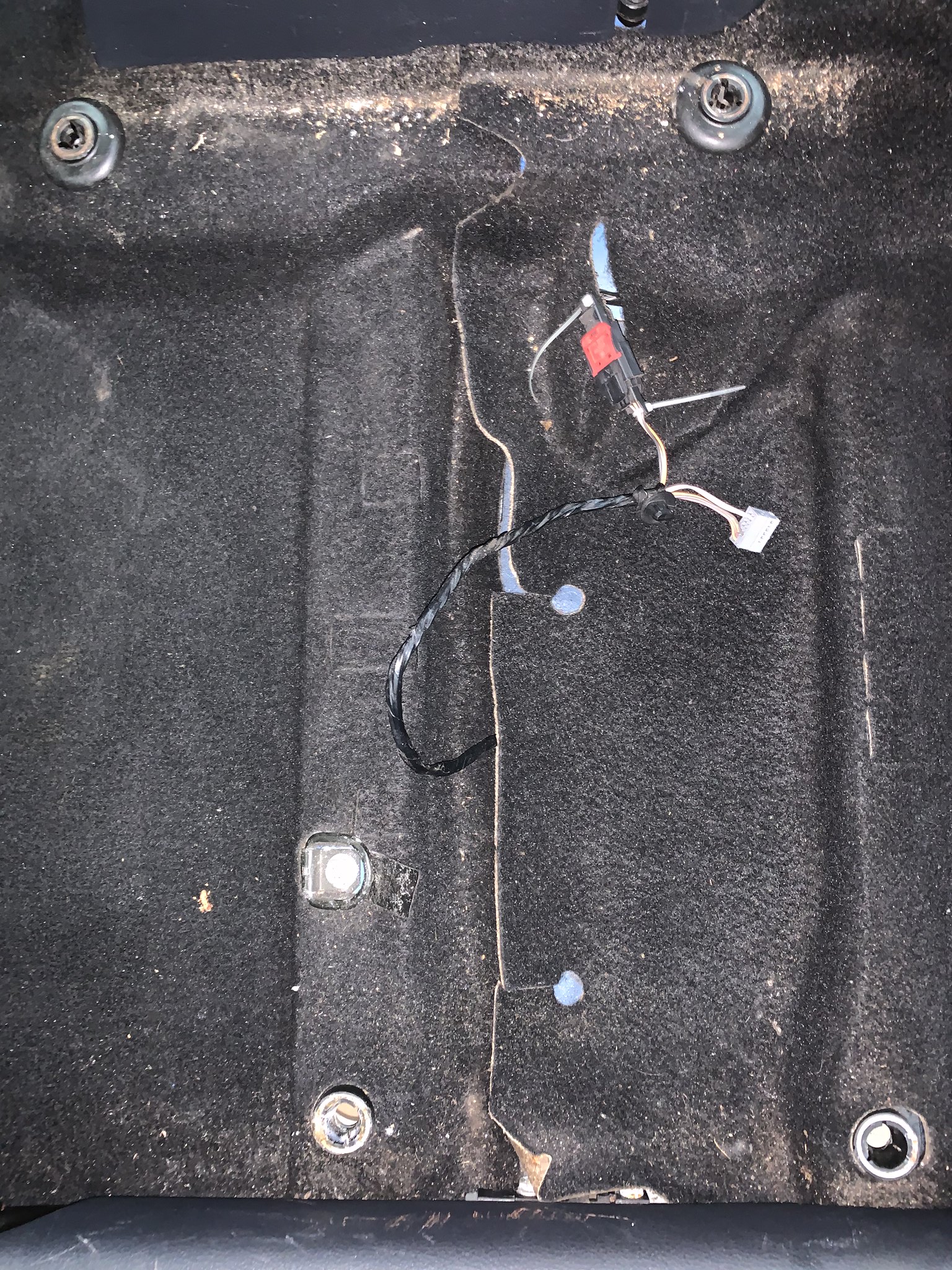

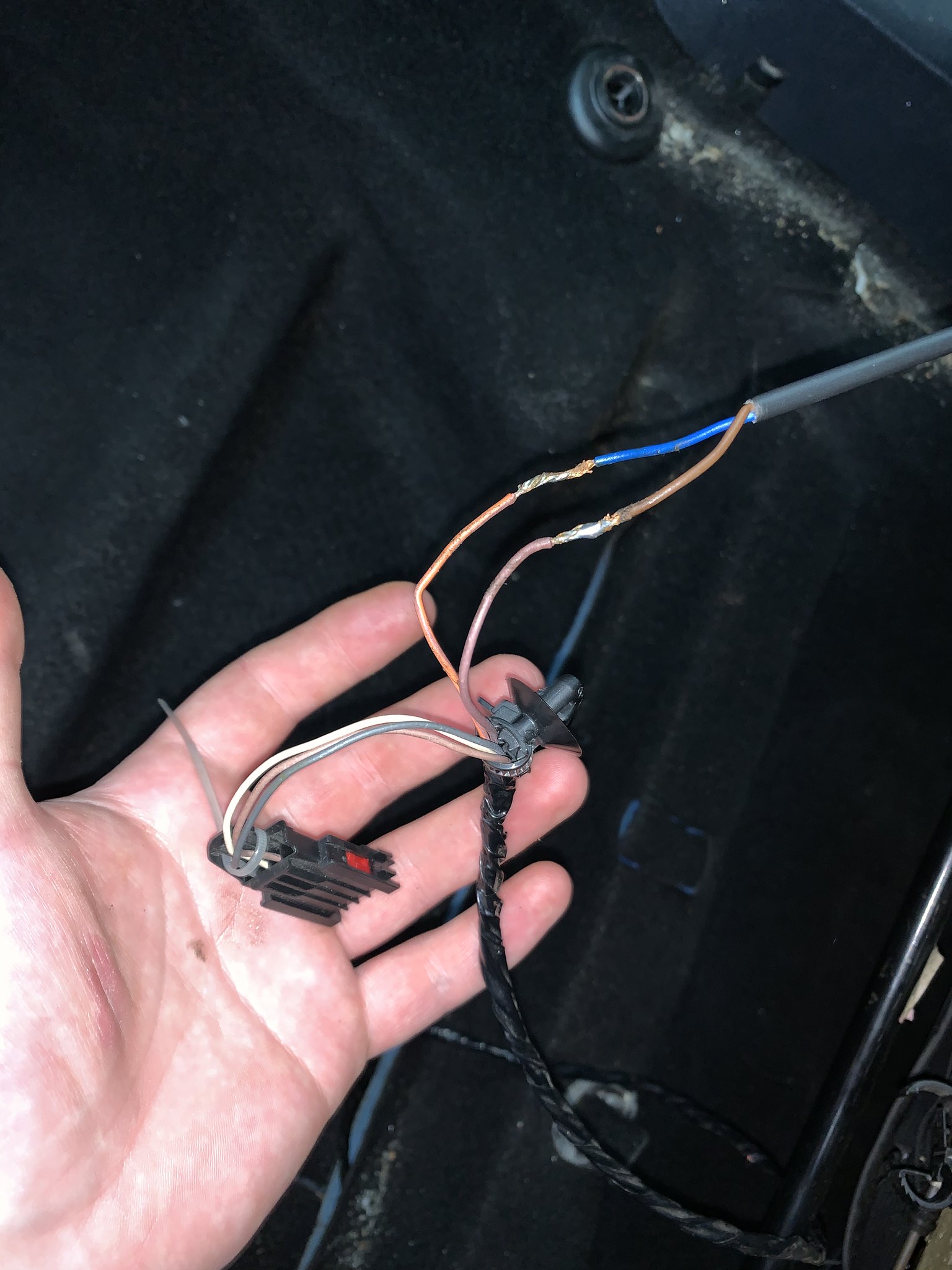

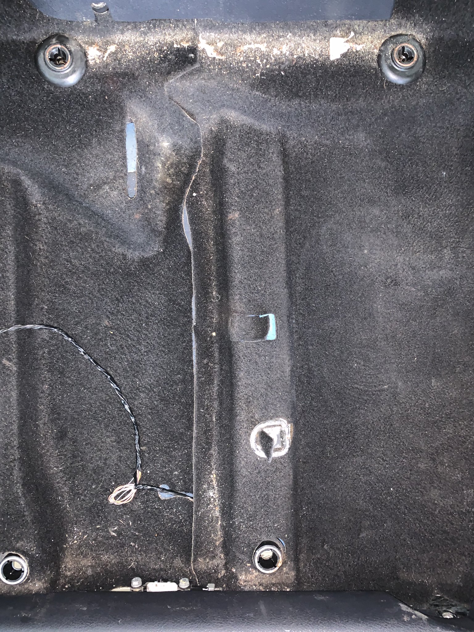

This is the wiring I discovered under the passenger seat, which I had to cut to get the seat out. Has obviously been done before, so I'll just solder it back up eventually. Of course this means there's an airbag light for the time being.
Anyway, once it was all removed, I cleaned al the interiorl up. Then swapped it for the interior from the bloke who came to collect mine.
Decided to leave the rear bench out as its in great condition, so I've stored that with my parcel shelf for now. Also you'll notice the boot mat, which is great quality for only £35 I think I paid. The lower drivers seat has transformed the car for me, the bucket was alright but it was just mounted way too high, even for me. The fact that I'm saying a standard 182 seat is low compared to the old bucket should tell you how high it felt!

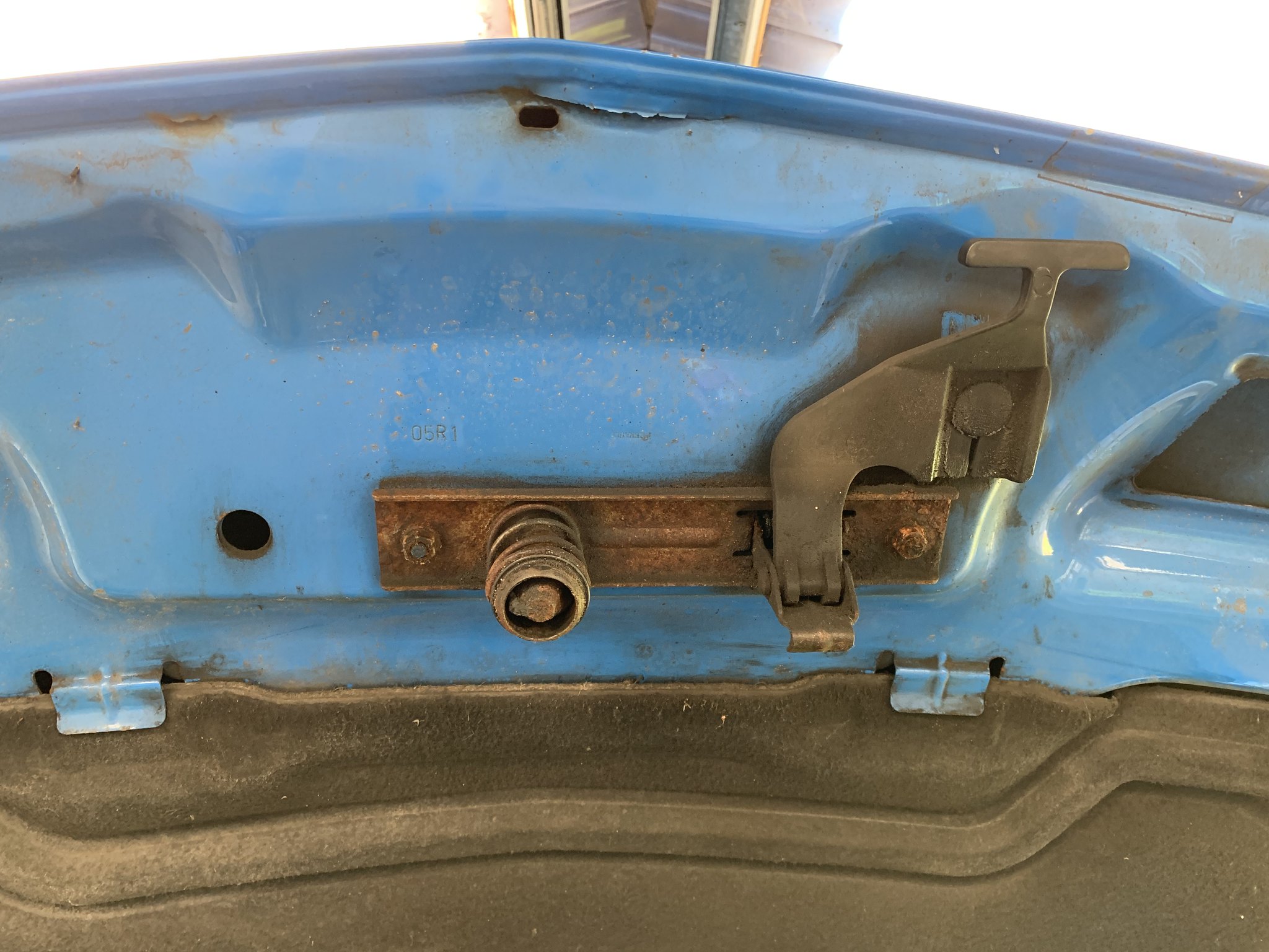

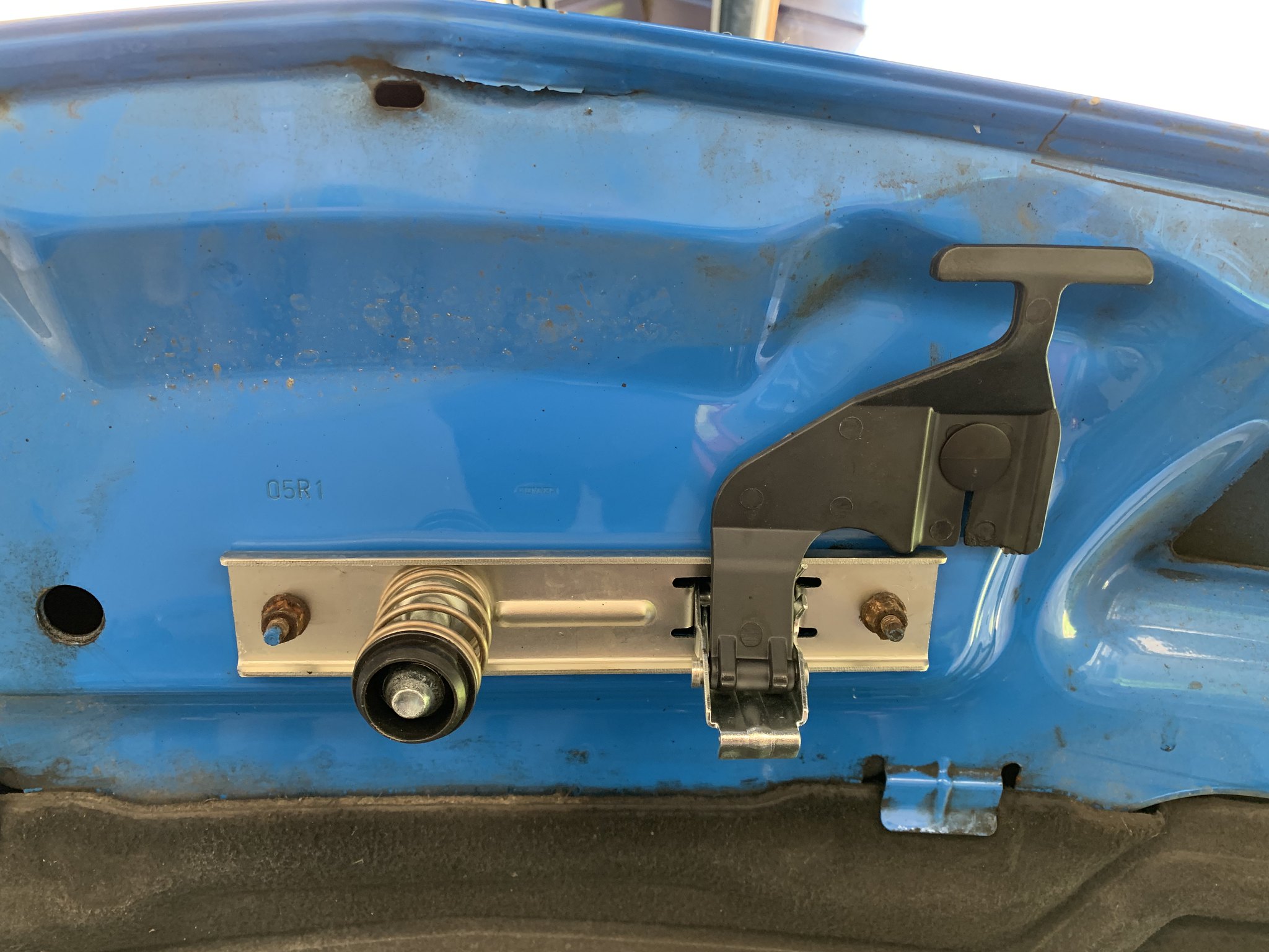

Two other small bits I've done, are to replace the bonnet latch as the original was hanging, and to change the airbag bolts as they looked scabby as well.

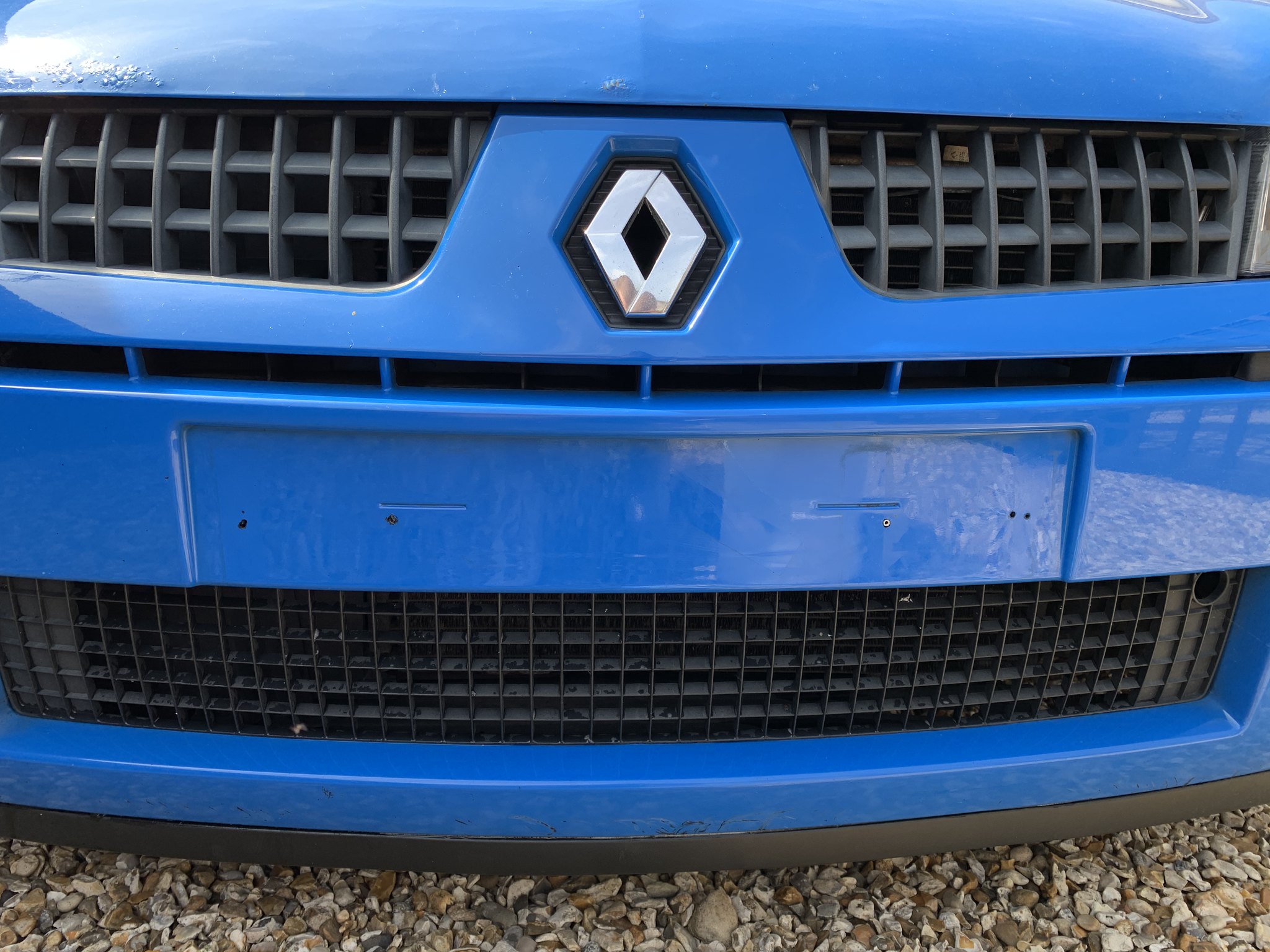

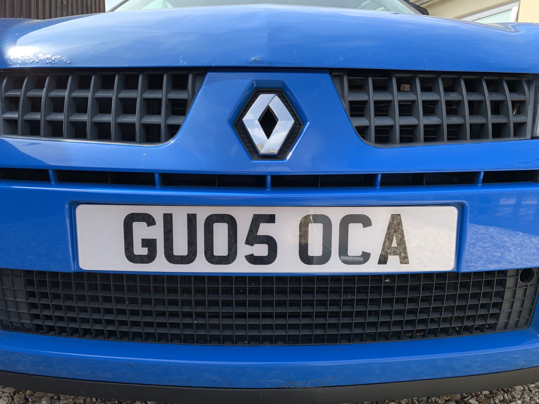

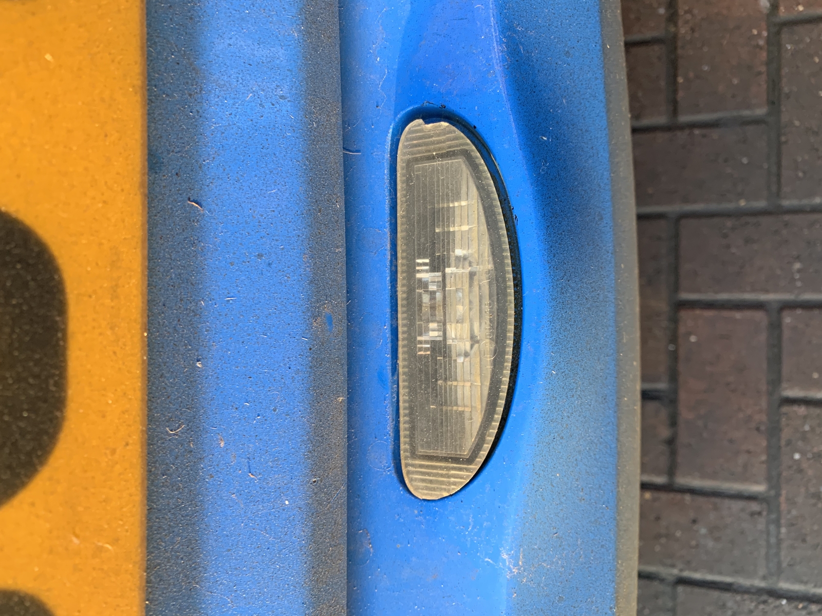

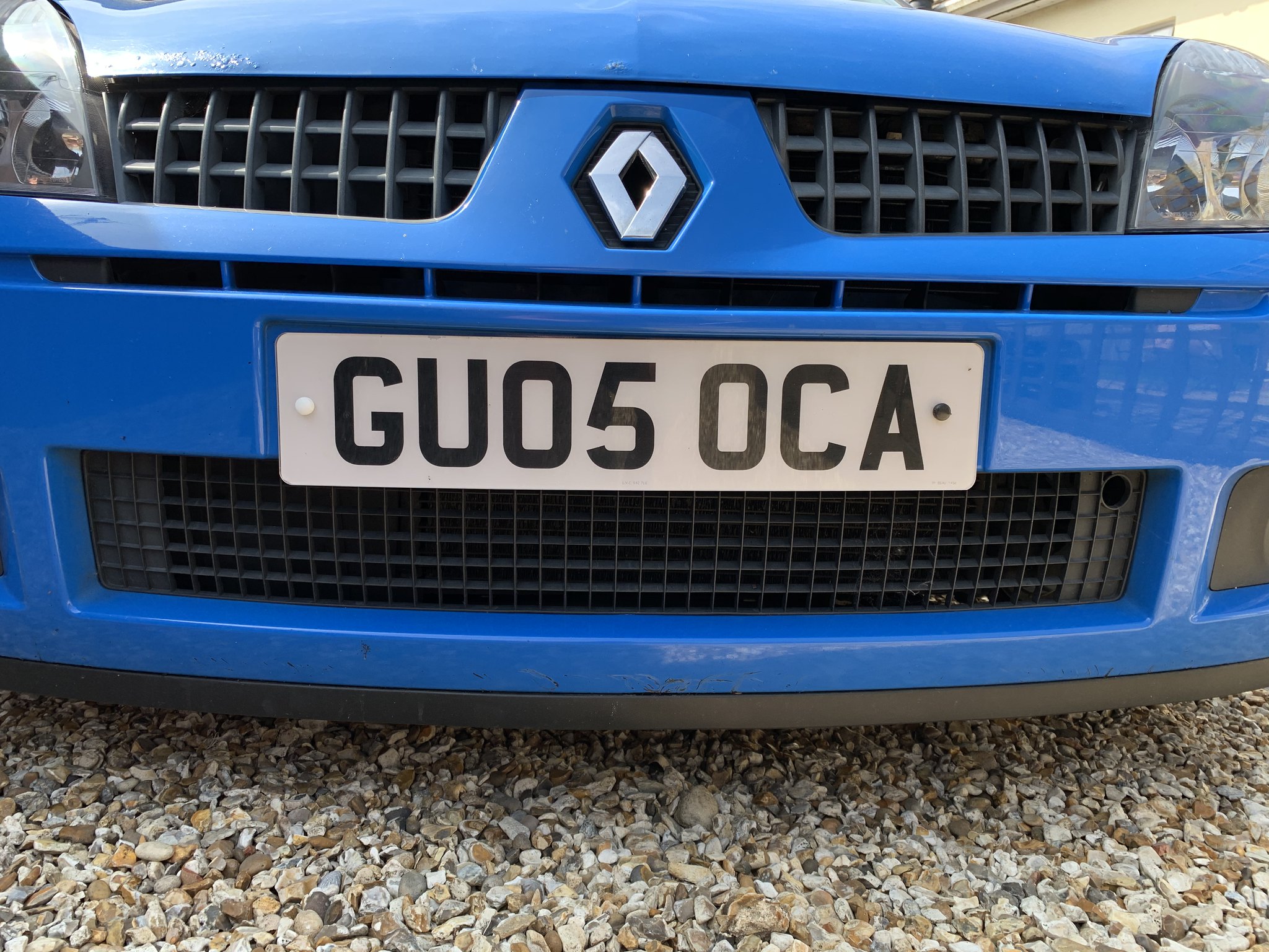

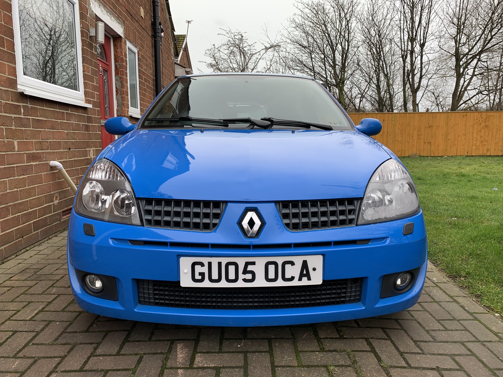

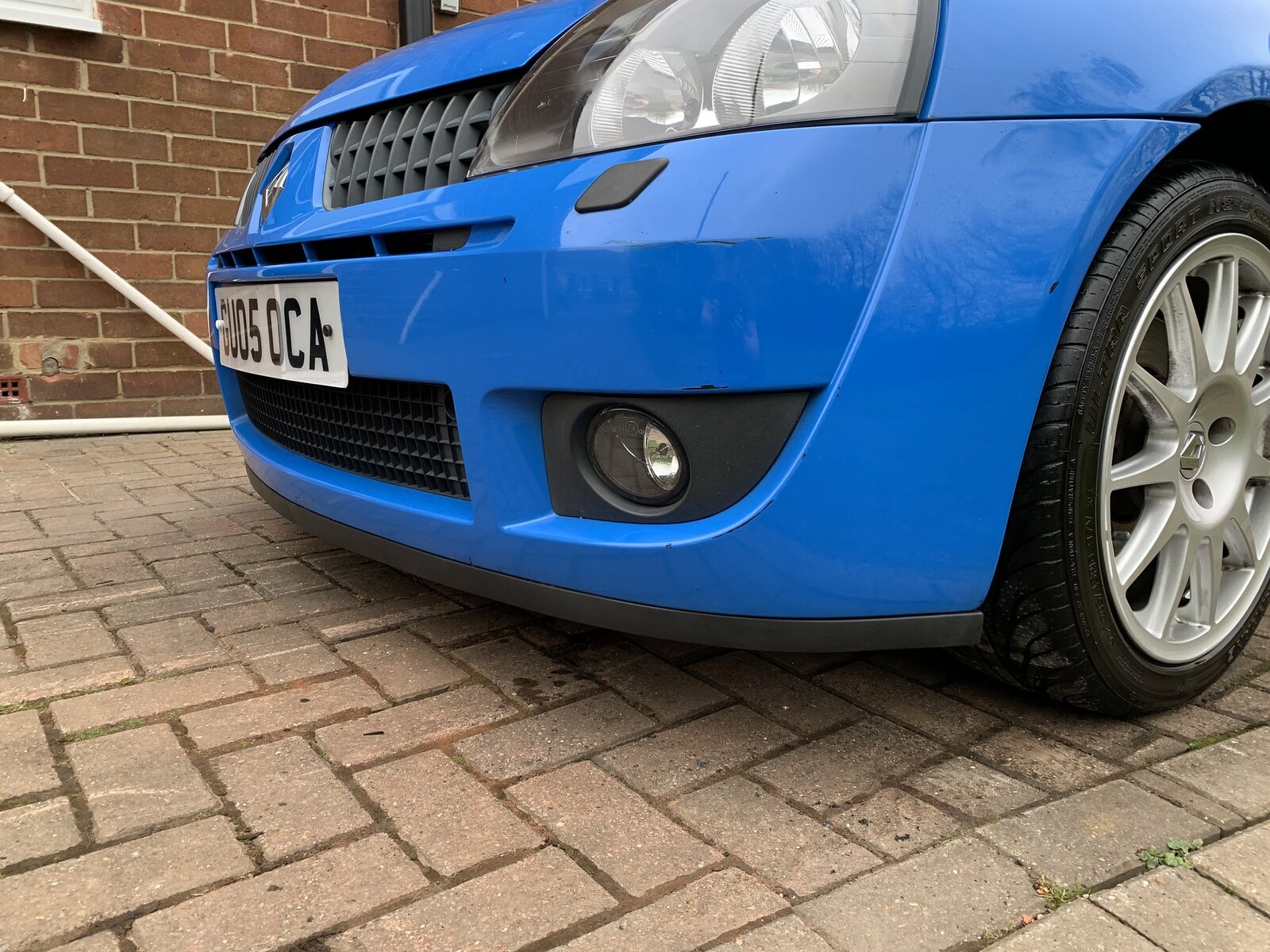

Today, I removed the front plate and fitted a reduced plate from Fancy Plates. The quality is great. I used Velcro coins to stick the plate on, after cleaning the recess using tar remover from CarPro.
Old plate
Recess cleaned, a lot of sticky pads were on here prior even though the old plate was screwed on?
New plate fitted

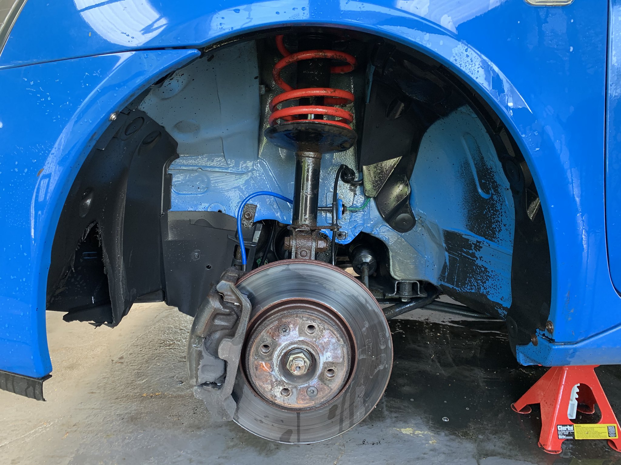

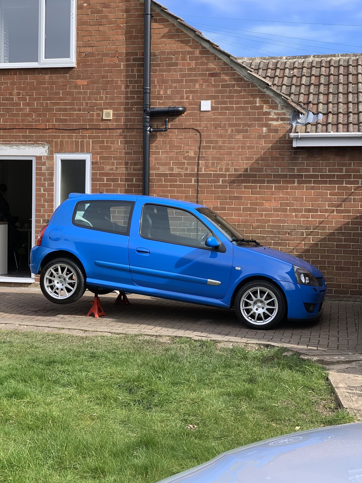

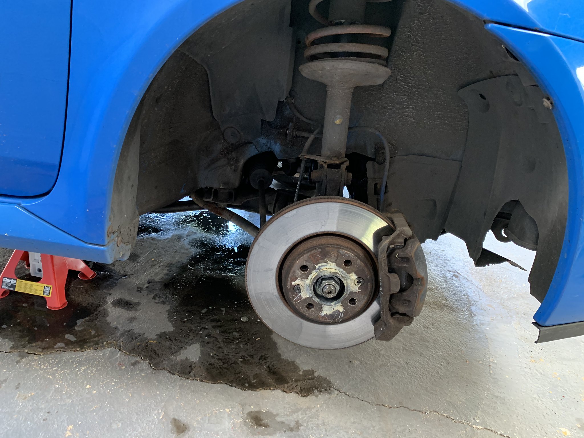

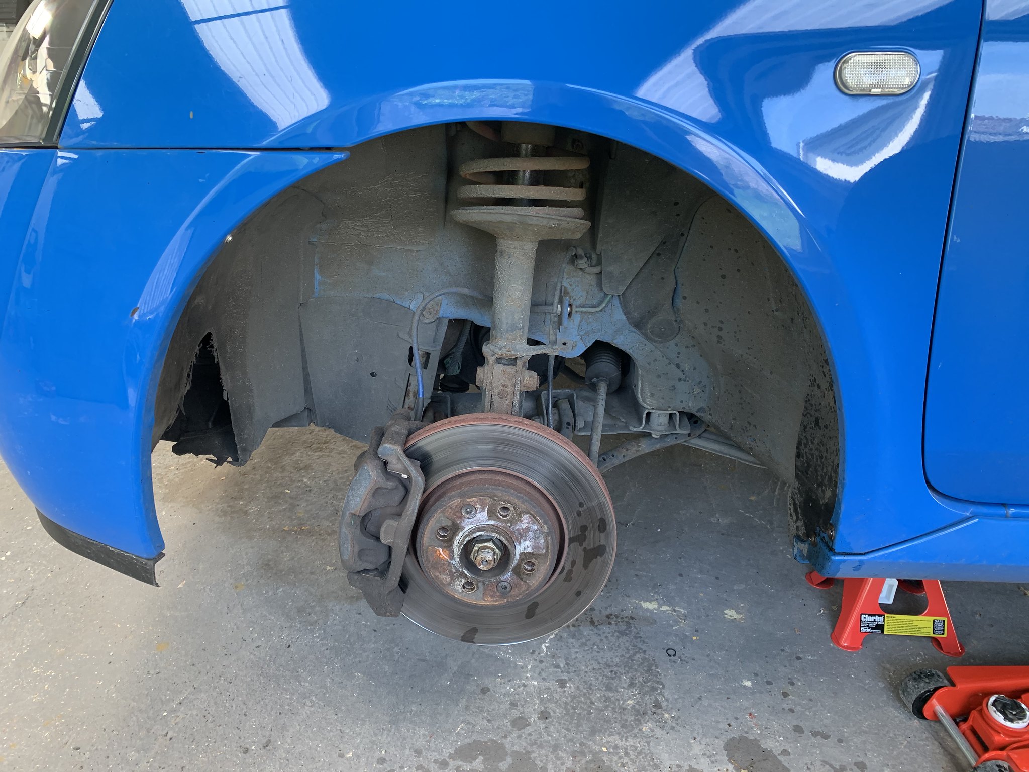

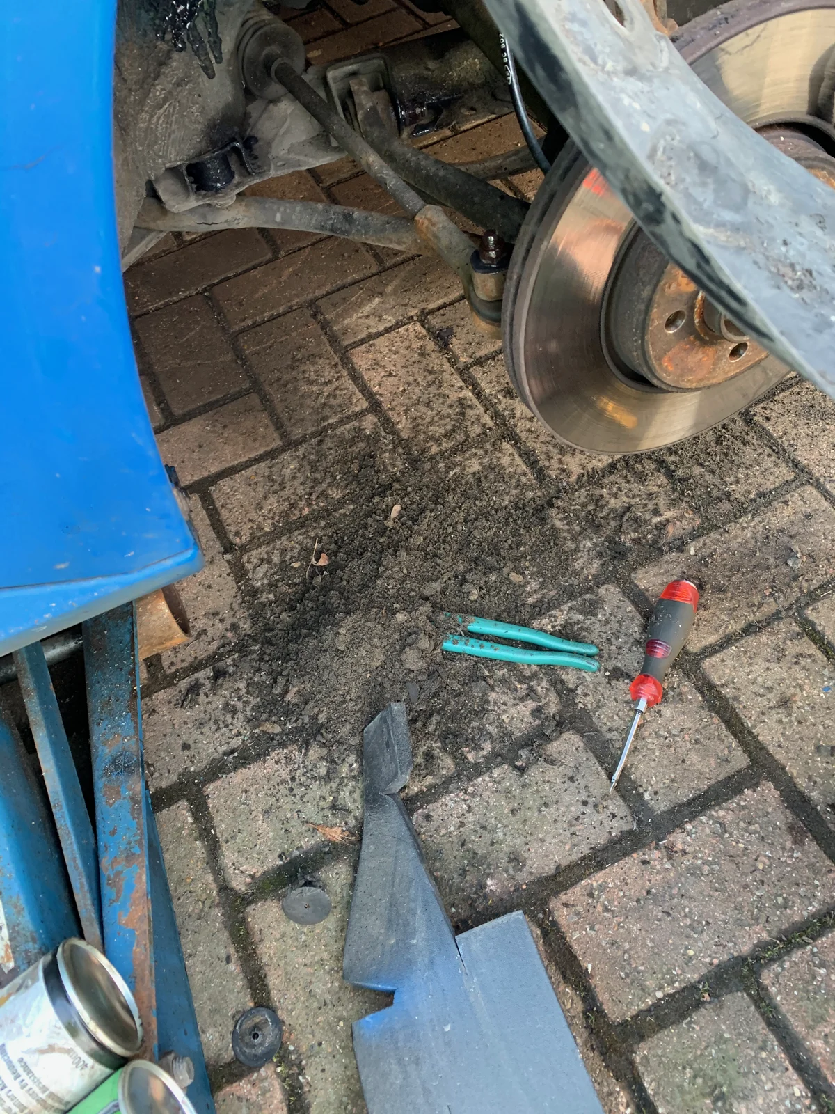

Next, removed the front wheels and cleaned the inner arches. Plan was to remove the arch liners as well, but the Torx screws weren't playing ball so that's a job for another day. Used Bilt Hamber Surfex diluted in a spray bottle then agitated it with a brush before pressure washing off.
Passenger side
Drivers side
Afters
It's just about visible that the front arch liners have been cut/torn? Guessing this was due to previous owner fitting brake ducts maybe?

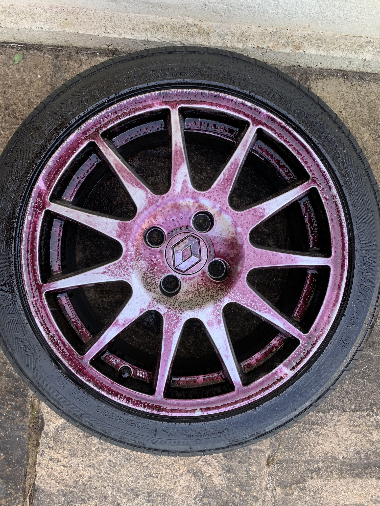

Took the opportunity to clean the wheels as well using an iron fallout remover and again then an APC from Bilt Hamber

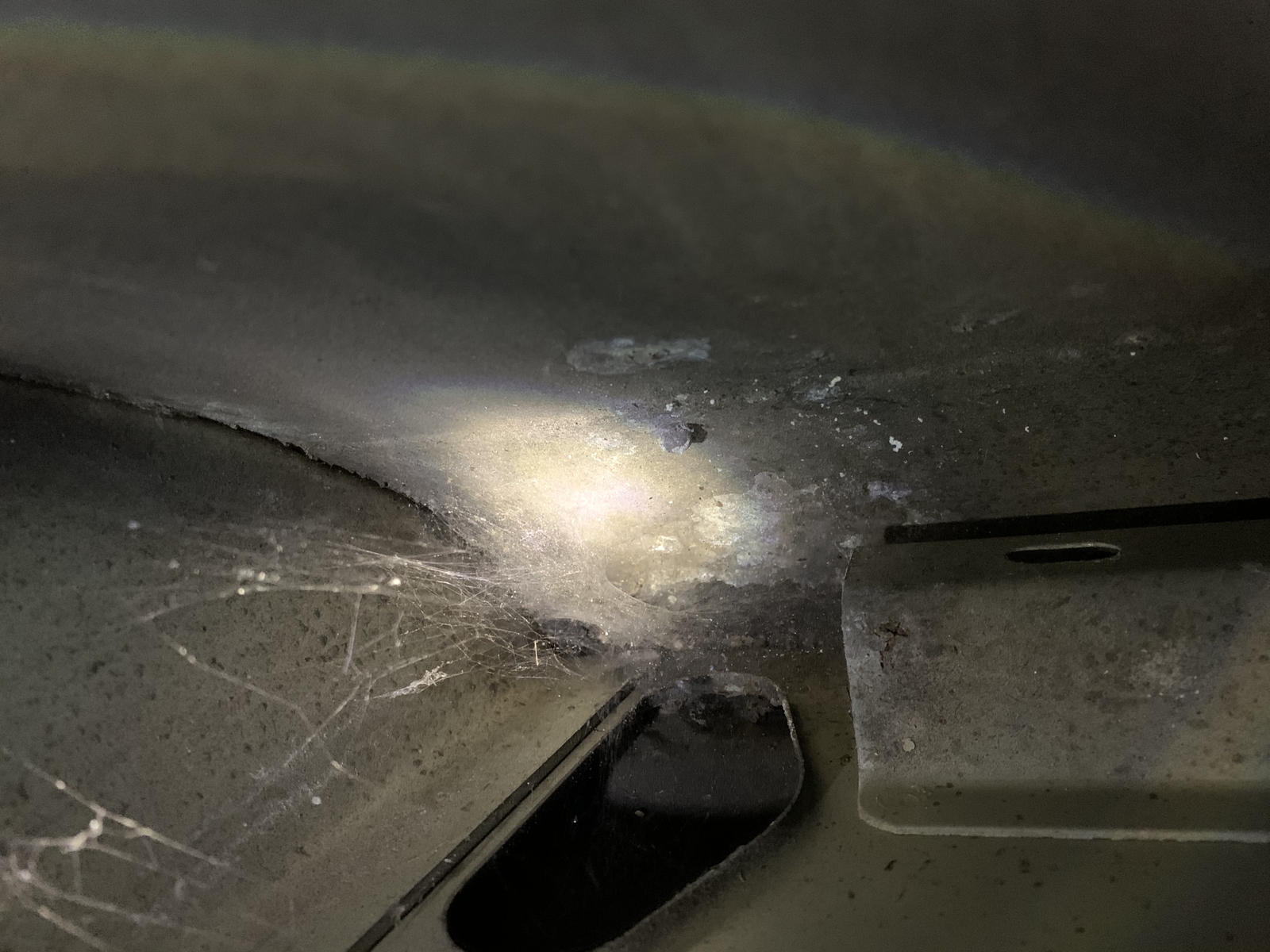

  • Weld small exhaust hole
  • Solder wires beneath passenger seat to remove airbag light
