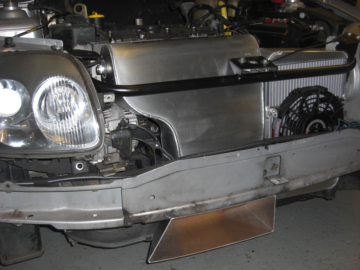

Would like to re-create something similar to Colin satchells 205 airbox/306 Maxi style box to allow better bonnet clearance aswell as trumpet to filter clearance.
Just wondering has anyone done something similar before? Il be using a large ITGc panel filter.
Colins
306 maxi
Plan is for it to be made from aluminium as thats what I work with but have it swoopy like the maxi..

Yup ive been looking into somthing similar myself, Colins car sounds MAD! and it flew up Gurston Hill Climb!
I think it would cure alot of issues.. Will have to make myself a radiator aswell for more room.
Yeah it does fly! 280bhp so no wonder why, airbox adds 80bhp so thats what I'm aiming for haha
Atleast :p
That was a joke mind.. Doubt it would make much if any difference. But I prefer this design and so do alot of engine builders.
If you can make one for a boosted car that would be great I can even lend you a demo car free of charge lol
That looks epic, suck up small animals as you go.
Might be worth doing some cad model tests first tho, there must be a few engineers on here that could knock one up pretty quickly.
Wouldn't that just act like a big water scoop?
I guess it would work well on a track - but for a car thats used on the road, its just asking for trouble.
Worked fine on our 4K mile trip around Europe a few years ago ;) The only issue was the welds cracking due to the stiff mounting, this has been resolved by fitting rubber bobbins on the mount points iirc.

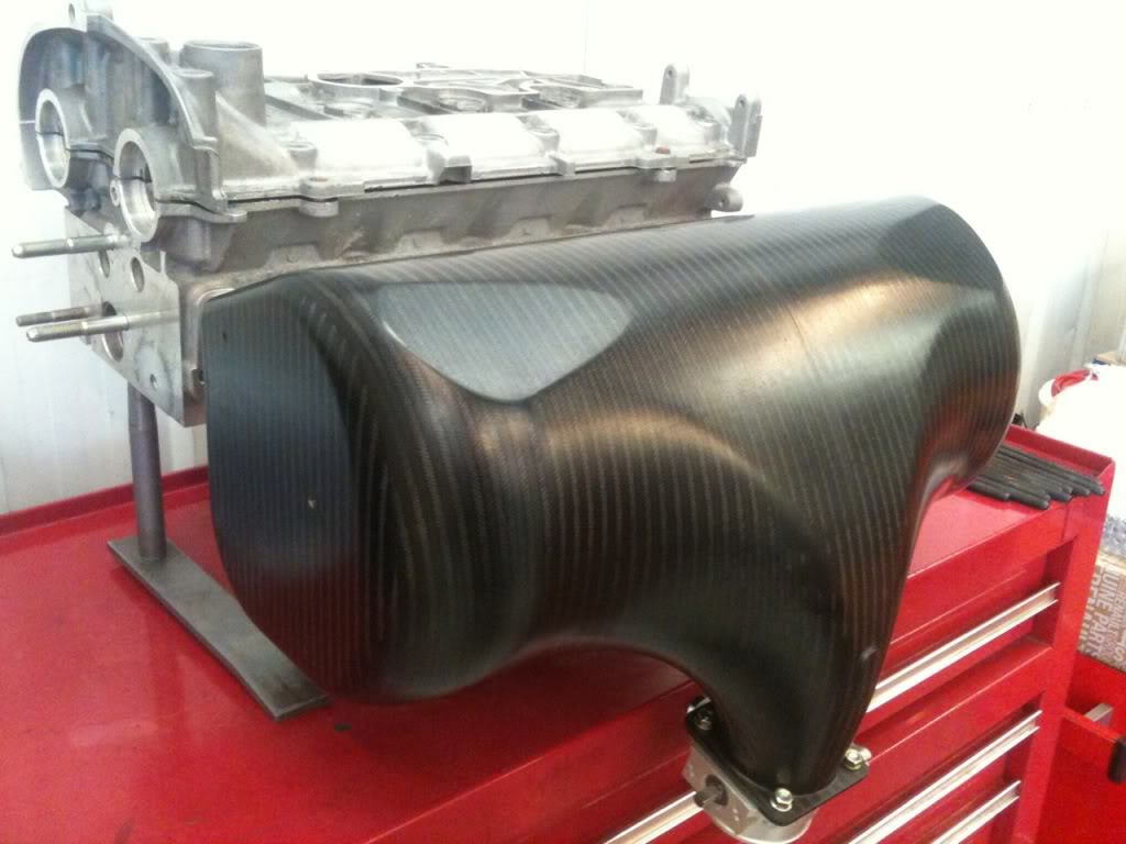

Yeah, that inlet was NOT designed or built by Matt or TDF. Want to know where it really came from? I know because I have one
No, the plenum itself is actually part of a two piece inlet from a 888 designed engine.
Touring Car Spares were selling the complete setups a few years ago. I was a little upset when Phil told me.
