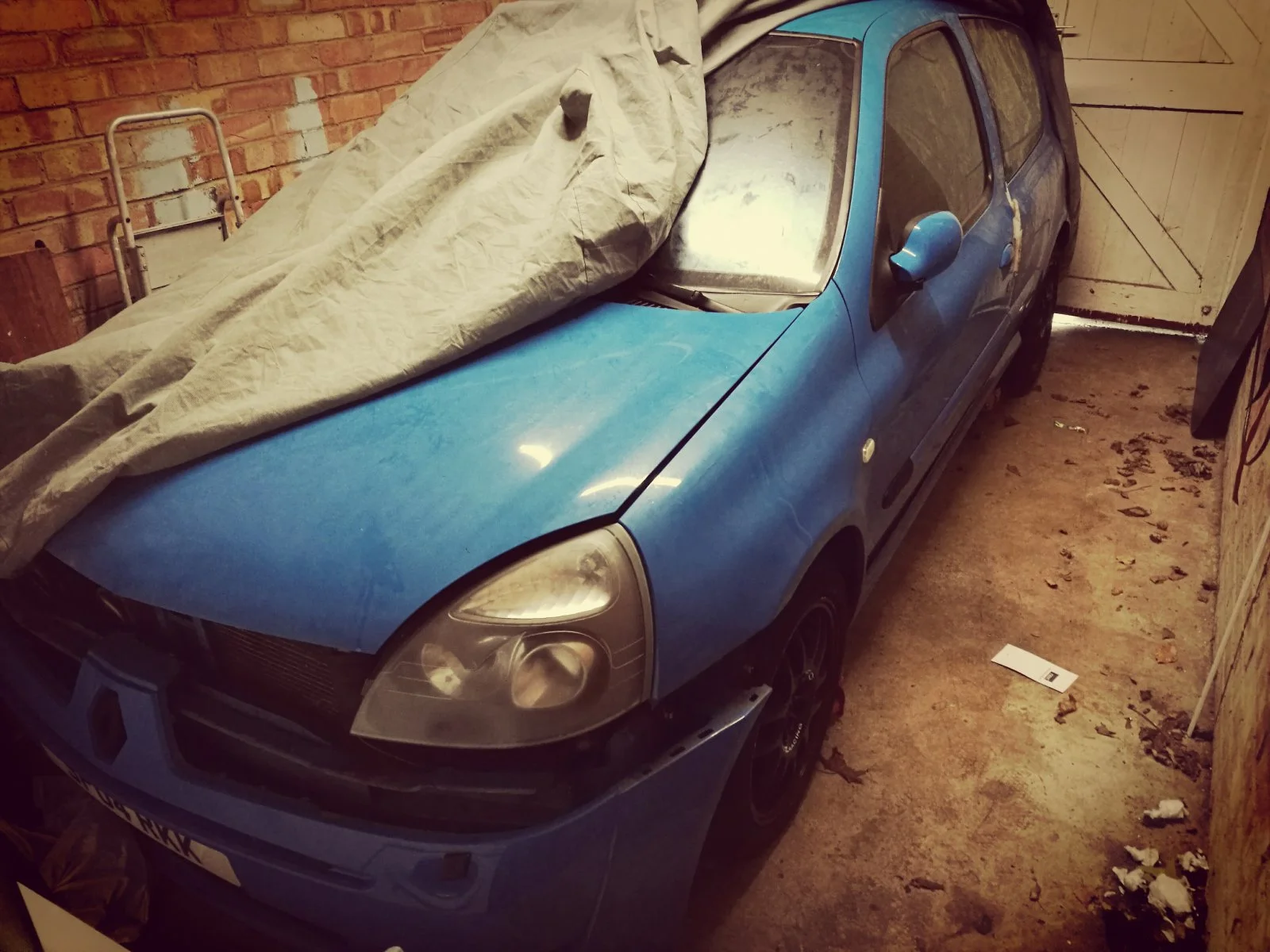

Starting point when I dropped it off.
182 Progress by ANDREW COLLINS, on Flickr

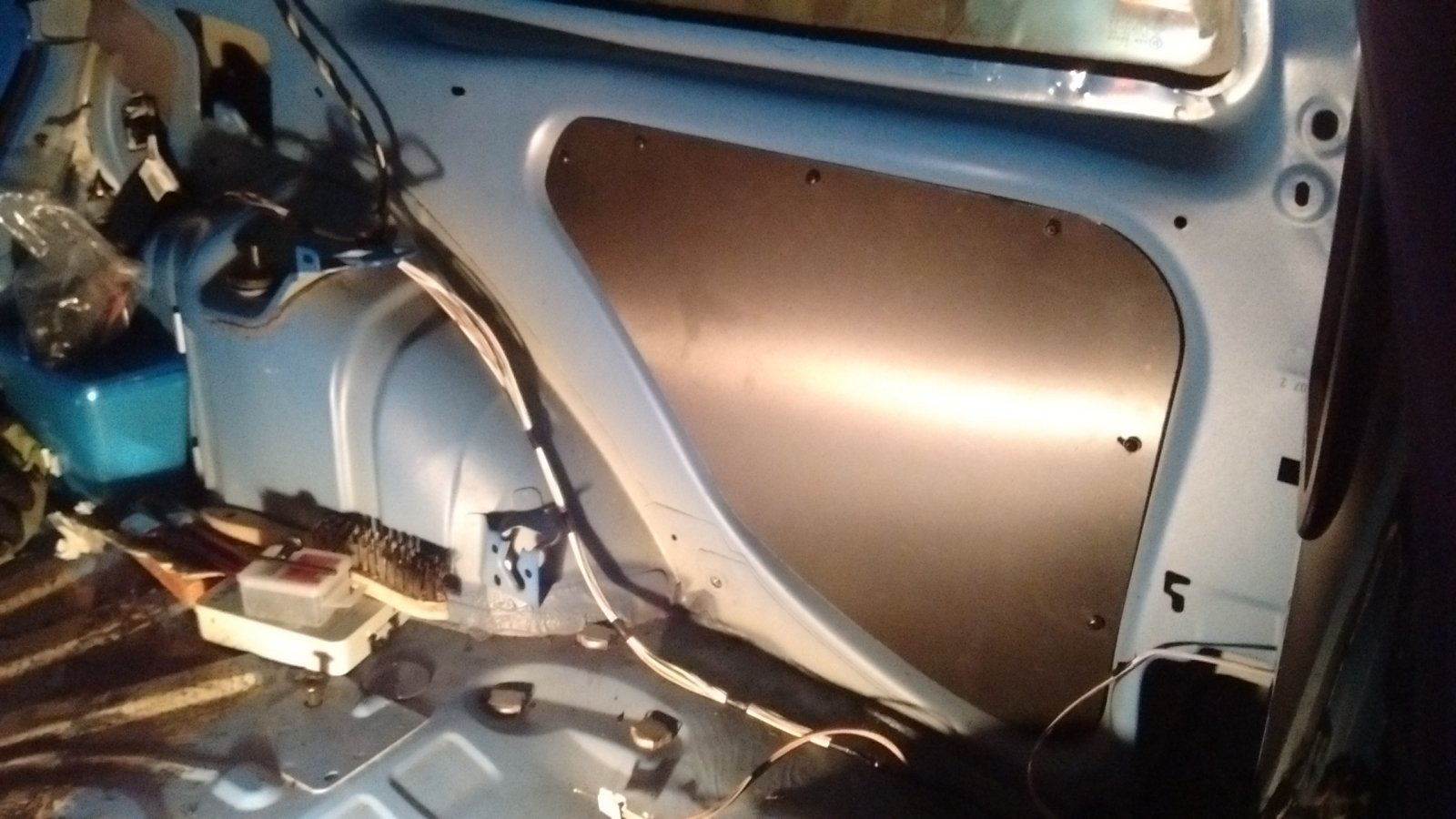

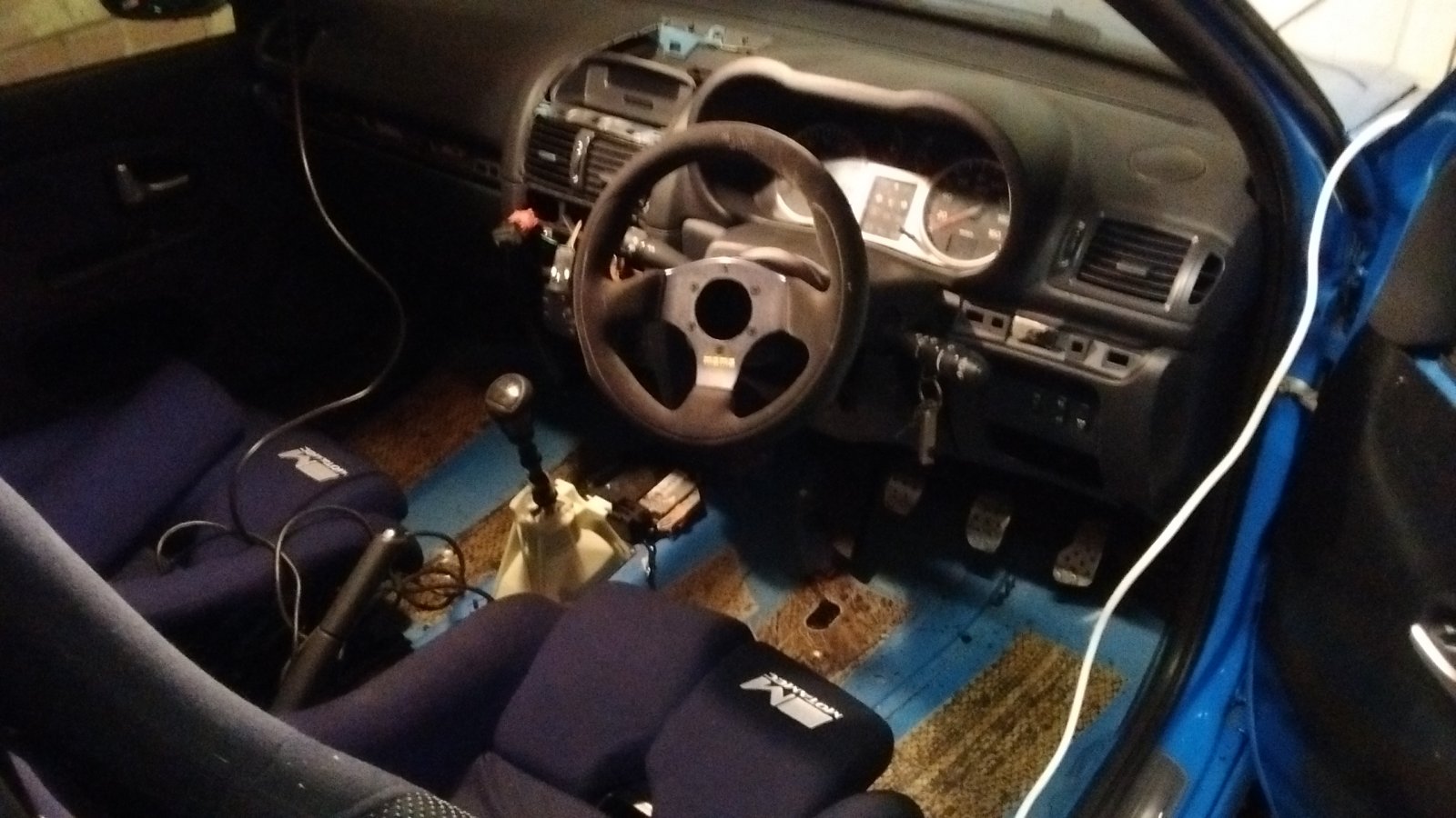

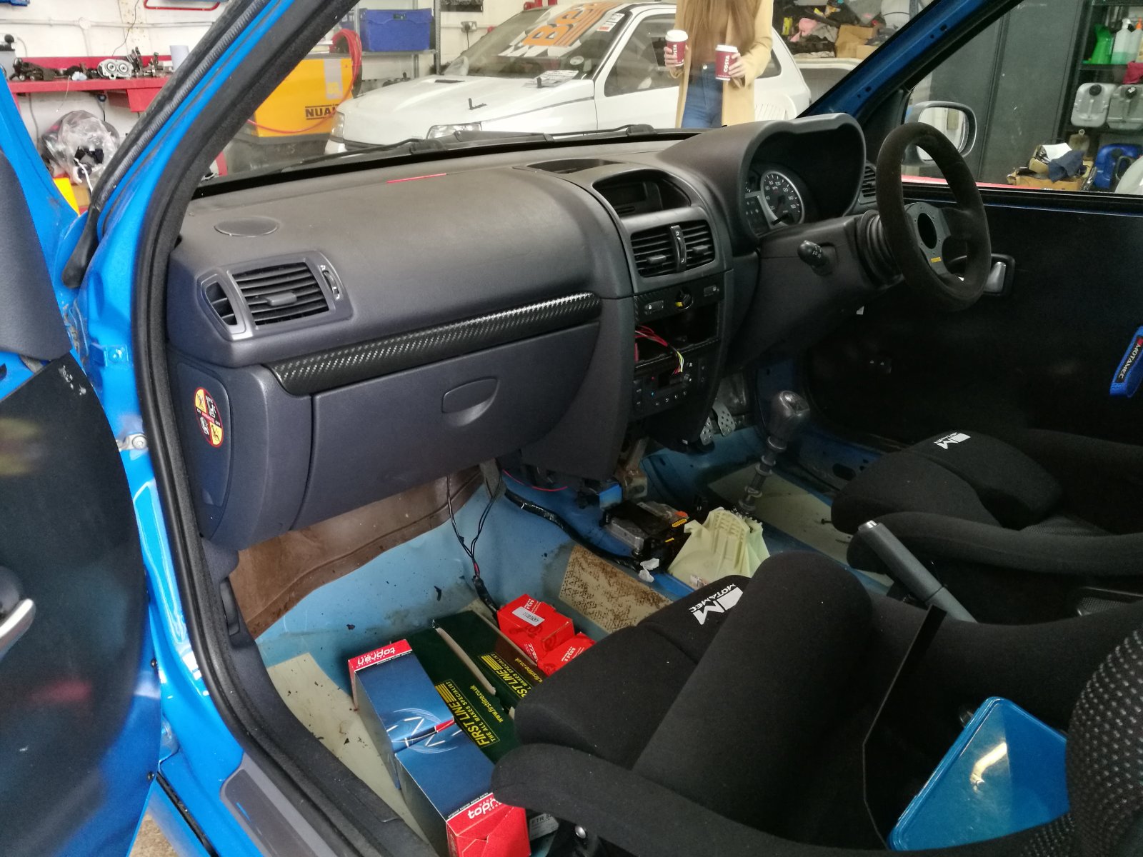

Update
We've finished the Epas conversion! Not managed to test it yet but we're confident it's all working correctly.
The dials had made are fitted, no picture yet of these installed as it's too dark inside the car currently.
But we did manage to find an alternator which meant we could refit the front end. amazing what a difference a front bumper makes!
Still lots of little tasks to do; Heat shield, Wires need tidying up, Air Filter, Aero catches.
Then Just need to book mapping and have the car detailed, then it's finished.. for now!

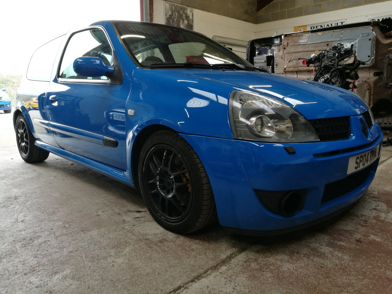

Update - Finished.
As it's been a while since I last updated this thread, November last year I believe.
The car had not moved since the last update until Valentines day this year, where I decided a great way to spend it with the other half would be following a recovery truck down to AW Motorworks.
Albeit a snowy horrible few days around then, the car made it safely. I had a comprehensive discussion with Alex about what it needed and anything he felt can be added. We basically gave the car to him in a state, it didn't run at all and hadn't been driven properly since August 19.

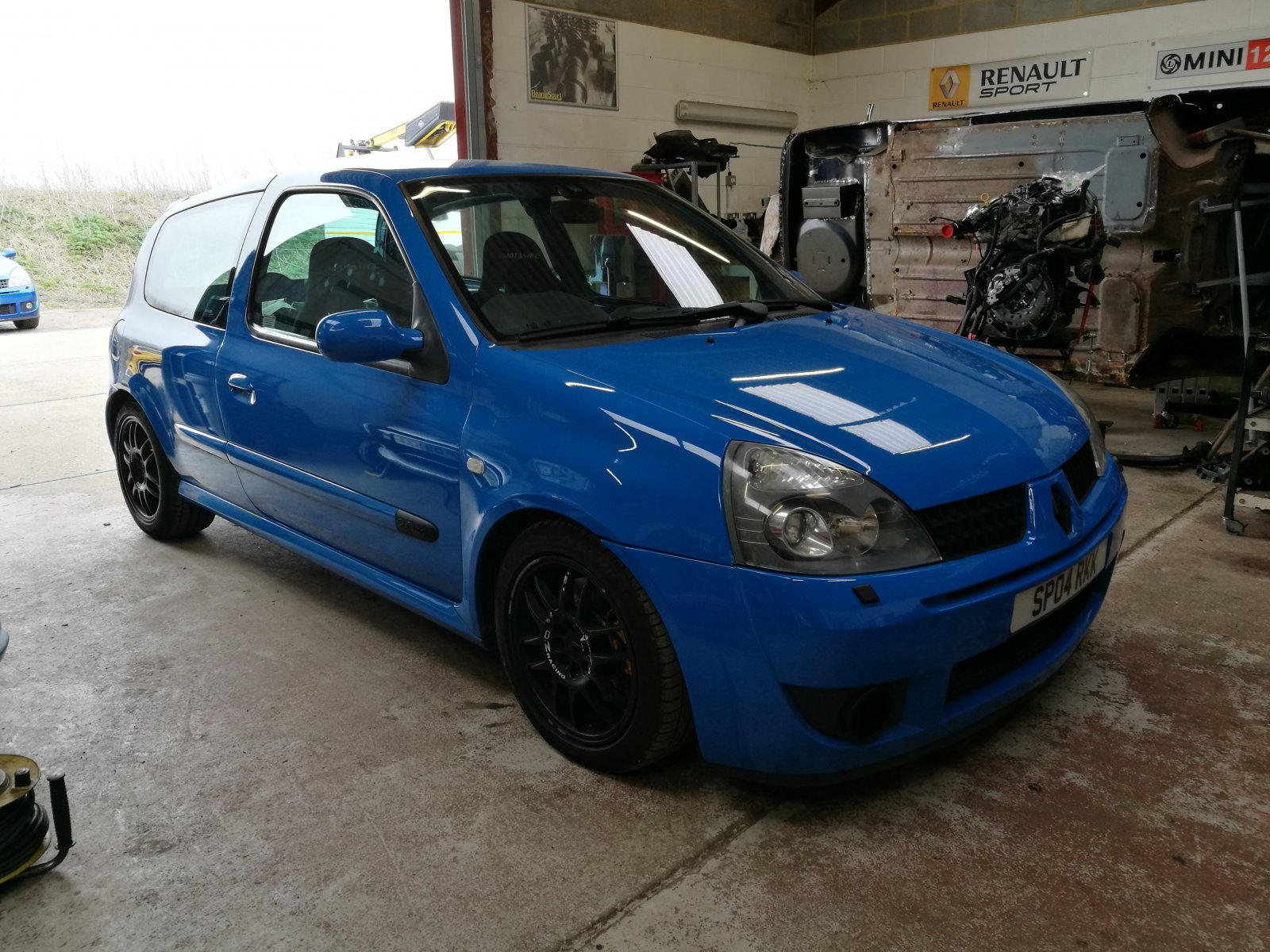

The main job was to finish the ITB setup and provide us with a turn key solution, so legally we can drive it home.
6 weeks later and we are planning on picking up the car Monday morning. It has had a lot of work done and made a healthy 202hp at ED on the rolling road.
Of course i'll grab plenty of videos and pictures over the next week or so, for now I have a couple Alex had sent me during the process. I'll write up a review on AW once I've had the car back as it's been flawless from start to finish!
Finally I'm not convinced at all on the new wheels now I've seen them a couple of times, so if anyone has anything they'd like to entertain swap with, please drop me a message.

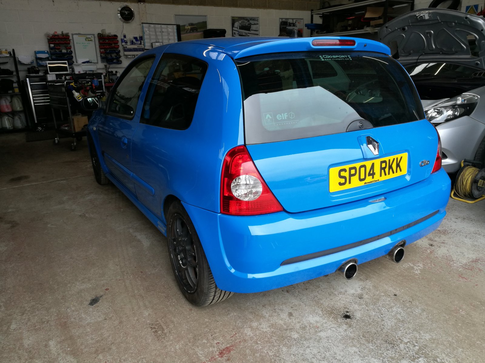

Couple more pictures from collection day at the weekend.
Alex has been brilliant as ever, really great handover and plenty of information to help us understand what's been done.
First time driven on the road again since 2019. Couple of pictures from the first petrol stop on the way home.

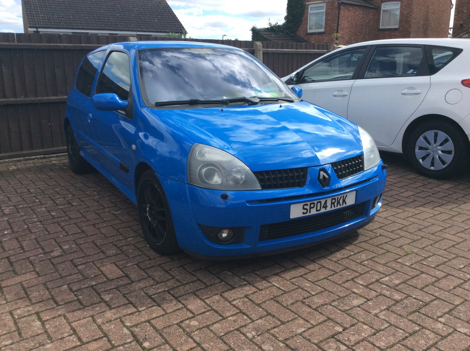

Update - Photoshoot
I spent a couple of days over the BH weekend last week cleaning the 182, it has not been cleaned inside for a very long time. The outside was treated to a full wash & dry, followed by a wax. I wasn't expecting much from the paintwork but I think it came up really well.
I'm still not convinced on the wheels yet, so if anyone would like the TD 1.2's in Anthracite. I'd be open to any exchanges.
I've taken the car to Bicester Scramble today which was a really great day.
I'm also on the look out for new fog light surrounds as mine are in a bad way. New headlights have been ordered which should freshen up the front.
Anyway, here's some pictures.

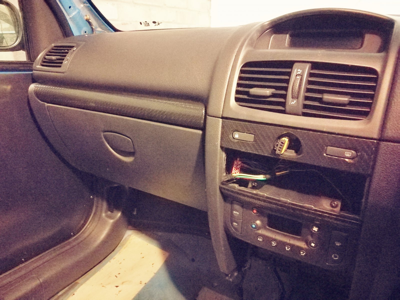

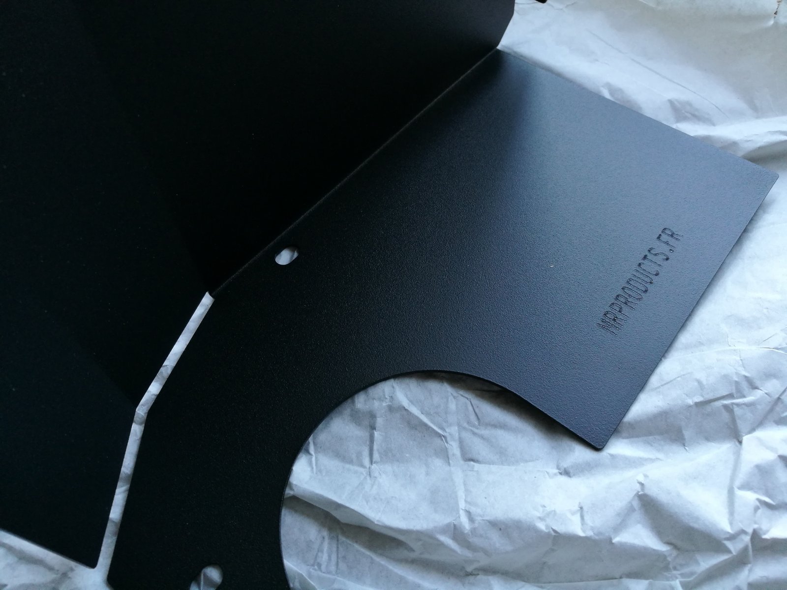

Looks great - assume no ill effects from removing the horrible shitty normal heat mat crap at the back of the engine bay long as you put something above the exhaust?

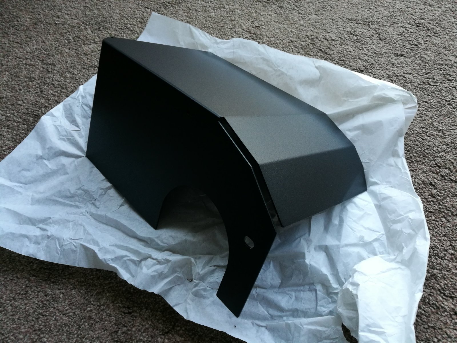

Yes mate, I've just put a 1.2 heat shield in place of the standard one after removing the air con. Then just a heat shield cut to size from Demon Tweeks.

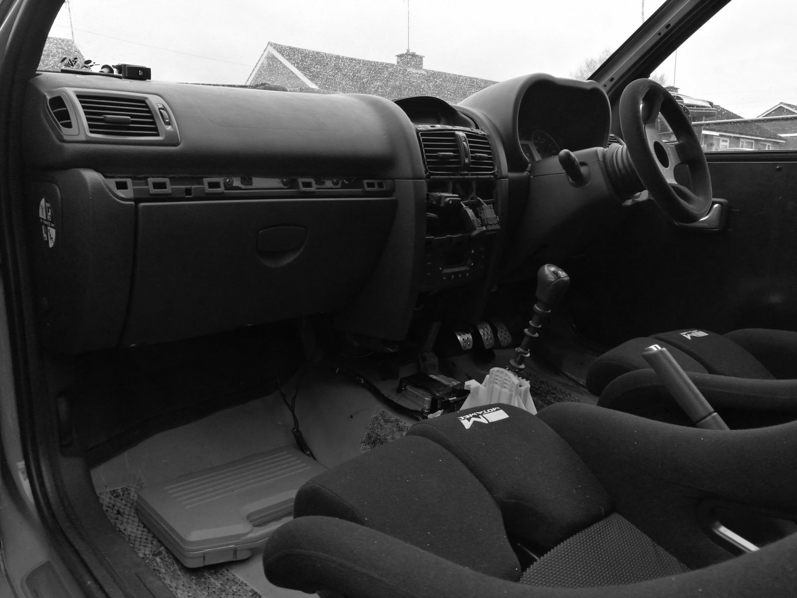

Update.

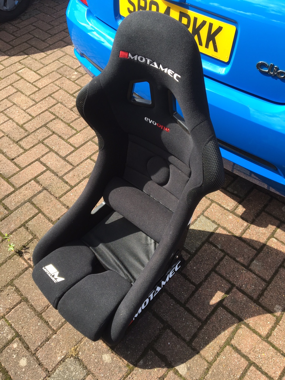

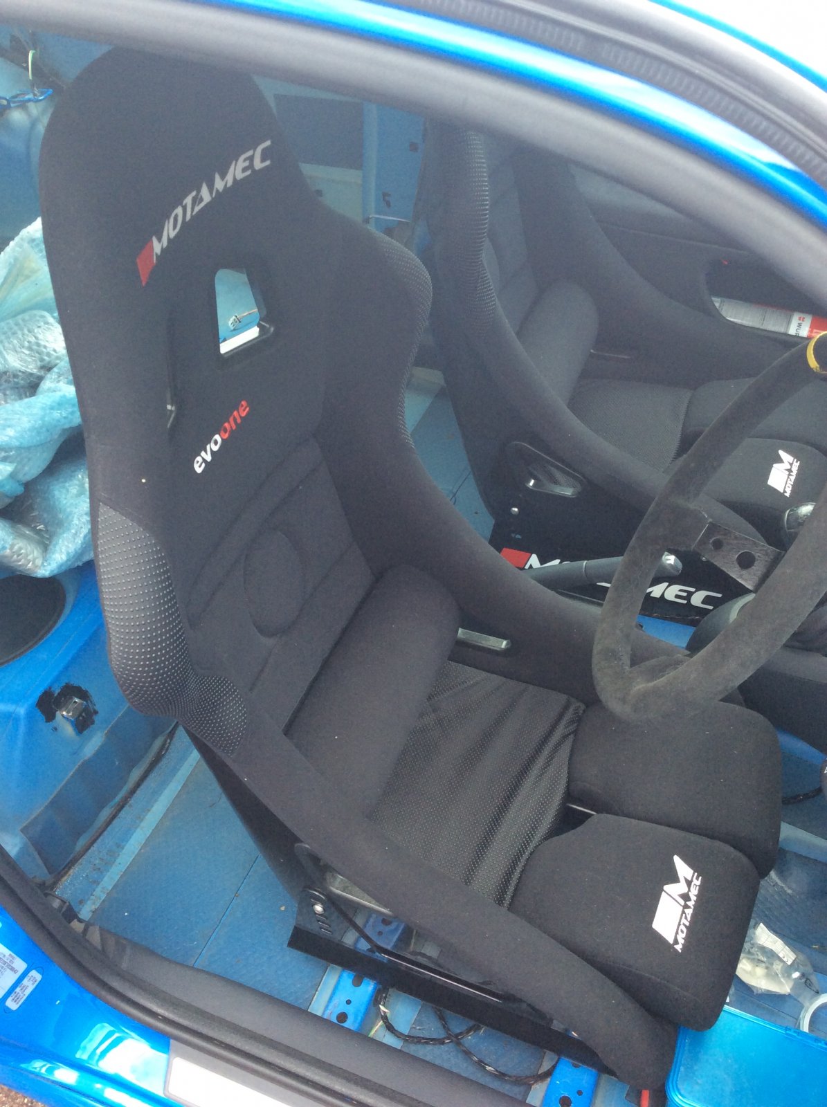

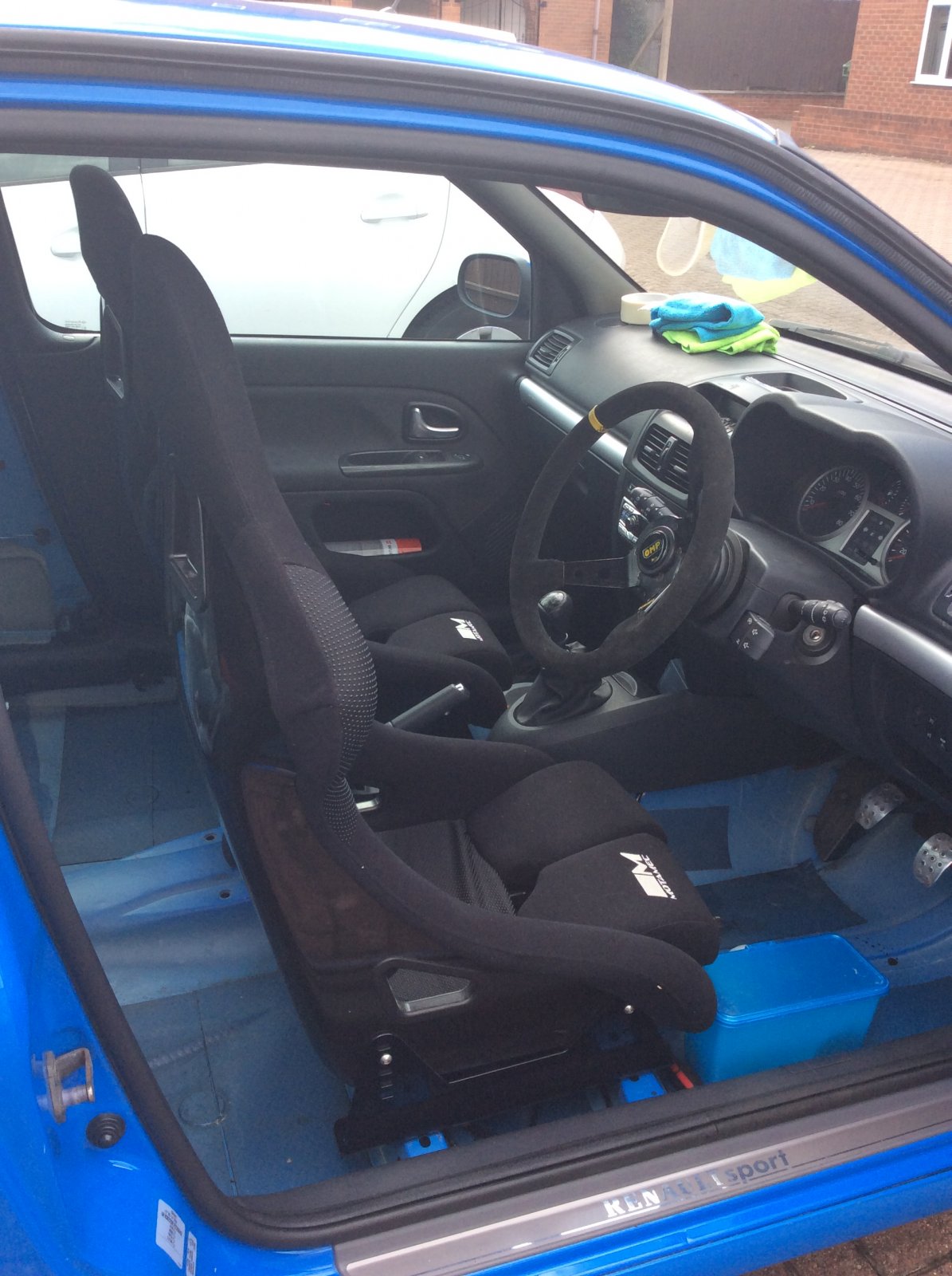

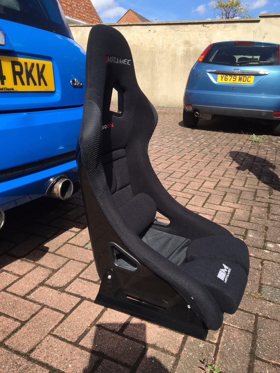

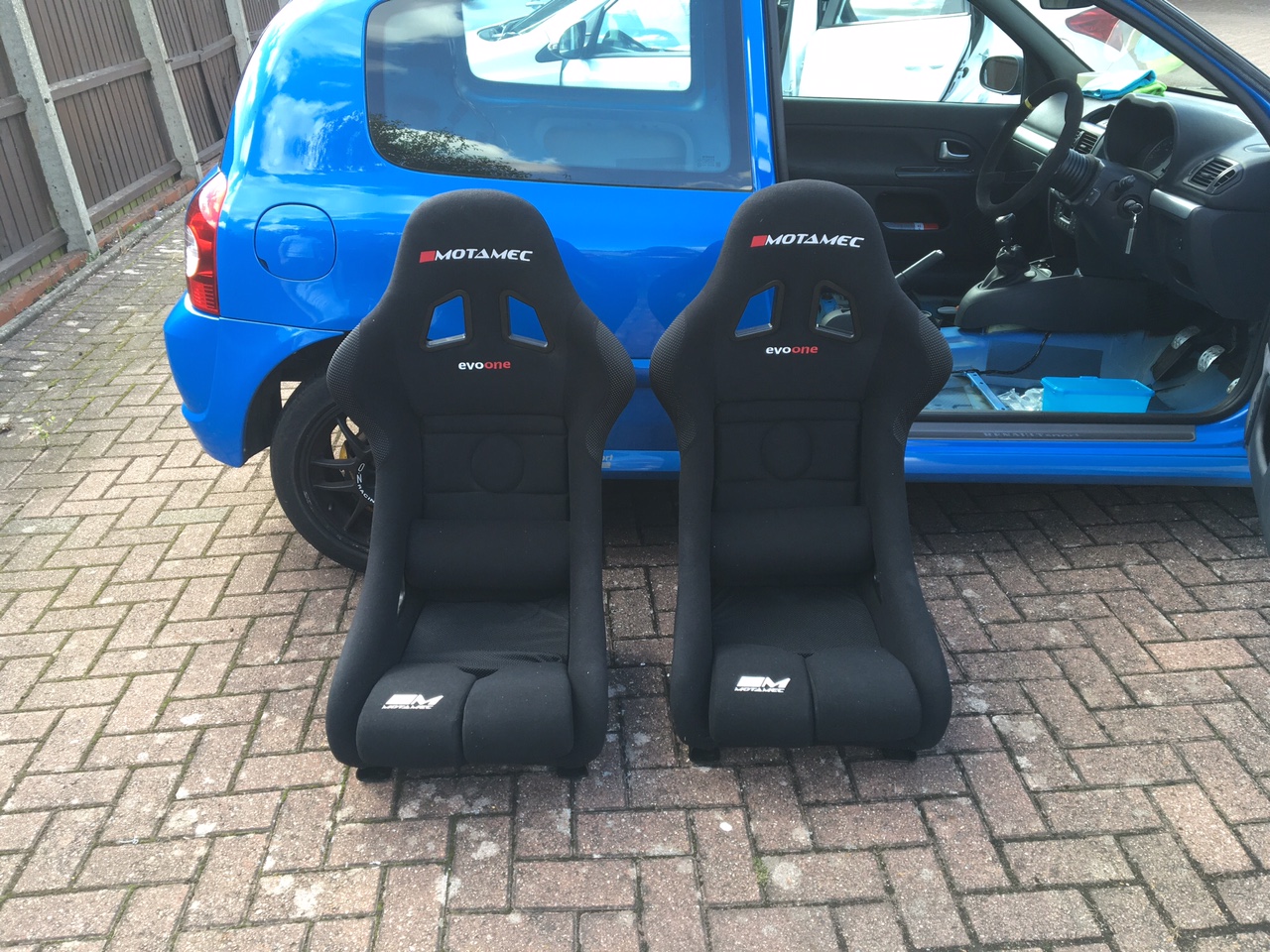

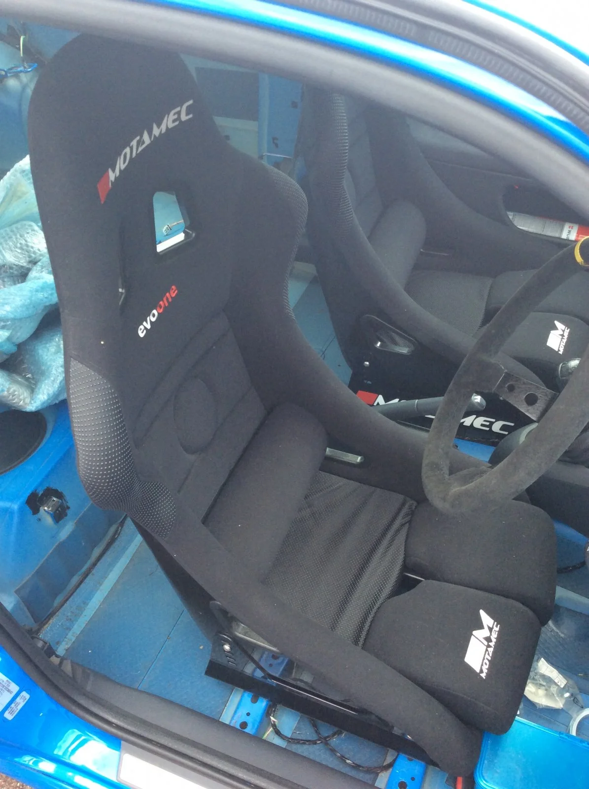

Nice positive update. New seats, it was my birthday on Friday and my partner surprised me with new seats as I was thinking of upgrading them to something a little bigger!
Also fitted a nice 'intercom' unit to the cage, as our helmets have the mic & aux feature. Makes sense to use this now.

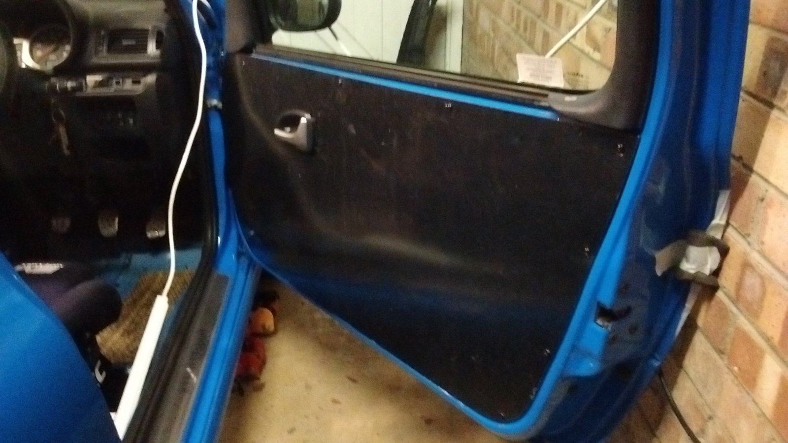

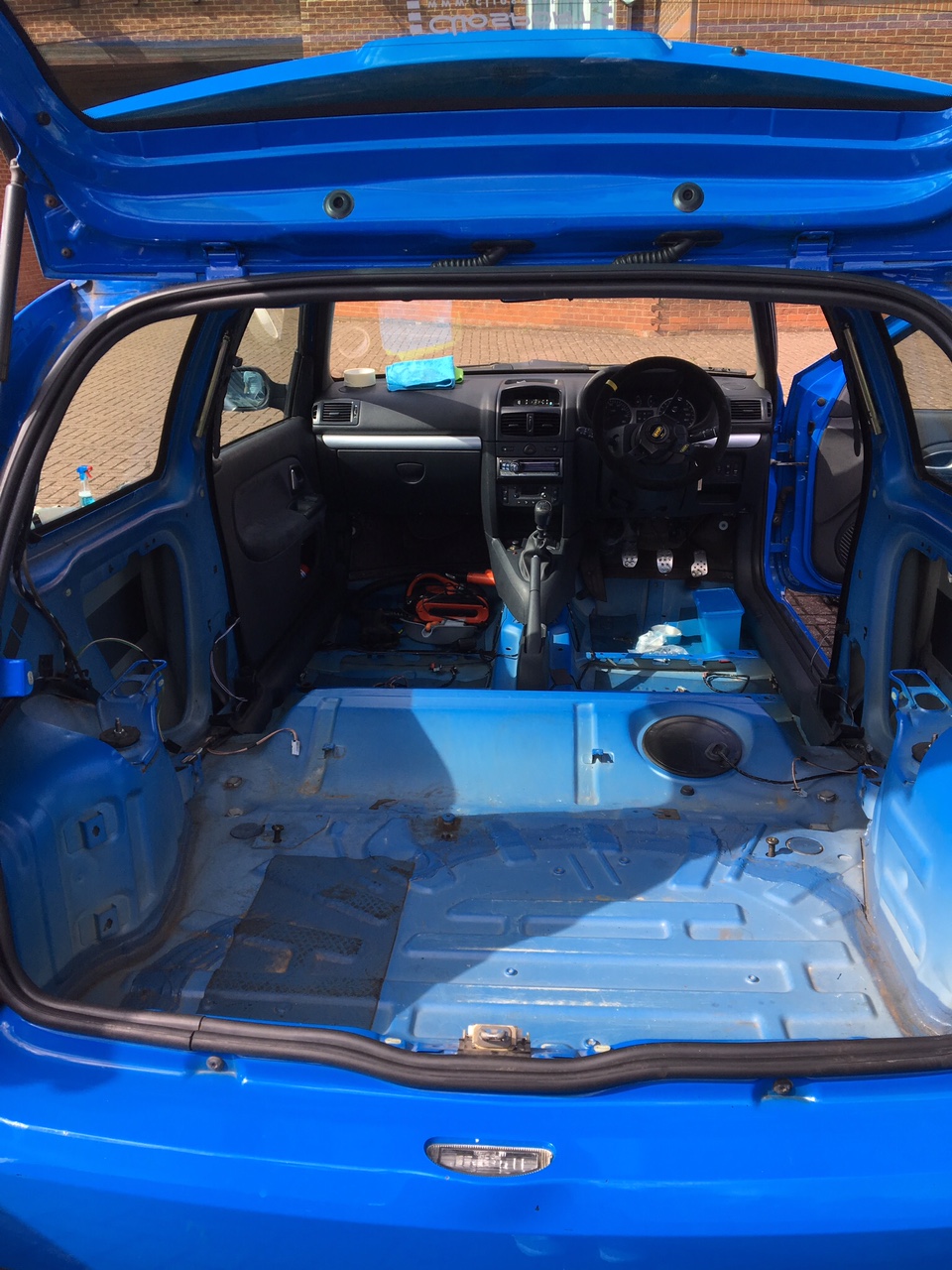

Update - Front End / False Floor
Following on from my update above I came across a company who specialise in building custom false floors for track/clubsport cars. Contact information for them is below;
HOME | JC Clubsport
They did a great job, as the white paint inside had quite badly worn over the last couple of years. The quotes to respray we're silly! So I dropped the car off with JC Clubsport on a Sunday and they did all the work same day. I think it finishes the interior really well. We also managed to fit fibreglass footwells which I didn't manage to capture.

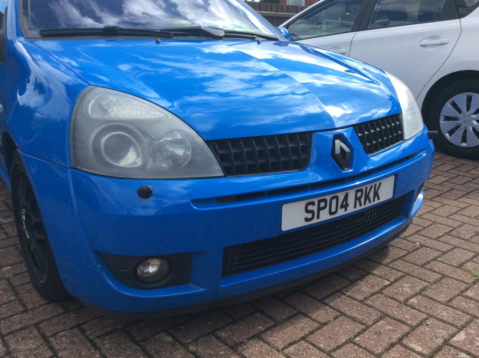

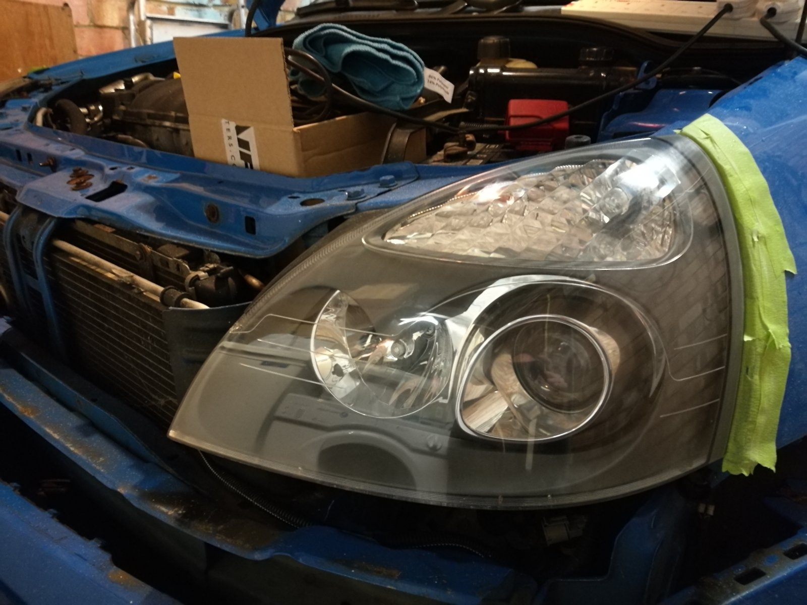

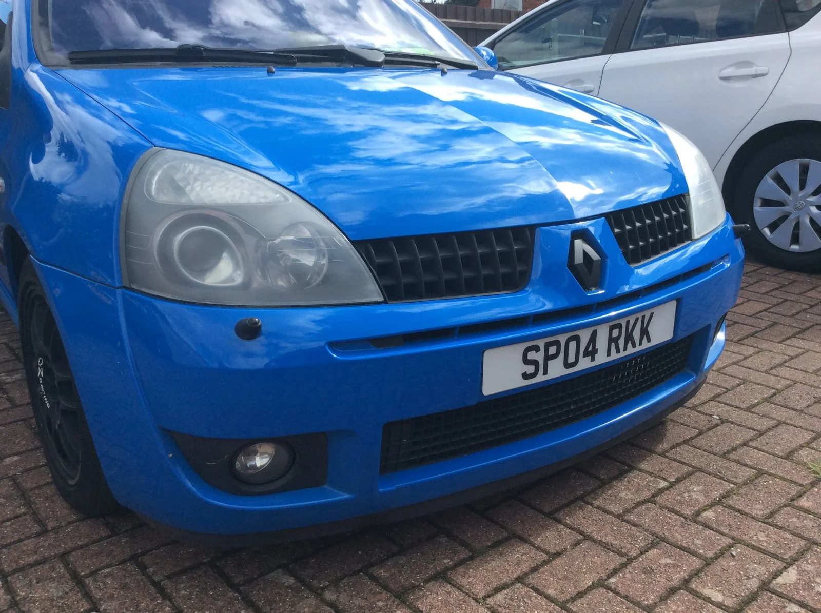

In terms of the front end, I had a new set of Depo Lights, Front Splitter and Fog Surrounds. Yesterday all of the above was fitted and I think the front now looks a lot cleaner and fresher.
Front End Refresh by ANDREW COLLINS, on Flickr
