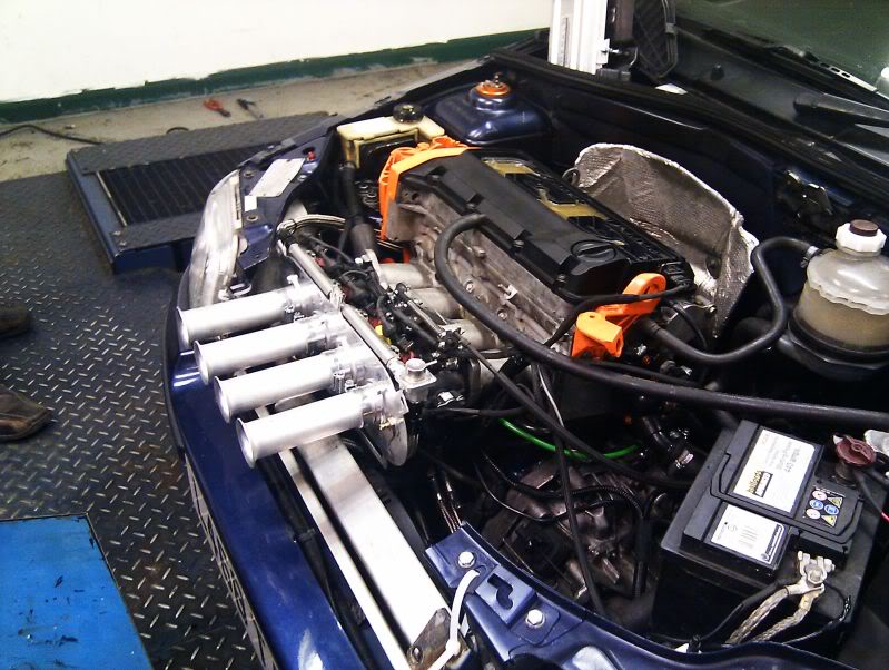

They don't make better power, they alter the torque curve. If you make big changes in length you see dramatic changes.
These for instance (yes that's right, adjustable length trumpets) made HUGE changes to the torque
