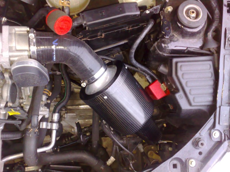

Job 1, speak to Andy at ITG regarding an RAB65 Airbox, these are basically of the Maxogen design but straight through, they are used in the Maxogen kits for other cars where the 90 degree airbox won't fit, after a good chat to Andy who is very helpful and knowlegable, I got one ordered, which arrived in 24 Hours (£150 delivered). This is the Aluminium version which is a few grammes heavier than the Carbon box, but well over £100 cheaper, and because it is smoother on the inside than the carbon one, it should in theory be better.

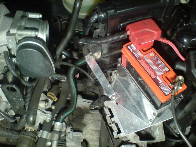

Job 2, Spec and Order new battery, Odyssey PC680, £78 delivered from e-bay.
Job 3, Build custom battery tray, using existing bolt holes in the original battery area so no drilling required.
Job 4, make ECU brace, the old one had to go to make room for the new airbox, again I used existing mounting points.

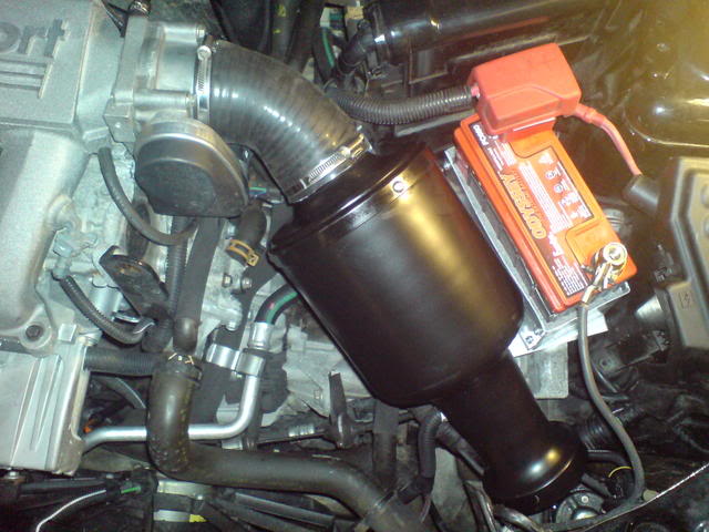

Job 5, mount airbox, cut 45 degree bend (£21 delivered) to size, and insert bits of rubber, from an old bonnet seal, onto the bits of the engine bay which may foul the airbox, also whack a breather filter on (the plan is to get a catch tank in time)
I've done this in stages over the last couple of weeks, and only managed to get the airbox in tonight, so I've only had a quick spin in the sleet, however initially I'm very happy with the result, I can't say if its any faster or any of that, but it does sound much better, though not quite as loud as my first Maxogen.

Lookin cool... erm hate to burst your bubble on the Ali theory but the Ali one will be the same heat as your engine bay = hotter inlet temps resulting in possible less power.. the Carbon has i high resistance against heat so therefore you would be taking in cooler temps to the block = more power/sharper engine response but since you now have got shot of the 90 bend the response should be nice ;)
how do you find the battery? had any problems with it? fitting one to the track car soon.

I spoke to Andy about the heat issues, and he assured me it would make no difference, remember there's lots of cool air rushing through there very fast. He could have tried to sell me the more expensive option on that issue, but said there was no point.
As for the battery, I'm using it day to day with no problems, but I've just invested in a charger / conditioner for days when the car is sitting in the garage, just to keep it in good condition.

great job ! Where did you lead the breather filter thingy to ? Down below ? (for smell?)
The breather filter it just tucked somewhere behind the ECU at the minute, I've not really done enough miles yet to notice the smell but its still on the standard pipe so not much to play with. It will probably be like this for a week or so, until I've raised another £20 for a catch tank.

On the issue of heat, I checked the airbox temp by touch today after my commute home: 30 mile drive with the last 5 miles stop starting in traffic and generally pootling along at 30Mph, so quite low airflow and the airbox was surprisingly cold, even colder that ambient.

The sillicon elbow to the TB, was this not 76mm ? And did you have to move/modify your ecu bracket to be able to fit it all ?
The elbow on mine is 70mm internal diameter, it fits perfectl. I didn't have to move my ECU bracket, I just used the new brace to push the ECU back slightly, the top left hand corner sits about 10mm further back than it did originally.
