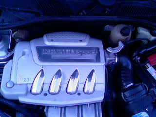

Ive given in and joined the polishing gang.....
  VRS
still gutted from the badger incident so started some polishing of the insides seeing as the outside is battered lol
got the main bits done but will have to concentrate on the finer scratches when ive done the plenham as well :D
btw i know what guys and carbon were on about with the sore fingers! mine are aching like a mofo :clown:

any tips on getting the mirror finish? used the grades of wet and dry and then autosol followed by super resin but aint anywhere near mirror yet!!!
quite happy tho, took just 3 hours for this finish and already looks way better than standard

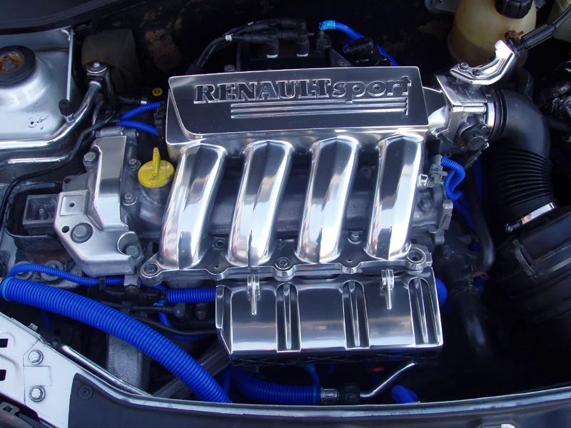

you want to use the wet and dry, wet (if not already), use the 400 grade for ages to get the little scratches out, then as you have been doing going down the grades and use 1200 or 1500 for ages too.
when using the autosol keep rubbing the polish in until it is rubbed in and then using a clean or different part of the cloth RUB HARD putting alot of pressure on the metal and it should come up mirror like!!
it should look like this

hats off to you rich.. that looks mint. must have took hours and been very painful
was bad enough for me just doing the 4 tubes..

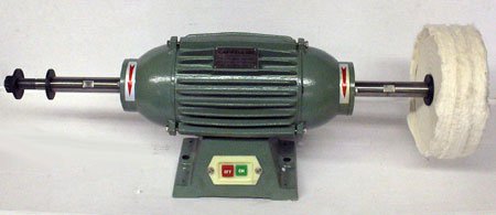

IMO, it is best to use sandpaper for smoothing out the subject, use no powertools here, as they do remove quite a lot material!!!!
But for the polisihing part, you can benefit from using a fixed electric motor/grinder, and a cloth pad like pictured!!! Also you will need a bar of hard wax, this will give you an ultra mirro finish!!! Afterwards you can remove the rest of the wax with autosol!!! You could get an extra cloth pad for this!!!
Motor with clothpad
Different types of wax!!
Check out:
http://www.caswellplating.com/buffs/index.html
Motor with clothpad
Check out:
ive got one in my garage..
its too harsh on the soft alloy IMO..
did more damage than good.. put in loads of scratches. had to go back to 240 grit and start again to get them all out.
i used a flap wheel on a drill to remove the majority of the 'grain' on the inlet tubes though, but have to be very careful with these..
