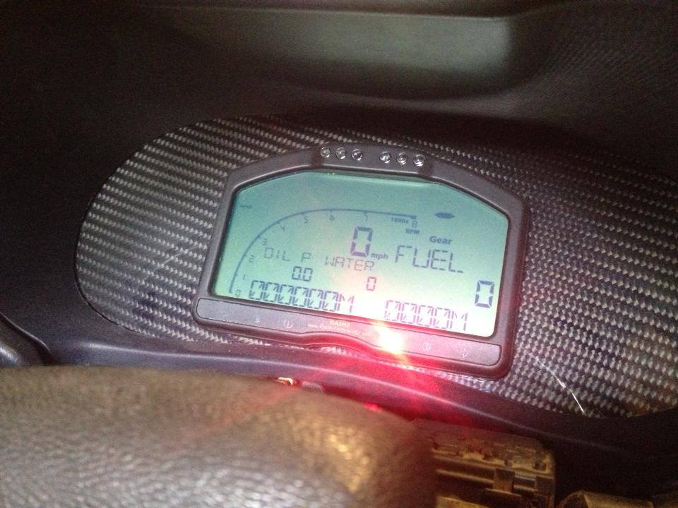

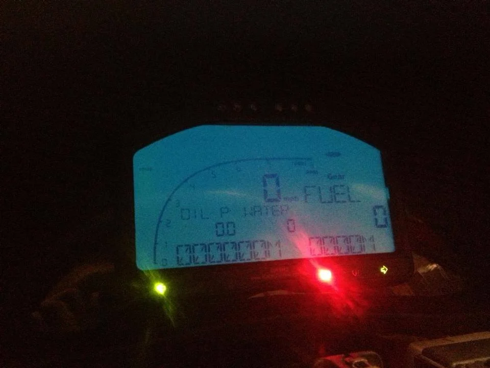

My Slap-dash was then refitted :)

Just waiting on a few fuses/relays i believe and basemap (and dash2 output enabled) my friend is putting together for me.

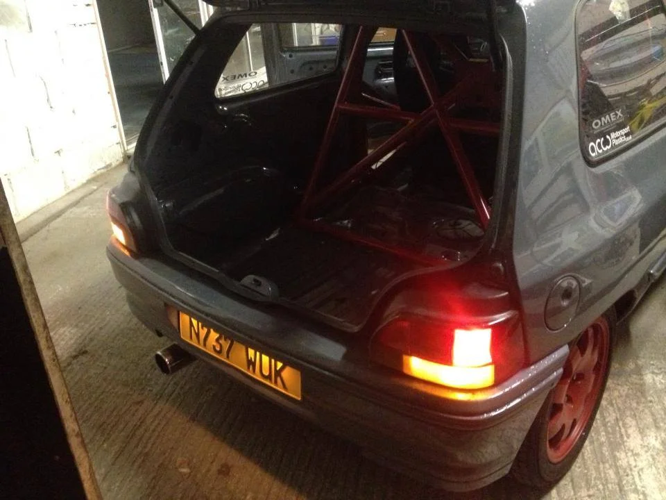

win! love it chap and really cant wait to see it out and about, so cant imagine what your feeling like now!

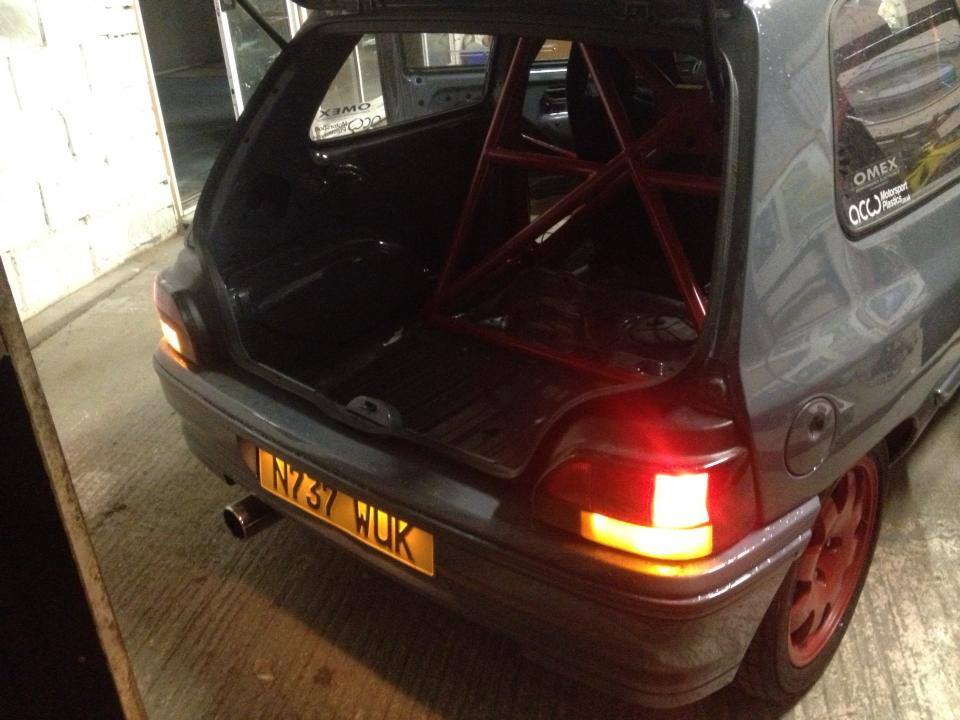

reckon in the event of rolling it that cage will be okay.......I reckon there is more room for metal.......................lolz! :)

was a miscommunication with the body shop lol

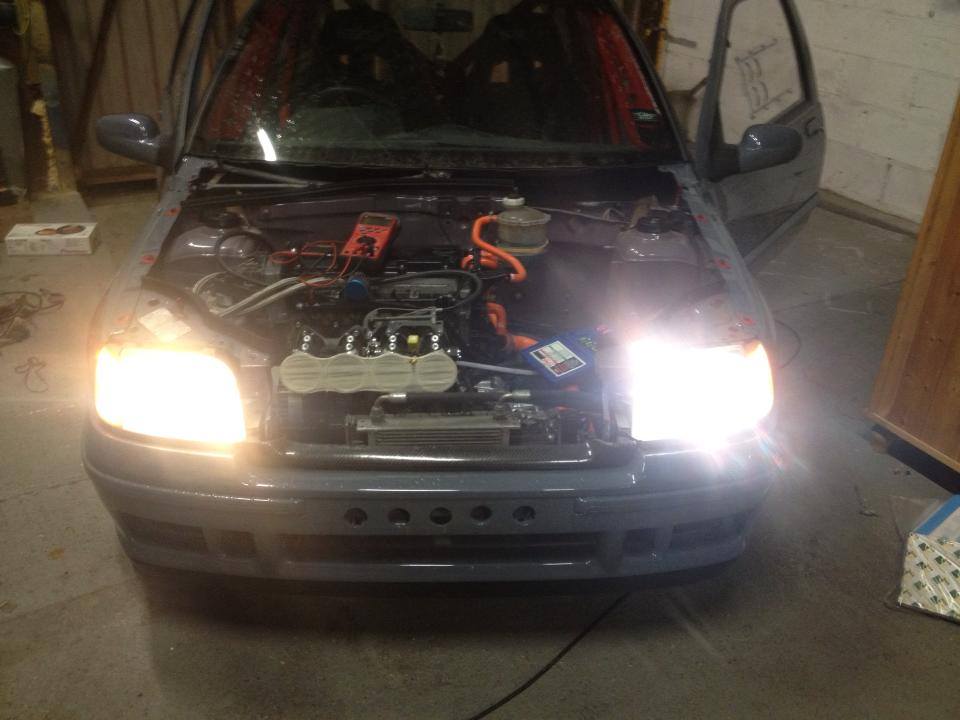

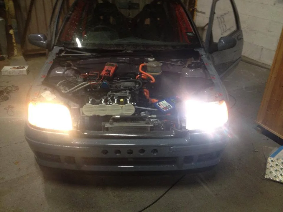

electrics now flowing!

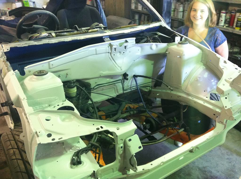

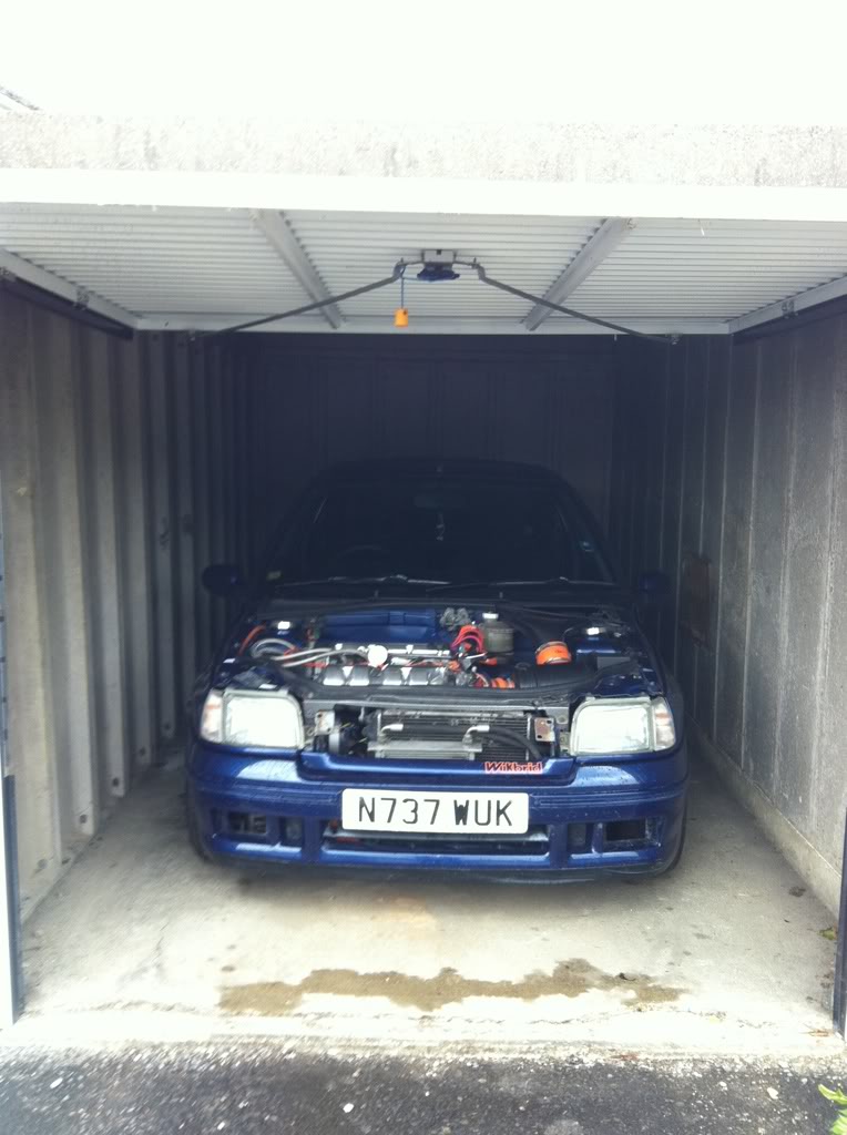

Stage one..... find a garage i can strip the car in
made a phonecall at lunch time by dinner time i had one
sorted!

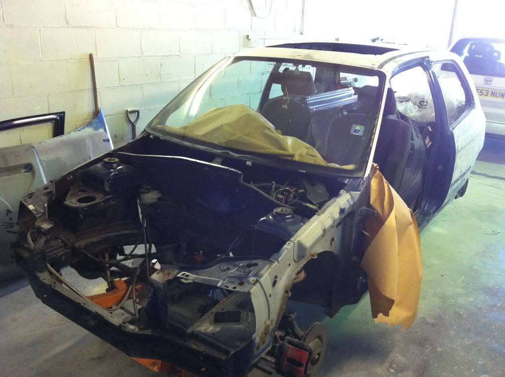

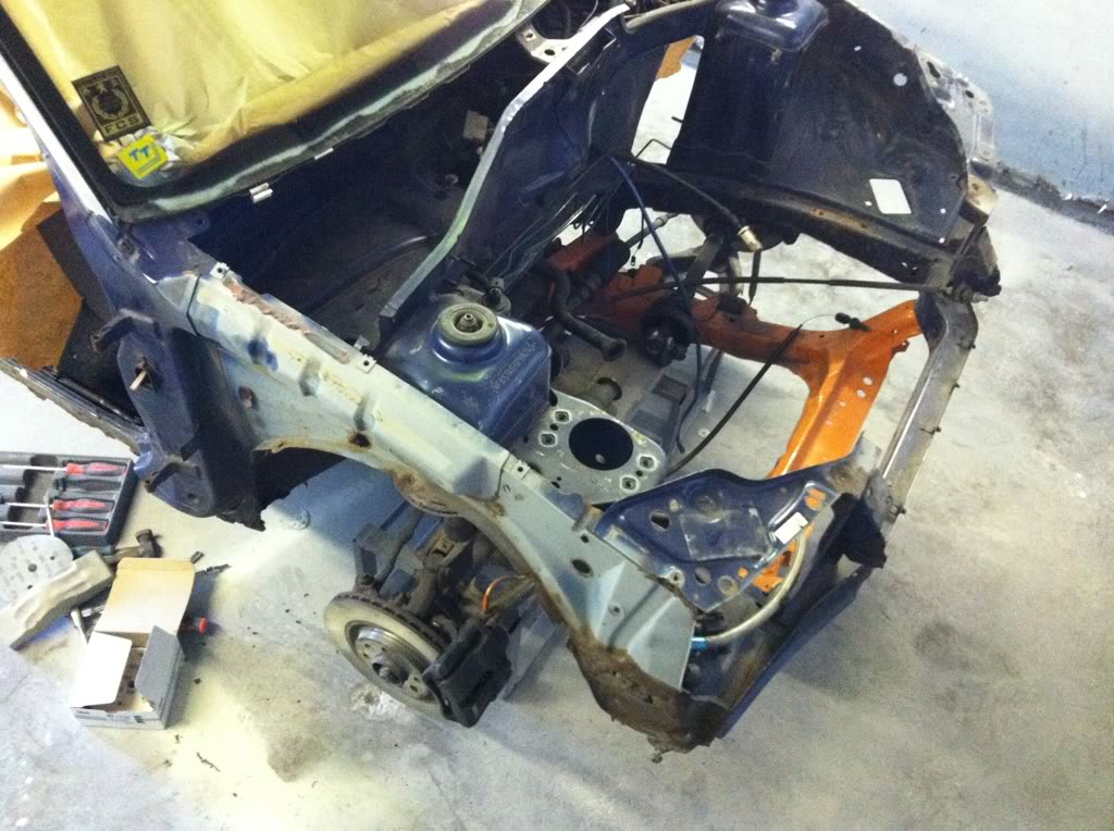

Moved the car into her and removed the bonnet!
then removed the wings bumper, wipers, head lights,skuttle pannel
then out came the wiper linkage and internal fan makeup and the washer bottle and the old OEM alarm (that i didnt know i had)

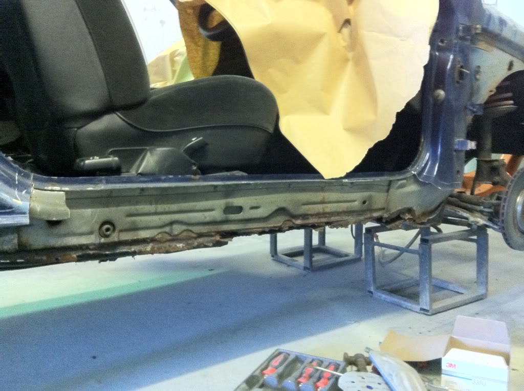

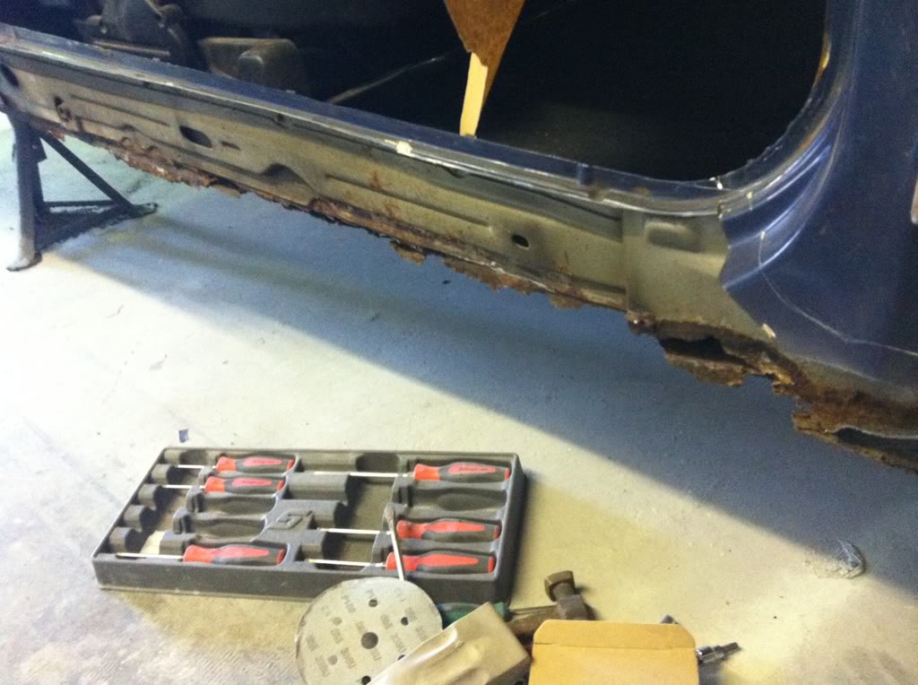

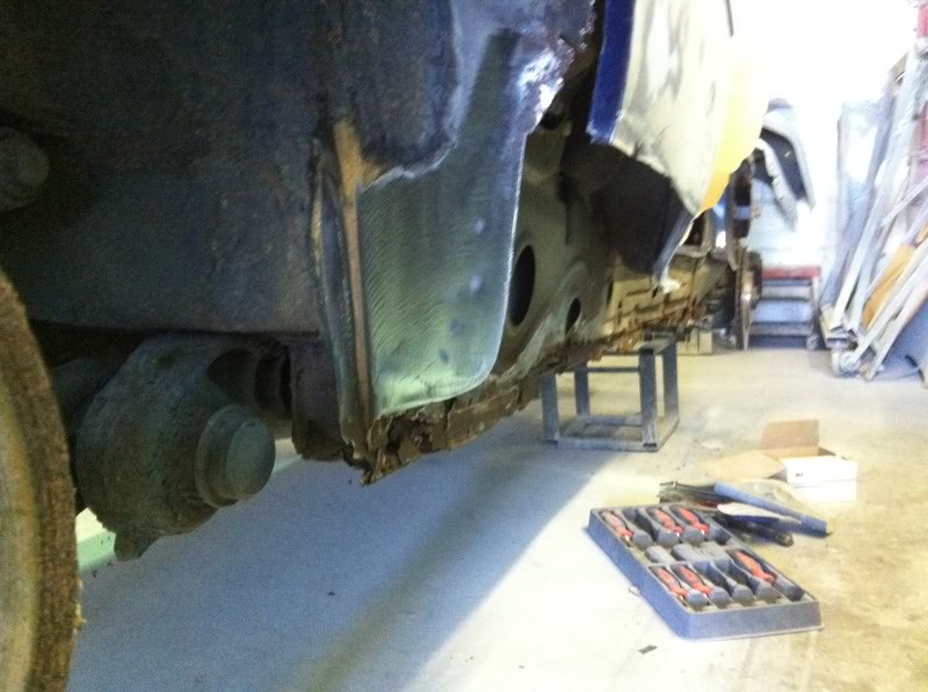

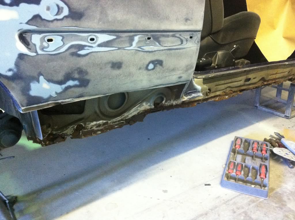

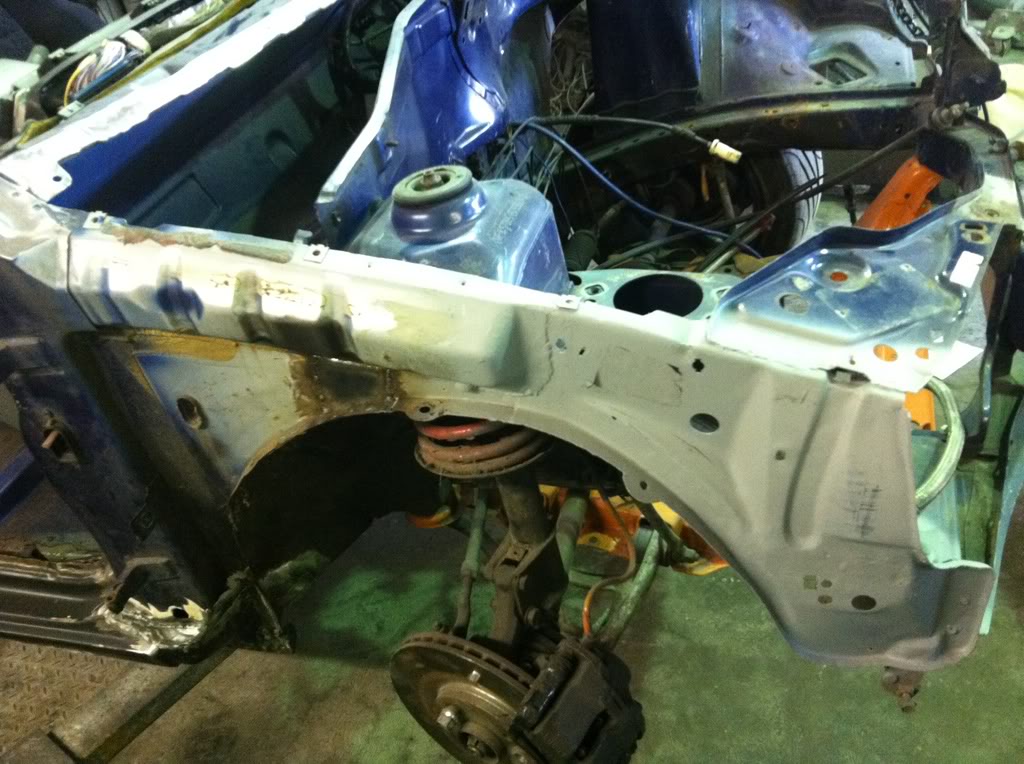

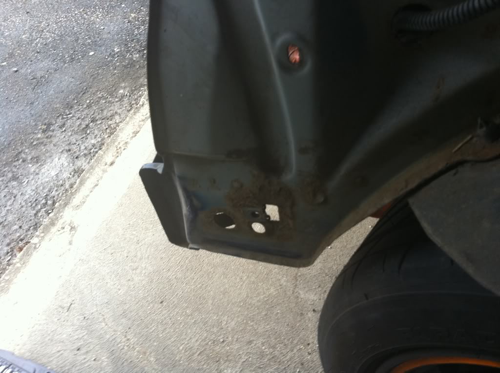

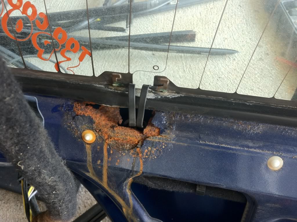

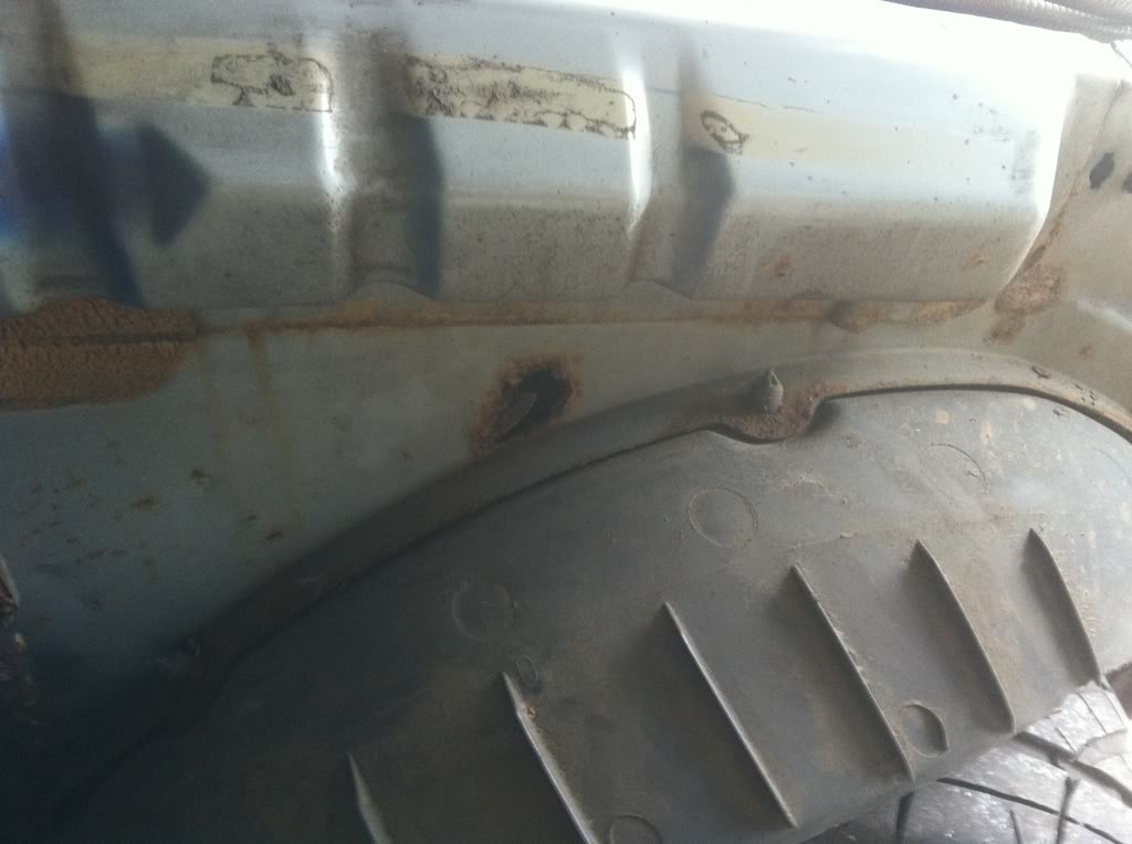

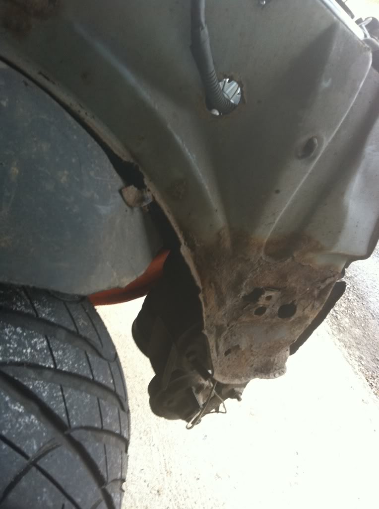

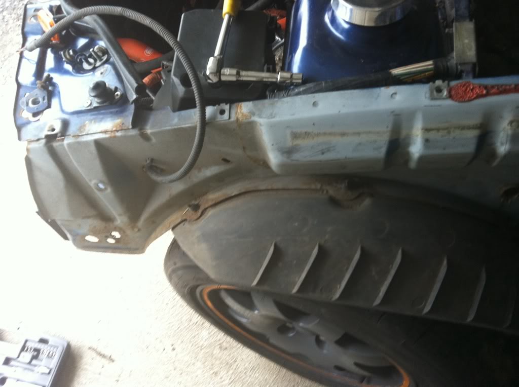

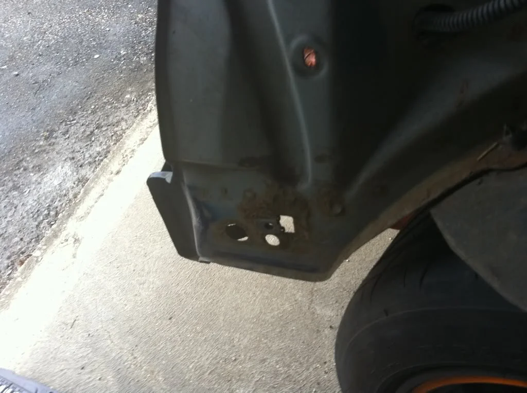

obviously i would be a fool not to expect some rust... soo here are the bad bits

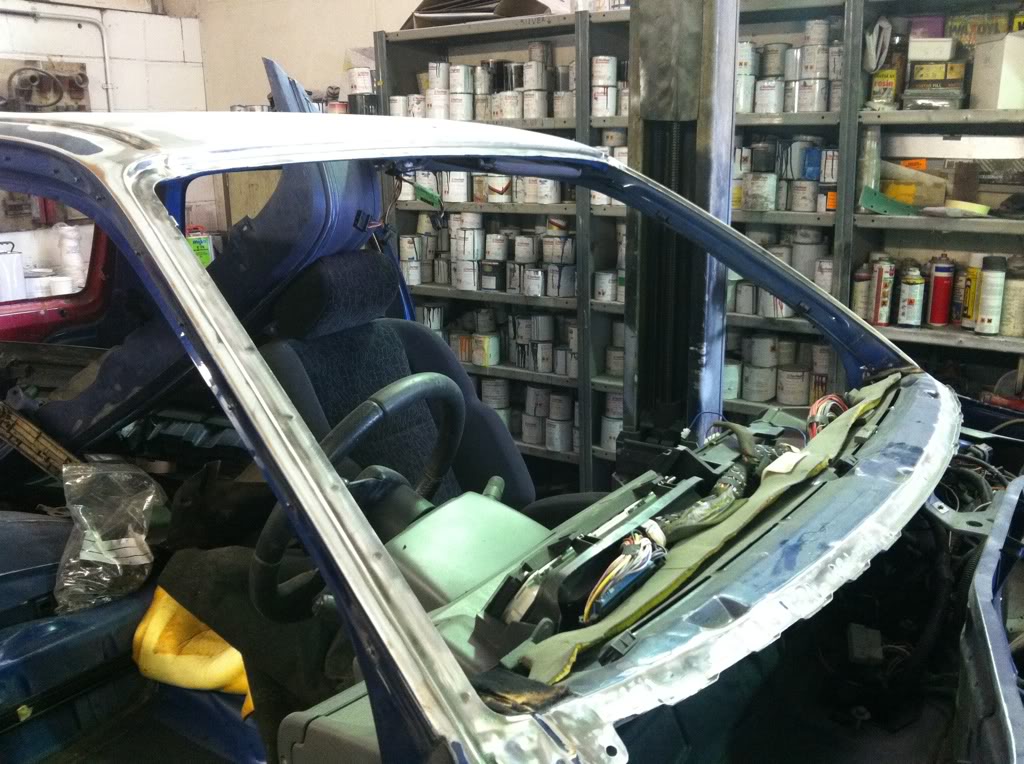

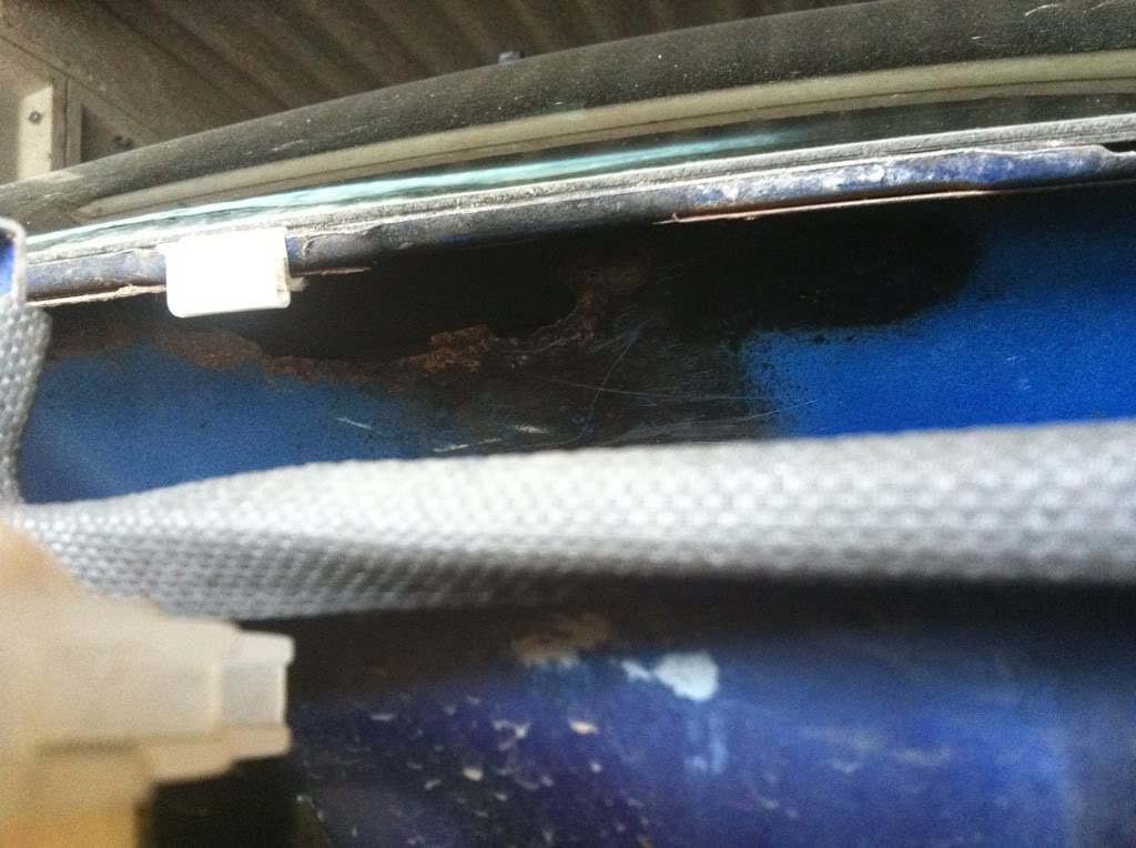

and the bit that looks like its going to need the windscreen removing to repair...fail....
what i dont get though is one side of the car is rusty... the other side (passenger side) has light surface rust....
and now she is looking like this... will keep you all informed day by day

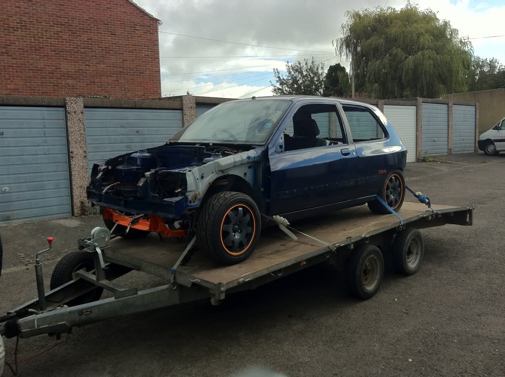

Ok off she goes to the bodyshop! Proceeded to discuss bonnet fit ment with aero catches then remembered I forgot to take it lol

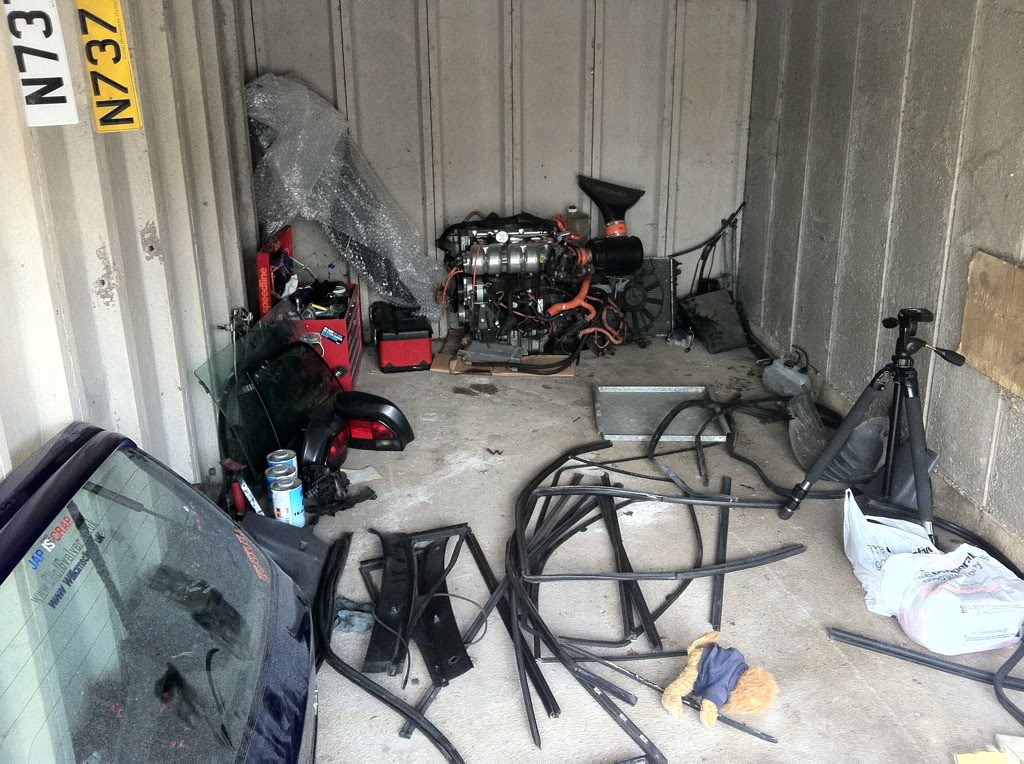

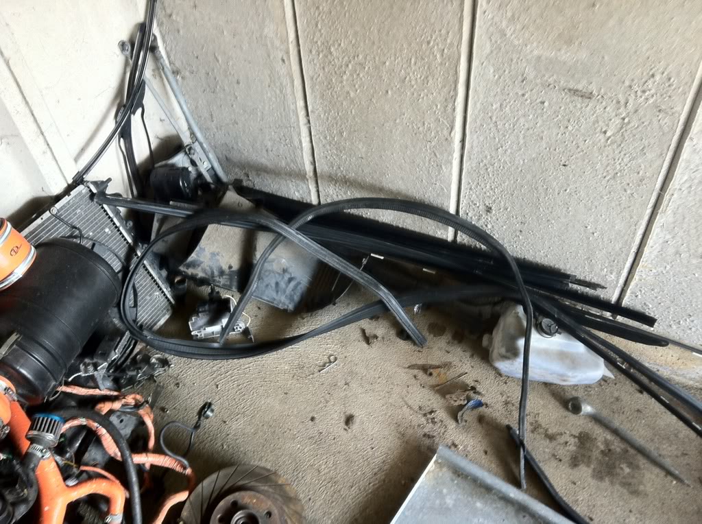

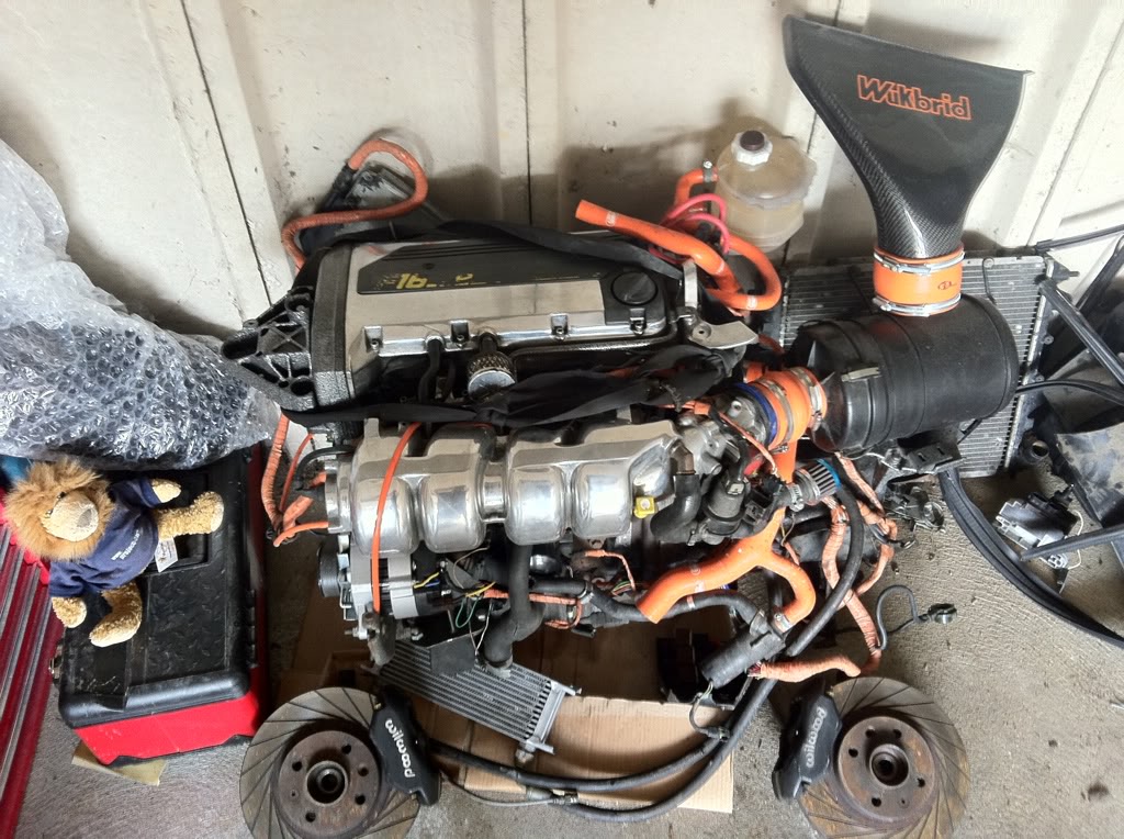

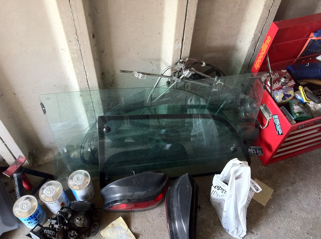

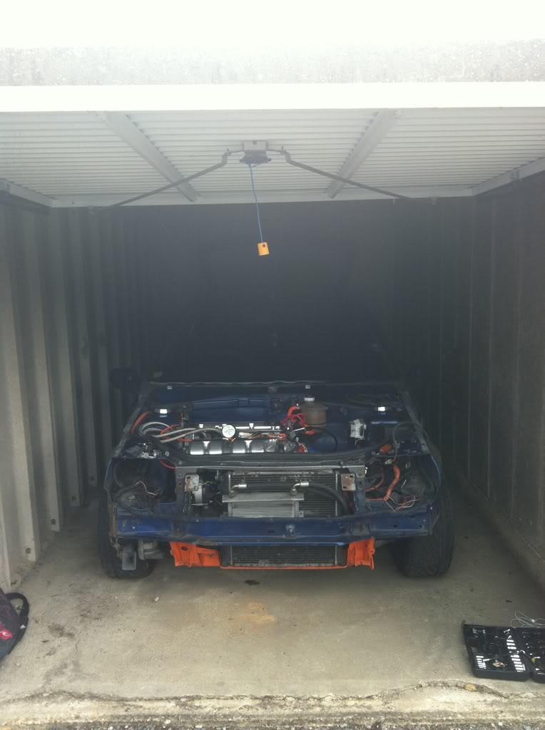

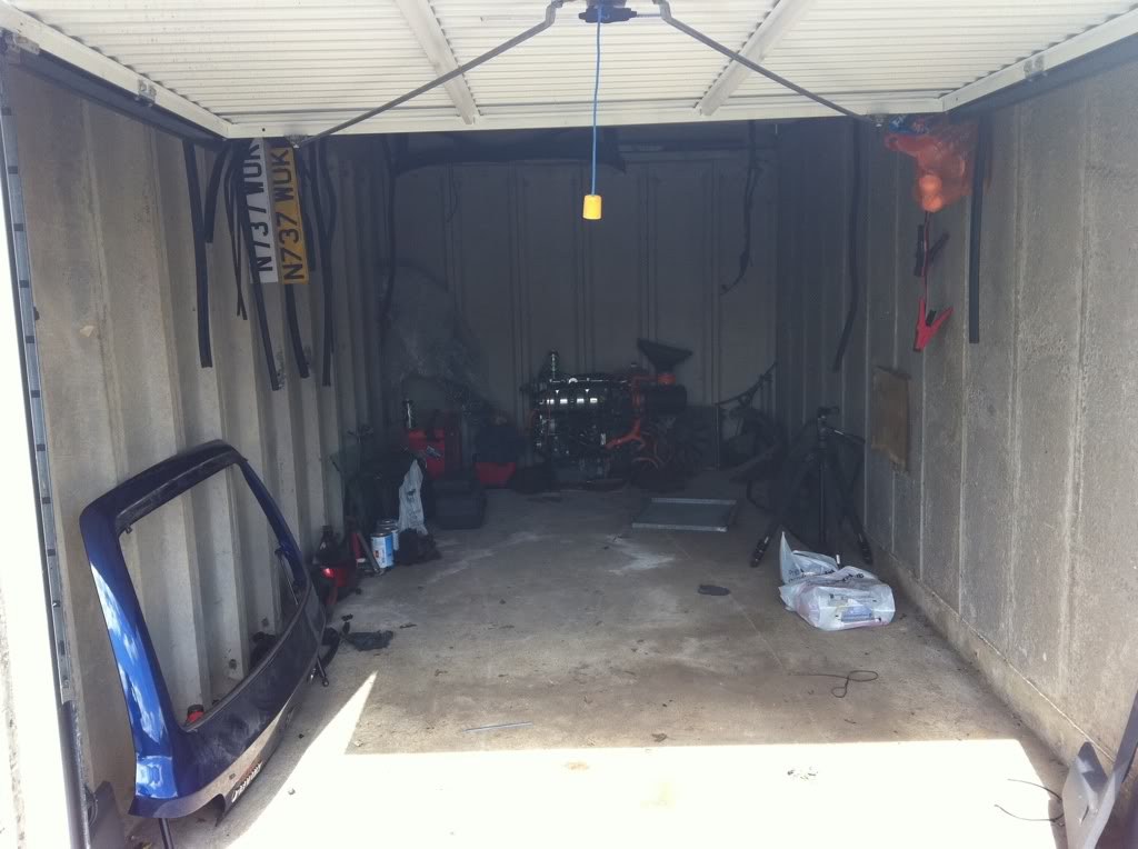

just a few shots of my very empty garage

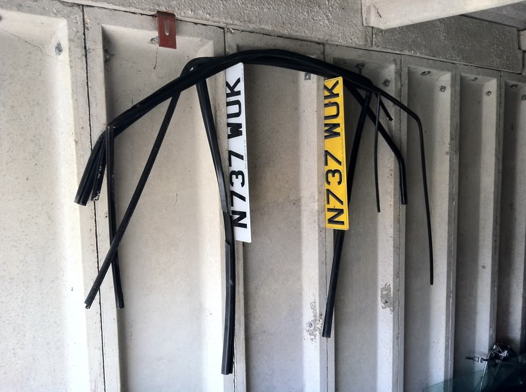

Rubber everywhere
Why I needed a new boot!
Just waiting for her new and improoved home!
Rubbers arranged
Glass no longer required

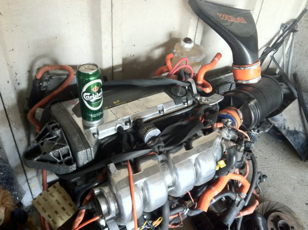

Carlsburg don't make engines....
All organised just waiting for new and improved shell

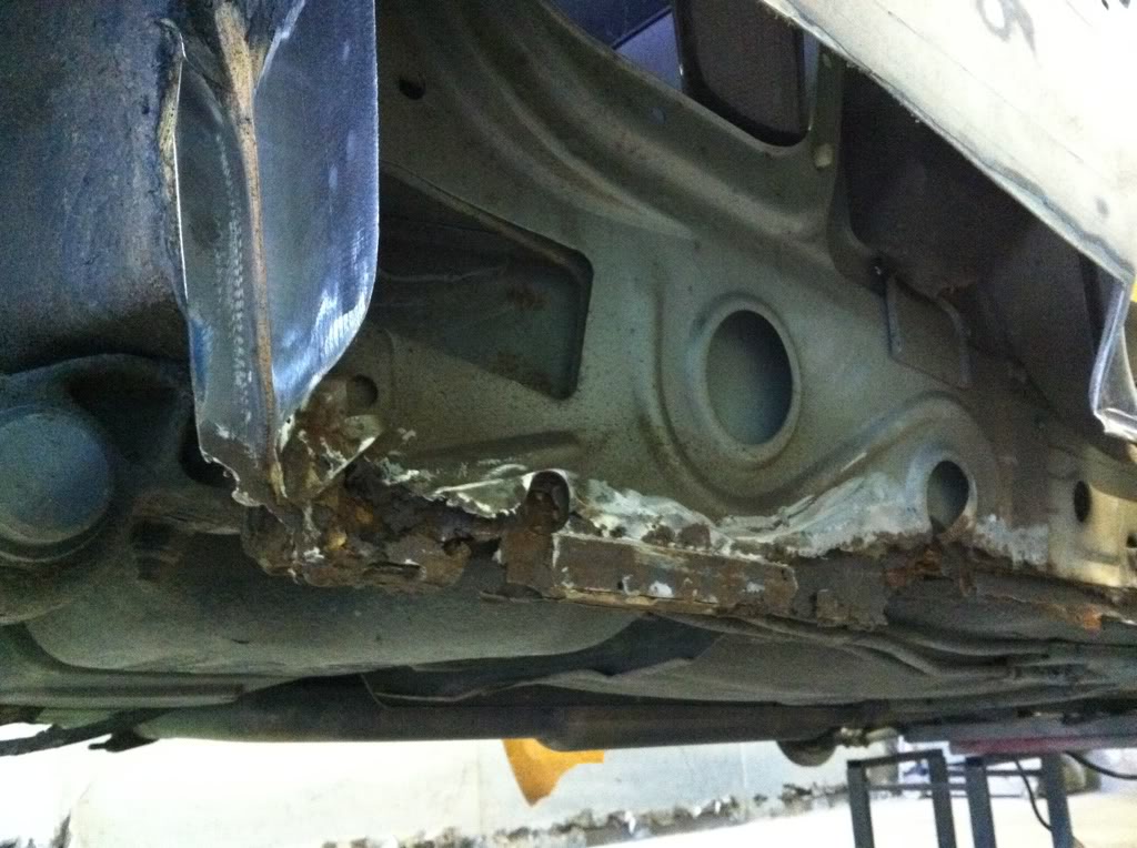

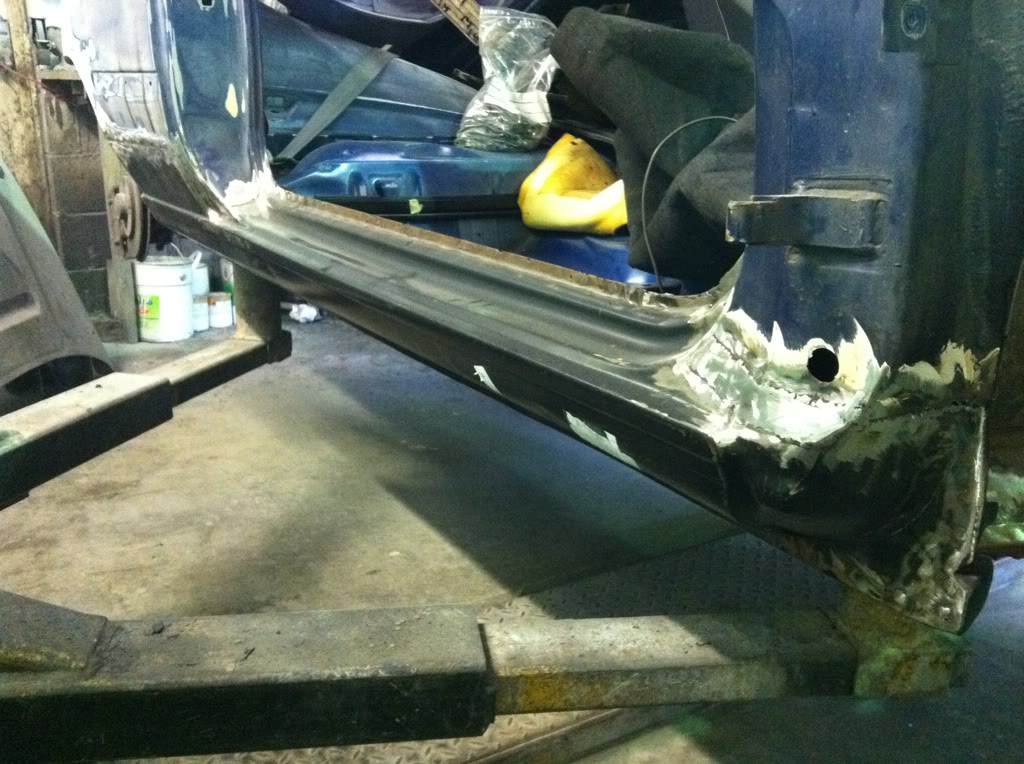

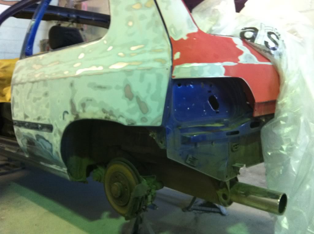

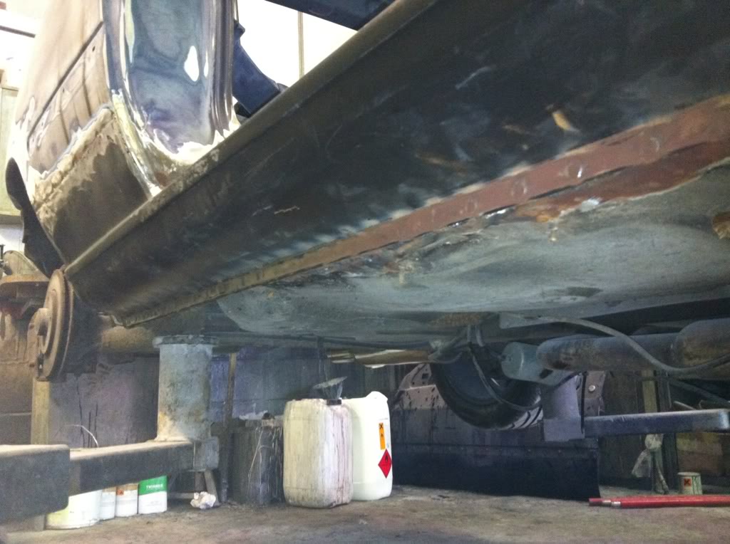

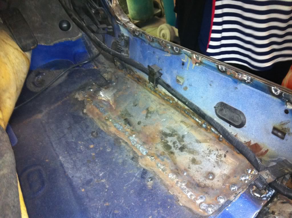

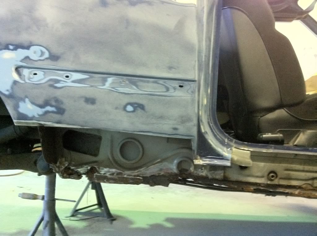

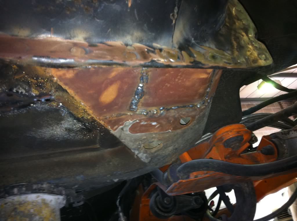

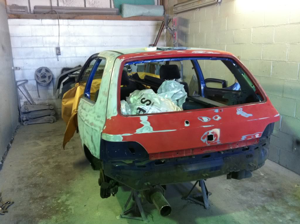

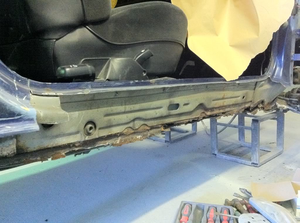

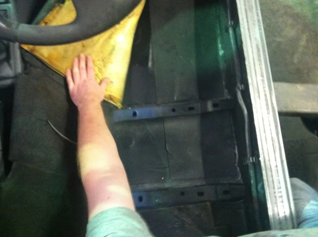

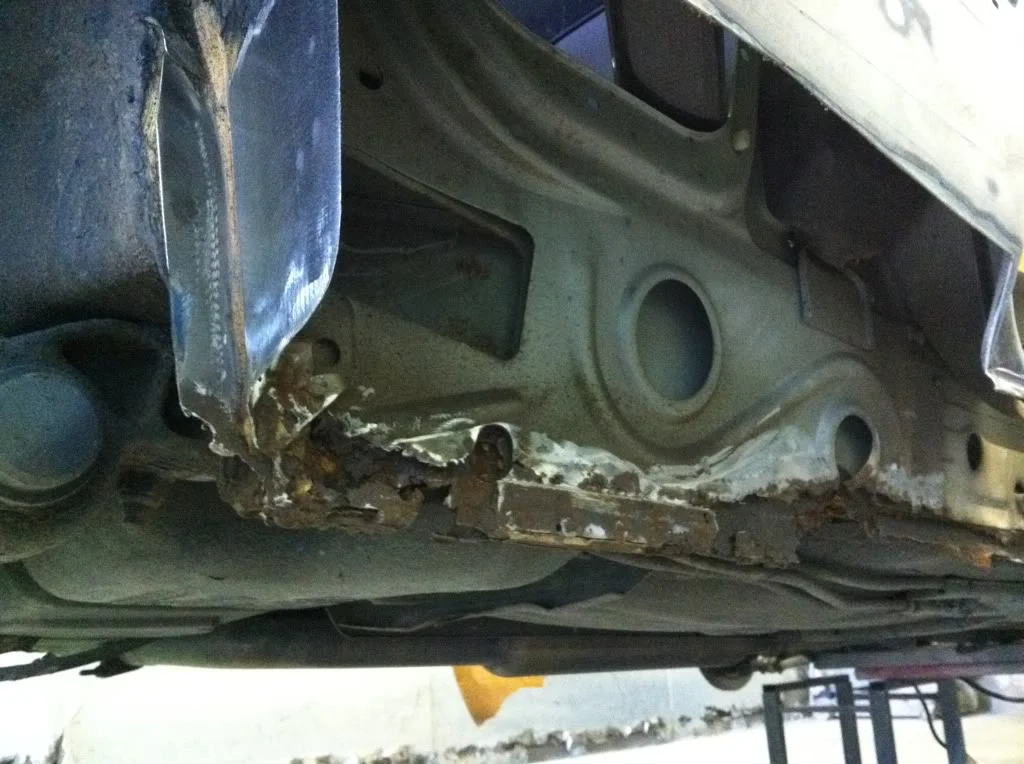

Ok some images from the bodyshop.....N REG disintegration factor!
As you can see YES that IS the floorpan thats nearly falling out... but better the devil you know.. so all getting fixed propperly....
Fitted
Jack damage repaired

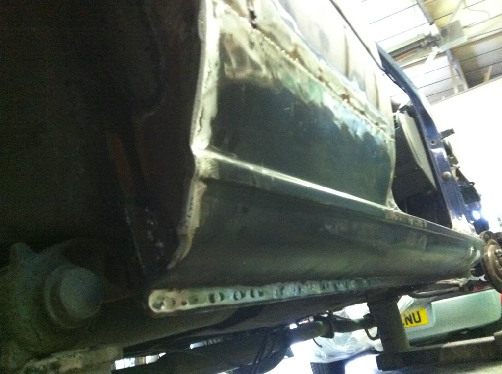

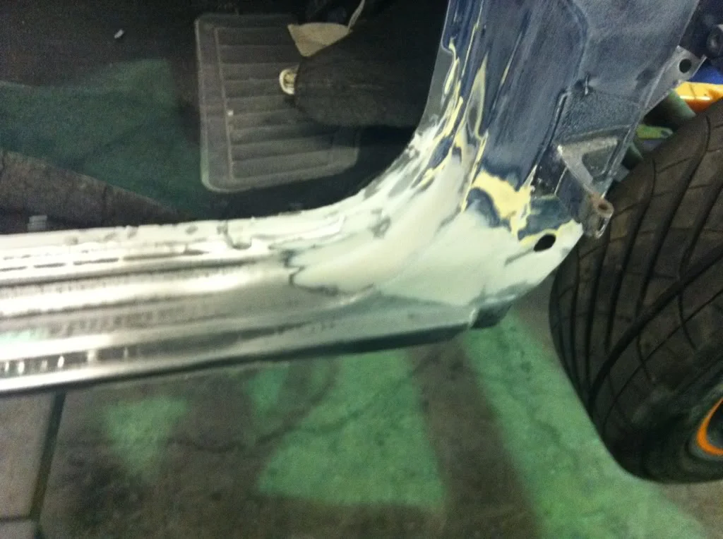

Cill is now hard as nails
Floor patched
Arch in
Front arch repaired
Screen out

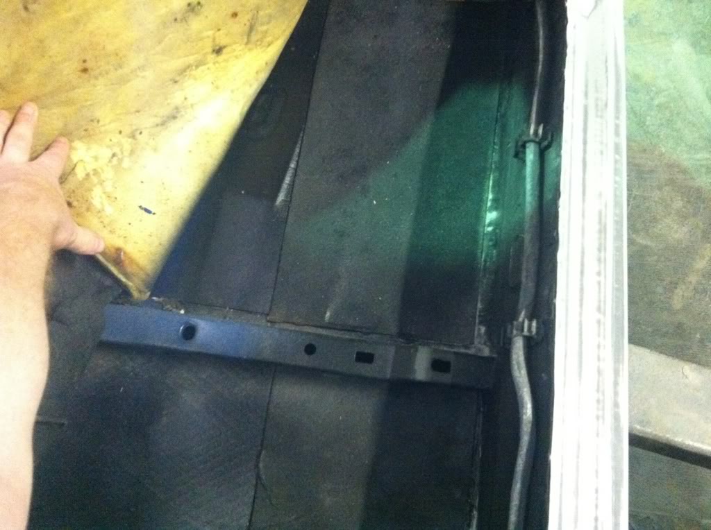

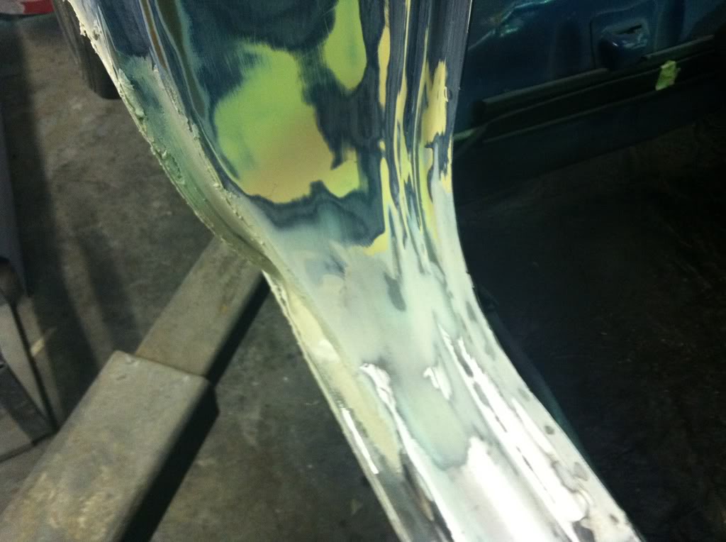

A rare morning off ive Been into bodyshop today, to find all the welding is now complete! Joy! No more rust
floor has been sorted,
Sill has been smoothed in yay
Door shut cleaned up

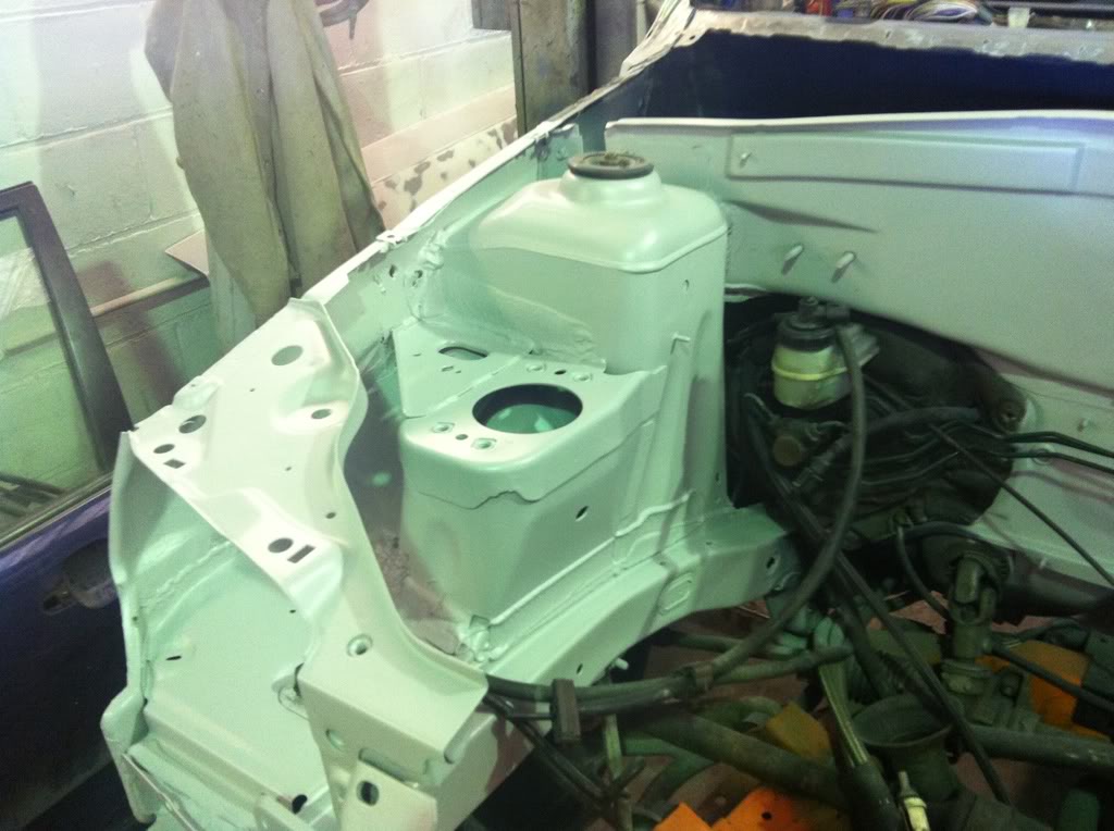

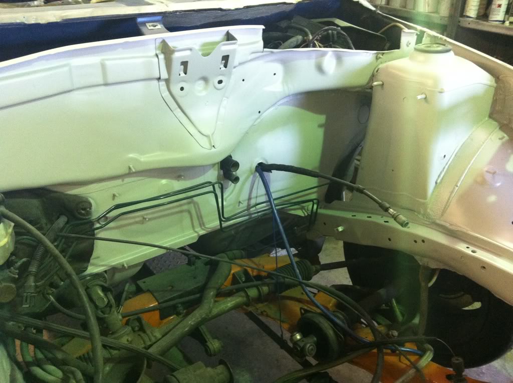

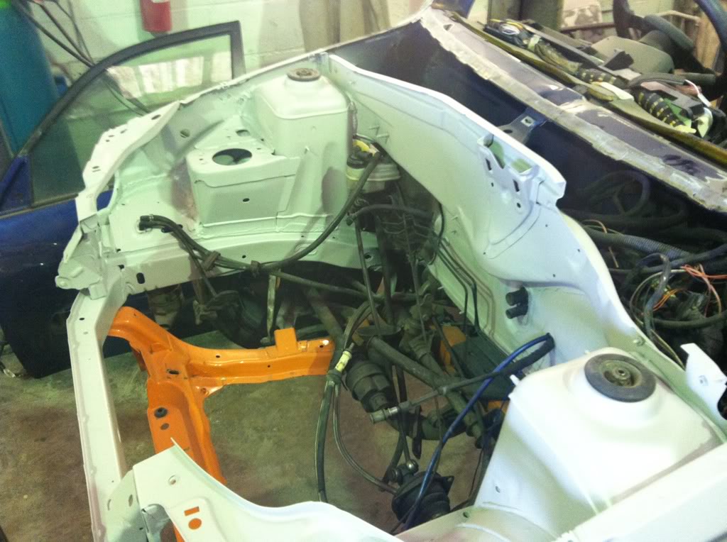

Engine bay in primer yay!!! One v happy mrs lol
thankfully no leaky powersteering will return here!

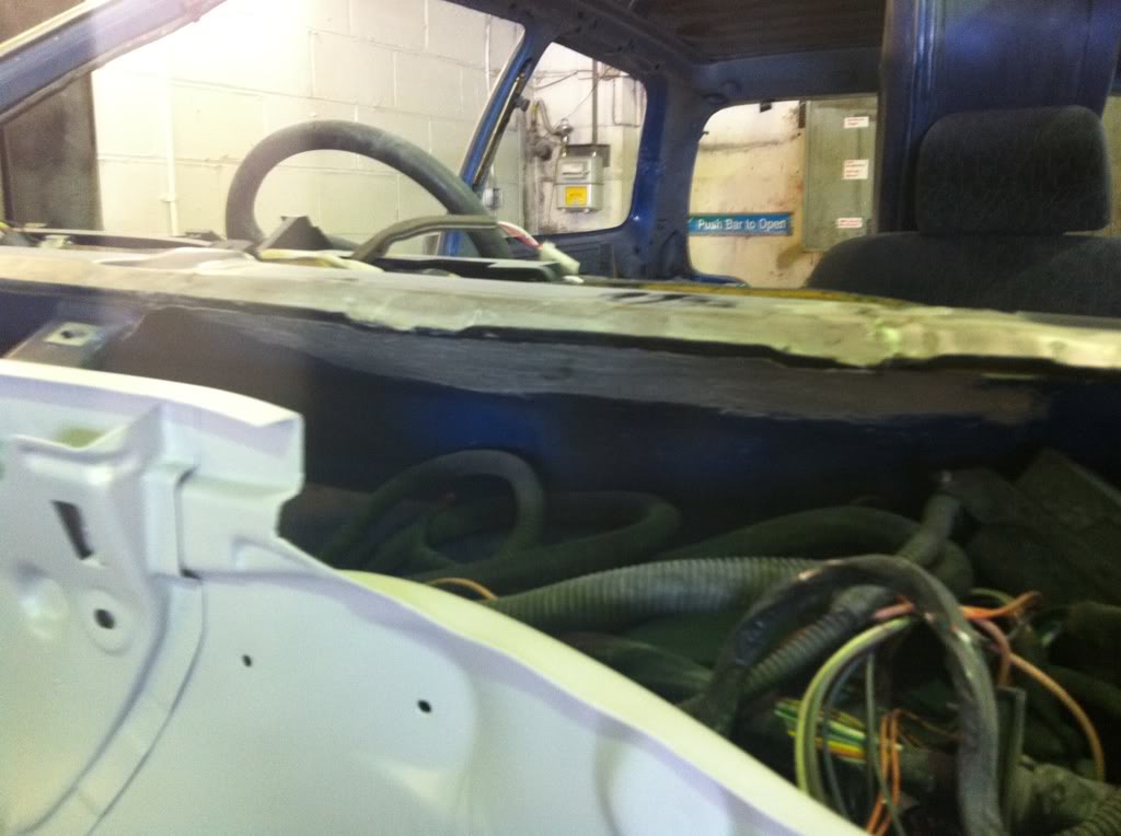

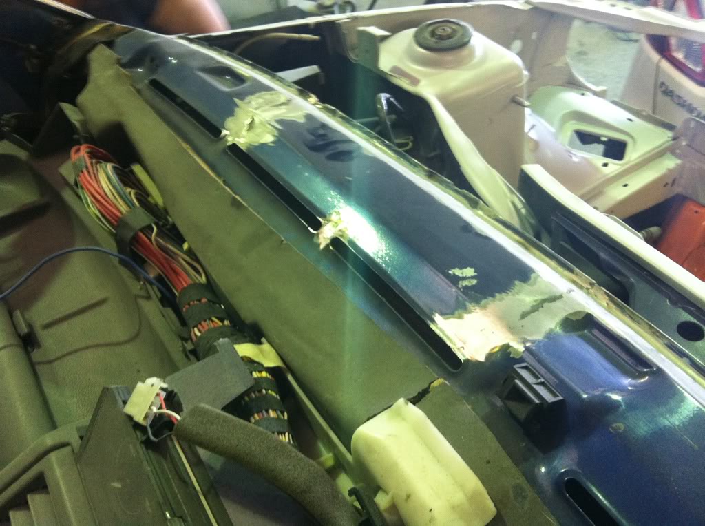

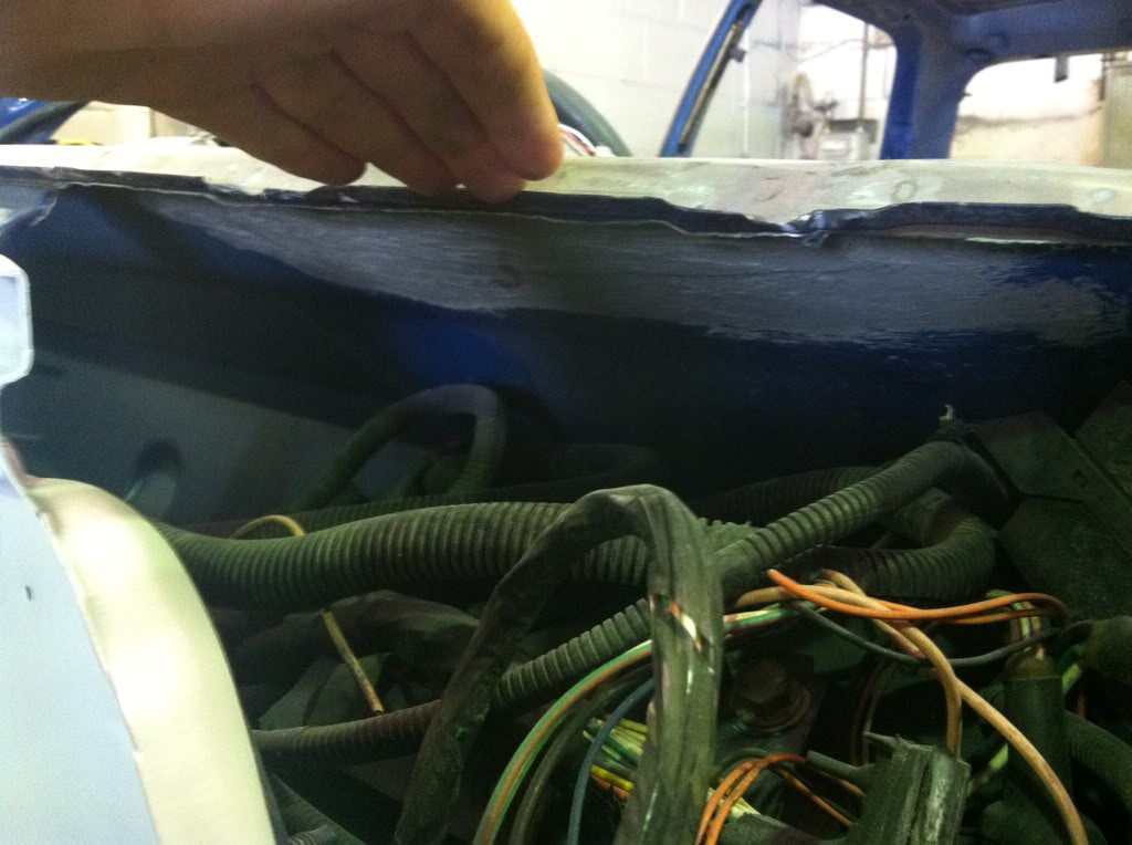

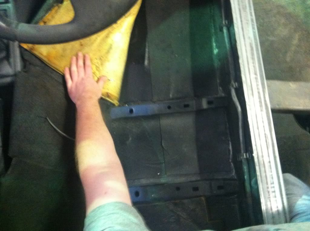

Ok remember the hole in the skuttle? Quite frankly the only bit I was worried about...before saw the floor?!?
Well it turns out the repair was **** simple!
Two cuts in the dash bend back weld in plate, bend back weld up, grind clean lol
And one photo before I left!

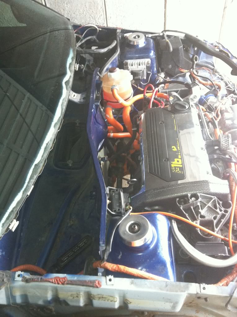

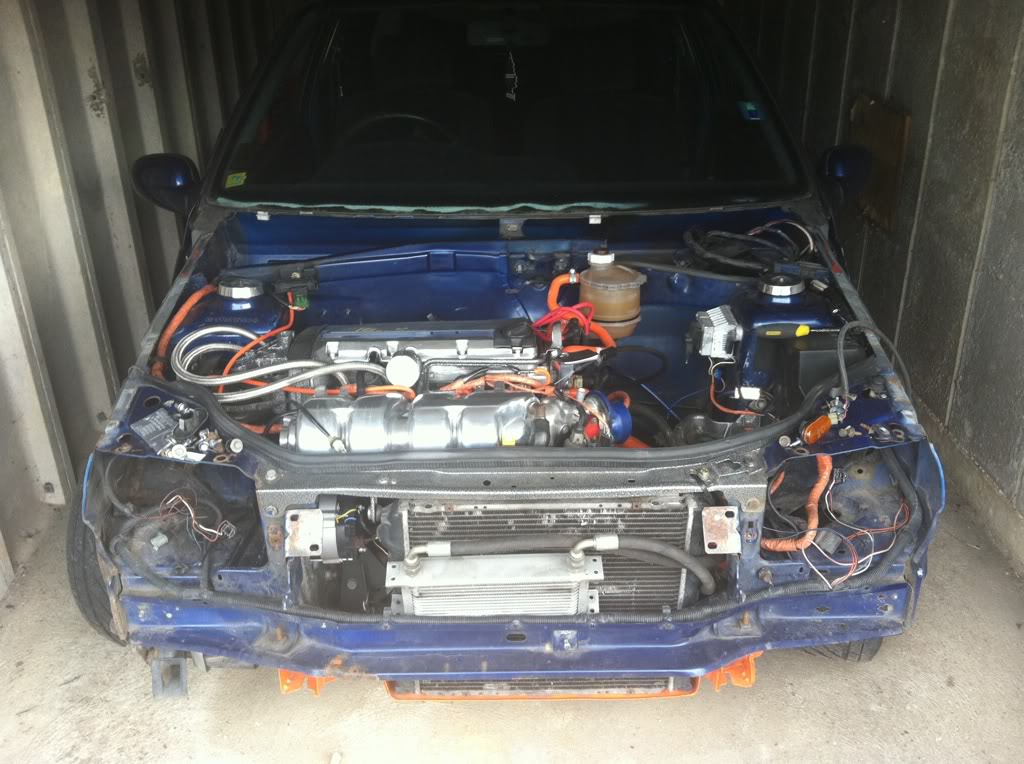

New radiator and pipework tidied up
[TABLE="class: ncode_imageresizer_warning, width: 615"]
[TR]
[TD="class: td1, width: 20"]
[/TD]
[TD="class: td2"]This image has been resized. Click this bar to view the full image. The original image is sized 720x960px.[/TD]
[/TR]
[/TABLE]
Looking neater!

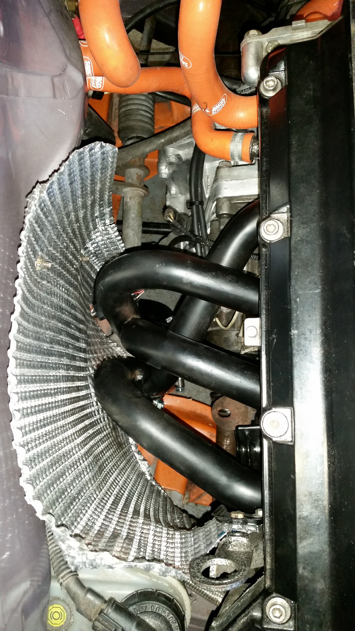

Nimbus heatsheild made!

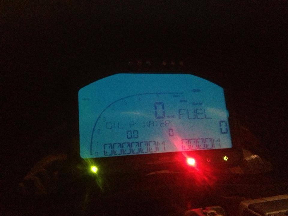

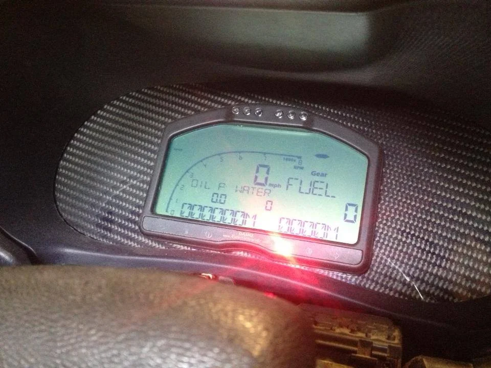

Launch control button mounted!
A few !wiring corrections later a basemap uploaded and…..

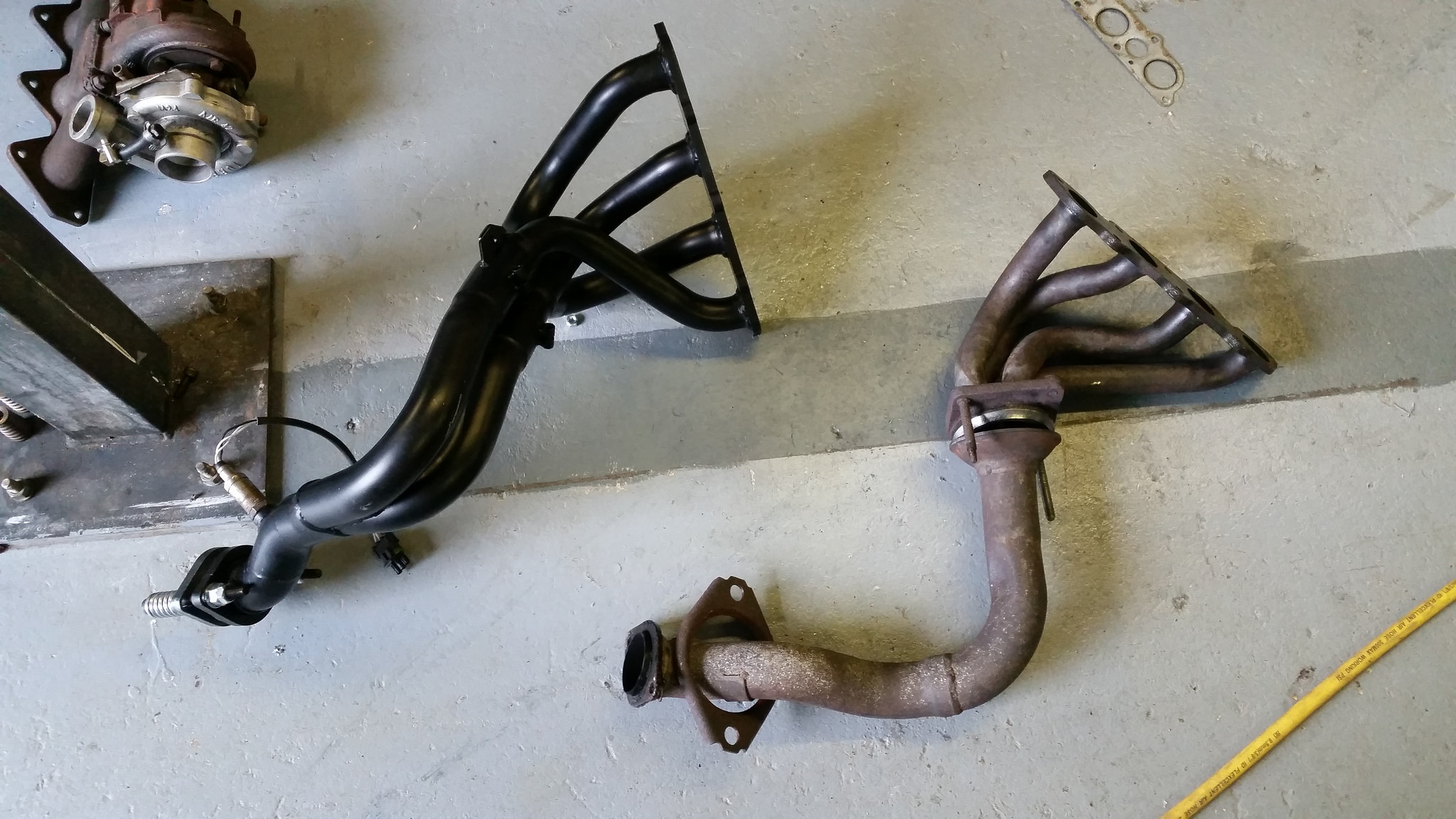

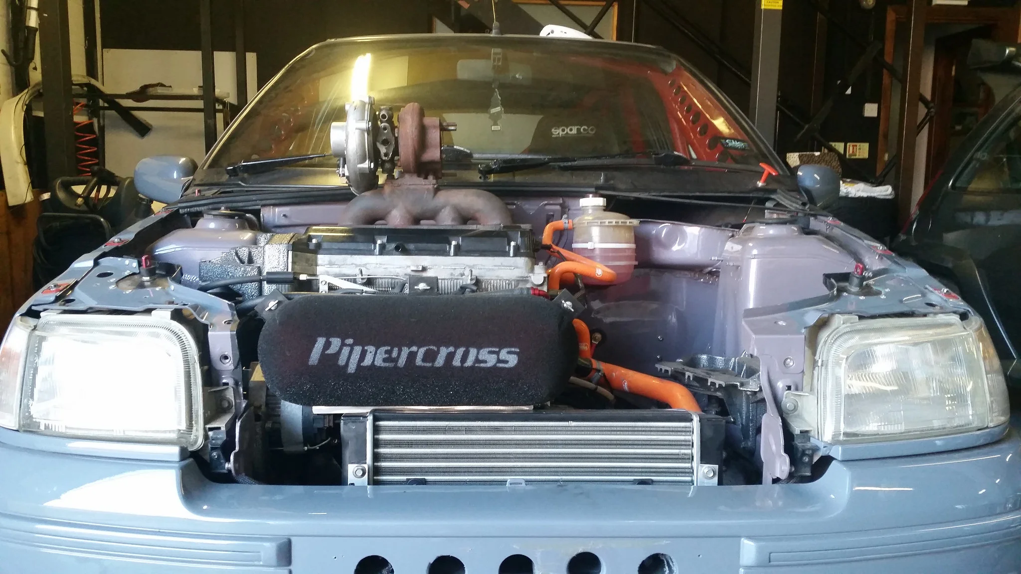

So after problems with the williams manifold i bit the bullet and bought a Mild Steel Supersprint copy
Clio build by Zmaster2k, on Flickr
its a better fit better design of 4-2-1 like the manifold from the original 1.8 16v....only not cast and made of solid iron lol
then realised i was wasting my time... and decided to put a turbo on my car
lol
anyway

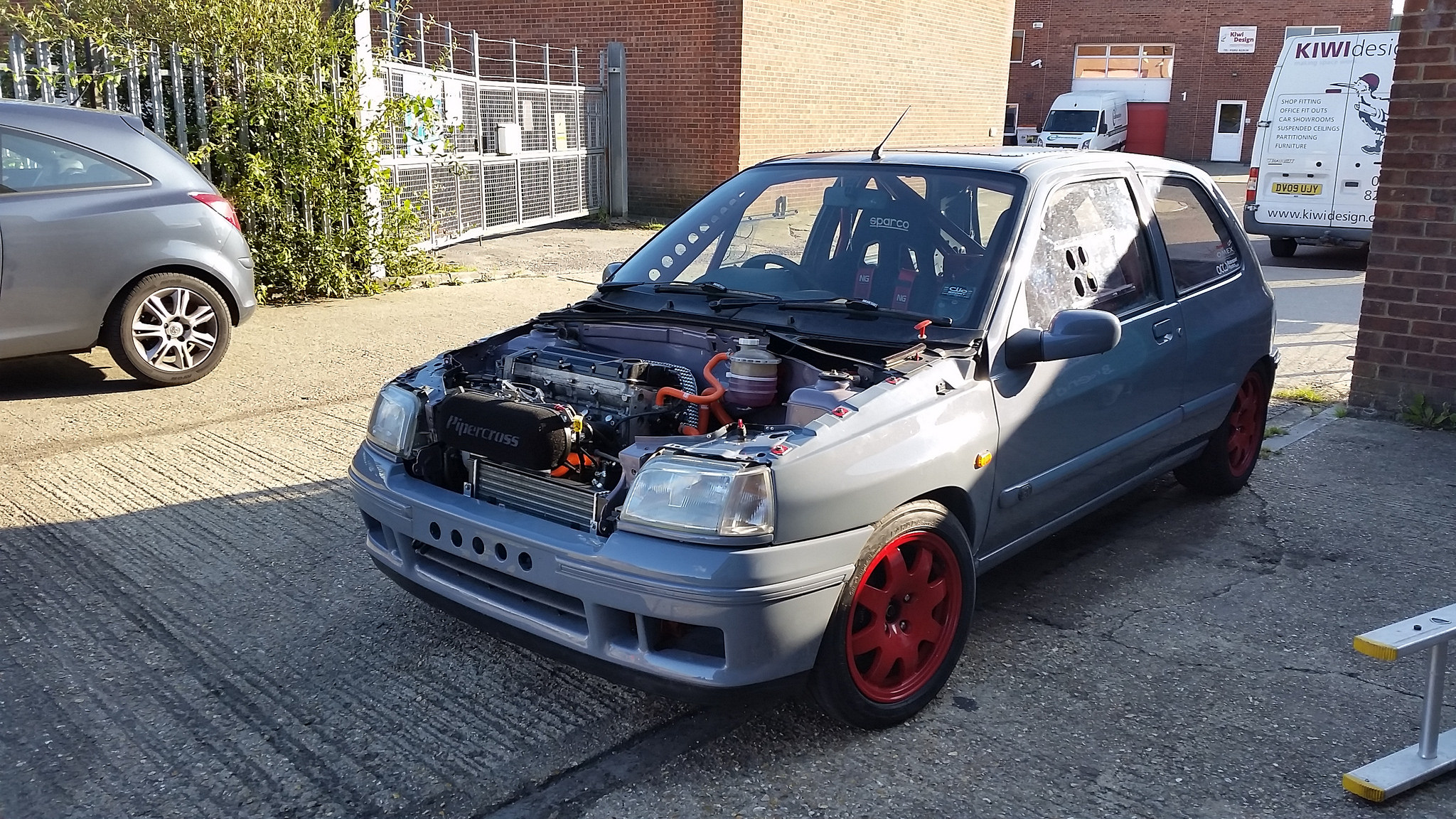

She now requires her horn wiring up...as it didnt have one fitted... and she is ready for her MOT :D
:D
Also drove her with a temp map on it... oh its quick! and f**king LOUD!

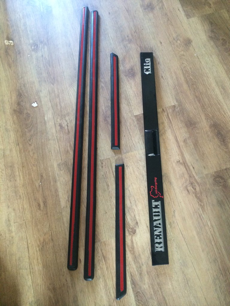

Carbon fibre bump strips mate, would look good IMO. That's the thing with mk2/3/4 colours on mk1s, the trims make or break them, well that's IMO anyway. That's what is throwing me on going inferno orange or not

will be changing the red though but not sure what to lol. Could do yours same as what mine are, would look nice I think. Then you'd have red bump stop inserts as well as red wheels :D
Think they're from a valver but I'll double check. I didn't know pov ones won't fit? I managed to pull one rear quarter phase 1 strip from a 1.2 clio in my local scrappy and it fitted alright, just needed the different clips
