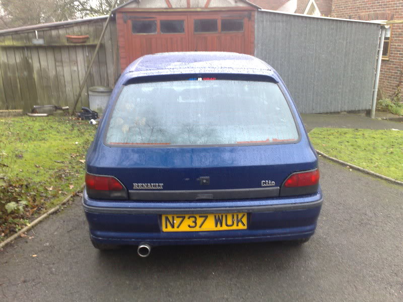

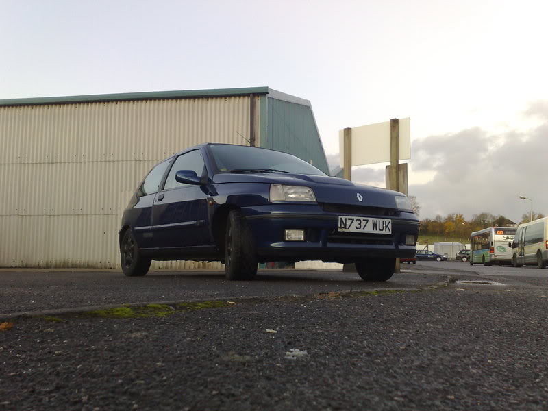

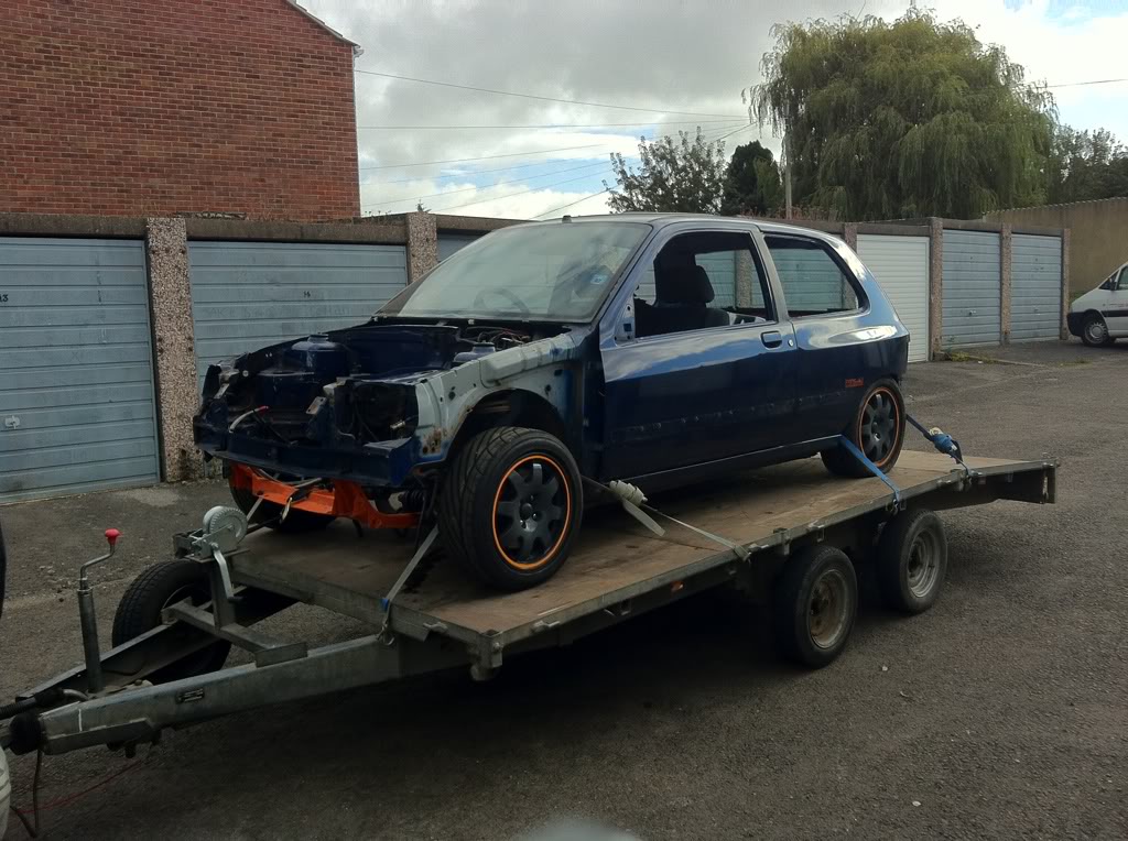

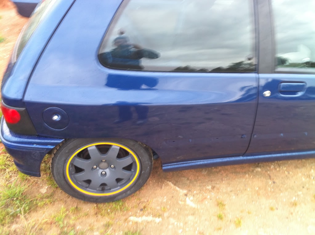

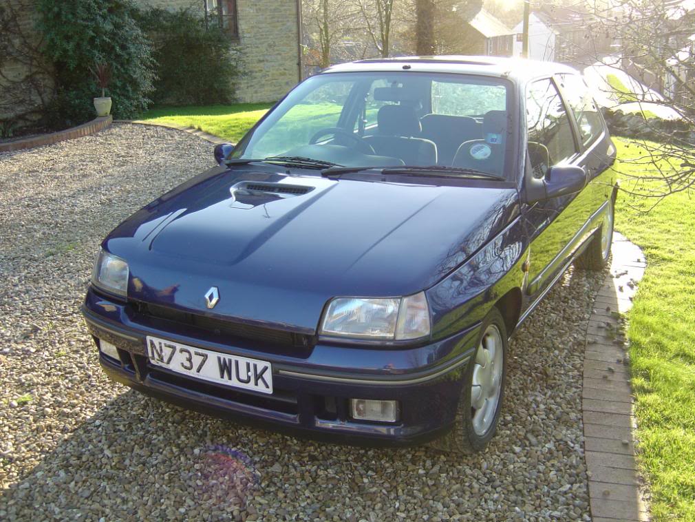

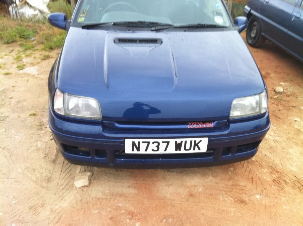

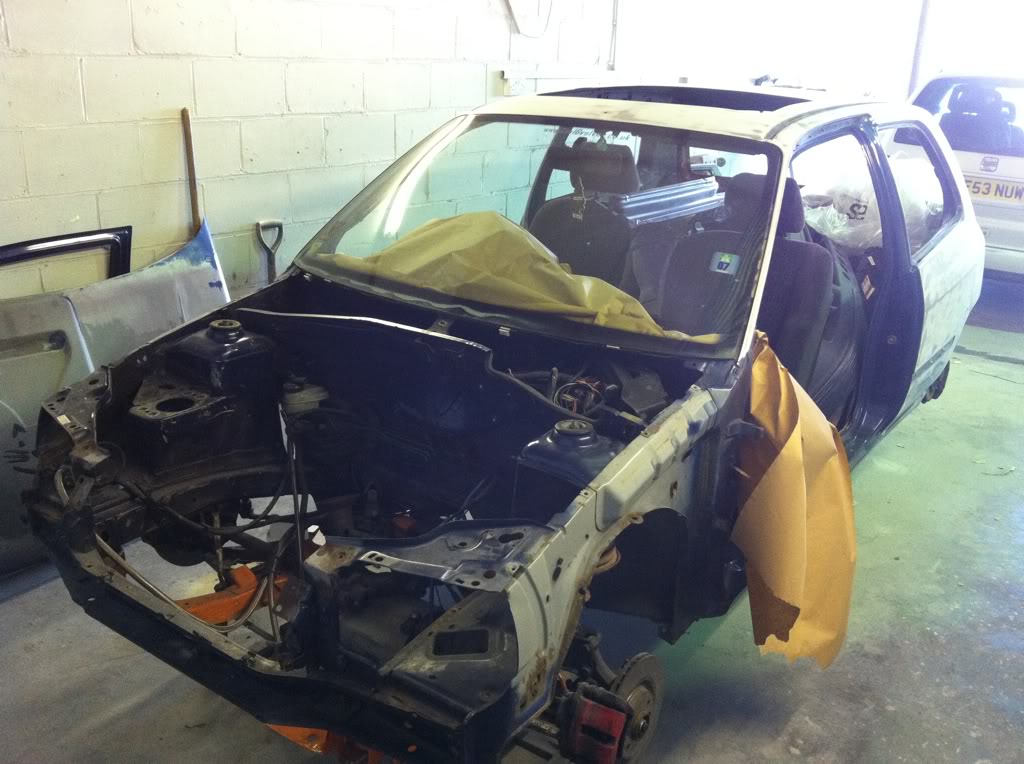

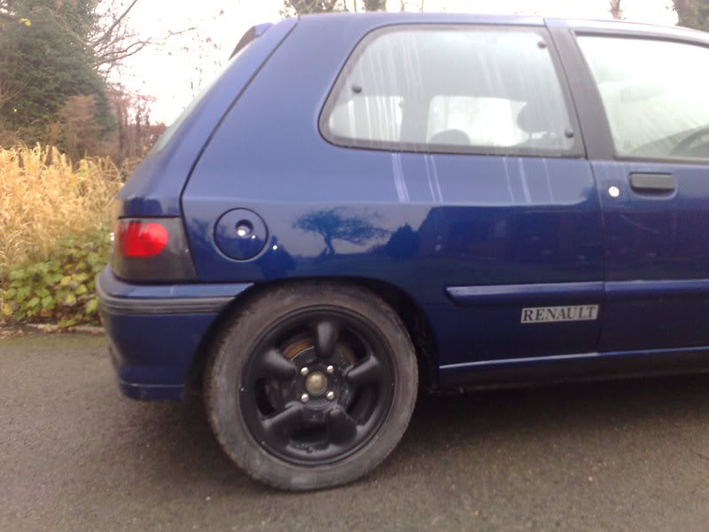

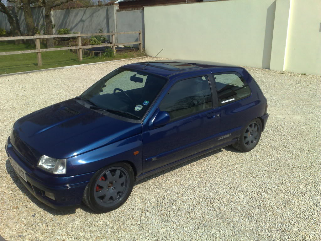

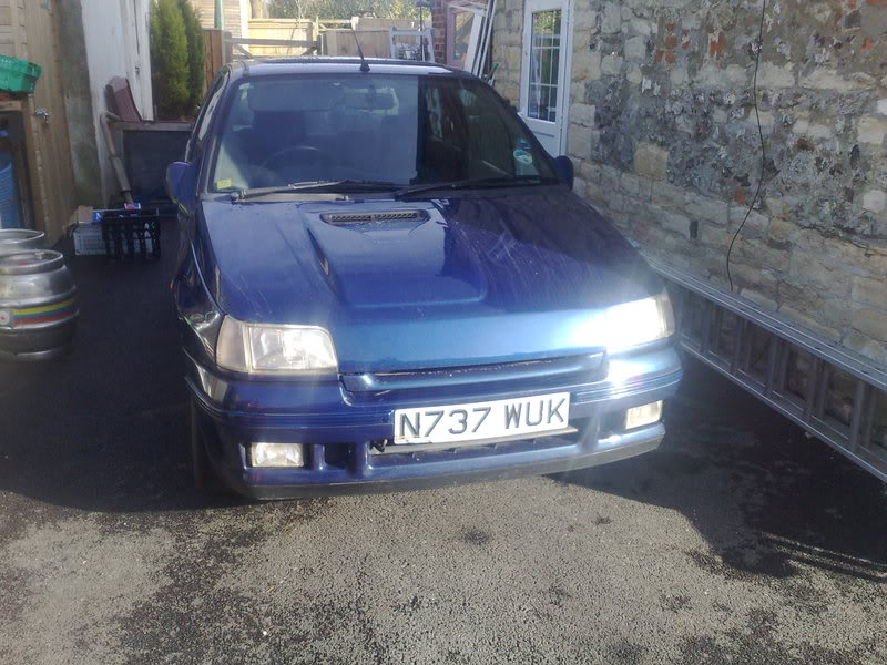

here she is when we got her
mods soon followed

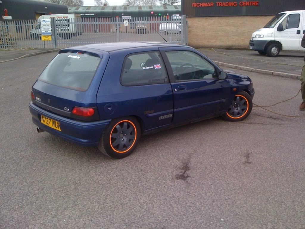

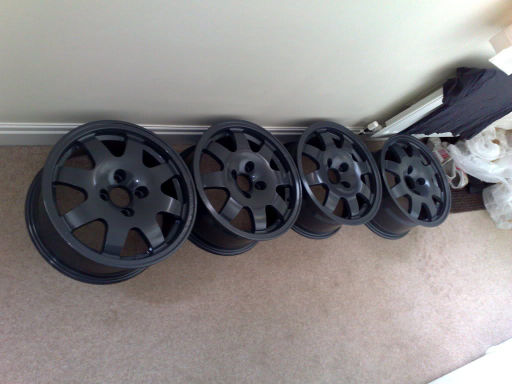

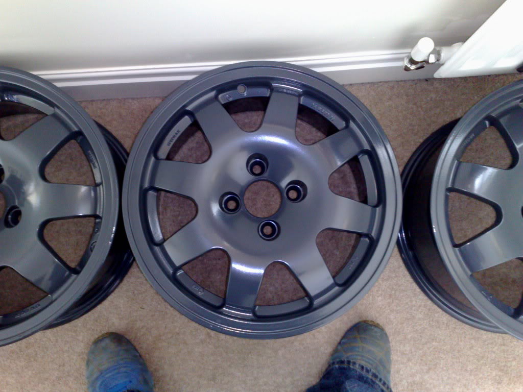

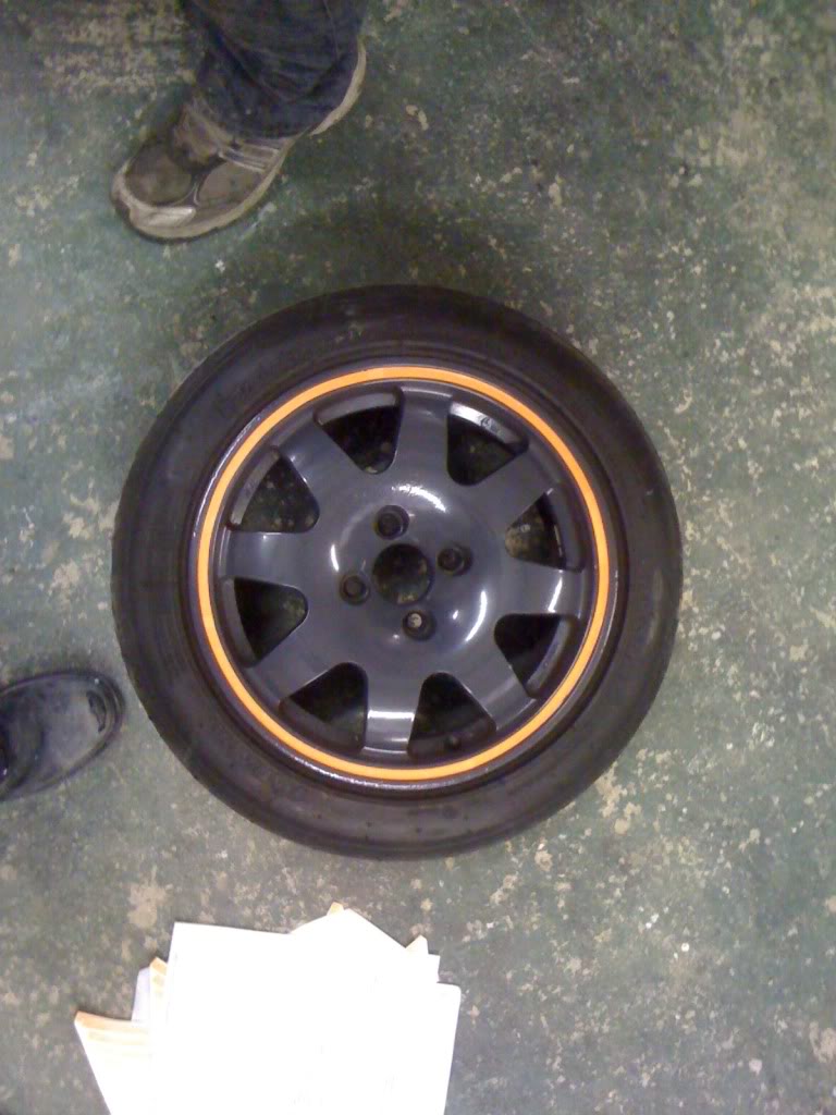

Painted up alloys

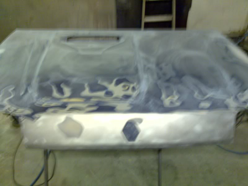

bonnet smoothed

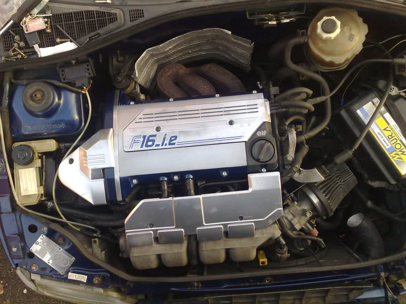

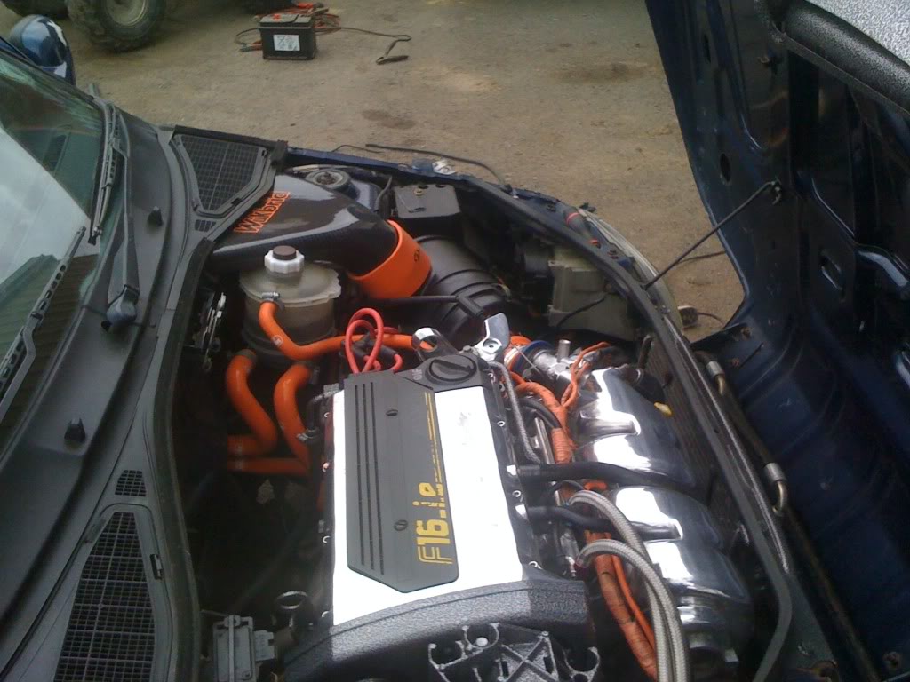

engine bay then got some love

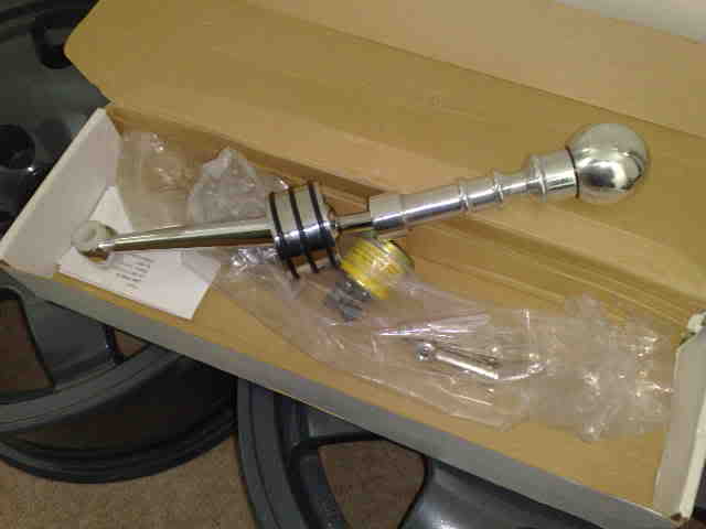

new quick shift

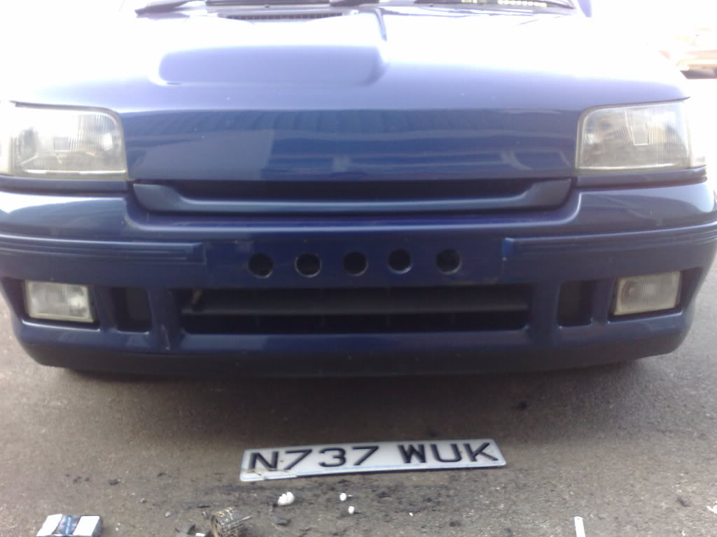

new number plate to replace the cracked one

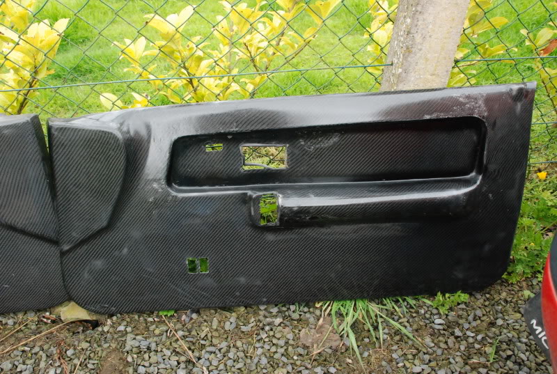

Fatman had some nice carbon fibre

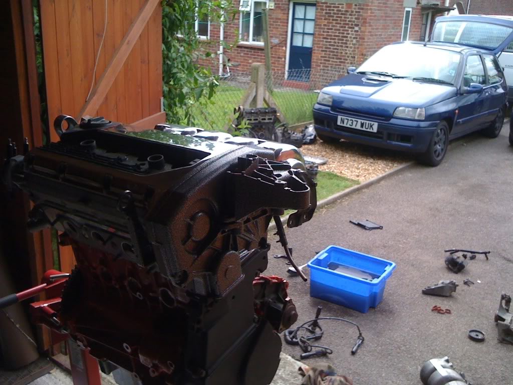

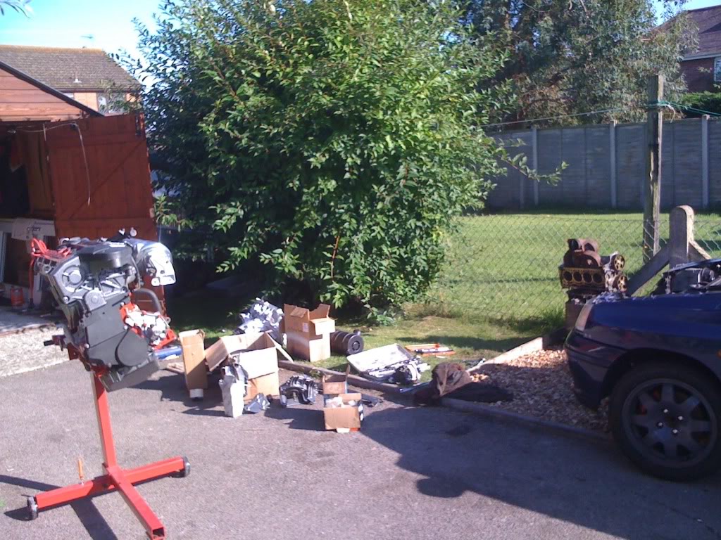

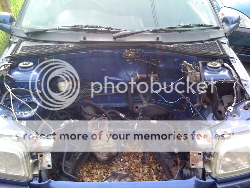

i then set about starting to strip the car ready for her new heart.
removed lots of parts to get thempowdercated and polished

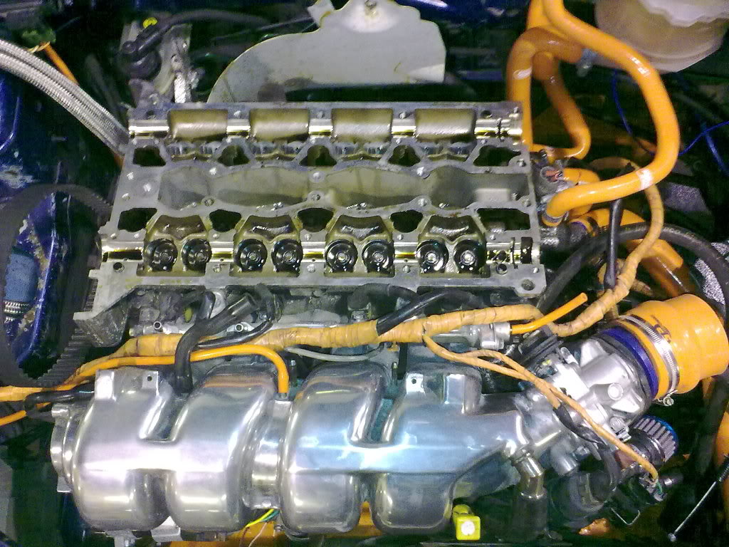

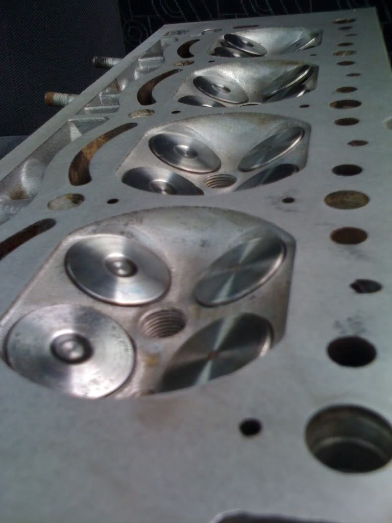

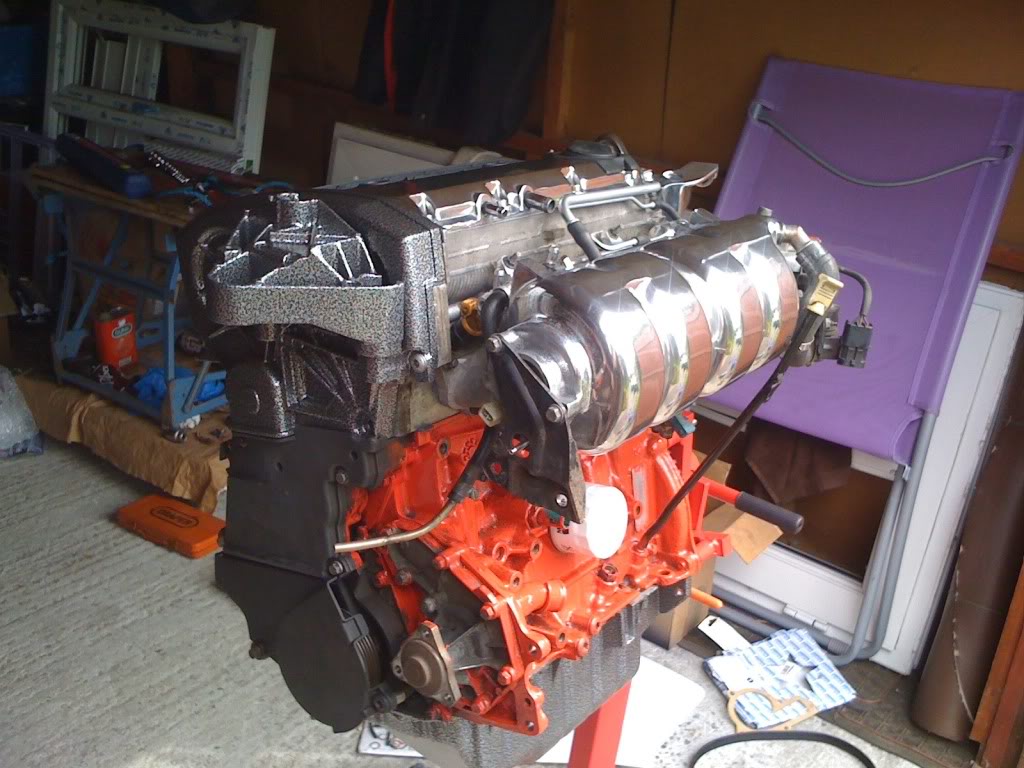

head has been reconditioned

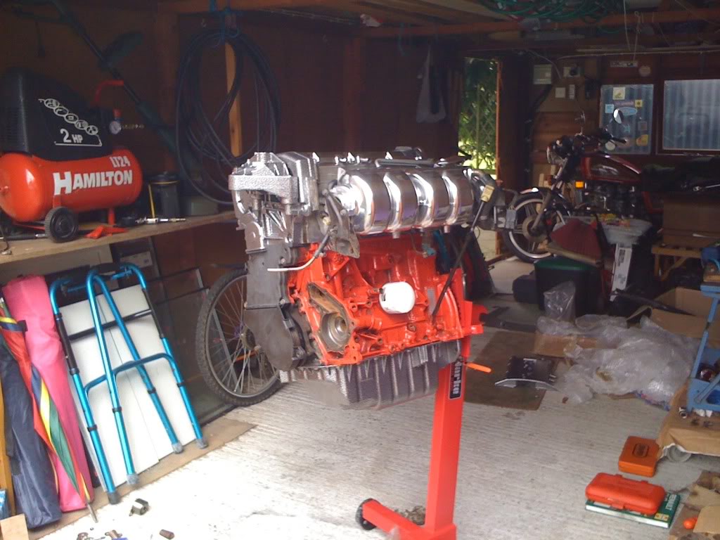

me and my brother in law managed to remove the old f7p

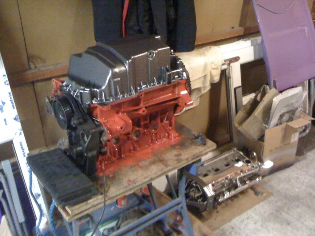

couldnt resist bolting shiney stuff together

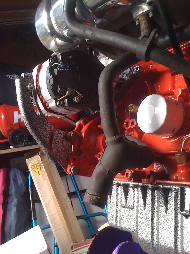

Block treated to some hammerite
the old f7p
degreased the engine bay
headattached to block with new gasket and new guide pins, new tensioner and cambelt all fitted, new rocker cover gasket, new shiney bits added

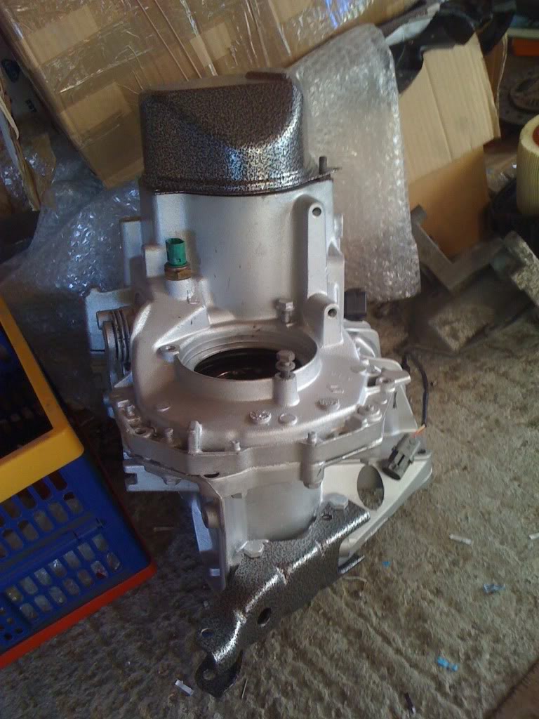

Gave box lick of paint.

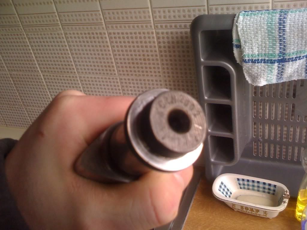

Then thought what the hell, so welded the circlip in place, if it goes wrong again its a new box for me lol

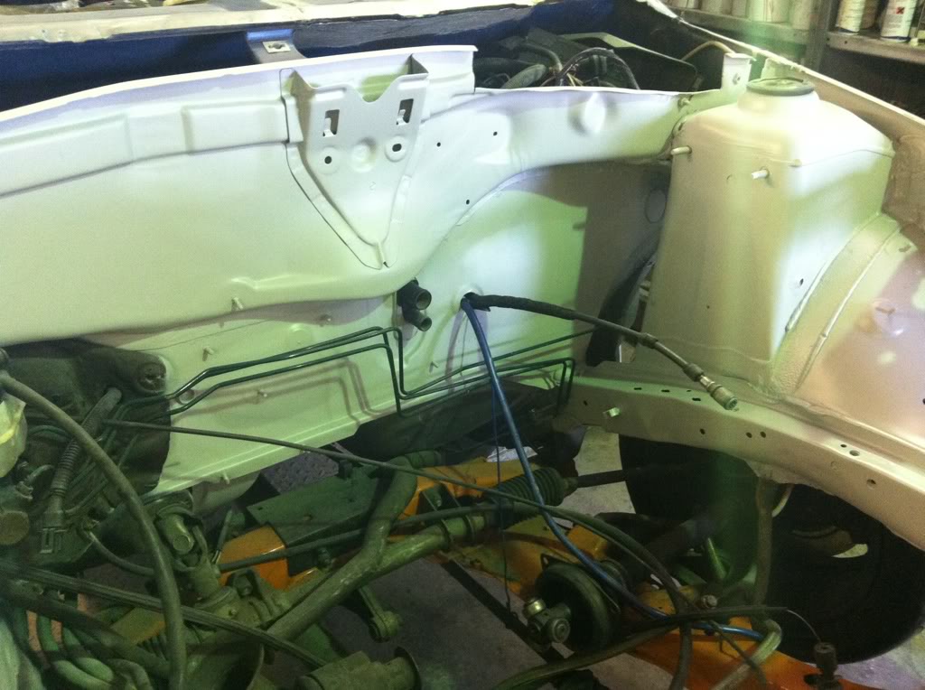

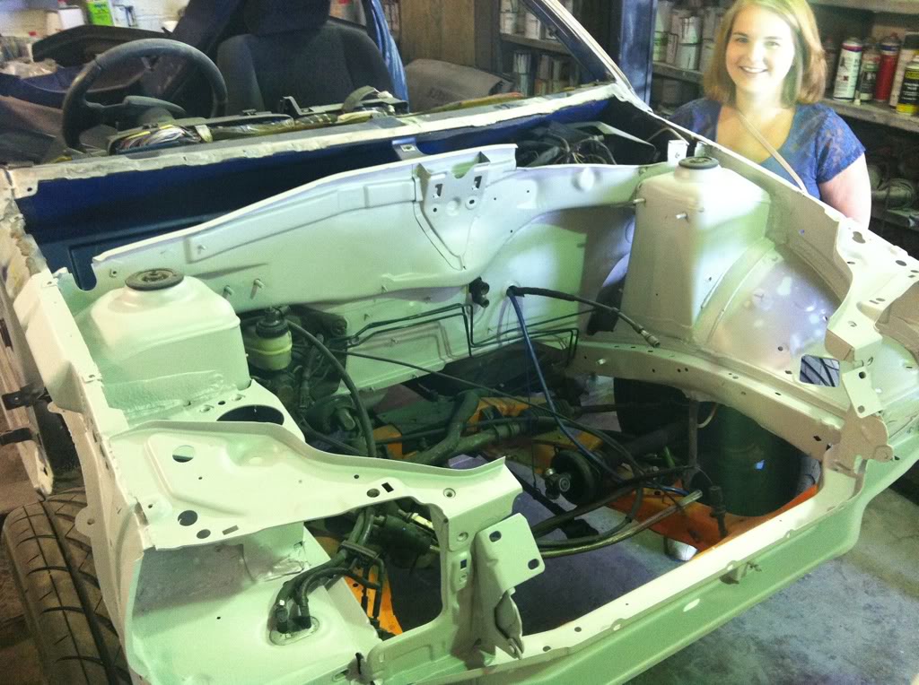

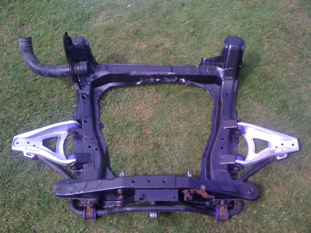

removed subframe for a lick of paint.

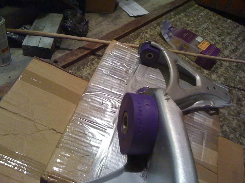

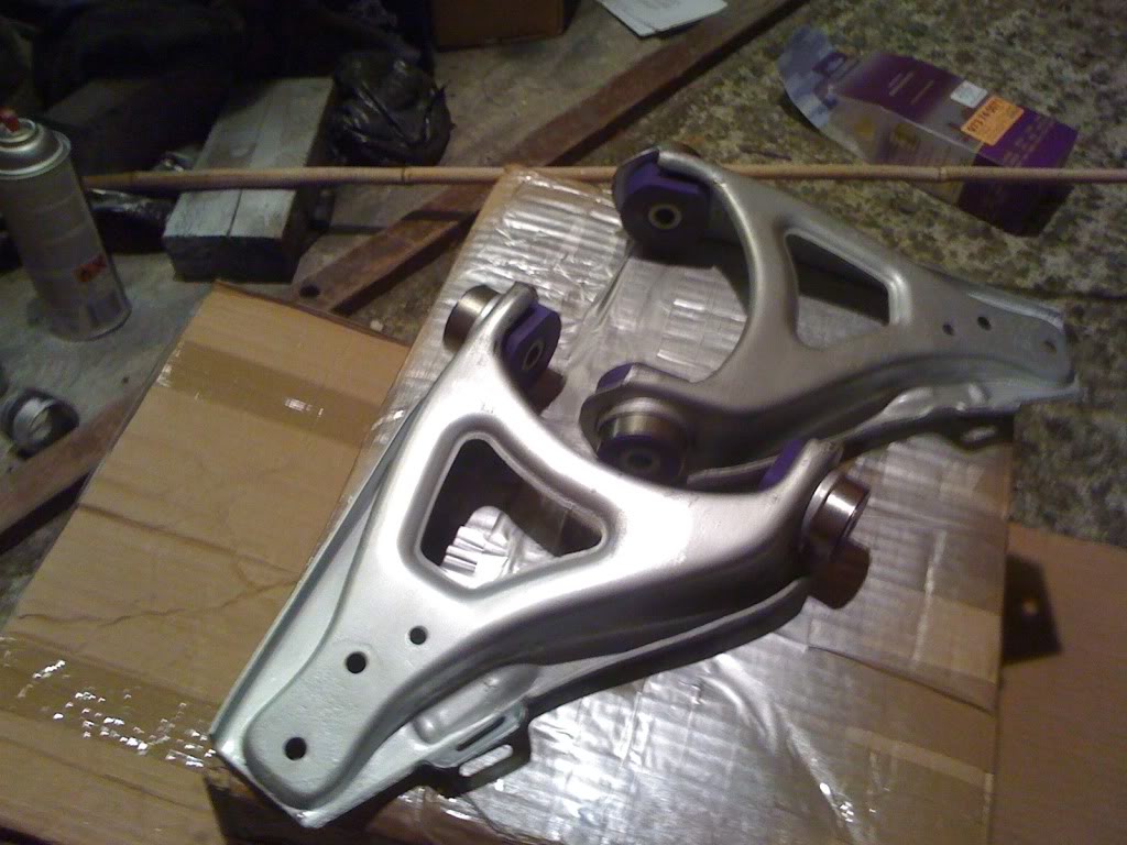

Wishbones scrubbed and paint applied.
Powerflex Rubbers installed....what a ball ache!
New Performance HT leads arrived from fatboy
More pics to come later! Hopefully re fitted lol!
Ok update 2:
Freshly Painted and Polyflexed Up Subframe and wish bones!
Subframe + 1 piece of Ally Sheet i have "aquired" through Jarvis enterprises!

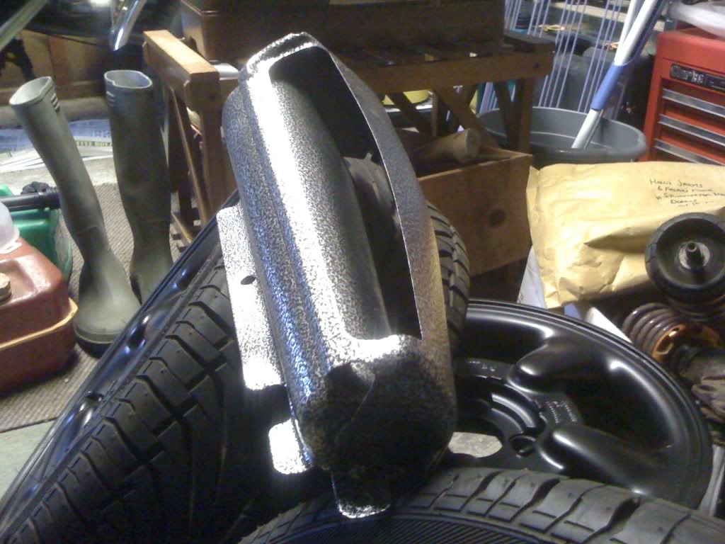

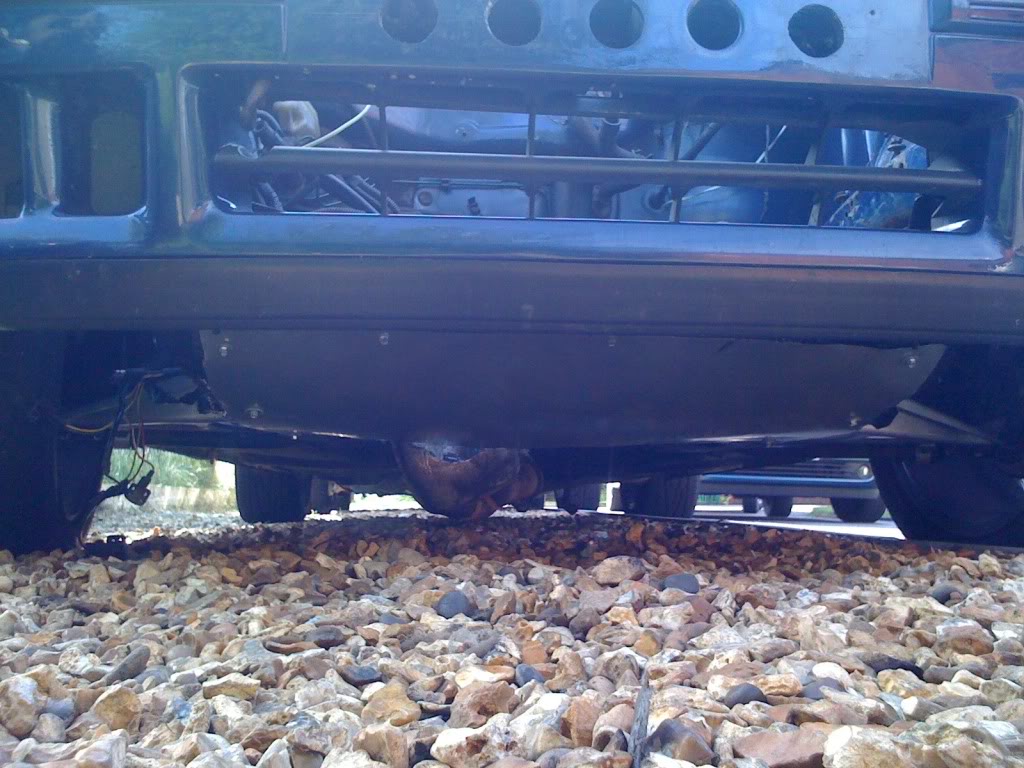

Bit of Home fabrication later we have a Sump guard!
Messy Messy Engine bay with fitted sump guard. But looks better with hammerite'd subframe

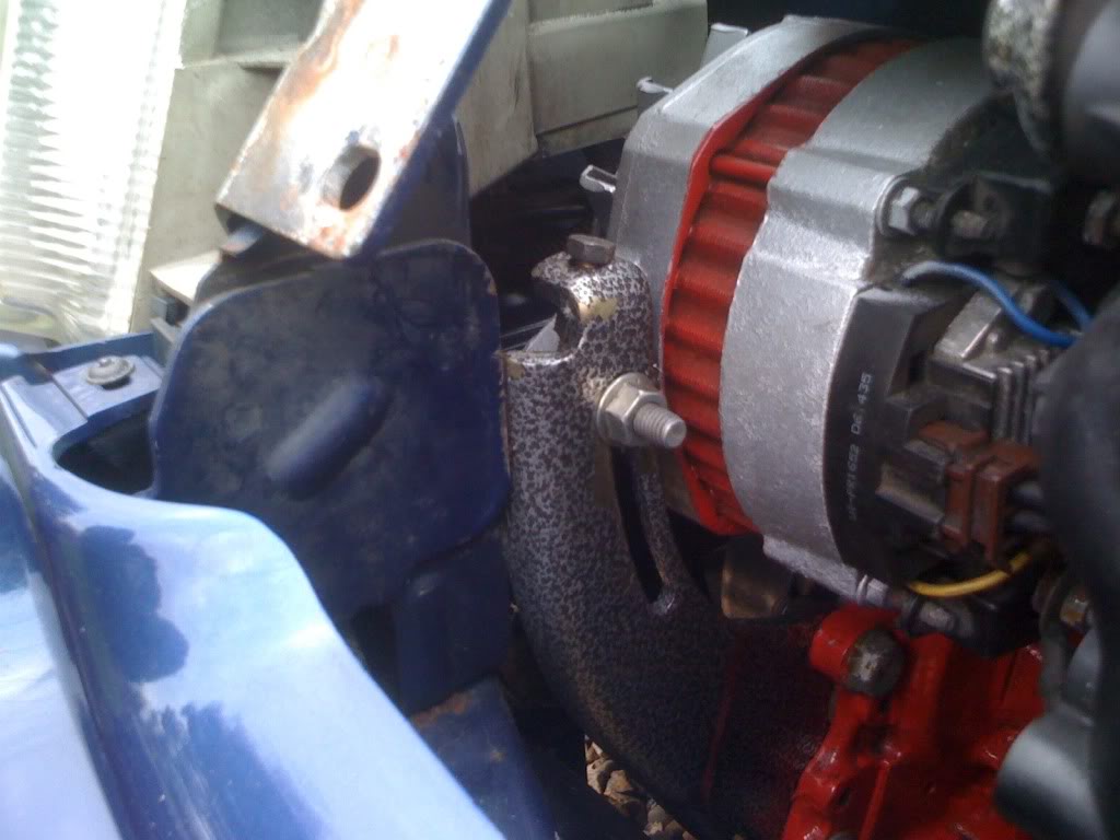

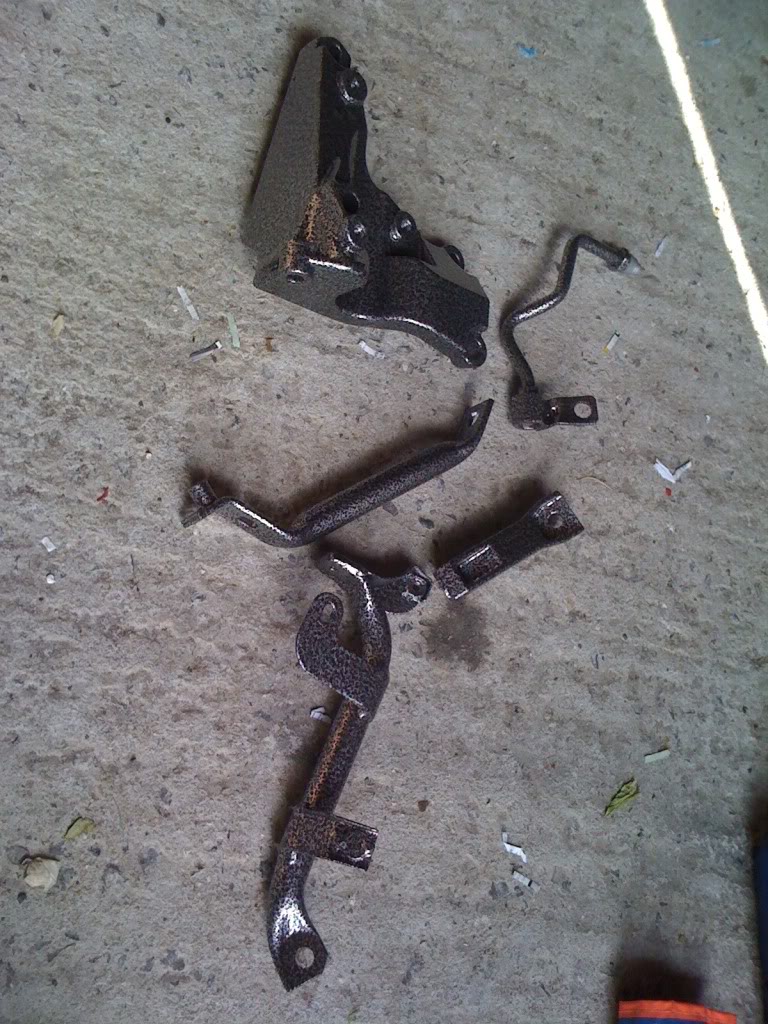

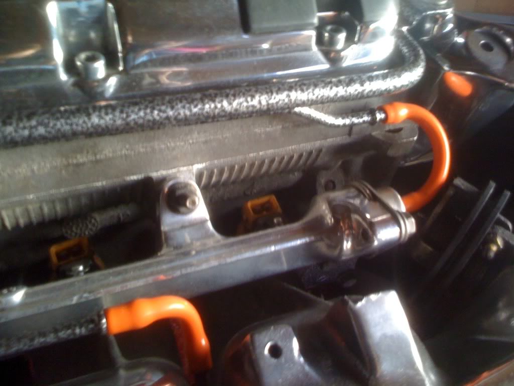

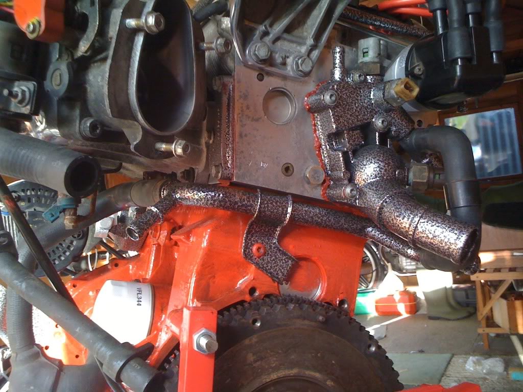

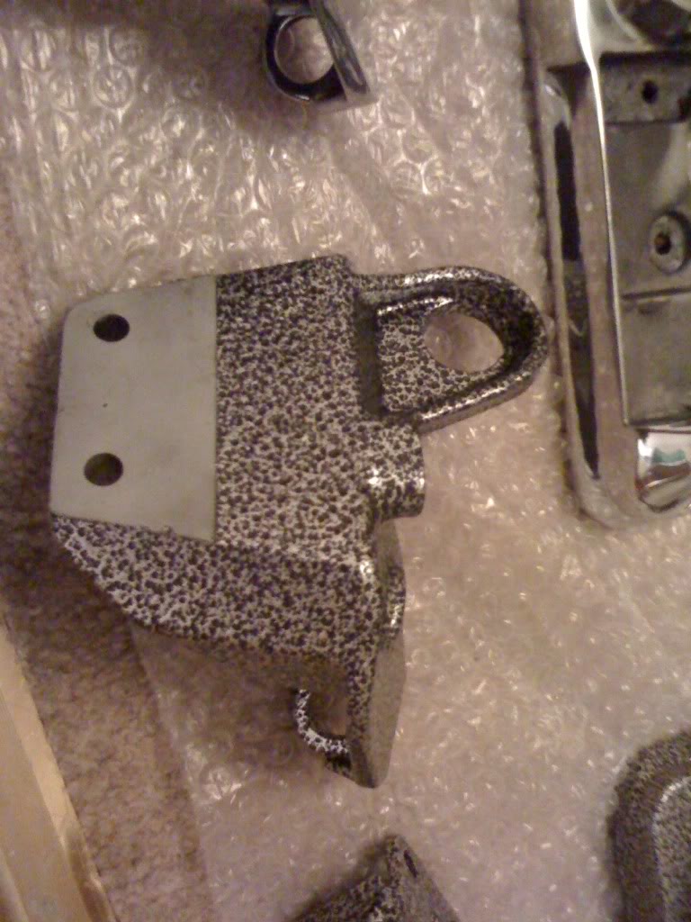

New brackets powdercoated and fitted along with alternator (yes i know im missing a pully!)

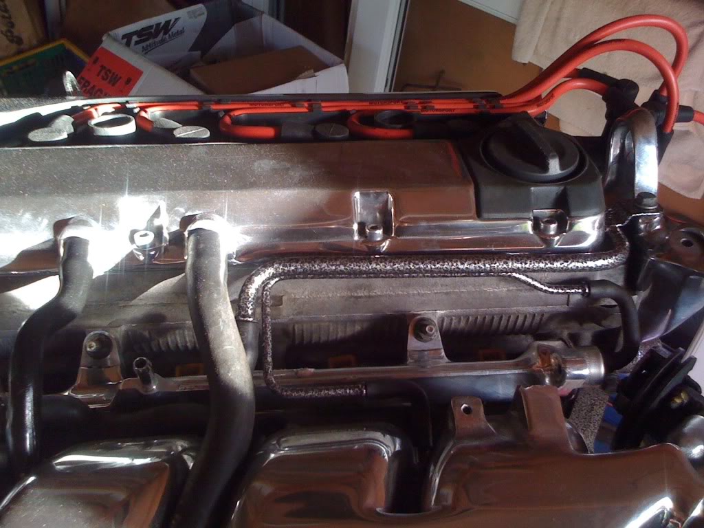

Pipes powdercoated too lol

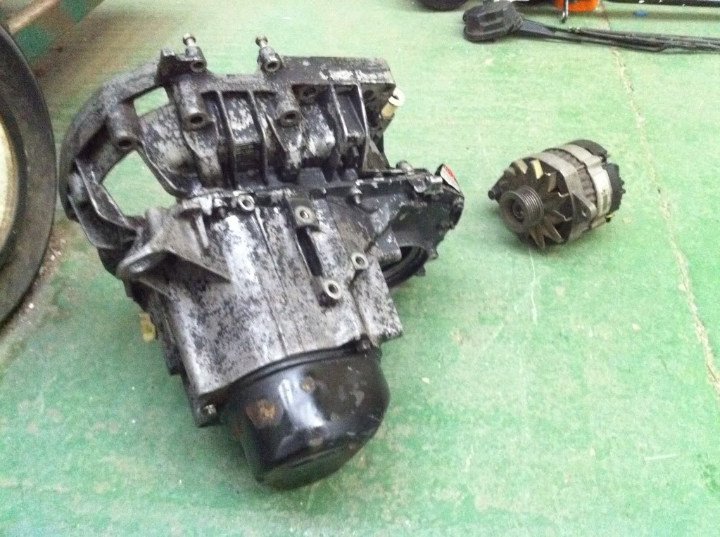

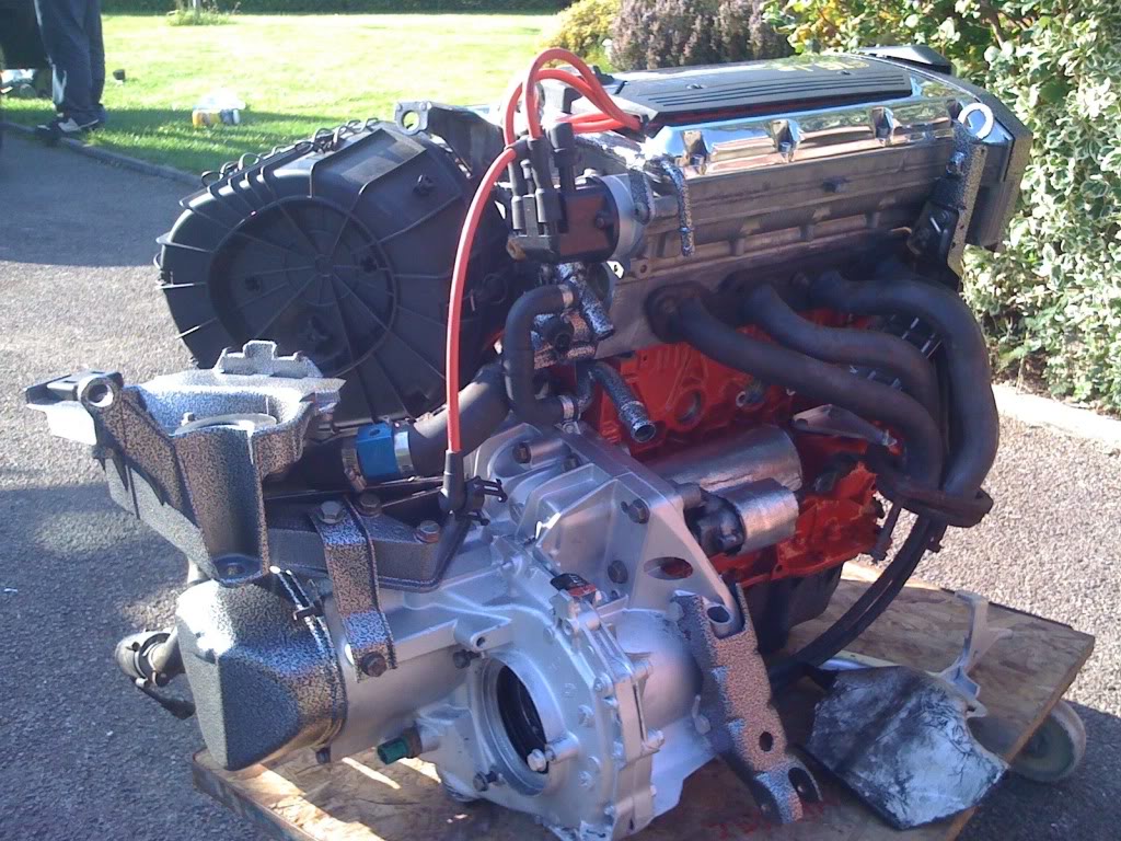

gearbox cover and mount powdercoated too :)

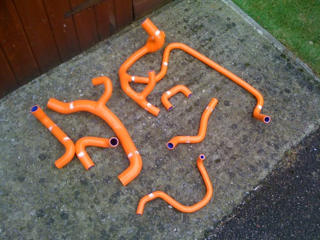

Also ordered up my first set of Samcos woop!

More powdercoated bits fitted
im aware most of this will have to be removed to fit biut i have lots of bolts and wanted to make sure i had the right ones to fit lol

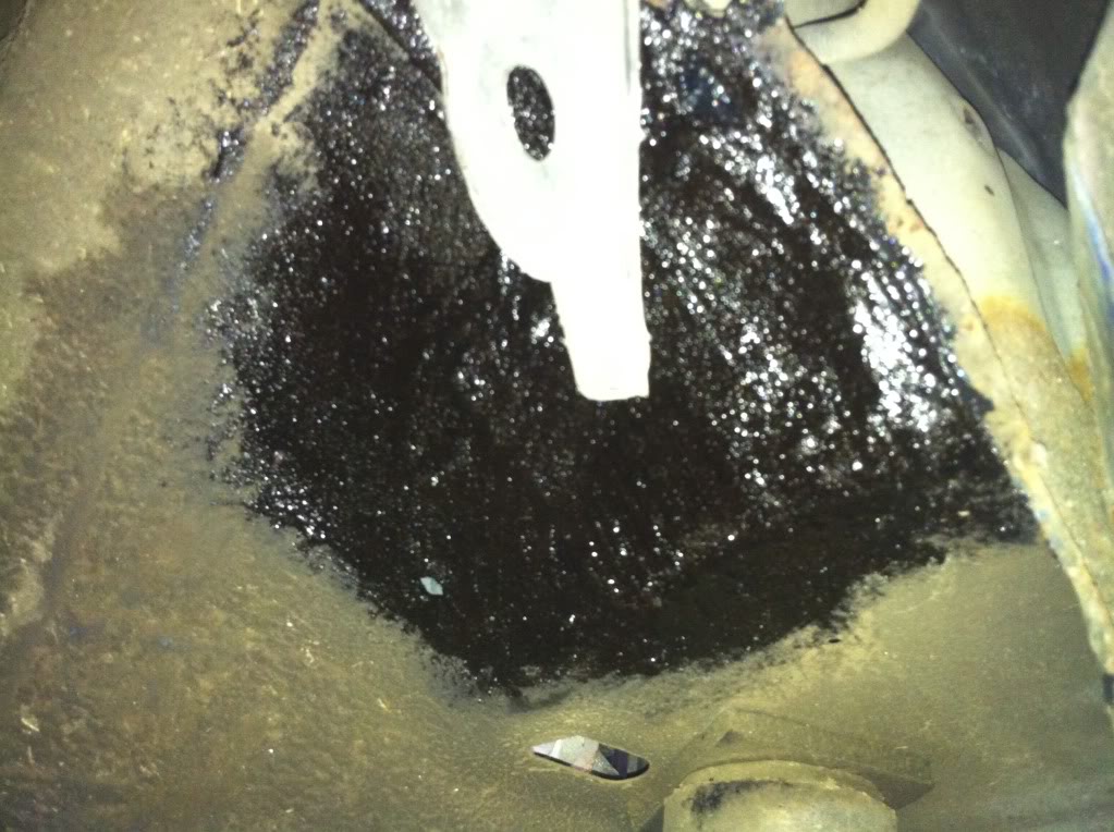

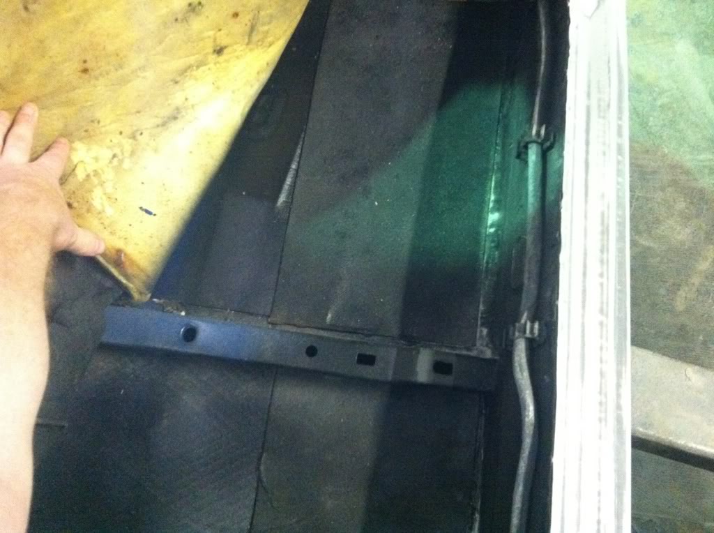

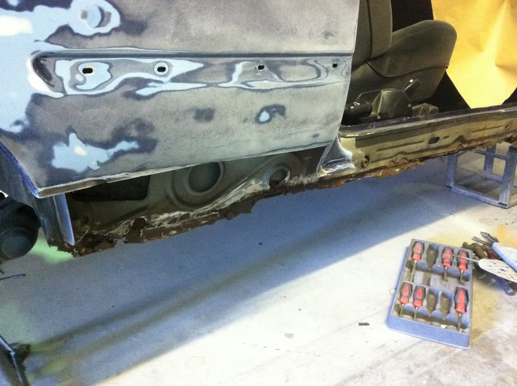

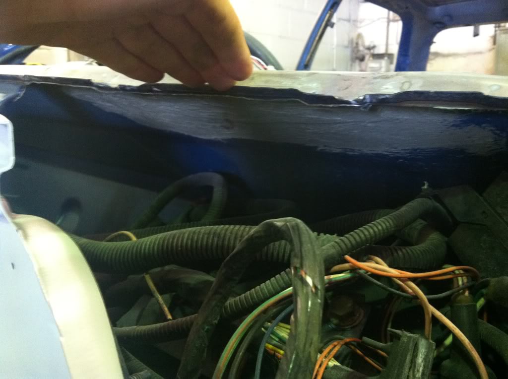

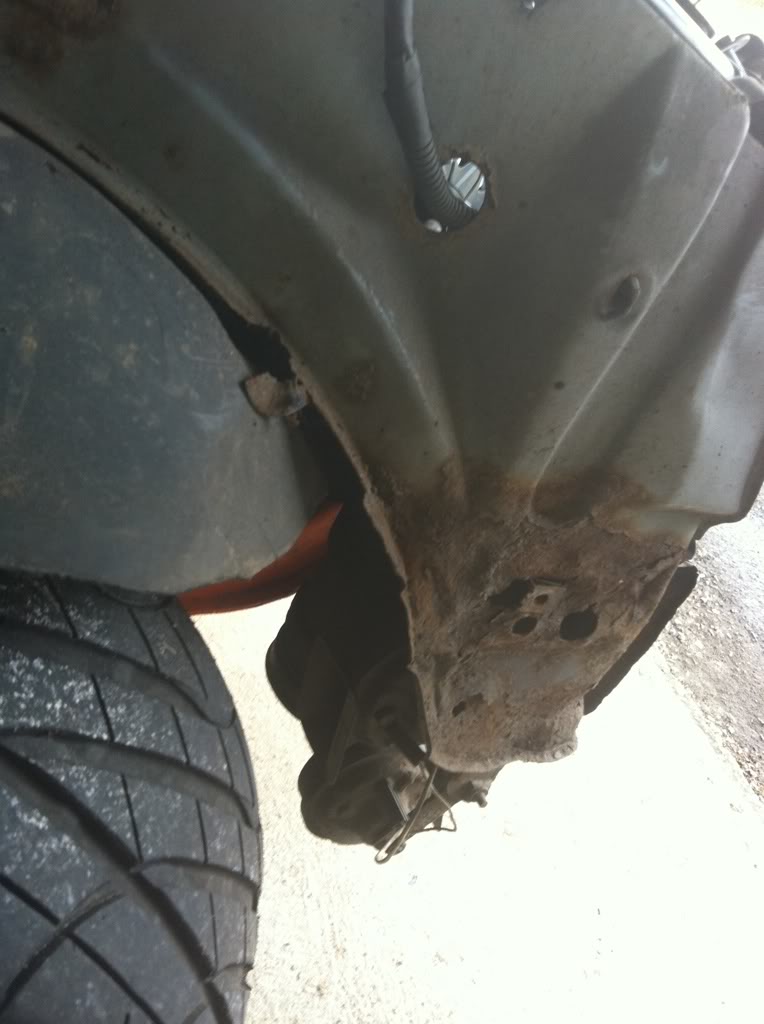

also looked into the rust whipped the dash off no sign its just under the skyuttle have treated it to waxoyl and will get it plated when she goes into the body shop

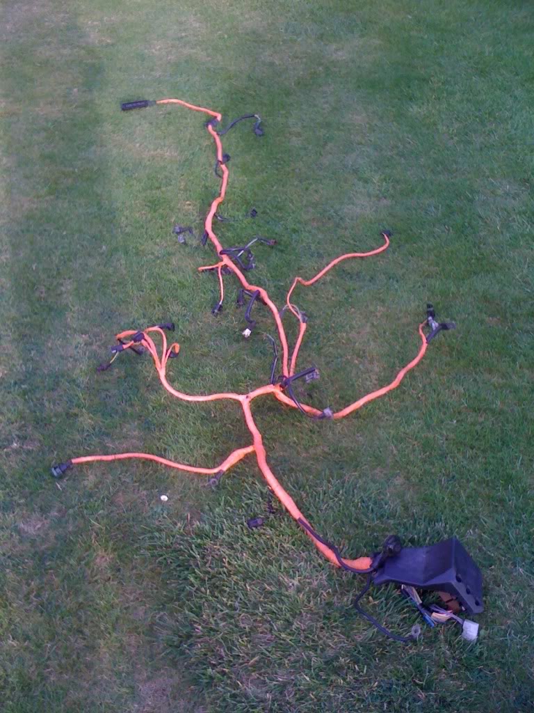

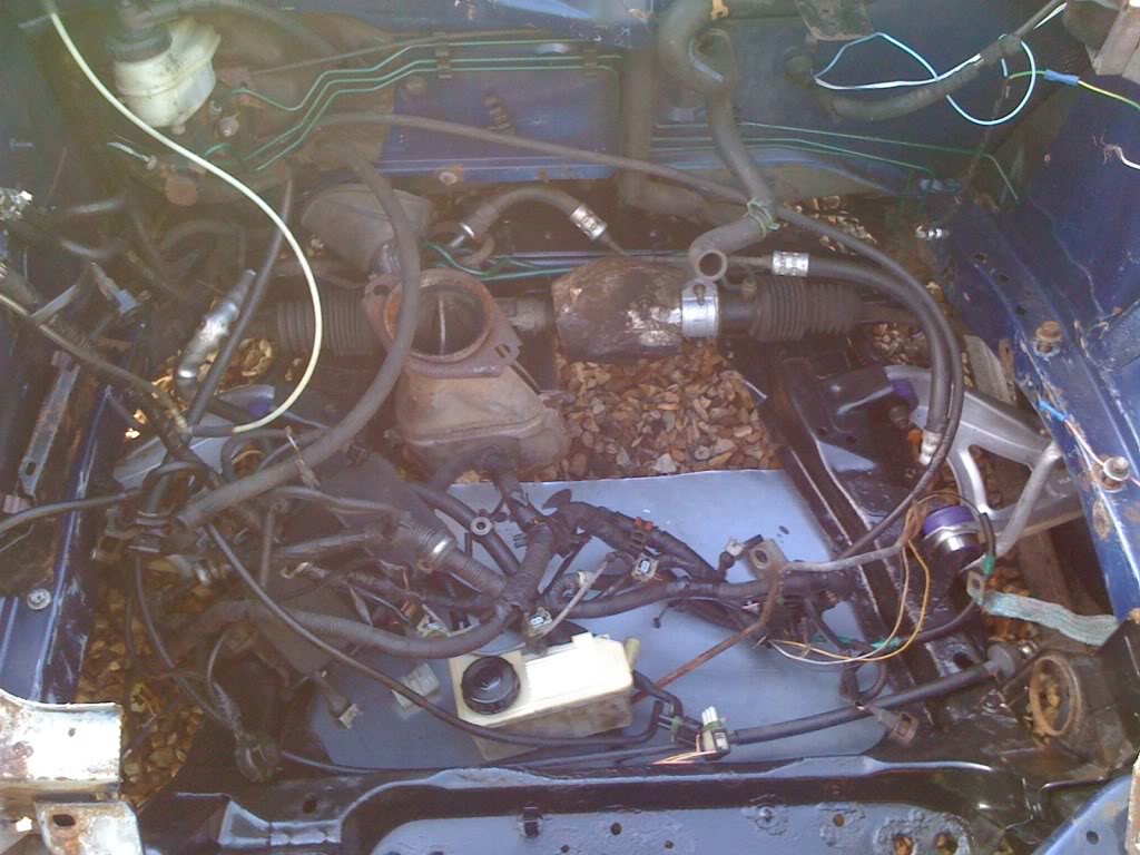

Finished work today, cracked on with the engine loom
looked like this
Removed all this
Now looks like this

just waiting for hose finishers and rest of my samcos!

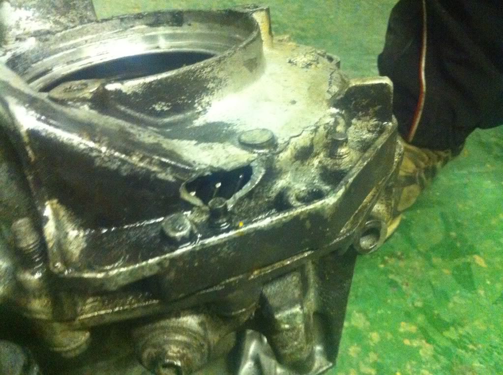

Box is deffo jammed.
Looks like its stuck in first gear but with the reverse selector ...erm selected becausae im a numpty. Cat get it out! jammed fast!
Got engine in car anyway, dont know if it even runs, as the guy who was fitting my chip carrier had gone out to work yesterday untill 3am. So....we can turn the engine over with the starter...but thats it. :(
Hopefully will get further today but its looking like i need a new box :(

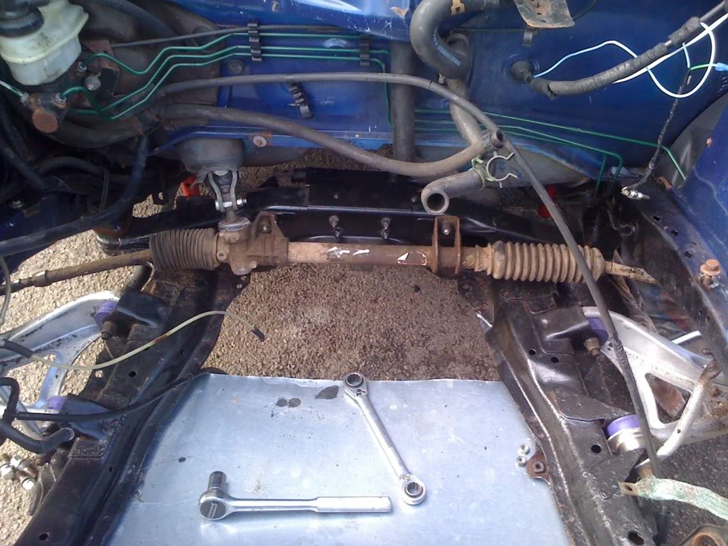

Manual Rack and column fitted to the wide track!

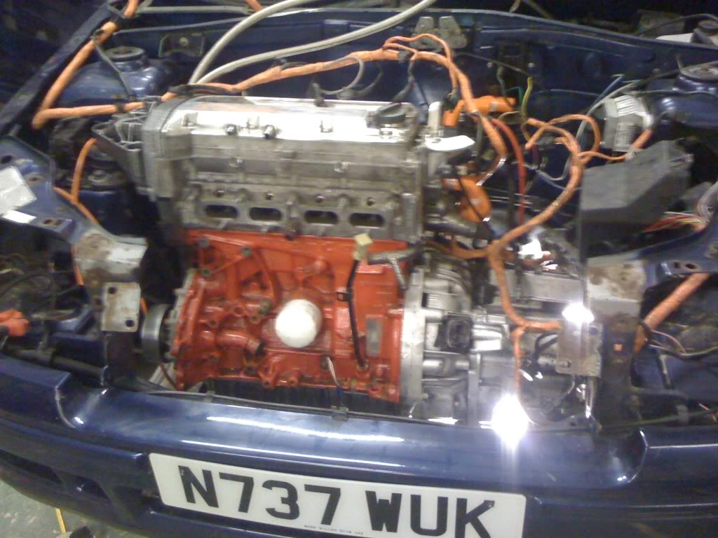

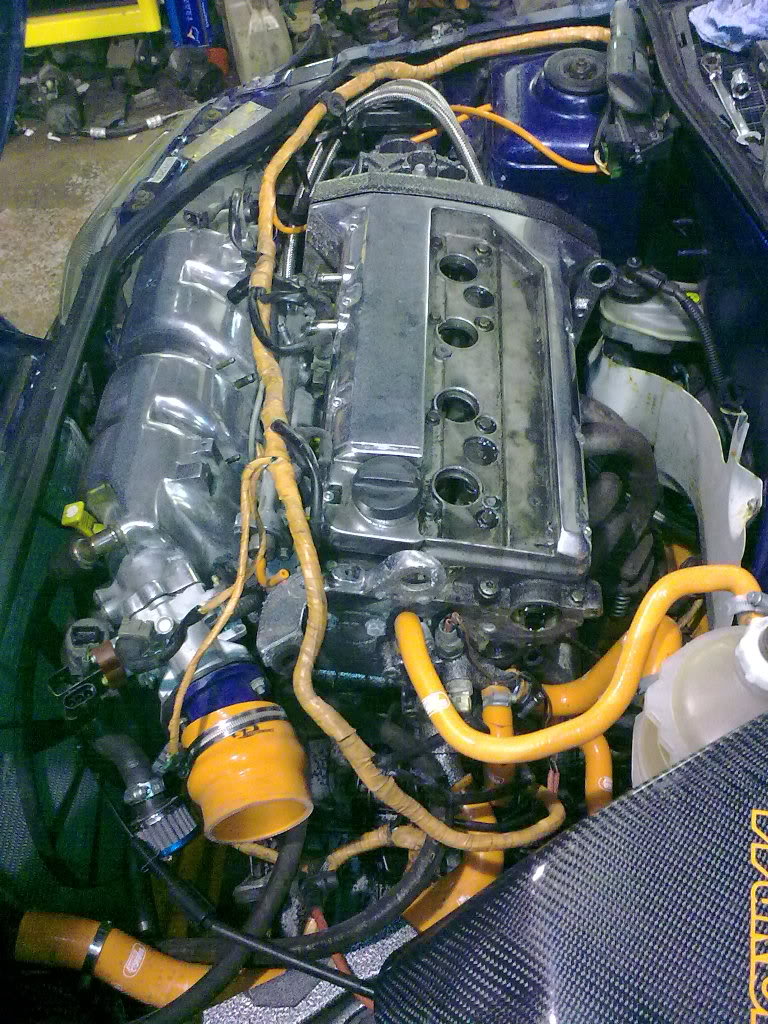

Loom being plumbed back in..... at this point im now noticing that the loom is actually more of a peach colour than a orange colour!
Engine in! Woop!

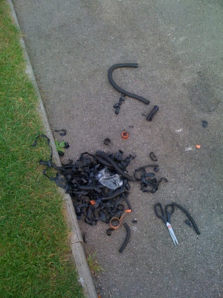

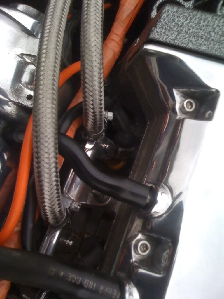

Old finishers replaced
Old Jubilee Clips
Systec Hose Finishers

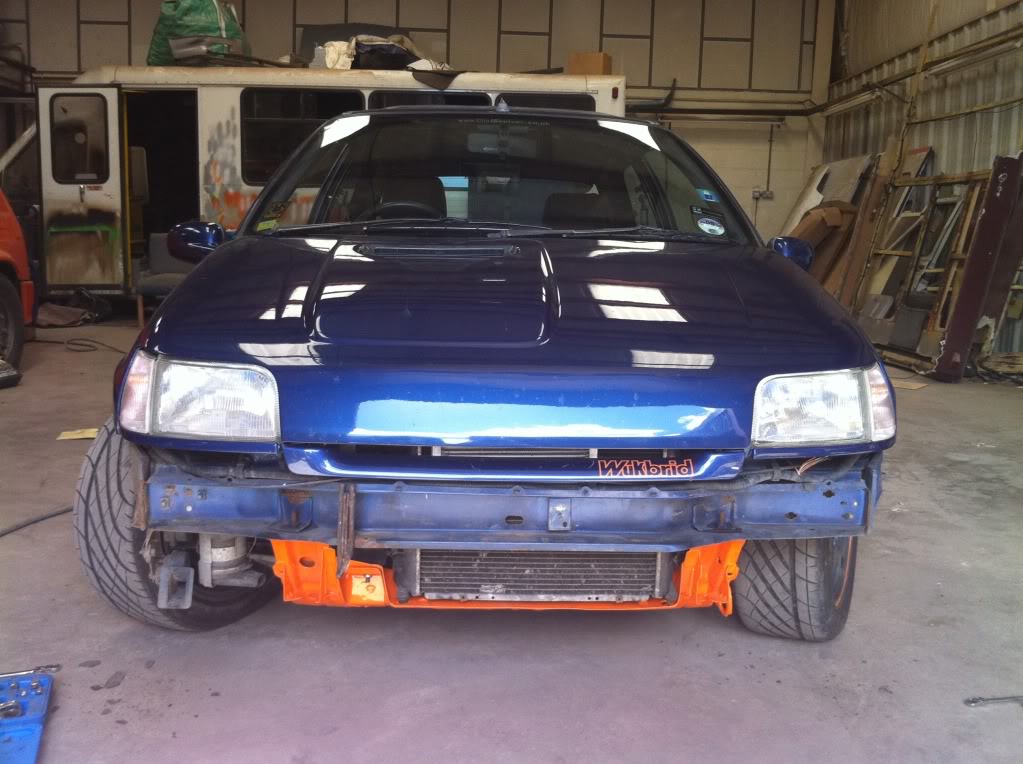

Car looking evil with no bonnet

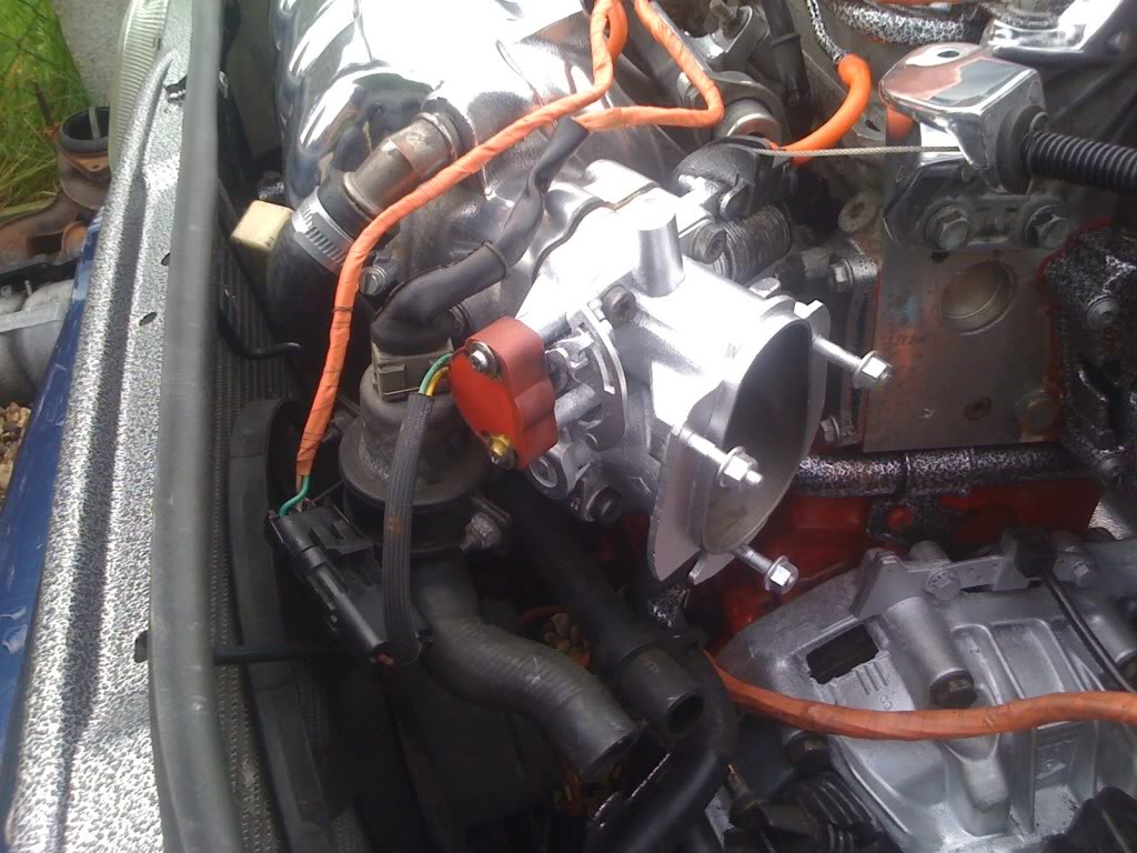

Throttle Body did kinda let the enggine bay down....especially when coupled to a highly polished inlet
Before
After a bit of Z magic!

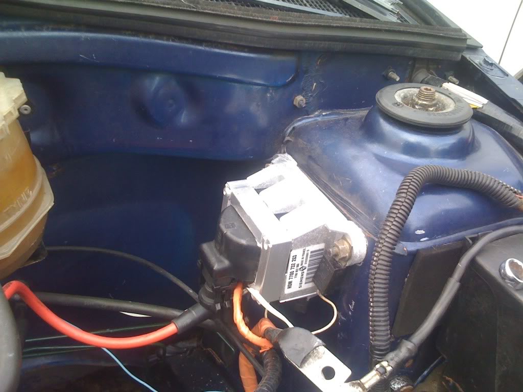

Also my Coil pack was also looking a bit shabby too! and also if you see the way its mounted means i cant get a strut brace in their either!
so again after a bit of Z magic its been painted and rotatedleaving plenty of room for a brace!

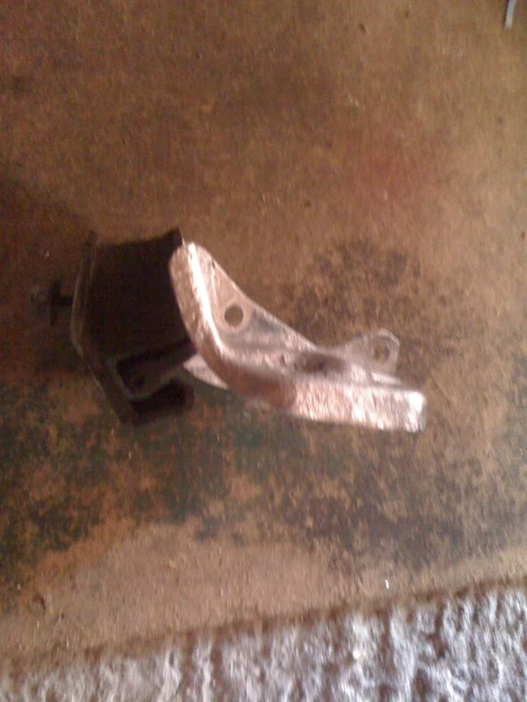

And a 4th mount!

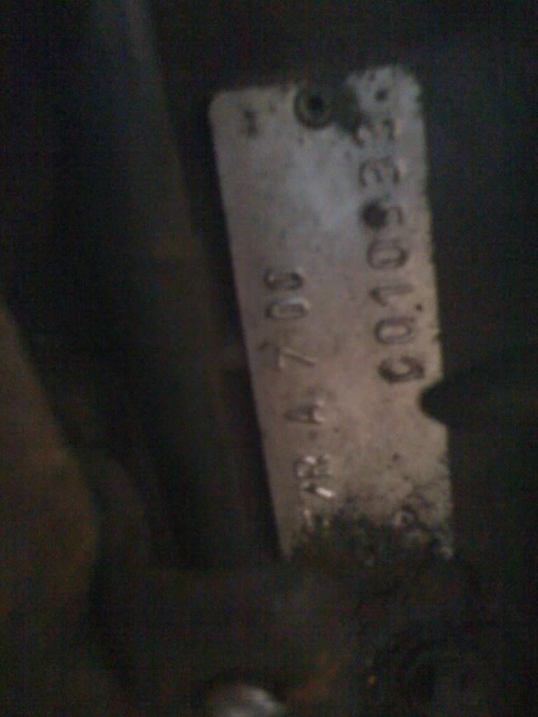

Right then! Update... most know, the engine i fitted was knocking like a b*****d. thought it was tappets to begin with. but alas...no
Sooo I decided to stop fannying about and look for a propper F7R A 700 which i found in telford with a man called dan.
A trip to telford found this blokey with a car in primer paint... tbh it looked a bit of a dog, the stupid sod had removed the sunroom using liquid swartz. :mrgreen: Think the car was going to get painted Brands Hatch Red? but i dunno.
Annnyway
here she is.....filthy isnt she

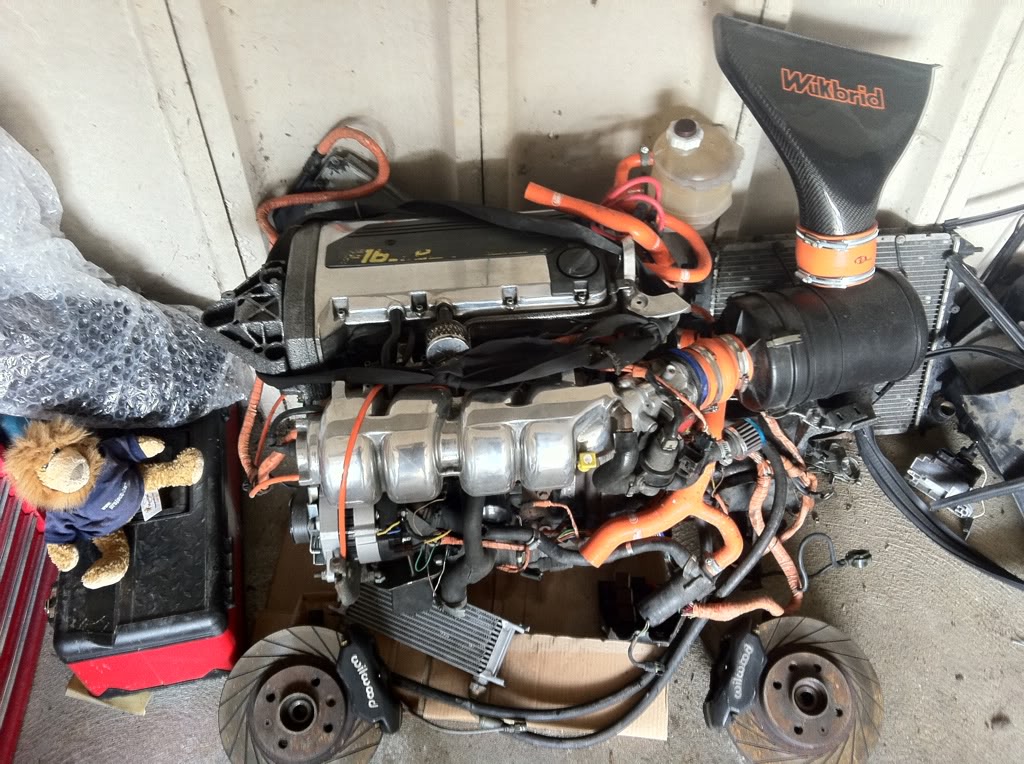

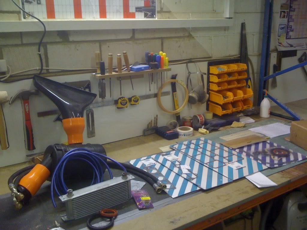

I ordered some parts

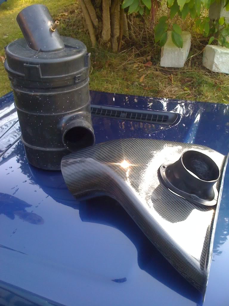

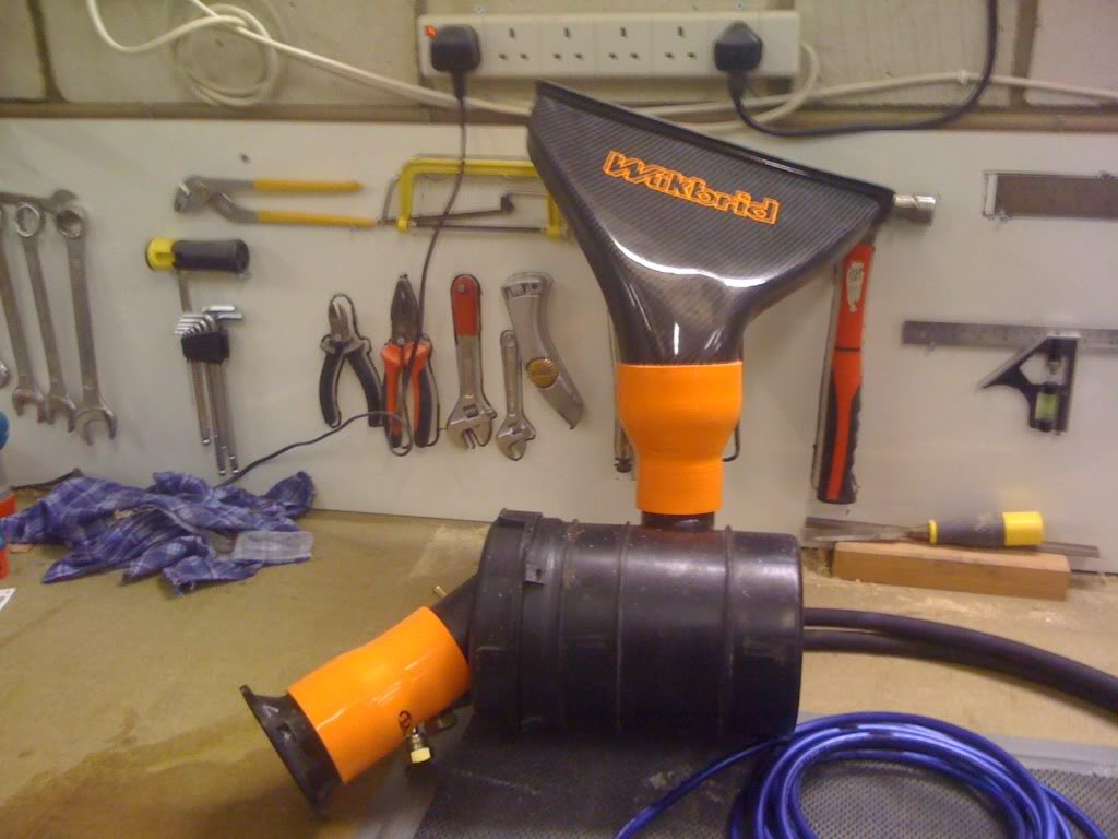

My Group N Skuttle Induction
Oil Cooler and Mocal Sandwich plate with UPRATED oil lines.....330BAR or 4750psi

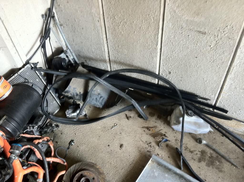

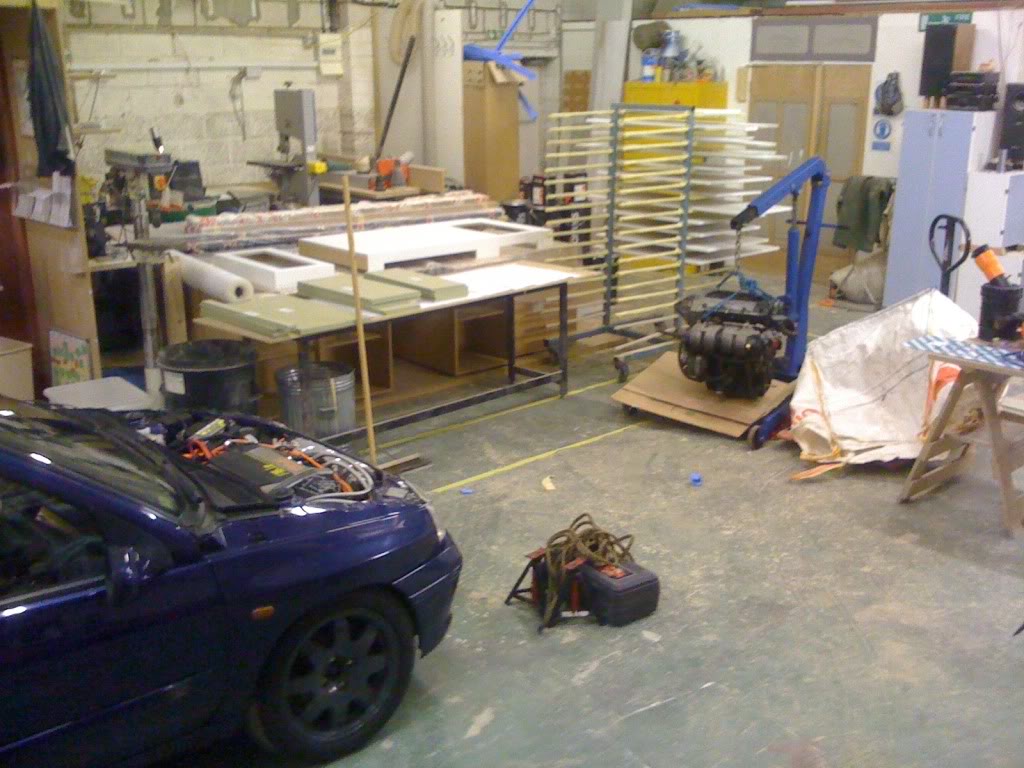

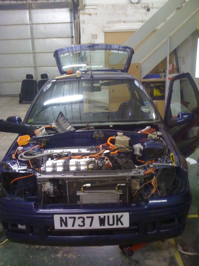

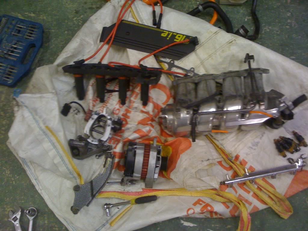

I moved the car into the workshop and started to remove things... lol
Moments later
mmm still clean

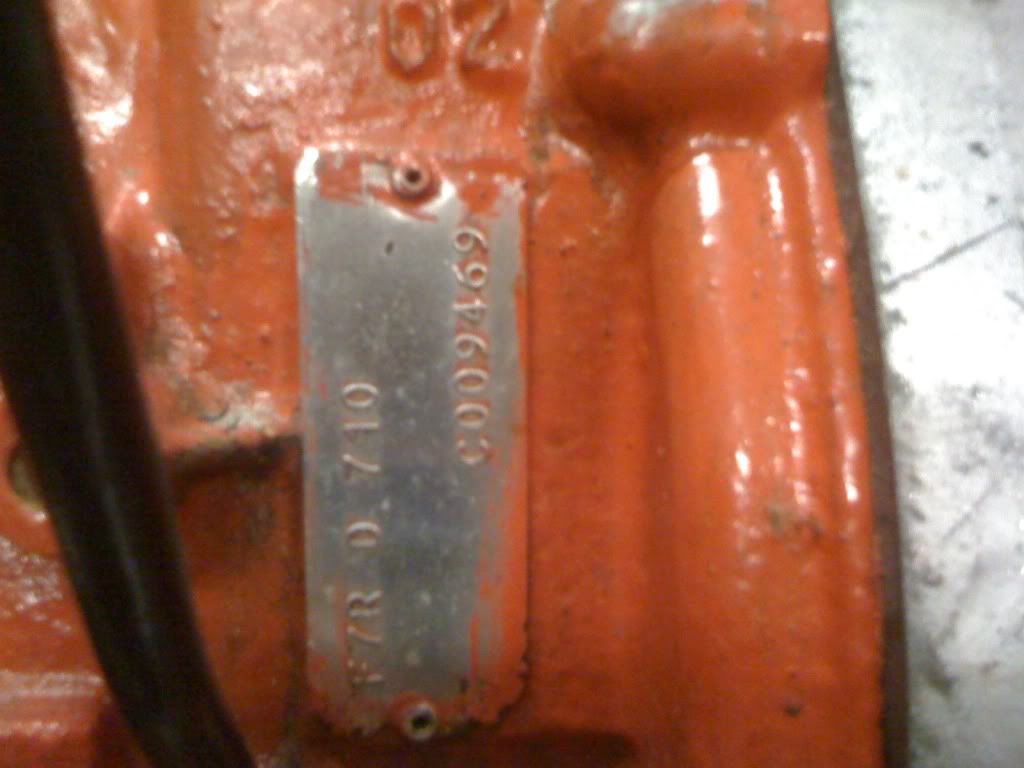

Inferior F7R D 710

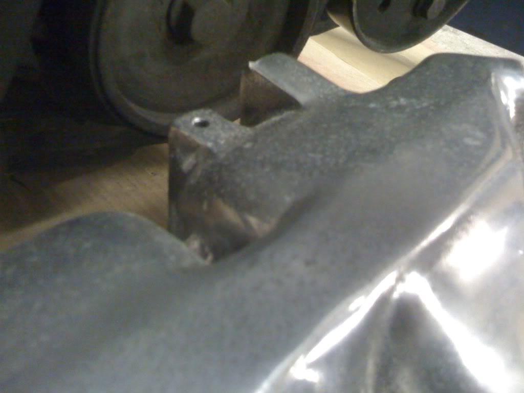

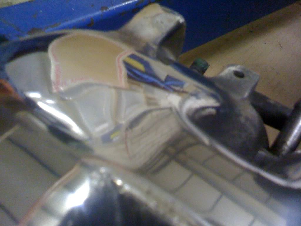

My polished stuff had started to dull

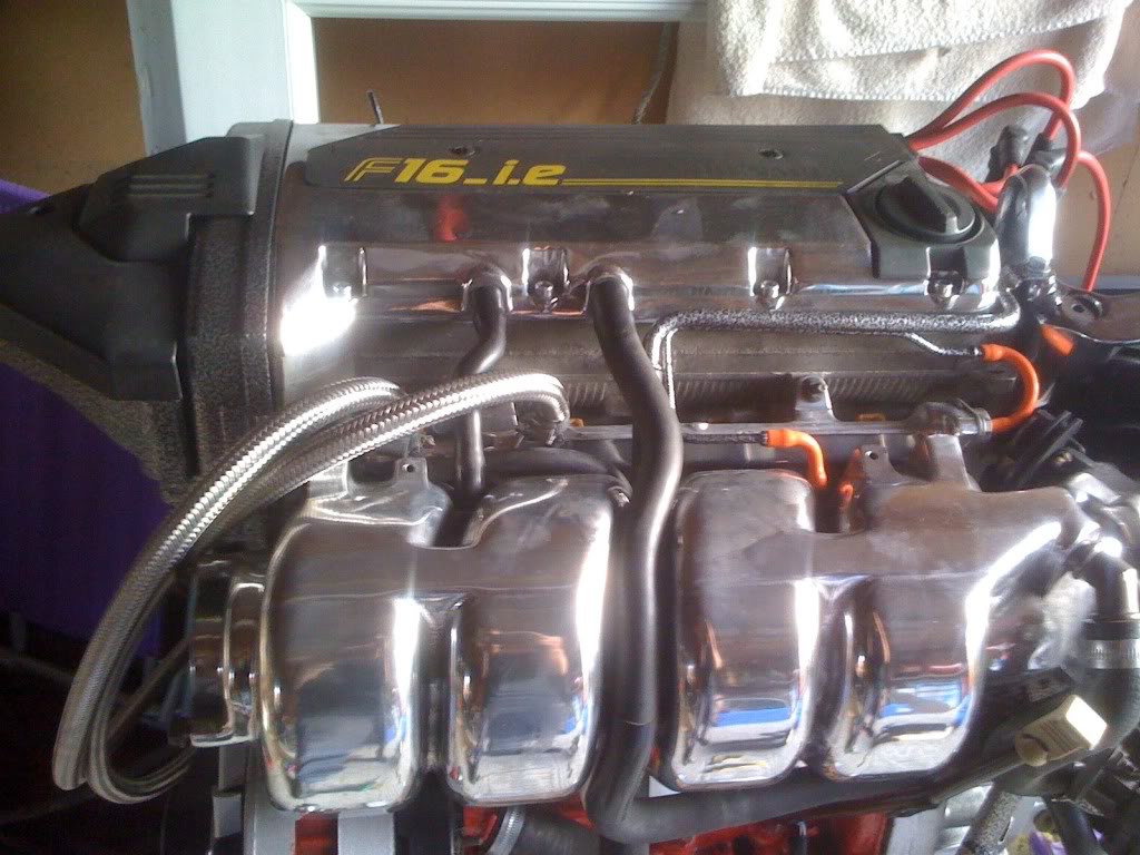

Soo a quick going over with my custom washing machine motor and polishing mop later
First inlet has been done other three remain dull.... hard to photo graph

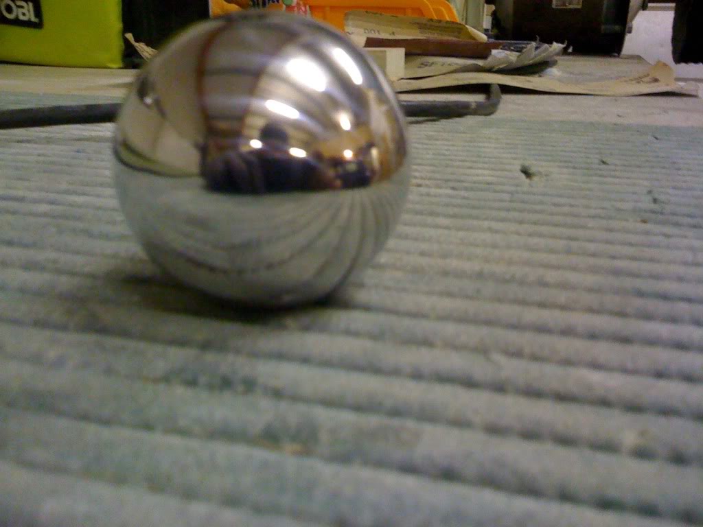

I even gave my knob a polish

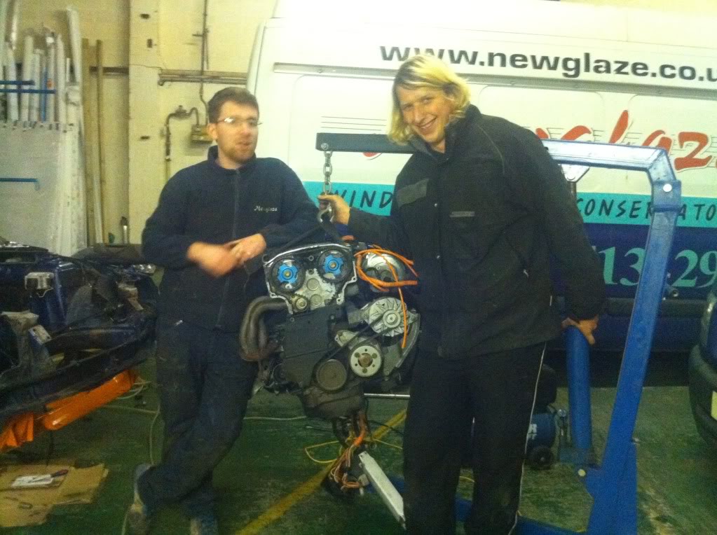

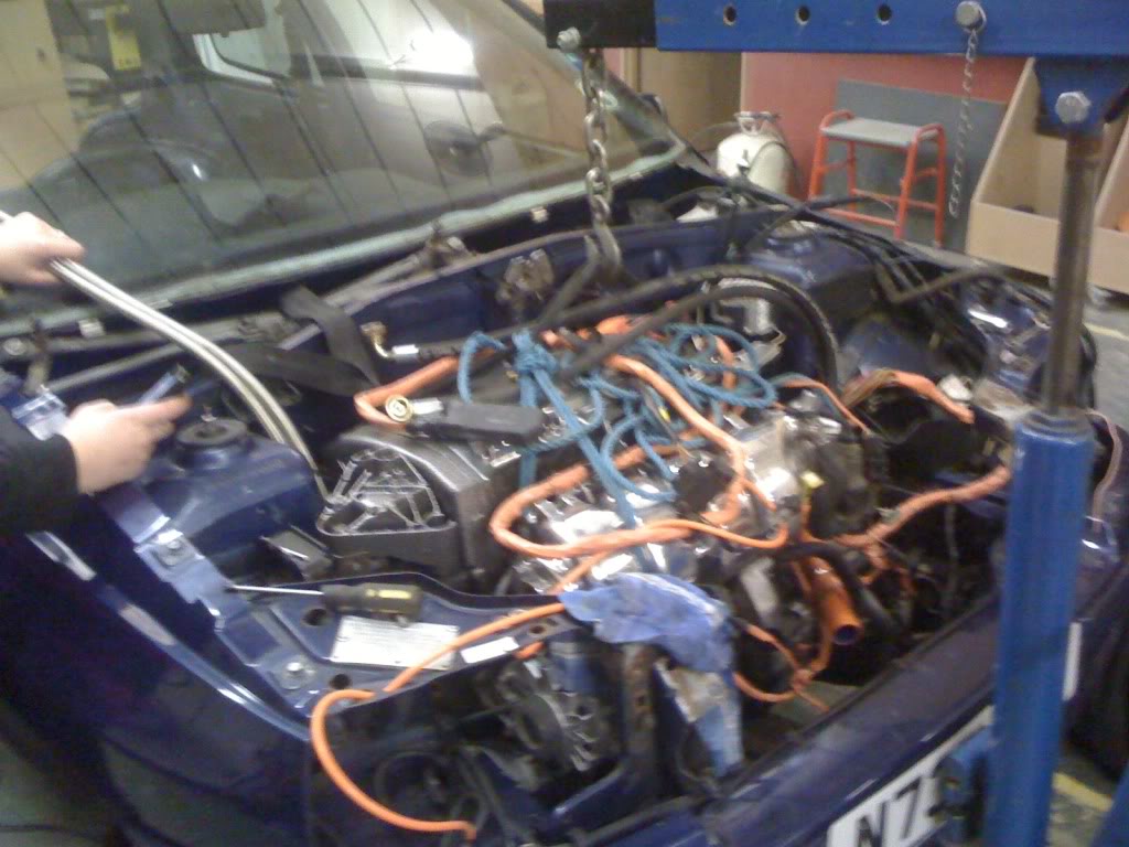

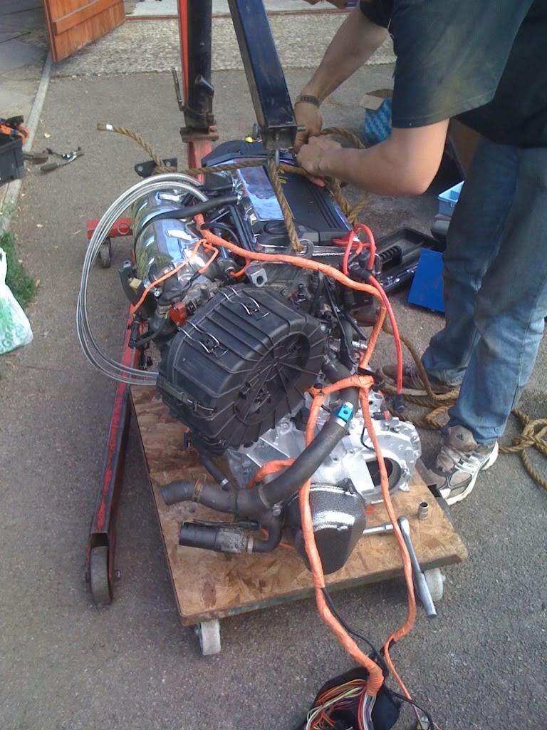

Hubs were removed and shafts out, then all unessesaty things dissconnected then crane in and hitched up with an old seatbelt and engine removed......

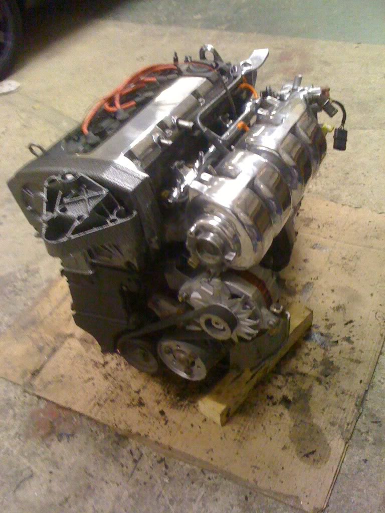

we then spent a few hours removing all bits off the old one and fitting to the new one.
Old and New
New engine complete at which point we for the first time realised we should both stop and go to bed as it was 4AM!!
From this
To this
The next morning yes MORNING 8am to be precise after a mere 3 hours sleep, we got back to the workshop and got cracking.
Removed the interior seats.......
had to change the clutch pedal and it was easier to hoover lol
Then lesley got her funk on with my willy wheels.

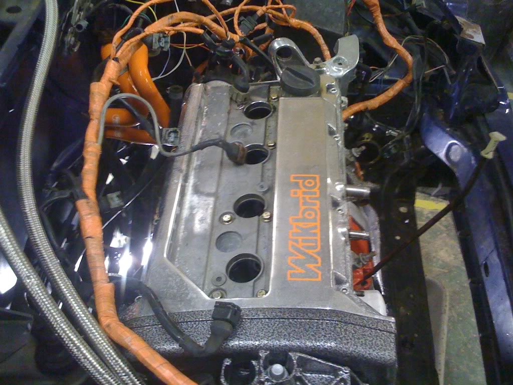

and now started to re-fit the engine.
with an added 4th mount.....
as you can see here.... lesly got very busy
engine in

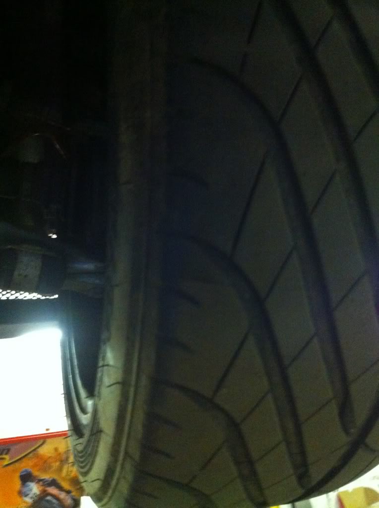

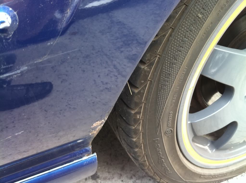

004: nearside fron brake hose fouls wheel on full lock
005: nearside wheel is excessivly worn
how the frig do i sort out the lights?! no idea im gonna get them to do it and just fit a non blue bulb!

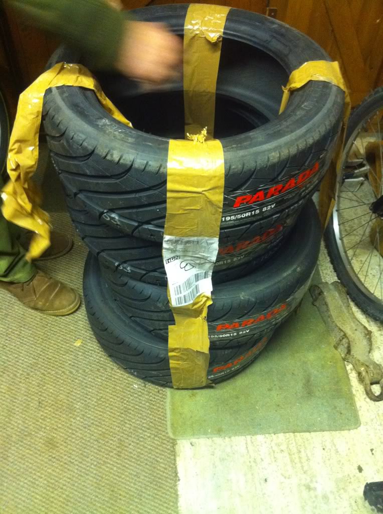

Ive had some willy shocks delivered to me now aswell..... wassnt going to fit new tyres with camber like that tbh! So some nice willy items will do.
Going to my mates next week for tyres and balencing, should my tyres arive in time.
Brake hose will be fixed with a cable tie or one of those round spacers i have on the other side hose?

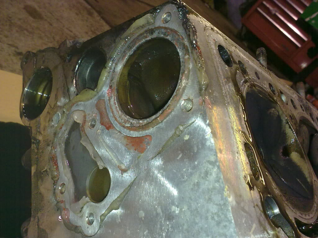

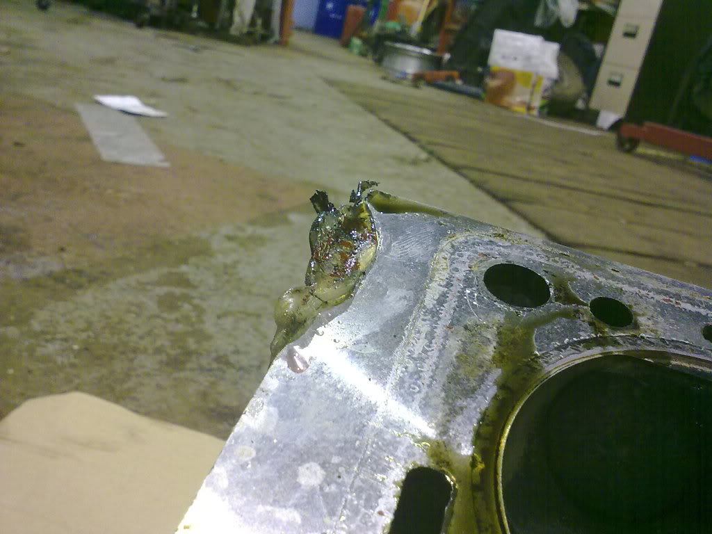

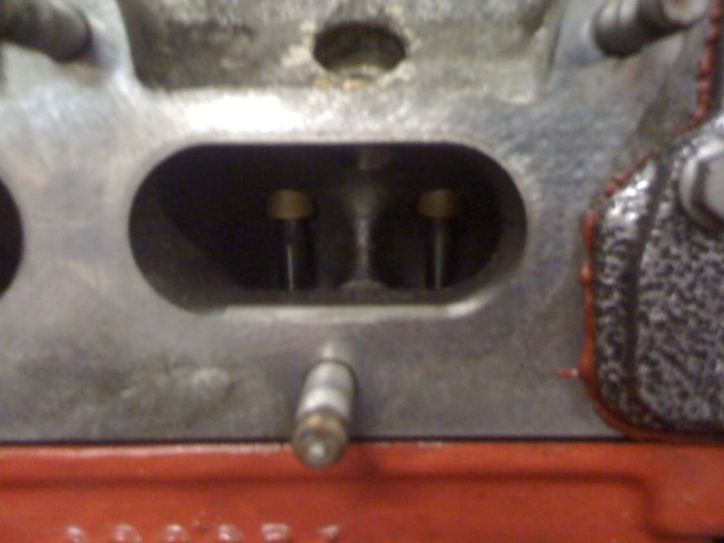

Basically the Headgasket failed and the car got me really ****ed off tbh, so i thought fudge it. and took her to Jday Engineering (www.dayspeed.com) and got them to sort the bloody thing out!
So while she was in there i got a few things done...rude not to init!

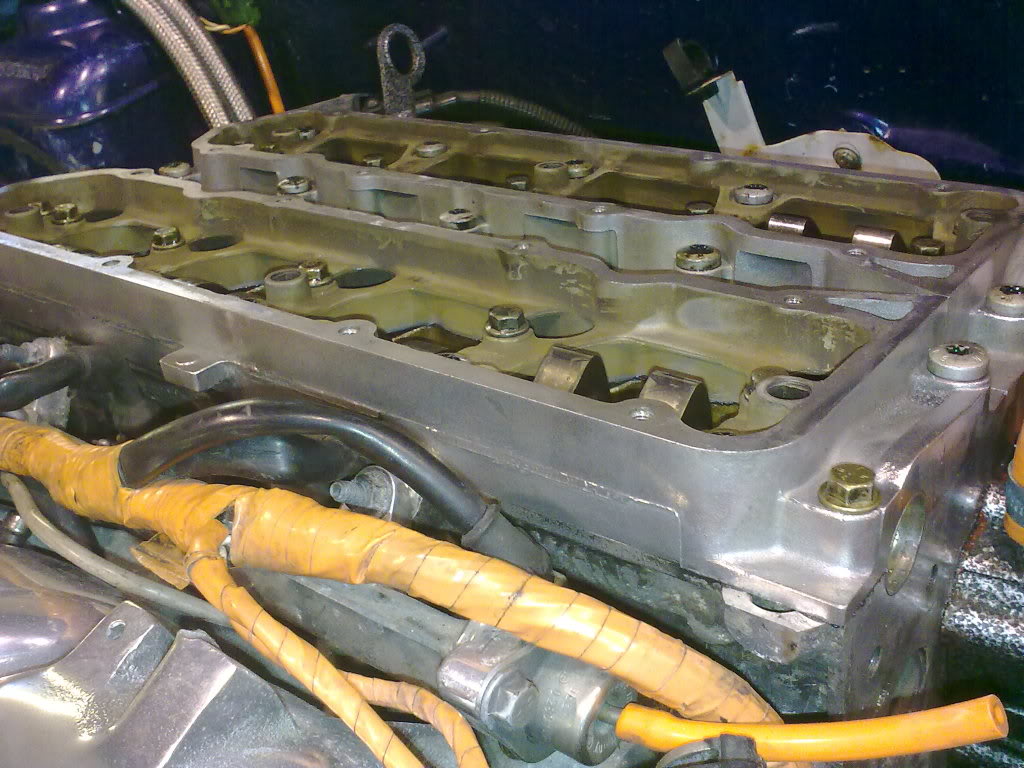

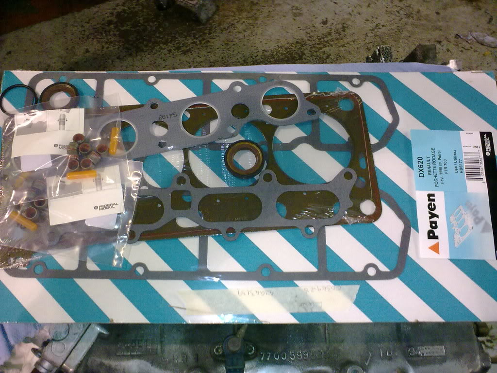

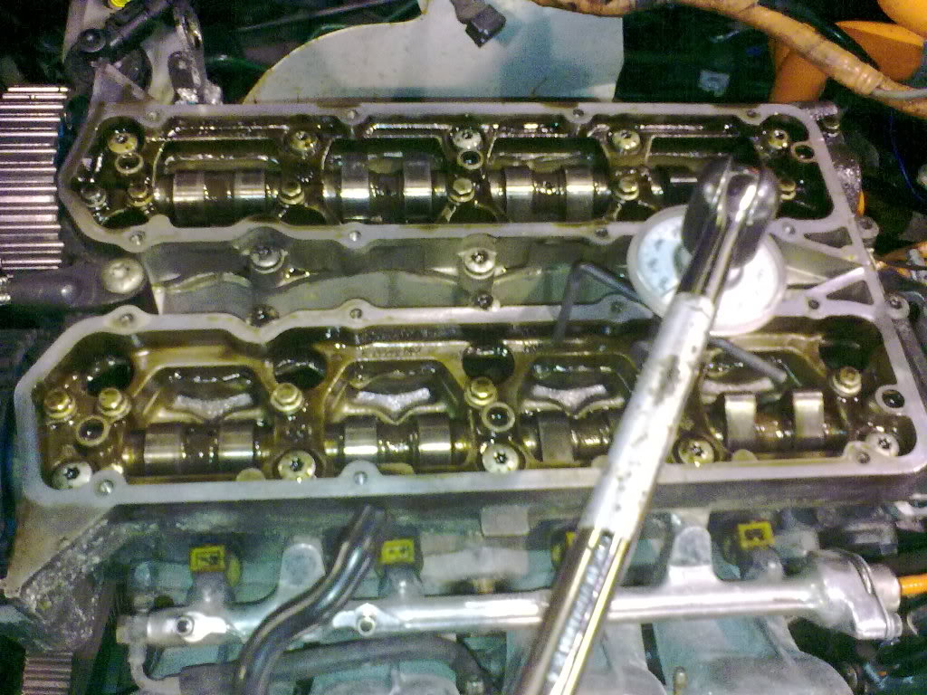

new headgasket uprated steel kevlar gasket

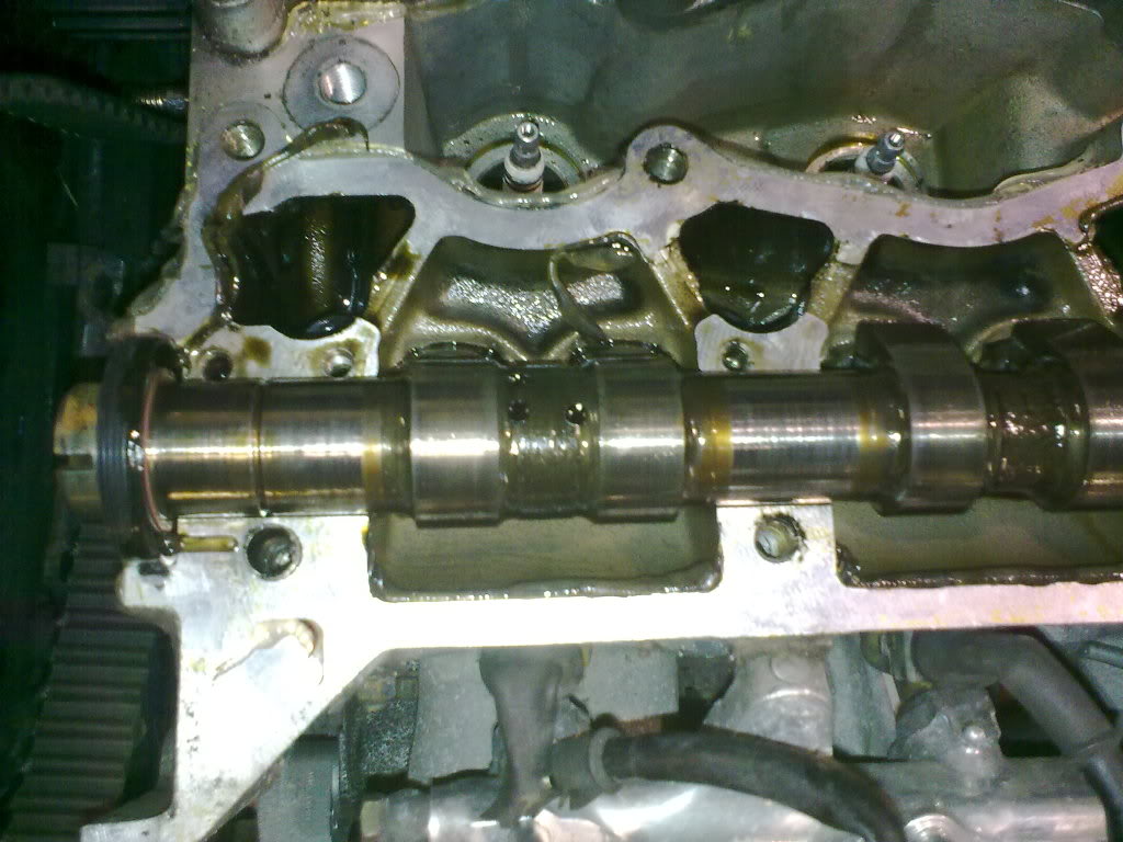

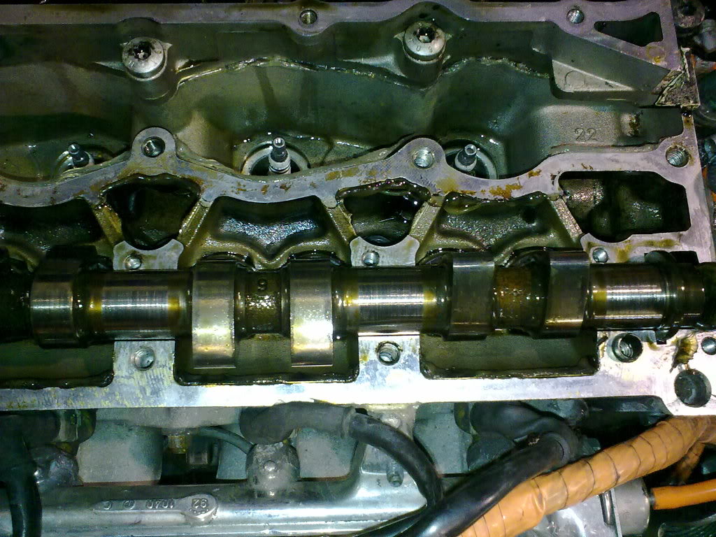

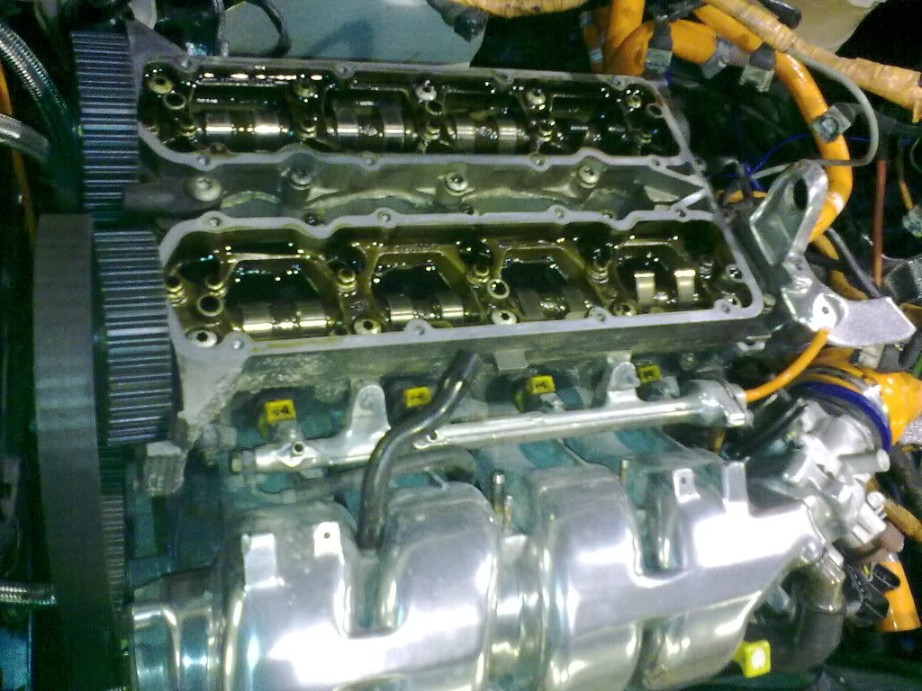

head skimmed and rebuilt with new stem seals (bit smokey on over run)

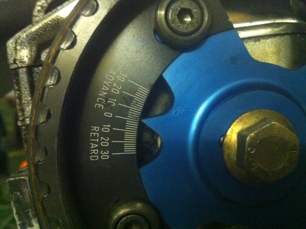

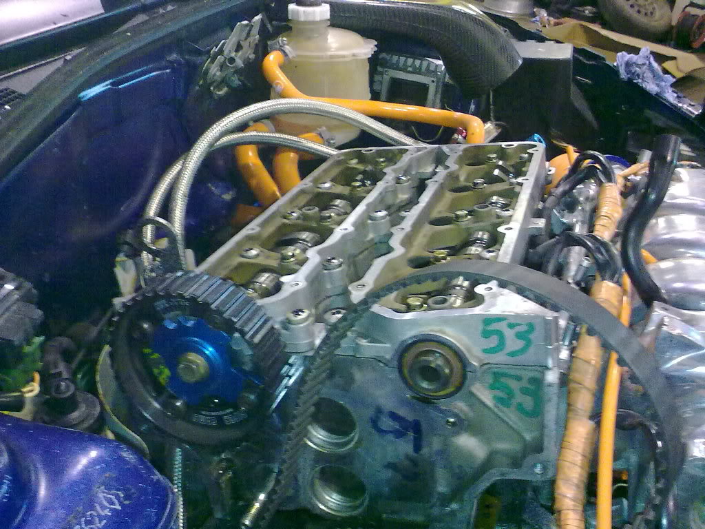

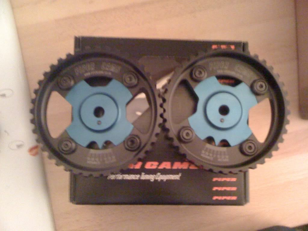

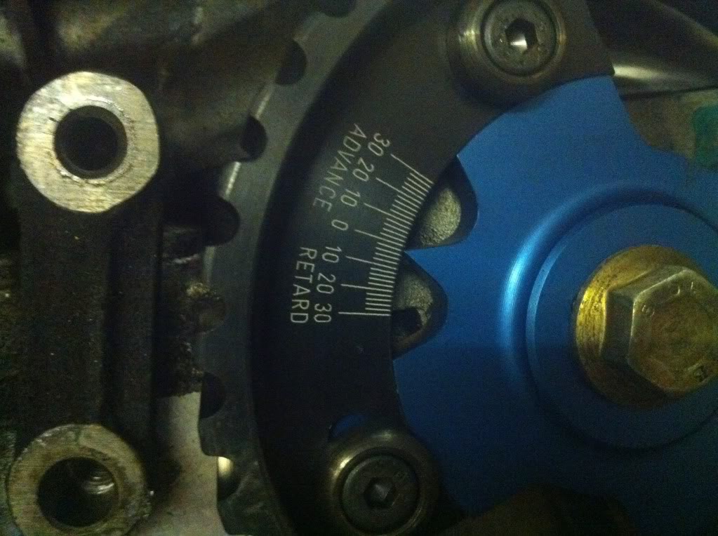

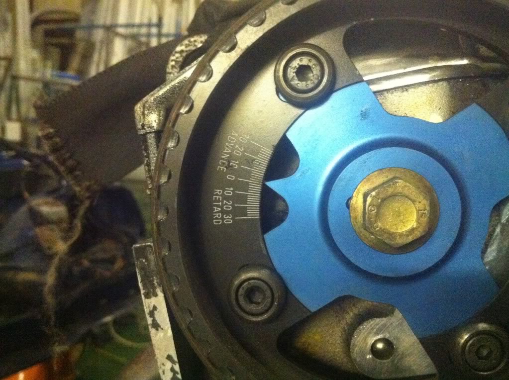

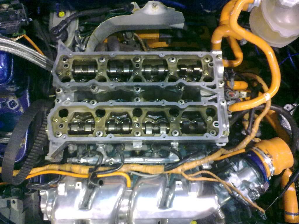

Piper Vernier Pullies Fitted and timed up
Kent Cams RN2002 260* cams fitted to the above
a custom made "foxys" 5th mount
Everything rebuilt and a good checking over.

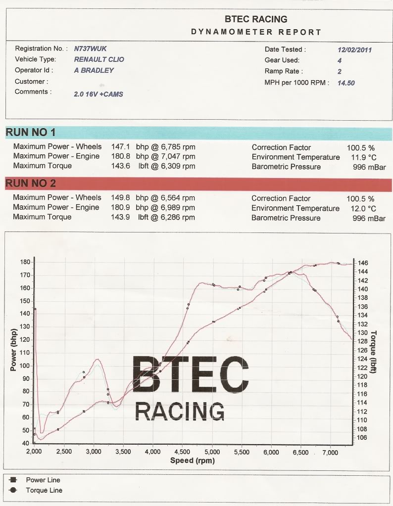

Well they have possibly the worst suppliers in the world but their work is very good indeed. They have a "we can do it" attutude which i love!
Their reports were...."**** this thing shifts" engine conversion is very tidy, and apart from a loose water temp sender (DOH!) very solid conversion!
£699 well spent!
My report.
5th engine mount, wow what a difference! engine dossnt move! gear changes feel fantastic! Reaally really reccomended to any mk1/ 172 owner with manual steering. completely different!
Cams and Pullies

new Group A induction

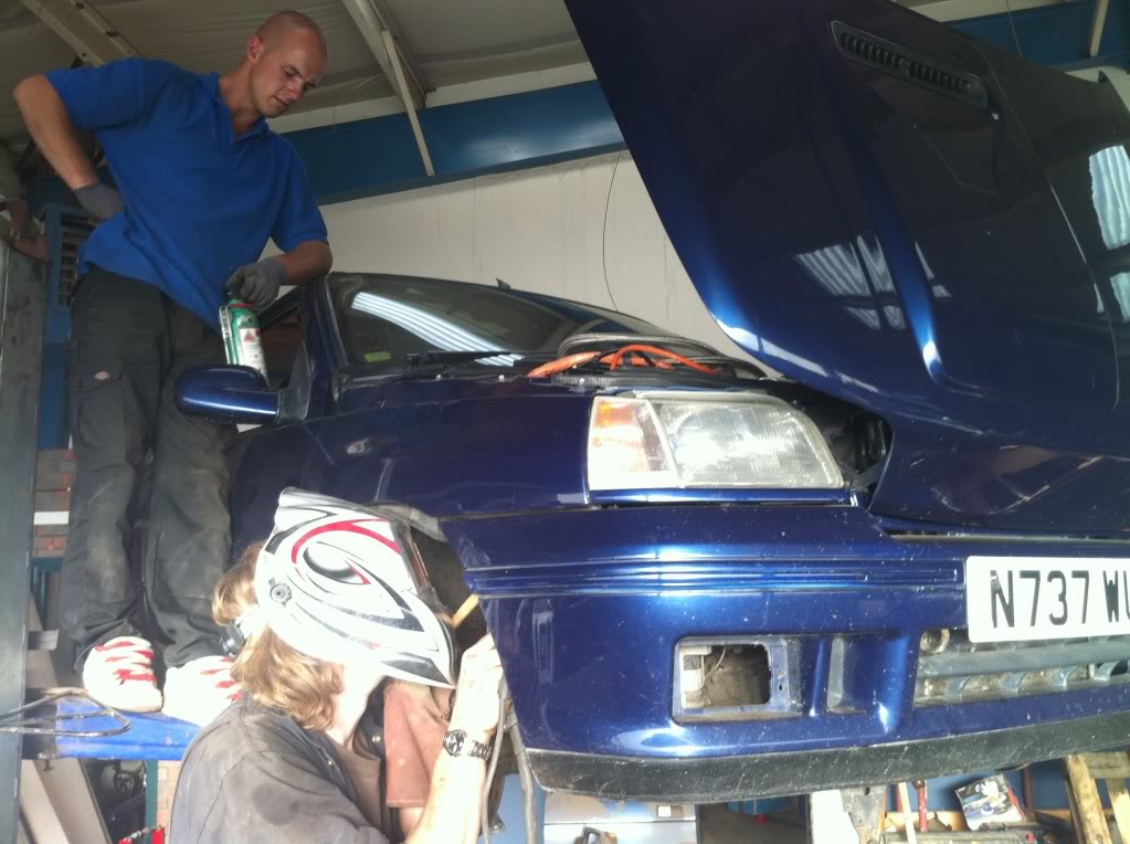

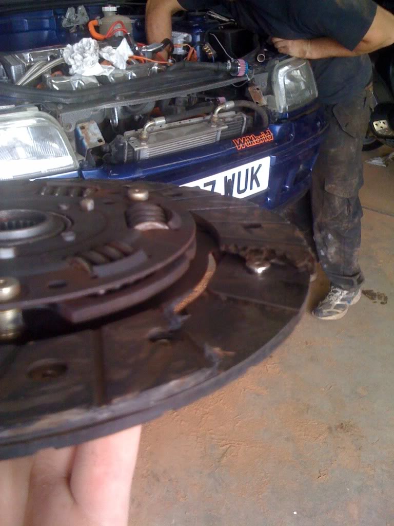

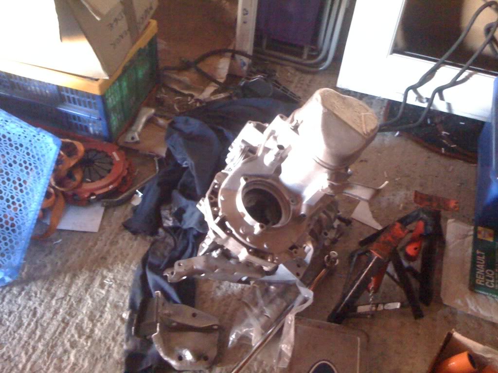

Fearing a blown box but not quite managing the style that The Naples did her box in!
nailed it off theline 1st..2nd...3rd... no 4th.... no 5th... no 3rd..no 2nd... then got 3rd....weird!
anyway after more inpection from the car it seemed i could get gears when the engine was off so maybe it could be the clutch.....

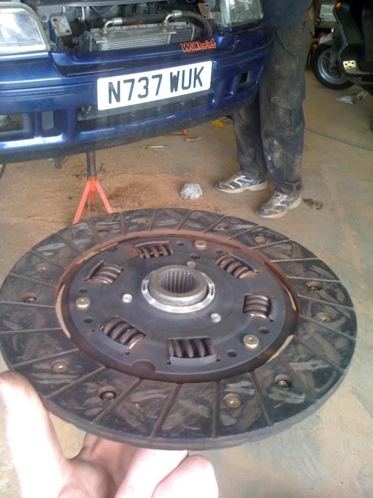

thought ok... ordered up new valeo clutch.... i received asaches one..... nevermind....
set about removing the clutcth...
looks fine....
turn it over....
oh maybe not..
Valeo FTL i think! hope the saches ones lasts loinger!!

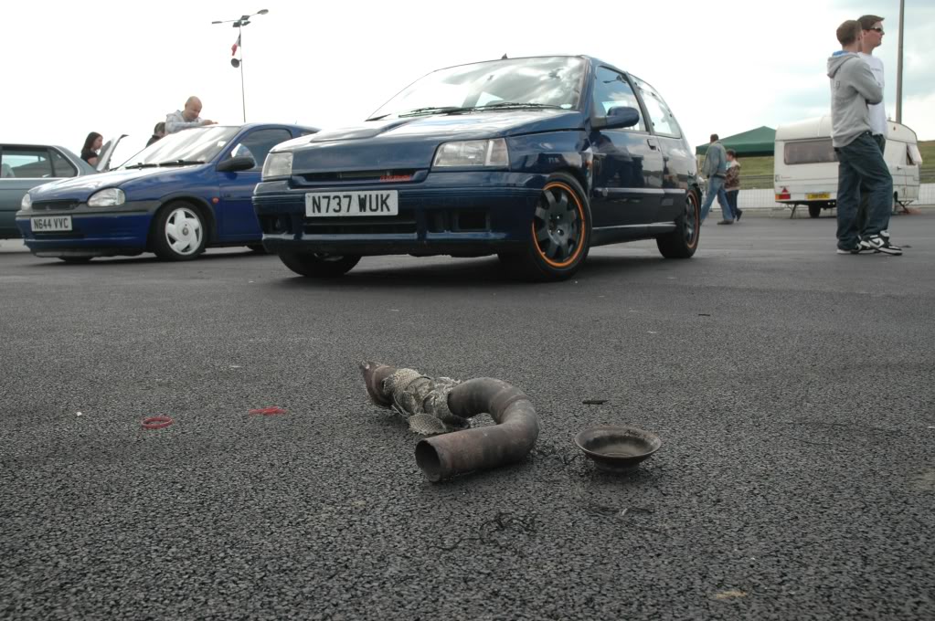

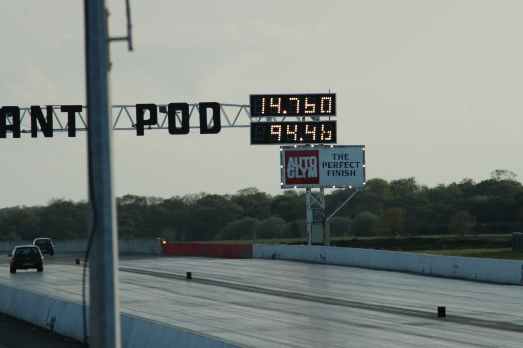

Downpipe FAIL at 132mph

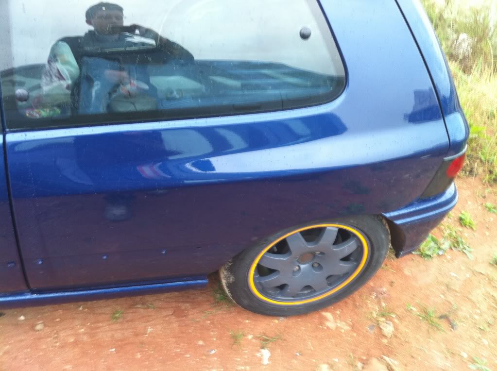

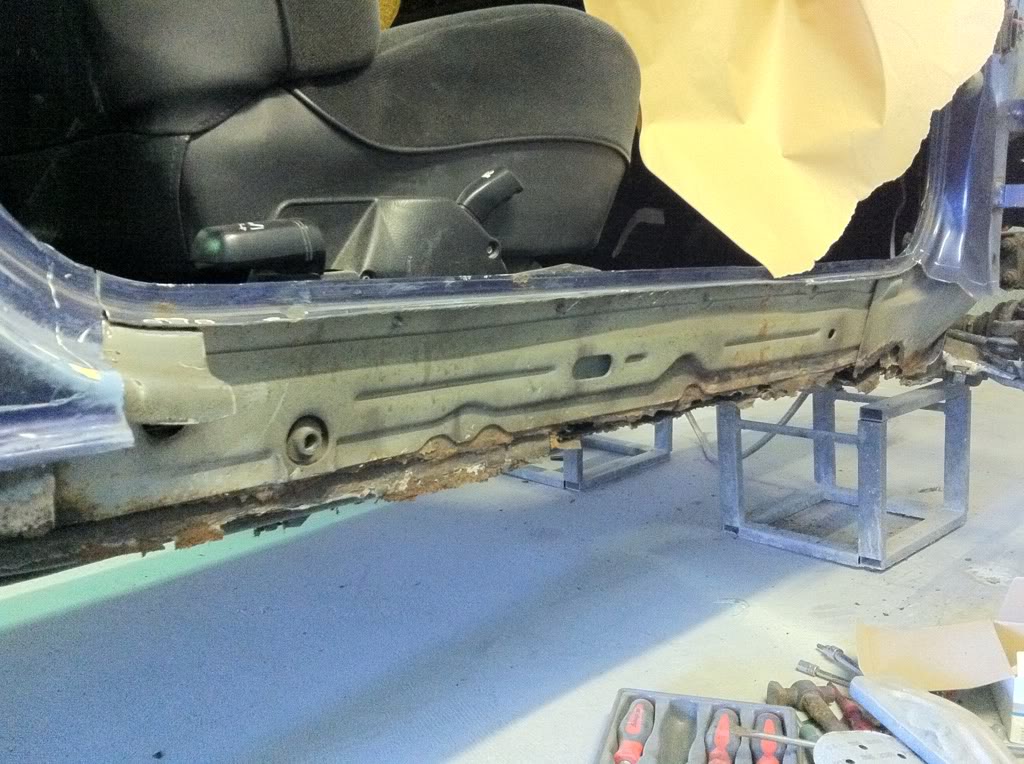

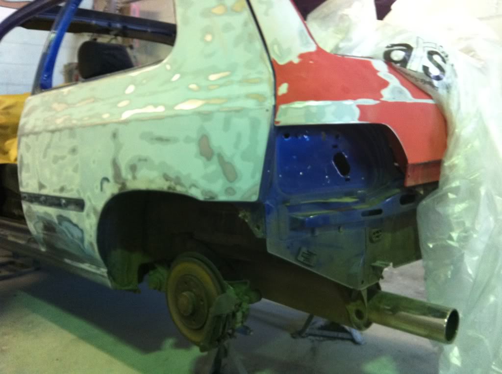

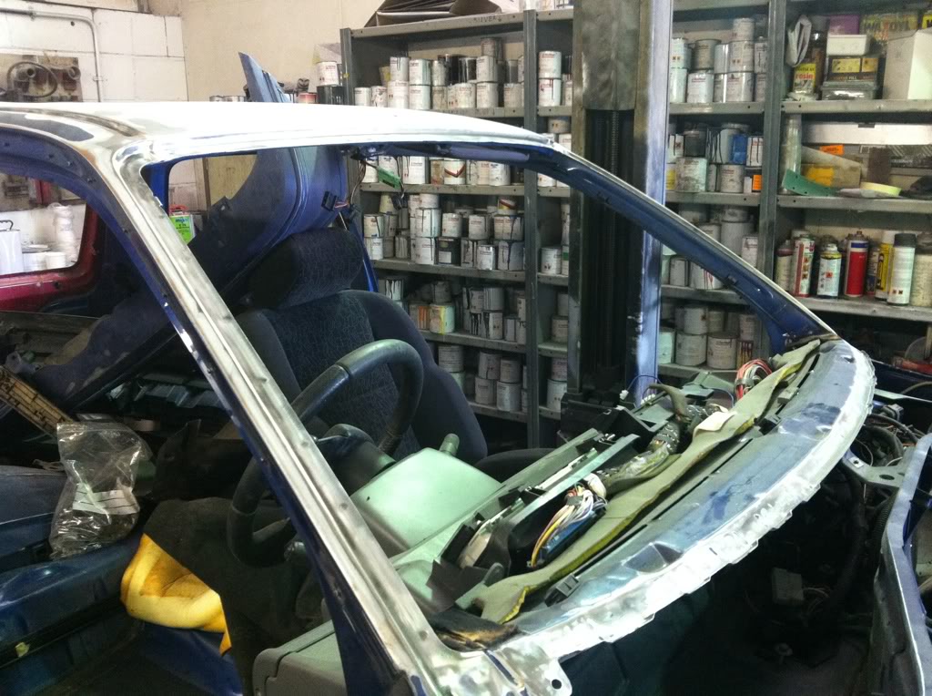

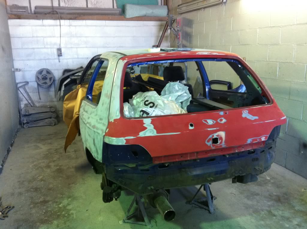

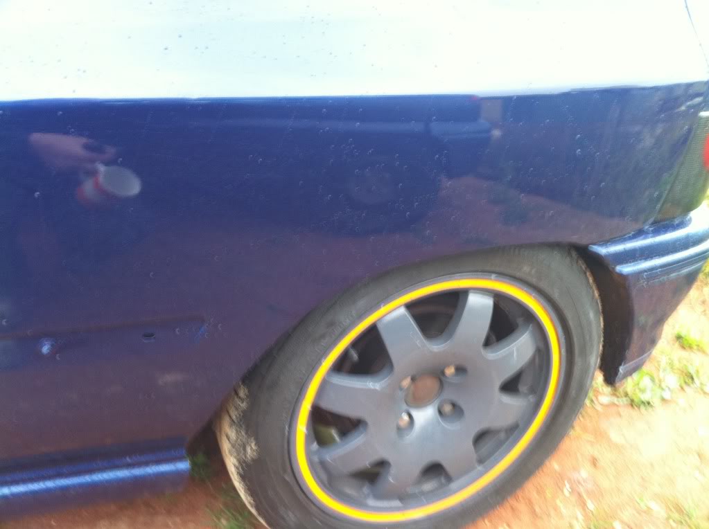

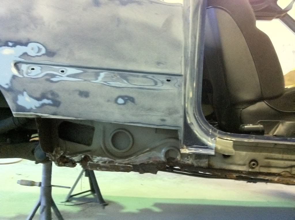

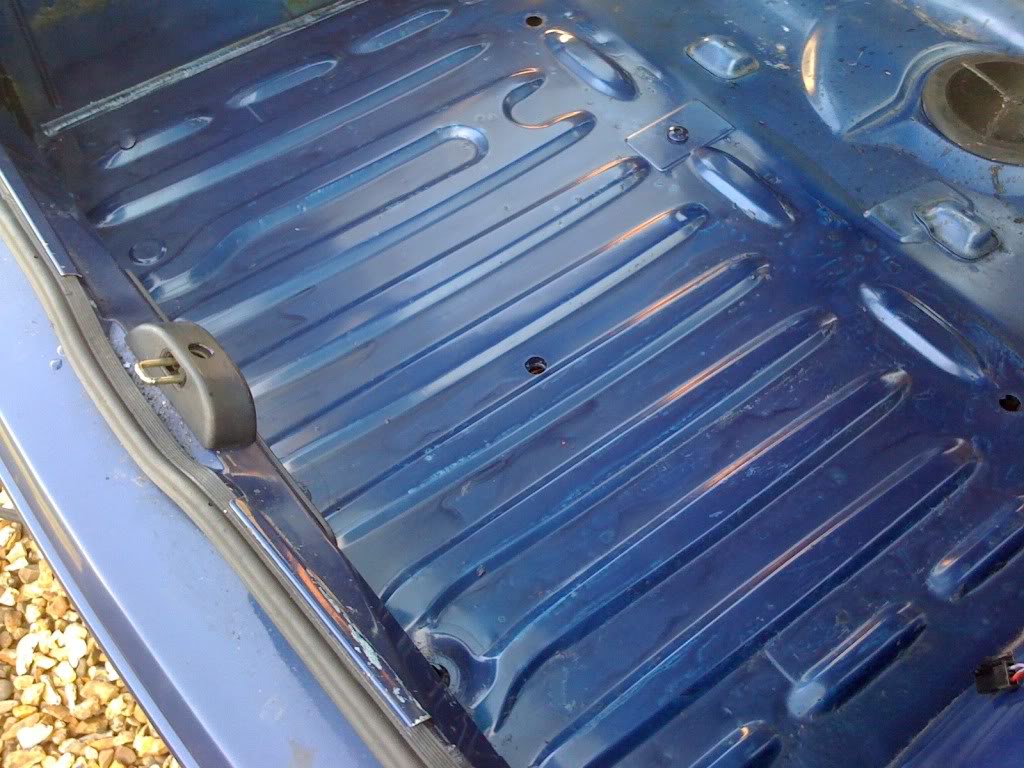

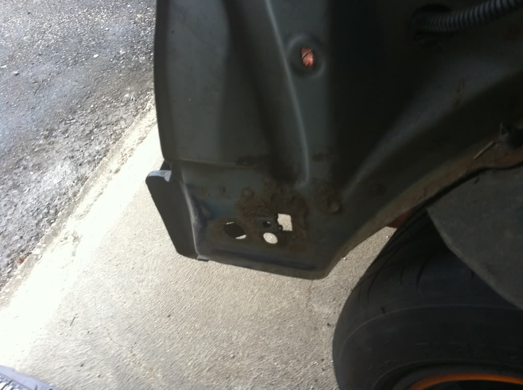

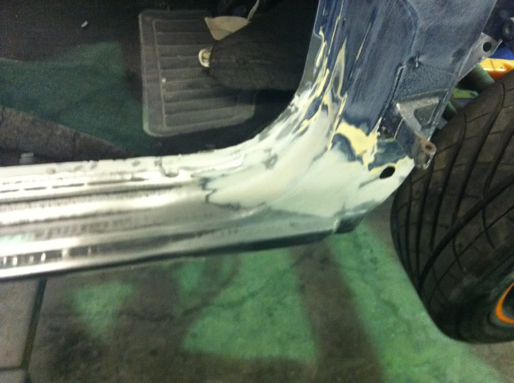

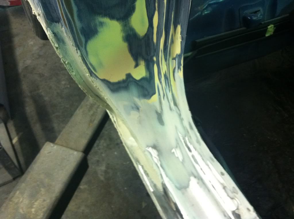

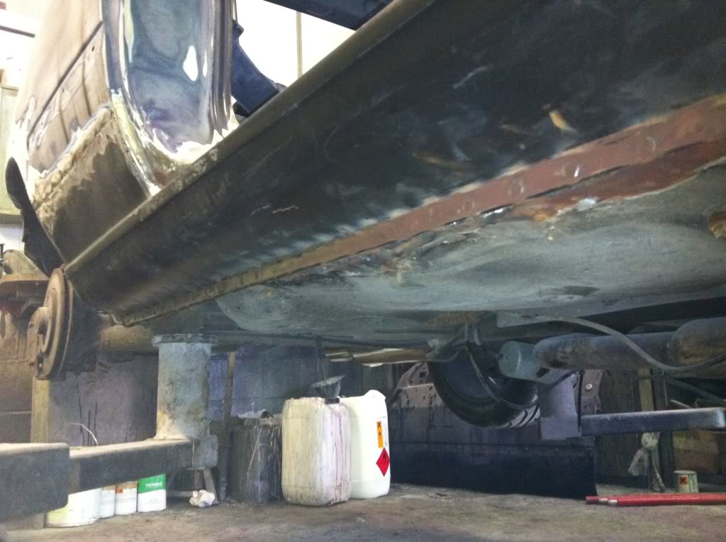

n to the bodyshop to remove any rust from rear arches

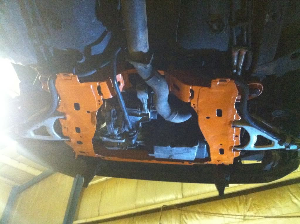

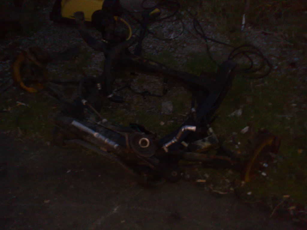

Then it was time to swap the subframe and exhaust
swapped to a valver subframe over a williams one as A its lighter and b... this one is orange.... i love orange
old subframe off
New KTM orange subframe assembled

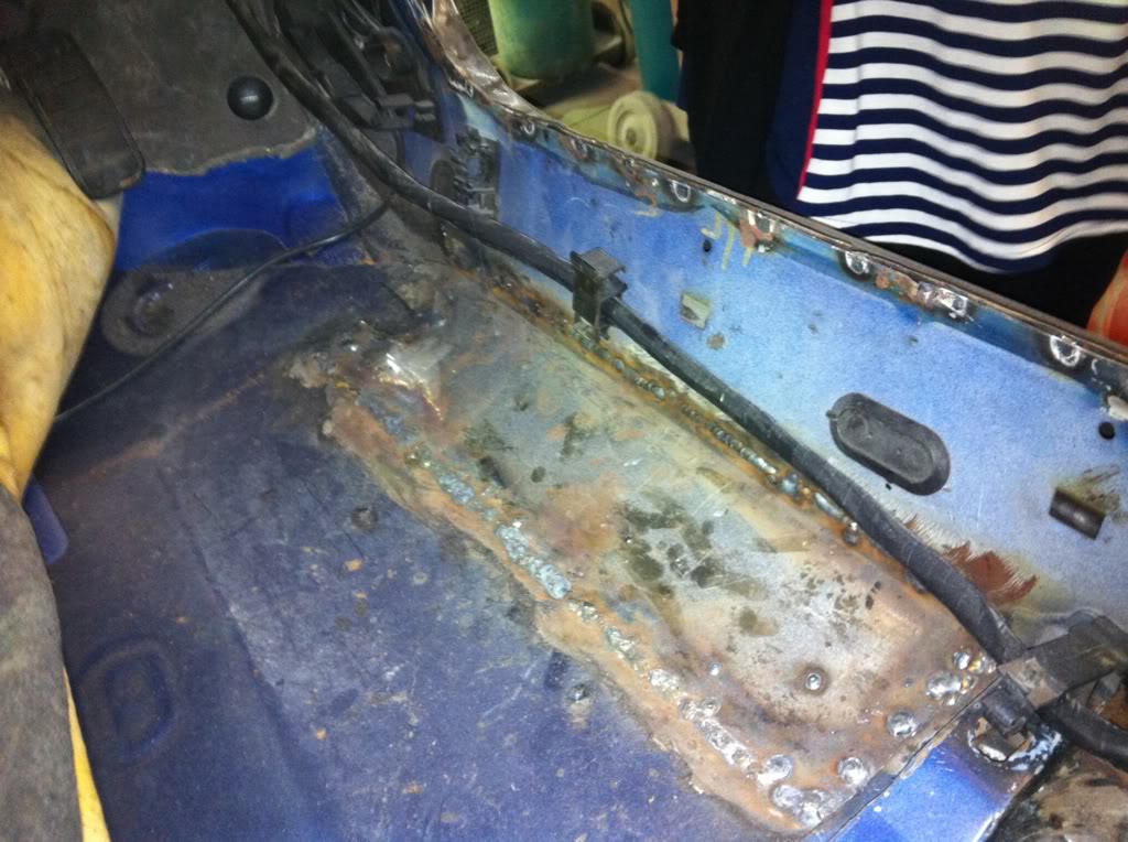

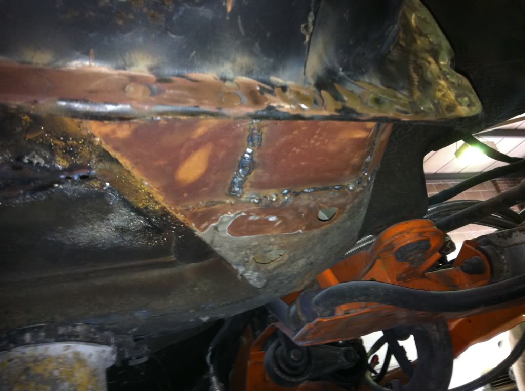

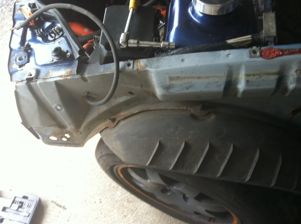

Found a small hole in the arch...
Mates with welders later
Gone

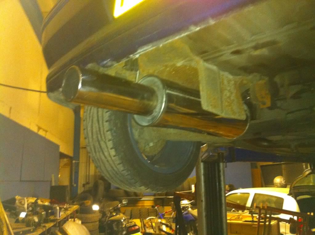

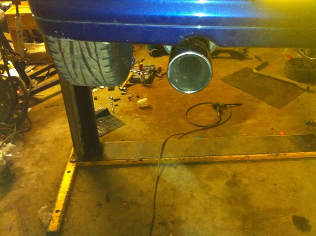

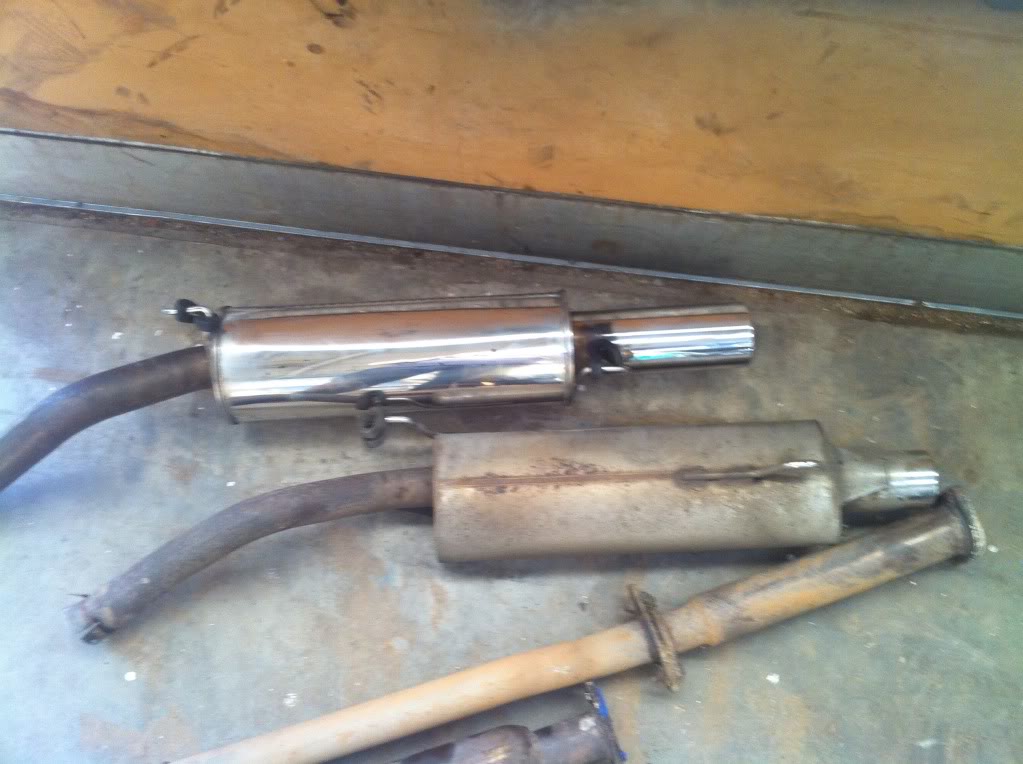

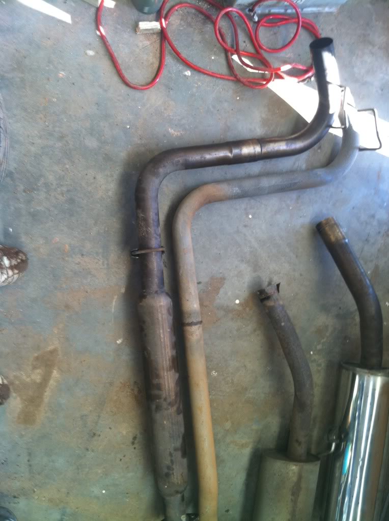

New Exhaust
(well second owner)
Its a Mongoose System it is the best system to have on your clio!
as you can see from the pics the bore is much better and has a box in the centre section
everything fitted

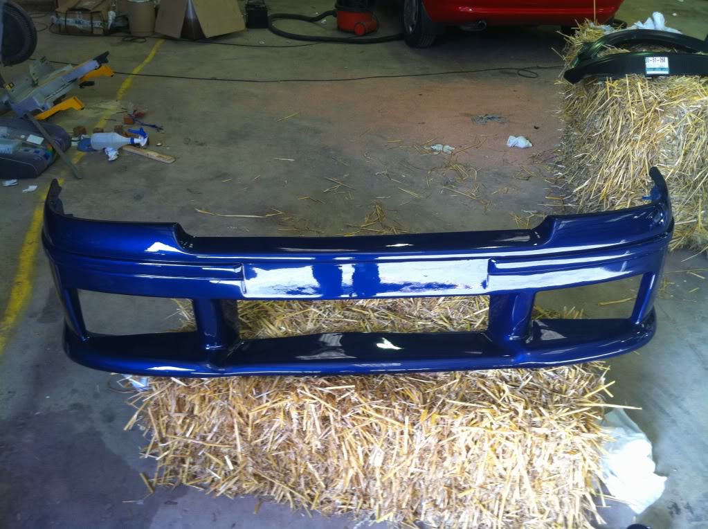

Then came the new bumper off an ex works rally car,
shitty state when it arrived!
But a mate with a compressor and an anal attention to detail and £40 later
fitting day
car in with old heavy stonechipped and scratched shitty condition bumper
bumper removed... oooh nice subframe!
New bumper on!

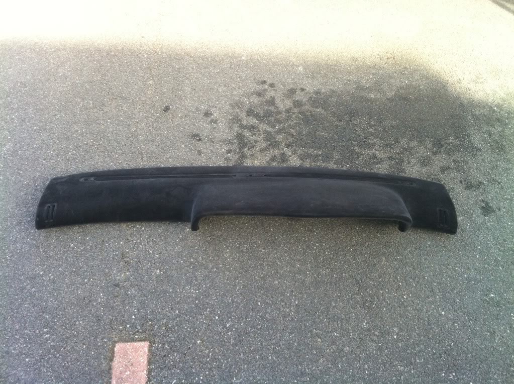

also treated my self to a flocked dash top: this is quickly turning into my favorite mod

another gearbox bites the dust
http://img.photobucket.com/albums/v104/zmaster2k/ce2980cd.jpg
So now went and splurged £570 on a reconditioned JC5-014 (genuine williams gearbox) with a custom bolt in differential that removes the need for a circlip.
Fitted this

ok time for an update as some of you are aware.. my car suddenly one day devloped a misfire and was only running on two cylinders, fearing a blown head gasket, i booked it in imediatly with the Cliolord!
car left my hands on a trailer (pimp: http://www.shiply.com) on route to the cliolord
car arived to him and in no time at all i was receiving text messages

car is quickly instsalled with a lift lol
airbox has been removed
engine mount and fuel pipes disconnected and cam cover removed
Fuel rail disconected

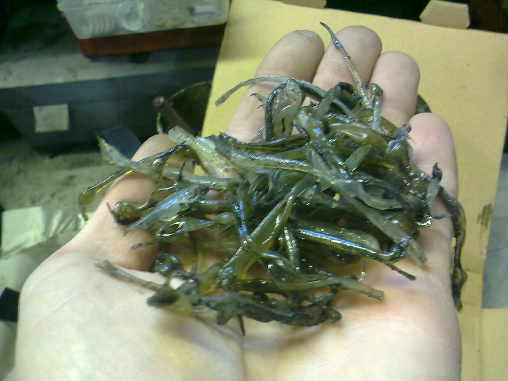

Silicone (ill get to this in a min)
Bottom end locked off and cam belt removed
Camshaft cover removed

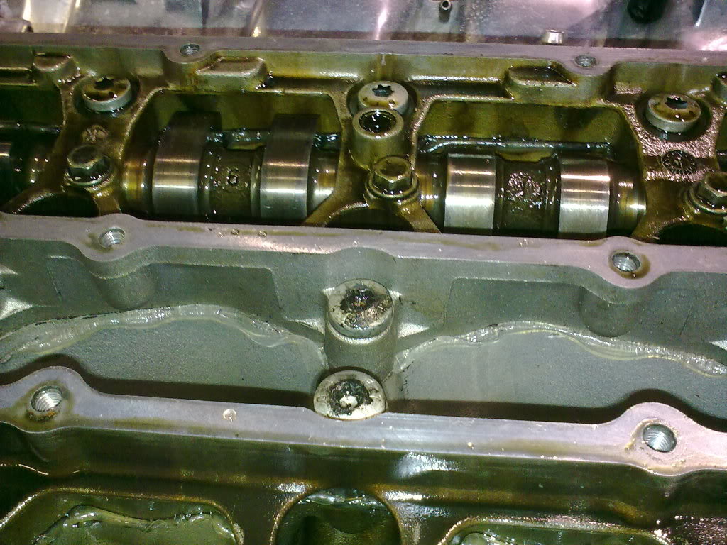

More pictures of the silicone...looks like its been applied with a spatula!
oozing out from the cam carriers WTF howmuch you wanna use?!
inside the camcarriers *next to the camshafts!
hope none of that has gone to my oil pick up!
head bolts whizzed off, and a VERY supprising amount of copper grease is all over the bolts (there should be some but not this much!)
as soon as the head is removed you can see the problem!
and for those that cant here is a close up
as you can see the gasket has failed between cylinders 2&3 as inducated by the compression test, and those with a keen eye can also see its about to fail on cylinder 1-2!
closer inspection of the head revealed it failed on the head side of the gasket.
the head has been inspected and verified ISNT warped, so the failure looks like its due to the wrong precedure used to torque down the head bolts, also compuded with the fact that soo much copper grease was used its likly the bolts "hydrolocked" themselves not getting the required torque anyway....but this is alone is a theory...
however yet more silicone was found on the head around the stat housing
The QUALITY lol Bga gasket
Now the block has been inspected and varified as flat, cleaned up and awaiting the next stage
The Cliolord Thought he'd show you the severity of the Silicone that was removed!
new head set, Payen..much better than the BGA stuff!
Head being re attached and final stage of angle tightening by 107 degrees
cam carriers removed alone with yet more silicone :(
Old noisy hydraulic Lifters Removed...they were soo tappy it was unreal!
Also the inlet manifold and throttle body, fuel rail, injectors and loom have been refitted
Brand Spanking New Lifters Fitted.......i think you'll agree with me... sexual (cheers Harv..owe ya a pint me feels)
Cams and newly chemical cleaned carriers refitted along with the patented cliolord "less sealant mod"
arnt they clean now :D

The engine is now refitted with a cambelt and timed up to standerd manufactuer settings, then using a DTI gauge on the inlet , 1.47mm of lift at TDC was dialed in and set using my piper vernier pullies. This was then done on the exhaust side, but with 1.22mm of lift at tdc and set using the vernier pullies.. These figures were taken from the Kent Cams Website for my RN2002 260degree cams. For reasons i wont go into on here we have not shown this precedure... if you dont know how(like myself) its better you leave this to the professionals.
Visually will show you the difference's in timing
The inlet
Before timing
(2.9degrees retarded.......not right at all!)
After timing
12 degrees advanced... as it should be!
15 degrees out............15... im genuinly quite shocked about that!
Exhaust timing
Before timing
just over 1 degree...hmm
After timing
7 degrees! 6 degrees out!

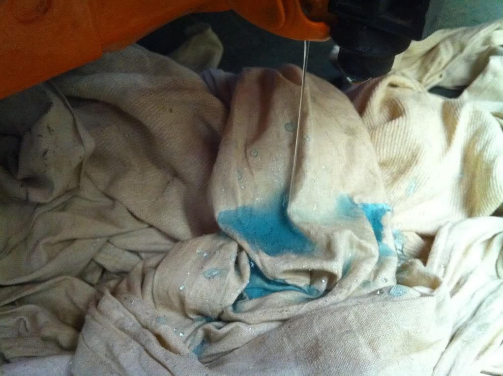

Coolant has now been added and new oil etc etc
Will get some vids up but the idle is now seriously lumpy!.... to the point now that because the Idle control valve isnt set up for these cams it not opening early enough and she nearly stalls when you rev down... this can be solved with the remap in the new year!
She is sounding savage!
as i mentioned before when i had the cams fitted it was kinda like and anti climax...... the engine reved harder but there wassnt that much different if i was honest! there was more revs that were useable but now less torque... and if im honest ive been kidding myself it was alright since.( i knew no better)
The Basic fact of the matter is... my *uprated* cams were giving less lift at TDC than standerd cams because the timing was soo far out.

We took the car straight to the rolling road and ran it up with the very random chip I was using! Kj put some det cans on and had a good listen! No detonation....good times!
Did 4-5 runs on the rollers, each within a fraction of a horse power!
180bhp
143lbs ft
147@ wheels
But the AFR was all over the place running lean low down then rich up top!
Then it was down to kj16v, wired up a wideband and his detcans and ecu emulator and took to the road.....with gaz who was just itching to see what was involved with mapping the stock ecu!
After cleaning up the afr kj set about tweaking the map! After a few hours I was presented with my car for a test......gaz was smiling so thought ok!!!
We don't have an after printout but.....

you should note that the rolling road printout was prior to mapping and the torque scale is not in proportion to the bhp hence the cross over appears to be out. The dip in torque was due to a lean AFR
also gone for A new set of Parada Spec-IIs in 195/50/15 flavour as the old set wernt looking too hot!
Notice how the passenger side is wearing on the inside soo much that the tread has dissapeared... we have deduced that i have a bent shock absorber... so have orderd a new one from Renault Parts Direct... £54 for a genuine williams shocker... would buy 2 but cant find the money just to spend if it dossnt cure it!
a quick polish and some new stickers installed not bad for 15 year old paint!

Stage one..... find a garage i can strip the car in
made a phonecall at lunch time by dinner time i had one
sorted!
Moved the car into her and removed the bonnet!
then removed the wings bumper, wipers, head lights,skuttle pannel
then out came the wiper linkage and internal fan makeup and the washer bottle and the old OEM alarm (that i didnt know i had)
obviously i would be a fool not to expect some rust... soo here are the bad bits
and the bit that looks like its going to need the windscreen removing to repair...fail....
what i dont get though is one side of the car is rusty... the other side (passenger side) has light surface rust....
and now she is looking like this... will keep you all informed day by day

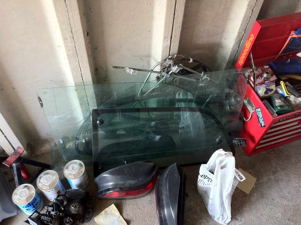

Ok off she goes to the bodyshop! Proceeded to discuss bonnet fit ment with aero catches then remembered I forgot to take it lol
Big thanks to bass for today! For dropping off boot and then unexpectedly bringing me some willwoods aswell! What a legend! Especially as he drove from Essex to Dorset for 8am!
just a few shots of my very empty garage
Rubber everywhere
Why I needed a new boot!
Just waiting for her new and improoved home!
Rubbers arranged
Glass no longer required
Carlsburg don't make engines....
All organised just waiting for new and improved shell
Ok some images from the bodyshop.....N REG disintegration factor!
As you can see YES that IS the floorpan thats nearly falling out... but better the devil you know.. so all getting fixed propperly....
Fitted
Jack damage repaired
Cill is now hard as nails
Floor patched
Arch in
Front arch repaired
Screen out
A rare morning off ive Been into bodyshop today, to find all the welding is now complete! Joy! No more rust
floor has been sorted,
Sill has been smoothed in yay
Door shut cleaned up
Engine bay in primer yay!!! One v happy mrs lol
thankfully no leaky powersteering will return here!

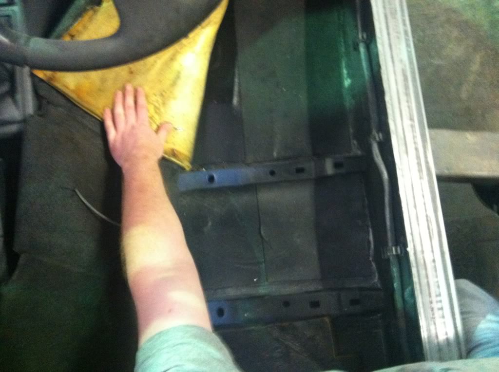

Ok remember the hole in the skuttle? Quite frankly the only bit I was worried about...before saw the floor?!?
Well it turns out the repair was **** simple!
Two cuts in the dash bend back weld in plate, bend back weld up, grind clean lol
