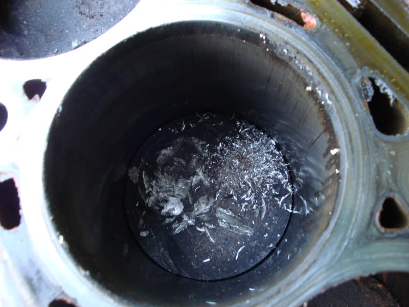

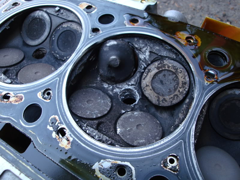

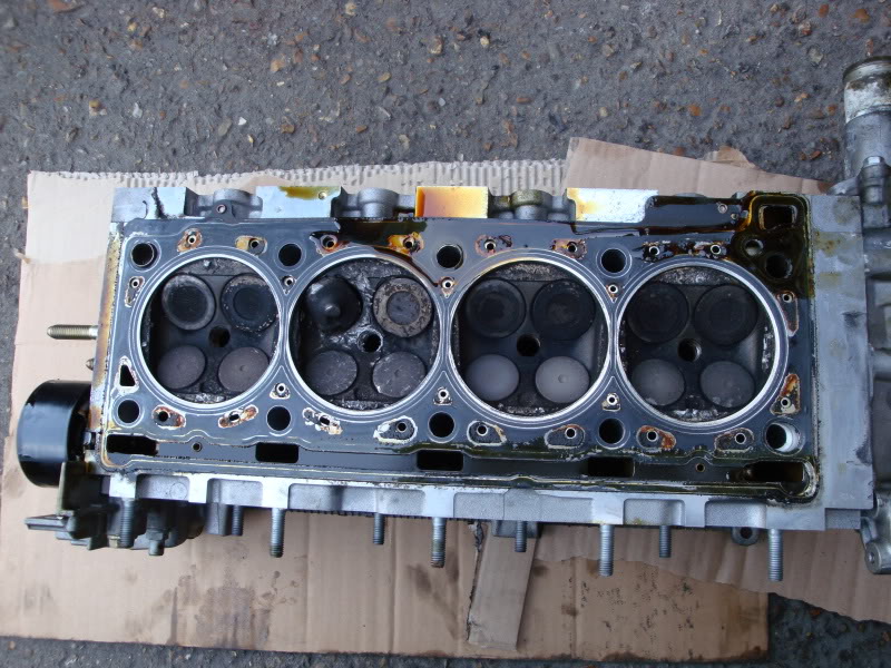

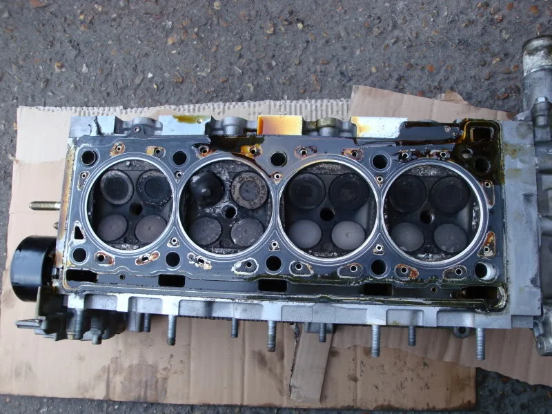

We removed the head off Nicks engine this afternoon
As you can see from the pics, some serious damage -
The valve head worked its way round 180 degree's and wedged it self back in the head
Cambelt was timed correctly when we removed it so can only be put down as defect in the valve its self.

Thanks for posting the photos James, it's good to know exactly what happened.
