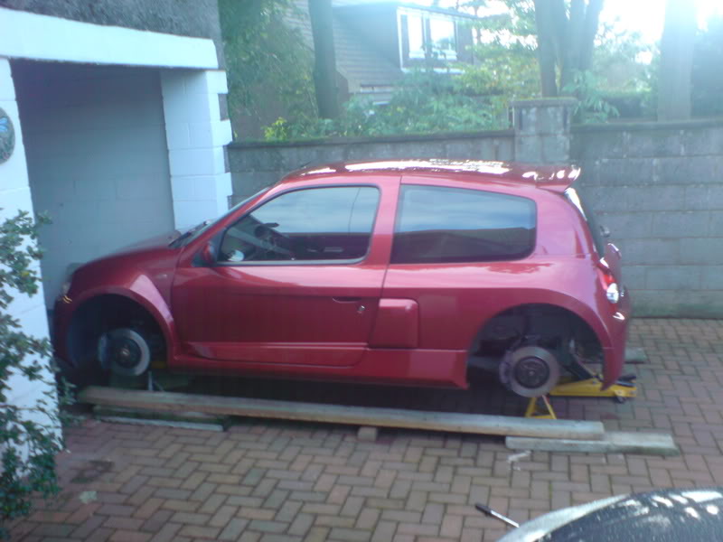

I know there is a point to jack up with the jack provided but is there any where else to jack up by trolly jack? Want to get both fronts up together then the same on the rear.
Thats if I can get the wheels off! :o
cheers
on the rear, take the plastic gaurd off, then jack up on the rear subframe X points, this well allow you to get 2 jacks eaither side to lift both sides up;)
on the front, ive used verious places, anyware solid, theres not a great deal of weight there anyways!
NB- pull the car onto a platform first (ALA a plank/brick or summit) this gives anough room to get clearance for a jack!
n0rm
EDIT- change your details under your pic, your driving no cup;)
