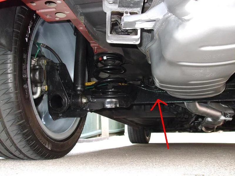

Anyway ive used the search tool :eek: and see that it seems to be safe to jack up on the plastic sill ?! :S near the little hole were i would use the sissor jack?! is this correct?! also im a little concerned as to were to put my axles stands - do i put them on rear beam?! Sure that will be ok?! :S

Yeah i have jacked it up on the sill as mentioned loads of times - i also place the axle stands there as well - but the rear bam should be fine

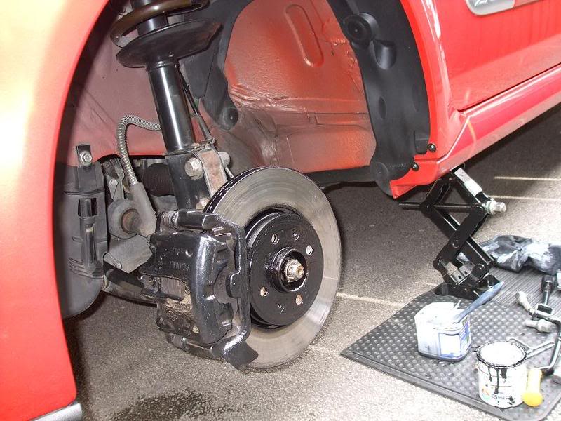

this bit rich! this is the bit i was going to do it on?! :S
what about a bit of wood and use my trolley jack / axle stands that spreads over the gap of this part! :) ?????

avoid the jacking points on the sills unless you're using the jack supplied with the car, they will bend. but they wont damage the sills.

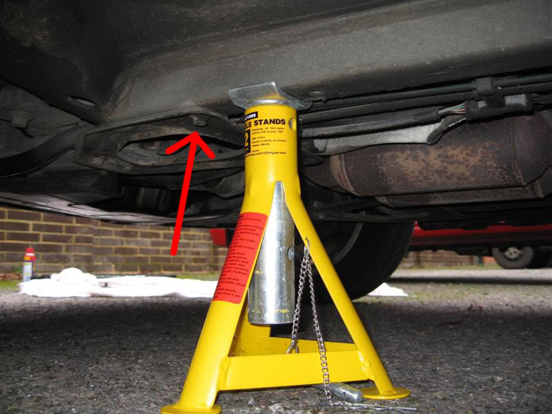

you can use the subframe as shown here, personally i'd put the axle stand where the red arrow is. get some wood or think rubber and put the stand where the bolt is.
your pic of the rear is fine aswell but as said, you only need to do the front to get both wheels off the ground

no to really thats fine but if the stand seat is an odd shape it could damage/scratch. but my renault mechanic mate always puts the stands on the bolts. one of the strongest points apparently and he knows his stuff pretty well.
plus he's normally doing an oil change so needs to go as far forward as possible so the car doesn't topple forward on 2 axle stands. just the right place for that.
