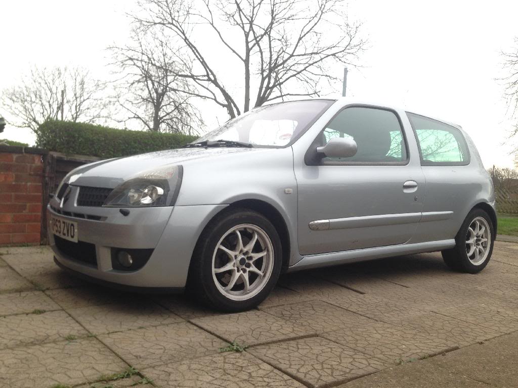

Bought the car from Trev at DTM cars mid last year. Soon as the car came up I thought great, a trust worth garage, its in my budget, reasonable mileage and once I took it out for a test drive, I HAD to have it. Felt like a rocket compared to my 1.4 16v clio 2.
After getting her home typical Teesside weather.

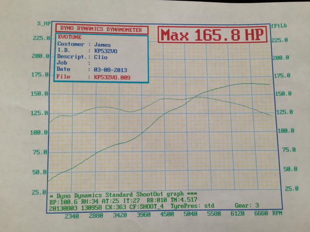

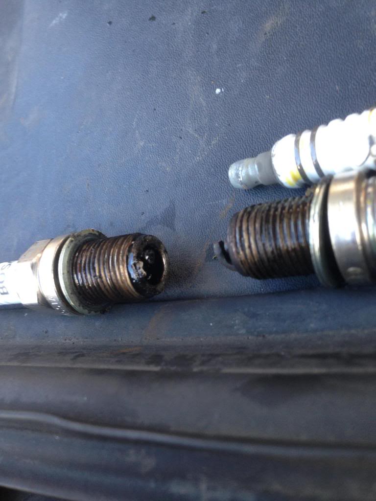

Took it for a power run up at Evo Tune in Durham. Ran what I expected for a standard 172 which was great, however it was using 1lt of oil ever 1500-2000 miles but Renault specs said this was an okay oil consumption :S

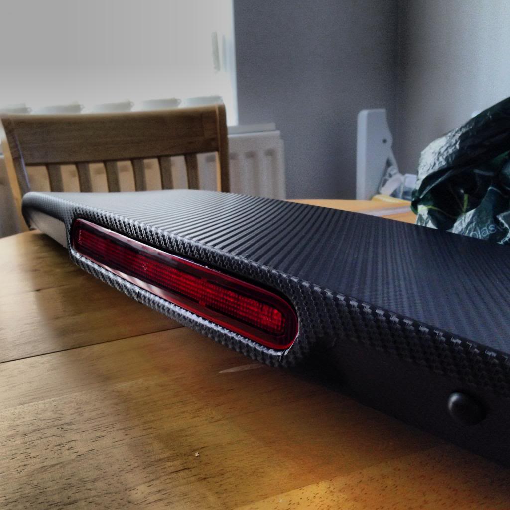

Got a cup spoiler cheap of Mark Fox and wrapped it in carbon effect. Also manage to get a spare engine, box, front brakes, braided lines and a battery relocation kit.

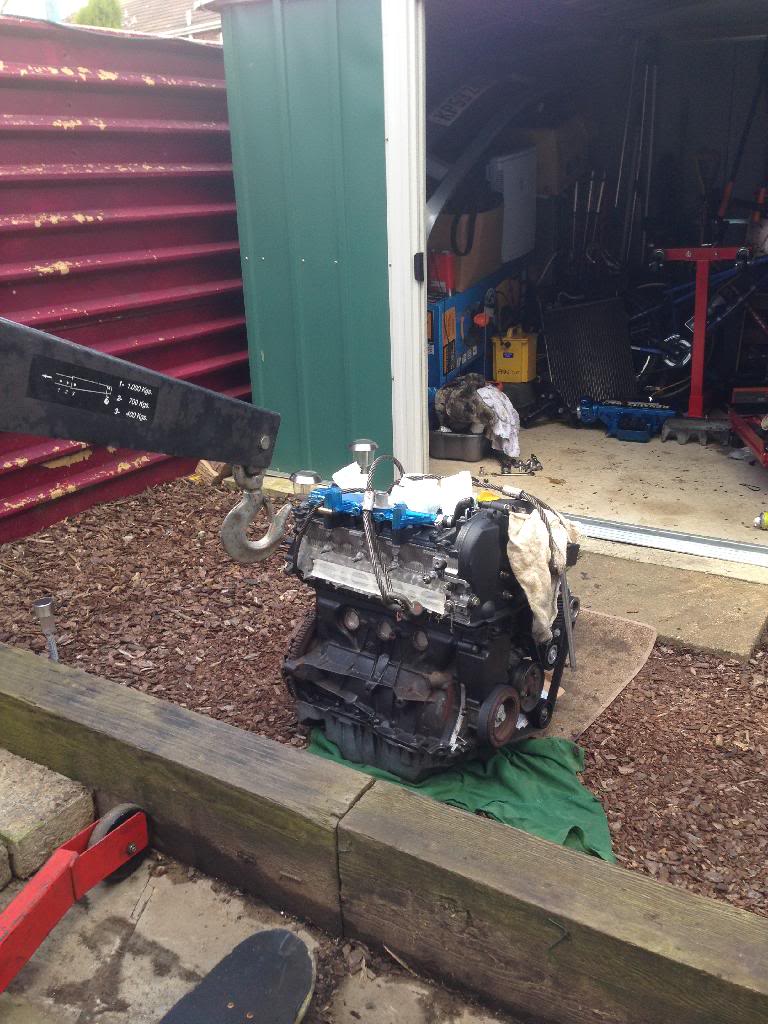

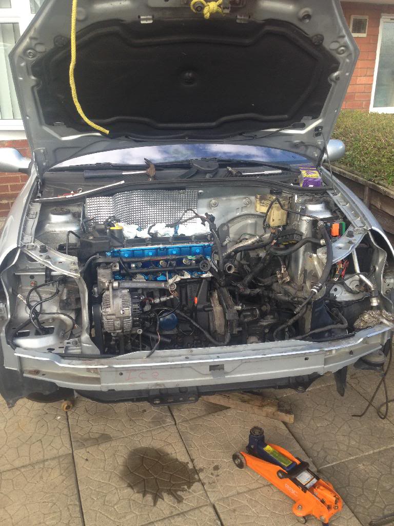

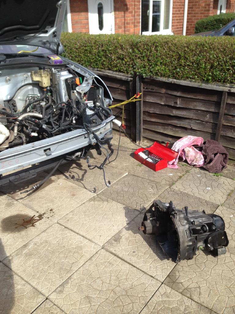

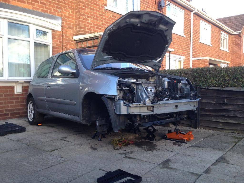

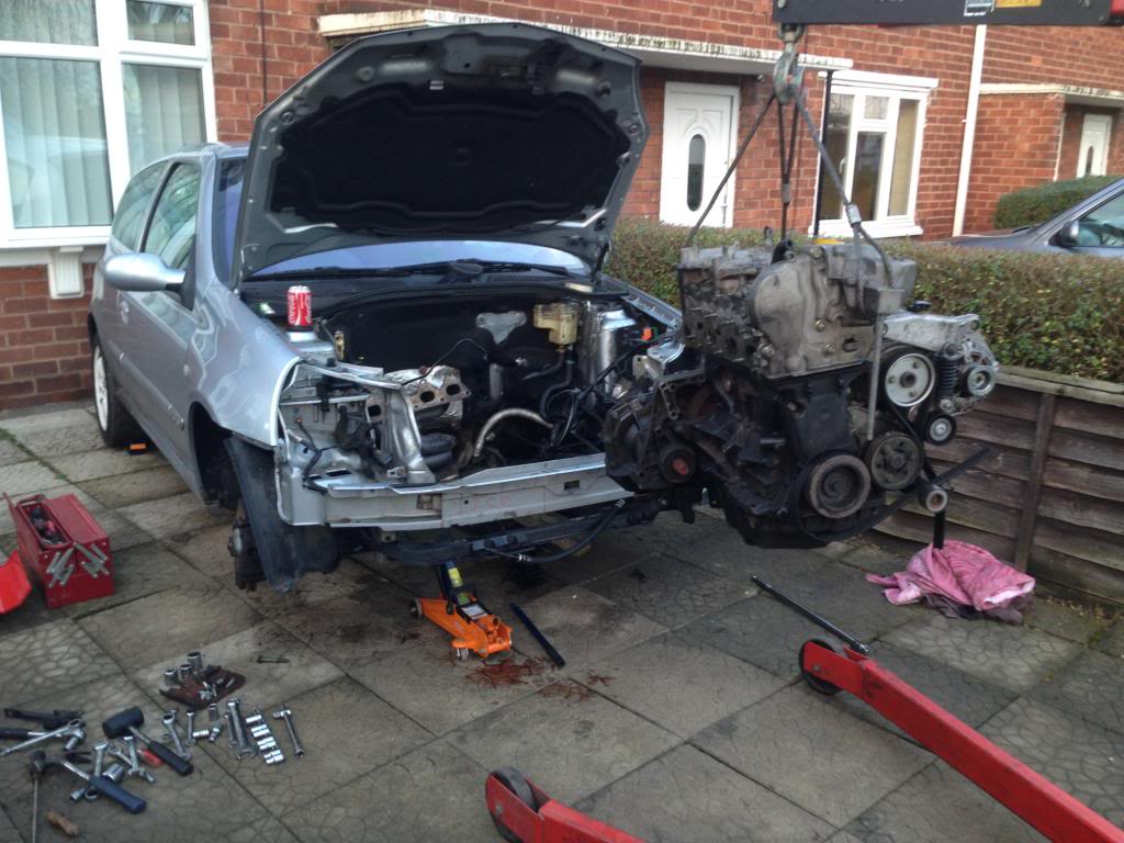

After breaking down on my way home at midnight a couple of weeks ago, I decided (never done anything like this before) to stick it on my parents drive and fix the problem myself and when I get stuck ask friends and fellow Clio owners for help/favors. Managed to get the engine out pretty easy on my own, labeling plugs and bolts with the hope that it would all go back together. I found that a con rod looks to have tried to make a break for freedom. Found a nasty crack in the rear of the block, bits of metal were everywhere, all the ports, intake, oil ways. So basically my engine was scrap. Using the spare engine I bought of Mark a while back I borrowed an engine stand and began to strip that and ordering parts.
With the idea of keeping things cheap but using genuine parts, it didn't stick. Ordered all the typical rebuild bits like gaskets, timing belt, dephaser, fluids from Renault Wolverhampton, then I had a little bit spare cash left over, and I haven't stopped buying.

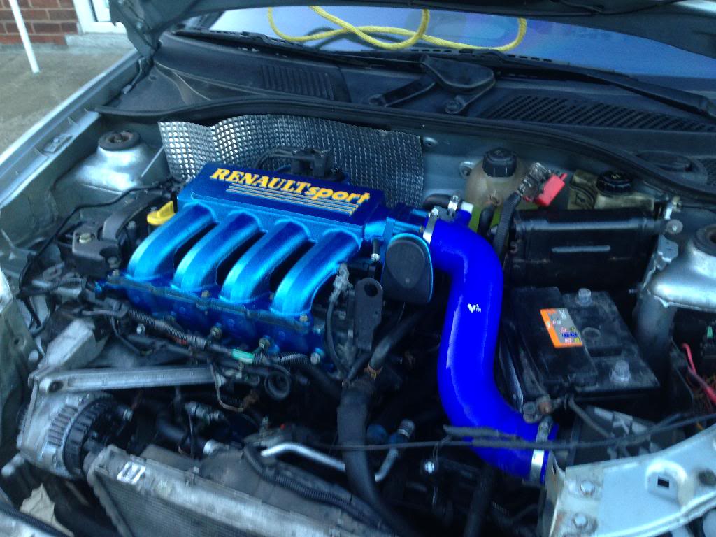

My build so far is looking like:
KTR Induction kit
RS Inlets
ALD Gas flowed head, with new Valve guides and angled seats.
Supertech Valves
ARP Rod bolts
182 Manifold Heat wrapped with decat link pipe
KTR Stealth Cat back
RS Tuner 98 Ron map
Air Con Removed
Removed carpet from bulk head and fitted Nimbus Lite
Powerflex Rack Bushes
Relocate Battery to the Boot
There is probably more I just cant remember, after find out my budget for a new padel clutch must now go on valve guides I'm trying to sell a few spares I have to make some money back.

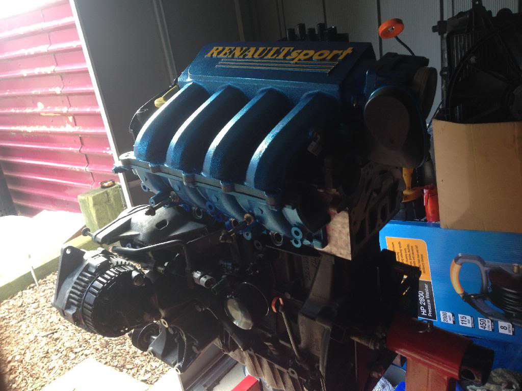

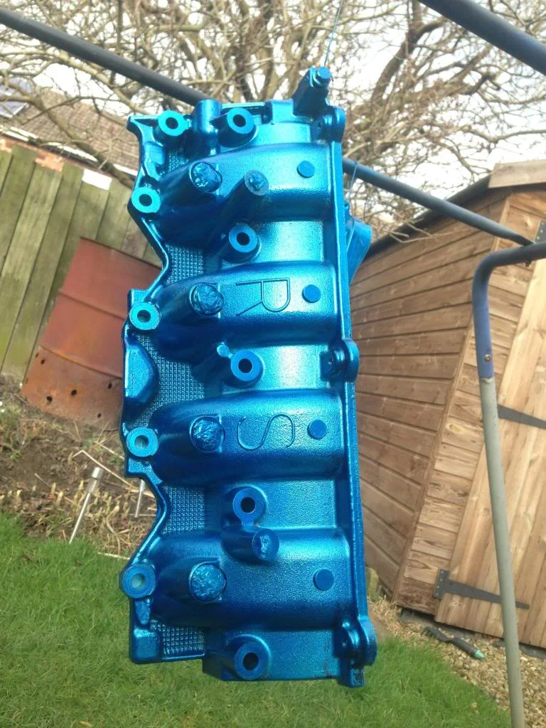

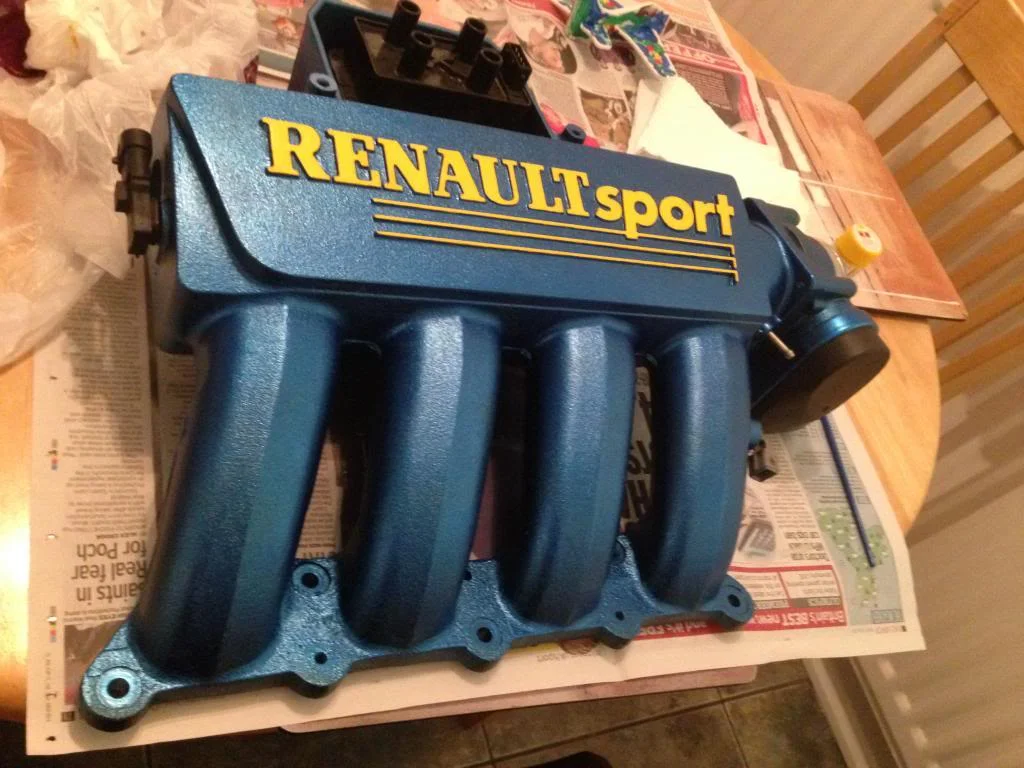

While my head is off at ALD I've spent some time painting up bits. I've gone for a matt black engine to hide the dirt, and well... this.

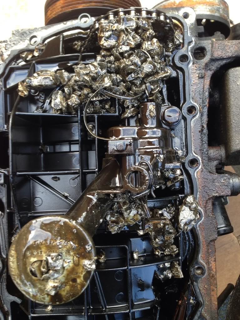

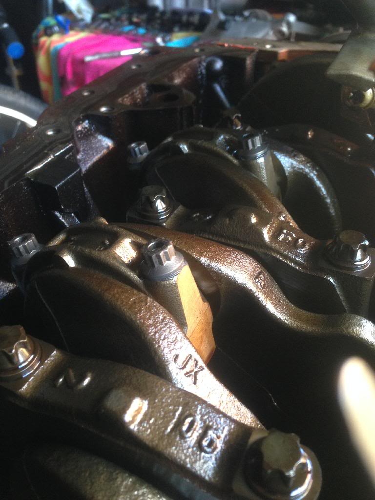

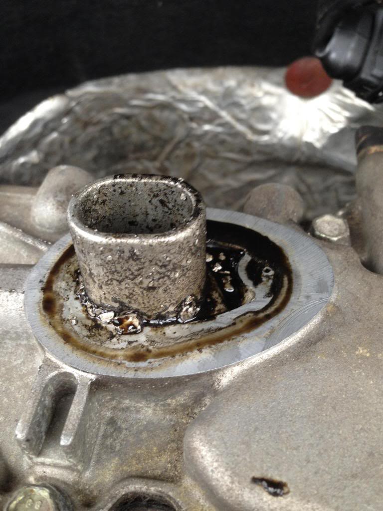

Took sump off broken engine and found the remains of something...

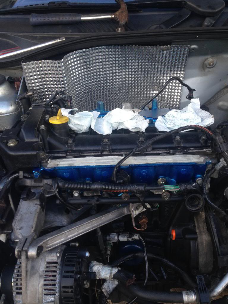

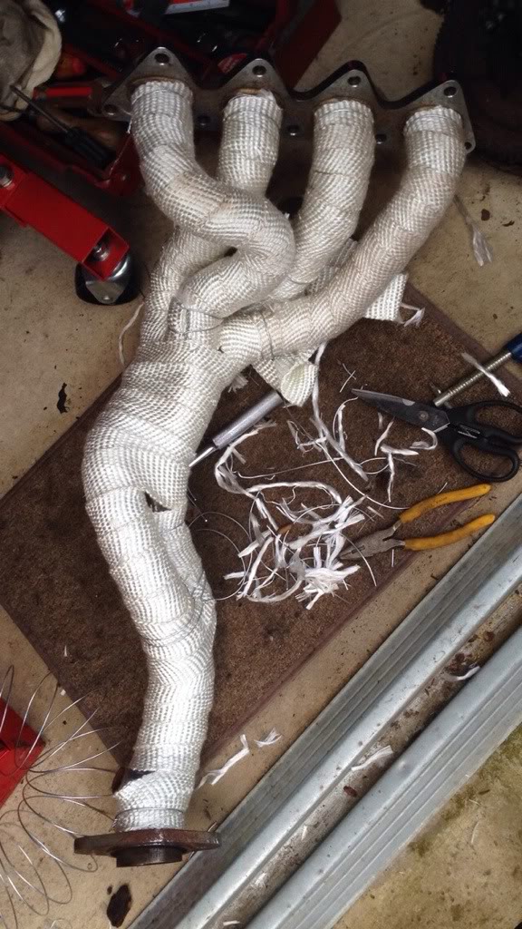

I fit some nimbus heat shield to the bulk head after removing the carpet and also heat wrapped a 182 manifold to go on.

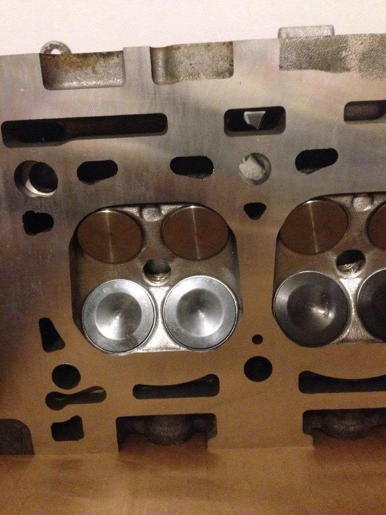

and the best bit was these pictures from ALD
The head had just come out if the parts washer so that why it looks so shiny and polished. It shouldn't look like that when you get it back.
Will be rebuilding it on the weekend and will get it out to you next week next day delivery

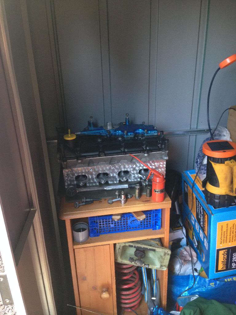

Head is all packed up ready to go

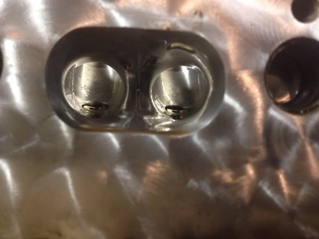

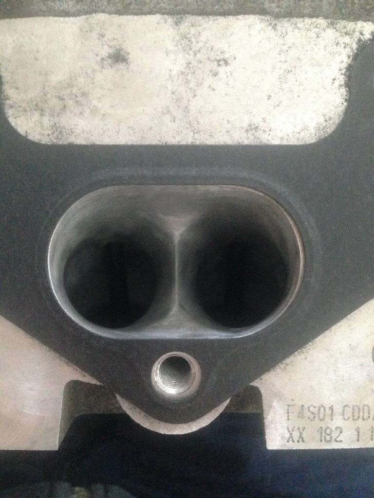

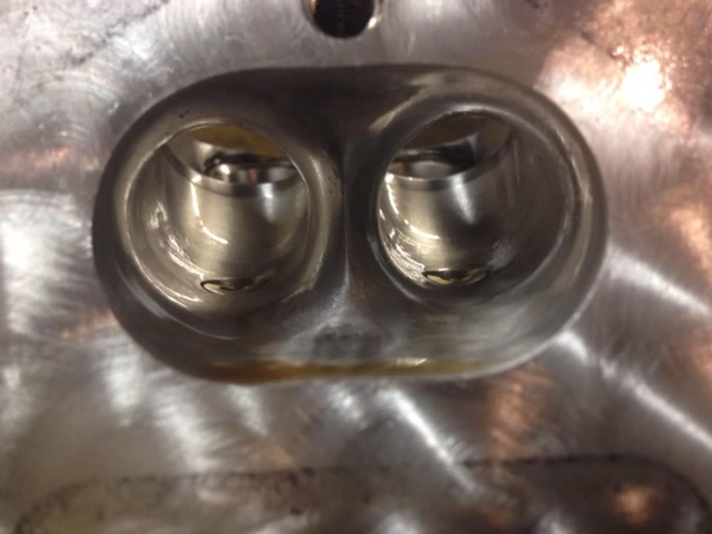

Hey, I was going to update it during the week to say I got my head back from @ALD, but I left it till now cause I've done more.
Got the head back on Thursday, and what a beautiful piece of workman ship. I cant believe how big the exhaust ports are now compared to the old ones. The knife edging of the port split is perfect. Overall I am extremely happy with how it turned out! My pictures don't do the work justice.

Also fit some ARP rod bolts because I think this may have been what let go in my original engine.

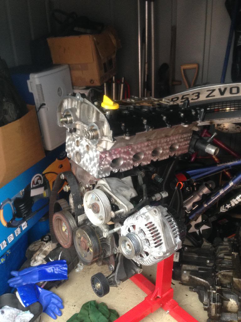

Then today was spent doing this! Sump on thanks to @Korky for the e8 tool, head re assembled and head on, thermostat housing, cams in and rocker cover torqued down.
Now its ready for @Andyrg to work his timing belt magic.

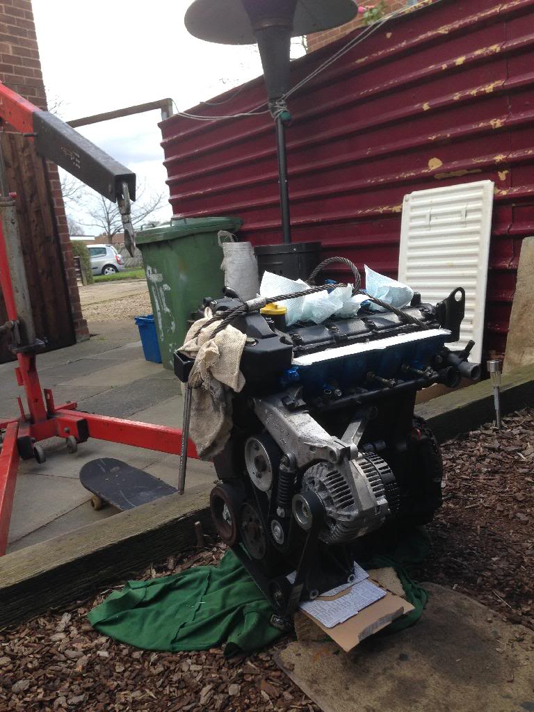

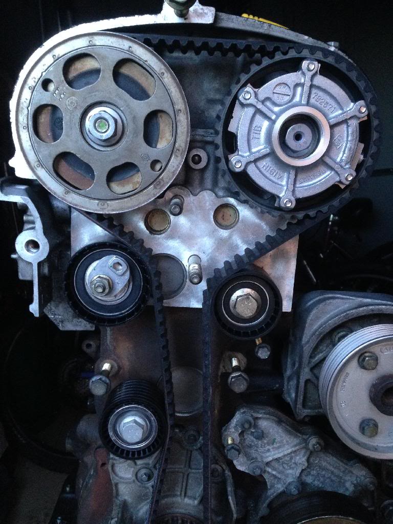

Engine is built back up, I put the timing belt on and I think due to the head being skimmed, the tensioner is sitting a bit further round than it should. Will have to run it and see how it goes. Got rid of the aircon and the aux belt is on.
Just put flywheel and clutch on, after Ive had a sit down the gearbox will be going on today. Then it will all be ready to go into the car tomorrow!

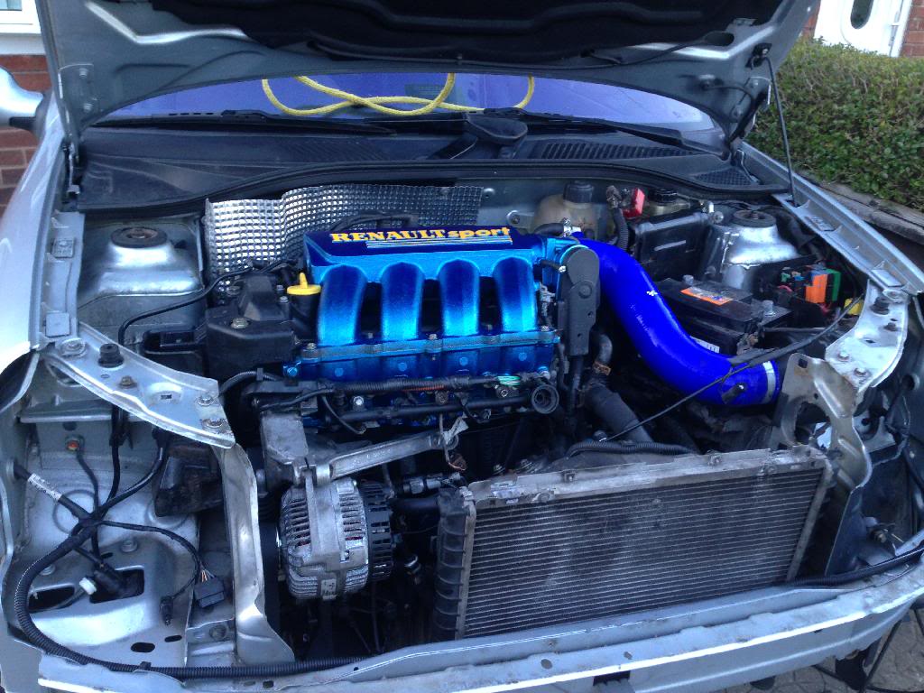

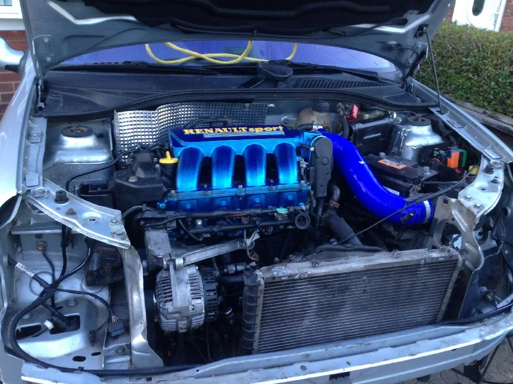

Some pictures from today's progress. Tomorrow's job is to fiddle with the exhaust to match the new manifold and decat, turn it over to get some oil pressure, plug coilpack in and hopefully she'll fire up. Can then let it heat up, let the heat wrap smoke, top up the coolant, keep and eye out for anything doing what it shouldn't. If all goes well I'll reinsure it Wednesday and start to run it in.
  ph2 172
Thanks guys, really appreciate the feedback. My hands are cut to bits and my skin is stained with old dirty cv grease but tomorrow should be a fun day! Finger crossed the tensioner is okay!
  ph2 172

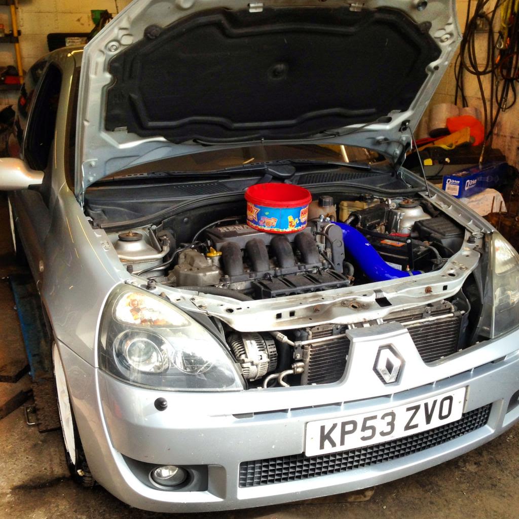

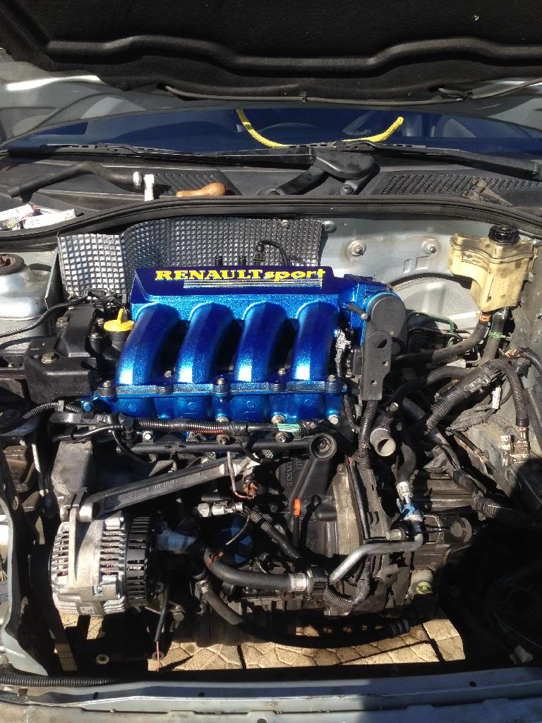

Well boys and girls. Had a fight with the exhaust but managed to get it to fit, after turning it over yesterday there was only 1 problem, an o ring from the fuel line to the rail had gone so replaced that. After that she ran sweet as a nut! Left it ticking over to bleed coolant check for leaks. Finished before work by returning the front end to normal.
Today I refit the ball joints and wheels, got it down on the floor and insured it!
Took it out for a test drive, clutch could do with some adjustment as the bite is at the bottom of the pedal. Other than that all I can say it that I can't stop smiling!
I cant wait to get it on the dyno going to call rs tuning soon. With the decat it's a lot louder, and it definitely feels faster than my 165bhp engine. I guess the dyno run will tell how much extra it has.
  ph2 172
First few miles showed that I had a slight leak from a core plug so swapped that out for a new one. The car was sitting just below ideal temp. so I swapped out the thermostat and temp. sensor and its now fine and goes all the way to 7200rpm. The exhaust wasn't sitting in the hangers due to the new manifold and decat, so I took a dremel to the rear hanger so i could slider further forward and tweeked the hanger a bit and that fines fine now.
I've done about 550 miles so far and its faultless now!

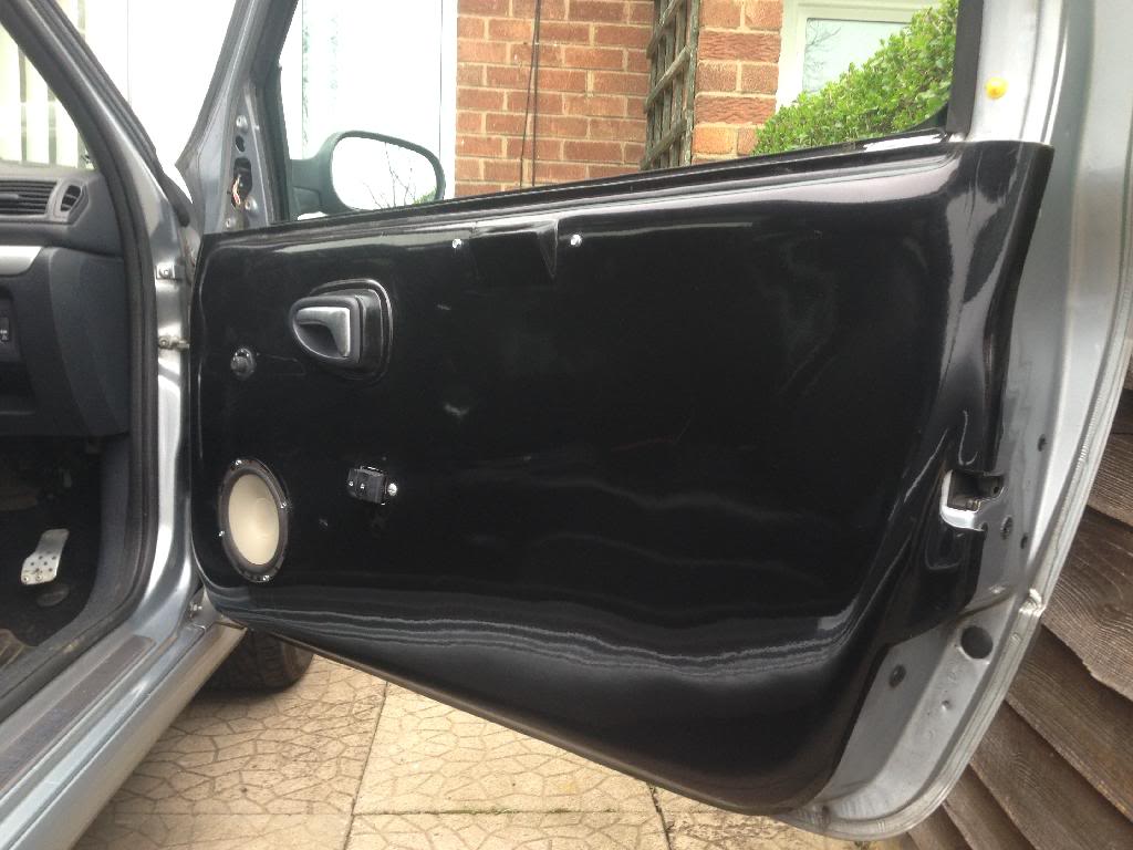

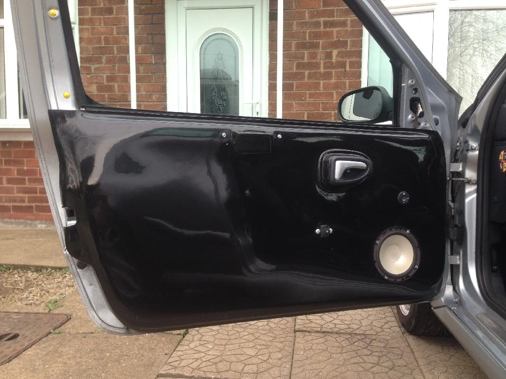

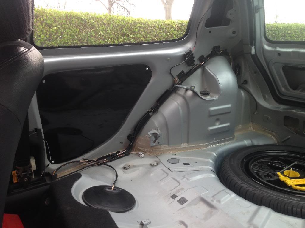

I got some Oreca front and rear door cards from sox711 really nice guy and his clio sounds like its going to be great!
It took about 6 hours to fit the cards along with wiring up the speakers, fitting air bag on/off swtich, mirror controller, window switches plus brackets. I plan on cutting out some holes in the rear cards so I can have the rear speakers in.
