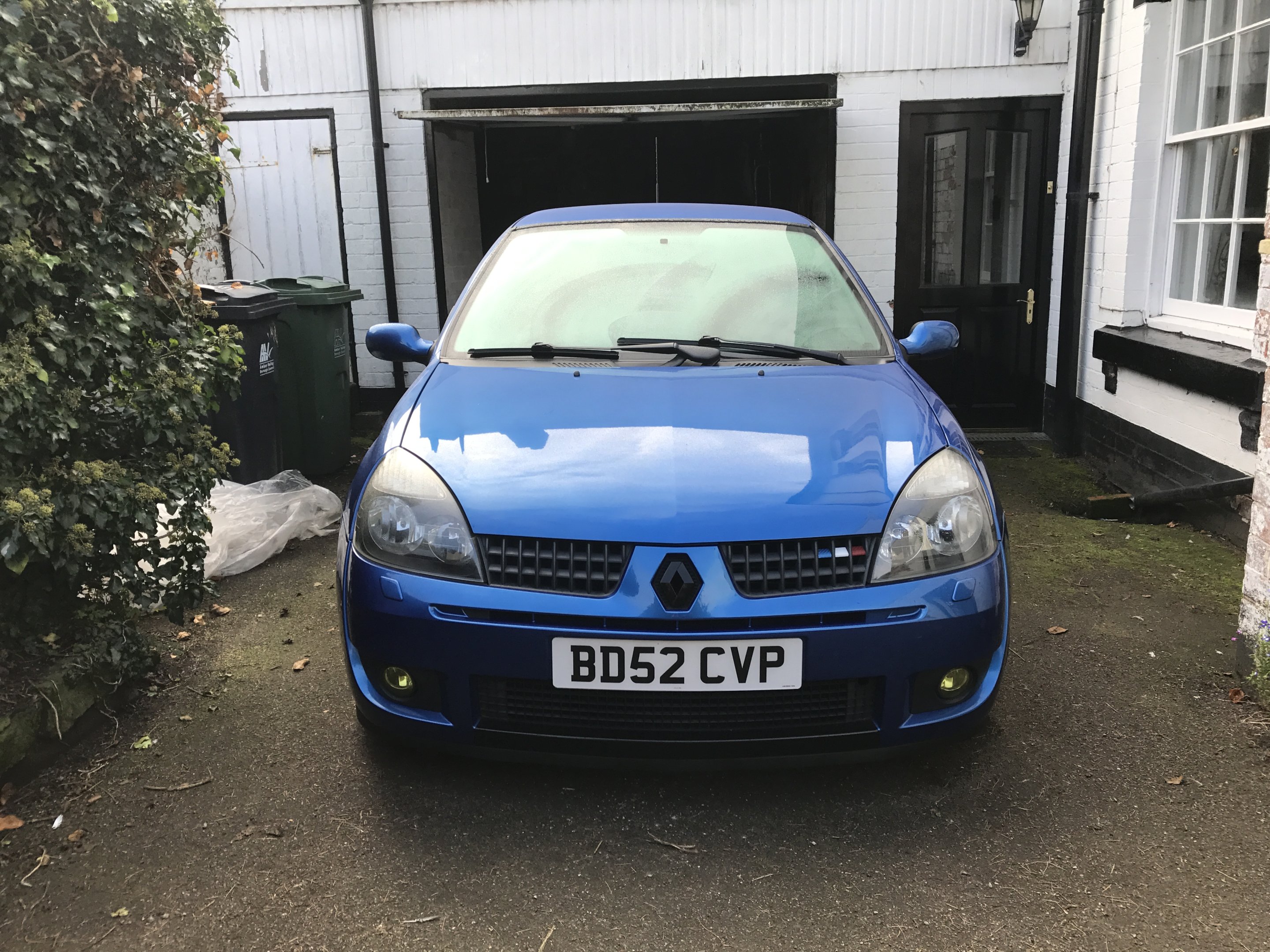

Rear wheels need swapping side to side matey as the tyres are directional and pointing the wrong way
Yes mate noticed that myself the day after uploading... still great spot, don't know how you noticed that from those photos!

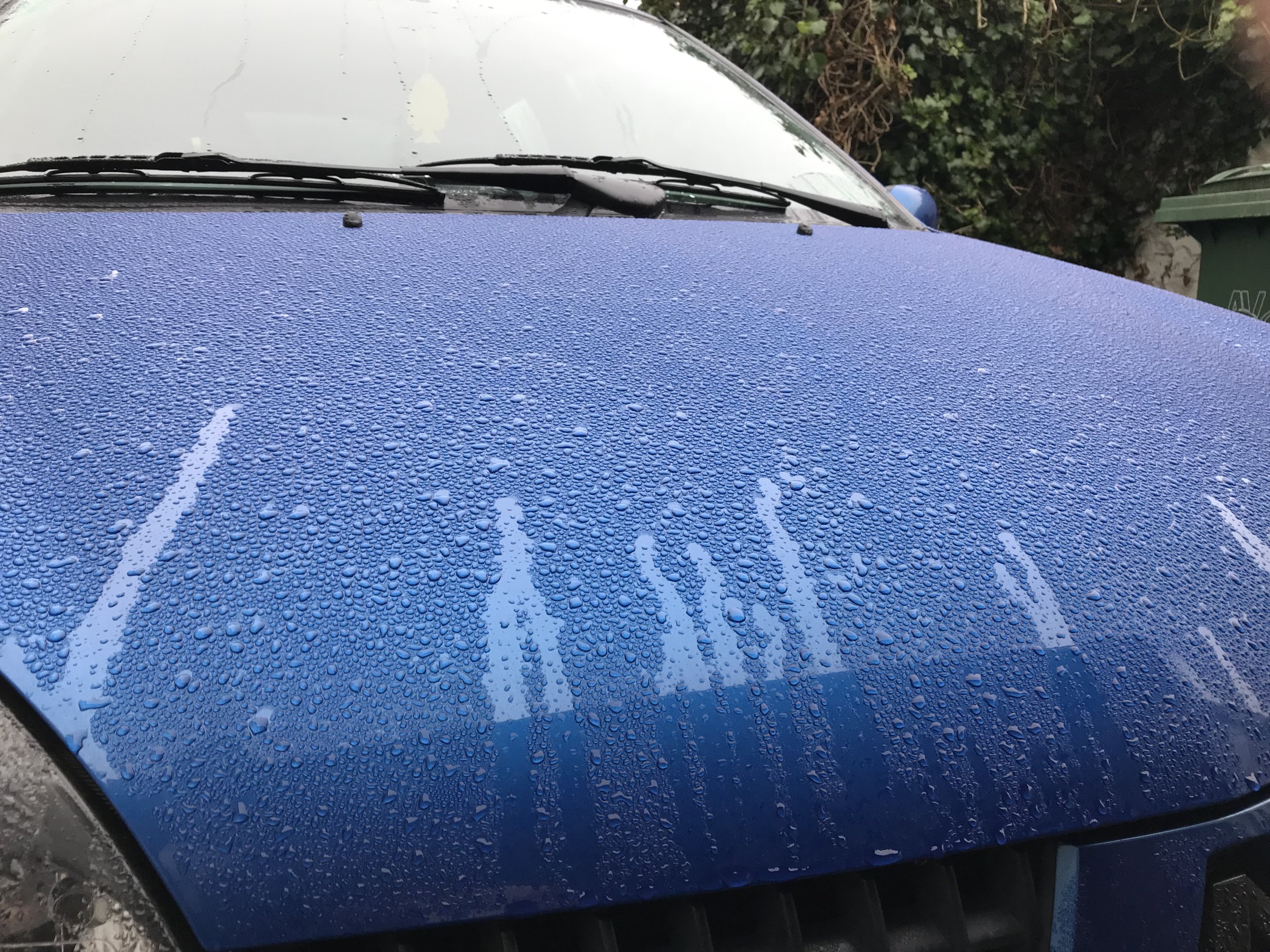

Paintwork polished and sealed.

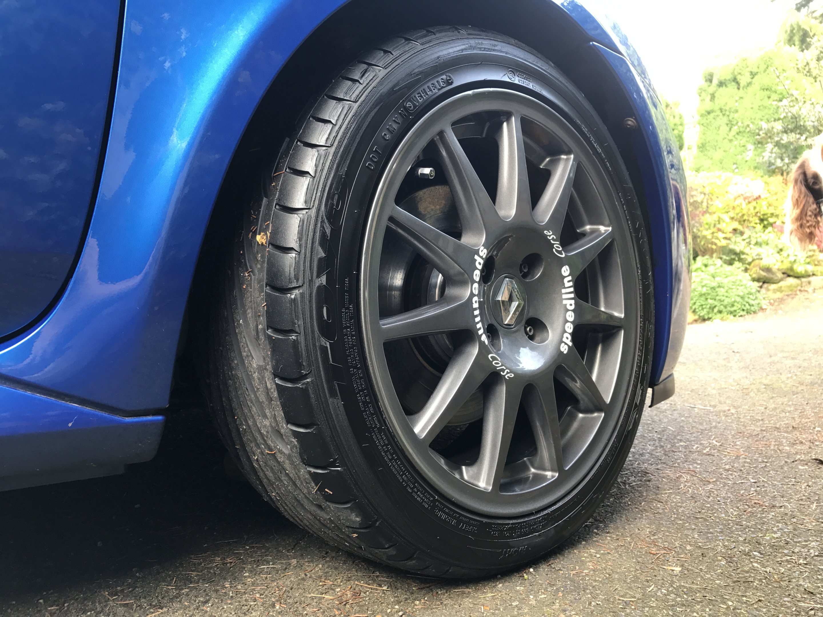

Wheels sealed and tyre shined applied, massive difference!

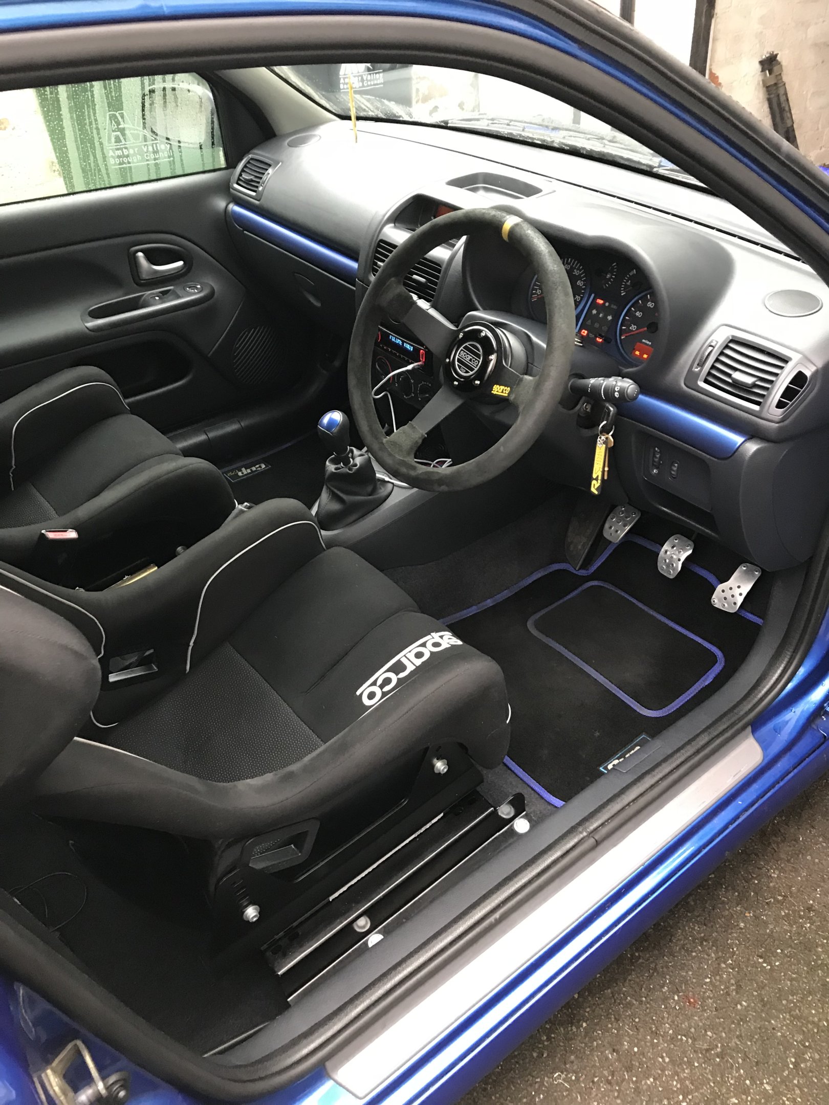

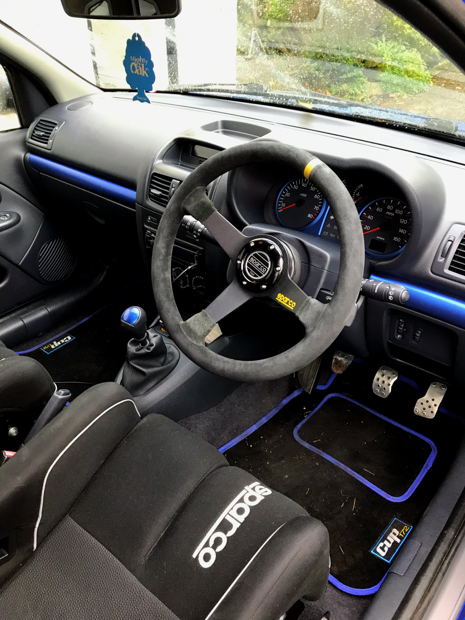

First of all, filled in the gap on my Sparco wheel with a horn. No idea how to wire it up but at least it looks far better.

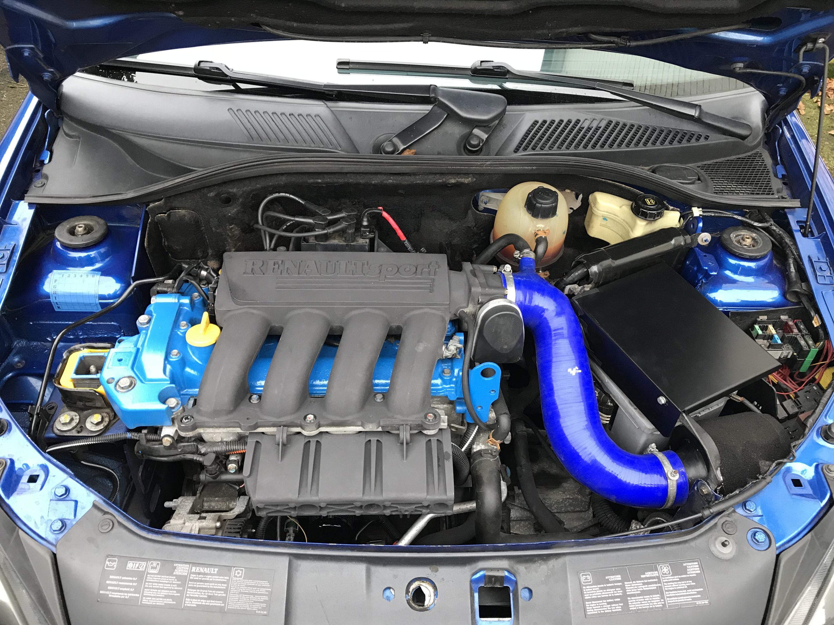

Also finally fitted a KTEC induction, what a huge transformation it makes in noise! It finishes off the engine bay nicely.

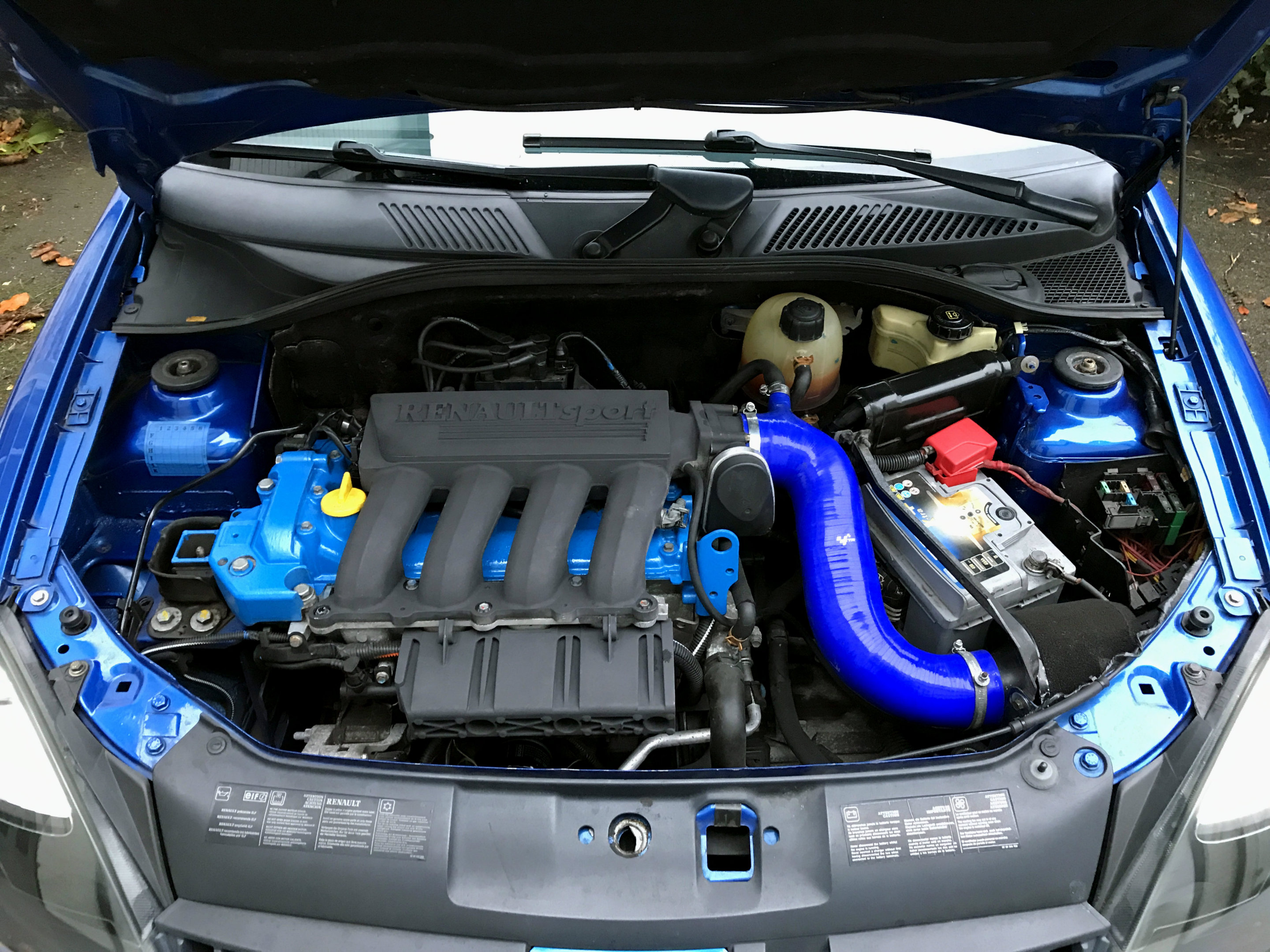

Fitted Battery Cover as recommended by @182_steve . Looks far better, just need an fusebox one now.
Also fitted Powerflex upper engine mount along with a Evol Engineering dogbone lower mount.
First impressions...wow. What a difference! Whole car feels a lot tighter now, particularly the gear changes are so much slicker. Vibrations have increased a lot, however I'm hoping these may die down over the next few days as the bushes bed in.

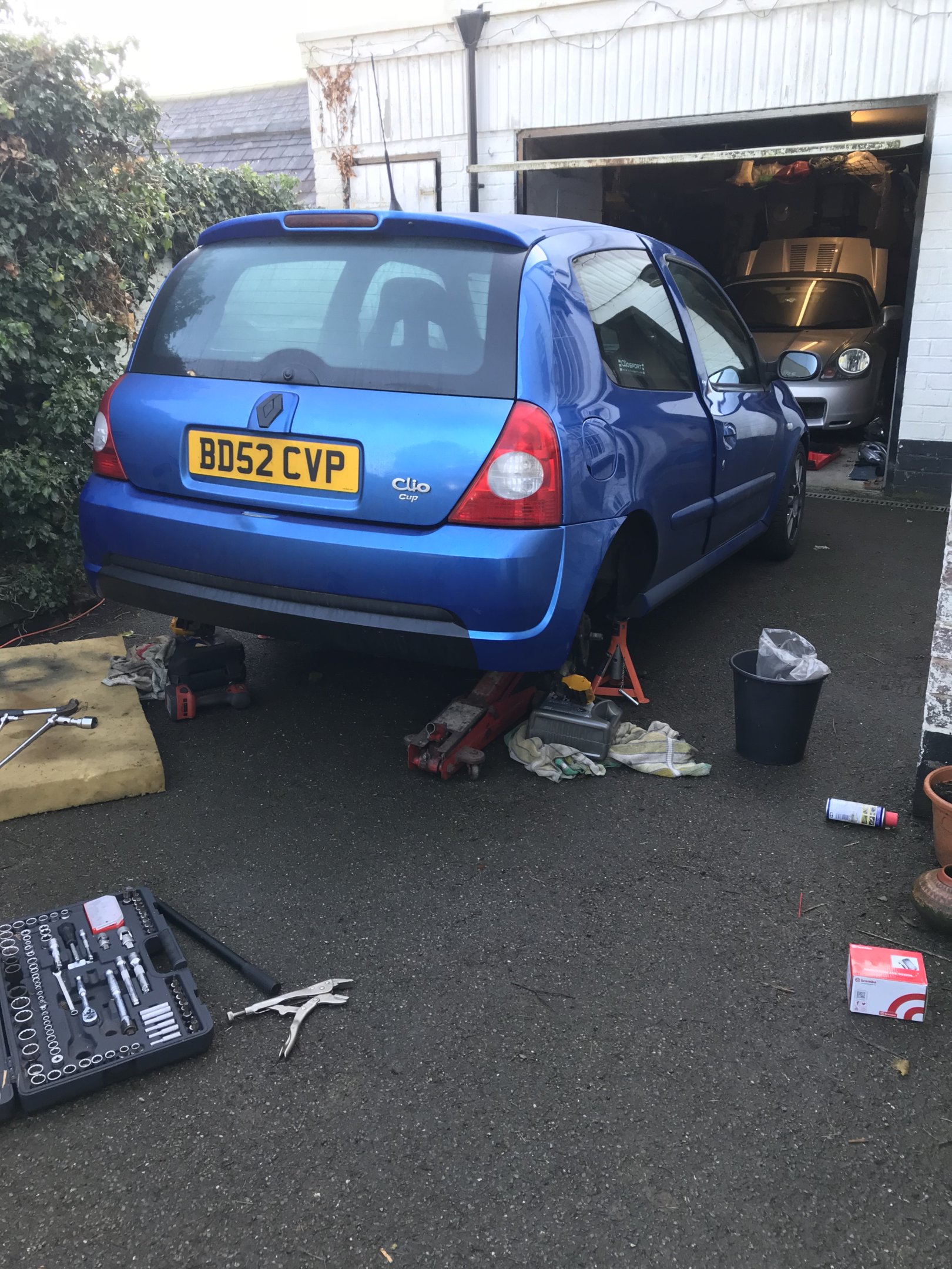

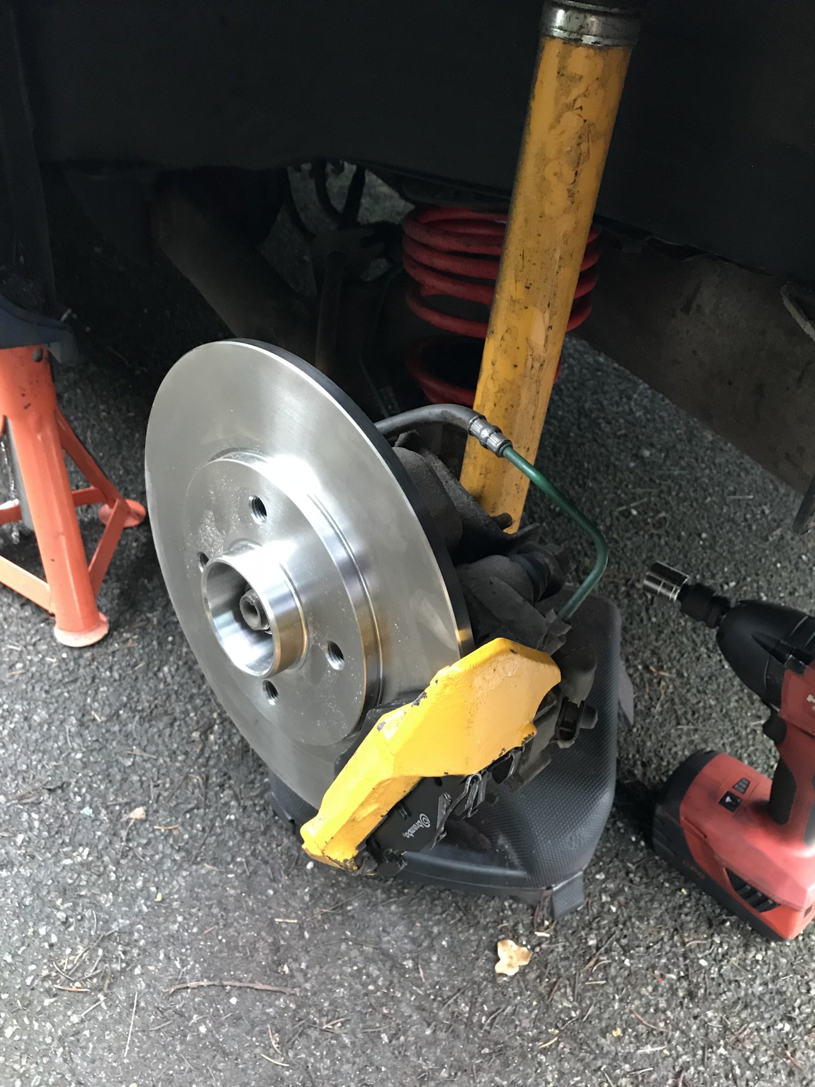

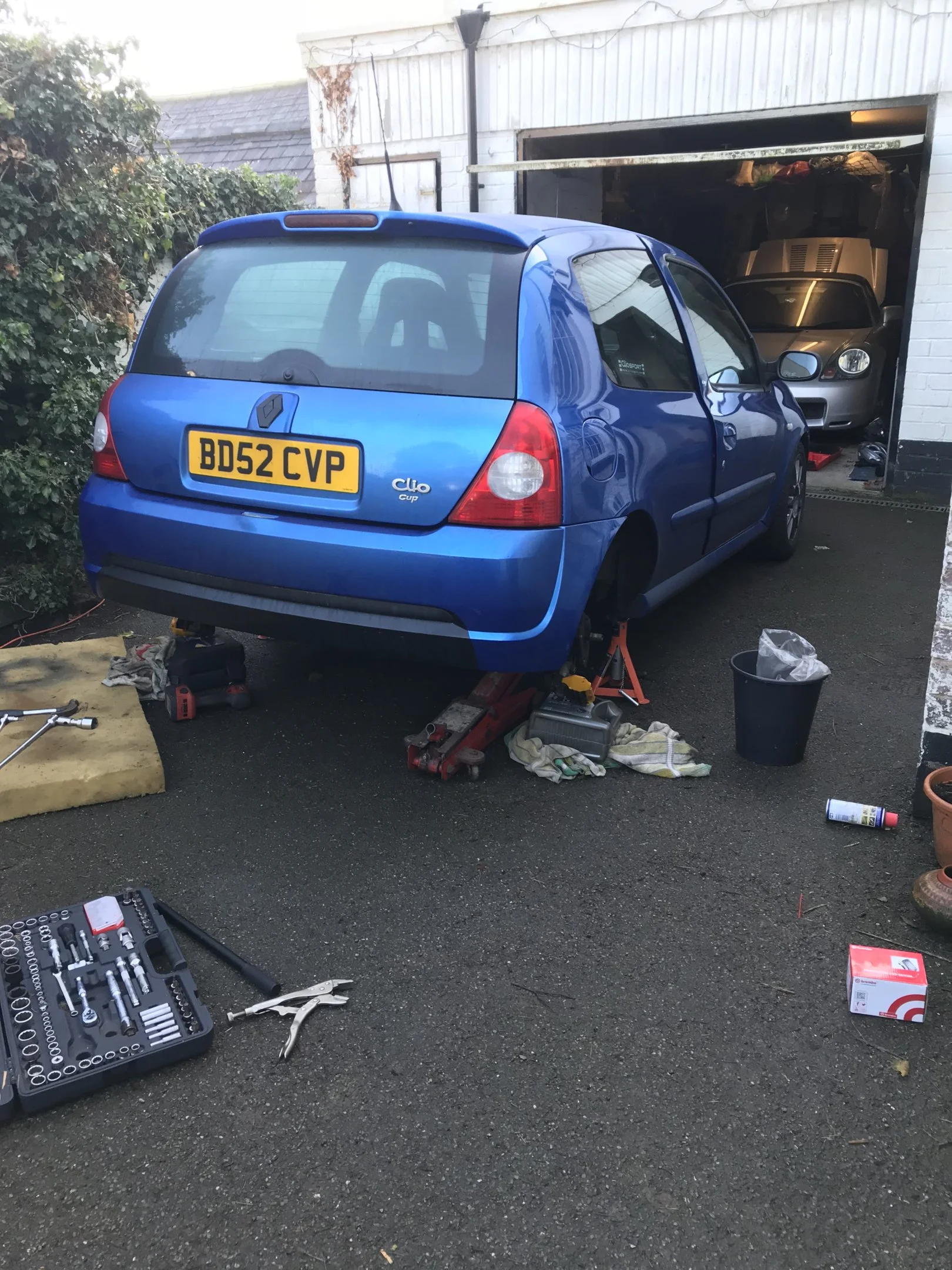

Cracked on with replacing rear brakes, brand new OEM Brembo pads and discs - would have preferred to go uprated but just can't afford it sadly.
Of course, something always crops up on even the easier jobs, for some inexplicable reason the old O/S rear disc WOULD NOT budge, took a fair bit of hammering to get off, and even worse - the new disc was 10x more difficult to get back on - for some reason the bearing would just not fit around the axle stub. It was like it's expanded over time or something, wtf :expressionless:. Got there eventually with a LOT more hammering (chock of wood and a cloth over the hub to protect it). So weird as the old N/S disc came straight off, and the new one slid straight on. Cannot explain it.
Also managed to round off 3/8 of my studs trying to remove them from the old discs.. fml another expense I could do without!
Hopefully the new rear brakes will sort my MOT issues. (Imbalanced brakes, binding one side and no effort from the other).

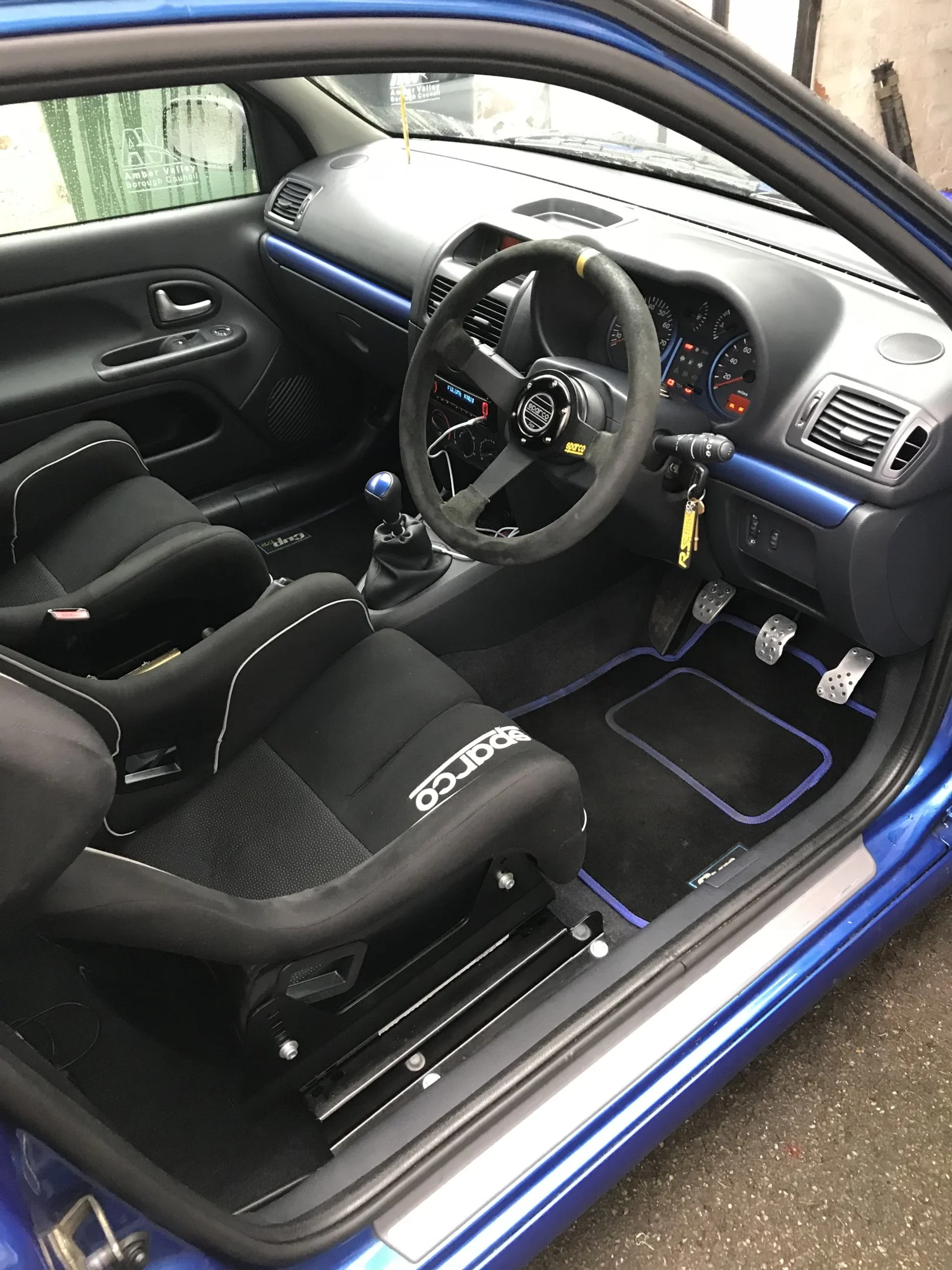

Fitted a temporary horn button above the steering wheel, looks daft but only done for MOT purposes - I'm used to living without one now. Also fitted a new metal cover to the clutch pedal as the other one had half snapped off somehow and looked really untidy, happy with how the interior looks now.

Like @Louis' said probably a bent stub axel.
Must admit I find the rear brakes make a significant difference in braking on the Clio. I’ve gone from standard rear pads to CL 5’s and the car slows much faster on track.
Could up grade to 182 stub’s for extra rear track.
Good luck with your re-test!
Standard rear brakes are more than fine. The hazard light switch does more of a job braking.
Yeah rears do nothing.
Yes I've heard that, my point was I've also gone OEM upfront as well - would have upgraded but funds just won't allow it. They should do a pretty decent job anyway being brembo!
You may have a bent rear stub axle.
I did consider this, I really hope not. Anyway, the disc is on, it's done now. Hopefully won't cause me any trouble in future.

Is it possible to swap the stubs around or is a whole new rear axle job? Thinking about it, a new rear axle sounds easier anyway.
Thanks bud :up:
Also, just cause I haven't got anything else on with the damn car... one of my front headlight bulbs has gone now. Wtf is going on!
Read they're a bit of a pain to swap without taking front bumper off (which I can't be arsed with) so really looking forward to that.
The stub axel’s bolt to the main beam, they are a bolt on part. It’s a bit more involved than changing rear discs but it’s only 8 bolts to take off then torque them back up.
There might be a how to do it in the guide section :up:
Cup looks great btw :up::up:
Thanks man. That's good news, now there hub & bearing are on and torqued up there shouldn't be any issues, hopefully, but good to know for the future :)
