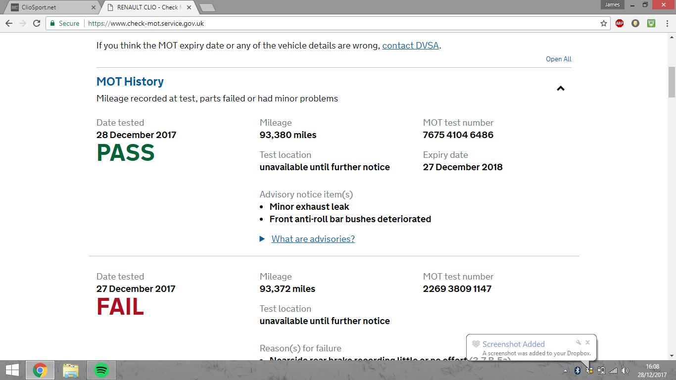

Boom
The little Clio has cost me a fair few hours of pain and misery over Christmas, but I believe I've saved at least £200 doing it myself, so happy days.

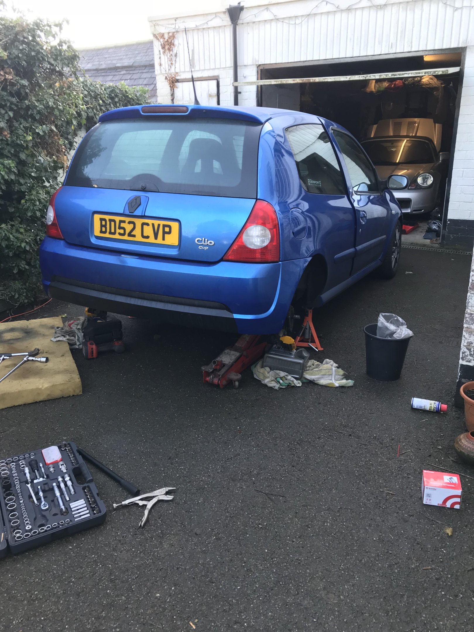

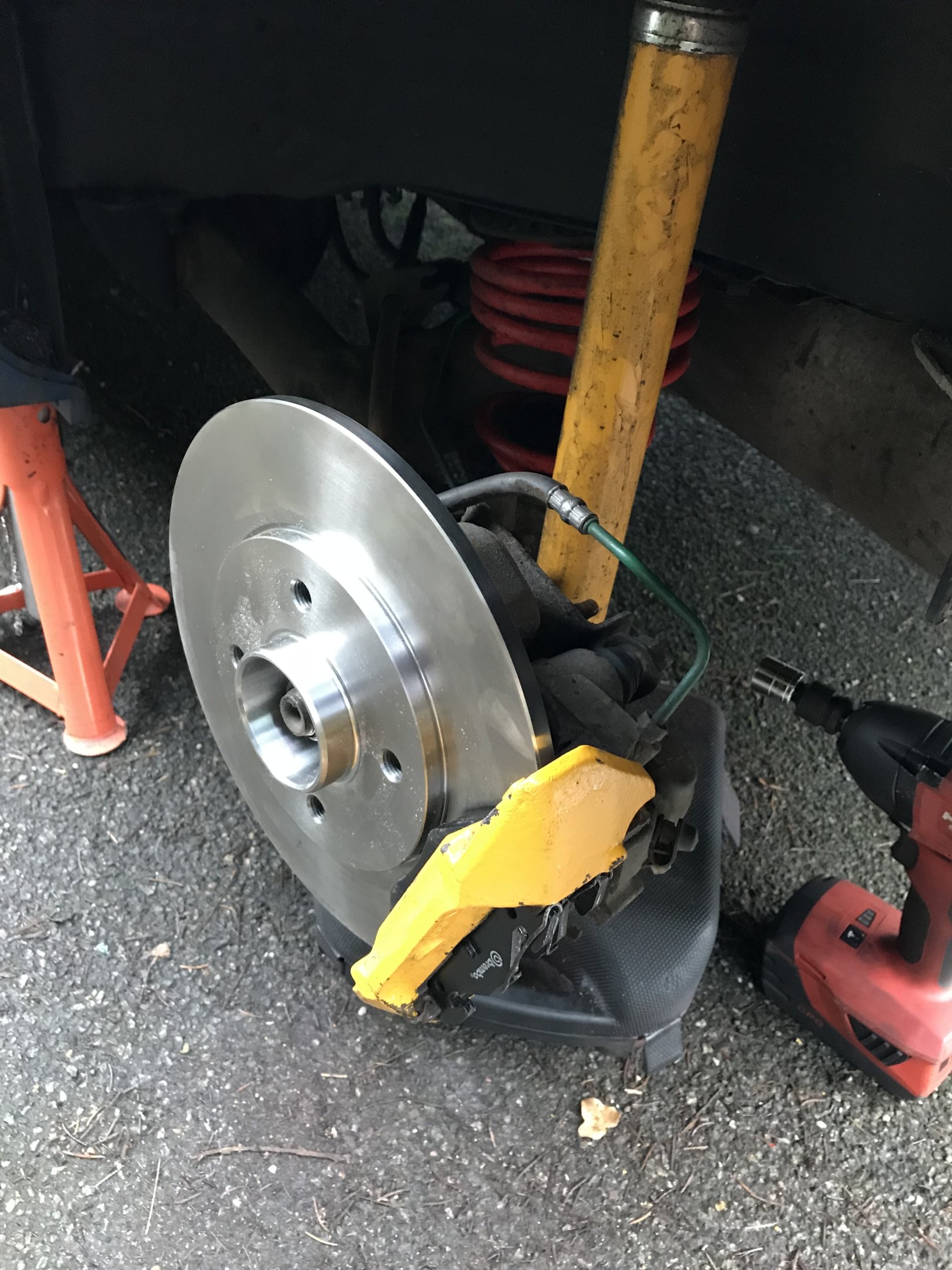

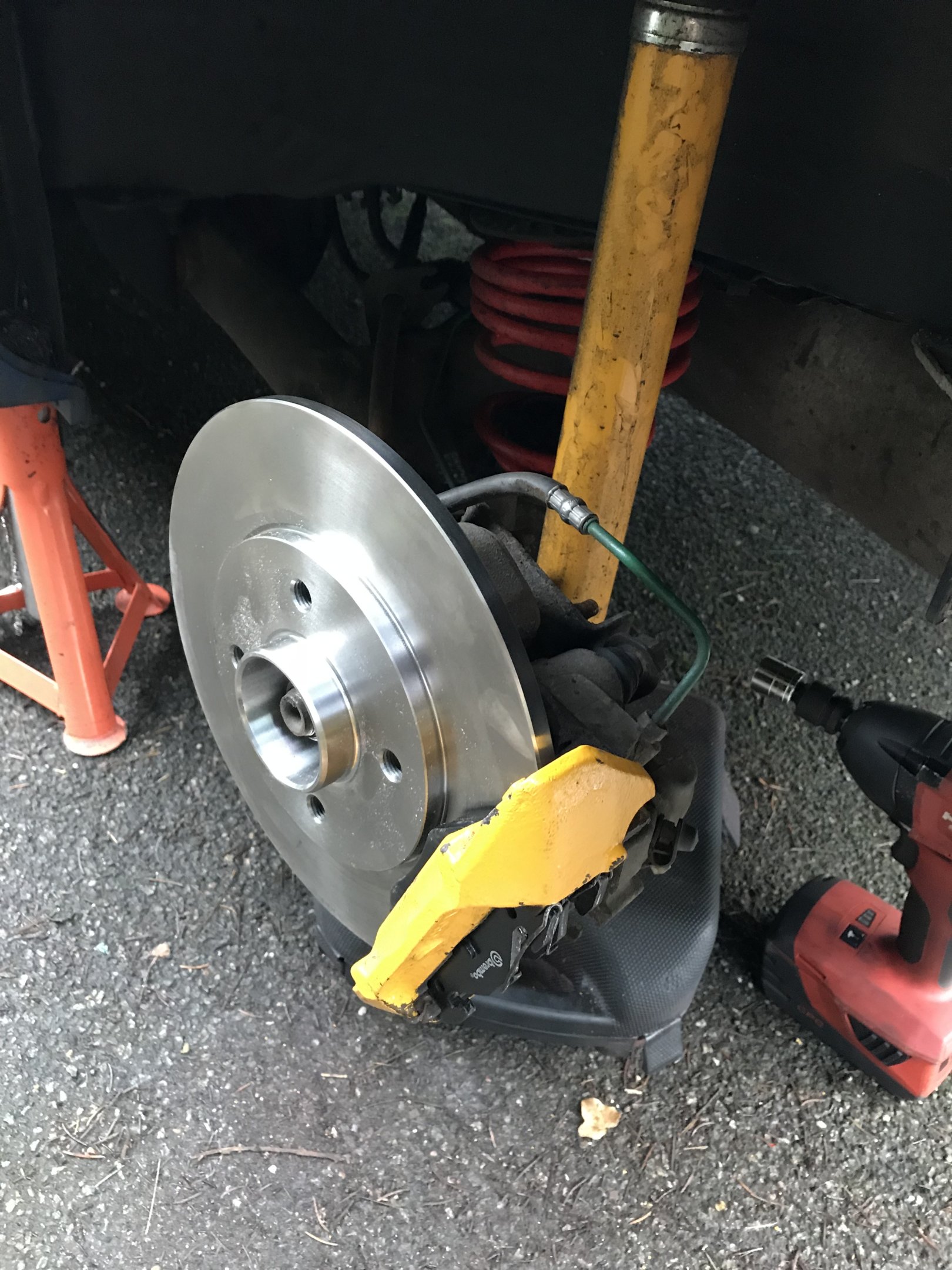

Cracked on with replacing rear brakes, brand new OEM Brembo pads and discs - would have preferred to go uprated but just can't afford it sadly.
Of course, something always crops up on even the easier jobs, for some inexplicable reason the old O/S rear disc WOULD NOT budge, took a fair bit of hammering to get off, and even worse - the new disc was 10x more difficult to get back on - for some reason the bearing would just not fit around the axle stub. It was like it's expanded over time or something, wtf :expressionless:. Got there eventually with a LOT more hammering (chock of wood and a cloth over the hub to protect it). So weird as the old N/S disc came straight off, and the new one slid straight on. Cannot explain it.
Also managed to round off 3/8 of my studs trying to remove them from the old discs.. fml another expense I could do without!
Hopefully the new rear brakes will sort my MOT issues. (Imbalanced brakes, binding one side and no effort from the other).

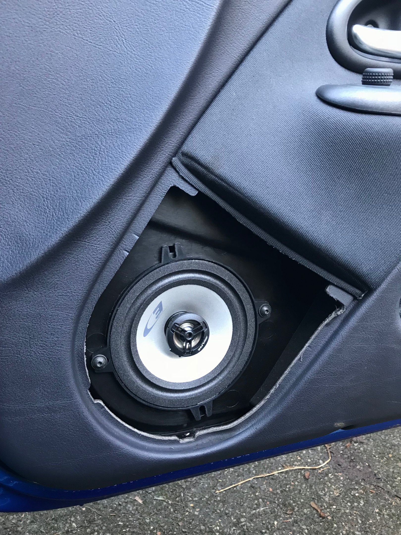

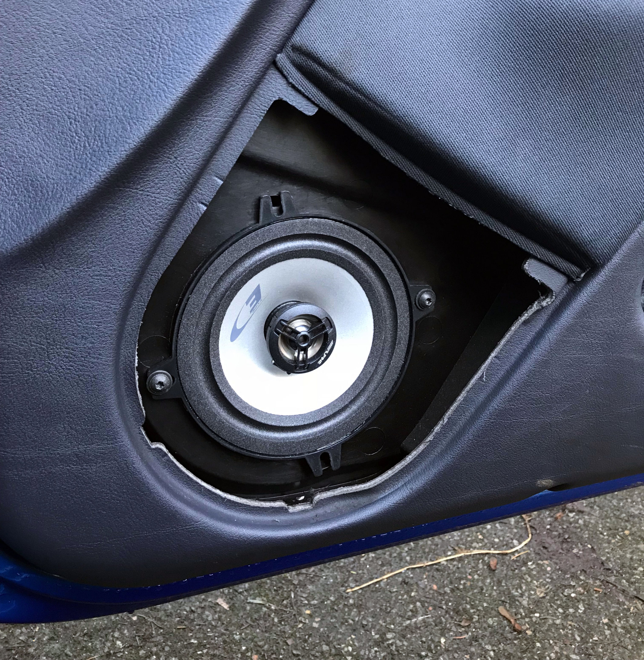

Looks good, what model are the speakers? Anything else needed to fit them? Have been looking at speakers just couldn't decide which to go for
SXE-1325S
Straight fit, plug and play, literally took 2 minutes to do both sides. £30 brand new off Amazon, not a huge difference, but for that price you can't go wrong really! Thinking off sound deadening some of the car now, especially the rear just to lose some road noise.

SXE-1325S
Much appreciated, will have a look at them, have you got full interior in the rear still?
That's a great upgrade doing the speakers and they sound a good buy for that money! Anything over standard is an improvement but in the standard positions and oem is the way :up:

Yep I was looking for some that would just plug in didn't require any modification, happy with the results!

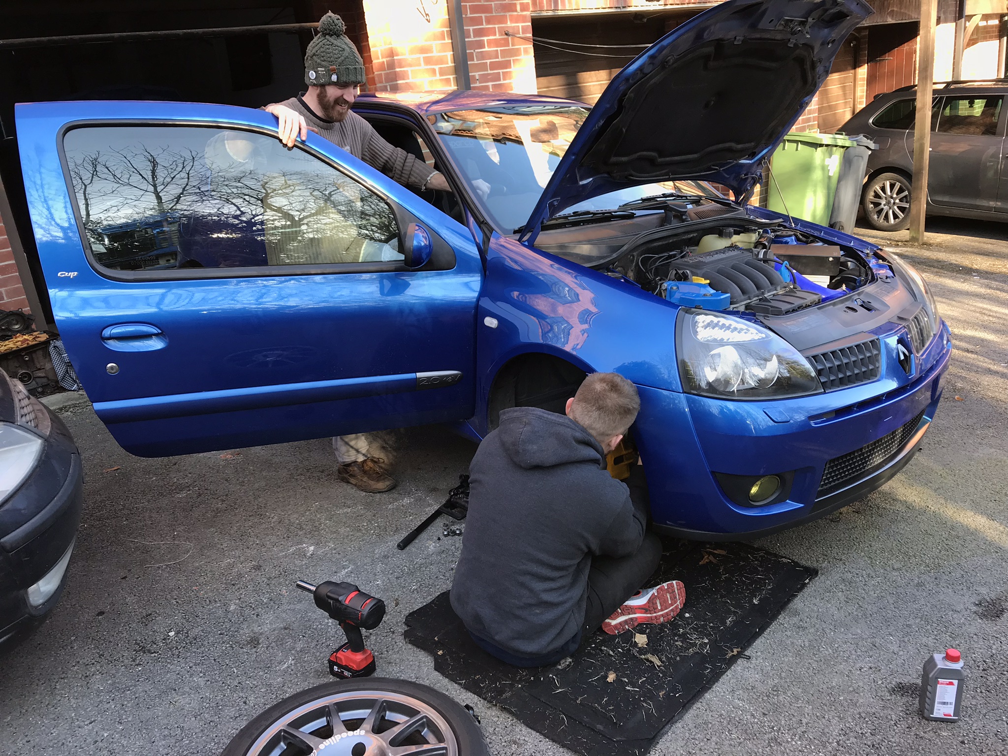

This one's from a while ago, @dann2707 & @Coops Mk1 bleeding the brakes whilst I...erm..
@dann2707 also came around last week to help replace the the rear Stub Axle which had somehow bent, knackering the bearing and causing the disc to sit at a slight angle, causing the rear pads to bind every time it rained. Cheers dude!

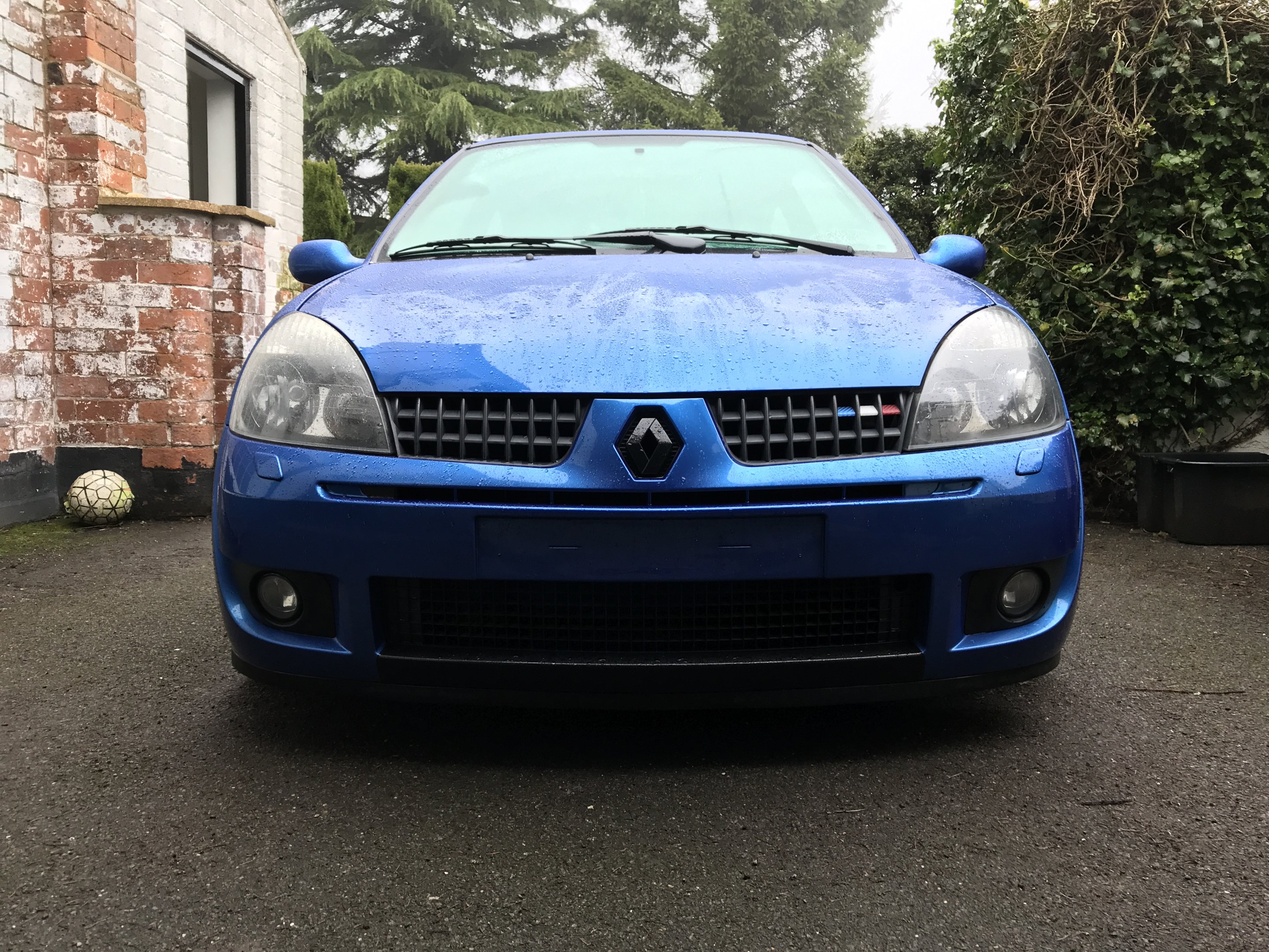

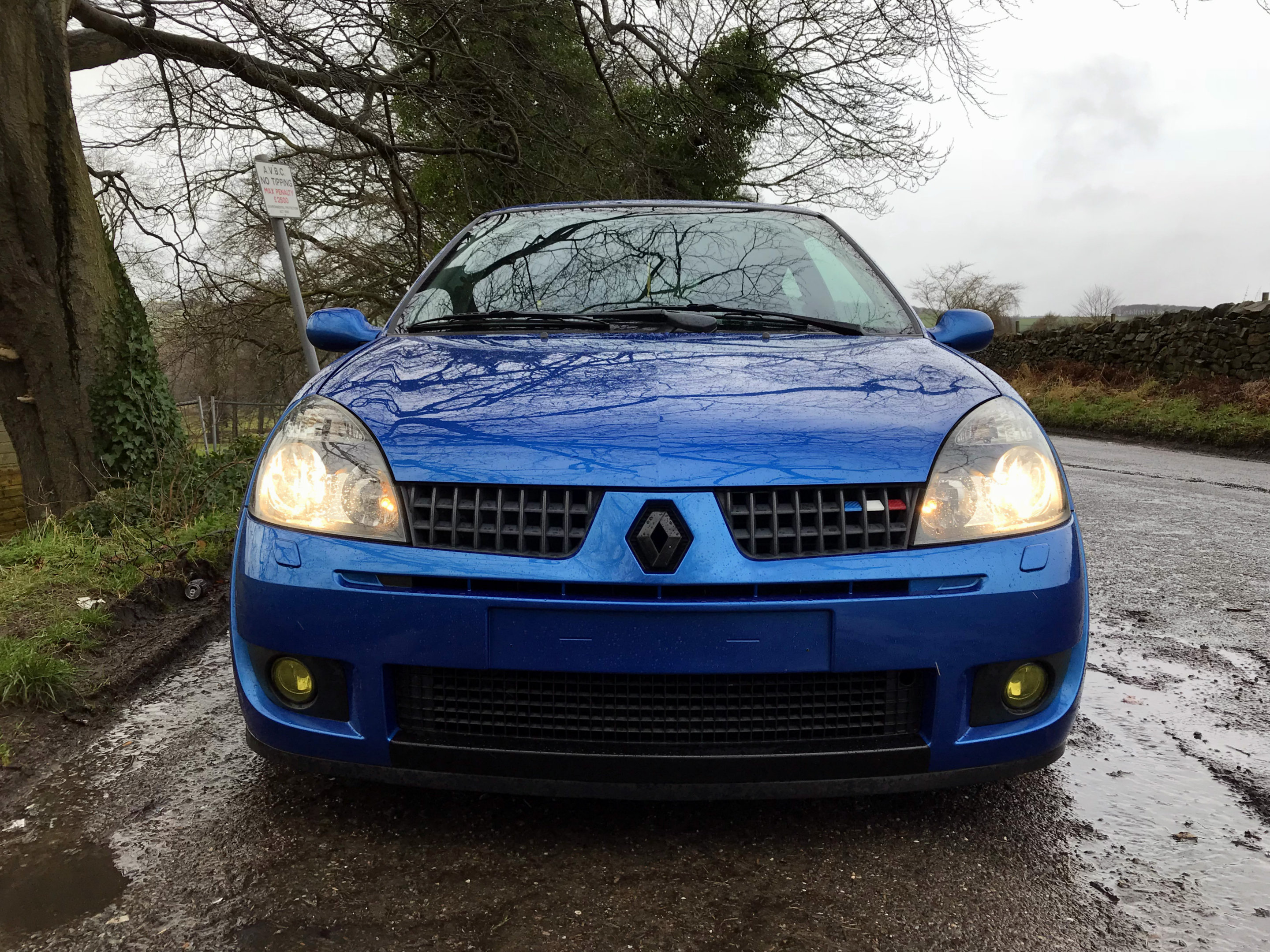

Took me a while, but finally realised the tinted yellow fogs looked properly tacky, so off that came. Cleans up the front.

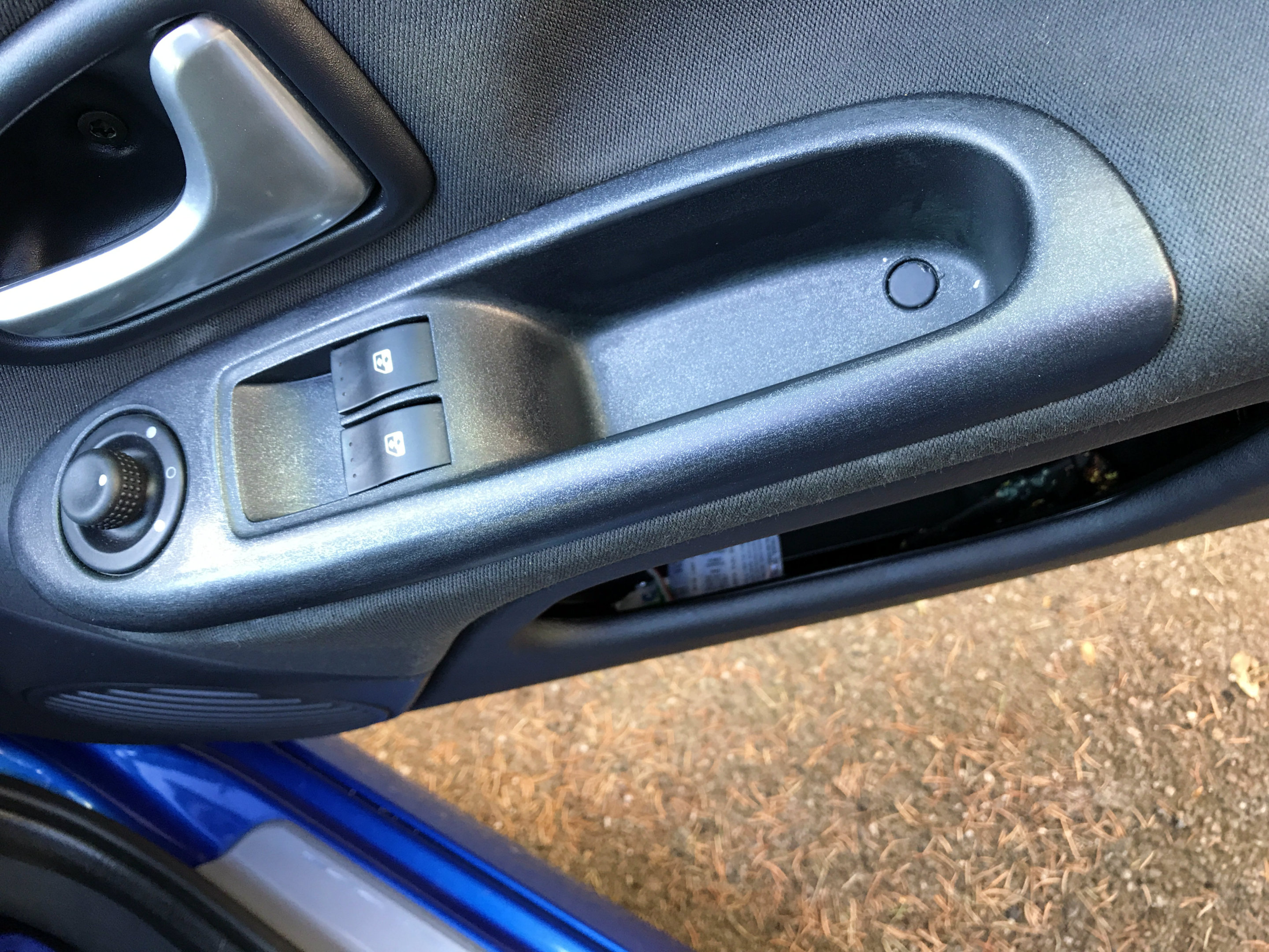

With the sun shining yesterday, and not too much else to do on the car, I got around to sorting out the 'sticky' door handles which are a common problem it seems these days. A bottle of oven cleaner spray, a couple of scouring pads, some plastic trim renovator and a bit of elbow grease later...
Now completely smooth and shiny, makes quite a difference! Happy days.
