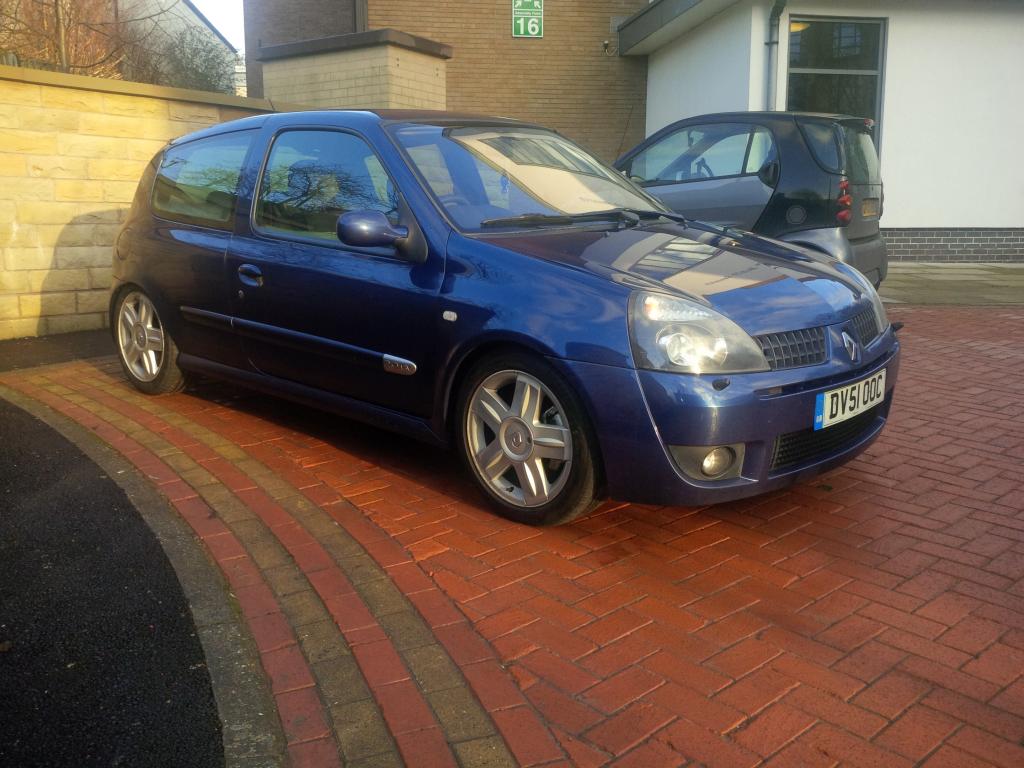

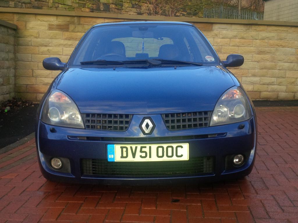

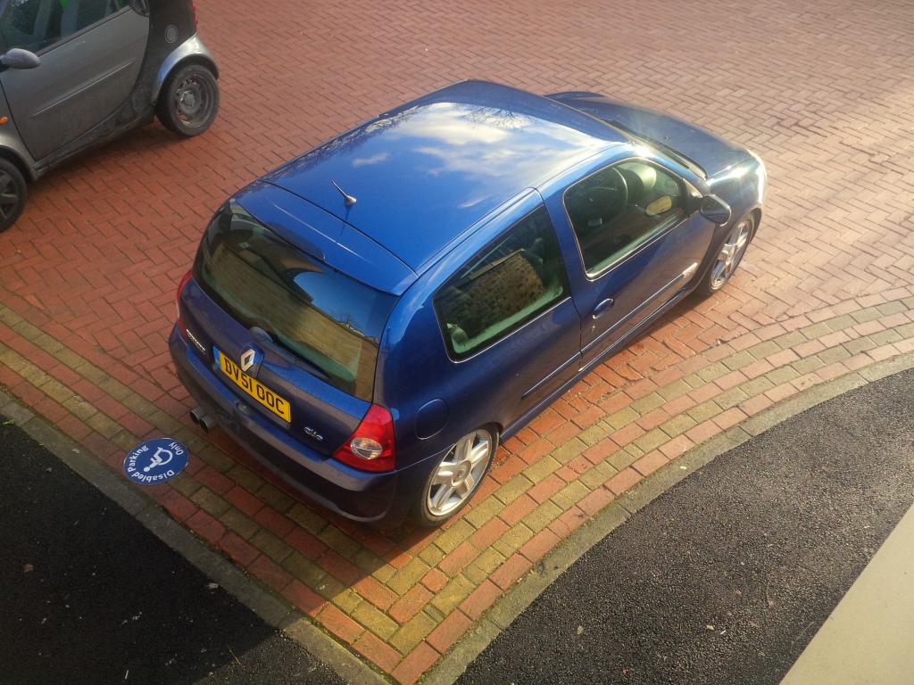

So the story starts as this. I am in my final year at university now and after a very short discussion with other lads on my course we have decided that to celebrate our university careers we are going on a road trip.
so the plan is to go to le-mans, departing England on June 12th. spend a weekend there, then on to Germany for a few days at the ring followed by a few days in Amsterdam before home.
good plan i hear you say? then i realised that i drove a 1.9tdi VW bora. this would not suffice. So i got my car up on swaps in the hope of finding something more worthy of a road trip.
on 13th Jan i drove from Oldham to Dudley and picked up my first clio sport 172 in exchange for my bora.

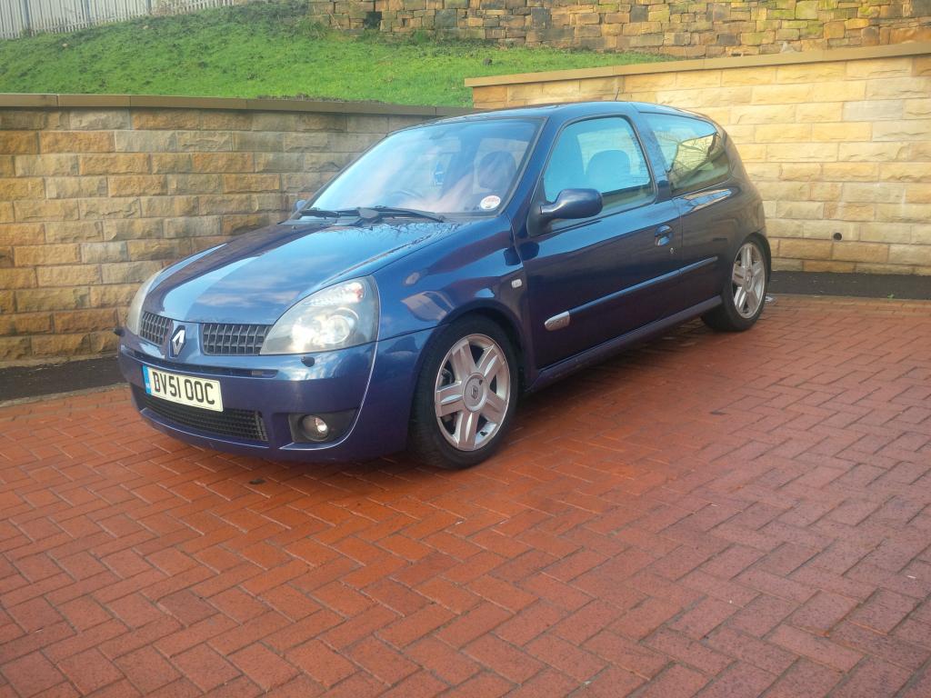

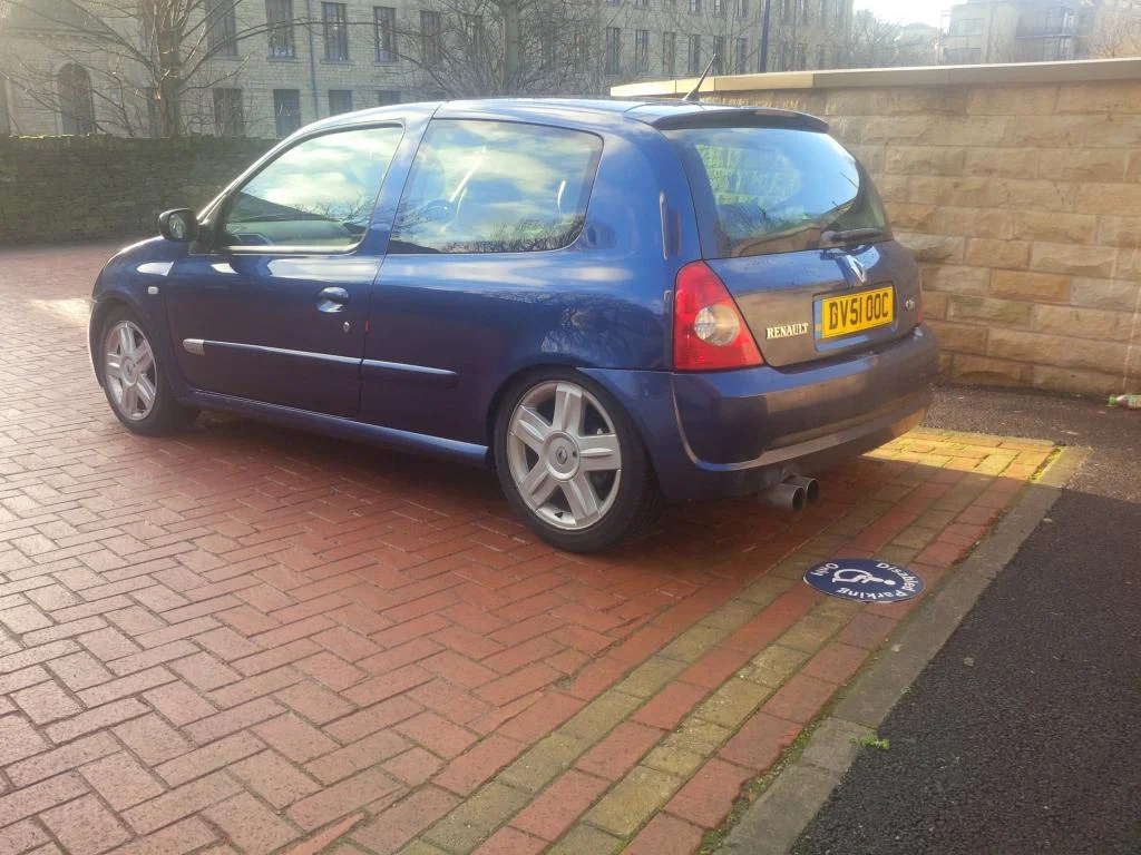

below are a few pictures i took on tuesday morning at uni :
now the car seems lovely and straight on the body work and even the interior is pretty clean. it does come with a few problems. what do we expect for a 12 your old car?
So it is lowered but as far as i can see it is not on coilovers but seems very low and the ride is VERY stiff. could these be ultra low springs?
It has a Ktec racing exhaust twinned with a miltek backbox.

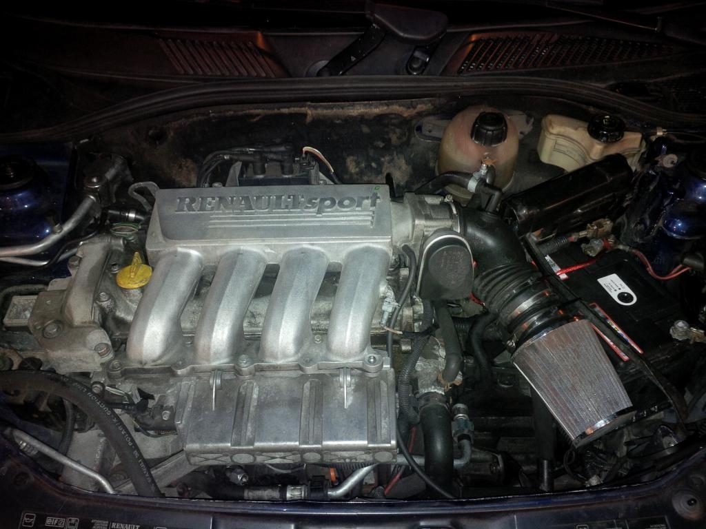

A silly cheap cone filter sucking in all that lovely warm engine bay air ( thinking of either an enclosed filter or a standard airbox with panel filter to replace it)
Silly Ripspeed head unit with tiny dvd screen that doesnt even fit properly.
steering wheel is at a strange angle when the wheels face straight ahead.
Digital climate control only blows hot air.
electric mirror stalk is broken and window switches a bit loose.
cigarette lighter has intermittent connection.
Needs a good service and i may throw a cambelt on as a precaution.
also desperately needs engine mounts doing. The engine attempts to leave the engine bay if you rev it with the bonnet open so you can see it.
Lovely headunit configuration.
This is the steering wheel position when the wheels are in a straight line....

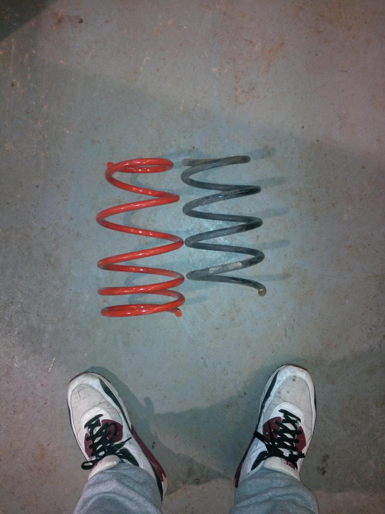

So I took it over to my mechanic last night for him to run a fine tooth comb over my new motor. Turns out its been bodged in several areas......

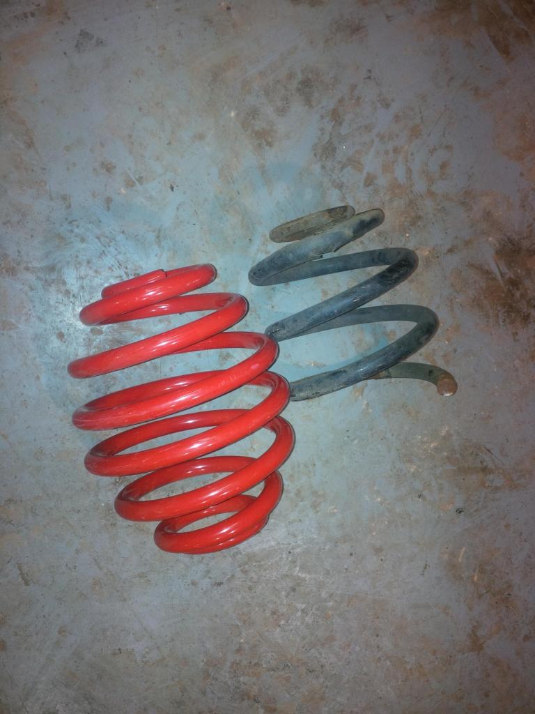

It's running on cut springs. Who does that anymore!? So I have ordered asset of cheap pro sport -35mm low ring springs just to make the car safe to drive for now.

@ welshname, im from chadderton
@ Jay.S i am technically classed as disabled at my university so get a disabled parking permit for on campus. i have arthritis in both hip joints.....

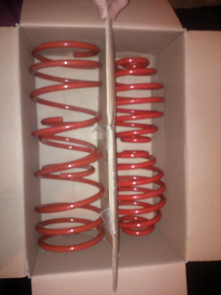

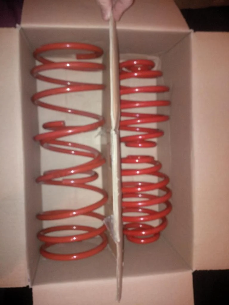

now for some more pictures! came home from university this evening to find a package on my bedroom floor.
ready for installation ASAP and get rid of the dreadful cut springs. the handling is deffinately compromised by it, solid bouncy rear end is not good. these should rectify that, i hope.

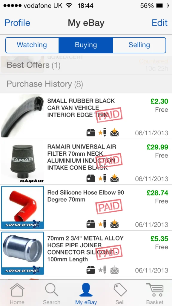

and onto my lovely air filter set up (this was already done before i became the owner).

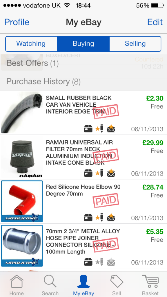

and the piece of kit im looking at replacing it with.

Better with the standard filter back on, that kit is a waste of money.
even with the cold air feed? what sort of power would i be loosing with an enclosed filter as apposed to a standard air box, out of curiosity? i like the induction noise on the clio tbh.......
welshname
The only aftermarket air filter setups that don't seriously affect performance are:
1) swapping to a ph1 setup
2) constructing something similar to the ktec setup which places the filter behind the passenger headlight. Very cheap to do compared to actually buying their kit. This method allows you to keep the induction noise from a the cone filter.

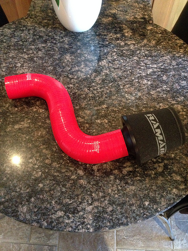

Here you go mate, better with this kind of set up if anything. The noise is fantastic too.
Got all the bits off eBay, obviously you need 2 of the 90 degree bends.

ah right okay i see, so literally 2x 90 degree bends to situate the filter directly behind the passenger headlight, looks good that azza_
  ph2 clio 172
cool, even that works out at around the £100 mark, but i guess that is cheaper than the k-tec induction kit? the carbon box i posted before is only up for £40 quid ish posted.
welshname
You could use your cone filter that's already on the car so eliminate £30 from the cost straight away.
The different between what you posted up and what Azza has is that Azza's had benefits, yours had none.

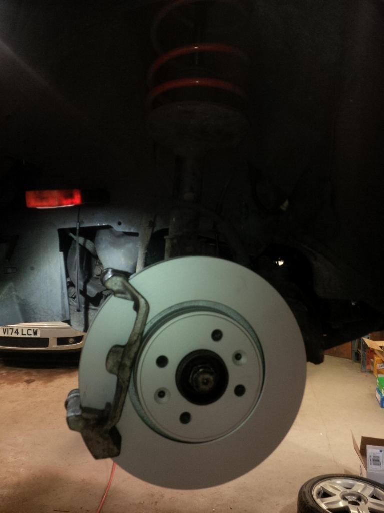

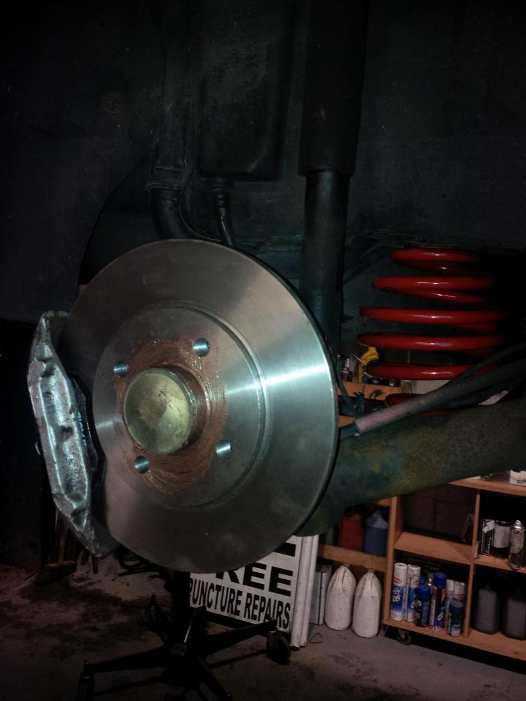

well last night i got severl parts fitted, springs are now on. discs and pads all round, track rod end and bottom ball joint.
however, i was sent the wrong rear discs using the 22 teeth abs rings rather than the 44. so now my ABS light is on. they have agreed to supply the correct parts however so should have them swapped over soon. Another part im finding it hard to get a hold of though, is the drivers side inner cv joint. ive had about 6 ordered from different motor factors and they keep sending thwe wrong ones!?
i keep getting sent the usual cv joint sleeve type boots. but im sure the inner cv on the clio also has a metal cup attached to the rubber boot? if that makes sense? or am i wrong?
few pictures later to show you lot how dangerous the suspension was on this little clio before i fitted new springs........

I did however get the new springs fitted along with new discs and pads all round, bottom ball joint, track rod end and patched over the inner cv boot. just needs the wheels balancing and tracking doing now and should drive nicely. Everyone likes a few pictures so heres a few of my shiny parts:
This is how dangerous the previous springs were:
Brakes:
