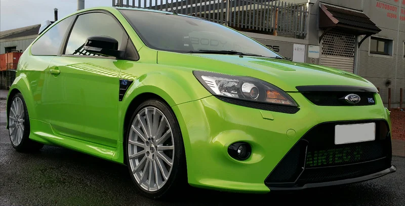

Another update to this, had an idea in my head that I'd wanted to do to the car since I got it and this week I finally managed to get it done.
Started with a set of the wheels I'd been after coming up for sale over on the RS forum, these to be exact:

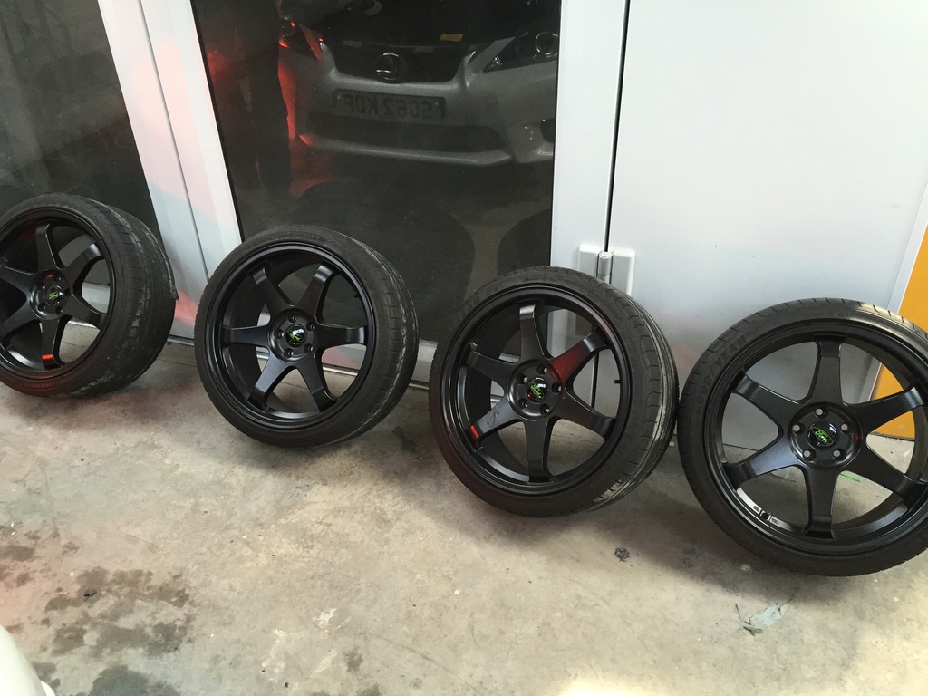

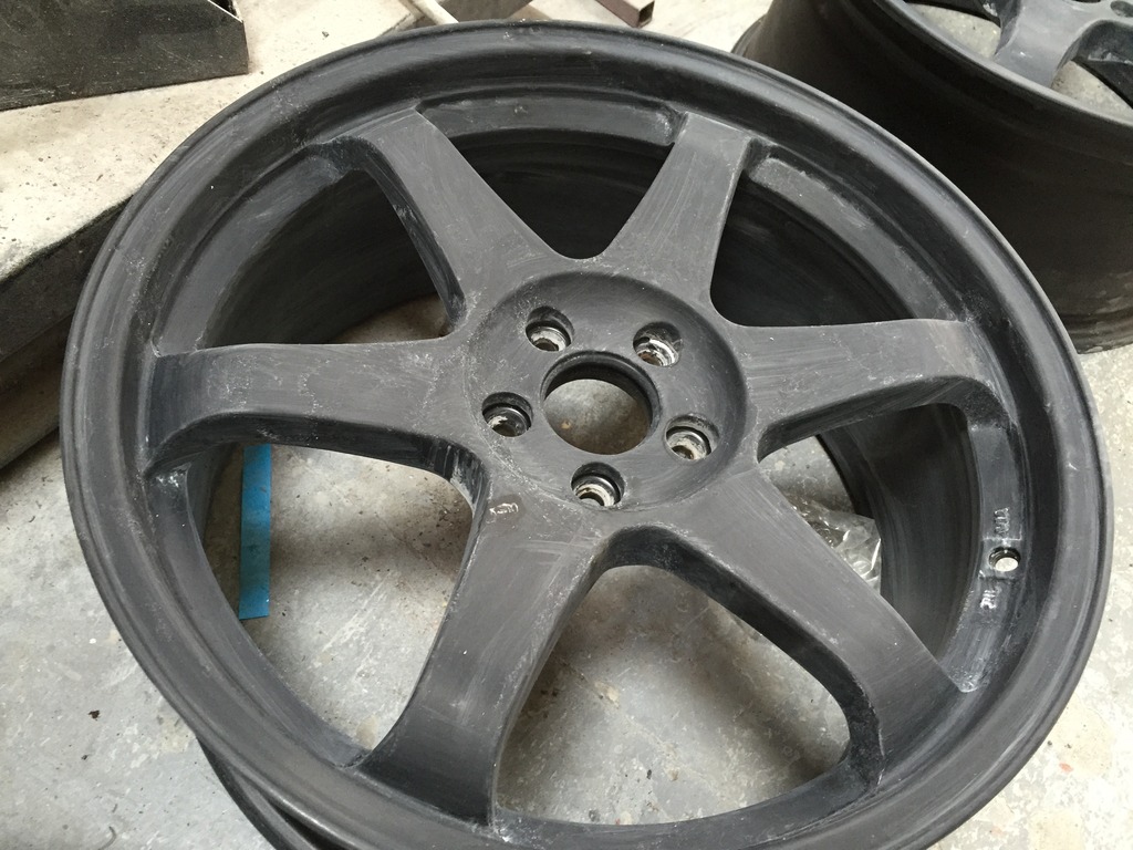

JW Racing (a Ford tuning company) alloys designed specifically for the RS/ST, as nice as they are in black I had an image in my head of the colour I wanted them to be, so the day they arrived I stripped the tyres off them and set about prepping them for paint:

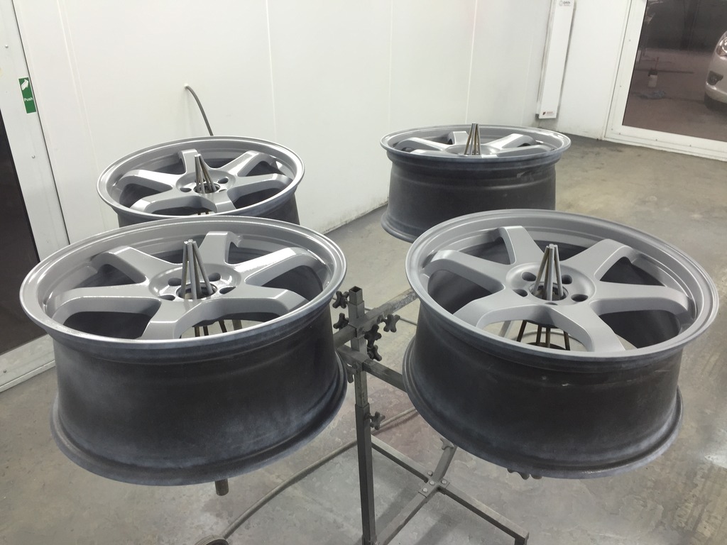

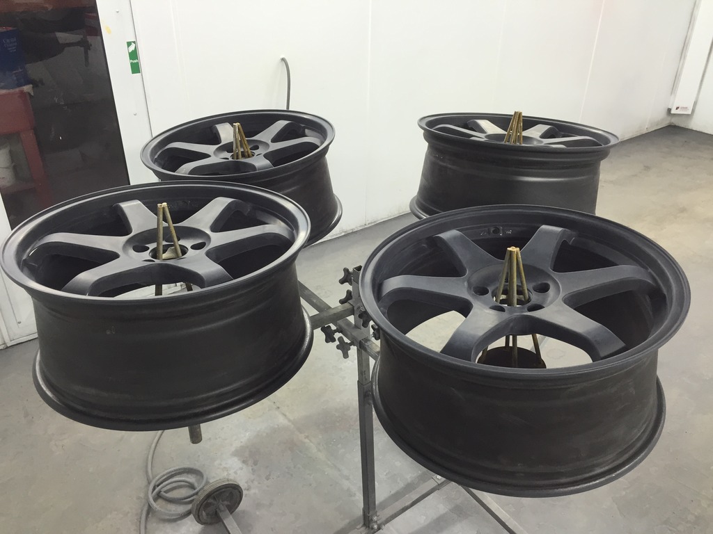

Then into the booth on the wheel stand, cleaned up and ready for a coat of wet on wet (very thin primer that doesn't require sanding, just to help adhesion)

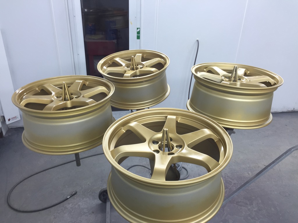

Primer starting to be applied, only the faces done at this point:

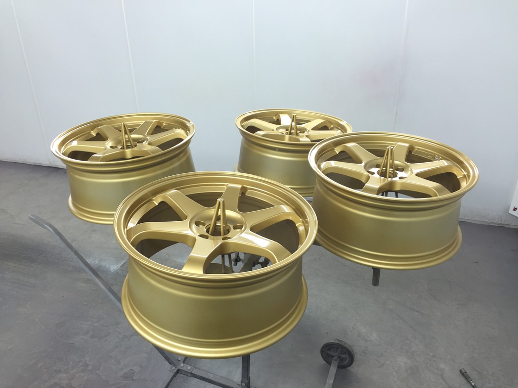

Once this was dry, I set about applying the marmite colour I'd chosen for the basecoat, Suzuki Mars Gold:
Fully based up and lacquered ready for a bake:

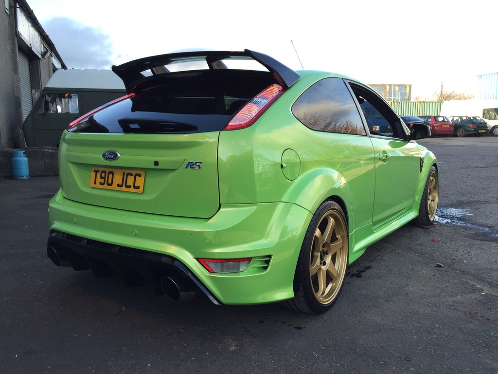

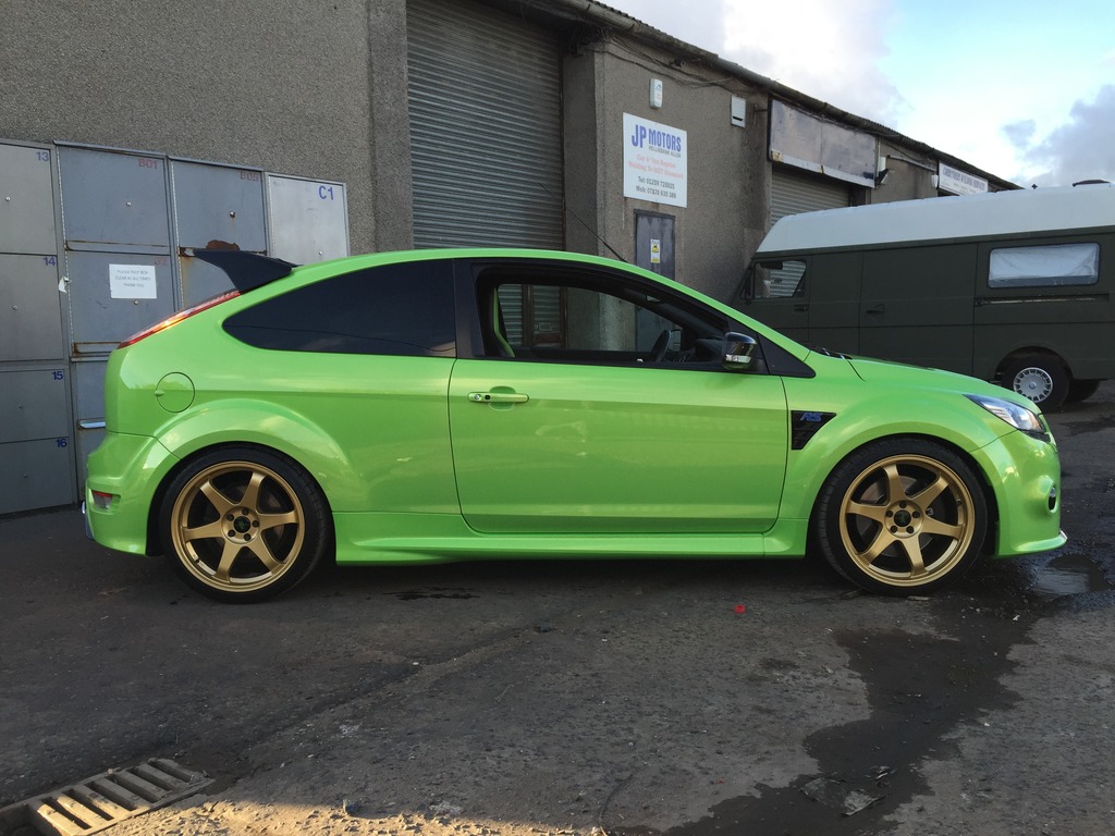

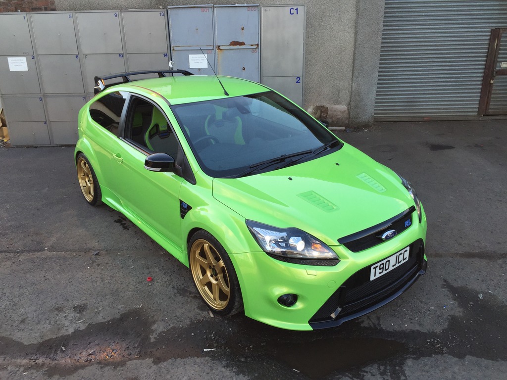

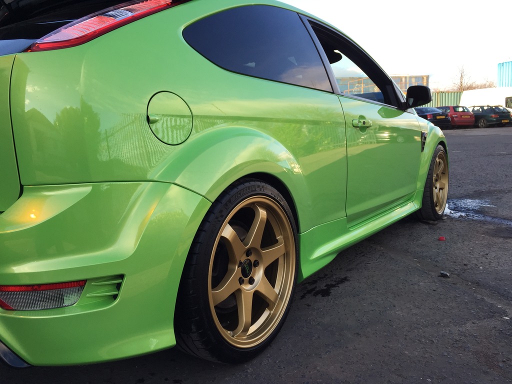

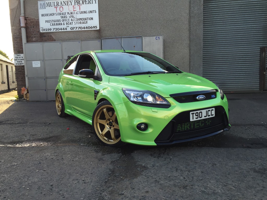

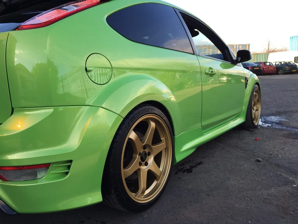

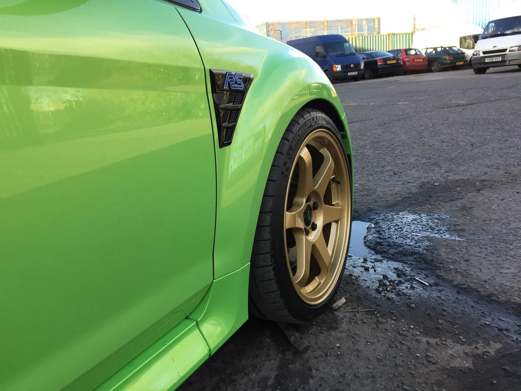

Left them overnight to harden up a little more, went in the next day and swapped my tyres over from my standard wheels. The finished article now looks like this:
Makes me chuckle looking at it in real life, it looks like an R/C car with how far out the wheels sit in the arches. I'm absolutely in love with it.
