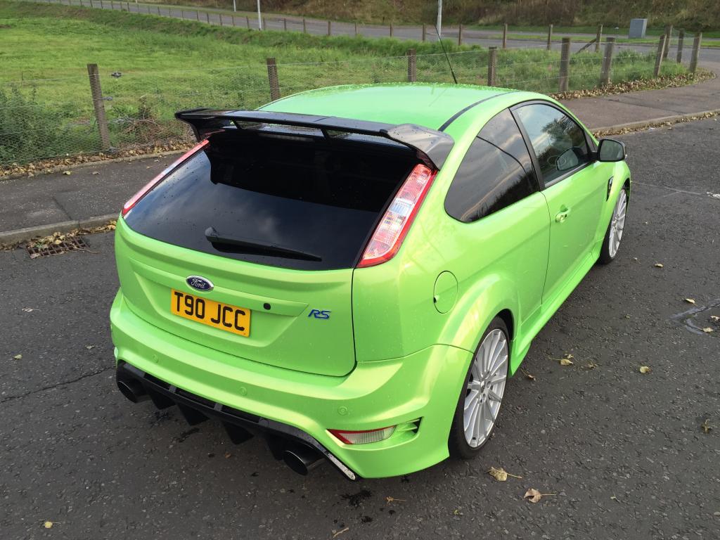

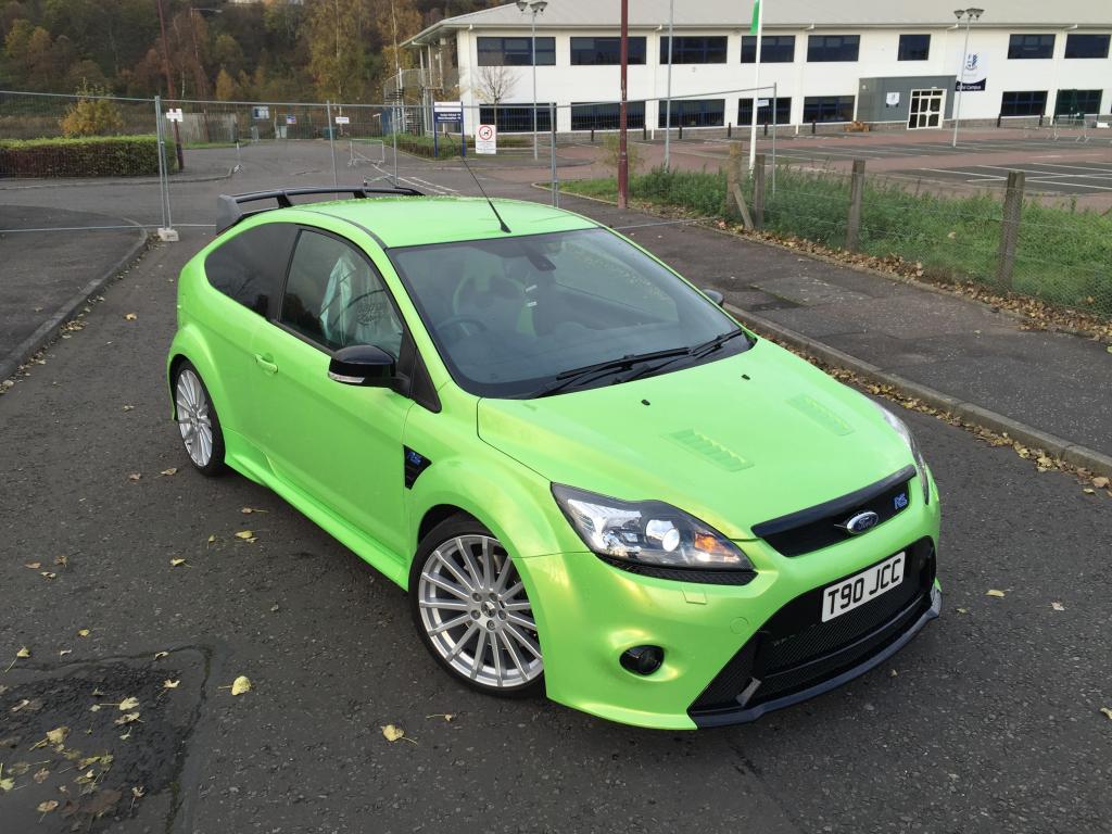

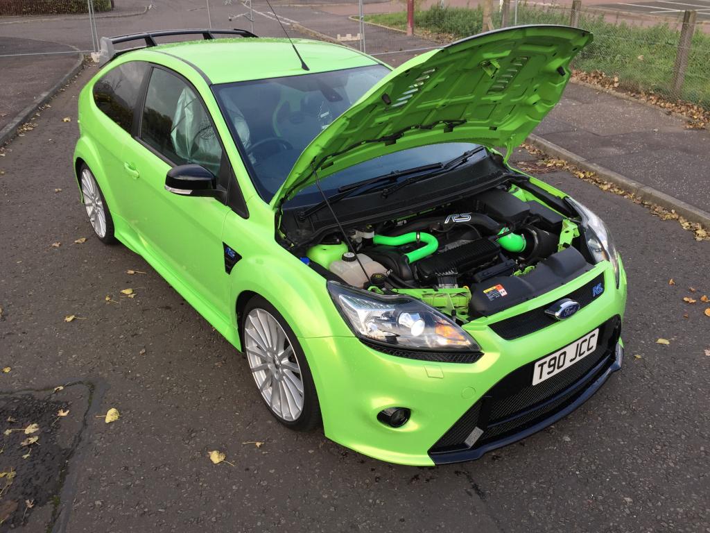

Gave it a clean at the weekend, decided to take a few quick iPhone pics. Couldn't be arsed drying it off for them, lol
Should hopefully get an uprated inlet from Sitech come the end of the month. Get it painted up to match the car and on and it's another step closer to Stage 4!

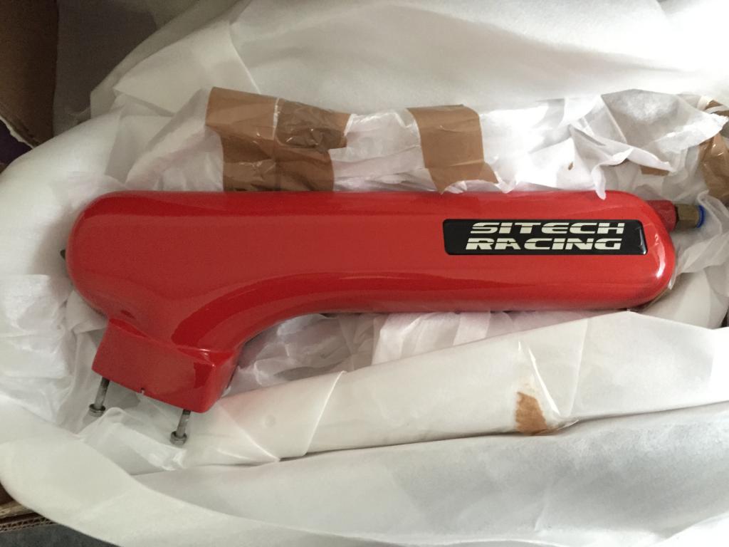

Another update, picked this up a couple of weeks back, got it for a decent price second hand from the RS forum. It's not "necessary" for the power I want, but it's a safer way of doing things as the plastic item on the car has been known to fail especially at higher states of tune.
It's an uprated inlet manifold, Sitech racing's own design. Was in near perfect condition but as it matched absolutely nothing else on the car colour wise I decided to give it some paint, namely Ultimate Green to match the bodywork.

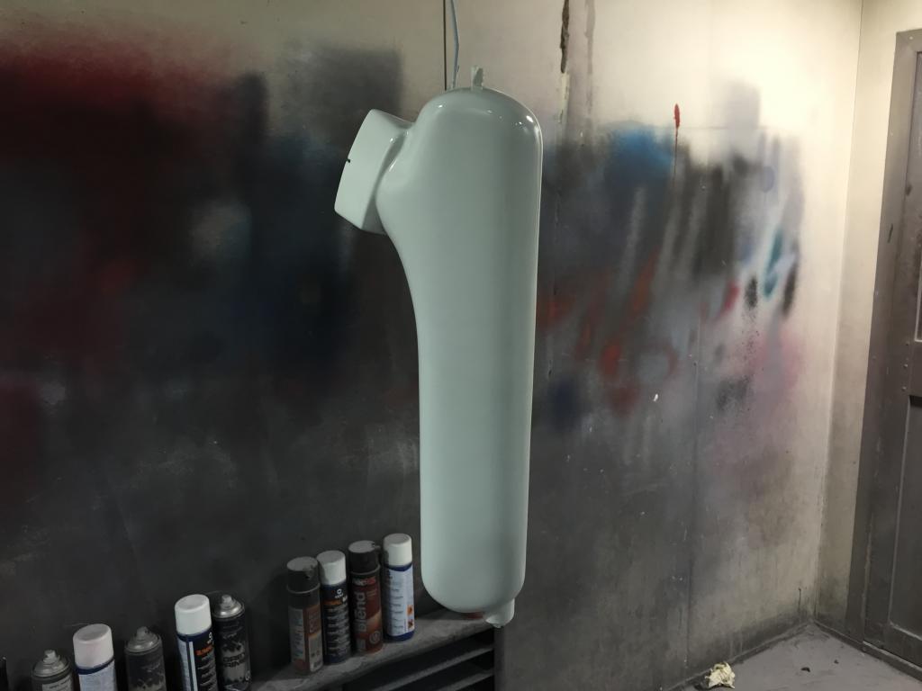

Stripped it down:

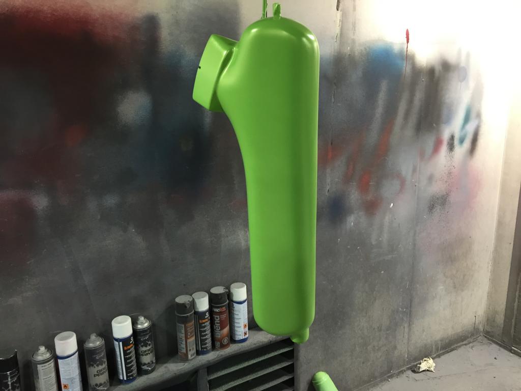

Prepped and hung up in the booth for paint:

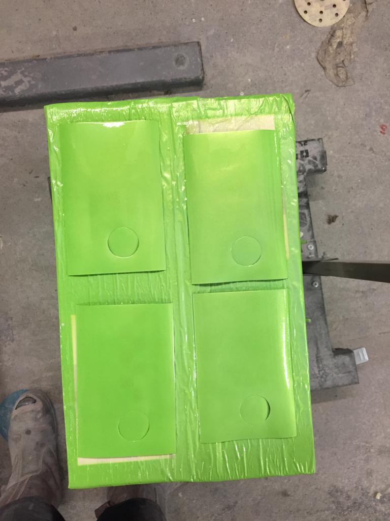

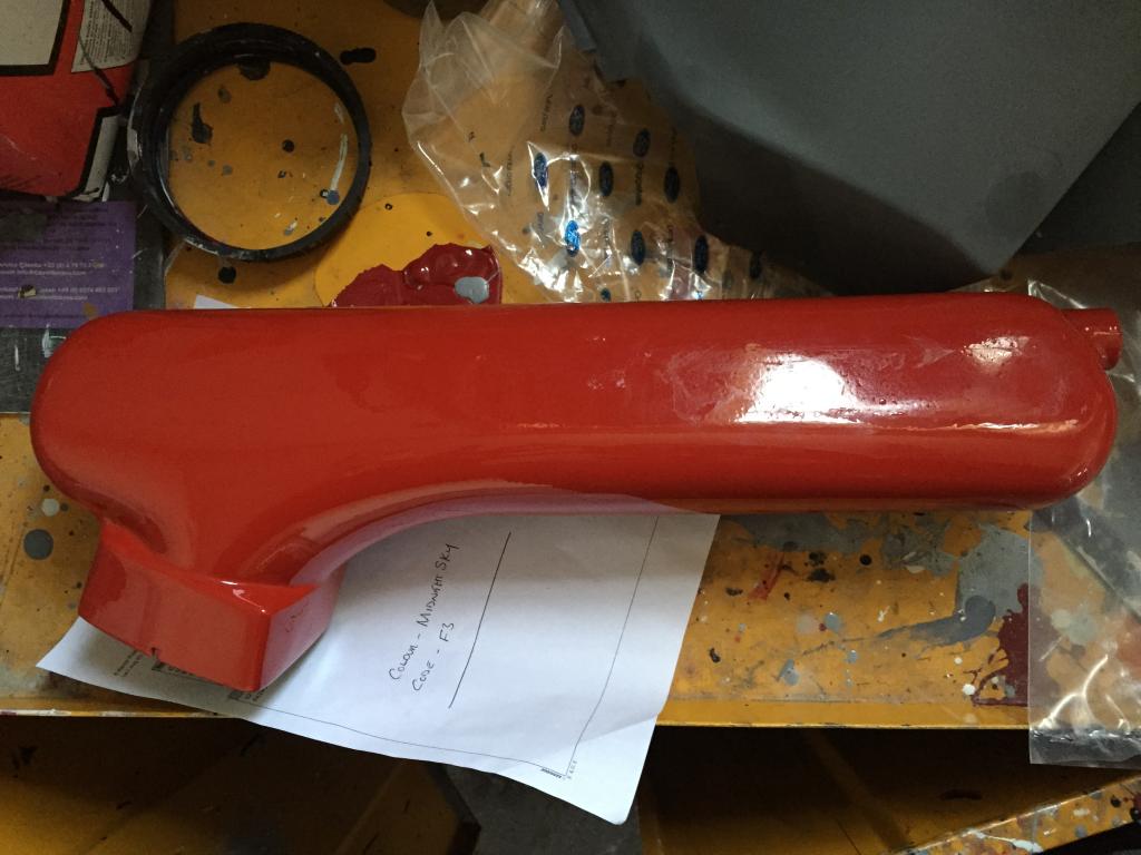

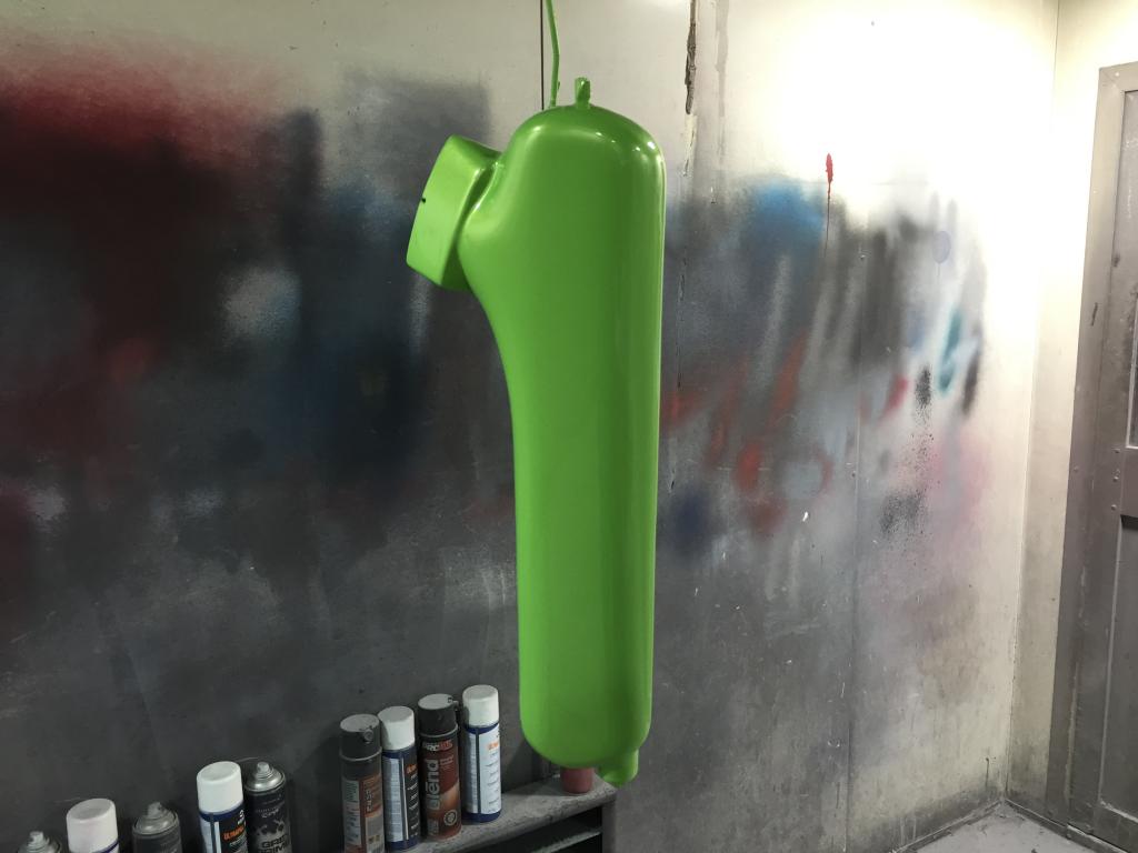

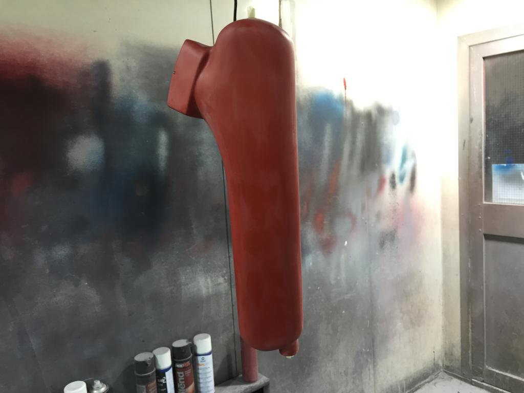

Did a few spray cards trialing different ways of applying the basecoats to get a shade as close to the car as possible, Ultimate Green is well known to be not the most straight forward of colours. In the paint scheme we use at work it's made up of 2 different basecoats, a solid green is applied first followed by a tinted clear which adds the pearl element to the colour. In the end I settled on 2 coats of the green undercoat followed by a single coat of the tinted clear as this gave me the best match to the car:
Applied a white basecoat first to kill the red, helps make the green more vibrant also:

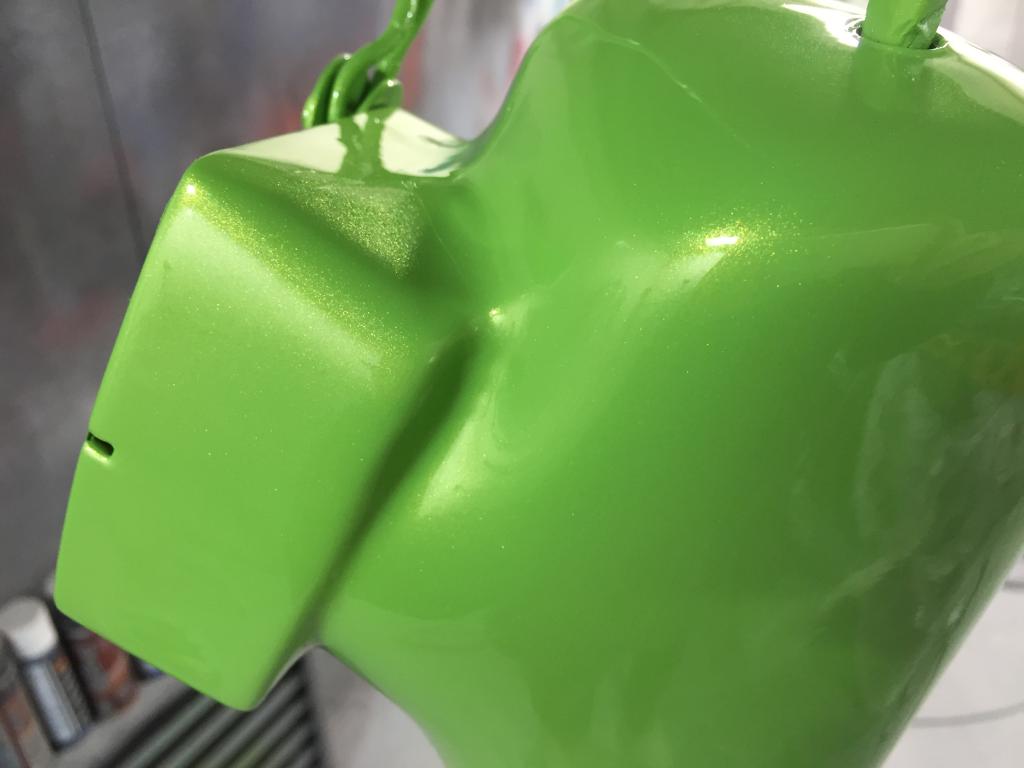

Green undercoat and pearl coats applied:
Finally lacquered:
Up close shot trying to pick up the pearl:
I will be flatting and polishing the face to give it a nice smooth finish, then will need to get some form of graphics on it. Will be Sitech Racing's logo and possibly the Skull logo they use to go with it, not entirely decided yet.

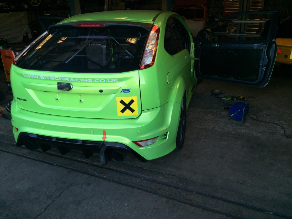

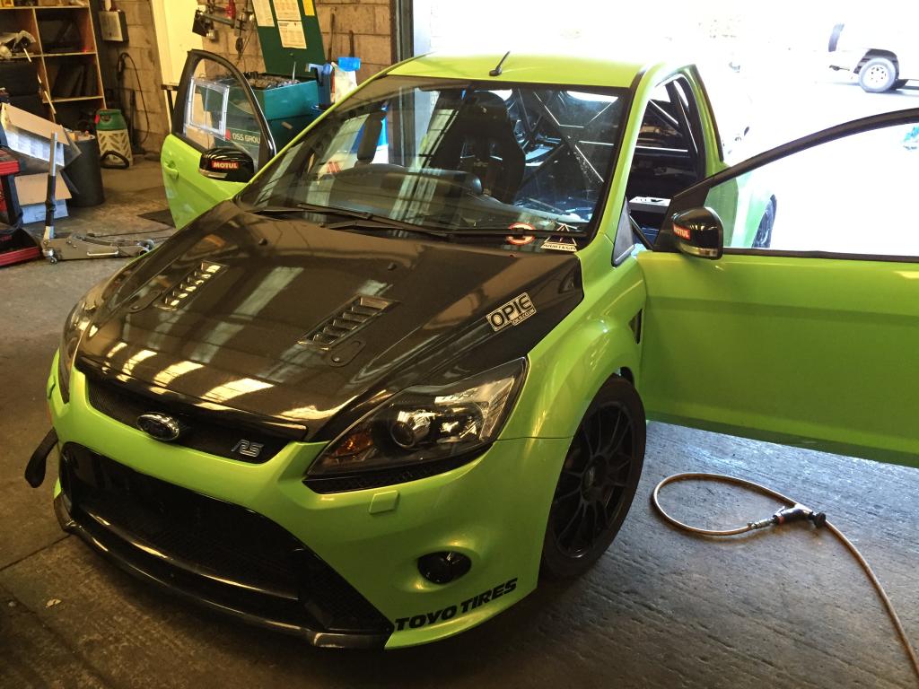

Another update, went to Sitech yesterday to have my plenum fitted, 650cc injectors put in and Revo's stage 4 map file uploaded. Soon as I got in the door at 8:30am I was asked how I was at removing stickers, handed a heat gun and an extension lead and tasked with removing some decals from Simon's new race car:

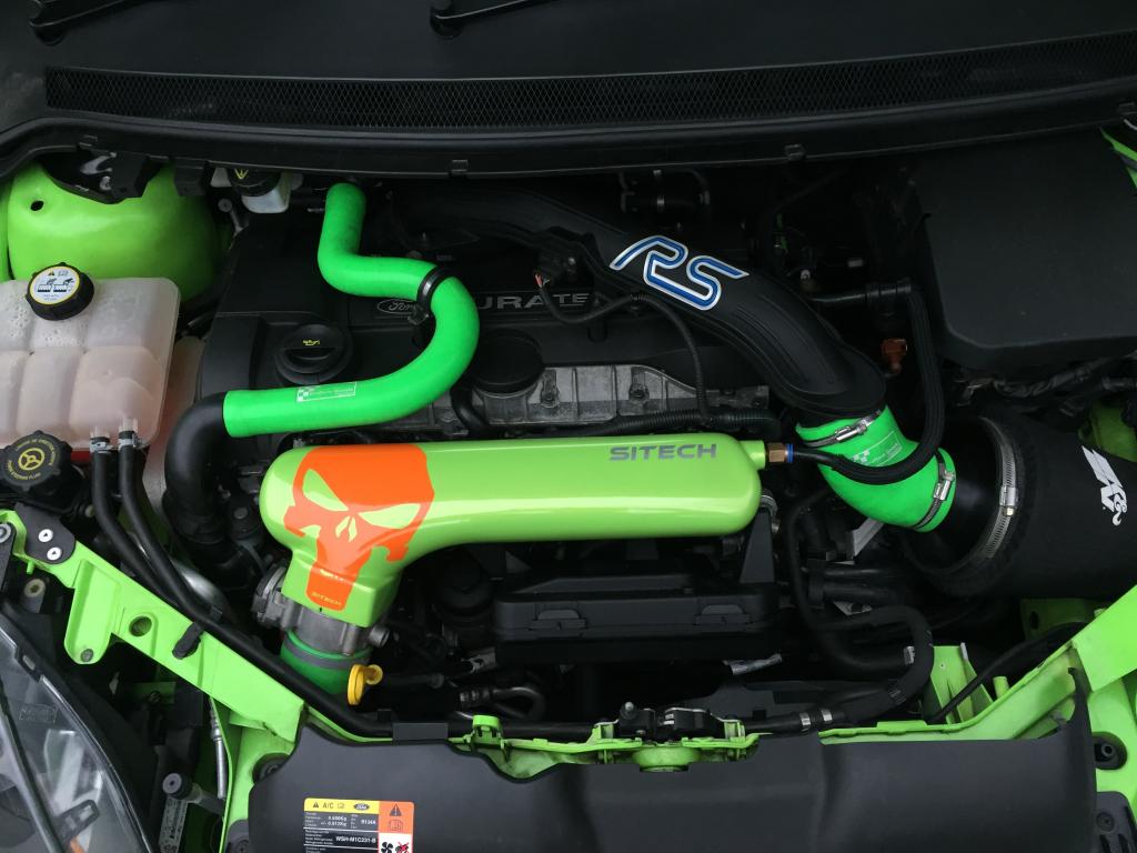

A serious bit of kit! Whilst I was doing this they set about about the work on my car. The inlet looked a bit bare in just paint and seeing as it's a Sitech inlet and they've done all the work on the car I thought it should have Simon's logo on it, so had a rake through his stickers and came up with this:
After this was fitted with the injectors and the map uploaded it was out for a test run before paying the bill and taking the car away. No point to putting the car on the dyno at that point as the eECU takes a while to learn/adapt to it's new settings properly. As Simon has had a sort of open day-ish type thing on all weekend and was open on a Sunday he told me to bring it back then if I wanted a run.
