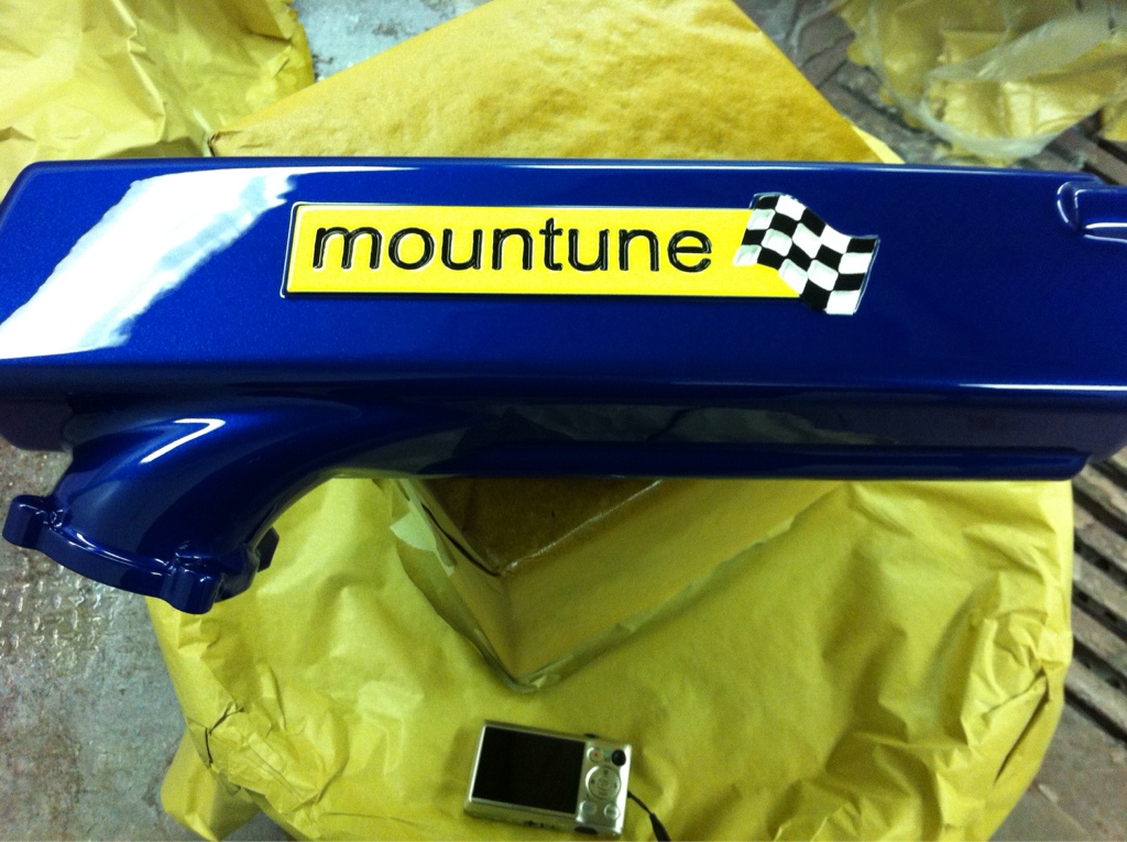

I remember your post about that getting done at your work actually! They look good when done like that, but I can't justify over £100 extra for no performance benefit over the Sitech item. It shall be green whatever one I buy though!
Gally
All done using a spray gun. ;)
Didn't realise the Mtune one was so much more! Jeeez! For some lettering!
We painted Scott's Sitech one as the White paint fell off from memory.
Sack painting all that by gun! I'd be touching in the flag and letters tbh.
Mountune was only really good for warranty purposes, now it's just overly expensive with no benefit really.

Ah but as you know the talent was in the gun finish. It was a nice little project.

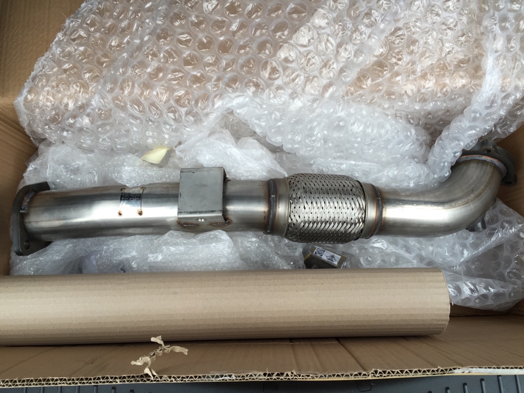

Small update. This just showed up:
3 inch Milltek downpipe, which Sitech shall be fitting on Saturday. Also getting every belt and tensioner changed along with a 5 year service for peace of mind. Seeing as the downpipe will now be 3 inch like the rest of the exhaust I'll get him to fire Revo's stage 2 map onto it as well while it's there.

Damn you took my Saturday morning space for this lol. Was meant to have my down pipe fitted on Saturday just there but it didn't arrive in time. Si messaged me to let me know it's in.
Lol sorry about that! I managed to get a cancellation slot from him a few weeks back, mega busy at the minute I think. I'm pushing my luck getting him to do the downpipe and map tbh!

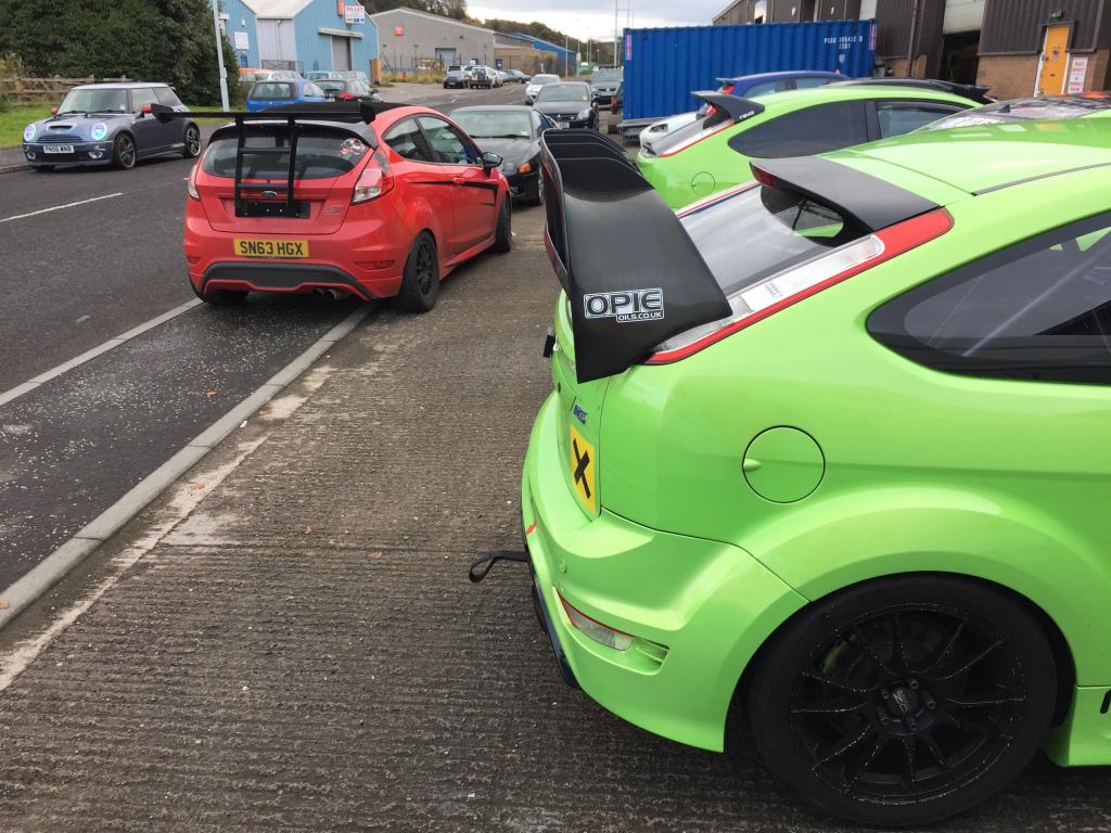

Had the car into Sitech this morning to get the new radiator fitted. Old one was leaking where the plastic end tanks meet the centre fins. Means I won't have to check the coolant before every run now so that's a relief! Also snapped a couple of very non-CS approved spoilers while I was there, personally I think they are awesome as they're both functional and on big power examples.
Car is well on its way to being 400bhp by the end of the year, which is my target!

I think the spoiler on the ST would look better if the car was a different colour.
Love it on the RS though! Sitech know what they're doing!

Simon definitely knows what he's doing when it comes to power. Between the two with the spoilers and the one with the Revo sticker you can see there's about 1500bhp sitting there alone!

It's currently running 370bhp+. Also R888s, 4 pots, coilovers, that wing etc, would run rings round my RS 😌. It's Simon's own development car.
  RB Clio 182
I really dont like those spoilers one bit, especially the ladders on the back of the fiesta, is that there to climb up and make it easier to clean the roof?
Nice car mate, dont be tempted to buy one of those ridiculous spoilers.

I totally would but it attracts far too much attention. Pulled up outside the paper shop and came out to local yutes giving it "haw m9, nice car". 😂

The spoiler on the Fiesta actually works well , its such a fun little car to drive. For the limited mods that have been done to it , it flys on track and still reliable and useable.
N0ddie
  Tesla Model 3
The spoiler on the ST took 2 seconds off the guys lap times around Knockhill.
Its scary fast.
Indeed. I've never driven it but imagine it's s**t loads of fun.
Its scary fast.
Yeah Simon told me that as well. Proper bit of home engineering!
Bodywork wise. At least from the back.
What is the spec on it?
Borg Warner EFR 6258 (62mm compressor, 58mm turbine) turbocharger, Sitech Racing turbo inlet pipe, enlarged boost pipework, Spec-R inter-cooler, standard fuel system, AEM methanol injection system, NGK spark plugs, Peron Race Edition tubular exhaust manifold with large primaries, Sitech Racing downpipe and 3 inch stainless steel exhaust system.
All of that plus coils, big brakes, R888s and other bits. Oh and a huge home made splitter you also won't like :wink:
One of, if not the most powerful new shape FST in the country.
