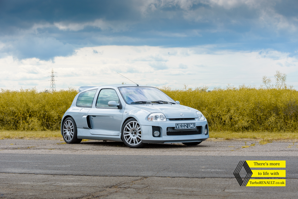

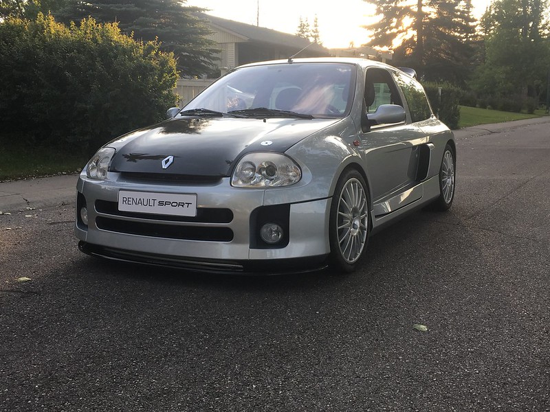

Looks really good, I think it just about carries off the carbon bonnet.

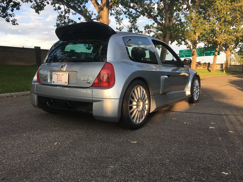

Do me a favour would you, where you posted the link earlier to where the Trophy boot spoiler came from, i'd be interested in buying one if you can verify the fit is good. I have a replica one on mine, but if you look along the leading edge of the spoiler when you open the boot, it ever so slightly rubs the roof on a 2" section and scrapes the paint. Its not really noticable unless you look for it, but it bugs me....its like a flaw in the mould they were made from that has that bit raised 1 or 2mm more than the rest of the lip. I've seen two others with the same copy spoiler with the same problem in the same place.
If i could get a non-catchy one, i'd happily ship it from the land of the rising sun.... being of that age group the opportunity to "overnight parts from Japan" would be too much to resist haha

The fitment on mine is great, the leading edge doesn't catch on the edge of the roof.
With the trophy spoiler you should run the BMW 1-series bonnet struts to avoid the top of the spoiler touching the roof when fully open.

Or just fit the Ph2 boot struts.

Looks great, nothing like a rare car!
Keep the carbon bonnet - I think it adds to the car.
