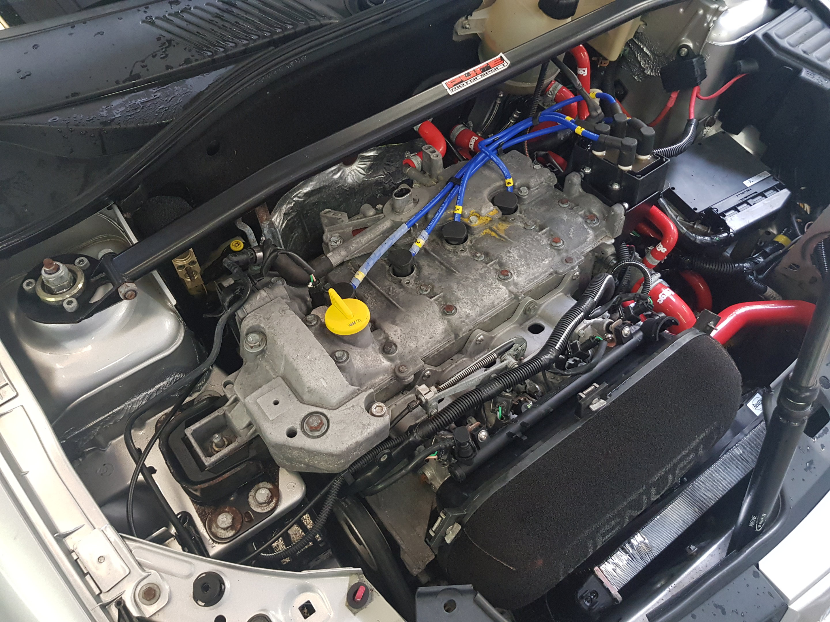

So bought a car with Jenvey bodies and Ktr gen90 ecu. It runs like a sack of s#!t. I've done the coil pack and plugs. It's got all new racing HT leads.
The spray pattern on the injectors looks all pretty even. So.... I bought a syncrometer to see that the bodies were set at after watching Ktr installation videos.
1= 4kg 2= 5kg 3=3kg 4= 5kg that's the reading I have using the syncrometer on each individual body.
My question is what is the idle Kg of air supposed to be set at so I can adjust them all up to be equal and then sort the Throttle position sensor and see if it helps with the sputtering and coughing.
More than likely needs to see a rolling road aswell
Any help appreciated cheers

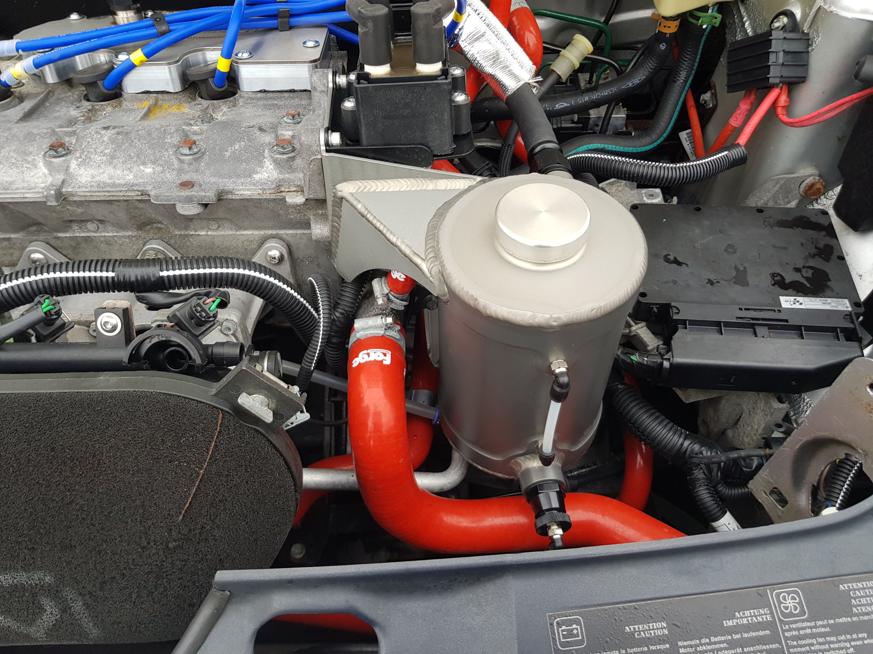

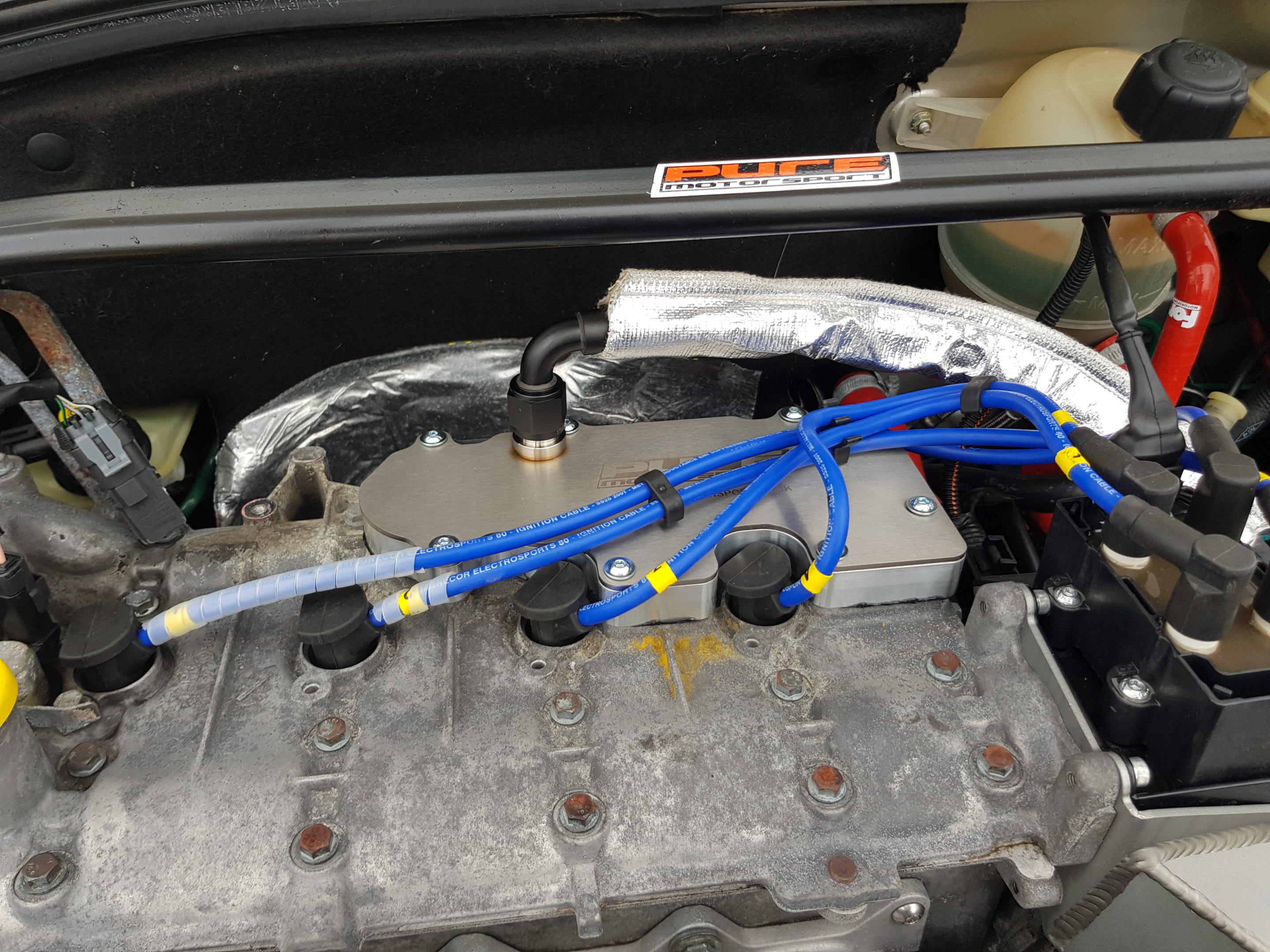

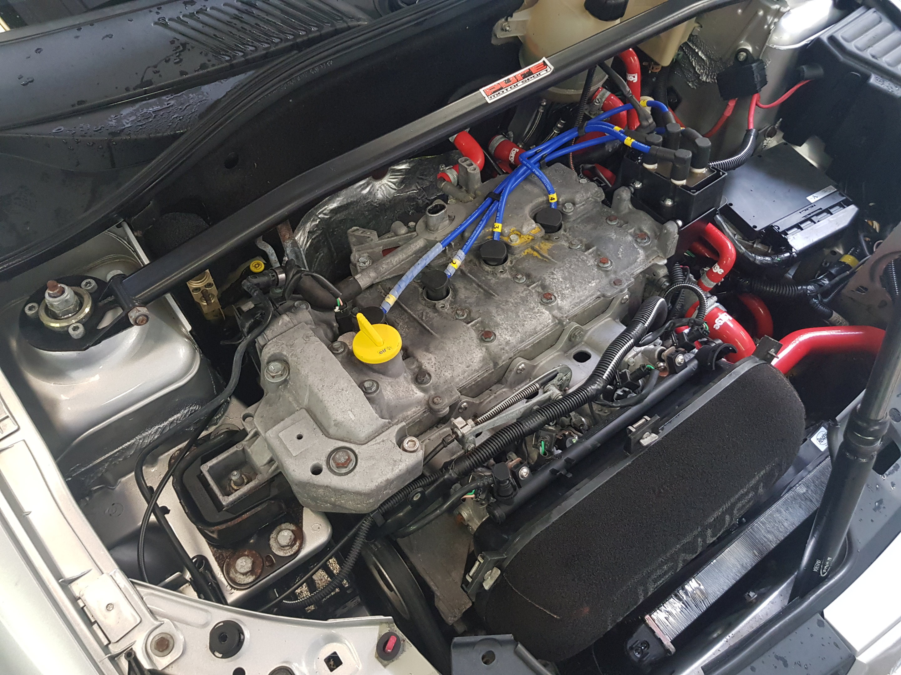

Ktec bodies are jenvey. I think idle will be done from the throttle springs as the butterflies are now cable operated. I'm not an expert but logic says tick over will be controlled from the bodies not ecu. Can you post a better pic of the bodies showing the cable setup and how each body is linked and the final linkage to throttle cable?

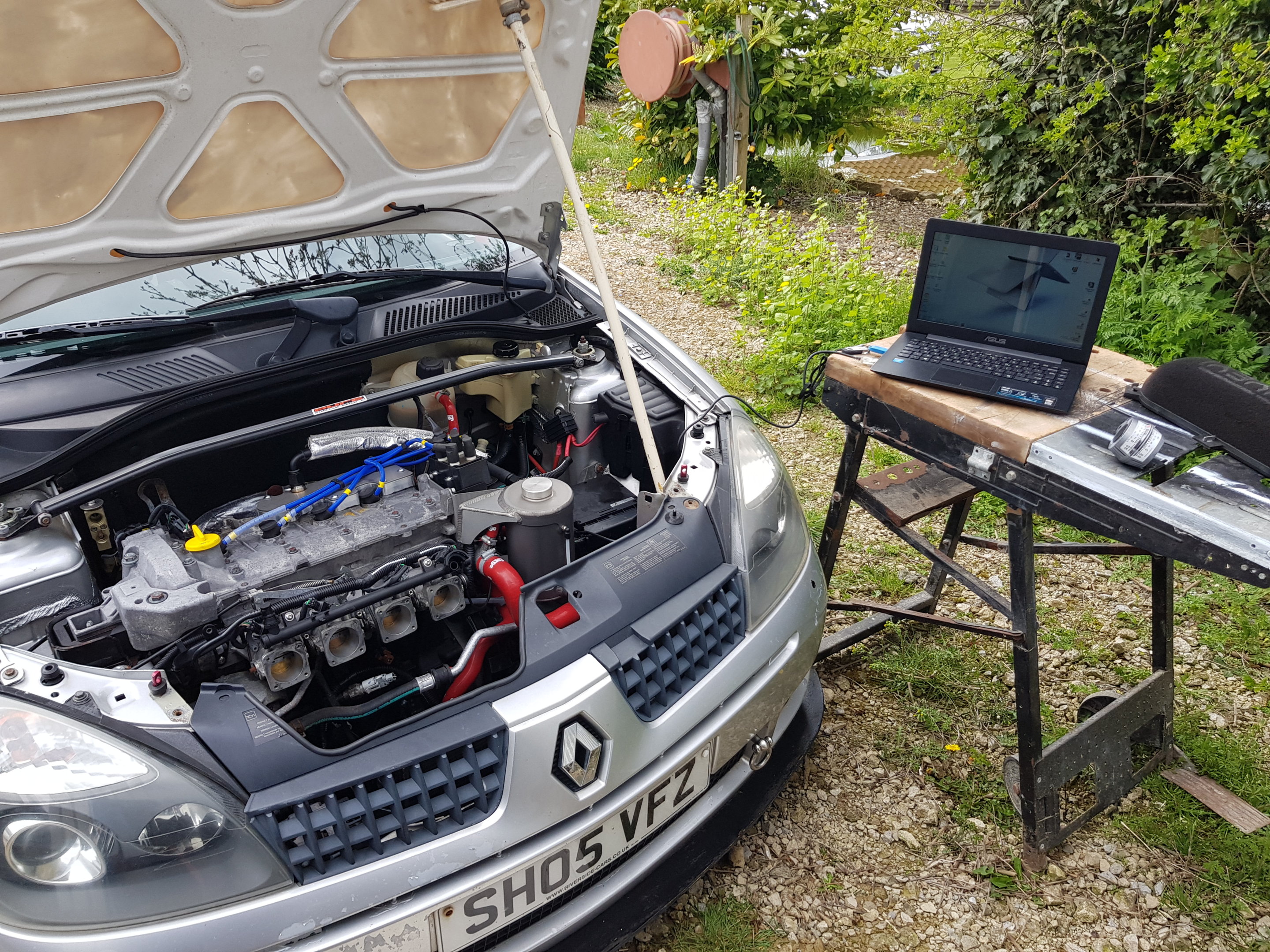

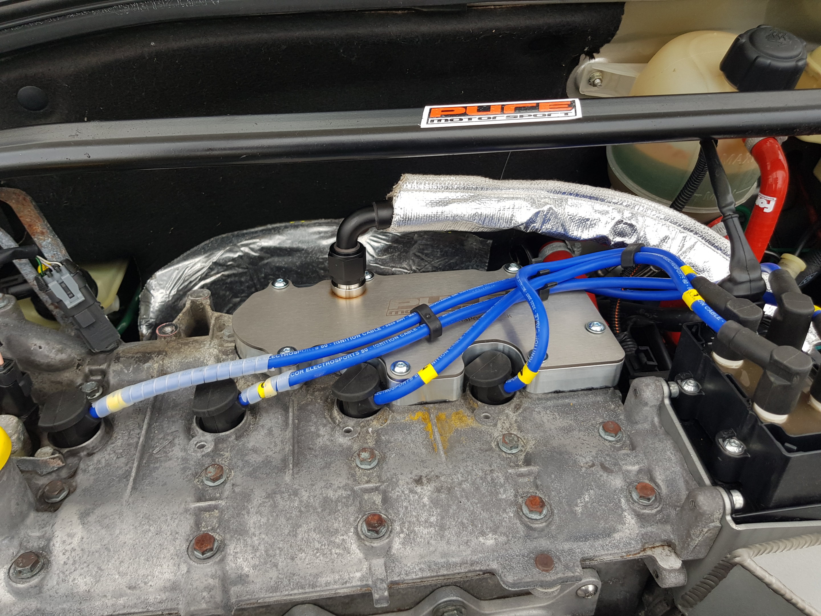

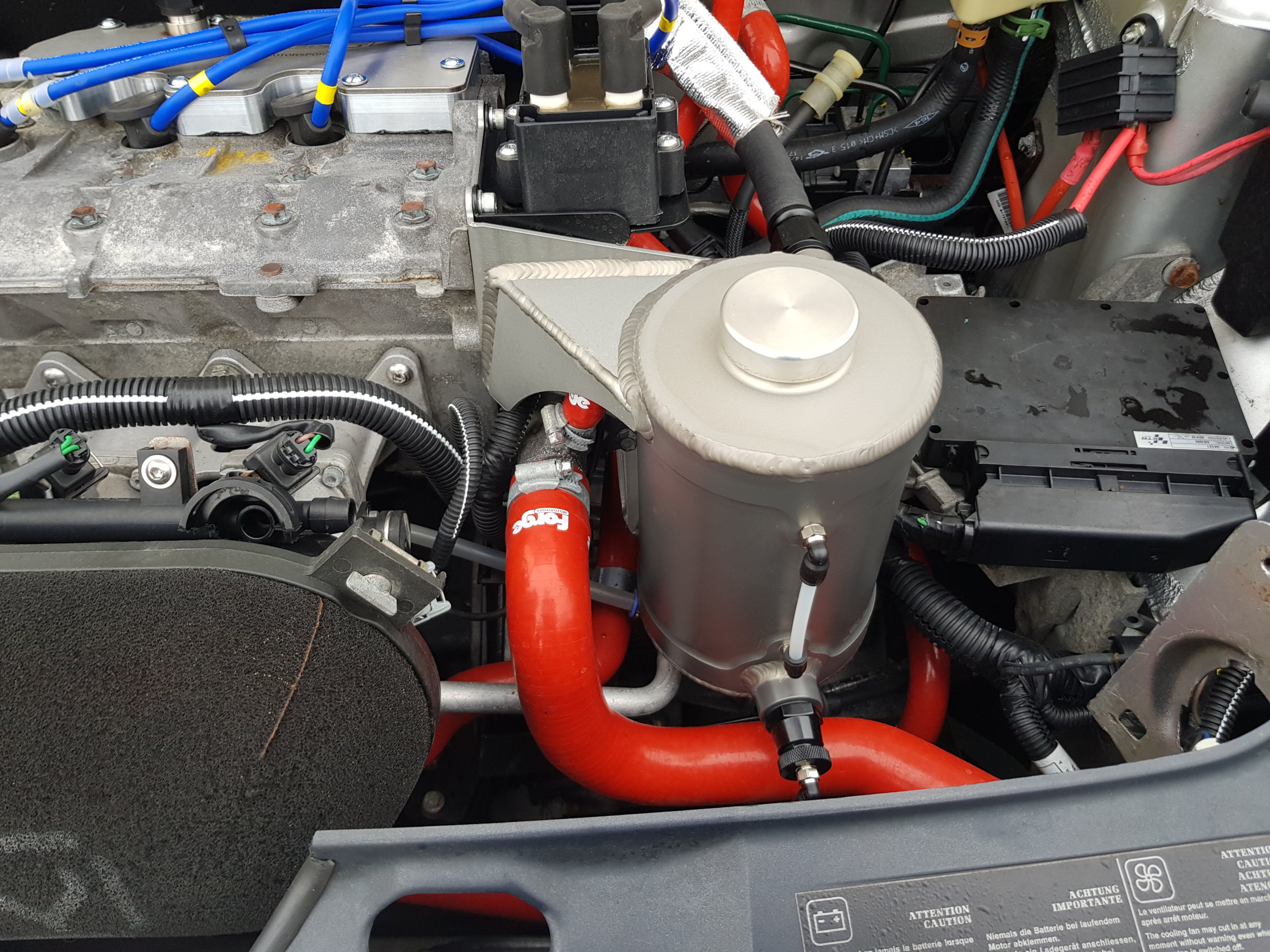

Oh sorry I forget to post pictures.
So I thought I would have a tinker over the weekend.
Took the filter off and the trumpets and backing plate to get the all the adjusting screw and to get the syncrometer to sit tight. I then plugged the laptop in to see if it would even work, and it did.
So I started the engine and started playing with the screws to see what changed what with the meter in each port.

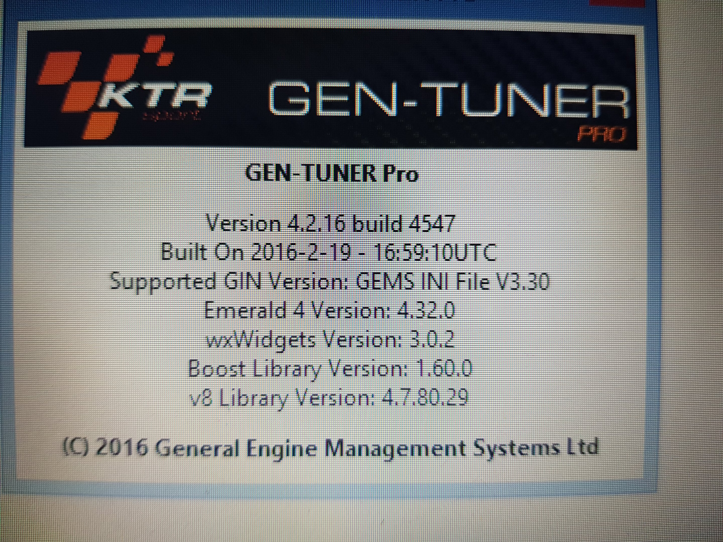

The idle is set by a screw in the middle which sets the second from the left idle. I opened it until it read 5kg on the meter. Then adjusted the one to the left of it, that was the 2 left sorted then worked to the right to match them. As they levelled out the idle lifted slightly as it was running smoother so I backed the main screw off abit until idle was 1000rpm and all at 5kg.
Then I turned engine off and left ignition on then clicked on the idle setup button on the laptop and looked at Throttle position sensor read out. TPS should be set at 10, mine was at 27 so I adjusted it to 10. Turned ignition off and back on to reset it to zero so the ecu knows then when the throttle is closed it's on 0% open. Open the throttle Right up and read the full open figure. That 100% throttle open and that need to be adjusted in the box on the laptop. Turned it off and on again to check it then opened and shut the throttle to make sure it was set.
Whilst adjusting it take the cable off the linkage aswell. I didn't the first time and it affected the setup.
When I started it up fully adjusted and rebalanced it ran lumpy for about 5 seconds then smoothed right out at sat at 1000rpm.
Took it down the road once I had rebuilt it and was a totally different car. I think it's still far to rich and maybe on a base map. Maybe previous owner didn't or couldn't be arsed to get it mapped so talking to RS tuning and EFI.

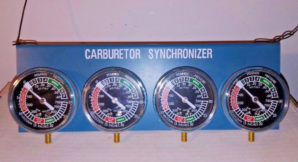

Are there no vacuum take off points downstream of the butterflies?
