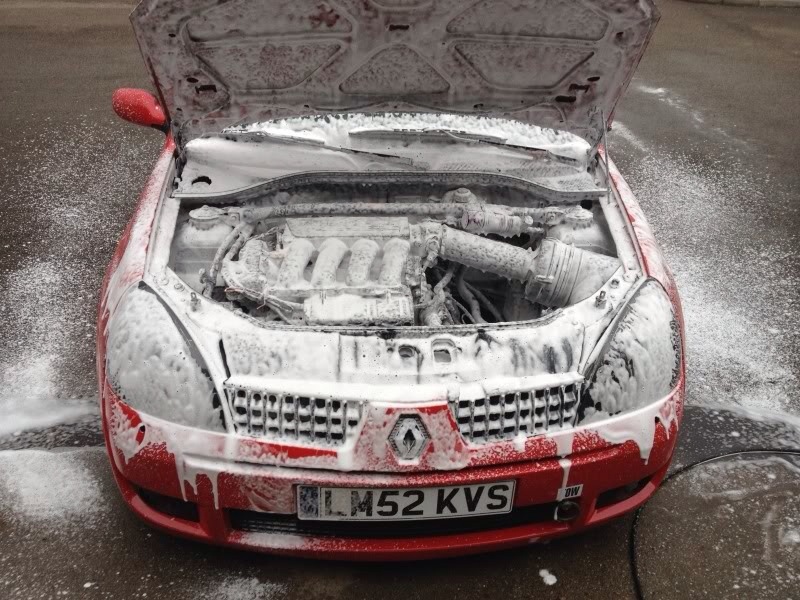

snow foam it (not may car btw)
Nowwww, snow foam is a step too far for me lol. Who's car is it??? He/she has a cup racer strut race and top mounts!
Looking at it again, its pedal box is on the left and no top engine mount. Must be a racer, you think that could be foam from an extinguisher??? Bit too much foam I would think.
I saw that a while ago on the saxo forum, believe the guy was trying to outline that you can snowfoam an engine quite happily.
Is it your car Jack?
It is possible but snow foam doesn't have much effect on oily substances anyway and takes forever to remove, it just keeps bubbling up so more washing needed and higher water ingress risk.
