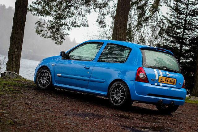

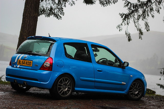

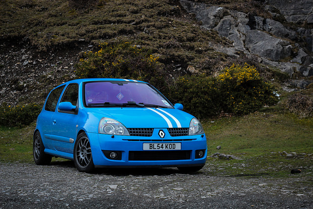

Also had a drive through North Wales and took a couple of photo's
IMG_7400-2 by Joe_Harding, on Flickr
IMG_7401-2 by Joe_Harding, on Flickr

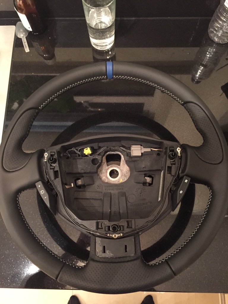

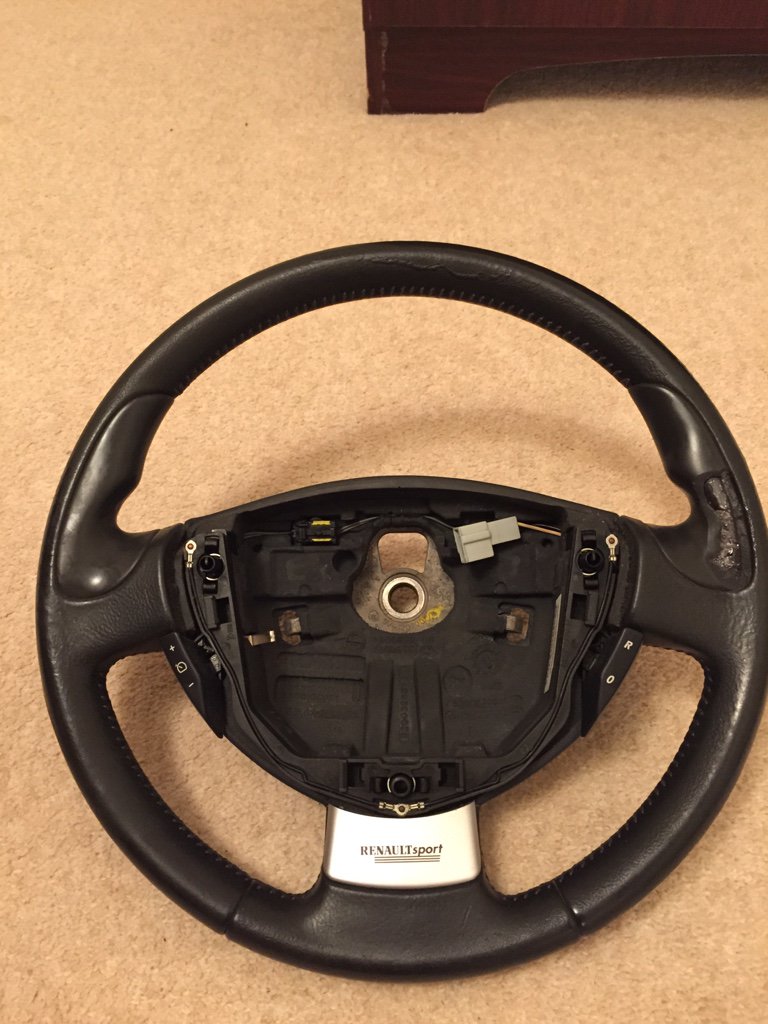

After talking about getting my steering wheel retrimmed I finally decided it was time to get it sorted. I Received the wheel back today from Snappy, and I have to say the guy is a genius. Top work! I'll probably fit it back onto the car at the weekend.
Before/After

Got the wheel back on this morning, wow it feels great. It makes it feel a lot more special now, really happy with it.

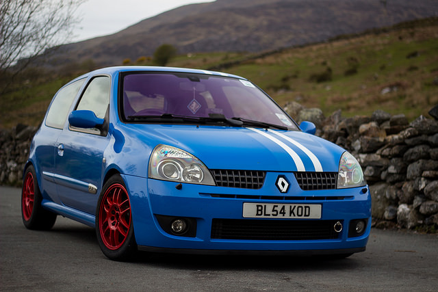

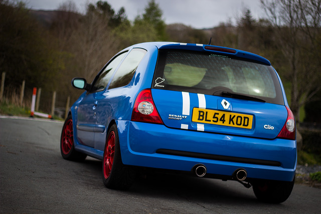

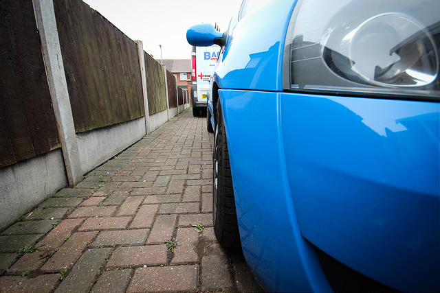

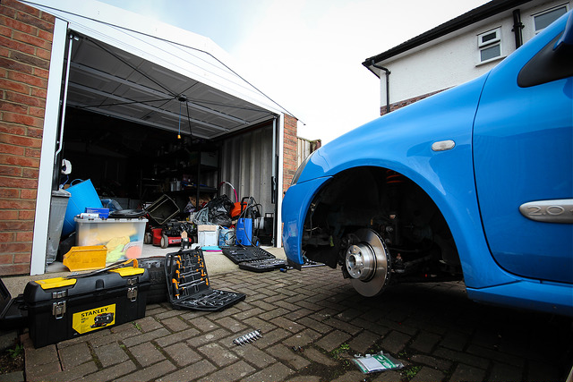

A little more to update with.
I decided to swap my day at Cadwell for Anglesey as a few other friends are booked on, and with that in mind I ordered up a few bits.
25mm M.A.D spacers
Powerflex Black Series rear top strut bushes
Brembo HC Discs
Carbone Lorriane RC5+ Pads
Slider pins for the front calipers
Motul RBF 660 Fluid

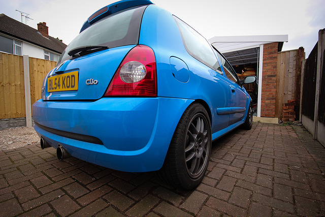

I made a bit of a c**k up on the order for the pads, by accidently ordering rear pads 😌 So I'll be exchanging those with ktec for a set of fronts this week. I've also fitted the 15mm spacers which were on the front to back. Hopefully it won't rub otherwise I'll swap them for something smaller. Although on that note the rear seems to have risen slightly after fitting the Powerflex bushes.
Once the new pads have turned up I'll book the car in to get thee brakes bleeded properly and a few other bits need attention. Just a few photo's I took, much happier with the 'stance' now.
IMG_7432-2 by Joe_Harding, on Flickr
IMG_7433-2 by Joe_Harding, on Flickr
IMG_7434-2 by Joe_Harding, on Flickr

What are the powerflex rear top mount bushes like mate? Might get some for mine as they're starting to knock over bumps a bit.
They seem a lot stiffer to be fair although I haven't driven the car yet. Mine never knocked before, but the lower bush looked a little tired.
Joe#
Which Anglesey day Joe? Mine on 16mm spacers on the back rubbed only when going up / down some serious hills (I.e. the one at Oulton, name I forget).
I've booked it for the 19th April mate. Mine scrubs on the front round there too :(
Jekyll
I'm not a lover of the MAD ones as I've seen the hub bolts come loose a few times. Interested in your views on the powerflex bushes once you put some miles on with them.
Joe#
Pants, I'm at Anglesey on the 2nd July. 😧
:( I might book that one closer to the time.
Oh really? I'll keep an eye on them. Torqued them up to 120Nm.
If your rears rub I'm sure I have some 10mm stub axle spacers somewhere you can have for cheap.
Thanks mate, I'll let you know how I get on :)

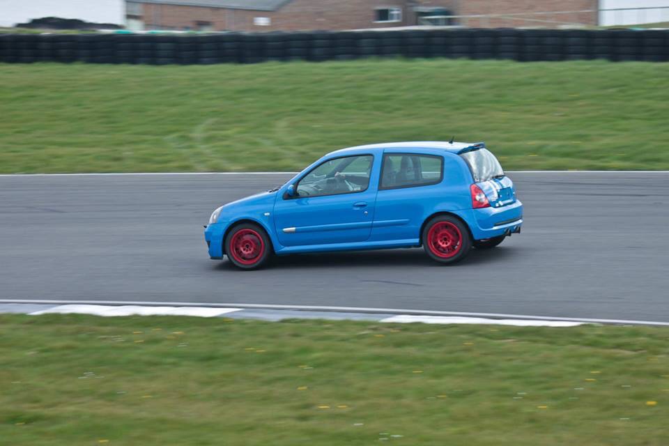

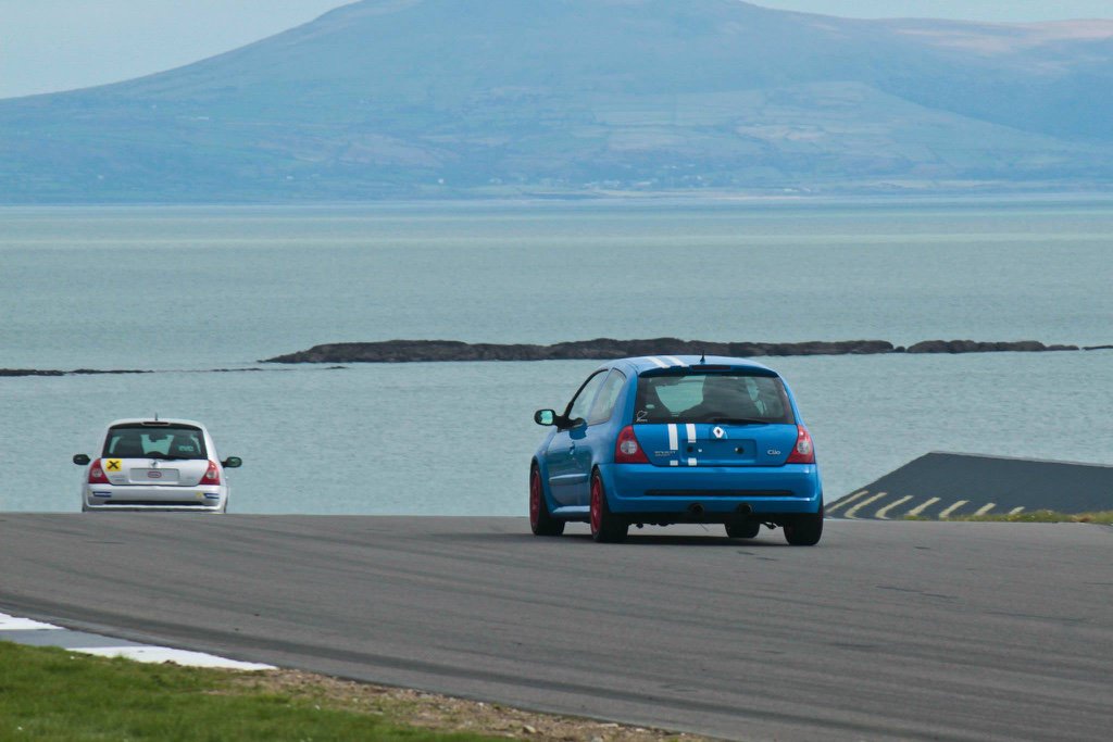

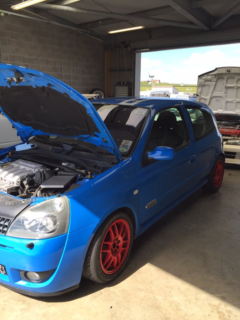

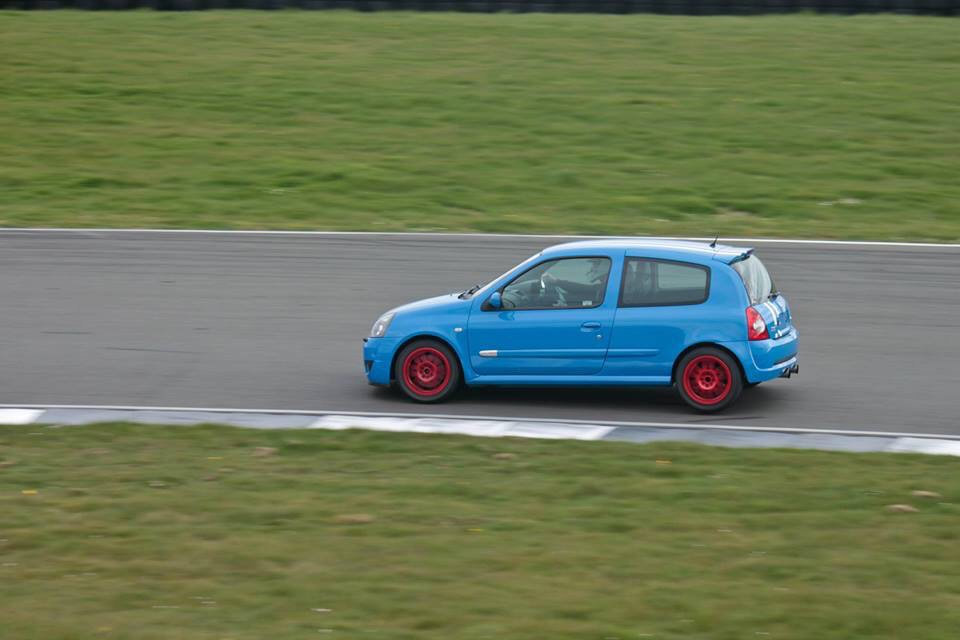

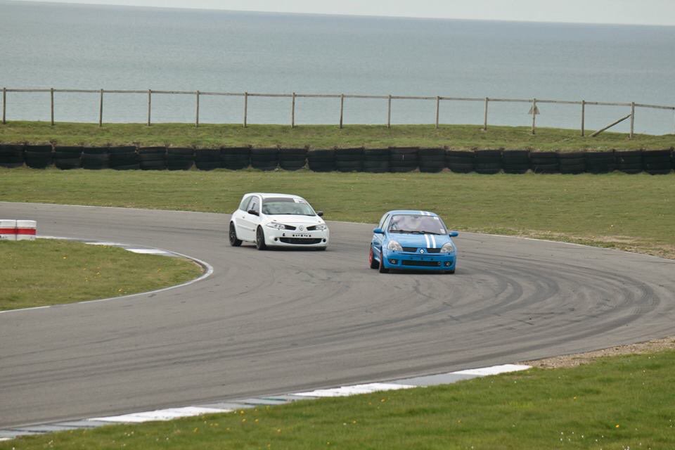

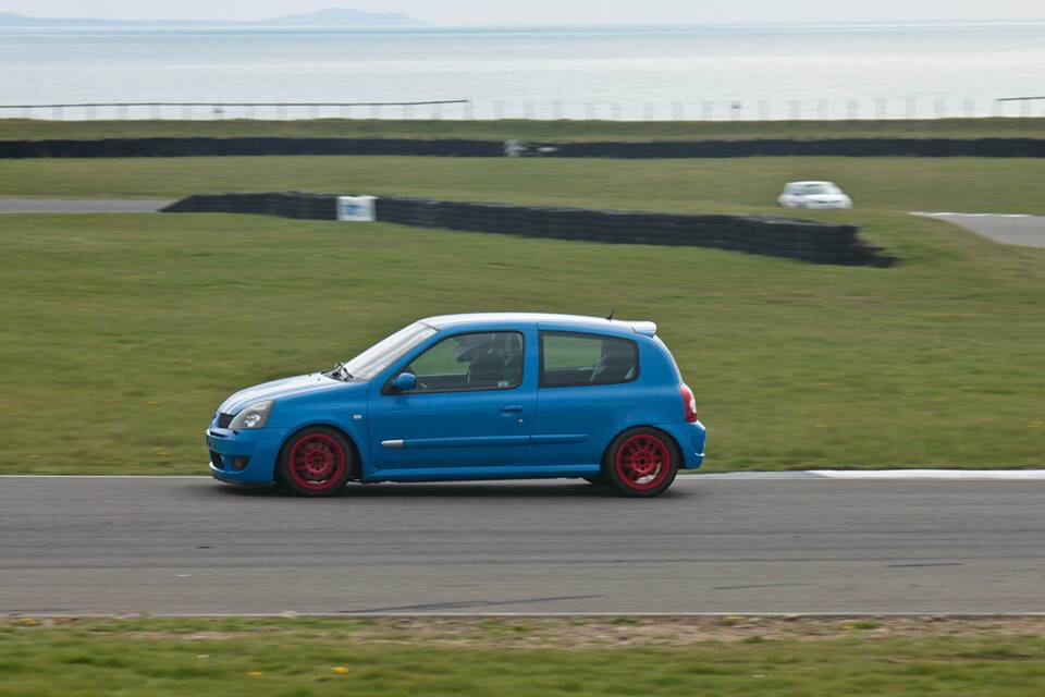

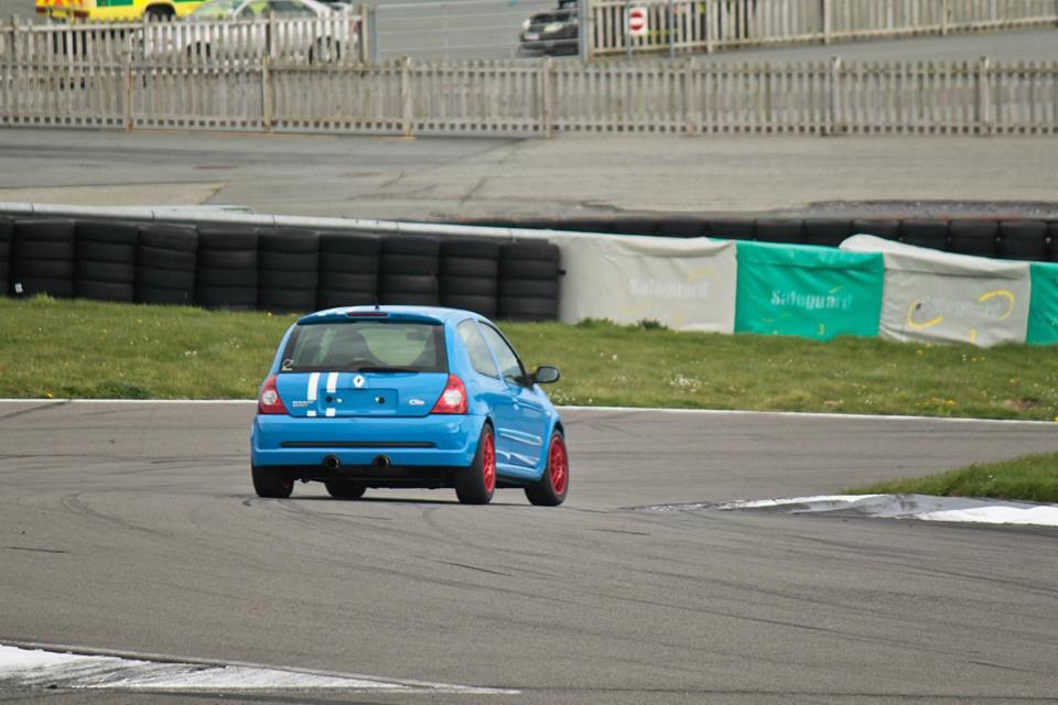

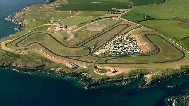

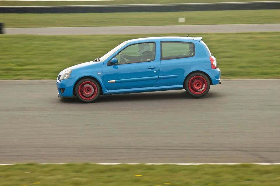

I did a trackday over at Anglesey a few weeks back (19th April) with a few mates from on here. Car performed brilliantly, and the weather was great. I was really impressed with the RC5+'s, I found myself staying out for much longer than I ever did when running dS2500. And had great stopping force all day.
That said however, I've noticed that my rear discs (both) look they haven't been used at all. They still have surface rust on them, which I've never seen happen before.
A few pictures from throughout the day..
