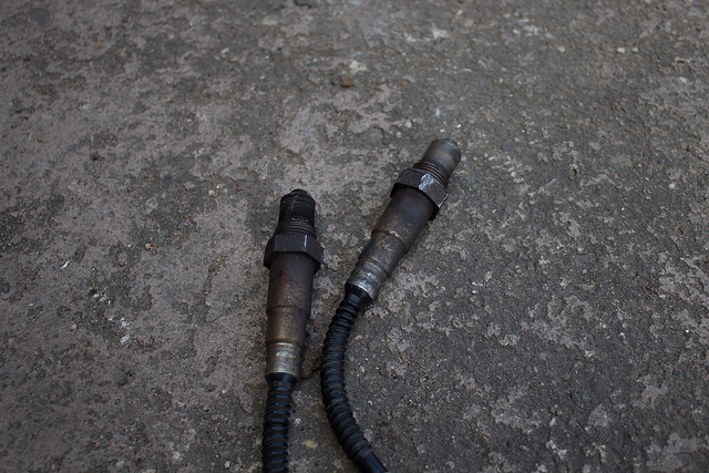

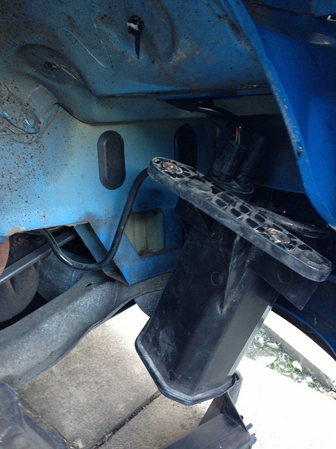

The cars EML came on a few weeks back. Plugged the RS Tuner and as expected, it was the pre cat lambda sensor. I remembered that my other sensor was still attached to my cat which has been sat in the garage for god knows how long. Had a bit of a fight removing it from the cat as it was hard to keep it laid flat whilst applying force. Eventually it came loose, and I took the goosed one of the car. Fitted the new one, refreshed the ecu and the light has stayed off ever since.

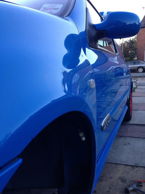

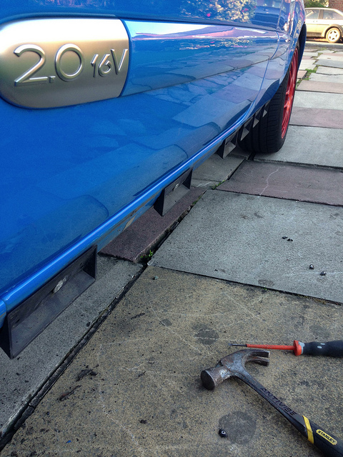

The passenger side wing was slightly damaged when I bought the car last year. And I finally managed to source a Racing Blue one, and get it fitted. A few pictures..

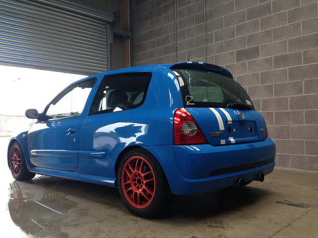

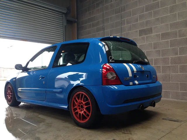

And a quick iPhone snap from the paddock at Anglesey. I need to try and sort out my official photo's I bought, having a few issues with them.
IMG_1984 by Joe_Harding, on Flickr

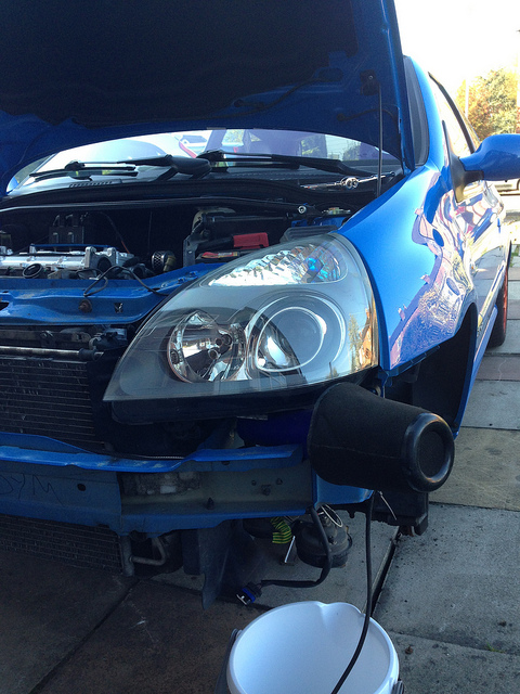

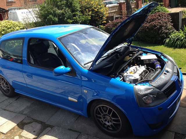

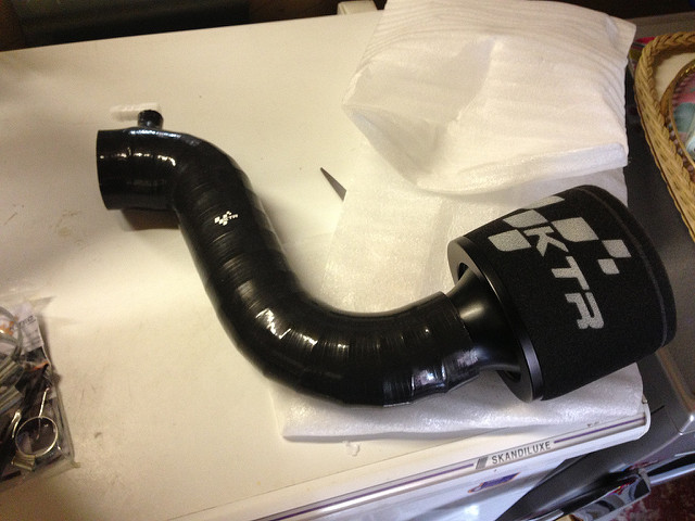

And as above, the RS2 was removed. I was going to make another diy setup, but I ended up just buying a ktec as it will look a little tidier in the engine bay. And is supposed to sound a little better.
IMG_2106 by Joe_Harding, on Flickr
A quick photo before I took it apart :(
IMG_2112 by Joe_Harding, on Flickr

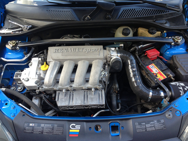

And here is how the engine bay currently looks. I'll be painting the inlets and rail guard up eventually when I get time. But I'm happy with it at the moment.
IMG_2152 by Joe_Harding, on Flickr

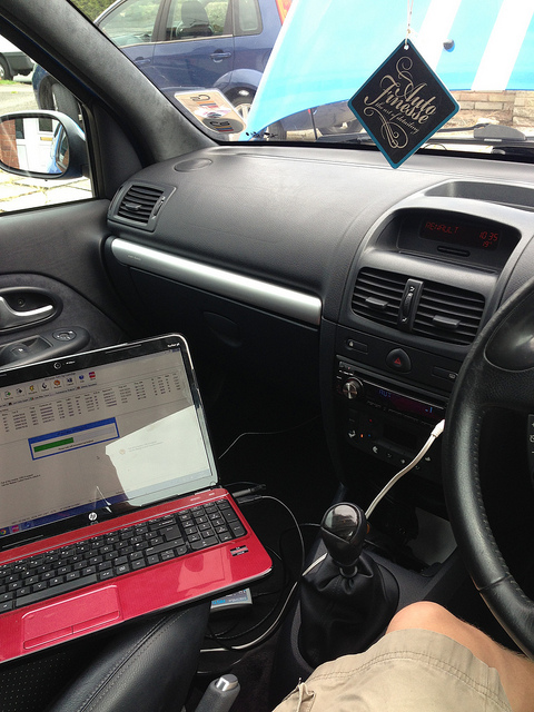

And finally. After speaking to Paul@RST, it turned out I could map straight over his map. Which saved me a trip up to Leeds. So I've put the Fastchip 98RON map back on the car, and its running perfect. I went for a bit of a drive last Sunday, and I'm really happy with it.

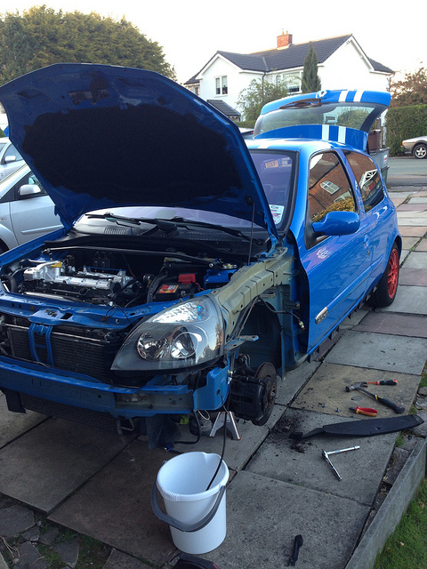

I sent a PM over to G172 on here the other day to order up some new brakes. Ended up with the following:
Brembo HC front discs
Ferodo DS2500 front pads
Genuine rear discs with bearings/abs rings
Brembo OEM rear pads
2L of ATE Superblue brake fluid.
Goodridge steel braided lines (demon tweeks)

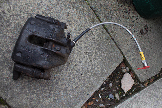

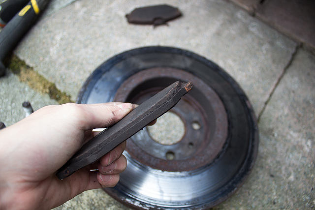

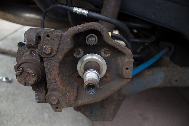

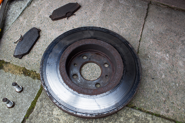

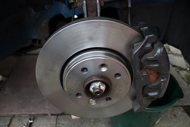

Ordered late Friday night, and was with me first thing Saturday morning. Top service! So Sunday I went about fitting them with ROB91. Raised the front end of the car up and got it on axle stands. I'd already sprayed the torx bolts the night before so they came off nice and easy. The carrier bolts were pretty solid, but came loose after a few hits with a hammer.
Old disc and pads off.
IMG_6116 by Joe_Harding, on Flickr
IMG_6114 by Joe_Harding, on Flickr

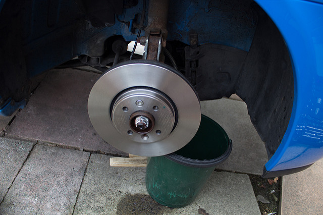

New discs were mounted and torqued up to 175Nm. As well as new pads in the calipers, which needed to be filed down slightly to get in place. Front hoses were also fitted, then all mounted back onto the car.

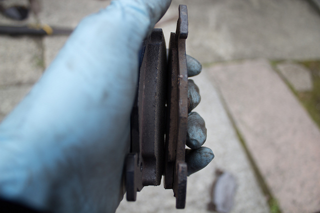

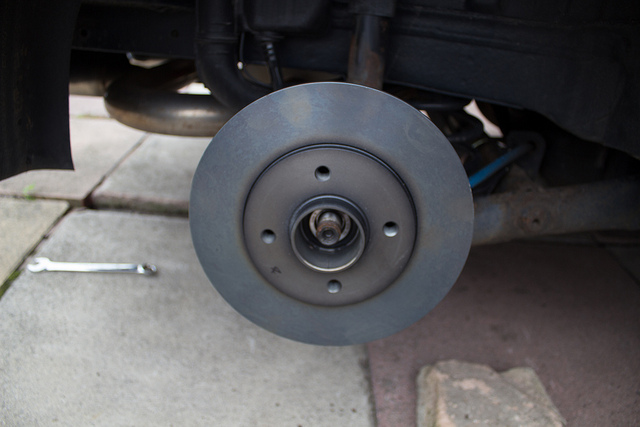

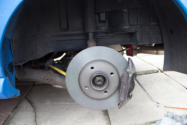

Caliper bolts were undone easily with a breaker bar, as too did the hub nuts. The discs took a bit of persuasion to come off, but in the end they did. I decided to buy 2 new spacers to go behind the discs. I've heard of a few being stuck to the old discs, so thought I may as well replace those for the sake of it.
Pistons were wound it, and the new discs were put on. And then new pads. A couple of pictures:
IMG_6123 by Joe_Harding, on Flickr
IMG_6124 by Joe_Harding, on Flickr
These were a little overdue..

The rear lines were then fitted, old ones looked knackered. Then it was time for bleeding. We used the Eeizbleed kit to do the car. Took one of the wheels, and lowered the pressure to around 19psi, then hooked it all up. Went around all the bleed nipples (which all were in great condition thank god), and got all the old fluid out the system, and more importantly the air. Once we was happy with it all, it was time to bed the brakes in. After many blips on the brakes, we got them up to a decent temperature and started to take away the film on the discs etc. Pulled up at a set of slight the smoke poring out of the fronts to the horror of some people lol. Drove the car back home trying to use the brakes as little as possible, and then let them cool down for a good hour or so.
Once they had cooled down, we went about bleeding them again. This time pumping the pedal. I'm really glad we did it twice as there was still a large amount of air that was stuck in the system. Topped the fluid up, and took it for a little drive.
The pedal feel is so much sharper now, I used to have to push down a lot further. I'm really impressed with them on the whole. It's the first time I've had 'proper' brakes on a car, so it kind of surprised me how good the feel. With these done now, I'll have quite a but more confidence on track :)
