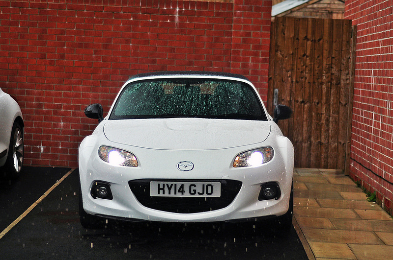

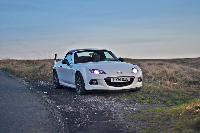

HID's fitted. Don't really understand why Xenons weren't standard equipment tbh. RX8's on which these are based have them. Odd...
Next up should be some form of suspension mods. I'm going to leave power mods for a while I think, except maybe an exhaust.

Lovely is that mate, HIDs are a great upgrade too.

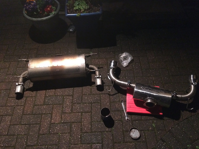

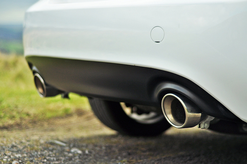

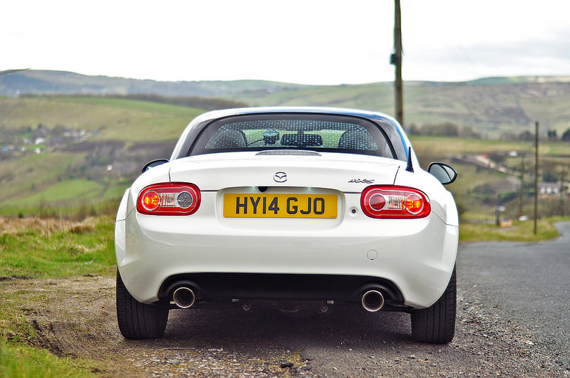

Well, I said suspension would be the next upgrade... yeah that didn't happen. A trip to Roddisons on Friday to collect some bits for Sebs MK4 ended up with me buying a Cobra back box. I talk myself into these things far too easily! Anyway, no time wasted, I set about fitting it that night.
Original tips for reference:
Side by side, you can really see the size difference!
And fitted
And one of the hids just because.
(yes usual location!)
Sound clip:
Mic attached like so:
Kinda just sounds like any other 4 cylinder engine TBH, although I was very surprised by the amount of pops etc! I've heard one with a manifold and while it was quite loud, it sounded really special. So I've got some saving to do!

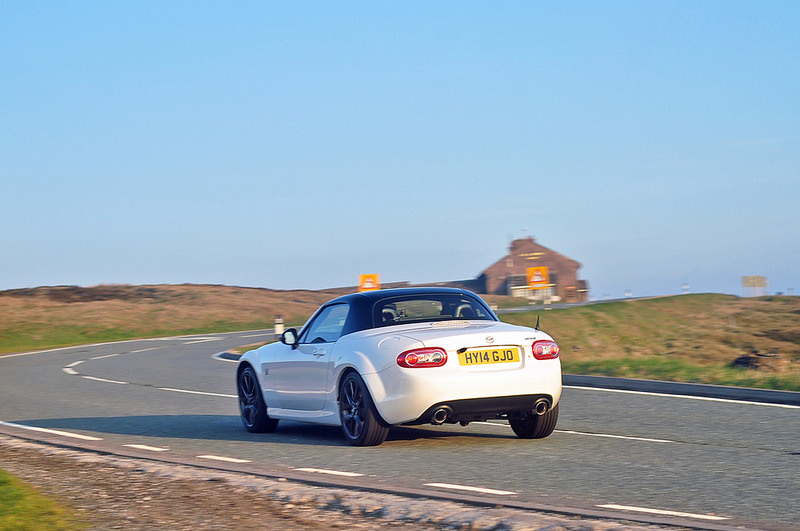

Went for a blast out with Seb in his ND the other night. Cat & Fiddle was horrendously busy with motorcyclists, and they're flipping mental! Didn't get too much footage as I was having quite a lot of fun being passenger in his car.
Also managed to get a few 'panning' shots. It's bloody hard work so fair play to all the proper 'togs out there! Really want to upgrade my camera gear - it's starting to show its age now.

Where did you order the HID kit from @JoeyD? I'm picking up an NC2 next week and will miss the ones I have in the Audi.
Car looks/sounds awesome btw.
Thanks chaps! Done 4k miles in it now (oops) and still enjoying it. Needs a few bits though, brakes need upgrading and I'm not happy with the suspension or the tyres either. I'd quite like to do a track day in it too, but I've just not had any time recently!
Luke, they're from HIDS direct: H7 55w 6000k. Proper proper ballache to fit though. Try get the slimmest ballasts you can, there's less than no room behind the headlights!
Also, not sure if NC2 lights are different to NC3, but you'll need a spacer/adaptor. I bought one off eBay but it wasn't the right size, so just ended up hollowing out the bulb holders. Bit pikey but it works!
I give a bit more detail with pictures here: http://www.mx5nutz.com/forum/index.php?showtopic=286825&p=3522065

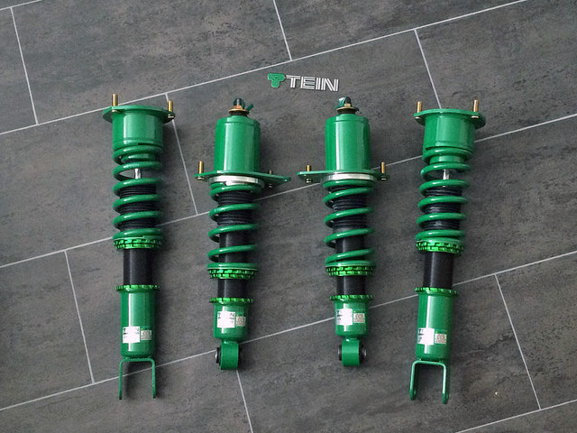

Look what's turned up in the post!

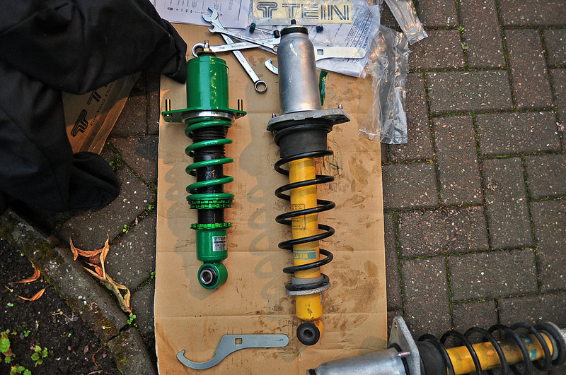

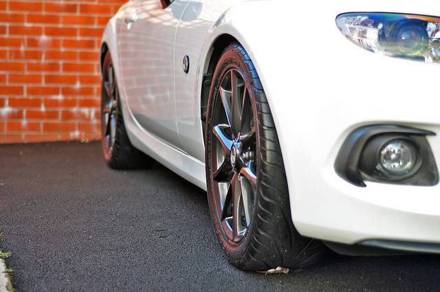

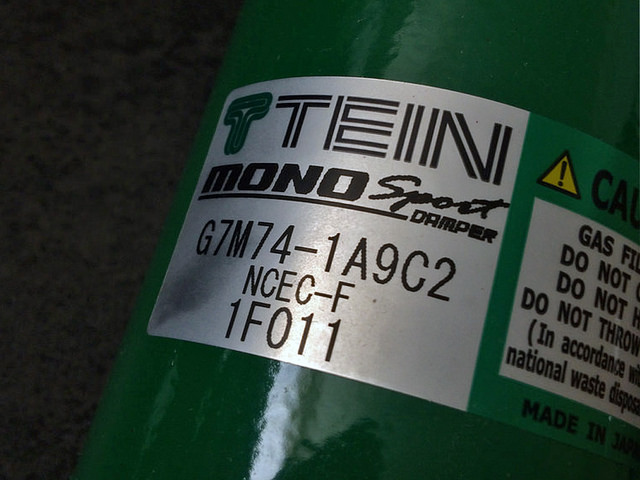

Decided to give Teins a go after owning a few sets of Meisters. The spring rates looked a little more suited to what I wanted to use the car for, and I've been quite impressed with Sebs set on his ND. I did consider Ohlins, but from what I've read they've very road biased along with being very expensive. I want to take this on track, so the Teins seemed like a good idea. Time will tell...
Well, they're on. Too early to give any kind of impression, but it looks great! Okay, yes it's far too low but it's not been set up in the slightest - I've just pretty much guessed at the heights and took it for a spin. What I could tell from my brief drive is that they're very firm, but not crashy and it really really really needs an alignment.
Here's a picture of the rears for a size comparison
Excuse the dirt! Not had time to wash it recently.
Crazy how far the wheels are in the arches... I don't really want to mess around with spacers, so wider wheels are definitely on the cards.
Yeah I do love how it looks, but if it handles like crap I'm not going to be sad about changing it - it's for driving, not looking at after all...
Looking at the race cars, they're a similar height so I'll just have to wait and see.

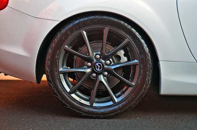

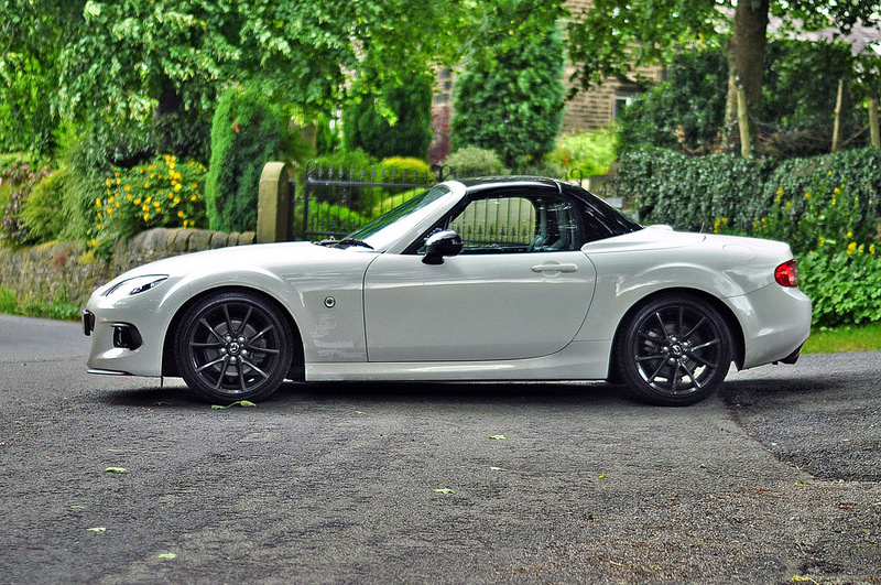

I acquired some new rubber a couple of months ago; Federal 595RSR's (225/45/17 all round) I've been impressed with them before, I rate them way above Nangkangs in terms of both grip and poor weather capability - sure they're no regular road tyre, but they're nothing like as poor as the Nangkangs IME. Plus they don't howl on the motorway.
Fitted to standard wheels (for now!)

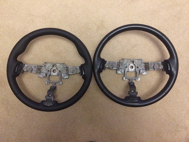

I've also upgraded the steering wheel, which is something that any MX5 owner should do right away. The standard item is like holding a noodle - so very thin! It's also quite large in diameter, but it's mainly the thickness that I hated. I did some research and decided to try Royal Steering wheels after hearing plenty of good things. They did not disappoint; cracking quality and I only had to wait about a week to receive the finished item. I went for smooth leather all round as I'm not really a huge fan of perforated leather and suede tends to be a pain in the arse to keep on top of. It's thicker, and has thumb grips sculpted in, and this way I retain all the cruise/audio controls.
And as a bonus it smells like brand new football boots - something I've not had in over 10 years. Such nostalgia!
