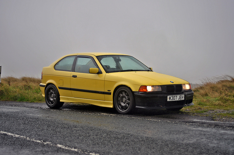

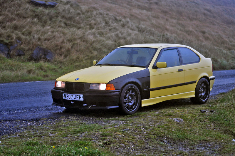

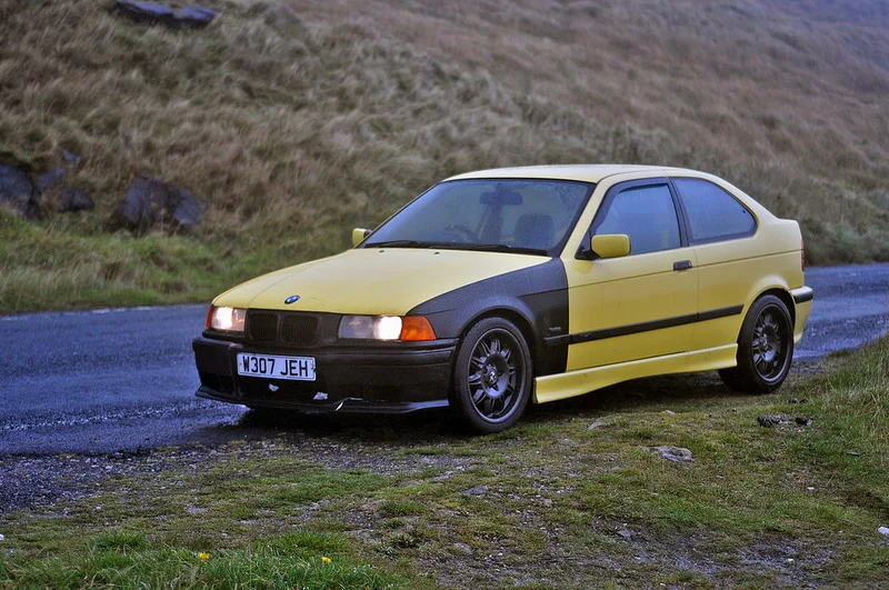

It's not pretty but it's a decent project and it's a surprising amount of fun!
Going in for paint on the front end in a week or two thank god...

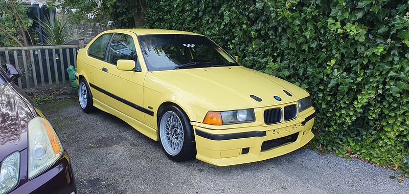

That actually looks quite good I think, especially with the contrasting wheels. What has been done to the suspension to get that stance?
It's just on BC coilovers with the interior stripped. It's very light at the rear which makes for "interesting" handling... Might get a thread up at some point as I feel like compacts are just labelled as crap for having an old fashioned rear end. Thing is, nobody ever said the E30 M3, Z3M etc were bad handling cars and this is no different.

Yeah, I'd be interested to read a full thread mate, always looked at these with curiosity

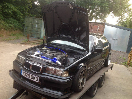

My mates got one with a 1jz motor in it. Goes well in corners and on straights lol
Fit's like a glove..
What engine is it dude? Nearly bid on a 318i on eBay the other week, it was immaculate!

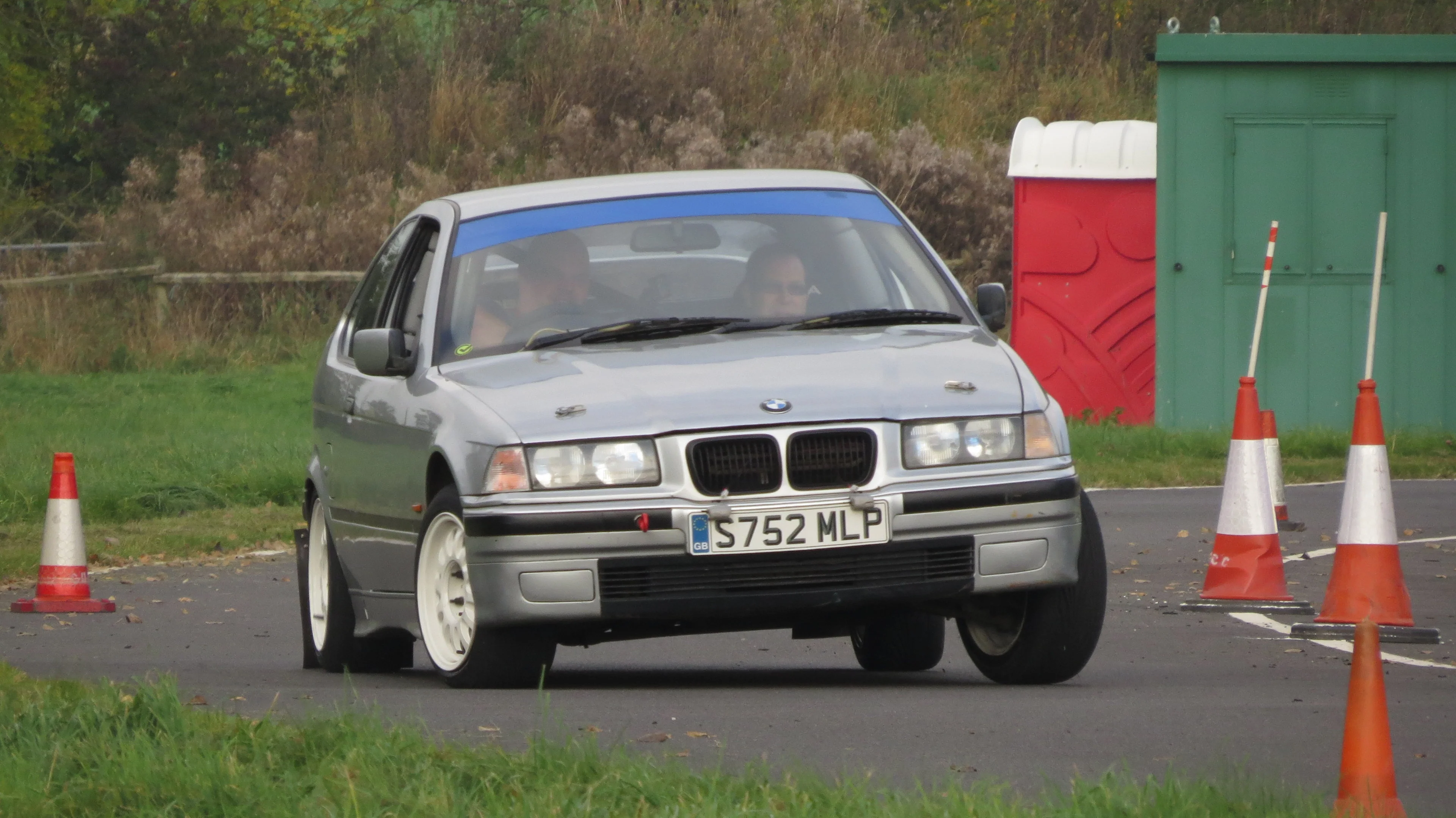

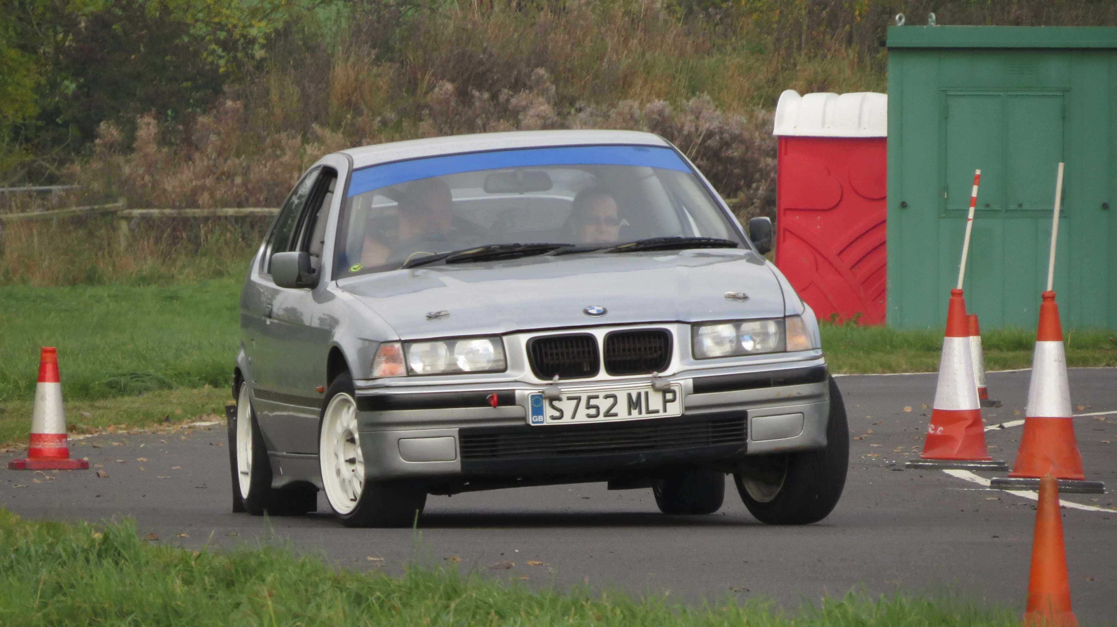

2.8 M52 out of a 328i. Would love to try a regular 318ti though, bet they're more than powerful enough for some cheap fun! They race them in the 'Compact Cup' looks like a right laugh!
Yeah I'm subscribed to the Compact Cup via the BRSCC which is what got me looking at compacts, along with my mate Mark who competes in one. I think I've mentioned him to you via Instagram...

So failed its MOT today, needs an exhaust and one of the headlights is from a LHD lol! No biggie, exhaust needed to go anyway and I wanted to swap the headlights for proper glass lense ones like you'd get on a coupe or saloon. Just a shame its so close to Christmas!
So wee update on the compact, cba starting a thread.

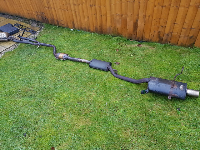

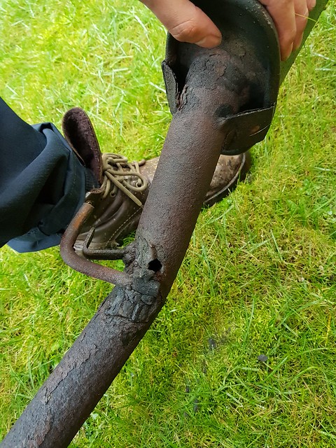

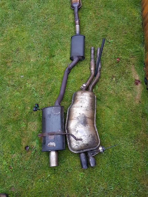

As above failed MOT on emissions and a crusty exhaust, so took that off to have a look...

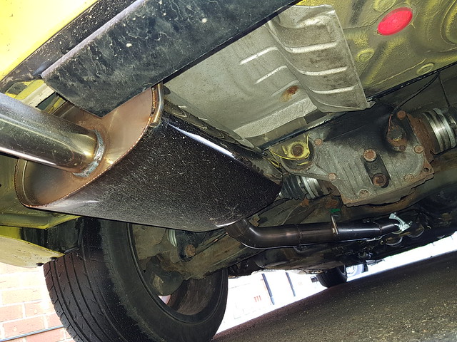

Nice and riggy. The 'cat' was just an imitation apparently! Weird.
I intended to just fit a complete coupe exhaust from a 328 with a bit of length taken out, but it was way more hassle than it was worth - the backbox is bloody massive!
So I stuck with the oem mid section and cats and just had a backbox made by JPexhausts in Macclesfield. Much better!
I'd butchered the rear panel trying to fit the other backbox so ordered a new one.
Note the new dealer plates too!

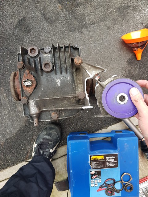

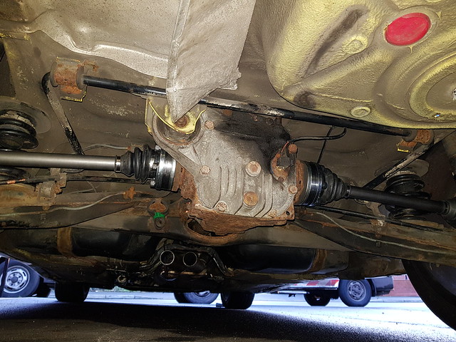

While it was off the road I decided to fit an LSD, I ideally wanted a clutch type, but there dont appear to be many E30 units for a reasonable price and they're probably all worn out by now anyway. So I found a medium case Z3 Torsen LSD (3.38:1 vs 3.45:1 previously on the car). Not quite as good as the clutch type for doing skids, but they don't wear out and it'll hopefully do for track use. I also fitted new, shorter driveshafts due to the larger case size. The old diff snapped the mounting tab on removal too, so I'm not going to bother with a polybush on the new one - clearly didnt like it!

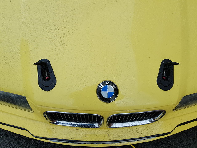

I then set about removing all the old crap bonnet latches, they were corroded and only one actually worked! Fitted a set of aerocatches to just eliminate the problem altogether.
I also fitted new grills as I didnt have any whatsoever.

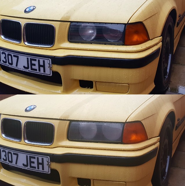

Another MOT advisory was that the passenger headlight was pointing the wrong way. It was actually from a left hand drive car, oddly. Kind of makes sense - the car has obviously been smashed and just cheaply repaired... nice. I took this opportunity to throw the compact-only plastic lense headlights out and swap them for proper glass lensed elipsoids. Just a small wiring loom change was needed for this.
And that pretty much brings it up to date. Passed MOT with no advisories thankfully, although now the gauge cluster has started playing up and a coolant pipe has started to buldge... always something!

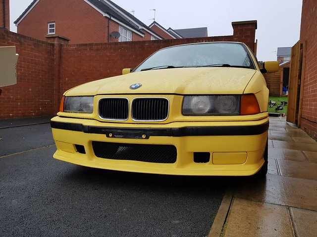

So this is how it stands now
Really really hate that front bumper, it doesn't fit properly at all.. but it'll do for now. Needs new tyres and the brakes need seeing to also... it's been a bit of a bigger project than I originally thought TBH! Ah well...

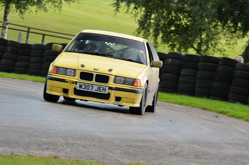

Well, the E36 ended up looking pretty good for a compact! It did a few trackdays
