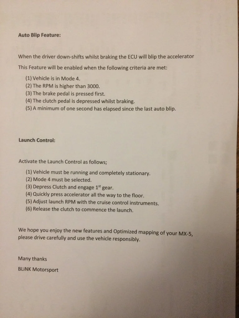

But what is flat-foot shifting and how does it and downshift rev-matching work on a manual car? Is the first one just keeping the throttle pinned while changing gear?
-Jamie-
Flat foot shifting is just that, keep the foot planted and change gear, ignition cut usually.
Downshift rev matching is just like heel and toe except you don't have to blip the throttle, loads of stuff comes with it these days from the factory GT4 included however if you can actually drive most switch them off

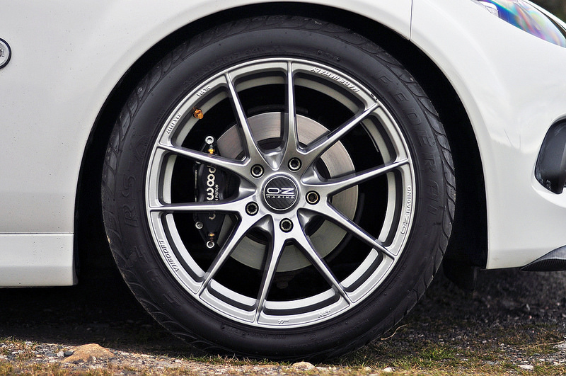

Complete package, everything done just right.... Must be an absolute hoot to drive, fantastic photos. Oh and what model BBS wheels are they again?
Yeah it's awesome fun! Even if you over-do it into a corner it just deals with it. Really flatters the driver in that way!
They're O.Z. Leggeras (17x8 et45)
As Jamie said really. This is what's in the little booklet I got:

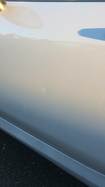

I found one on my car yesterday too! f**k people!

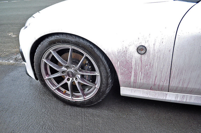

I gave it a proper wash at a mates house, was covered in crap unfortunately, mainly from the brakes I think! So dusty.
Lots of fallout removed. Looking as good as new again.
Noticing a lot of new cars coming out with this style of wheel now, most recently the M4 CS... Must be fashionable or something!
Gave the ECU features a go too, the rev-matching is really really good to be fair, though it does make it all a bit easy! The flat foot shifting is good, but I still think it's a bit harsh and I've not gone anywhere near the launch control!

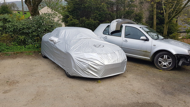

I'd do it. Still maintain that they're better to drive than the early cars. Unfortunately I've had to put mine away for a while until I move house. Had trouble with c**t kids jumping on it because it's sat at home all day...
Sigh.

It's far too nice a car to let that happen again. What pattern are those OZ's by the way? Seriously tempted by a set myself.
@JoeyD
Christopher
  Z4M
Id go for it! Theyre awesome wheels. Mine are 17x8 5x114 et45 and theyre only very slightly heavier than RPF1's. Still light as f**k though, you'll need all the help you can to go sub 1100! @Christopher
Nice! It'll be next year I think but it's definitely on the cards. Between ATS DTC, Braid Fullrace A or these badboys now.
