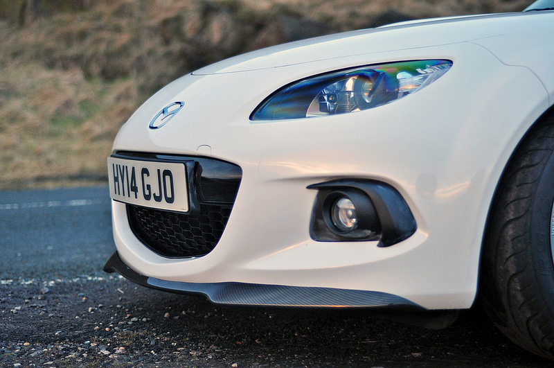

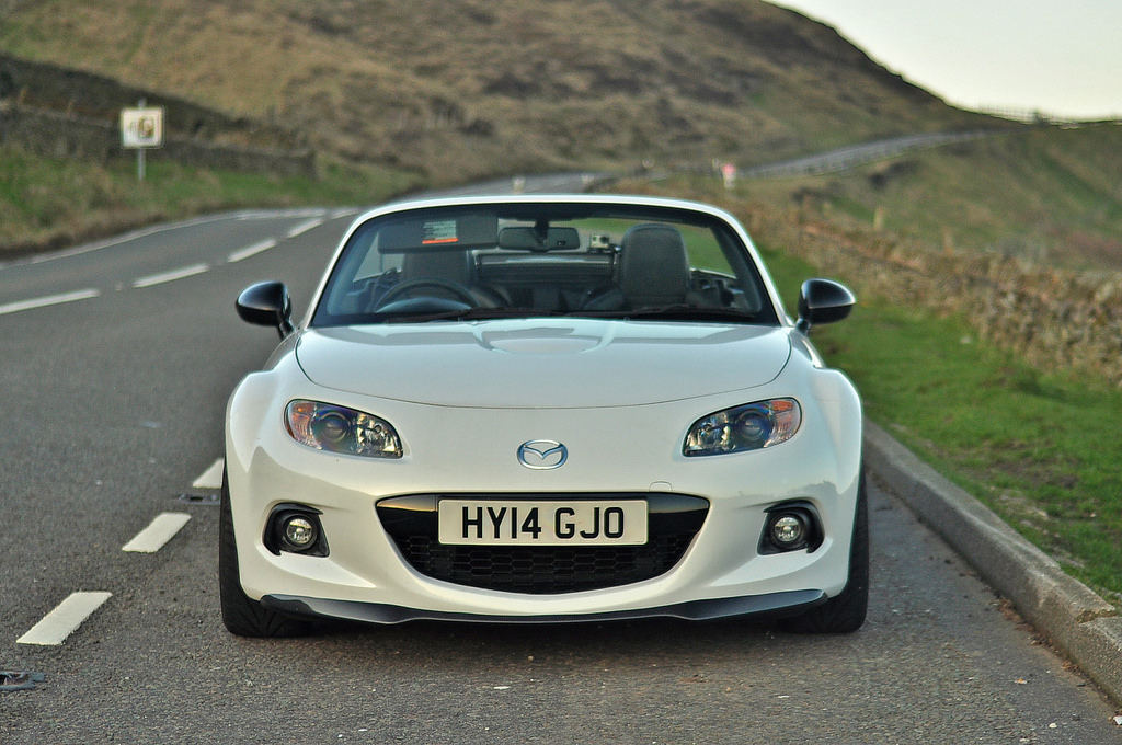

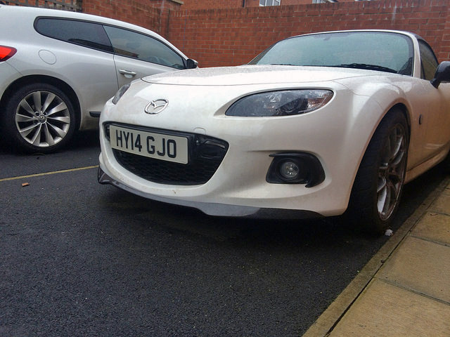

Finally got round to fitting the carbon lip which was an absolute ballache to say the least. Not got round to properly re-attaching the bumper or washing the car yet so I'll get some better pictures once it's done.

Love it! Looks so good. Wouldn't have thought the silver wheels would look so good. Such a good looking car. Very fond of this generation mx5.

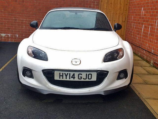

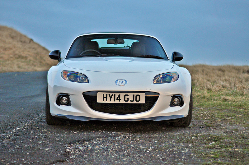

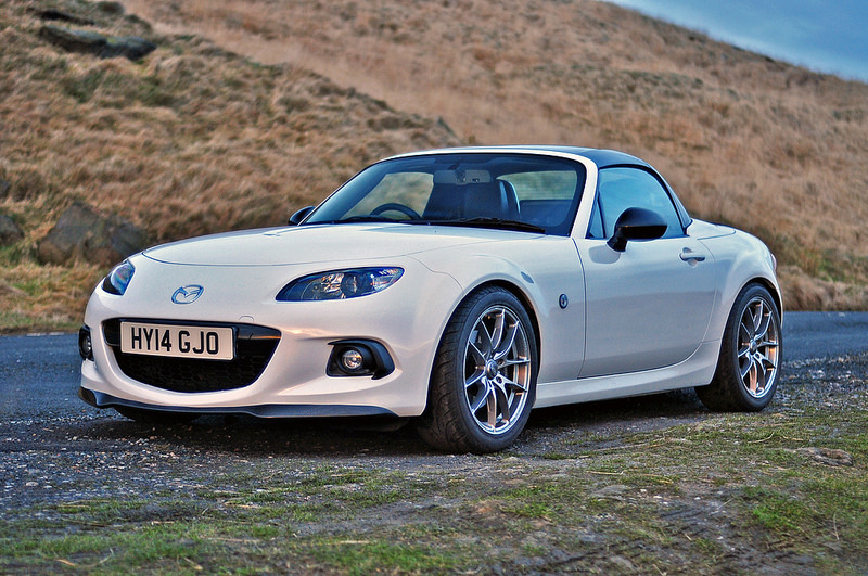

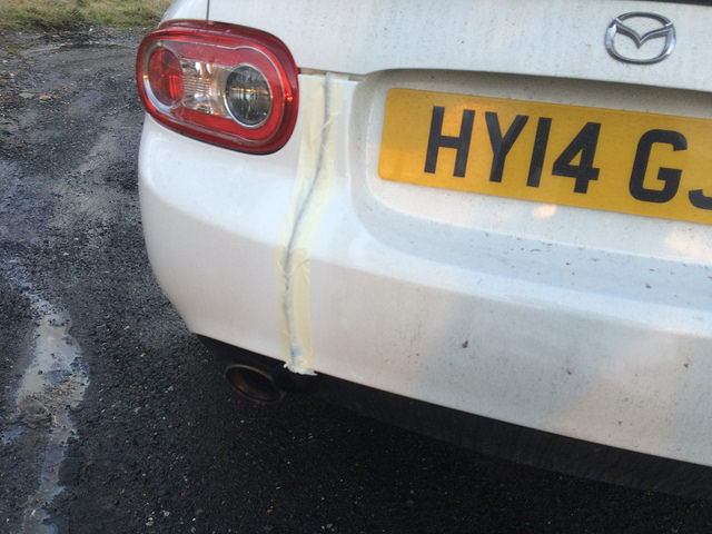

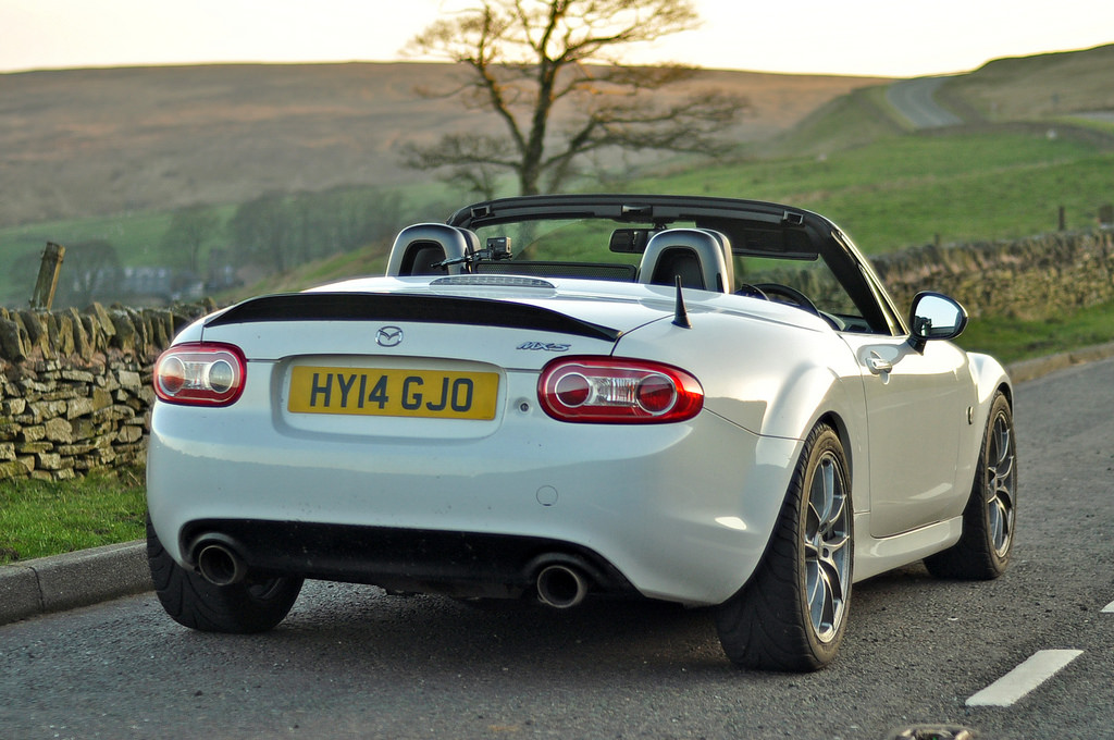

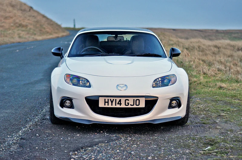

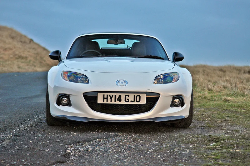

Anyway, finished off fitting the bumper this afternoon, decided to throw some dirty water over it and go take some snaps (yes usual spot!)
Not sure how well you can see, but the 4th picture kind of shows how it's not such a great fit. I imagine it's quite difficult to get all the mounting tabs in the right place when manufacturing and it doesn't quite sit flush with the bumper as a result. I actually had to buy a dremel to hollow out some of the mountings to get a bolt in. So, unless you're going to get a body shop to fit it, I'd struggle to recommend it sadly.

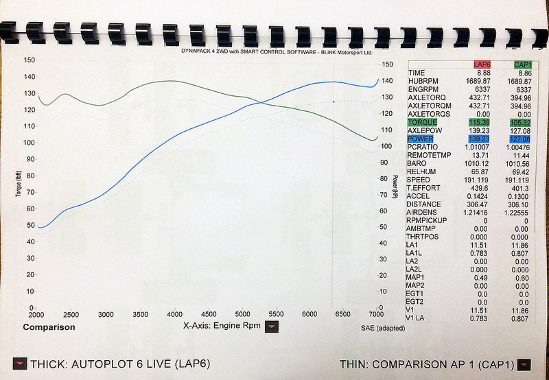

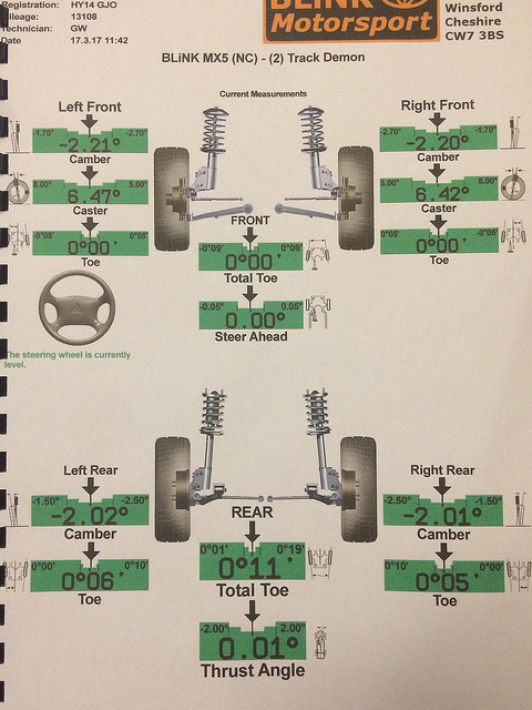

Small update: it had a decent day with Blink motorsport last Friday; was in for an alignment, fitting the RX8 rollbars, an engine, gearbox and diff oil change (not necessarily needed but well worth it IMO) and a remap.
I wanted it set up pretty aggressive as it's essentially just a toy to be used either on track or at the Cat & Fiddle. Ride heights were all set, I pretty much just said give me what you'd do to a race car and it wasn't all that far off apparently.
RX8 rollbars and new drop links were fitted and IMO are a huge improvement. The standard rear ARB appears to be the same thickness as a coat-hanger so it definitely feels a lot more stable through corners. No idea if it's any quicker, but it certainly feels more confidence inspiring.
The remap features a few maps which are selectable by the cruise control buttons on the steering wheel which is cool. There's some new 'driving aids' including flat-foot shifting, downshift rev-match and launch control - none of which I've used yet, they all sound a bit hard on the car to me and I can already heal-toe pretty well so...
There was a decent power increase, you can just about make out the faint dotted lines on the power graph which is before. As this is a hub dyno the figures will appear low, but for reference, 140hp at the hubs equates to roughly 180hp at the flywheel (and 165hp before). Certainly feels lively enough for now anyway!

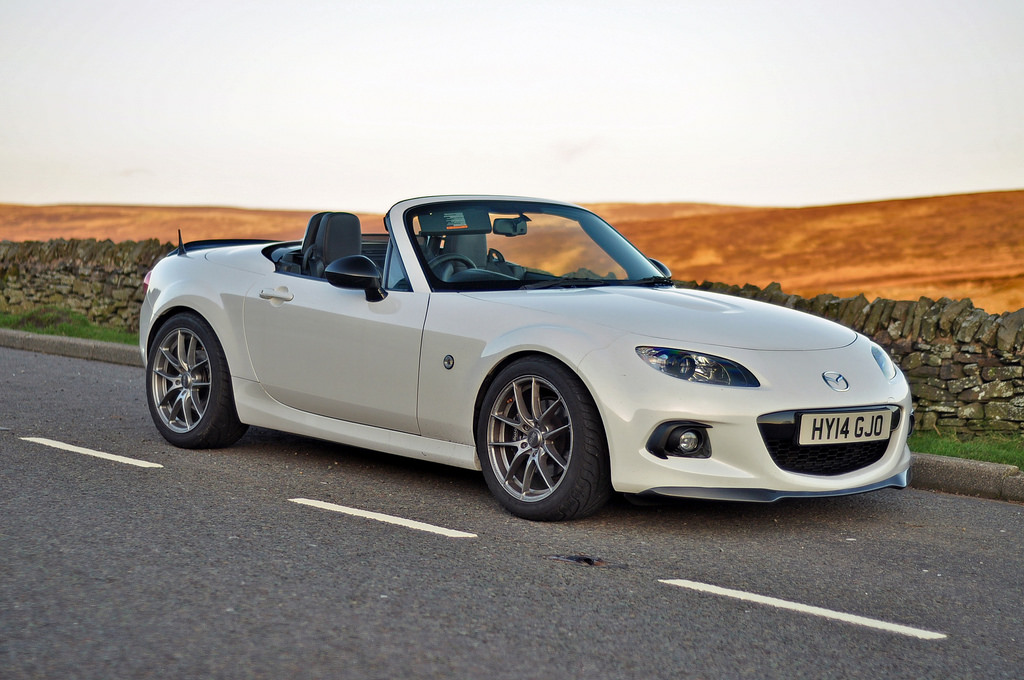

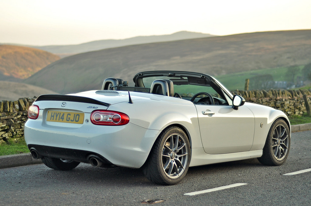

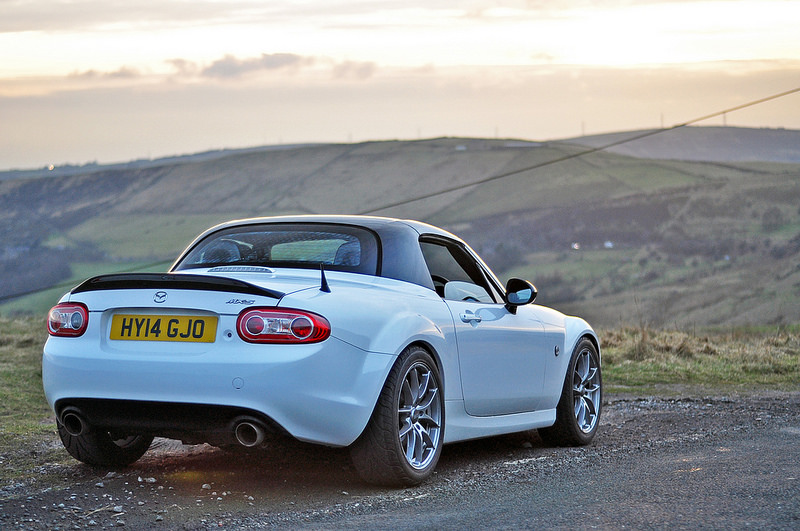

Managed to grab a couple of photos, however:
You can tell it's a little higher than before but if anything I think it looks even better tbh.
