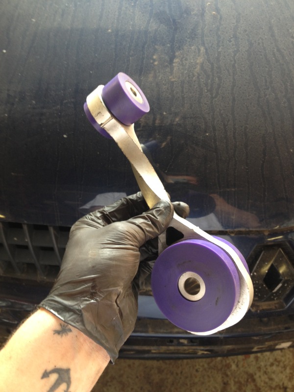

The car was in the garage getting a service, coolant change and winter check yesterday. Today when I picked it up I noticed that there was a judder/jump when I went to pull away. I went in to see the guy again and he took it for a drive with me and said it felt like the engine was moving. He asked how long ive had my Powerflex dogbone mount which is about a month.
He stuck it back up on the ramp and tightened the gearbox end of the dogbone mount bolt by about half a turn, it seemed to cure the problem at the time however it seems to have come back again tonight.
