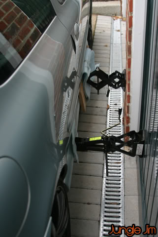

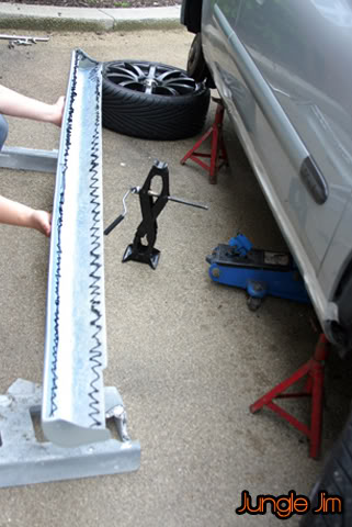

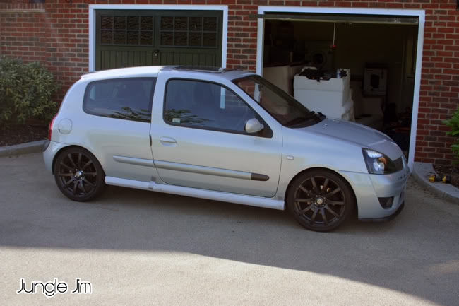

today i managed to get round to 'first fit' of the side skirts, drilling and screwing them in place, they will then be painted, rescrewed and glued on

The 'sideys' make a huge difference. They'll be great when they're on properly :)
  1.2 Dynamique billabong
Thanks guys glad you like them i think they make a massive difference, stops the car being 'front heavy'

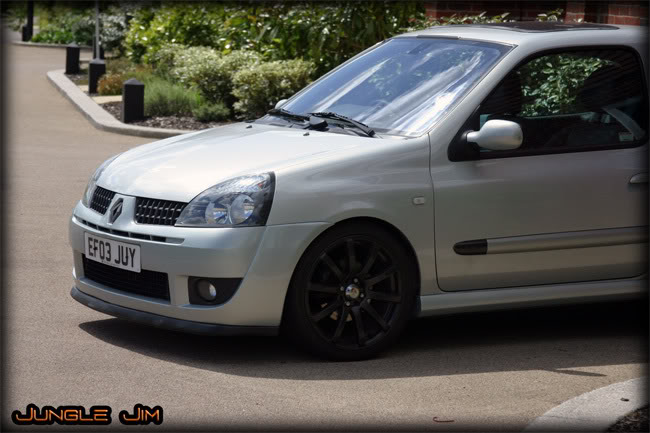

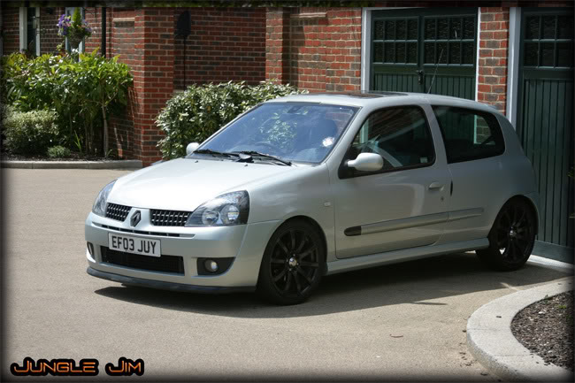

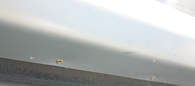

today i started fixing the skirts on properly as they are now painted.

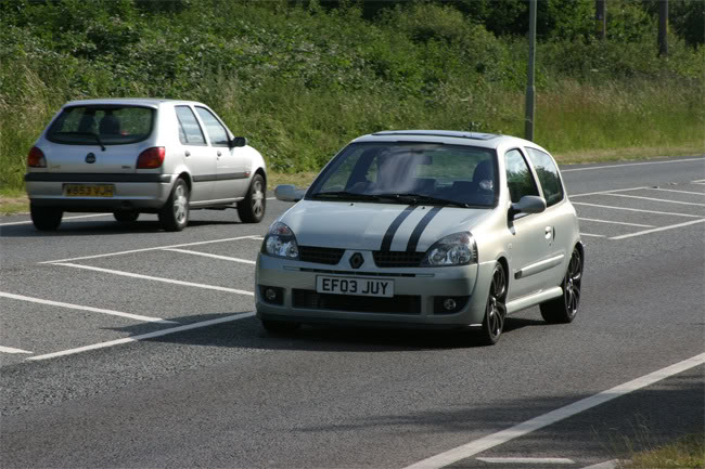

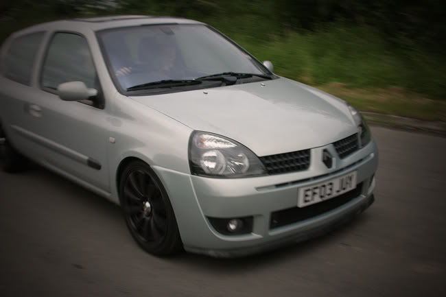

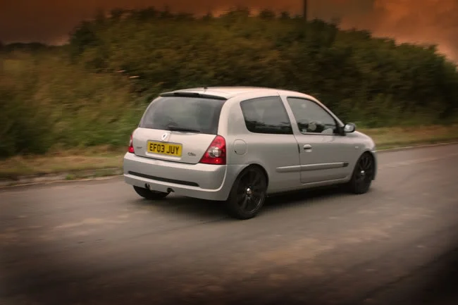

also my bro had a quick blast in the car so i snapped some pics. needs a clean and the car PC'ing

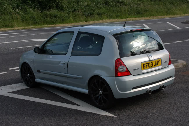

182 rear bumper is now on, plus i have bought a mig welder to fabricate the 182 style tailpipes

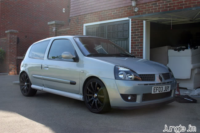

side skirts are now done
just got to order the rest of the tubing for the exhaust and then PC the car. i will PC the skirts, door strips and rear bumper as i havent done that yet. it makes a massive difference in bringing out the shine and giving a gloss finish to the laquer. Then i will go over the whole car again

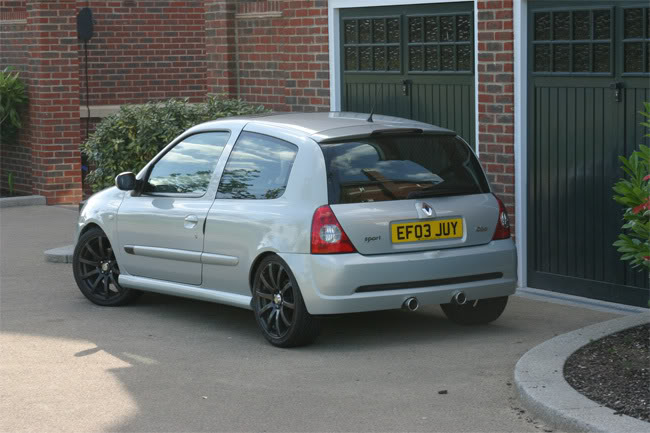

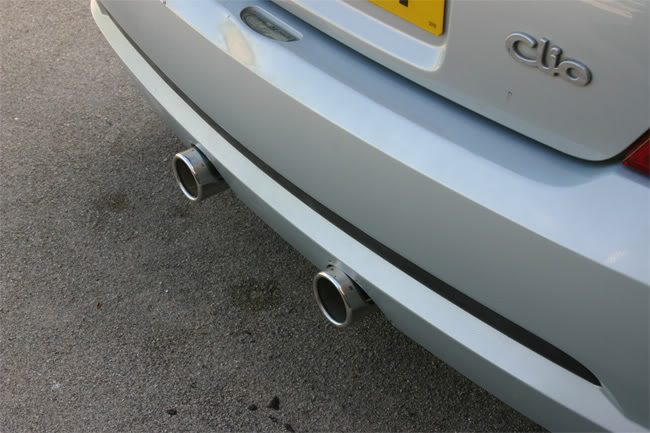

i finished off the exhaust today and i have to say i am pretty pleased with it. it cost me about £40 to make, rather than £450 to get one made. i need to lower the right side abit but thats not an issue as i made adjustable brackets. one thing which is rubbish though is i took a chunk out the paint work on the rear bumper
i dropped the mig welder on it when putting it in the boot so i will have to repaint it

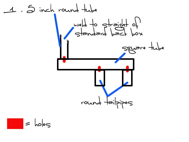

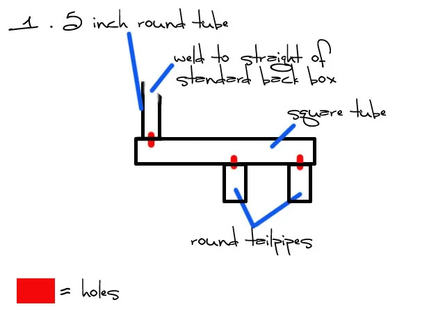

i made it from scratch mate, i bought two tail pipes from here
http://cgi.ebay.co.uk/Stainless-Ste...photoQQcmdZViewItemQQ_trksidZp1742.m153.l1262
, i cut them down to length. i cut circle discs out of sheet metal and welded them onto the ends, i used a hole saw and cut a 1 inch hole in the centre of the discs. i then used a piece of box tubing, which i capped each end (by welding a square of sheet metal on to it). then i drilled two 1inch holes into the box tubing and and welded the tailpipes to it so the holes lined up. i cut the curve part off the standard back box so it was straight and welded a pipe from that to the box tubing
haha lol cheers buddy, it was the first time i had really done any welding too. i just practised a bit first. it was a bit tricky but turned out ok and it works properly without blowing

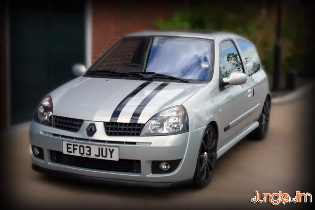

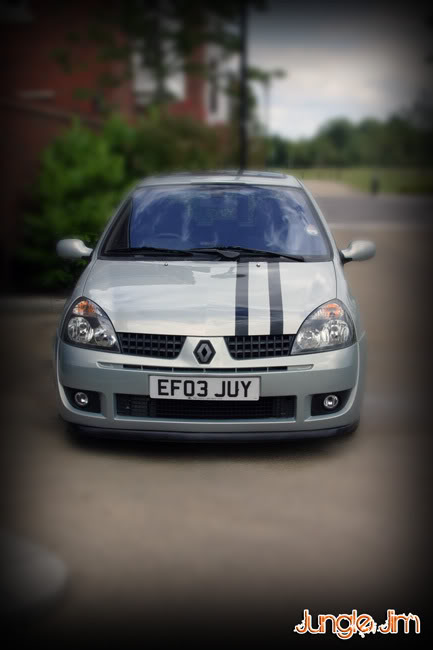

i tried out the 182 stripes this morning and also painted the shite chrome washer jets put on by the previous owner in the same paint as my wheels. (only after pic is the last one)
i am still undecided on the stripes so i only have put them on the bonnet, if i change my mind i can just pull them off, i thought i may as well give them a go seeing as i had bought them.
Cro
  Meg'd r27
Im undecided about the stripes mate. Great job on the exhaust! is box tubing square?? looks like you could do with tilting the pipes down a bit or it'll be melted bumper time! Fantastic job though a homemade exhaust that rivals my own :rasp:
cheers buddy, yeah the tubing is square so the ends of the tailpipe can be welded on to a flat surface rather than having to drill through the side of a cyclinder. its made like this, maybe not the best for performance but it works, its cheap and its a 1.2 so not really that the performance is ever amazing lol yeah i need to lower it abit but i made adjustable brackets so that isnt an issue, will do that later today
yeah im still debating the stripes i thought i may aswell try them seeing as i had them i will leave them on there for a bit as see what i think.
