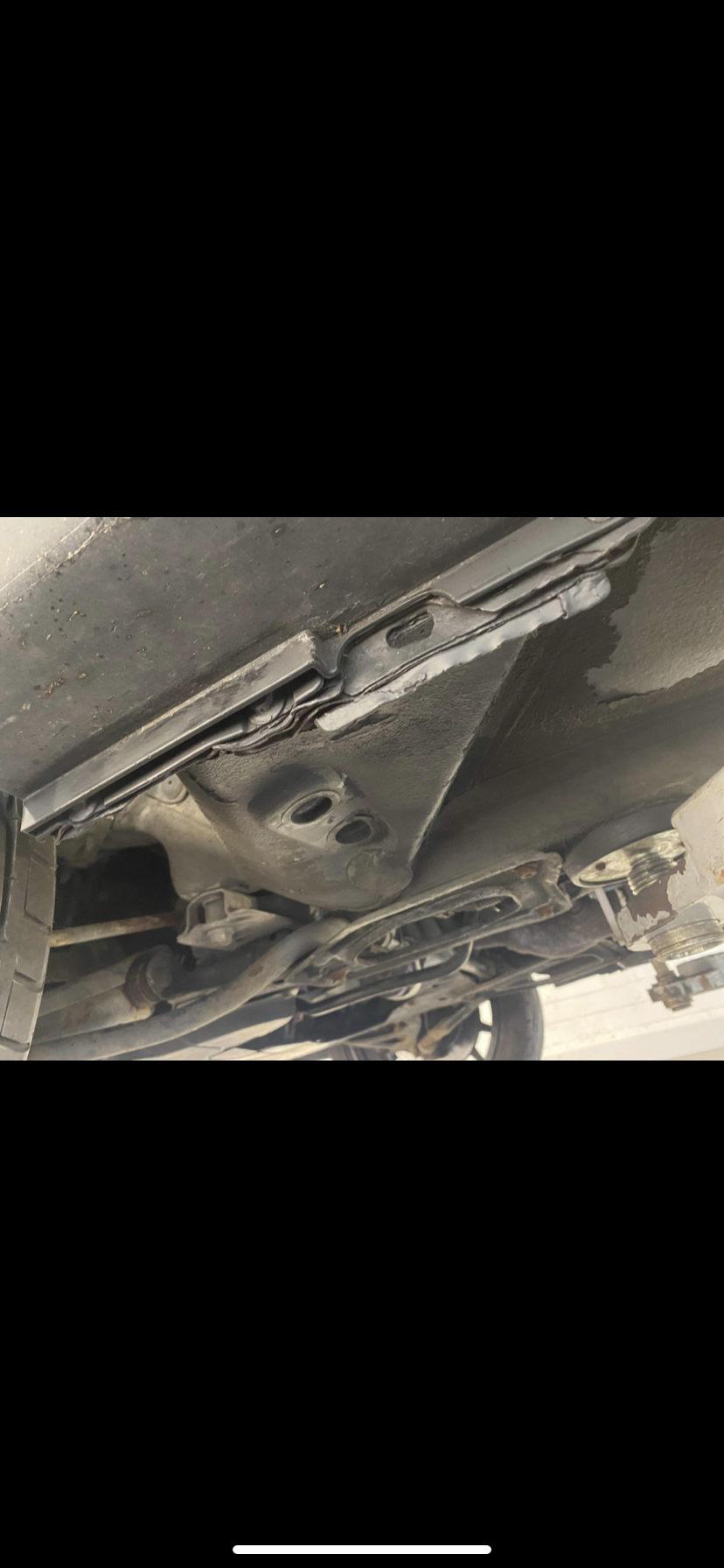

The only thing that is concerning me is the mot sheet for last year would you think this is bad enough to get out of the deal or should I just keep an eye on it, it’s been perfect every year before hand

Sounds like front jacking points are bent and rusty, like on 99% Clio’s, but hard to tell without photos….but the very fact it’s only noted as an adversary on an 18 year old car would suggest to me it’s not too bad. What does the damage look like?

Grab some pictures of the sills and put them up on here once you get the car. Very common for them to be bent a bit at the front jacking points, can usually be straightened out, bit of rust correction and painted quite easily.

Sounds like it to me as it’s both sides I will do when it arrives, it’s being tested again before goes out to me anyway!

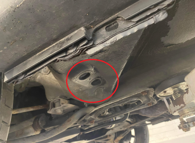

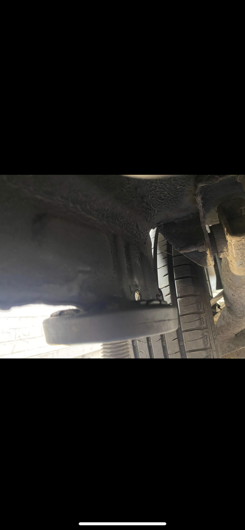

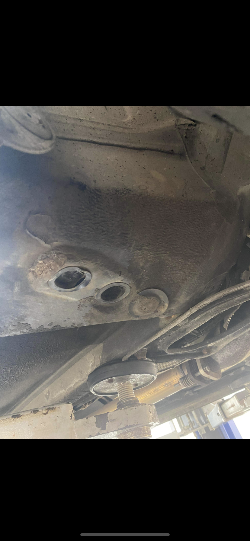

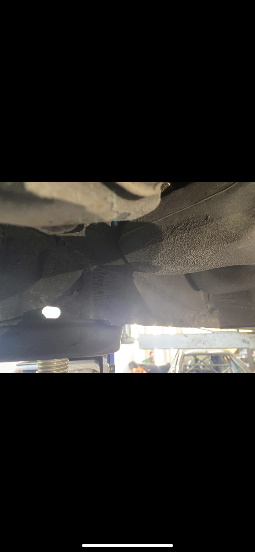

Not the greatest photos, I'd want to see the inside of the front sills from under the car, if that makes sense, at the least.
Also is it just the angle or is this caved in?
I'm sure a lot of Clio's are much worse than that jacking point wise, mine are definitely not perfect, just not something I'd be best pleased with on a car that's up for £6,500.
Repairable I'm sure, cost wise I can't help though.

It does look decent to be fair, I'm sure if you decided against this one you'd only find another one with it's own niggles. What's your plan for future MOTs considering it's decatted, or do you know a friendly MOT tester?
I don’t think it looks to bad to be honest better than most Ford st3 I was looking at!
Mine are completely folded and rusty, yours look brand new in comparison. Lord knows what the previous owner of my car was doing, but the entire sill on both sides is fucked. I still use them though 🤷‍♂️
