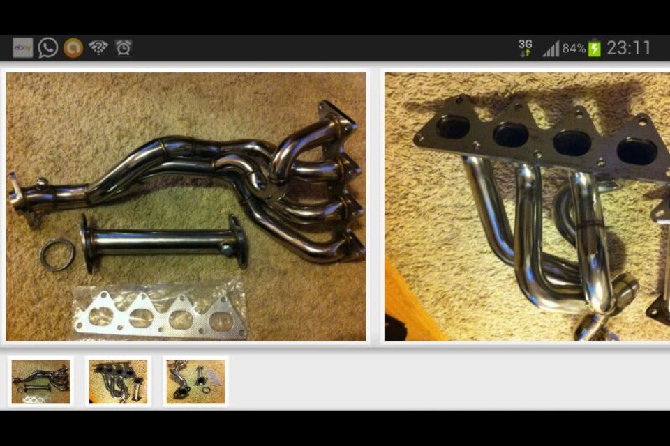

Just bought
Car  172 Cup,Gtr,gttdi
Oh. Is that from eBay? Bit awkward but try and reverse the transaction. Have you heard the term "fits like a 6 fingered glove"? Sorry :(
It's an aftermarket exhaust manifold, 4-2-1 with a 2.5" bore. It's made out of stainless steel and looks well made. I've seen cheap stainless steel turbo manifolds crack and for that matter expensive stainless steel turbo manifolds crack on Rb26 engines (my hubby's got an R32 GTR).....but never heard of exhaust manifolds on NA cars cracking. Have any of you guys bought these manifolds off eBay and what is your experience of them?
Do a search on here for toyosports and you'll see why I've not bought one. I went for a genuine 182 manifold. And it makes no difference in day to day driving. Or track driving. Couple of bhp on the rolling road if that sort of thing bothers you.
​Not worth removing your subframe or engine to fit.
Afaik the standard 182 one is the one to fit and even then would only be worth doing if you had the engine out etc or had a broken one.
As said get your money back before you waste any time and money on that.
You only need to drop the frame, not totally remove it. Or you can drag the engine forward out the way, you dont need to do both.
Or if you have the head off it will slide straight in, I changed to a 182 one when doing the valves after a belt went and it was easy without the head on.

The 182 standard one is very well made and NEVER cracks, so seems silly risking another one that may or may not be ok.

Especially when people are selling genuine ones for less than that shiny piece of of s**t on the first page! Talking of which I do have one, if it doesn't sell it will go on my ph1 when the time is right/the engine comes out :) only thing I like about the 182 manifold is the ease to change the cat!
While toyosports may use cheap shite, I'd rather pay £180 for an exhaust that cracks, instead of £600+ for a milltek that cracks.

if its a toyosport it will be a replica of a reputable manifold.
toyosports are a good fit and decent quality from my experience (never had one for clio mind) they always have smooth bends, decent welds and the 6 i have fitted have always been a perfect fit.
Though, they are made from cheap stainless. I would expect the decat tube will look pretty rough within a couple months.
Often, you do get what you pay for, but im always a little surprised by how much people dislike the toyosport stuff, and how often the people taking a dislike have never even seen one, let alone fitted one (mainly a saxP dig) and just winge about them, presumable becuase they paid 4x the price for a piper/supersprint that does the same job.
P.S send it back if you can...

The manifold will do its job, it will look pretty and will fit fine im almost certain. The company has been around long enough; if they were as bad as people make out the company would have gone under ages ago, simple capitalistic principles. BUT, a 182 manifold, the one designed by a team with many many cheques to throw about will be the better call.
