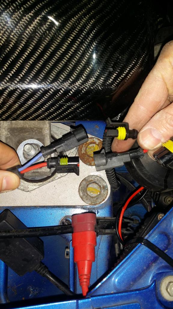

Managed to get the thing out but am I right in assuming that's a HID kit? So first question is do I replace the bulb and see how it goes come MOT time not sure how they are set up/aligned only the 2nd time I've driven the car and first time I have needed to use the lights and found the bulb gone. 2nd question is do I just get a set of OEM headlights and fit decent bulbs into them? Not fussed as it's mainly a track car and just don't want the hassle of having to order loads of bulbs so I have spares and don't have to wait for replacements (I've read that the HID bulbs don't like being turned on/off all the time etc). Would it be simply unplug the HID and plug in the OEM headlights? Or get new Bulbs/Holders and fit into my headlights.
Personally, I would go for the oem headlights, as you said y8u have your mot coming up and if I am correct in thinking that you dont have projector type of headlight housings? Also best find some new rubber covers as yours have holes in, I had te dame ting and wat mucked up my headlits, had ot have anew set of lights

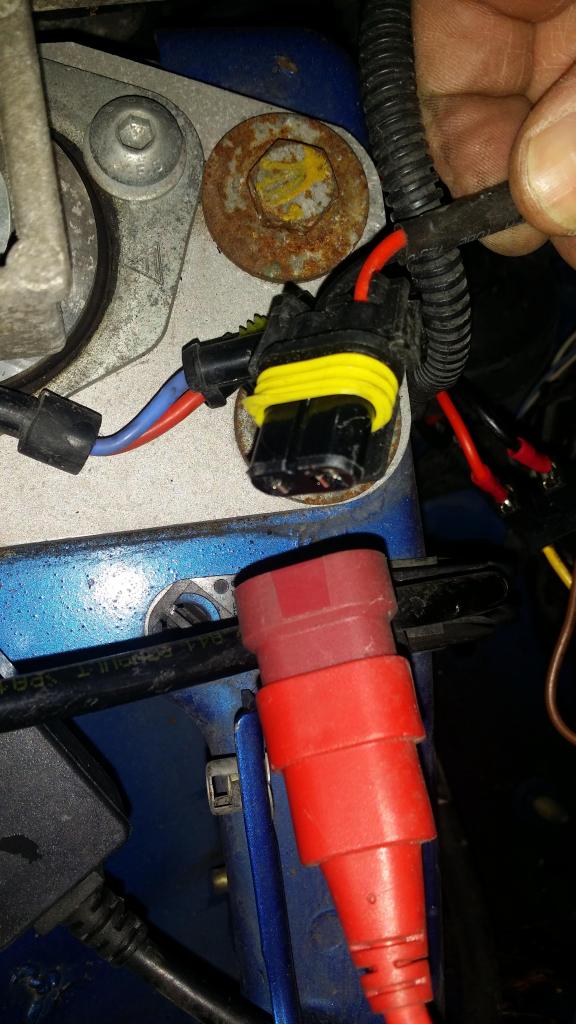

Would I just need to unplug the HID kit and get some standard bulb holders and they would plug into the OEM housing? These are the cables/wires that were there? I assume the HID kit just has connectors to use the OEM headlight connector?
(took these pictures so I knew what plugged back in where lol my dad was like 'don't just unplug it all and see what goes where when you come back with a new one' like I normally would)

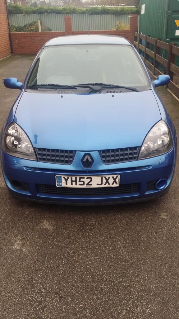

Are the headlights on a 172 Cup xenons or might be worth swapping them for xenons if the aren't. Don't really have a better picture of the headlights themselves at the min.
They're reflectors so shouldn't really be used with HIDS so may be worth switching to projector lamps if you intend to keep the kit.

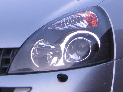

This is what reflectors look like;

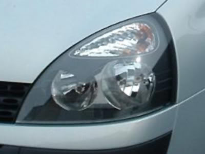

and this is what projectors are like;
