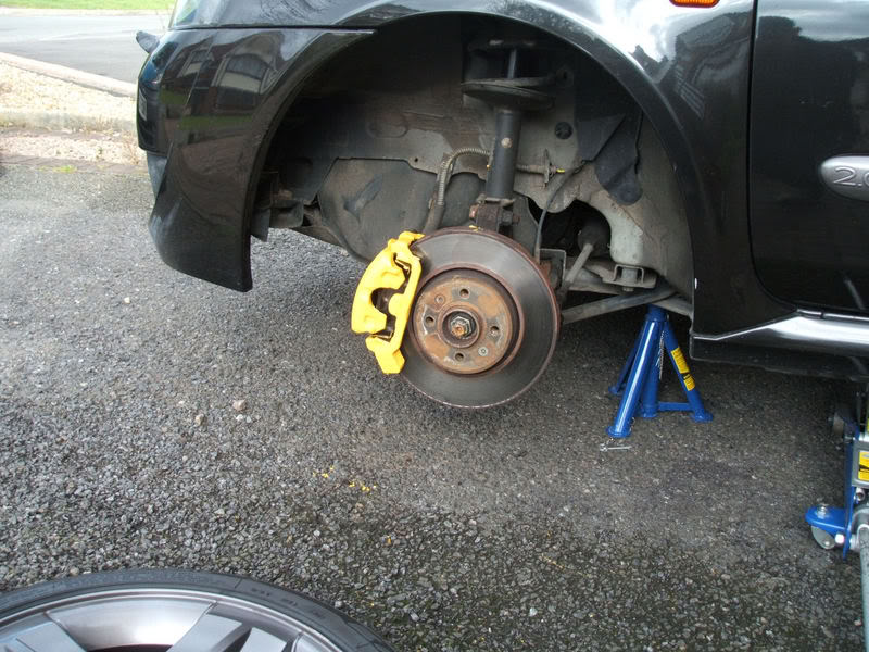

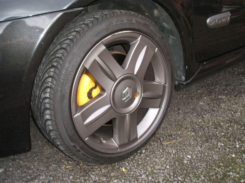

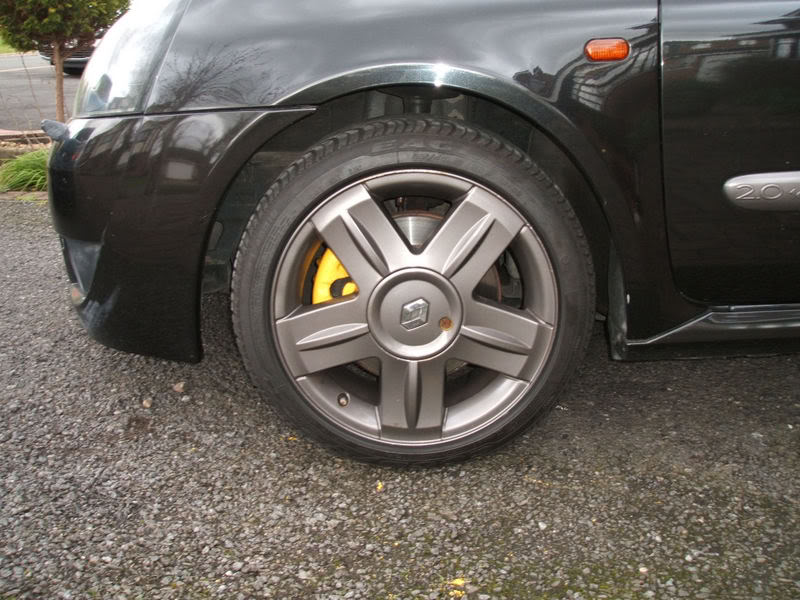

Only got the 1st coat done due to rain stopping play but i'm happy with the results - didn't expect them to be so bright lol

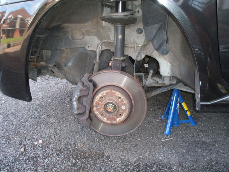

Before:
After a Good Scrubbing:

looks good, there are a few on here that are against it but i like it.
mine are getting re-done this weekend. not happy with way mine came out, and also coz i forgot to mix the hardener in the paint :o
they look good.
i remember when i did mine yellow for FCS 2005, not many folks liked them.
it was only Elliot (Eskiibest) and myself who had them.
Looks good with the dark wheels.
P.S. Put some touch up paint or something on the centre cap bolts, to get rid of the rust.

I took about 30 - 45 mins prop work on each caliper.
Good srcub with a wire brush - then a quick rub down with emery paper.
Cleaned with detergant then fimaly used a solvent cleaner to get any grease off.
I left them attached but took the pads out.
I went over the top I think with prep but I didn't want to go to all the trouble of painting it only to get a rubbish finish
