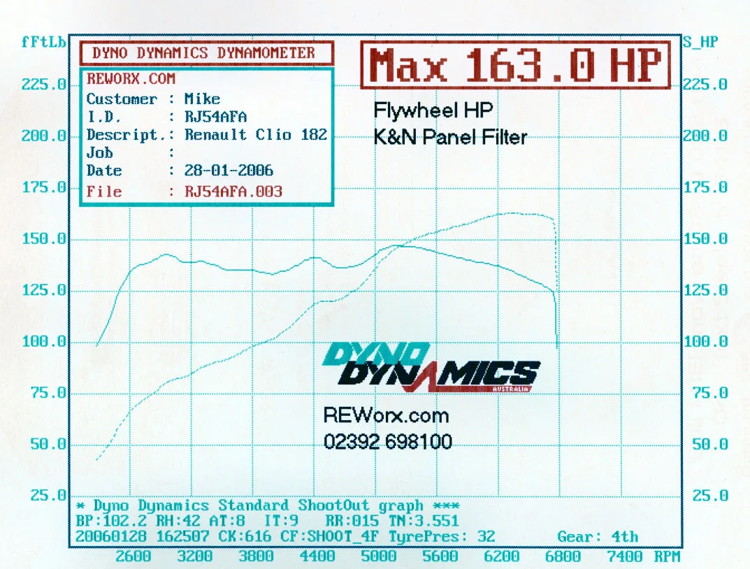

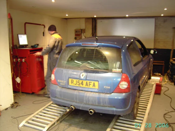

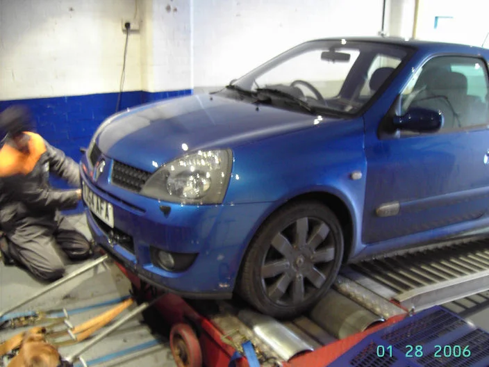

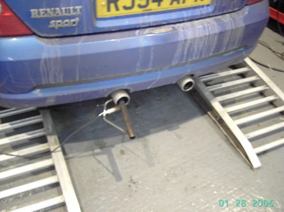

Just Come back from a weekend down south, and my Girlfriend's uncle work's in a tuning garage down there (re worx, portsmouth) so i thought i'd get my 182 on the Rolling Road, whilst I had the chance.
The results were a little dissapointing, but to be honest I did expect it for some reason.
The only mod on it is a K&N Panel Filter, and the end result was 163bhp at the flywheel (see pic below)
Any Idea why its missing almost 20bhp???
Ive got a Vid as well (just under 5mins but 65mb if someone can host it at all)
Cheers, Mike

i wouldn't worry too much as cocopops had his RR'd with mine when we had just got them and mine got 184 and his got 15X and he was well disappointed but when we went out for a blast his accelerated as fast as mine so it must have been something else.
If you are really worried then get it tested at another centre.
dk
  911 GTS Cab
also depends on how they calculated the power at the flywheel, they might not have added the correct losses for the car and the conditions? Would have been better if you had another 182 there to compare it to.

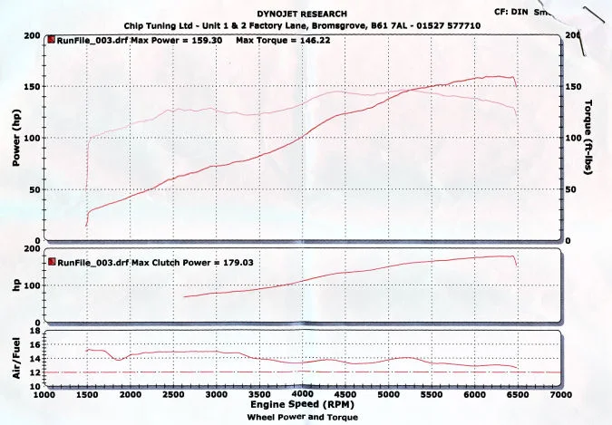

Just thought i'd add, here's the figures from the rolling road that my mate went on, its on a differant one, so as you lot said earlier, its difficult to compare.....
His came up with 179 at the fly, and mine with 163, but when we compared a while ago, there was absolutely nothing in it.
But since then, in the last few weeks, its been feeling slower, and he caught up with me no problem..... Looks like its a trip down to the stealers again for me! :dapprove: :mad:
Could it be anything to do with valve seals, or piston rings, as my oil level has dropped alot lately???

how come the torque curve looks the same than afr curve between 4k-5.5k rpm? how would it change if afr gets corrected?
and howcome your car cuts out at 6.5k, is it cold!!!
  Octy vRS & Ninja1000
That one there is the one my mate had on his 172, and I didnt think the graph looked right either... but this is the first time ive ever been on a RR anyway, so i dont really know much!

Rolling roads are a can of worms IMO i had my 172 tested when i first got it, it produced 175 bhp but more importantly 170 ft lb of torque theres no way that this is right, car only had a cat back on it.
  172 ph1
Looking at the graph, it makes good Torque at 3000rpm, and about book at 5200rpm, but dies a bit after that.
So I'm not sure where that puts the fudge factor arguement - can the various "compensation factors" have more % effect at one rpm than another?
If not then I think there are 3 scenarios
The measurements are low and your car actually makes more torque than std.
The measurements are about right and your car is not performing at higher rpm.
The measurements are high and your car is running on 3 cylinders.
