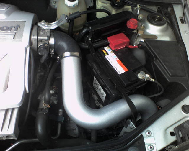

I have got it fitted in a fashion... I wouldn’t recommend any 1 getting 1 for there 172 phase 2 it just doesn’t fit right :(
The main problem is a connection that fits into the back of the light cluster... I’m going to modify the pipe to fit with some Samco hosing or something... haven’t thought it through yet but I will prevail!
Also the 90 degree bend it is supplied with is very short and could do with lengthening to help it fit, I think the best solution if any body wants a similar setup is to make it them selves by buying bends and lengths of tubing and sticking a cone filter on the end (Some 1 mentioned this before).
The good news is that it sounds nice :) and is nice and responsive.

HI gaz sorry mate just got your pm about this kit. yeah whn k&N fitted mine they said there would be a problem when fitting it to a MK2 I cant remember exactly what he said. Sound is still amazing I always put the window down to hear it better =D
Pics of mine
  Clio 172 mk2
That looks pretty good
I take it the problem with the fitting is the bracket at the filter end to stop it moving about?

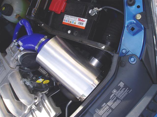

Tbh , i can't see any advantage in the typhoon . Its just a standard k+n cotton air filter on the end of a long tube and probably costs hell of alot of money as well .

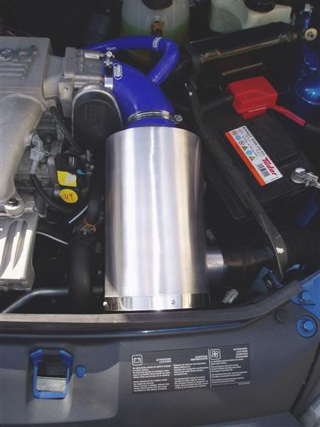

I have a k+n air filter , £30 new off ebay , in an aluminium enclosure with both the original air feeds . I've had it on a few weeks now and i'm very happy with it , sounds good when you boot it , nice deep roar , and pulls as hard if not harder than with the standard air box and filter .I'm pretty sure it will be getting just as much cold air as with the typhoon.

Not a bad looking setup although I feel the gains over the std box with panel will be very marginal.

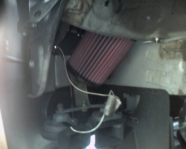

Nice idea, although if you replace youe acoustic valve and piping with a set-up like this, I feel you would get more cold air to where it is needed. This is my cold air feed set up. Pipe is bigger 85 mm compared with 58mm standard
http://www.cliosport.net/forum/showthread.php?t=152583&highlight=air+feed
I now have heat shield too, which I will post pics up of later. I can't see that I am really losing any power to heat soak anymore as the filter is never hot (warm at the most). But I also get the great induction roar!! :evil:

I made it myself . Can't be arsed removing the acoustic valve ,i've read posts were people have removed it and its made no difference , but i might replace the other cold air feed with a larger diameter one when i get some time .I might even get a video up oneday so you can hear the sound . I'm a bit busy for the next couple of weeks then off on me hols so its havin the time to get round to doin it .

Only reason i removed it was to free up space to fit larger air feed. No difference by removing it. But a small improvement on low down acceleration (im talking minimal) but better than before since fittng this feed. Plus sounds marginally louder!! :dead:
