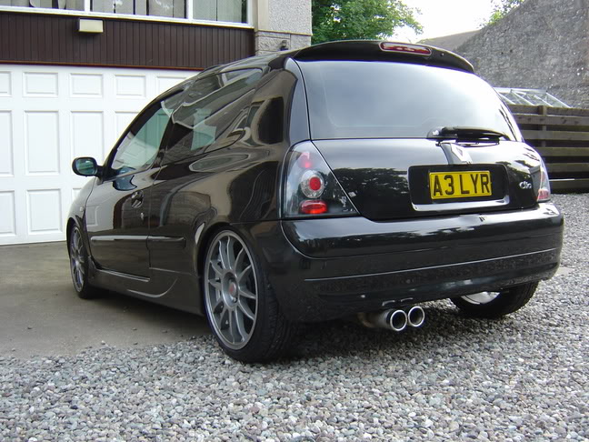

had so many problems with it, and only been on a month, wondering if anyone else had similar experiences?
1. the centre section was about a foot short of the cat (so had to get a new peice of s/s welded on to make it fit)
2. my original renault hangers needed to be replaced with new ones (fair enough, they're 6-7 years old)
3. the flex on the cat also had to be replaced for a s/s version to stop the exhaust from twisting
4. the hangers which k-tec supplied have now fallen off leaving the exhaust resting on the rear axle. (pictured)
going back to get this (hopefully) fixed tomorrow [all fitting work has been carried out by a stainless steel exhaust specialist]

sat nice and tight for a wee while, and there's no problems as regard to fitting, as the garage is held in very high regard.
considering writing an email/letter to ktec, but there's every chance i might have to send it back or whatever, and I can't afford to go without an exhaust for any period of time.
highlighted the bit where its resting against the axle, and one of the supports that has simply came out.

yeah i think its far too heavy too, but then its apparently designed for a clio, and my hangers are all brand new. It was twisting like anything too before I got the new stronger flexi pipe.
any suggestions with the refit? to strengthen it likes, so this doesnae happen again. (also, its only been on for just over a month)

That pic looks pretty serious though as is down to weight/movement of the box

tbh that looks as if the exhaust rubber mounts are the wrong type...
rubber mounts have all been replaced for brand new renault parts. they caused the problems i had to start with, but then it was all refitted, and now the hangers have fallen off completely.

from looking at the pics in this thread it seems the "band" around the back box hasnt been twisted around the back box to lift it up....... where u located sharpie?

i stay in scotland, and got my exhaust fixed today by dave at sounds of silence in bo'ness. turns out the nuts had been stripped off, so now ive got some locking nuts and washers on that really wont come off in a hurry, and yep... some cable ties.
im really happy with the sound and that of my exhaust... but the dave commented on the poor fit and quote "worst exhaust ive ever seen... if someone comes in with a ktec exhaust and asks me to fit it, i'll say no"
