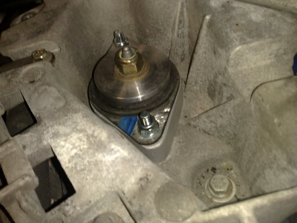

Hi guys,

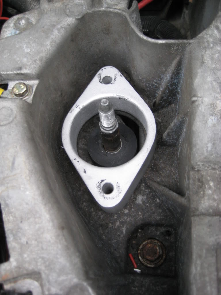

I'm 99% sure this is the right way to mount the gearbox mount.
Please tell me where i am going wrong as the part in the second picture rattles around when its all done up tight.
Obviously the bolts go in the side but i just laid it out as i had put it on the car.
Any help would be appriciated
Thanks

I am sure I fitted mine differently, it goes on the way it's tie wrapped together ;)
Re: K-tec Gearbox Mount Problem
think it's together in the right order - is the centre bolt that it all sits over tight? it tightens into a nut underneath
ed. lol. difference of opinion! i can't remember to be 100%, but yours is in the same order of assembly as the picture shown on KTEC's site

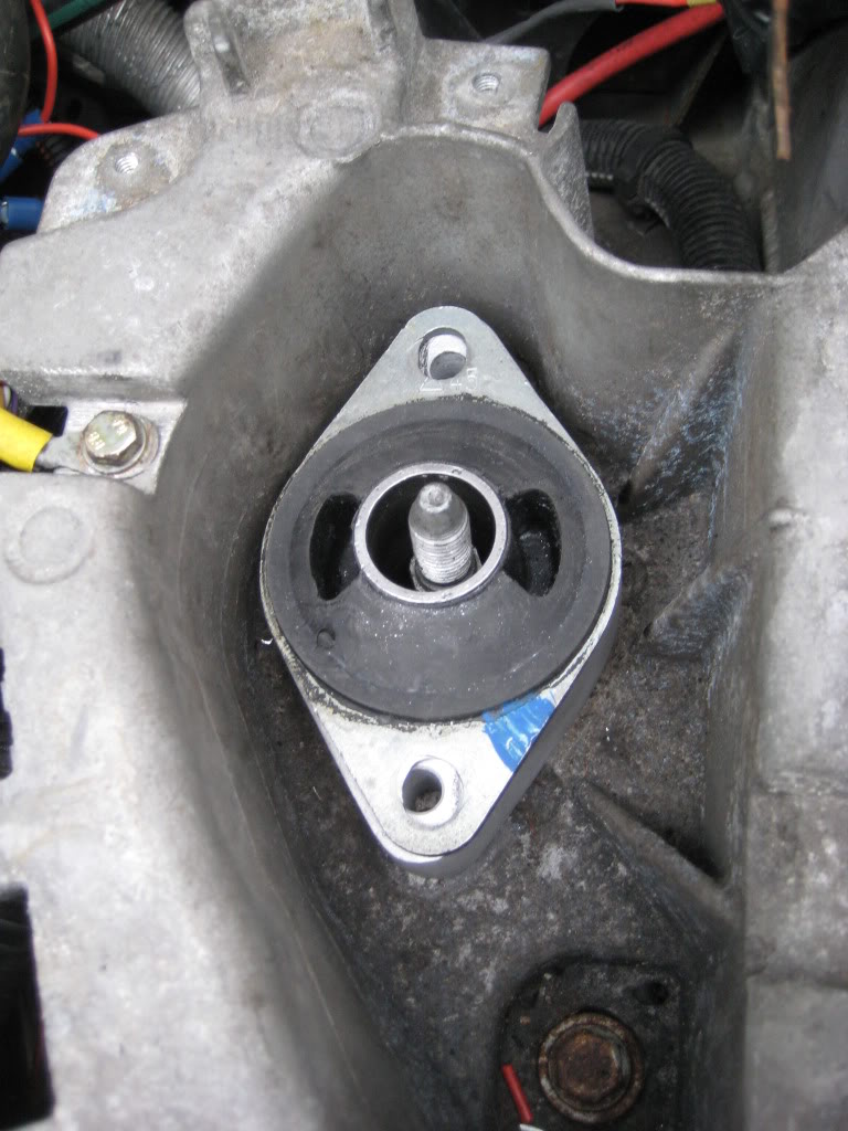

This is what it looked like when i fitted it the first time
But the little black washer thing which went on first rattled around and thats deffently not right.

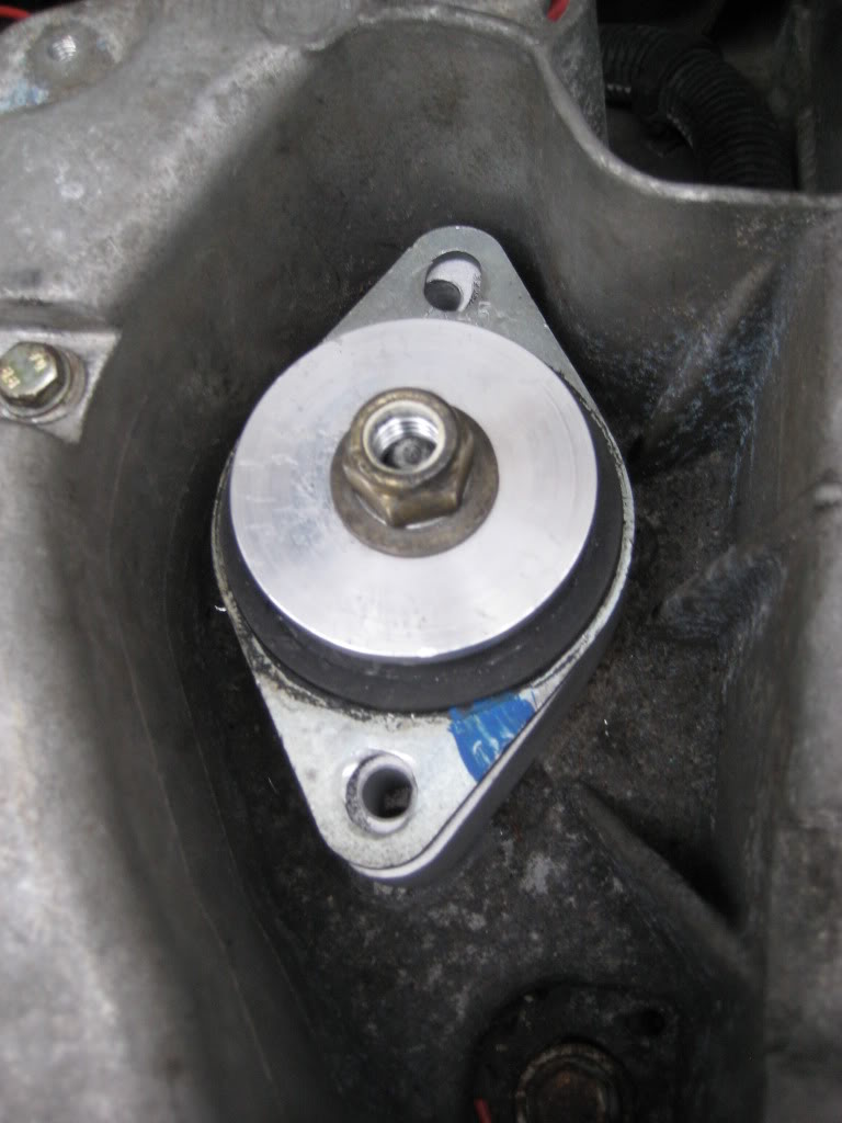

that's about the right amount of thread exposed on the middle bolt - odd
this contradicts above, but could it be that you've got something trapped ontop of the gearbox that's not allowing it to be pulled up as far as it should?

Hmmmm i dont think there is anything trapped as the bolt wont tighten up any more as the bit silver dics is eating into the bit where the thread ends on the bolt/shaft

I have no idea on how this goes together, but I can't believe this to be the right amount of thread exposer as Henry said above, correct me if I am wrong but that is a locking nut, the nylon ring is not covering the threads so this wouldn't be enough to lock the nut off.. Odd indeed, I'd give K Tec a call when their open
Edit: Looking at the pic with the smaller rubber, it looks a lot thinner then the one shown on the K Tec website? Perhaps that maybe the issue?
Edit x 2: Ignore the first edit, I noticed on another thread this looks the same... Strange

have you tried it with the black washer up the other way around? as i recall, its inner circ is bevelled on one side

I tryed placing the washer both ways round as one side was tapers a little but they both didnt make a difference.

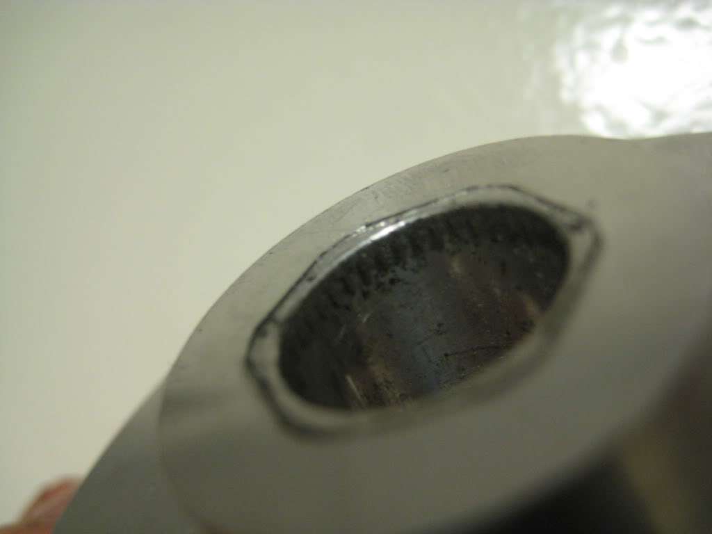

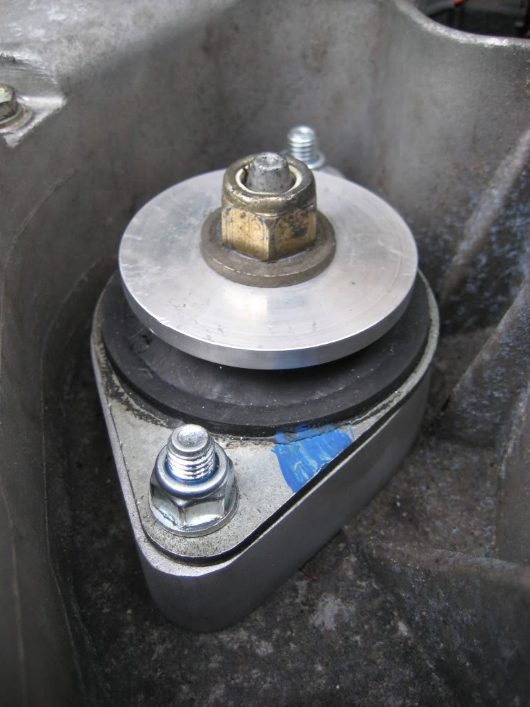

I had the same problem as this,when I tried to tighten it all up you can see where the nut is pressing into the alloy as in one of the pic's on here.I resorted to grinding the alloy tube down this did the job.Yes I did put it together as it came and it just would not fit,I even had the whole lot out of the car.

Post No 7,you can see the problem,it won't tighten together as the nut is touching the alloy plate.
Forget all that now then.
Chrsipy,this is what I had to do,it was the only thing I could think it could be as I had tried everything else.Phew I did the right thing then.
