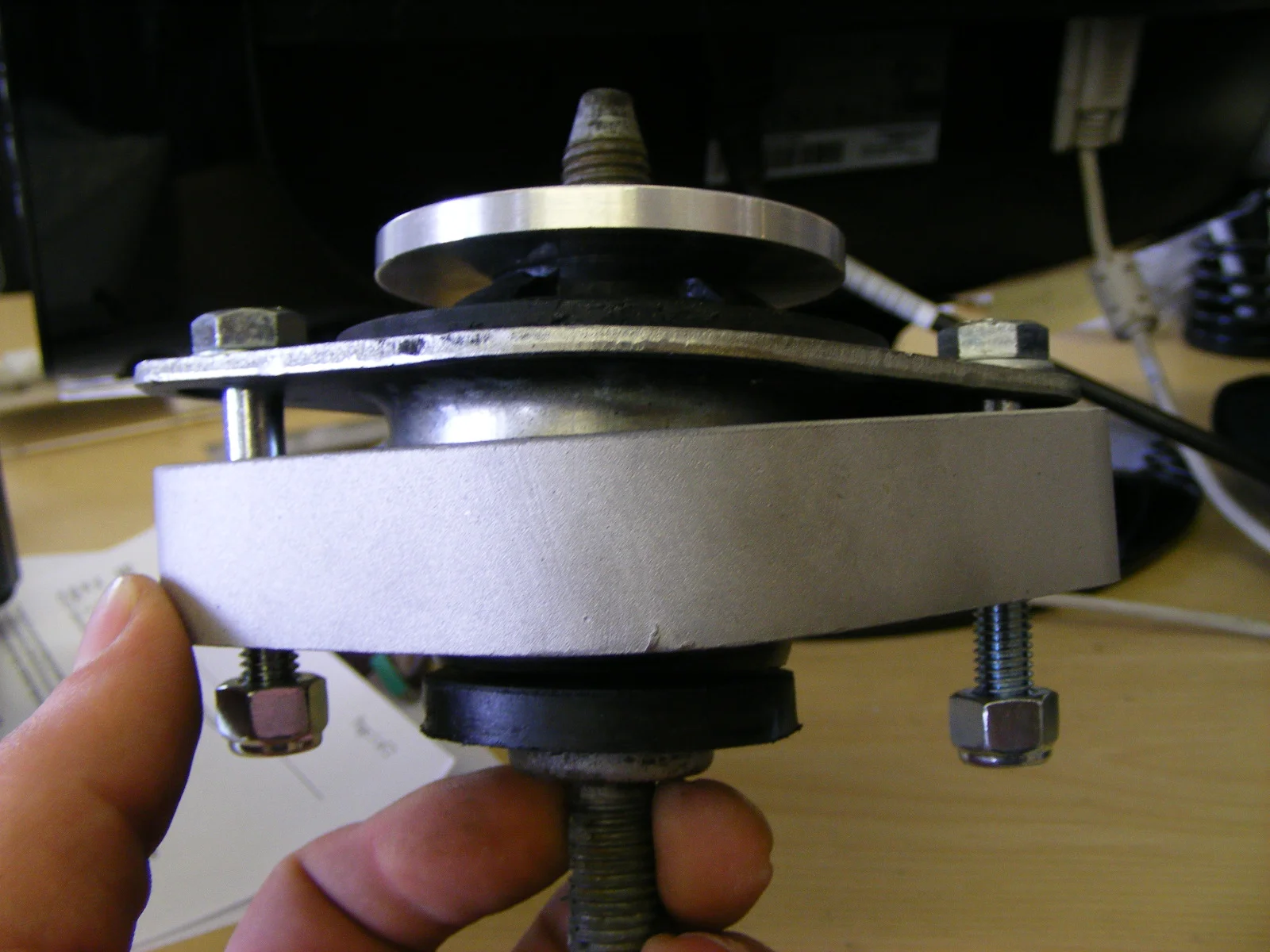

Washer
Spacer block
Mount / bush fitted with blue marking face up.
Top hat slotted in.
Bolt up.
Thats the right way is it not ??
  TrackCar & F30 330d
Re: K-tec Gearbox Mount Problem
Washer
Spacer block
Top hat slotted in.
Bolt up.
Yes thats the way i did it and it the way i showed on the first page of the thread :)

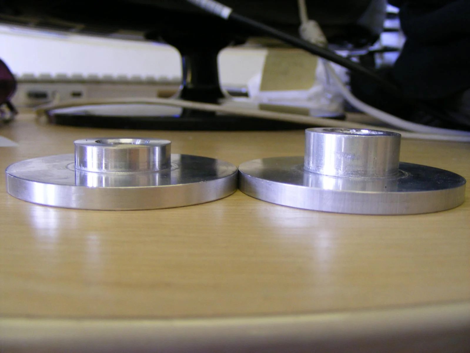

Hi guys,
OK, so here are two pics to hopefully clear this one up. One shows the revised top hat against the incorrect ones. As a side point, if people have the taller top hats from previous batches, i.e. before March 1st, do not be concerned, the overall assembly height was the issue, the easiest remedy was to adjust the top hats. It is in fact the case the mount body has reduced in heigh, very slightly, but this cannot be remedied with ease.
The second image shows the correct assembly order, loose of course. This is photographed on the gearbox pin.
Top to bottom, it goes as per website pic:
1. Nylock Nut
2. Washer
3. Top Hat Aluminium
4. Rubber Mount
5. Casting
6. Rubberised spacer, bevel side down.

New mounts from our stock have started leaving today, replacement parts from Vibra-technics should start leaving from tomorrow, please allow for the Bank Holiday weekend in the delivery times.
