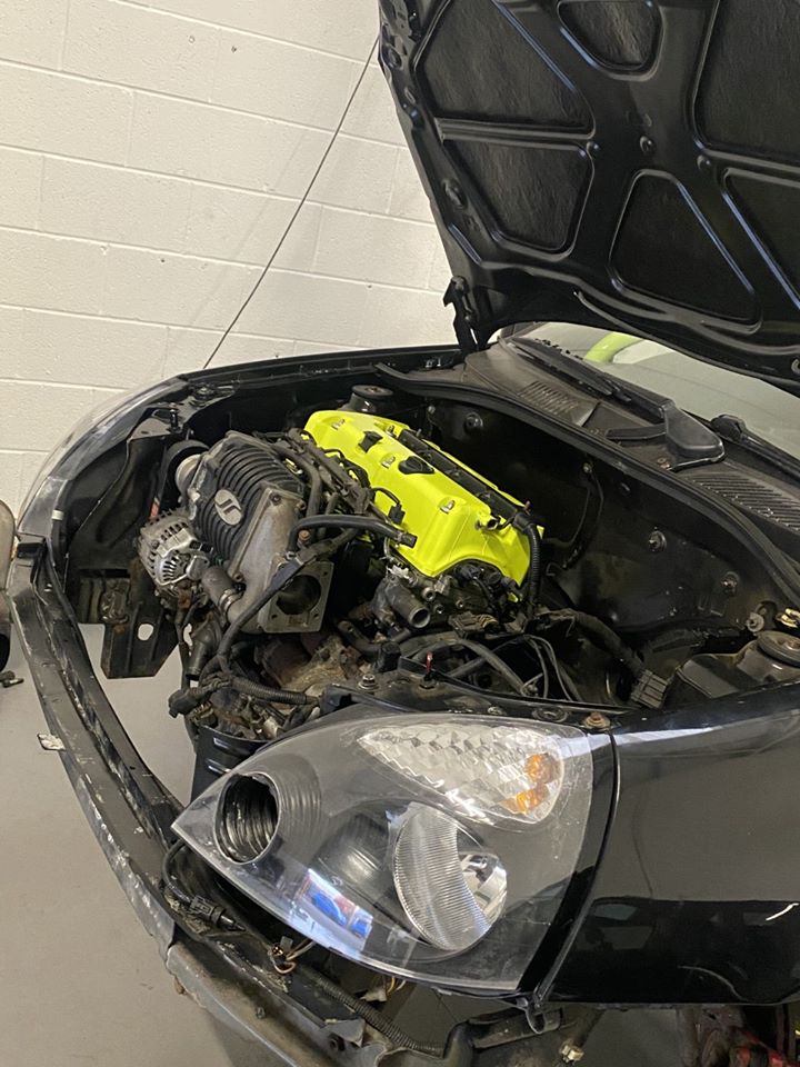

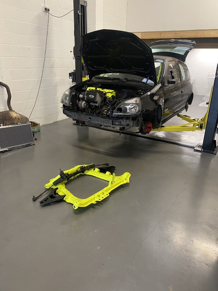

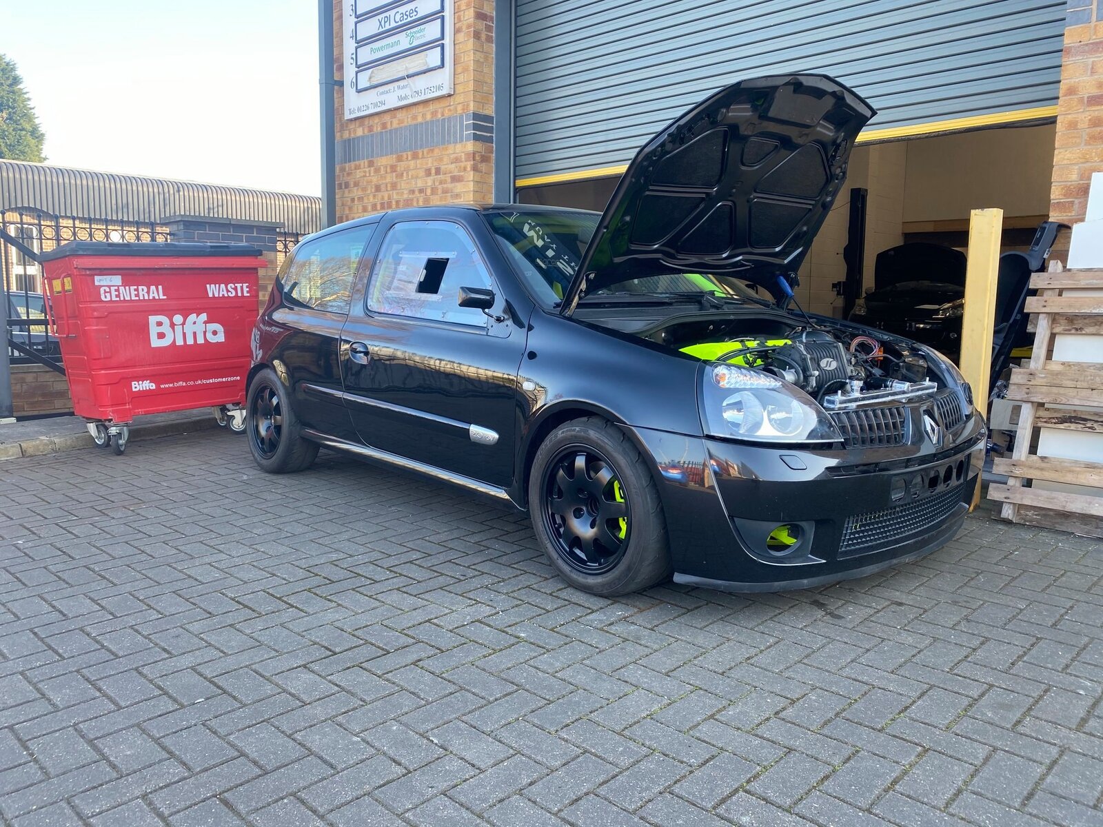

I was scrolling through facebook and Found a company that is currently in the process of sticking a k20 in a 182. Not the interesting part, they're claiming the chassis or subframe dosnt need modification, which from what ive heard is virtually impossible. Be interesting to see what the outcome is and if they fit a k20 without any modification.

With EP3 box and the engine as high as it is in that picture it has a chassis notch (I’ve spoken to him). Although he said they can make it fit with no notch or subframe modification, amazed at how they will manage that tbh

The car has had the chassis leg notched slightly but other than that it fits like a glove. People always said you would never get a K20 into the bay due to the height of the engine but this sits bang on and is still at the correct lean angle too. Oh and its supercharged too so there's plenty of space on the front of the engine for a whopping charger😂
