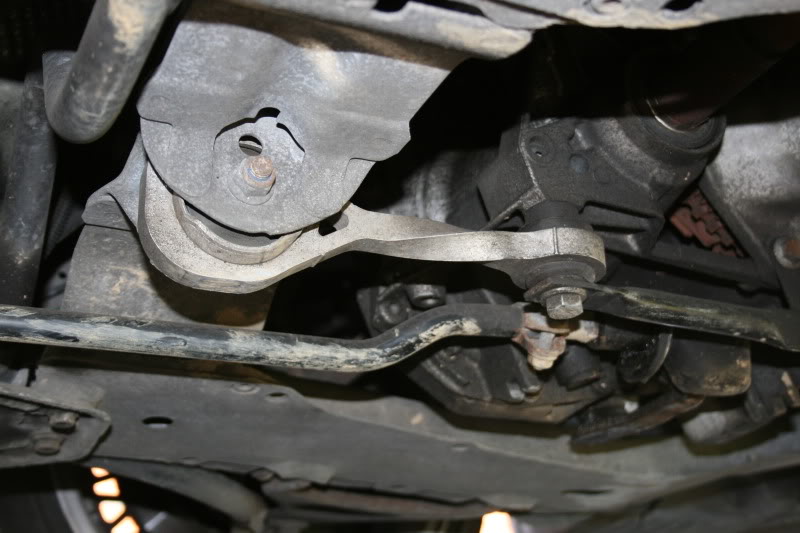

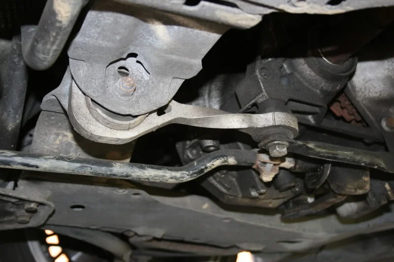

Basically i'd like to powerflex my dogbone mount and ive been unable to find any info on doing it to a 1.6, what im wondering is if its the same as the 172's mount? as i'd then be able to buy a second hand one do the bush work and sling it straight on without any hassles.
Heres a pic of mine :
Cheers, Keiran
I see, im presuming the differences would be mainly in the diamteres needed for the bushes? its just from what ive seen of the 1*2's dogbone they look pretty similair to mine in the pic above.

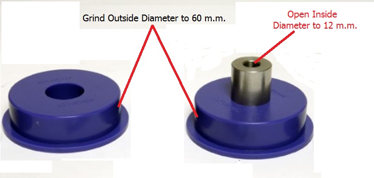

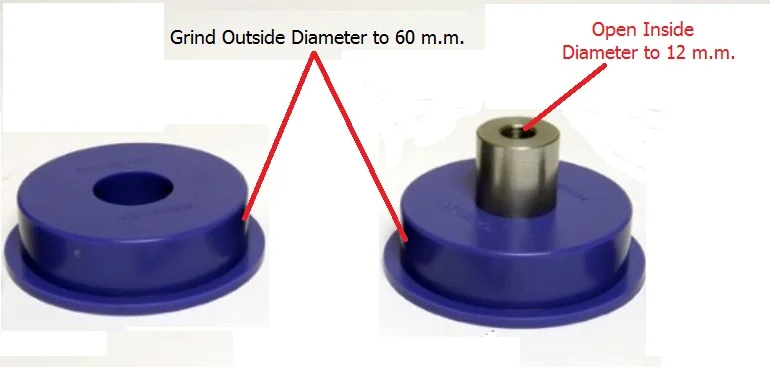

I got Clio Sport 2.0 set of PowerFlex DogBone bushings and grinded the outside diameter of the big bushing from 70m.m. to 60m.m., then drilled the center steel
boss from 10 m.m. to 12 m.m.
Something like this:

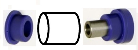

For the small bushing: The outside diameter was smaller than the DogBone (can't remember the size) so I fabricate an steel sleeve and "press it" to the dogbone,
this sleeve has same inside diameter of the small bushing.
