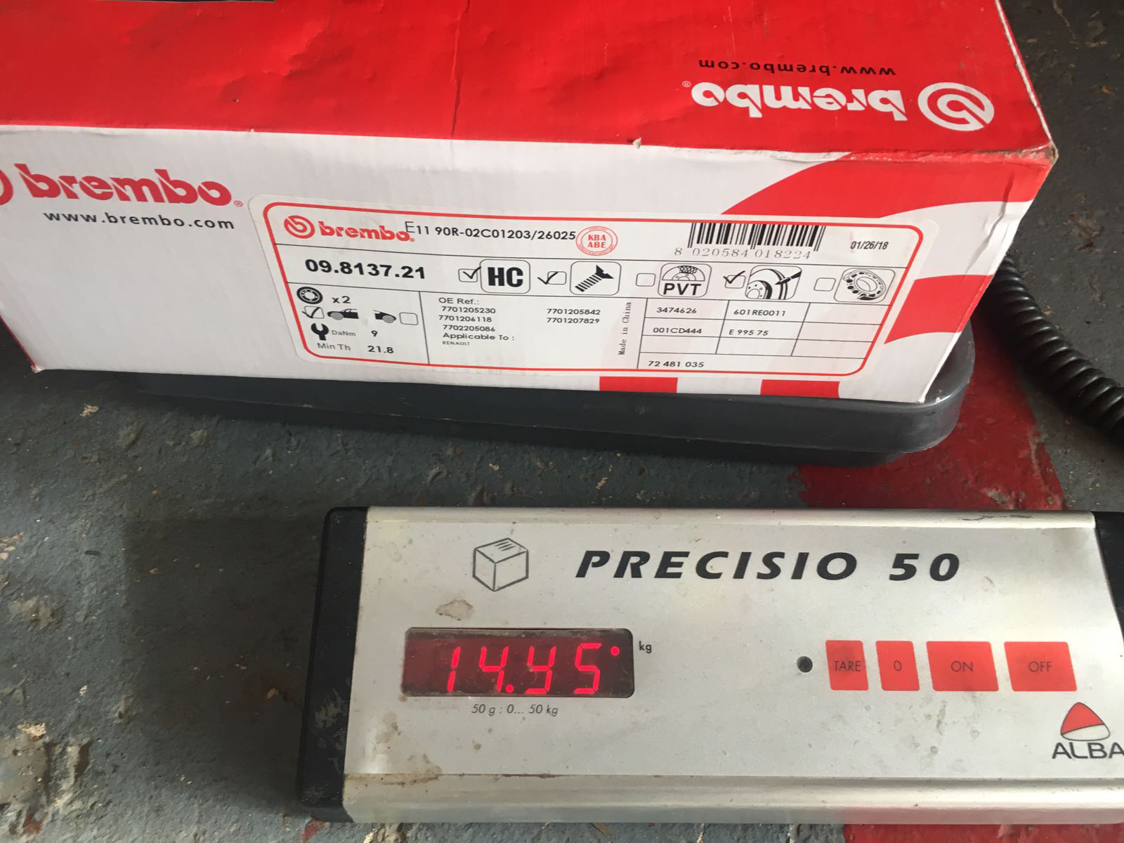

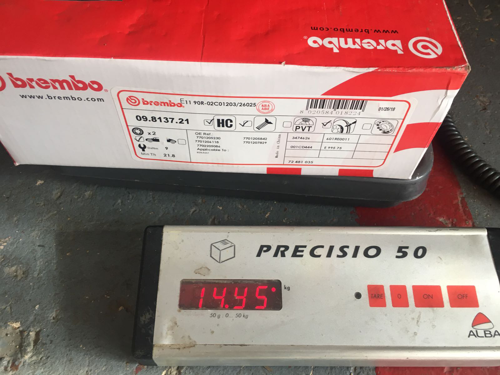

Some people tackle their brake solution by fitting the biggest set of discs and calipers they can under the wheels. I'm trying to fit the biggest I need. This will allow the suspension to work more efficiently due to the low unsprung weight.
I decided a 280mm disc would be about right. You can just about squeeze a 305mm disc under 15's with the right wheel but thats far too big for a lightweight car...
I've gambled on an AP Racing disc with reduced cooling vanes and reduced thickness. Hopefully this will prove adequate when we get to a testing stage as we are aiming for a car massively lighter than standard.
So to put the weights in perspective. Your Clio average Clio 172 runs a 280 x 24mm disc. Originally came in just over a tonne in weight. Hard core racers may get to 850kg. I should (fingers crossed) be 100kg lighter still and running much larger pads than the original calipers too.
The fat shaming scales say...14.95kg for a set

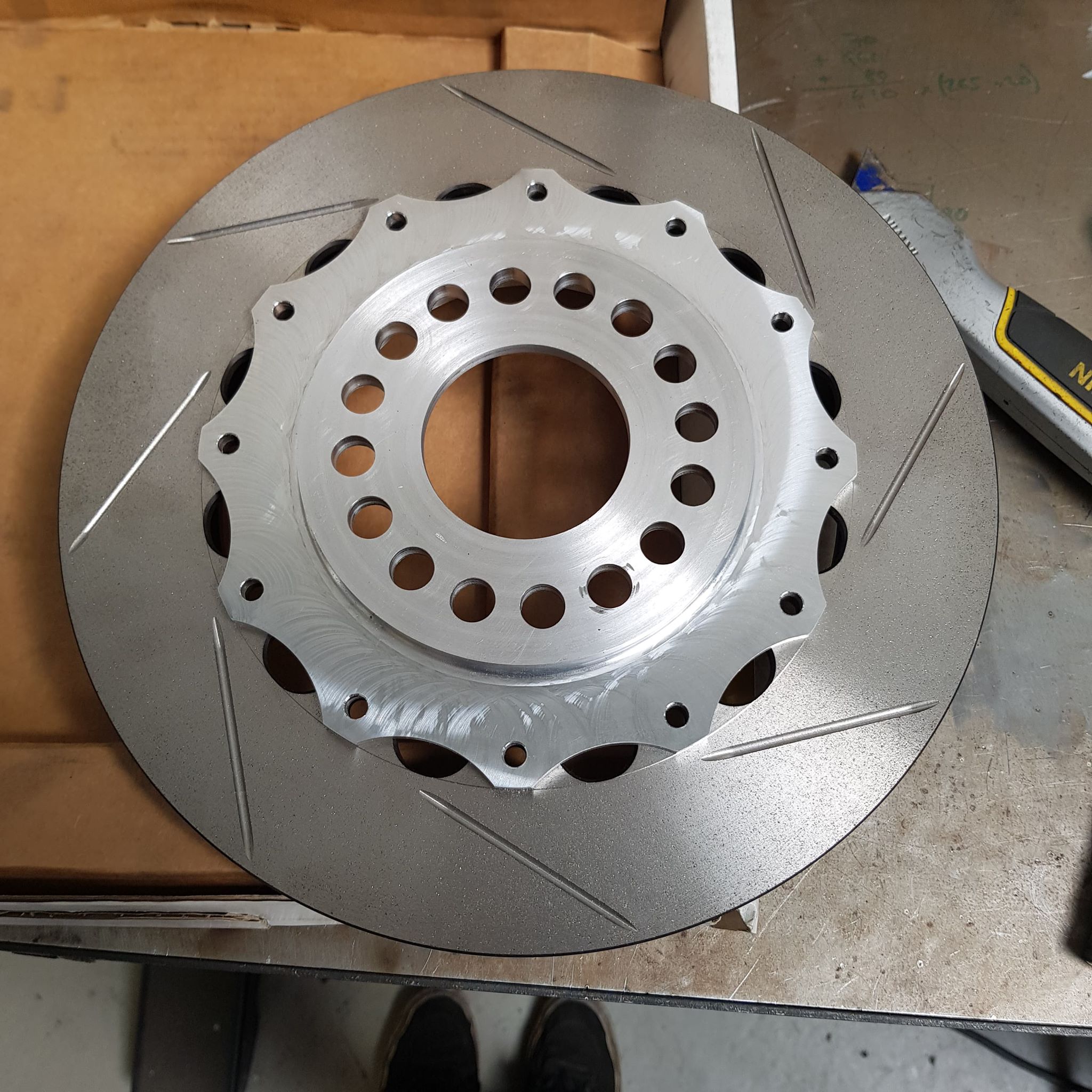

As I write this I've realised I actually changed my mind on the discs lol. The 25mm discs were only a little heavier and would cope with more sustained abuse.
We've had the bells made and the resulting weight is 3.1 kg per side! I think a few more holes could be drilled to get it to 3kg per side lol Standard 247mm disc from a 1.9 gti is 4.3kg and these are 4.4kg per side lighter than those Clio discs. This is a performance upgrade with no penalty (other than the wallet).
GSF supplied discs I see ?
The unsprung weight is important and you'll gain with the calipers too, but the rotational inertia of the disks under both acceleration and braking is a substantional gain too!
Bigger pads should give better heat handing ability, but wont actually affect your braking power.
I'll be running Alcon 4 pots. They dont use a massive pad but its a fairly decent size and the calipers a nice weight. Brakes are pretty much only about heat really long as its up to the job of applying enough hydraulic pressure to maximise the tyre/ground friction co-efficient.

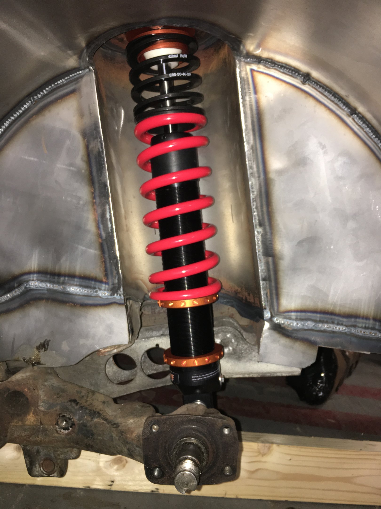

Its been a while. A busy summer has taken the pot off the boil a bit. We are on final assembly of the front subframe, suspension and a custom engine sump. I collect the shell end of the month so we can move onto the next phase!

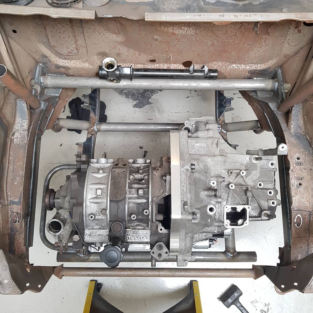

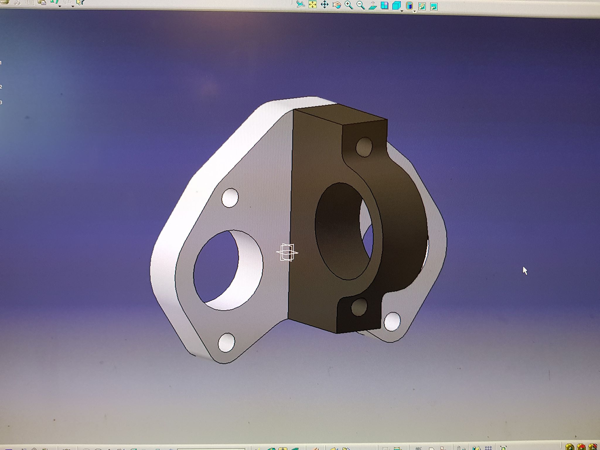

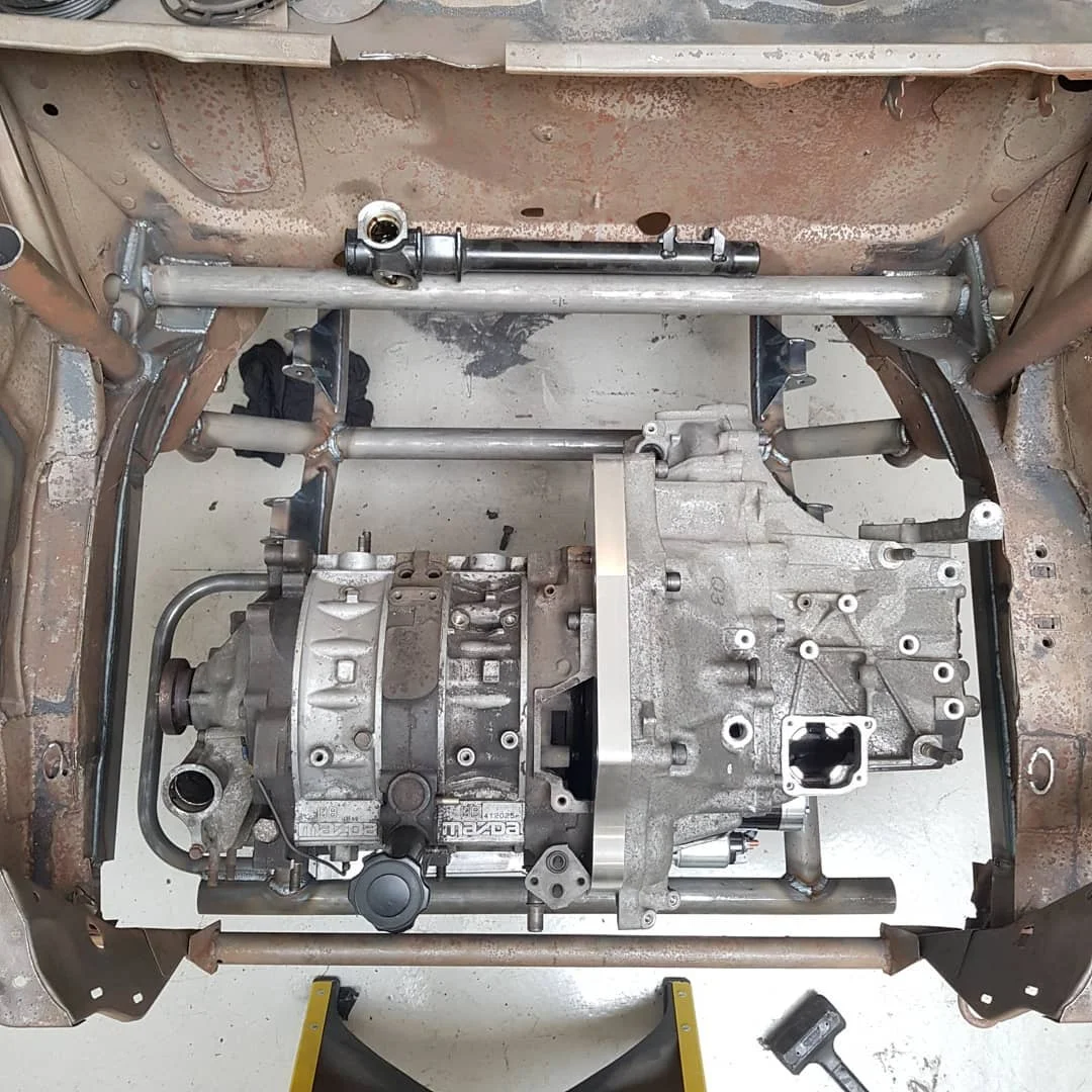

At the moment progress is frustrating. The puzzle to solve is where to put an intermediate driveshaft bearing.
Theres a couple of options - this being the easiest to make as it will not involve welding onto the cast alloy engine front casing.

The dilema is this puts the shaft bearing about 100mm away from the inboard plunge joint. I don't know whether this is a bad thing or not.
I'm waiting for more clever people to tell me whats what before doing a test on manifold clearance as it'll be tight.

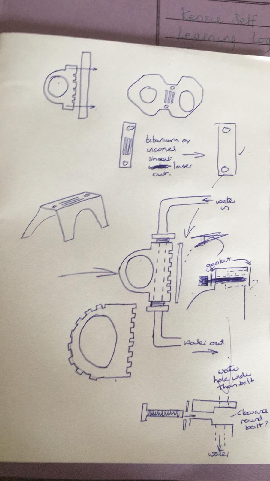

Slow updates...
We are going with the bearing housing in between the exhaust manifolds. Its drastically better for driveshaft angles.

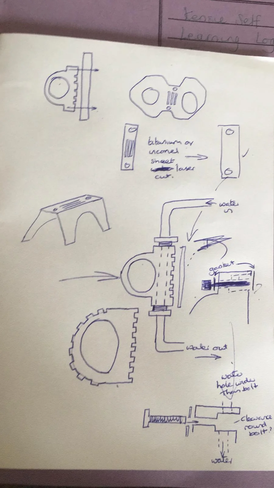

What do you do when a high temperature bearing is not high temperature enough! Apparently they are only rated to 130degrees centigrade so I'd call that a mildly warm bearing.
Cameron came up with an idea to run the bearing on a bridge between the inlet manifold and sump. Now we originally said no to this a while back due to the amount of strengthing needed for the sump and the high risk of a big mess if there was driveline issue which ripped the sump open.
I dont like it
A: Because i'm in the process of getting a sump made in the USA,
B: its complicated, needs a lot of extra custom components and
C: its not very elegant.
So while helping my daughter do her homework I brainstormed increasing surface area of the housing, decreasing contact area against the engine and then hopefully the route we will take....

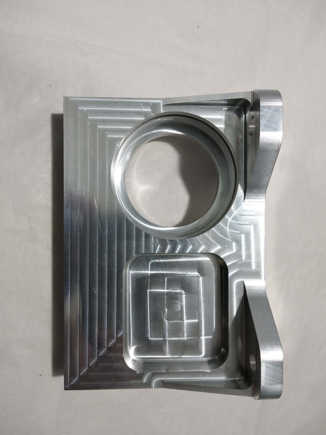

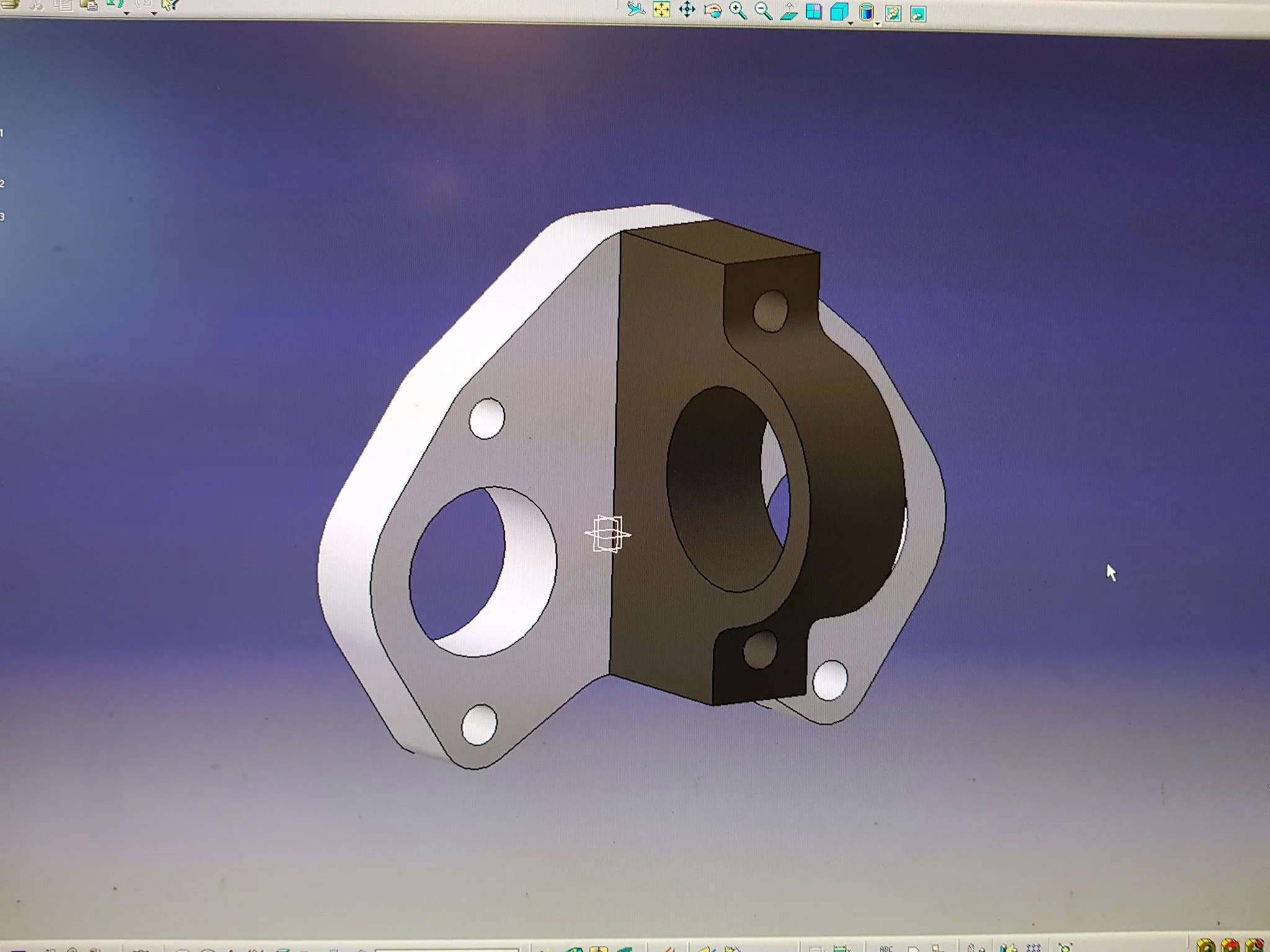

Theres always a balance to be found from the initial design to something that can be affordably manufactured. I wanted the water cooling between the bearing and the engine but the inlet manifold above was so close we'd have fitment issues. The alloy hopefully will stay cool enough though that it wont matter. As long as a bearing lasts an event we will be ok!
