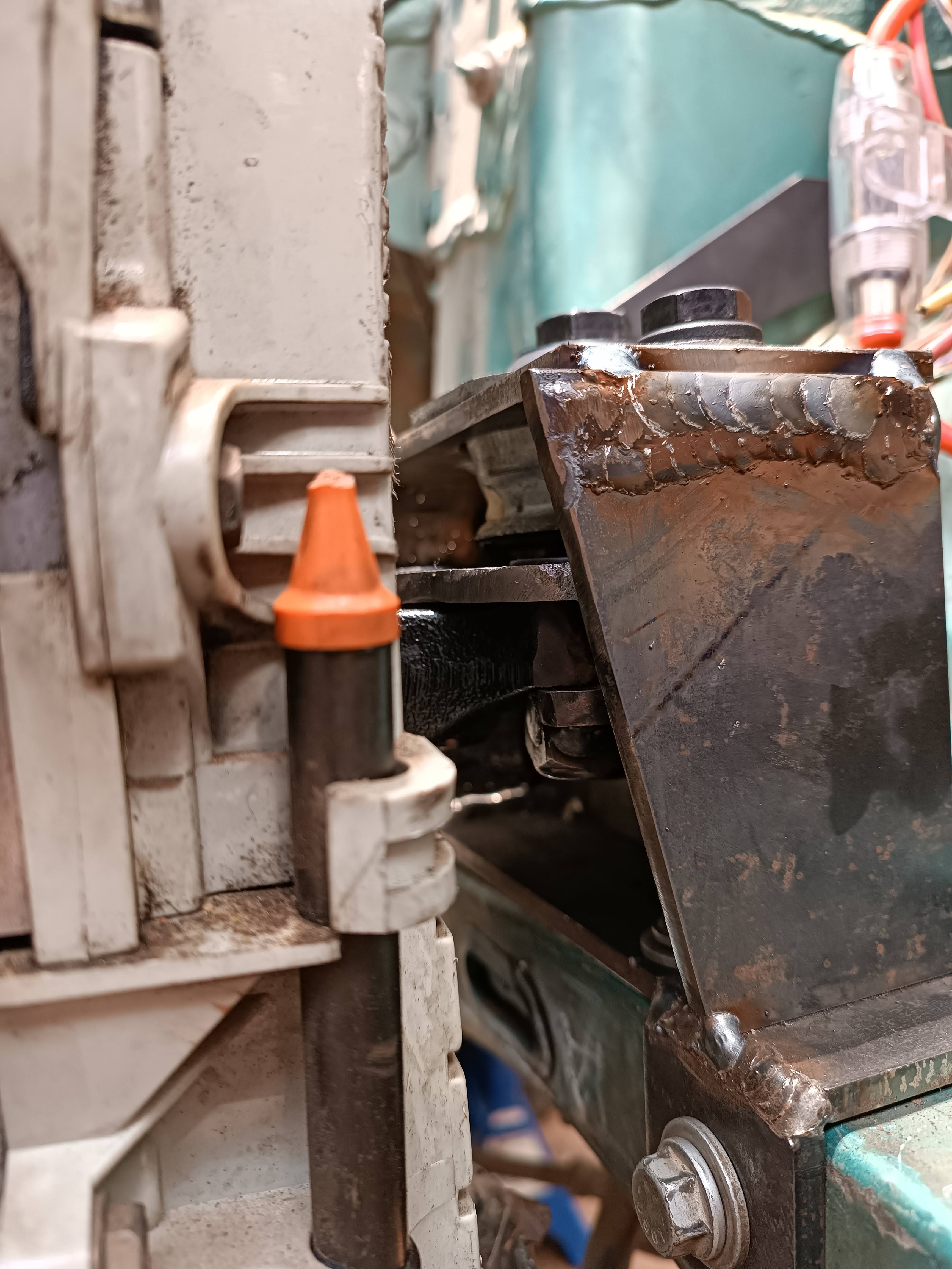

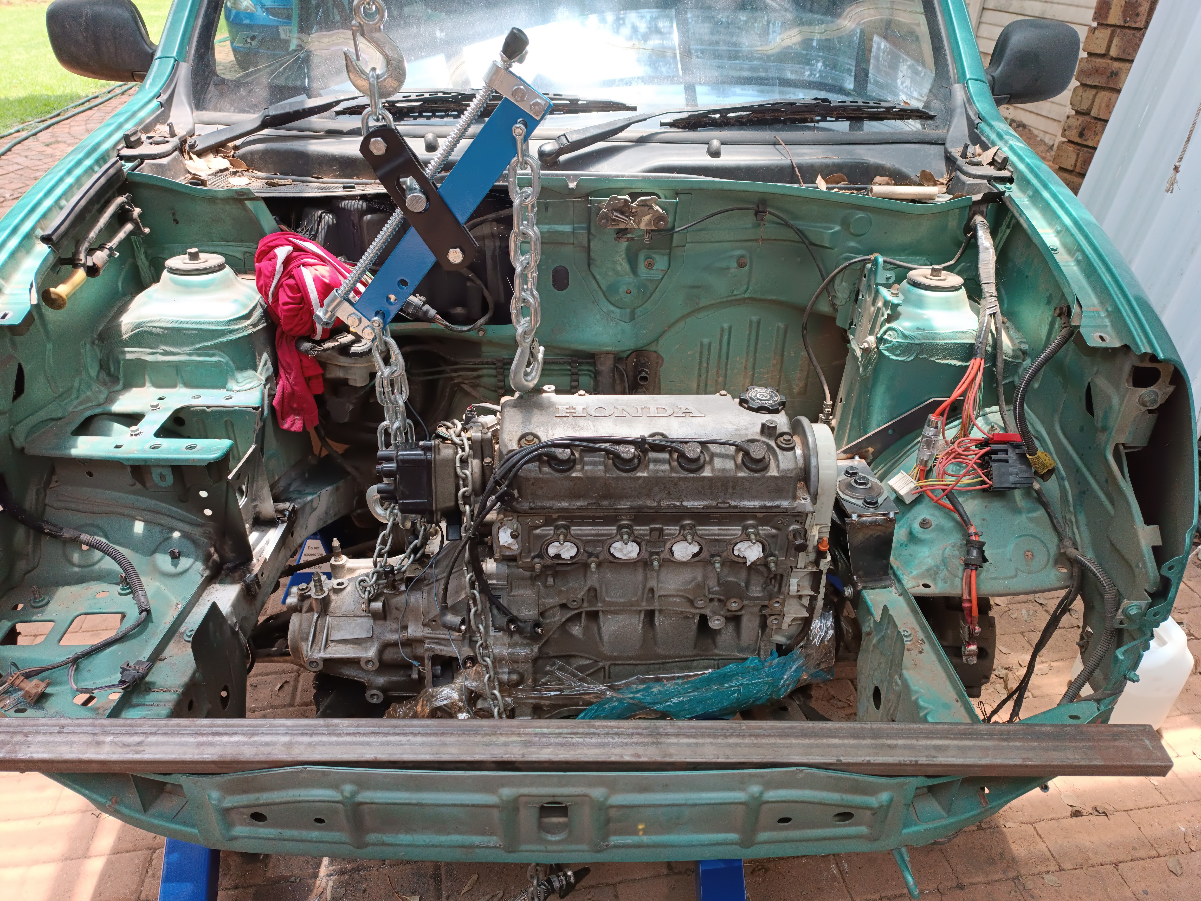

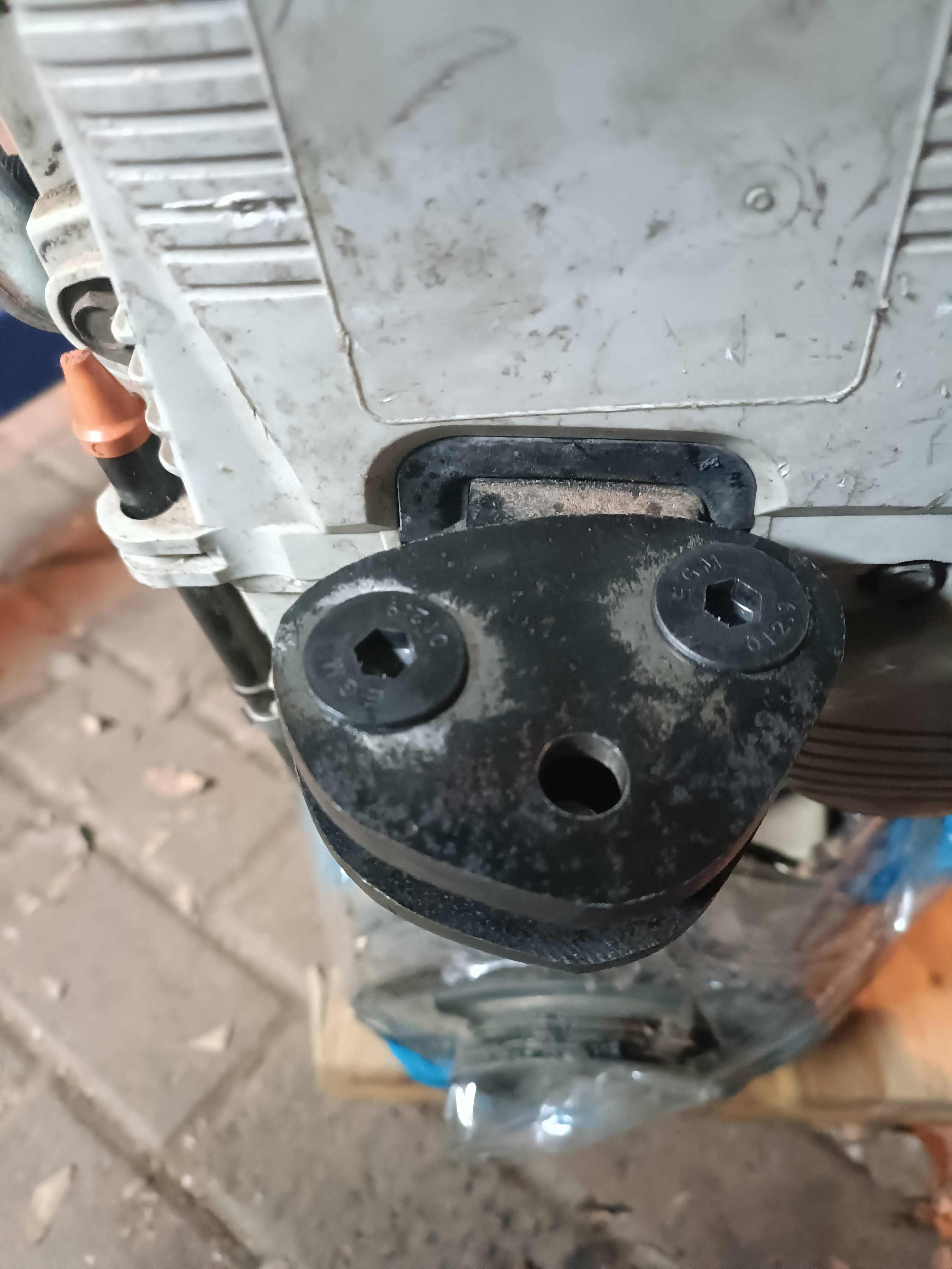

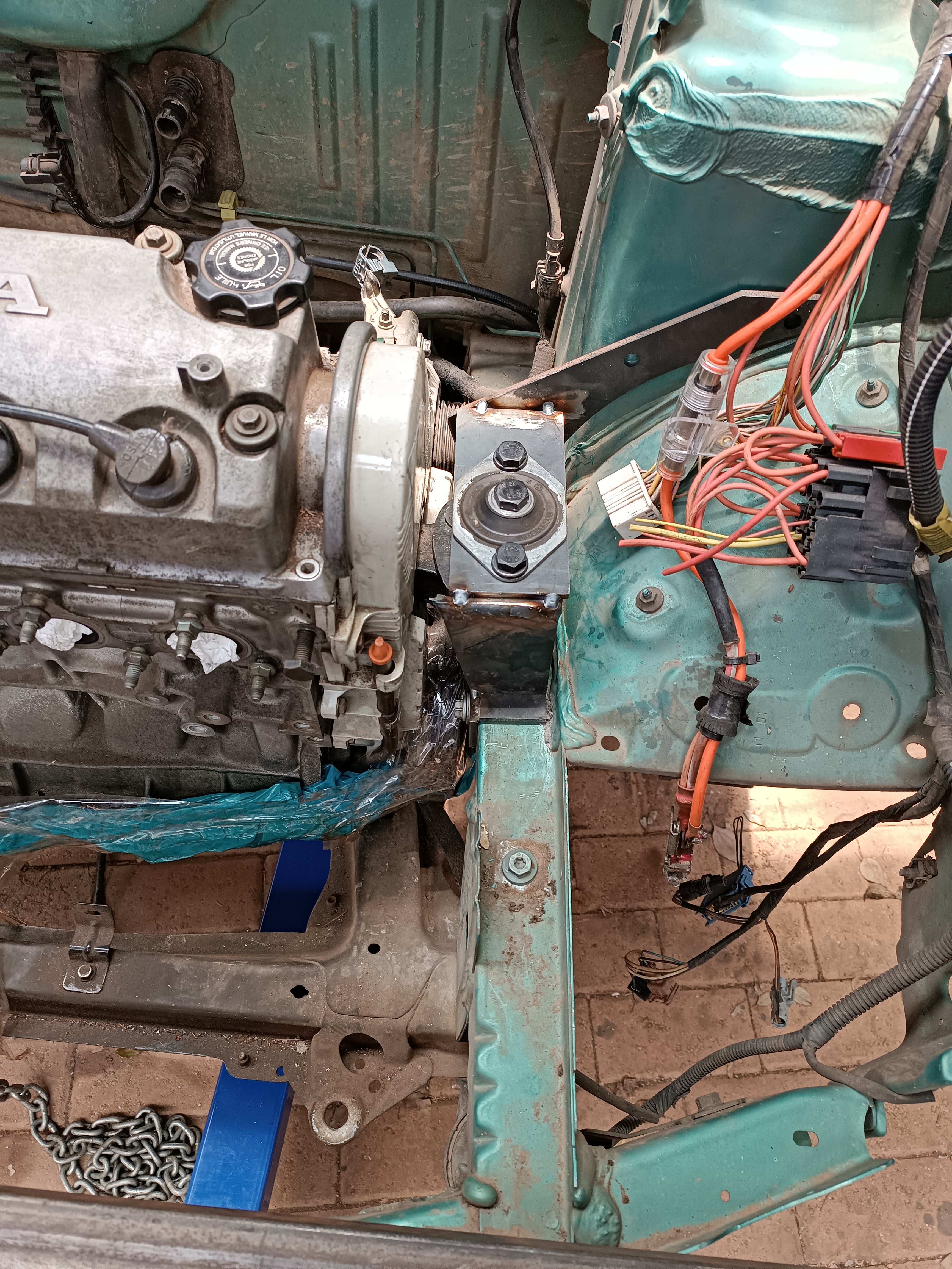

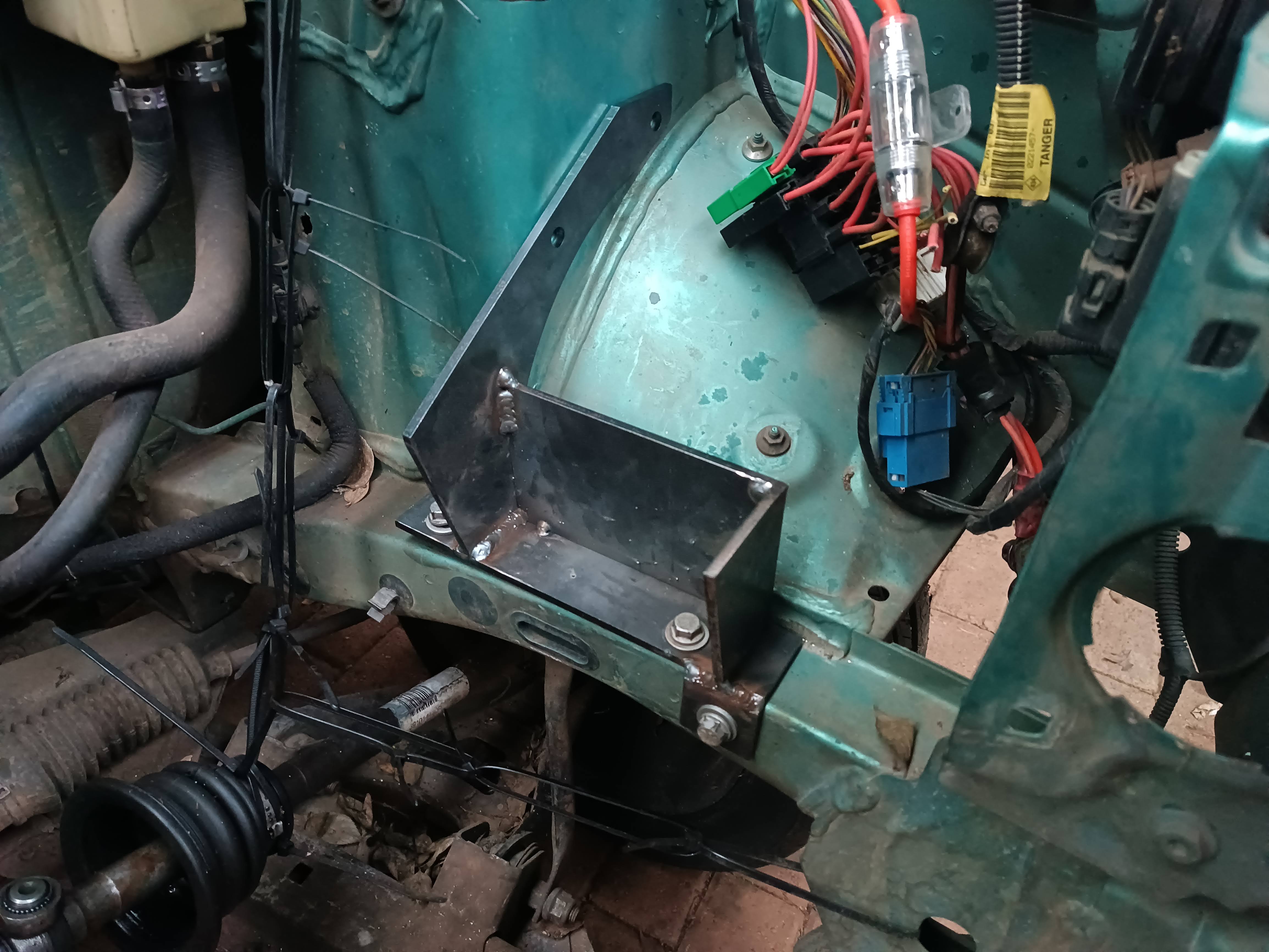

Just some pictures of the engine in the engine bay.
